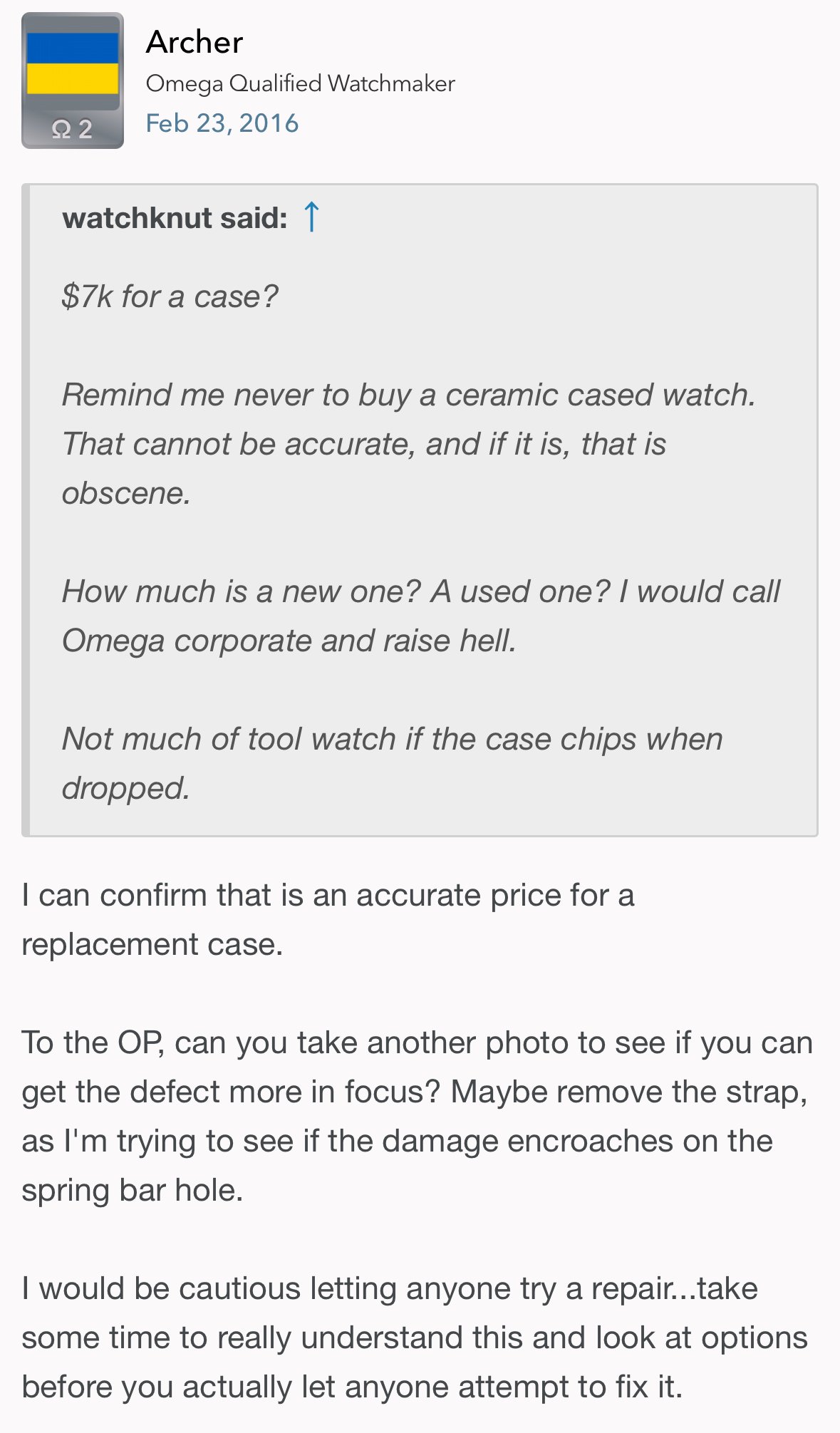

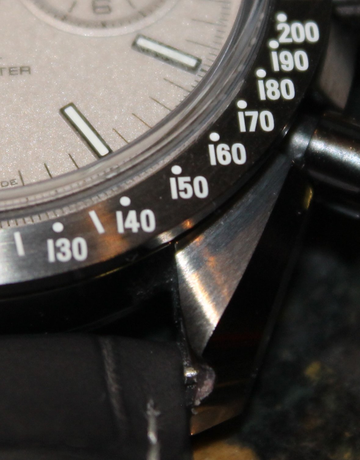

This is the thing with ceramic cases… I believe they are considered an exotic material and as such, it’s quite an expensive material to replace. They are strong and durable, but on the flip side, they are quite brittle and can fracture/chip/break on impact. Just look at this Grey Side of the Moon Speedmaster.
That photo was taken from this thread in 2016, where Omega was charging 7k to replace the case
