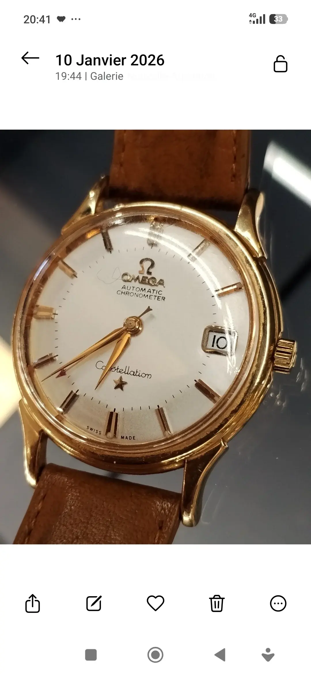

Nearly mine... Is it authentic ?
Hello, I'm a newby : I really want to buy this Pie-pan, normally in massive Gold 😅

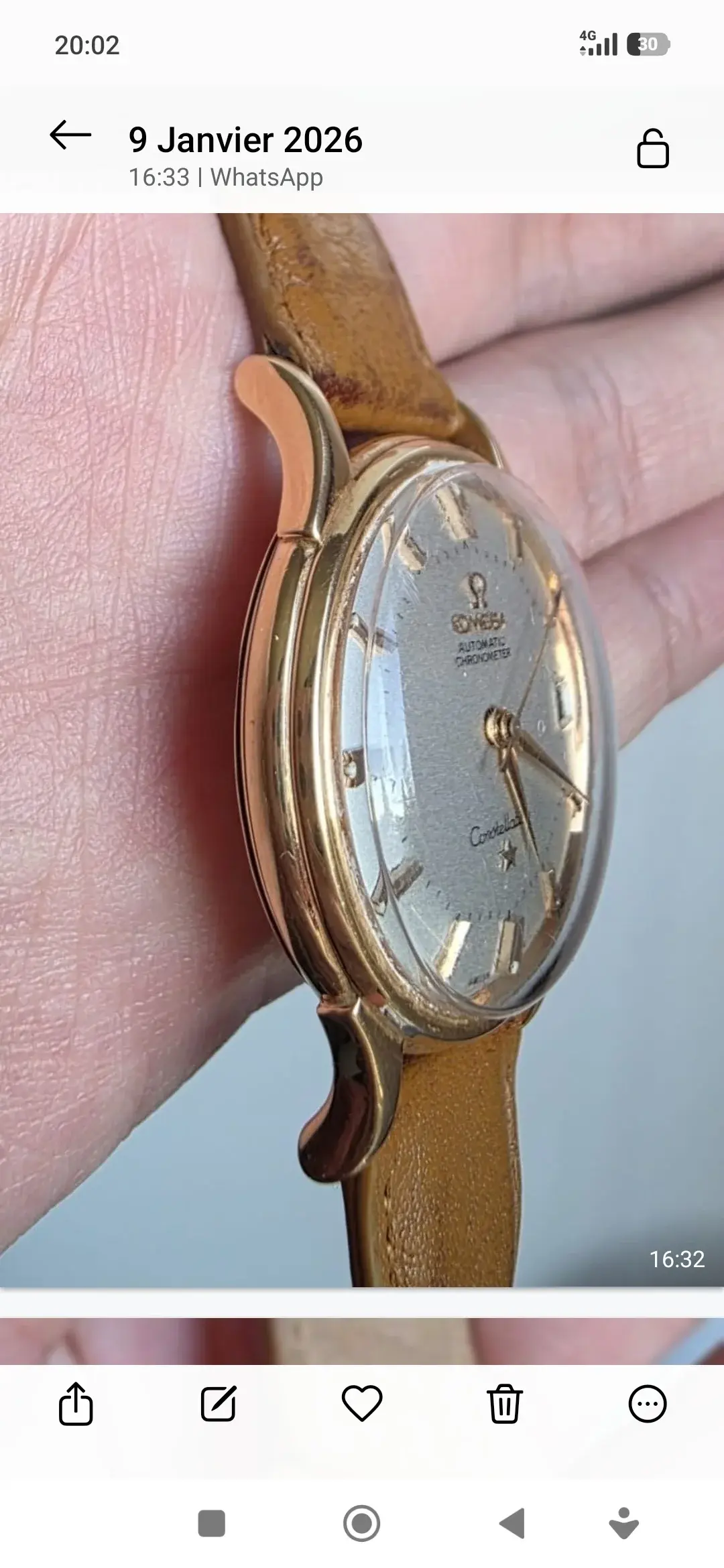

I know hands aren't originals...
It was made in a 1947 if we follow movement's serial number

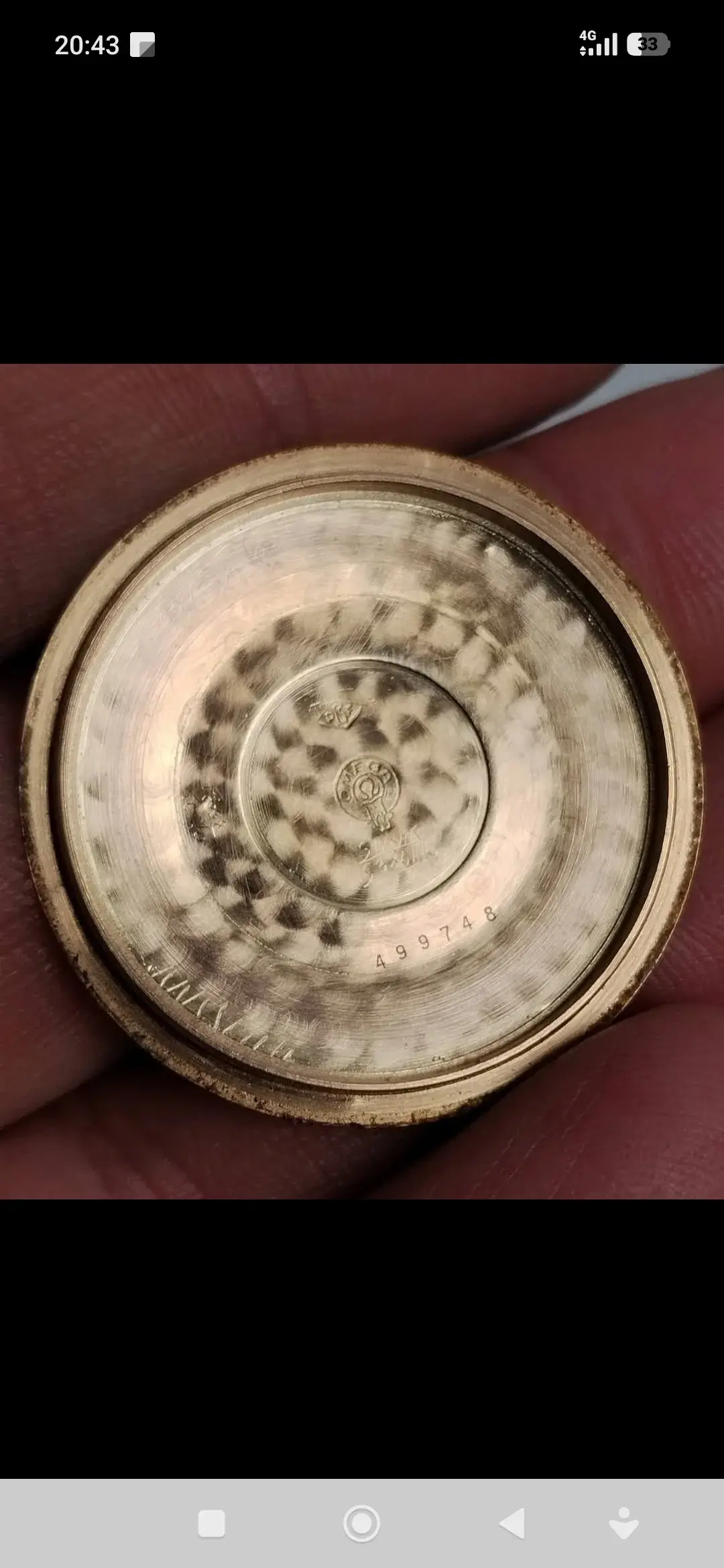

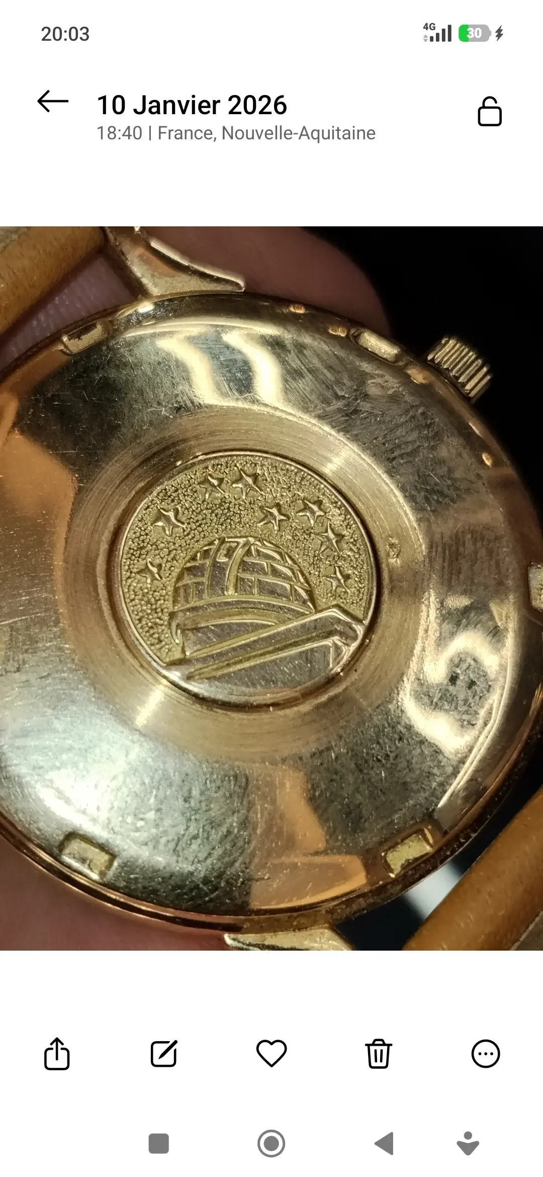

I feel strange about the caseback...
And you, what do you think about it, please 🙏 ?

I can't speak to authenticity (though that dial is pretty suspicious), but for me, that isn't NEARLY enough 'pie pan' for me to spend pie-pan money on.
The case has a few things that are suspicious to me beyond being pretty polished (one of the best parts of these cases is how 'sharp' the legs are)., like lacking a gold-hallmark (I suspect the PBF is a makers mark?).
That said, even if it IS completely authentic, this isn't a watch I would buy.

With the others on this. Seen better alternatives out there. Would pass on this one.

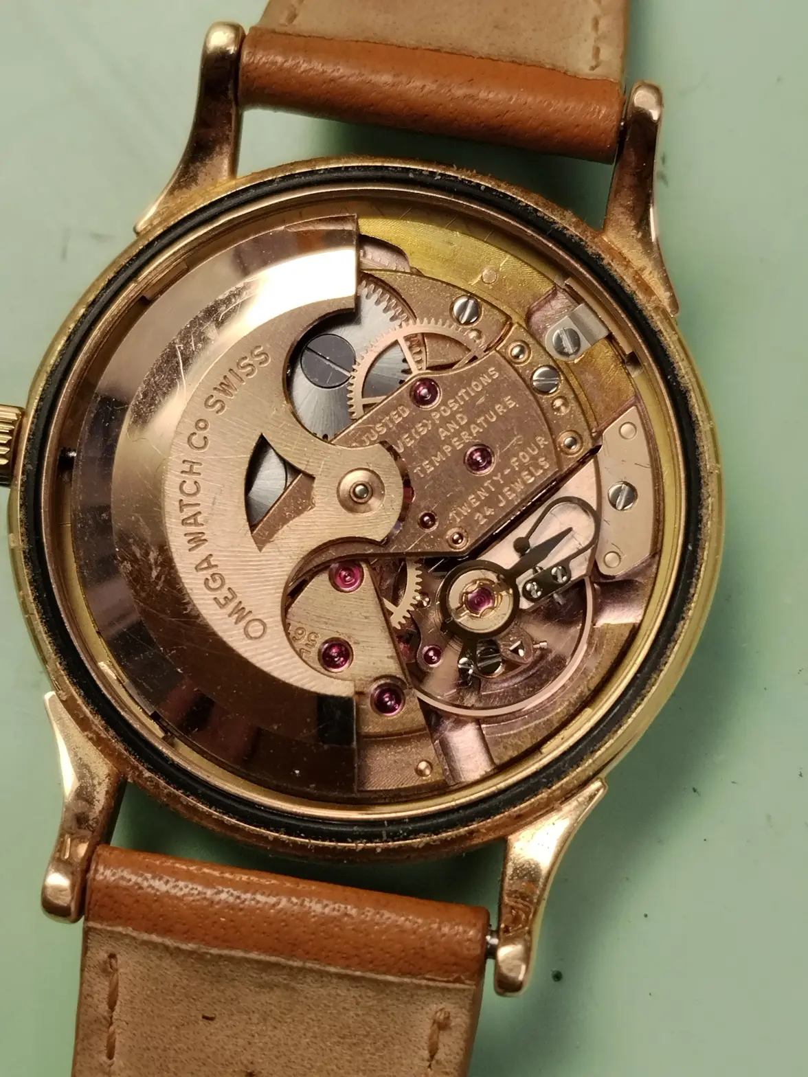

Not even remotely a 1947 watch either, the Cal 561 was released in 1958 and Constellations didn’t exist in ‘47.
Rough watch and the seller seem to be giving you very bad information.
