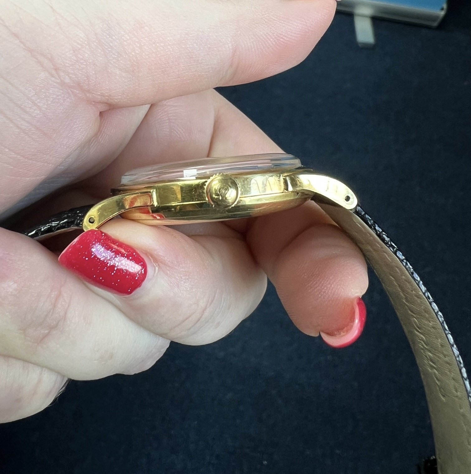

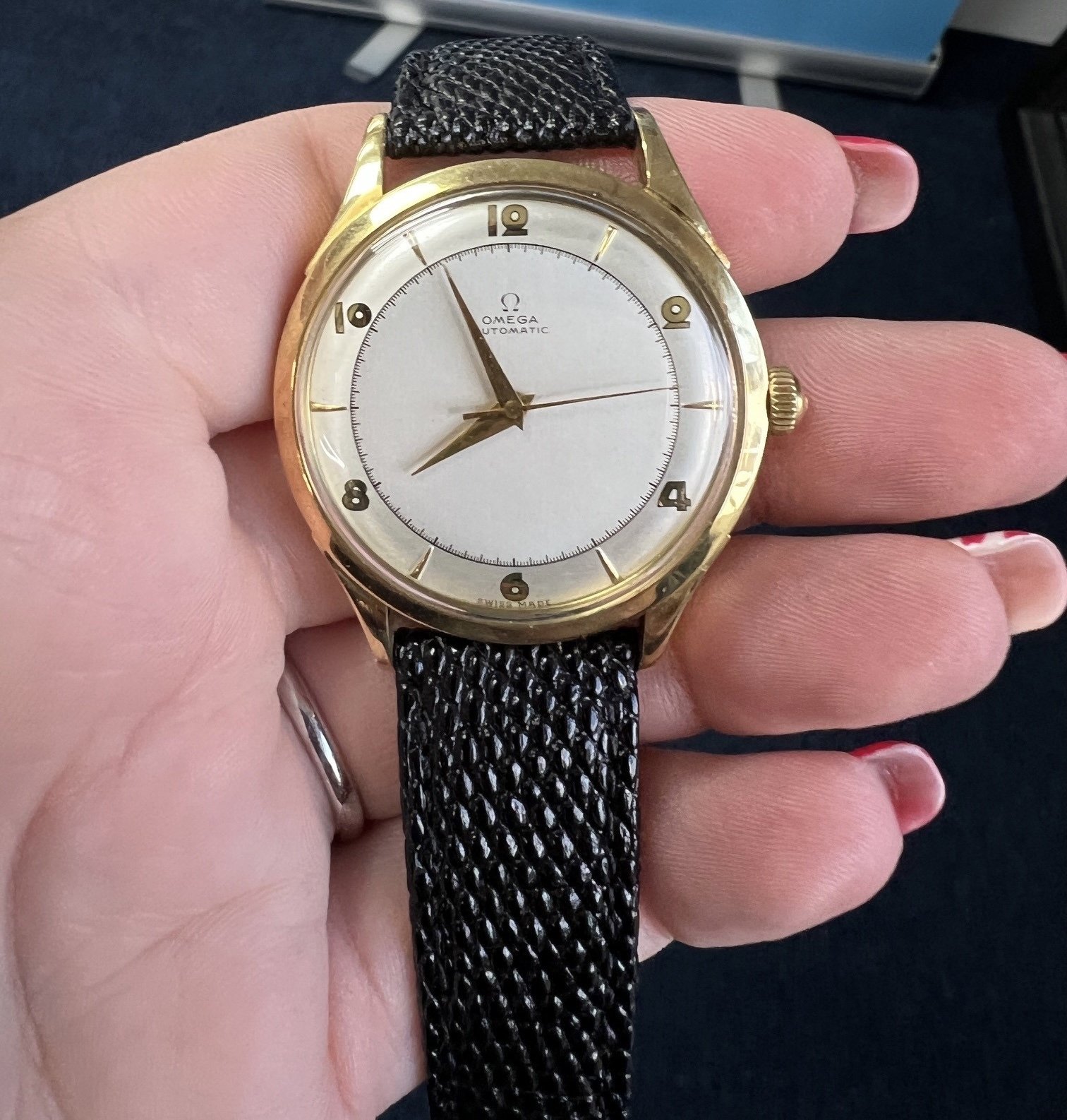

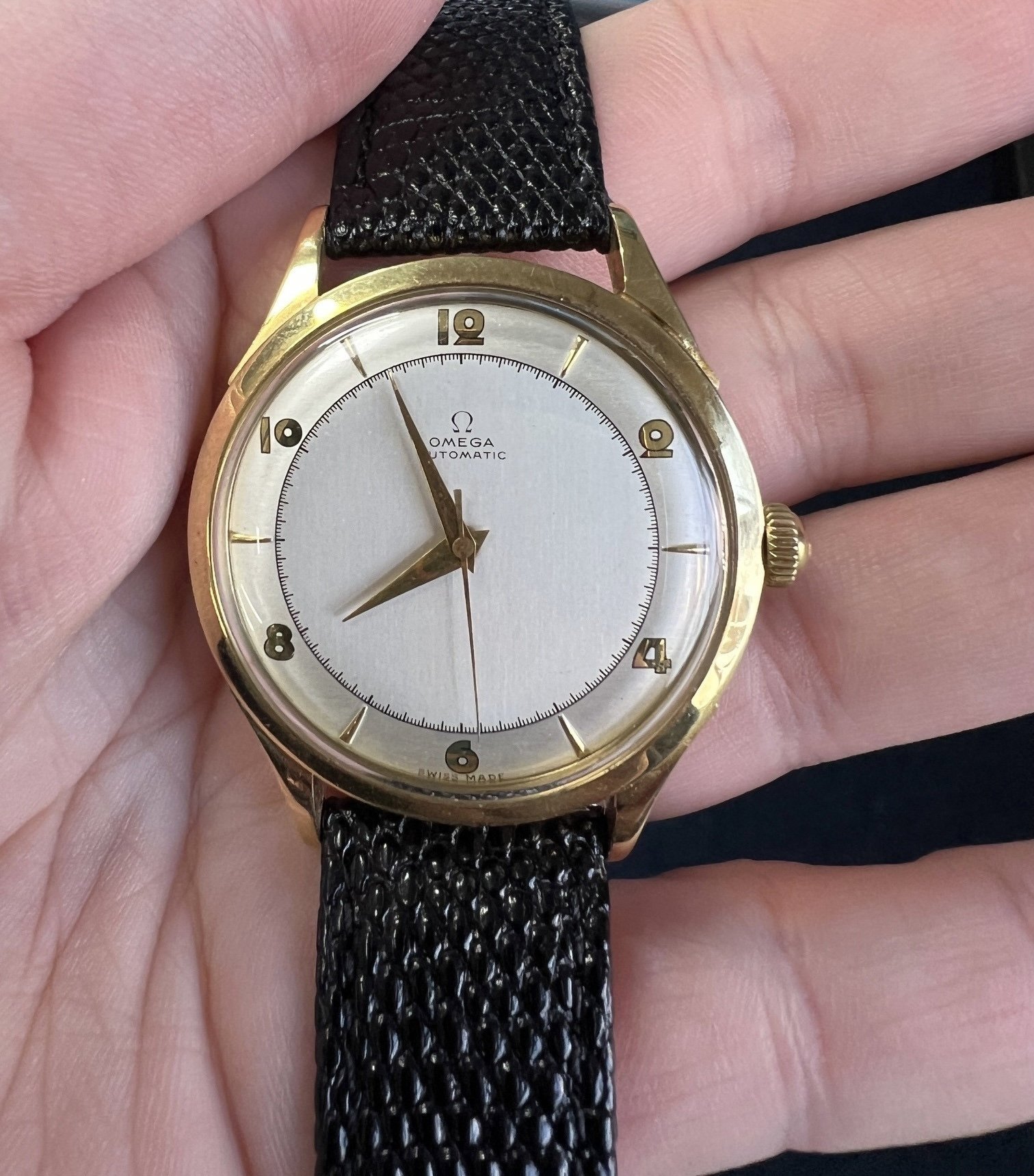

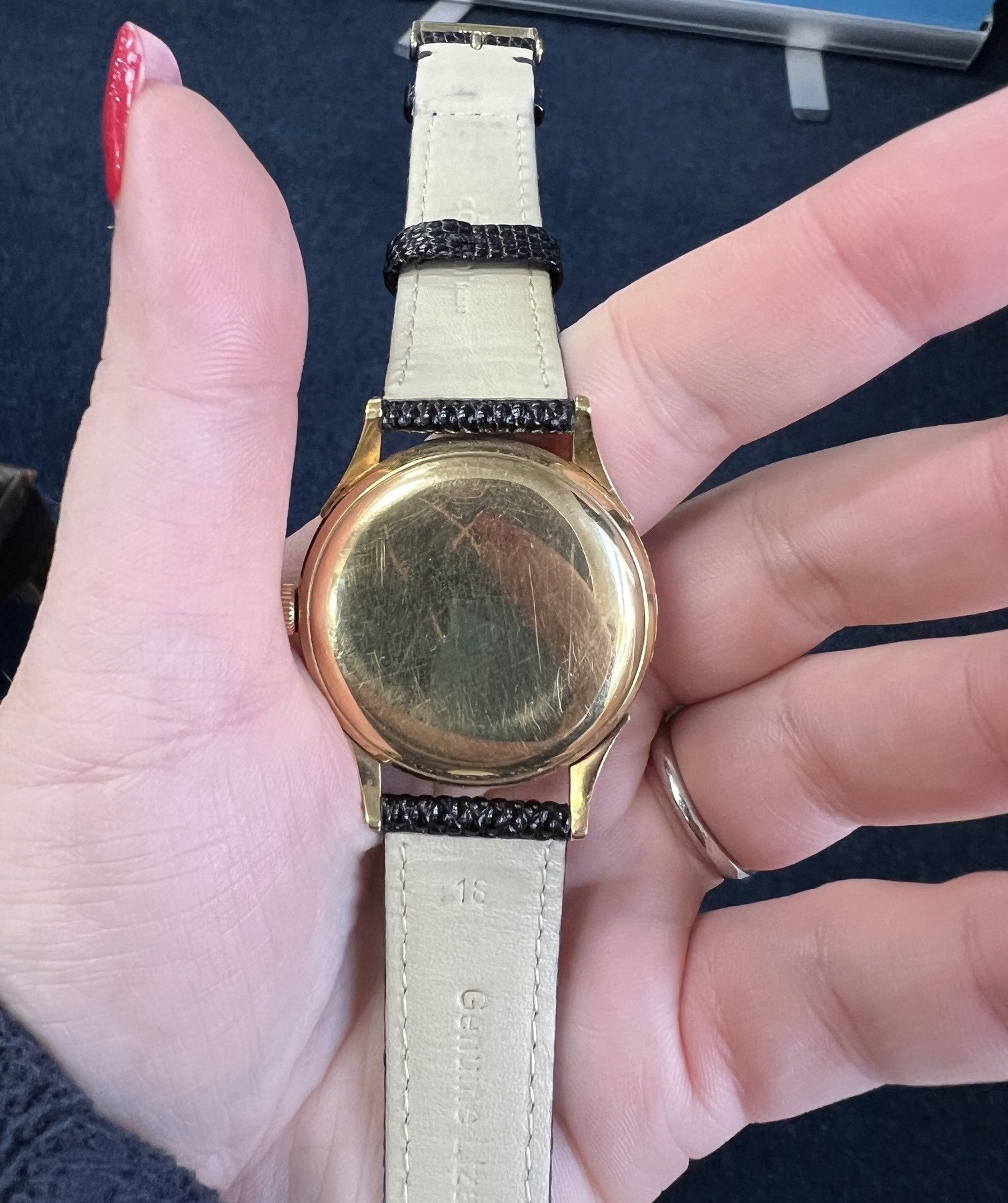

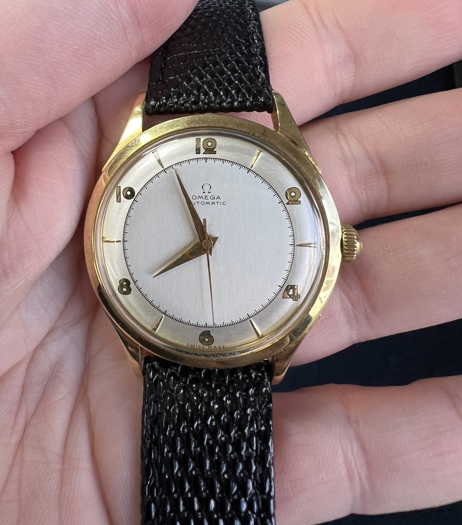

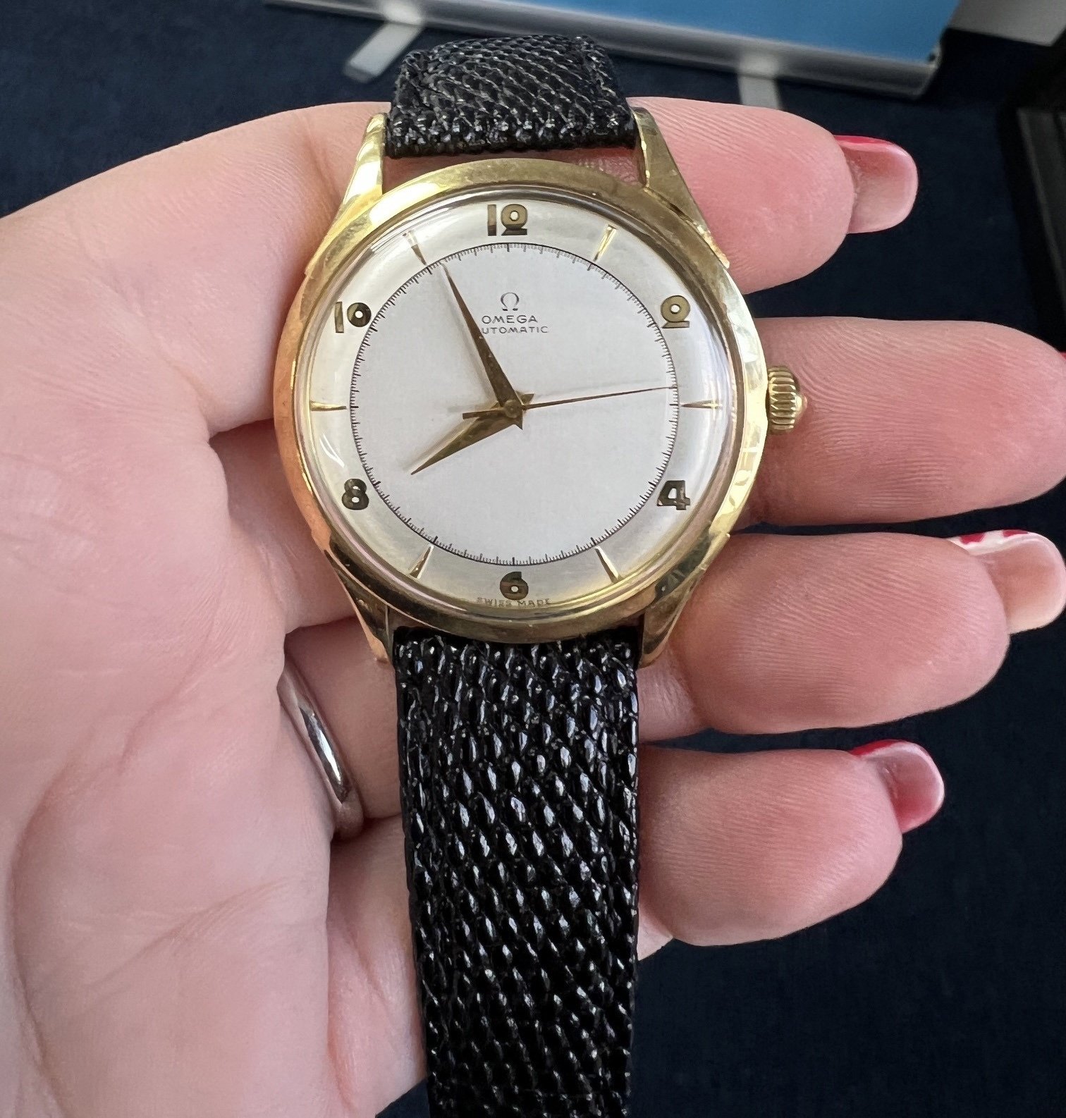

What is this Model and is it Authentic?

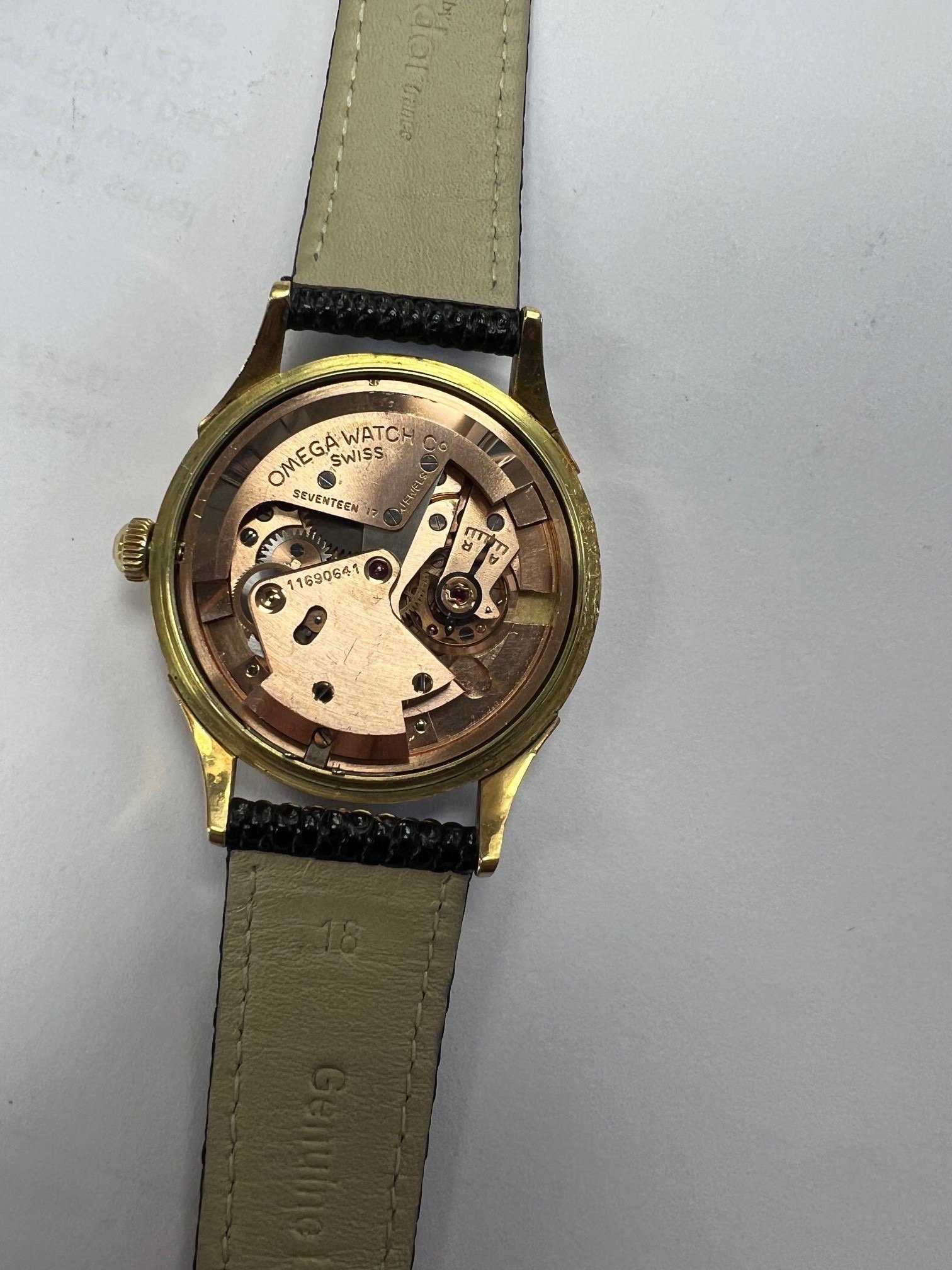

It’s real. Small modification, but nothing that affects the watch.
some models used a curved clamp and the back to hold the movement in place to keep from lifting. Poor design.
someone placed a flat added clamp to hold the movement in place. Only problem is the incorrect type of screw, but can be left as is.

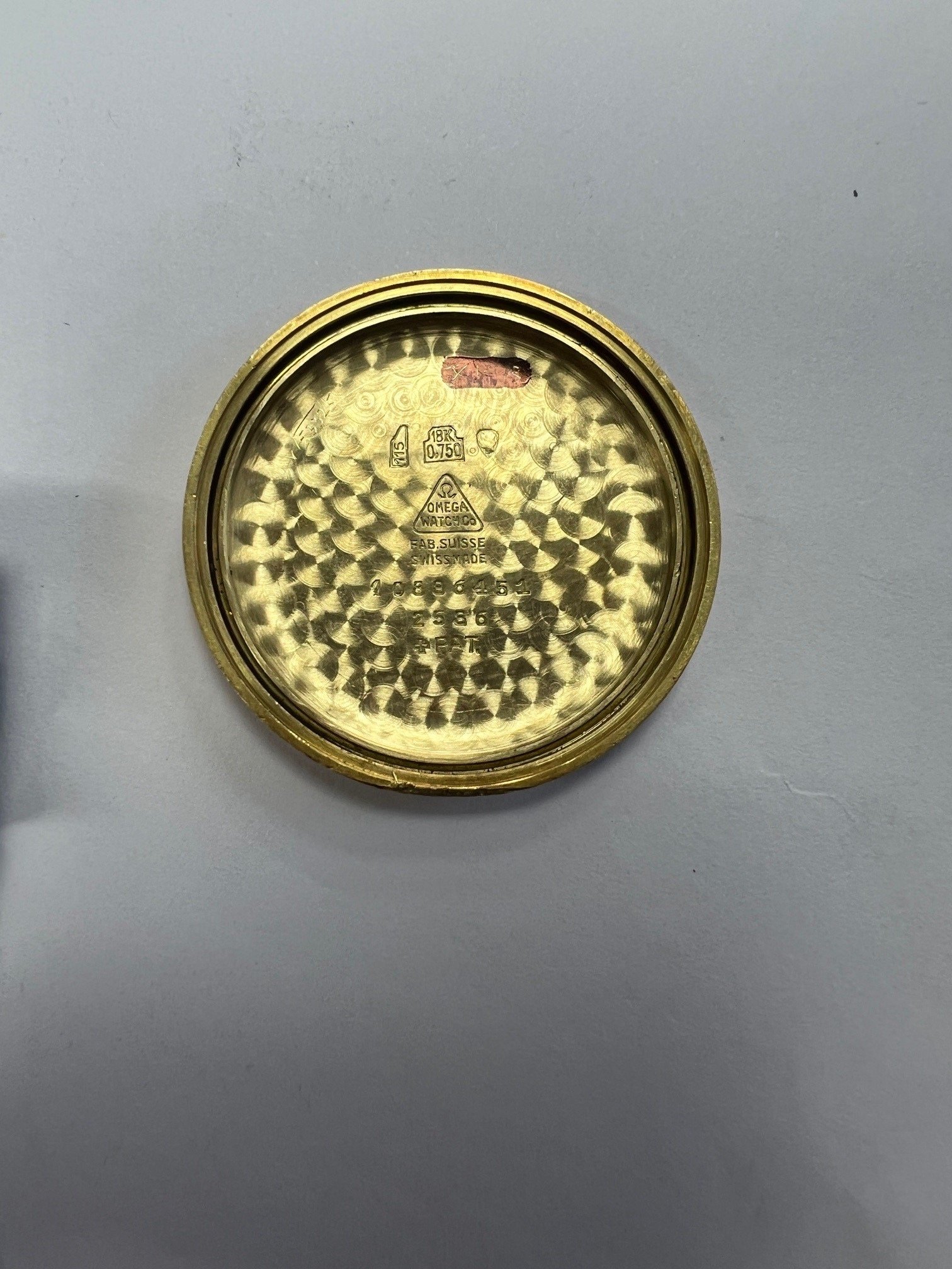

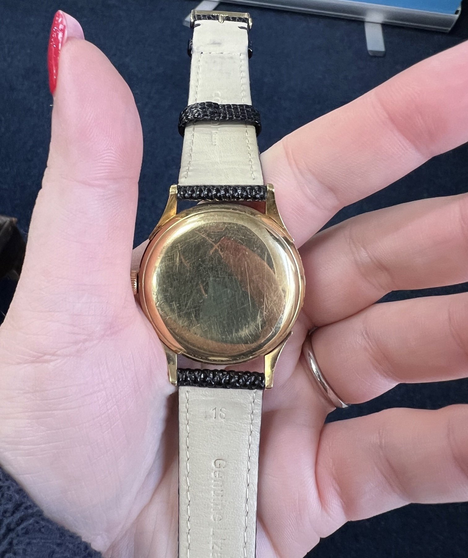

reference number on inside back. The 4 digits
Not all models have names.

Is this a 30.10 SC or a 351 bumper? Scan with the rotor moved would help with that determination.

Nice watch.

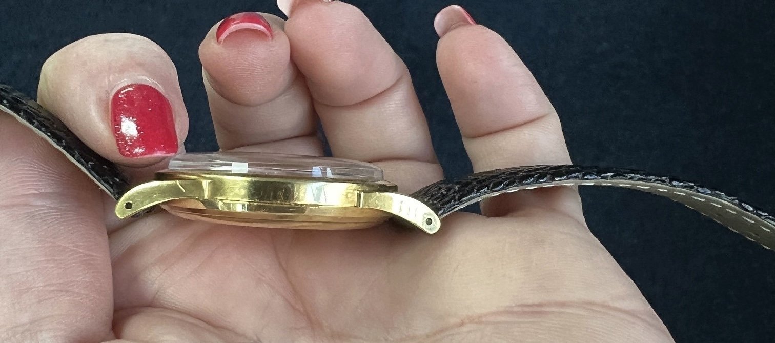

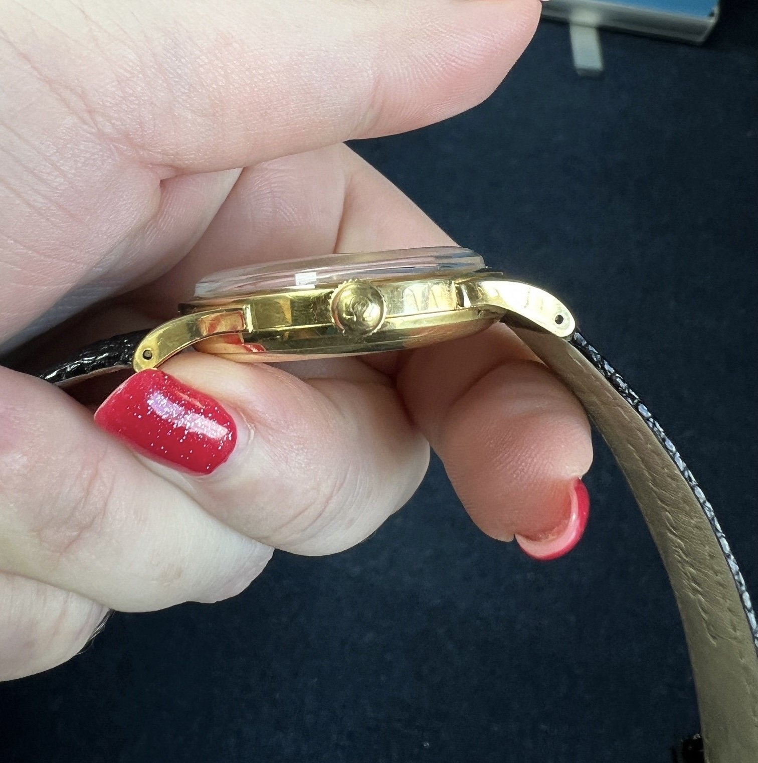

The casemaker is Manufacture Favre & Perret SA, based and active in Le Crete-du-Locle since 1934.
