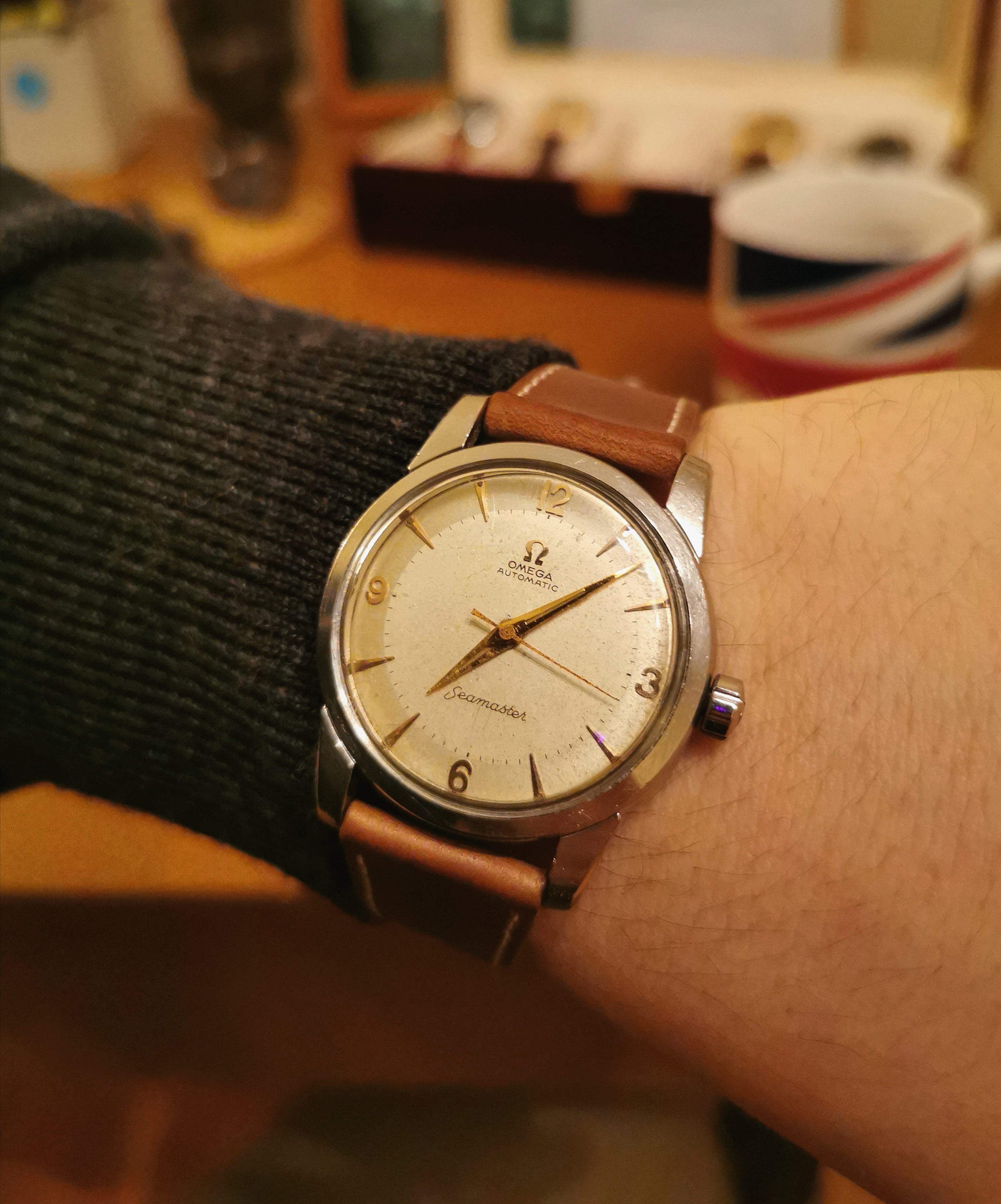

Hi everyone, another snowy icy day in Germany and I hope everyone is safe.
I would very much like to ask you all if anybody has had a similiar experience to mine in regards of power reserve on a vintage and recently serviced piece.
I am fairly new to the vintage game and have only around 4 vintage Omega pieces, including a 40s Rosegold ref. 2438 with a cal. 354, a Seamaster ref. 2767 also powered by a cal. 354, a C-Shape-Connie ref. 168.017 powered by cal. 564 and the watch in question, a Seamaster ref. 2846 powered by cal. 501.
So I was all happy to finally get my Seamaster ref. 2846 in steel after it was serviced by a watchmaker a close friend in the watch world trusts. It was part of the deal and I didn't have to pay for the service. The gentleman who sold me the watch paid for it.

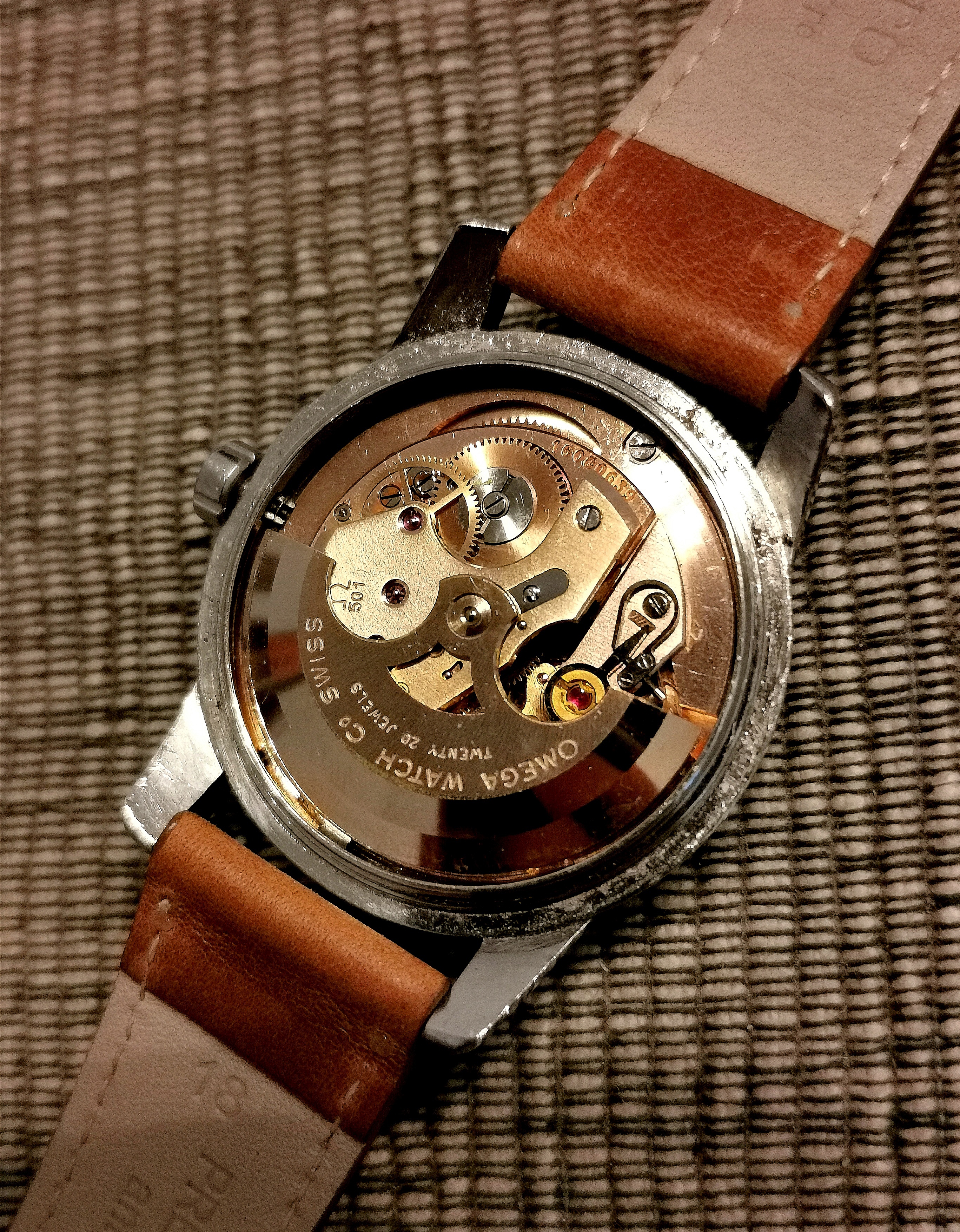

I took also a foto of the movement when I visited the WM last time.
My friend who is also a member went to really a great trouble to make sure I had the best experience with the watch and provided replacement parts for the 501 movement prior to it's service. I just don't understand what can be wrong with it as well. It looks really pristine.

Was the pinion for the rotor replaced? The rotor has signs of rather severe wear from scraping on the inside of the case back. If that wasn't addressed, it could be part of the issue.
But I would suggest a test that takes your wearing it out of the equation. Wind it fully - as many turns as you think is needed to make sure of that - set the time, lay it down dial up, and see how long it runs.
