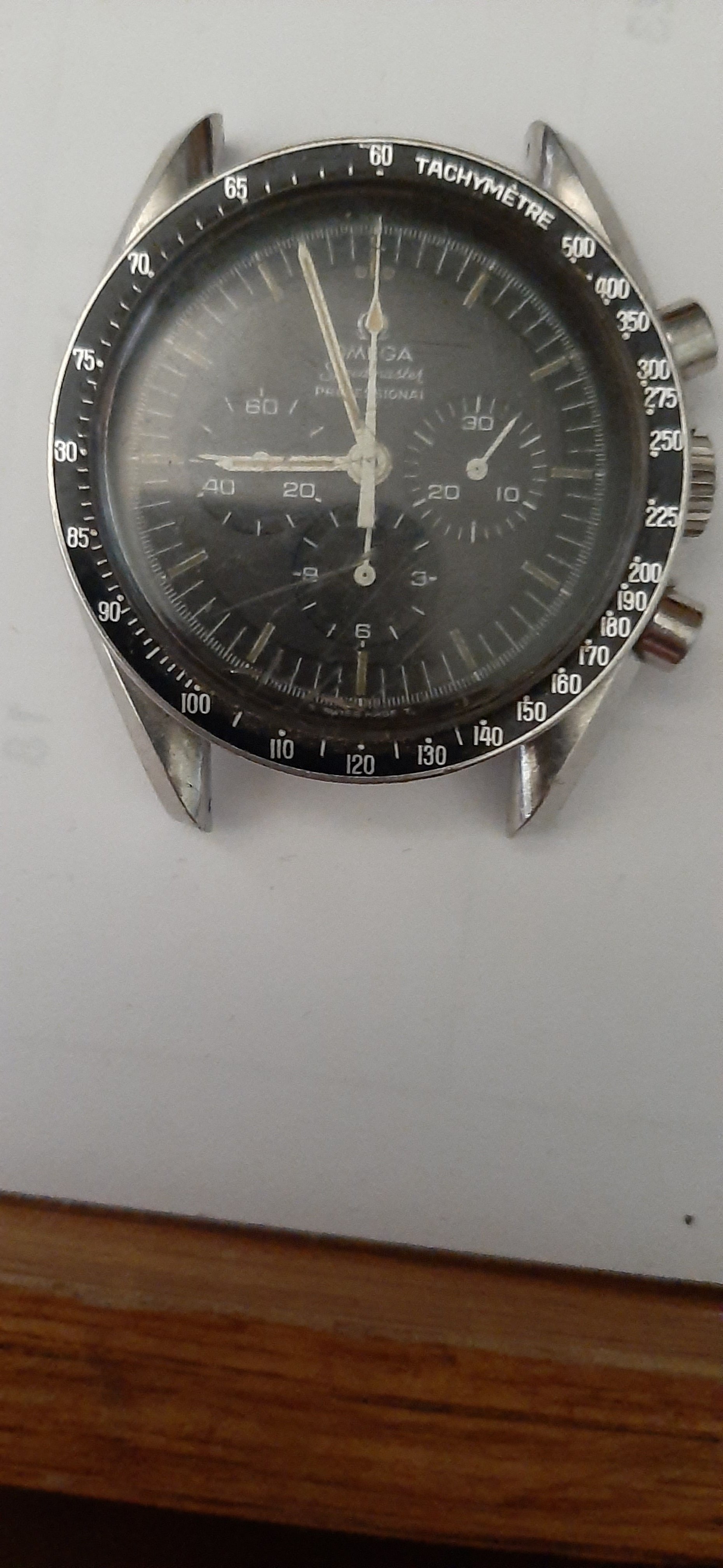

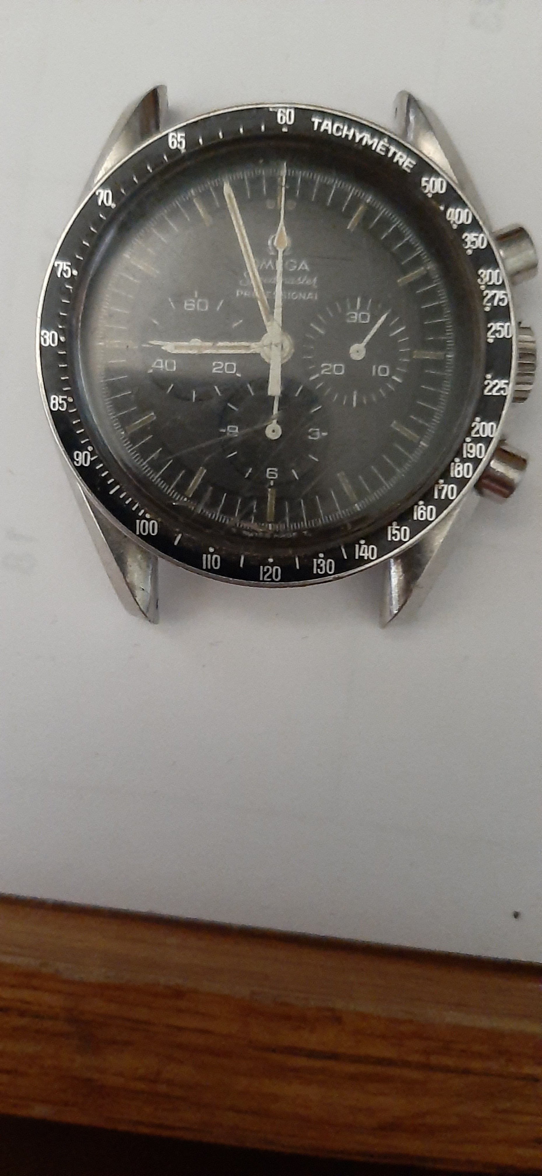

Hello,

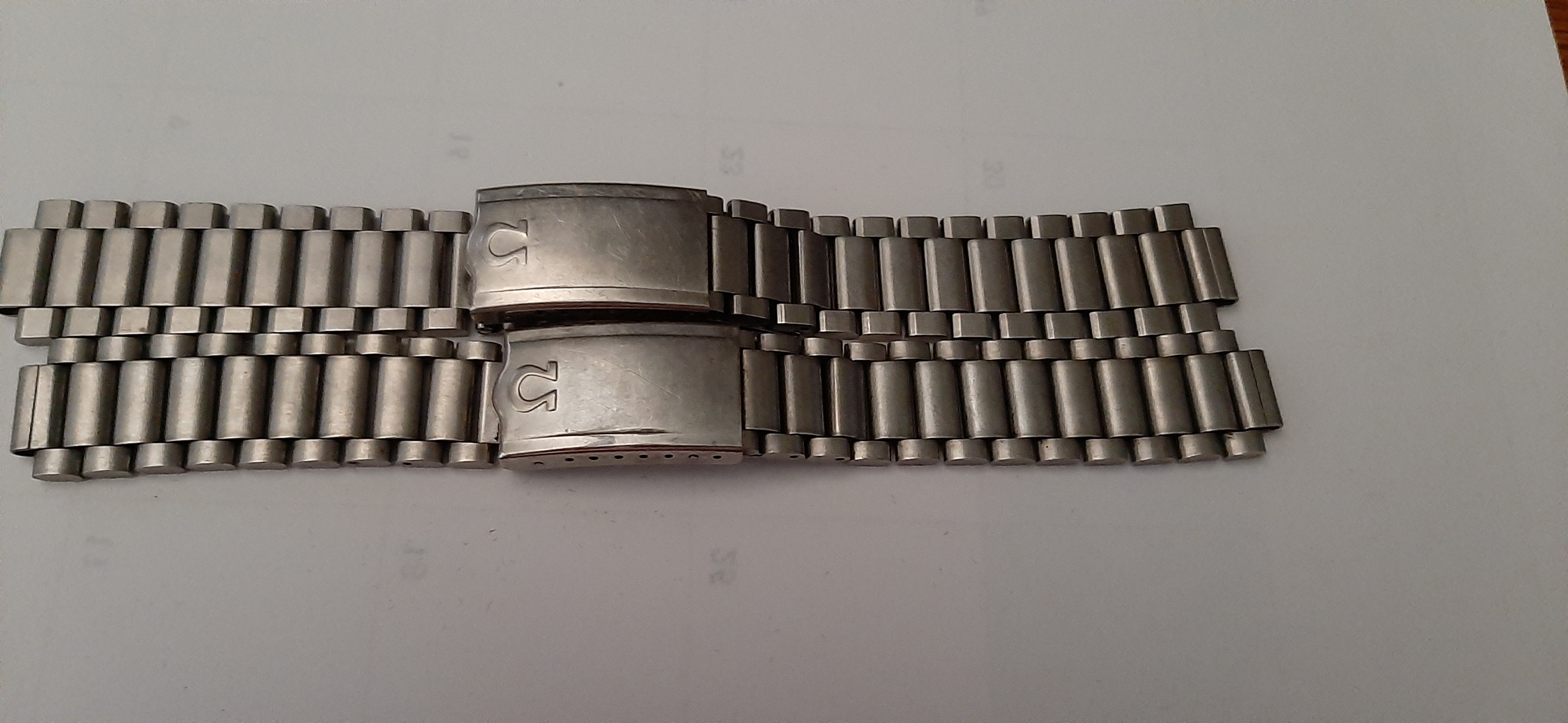

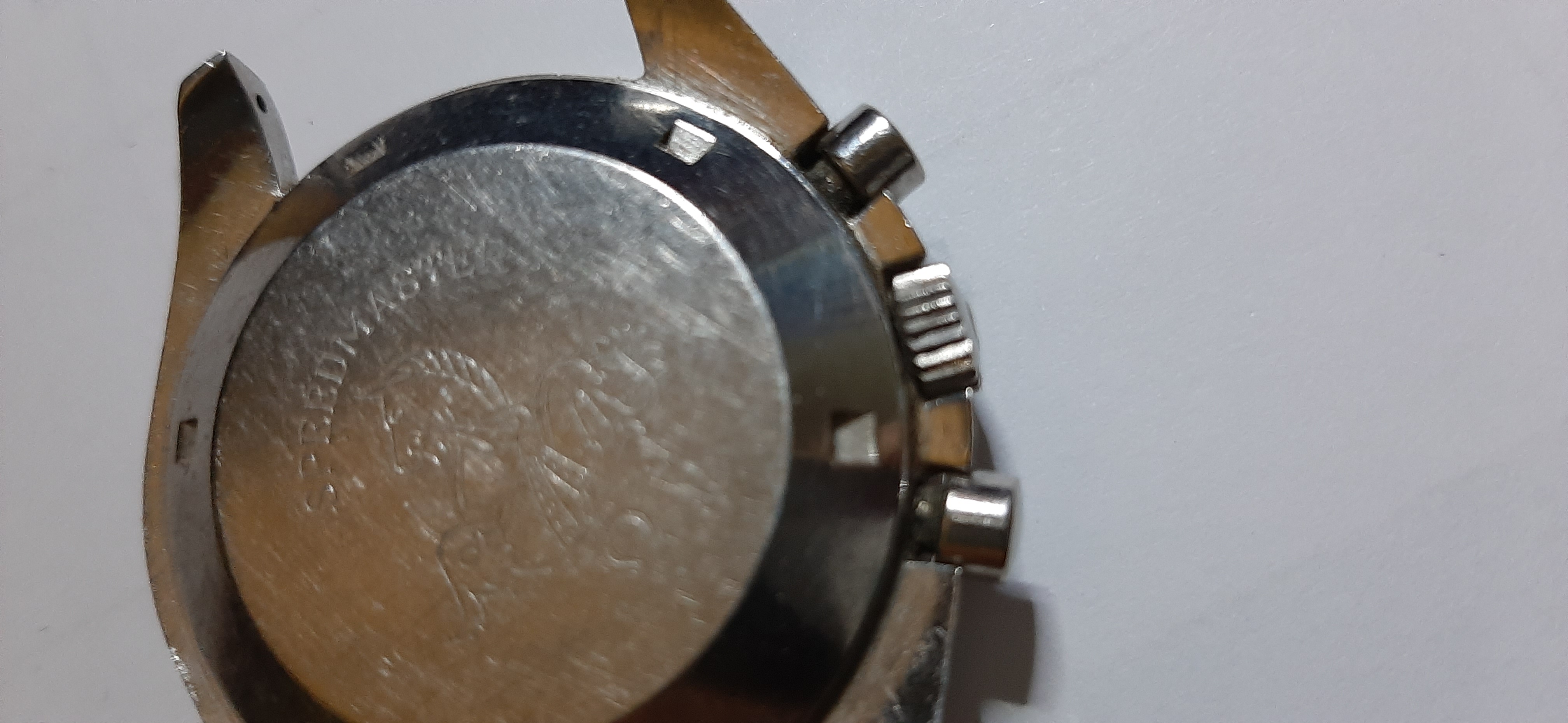

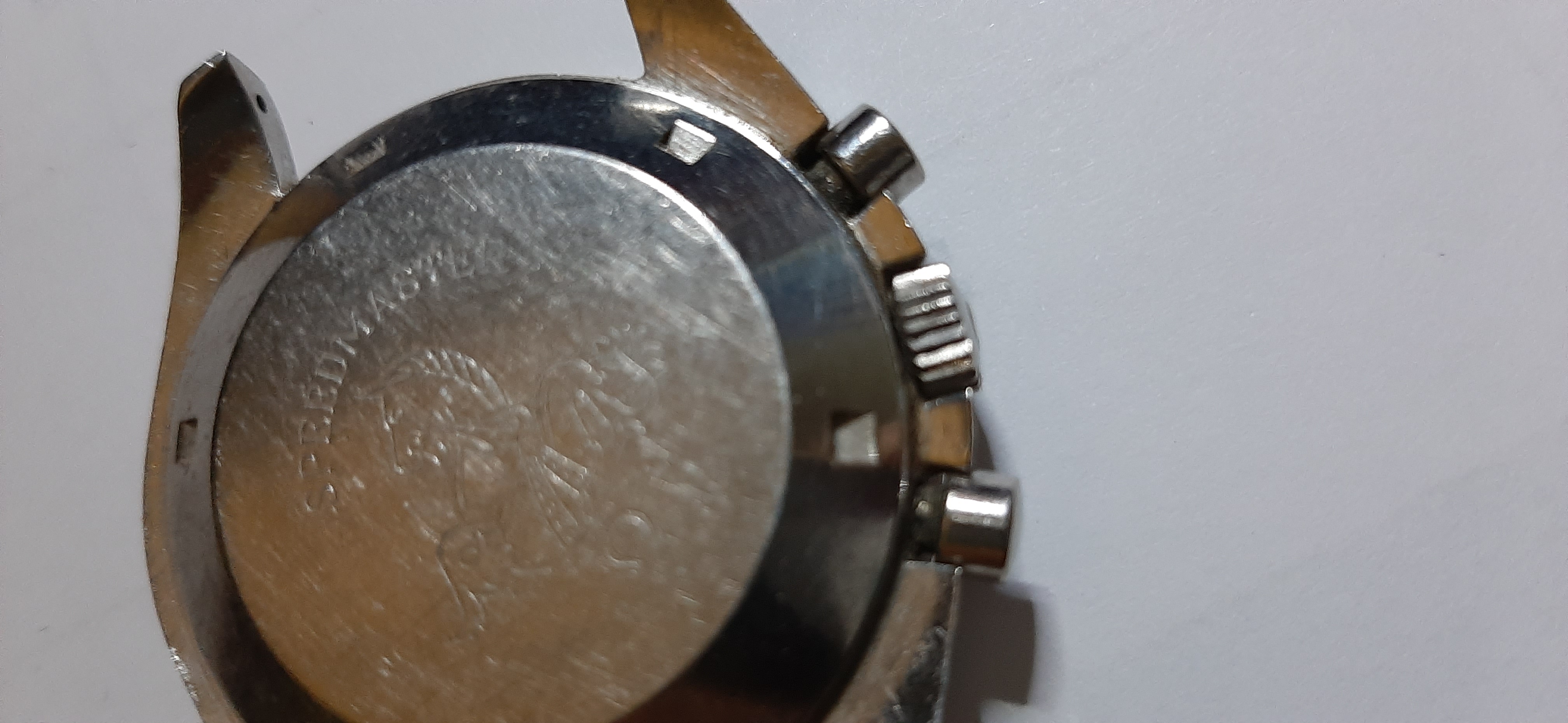

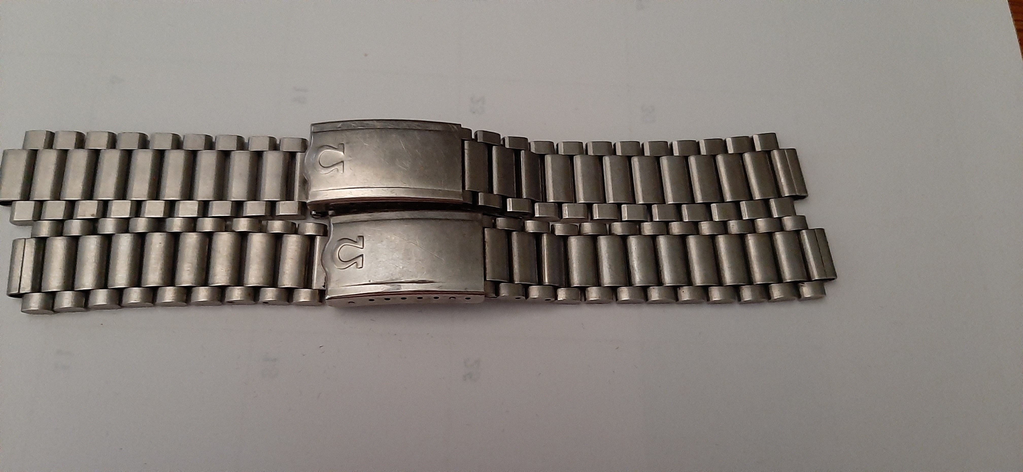

I need some help with my Speedmaster. The watch was given to me new as a gift in the early seventies.I wore it daily until around 1981. Since then it has been in a box on my dresser. For some reason or other I got it out the other day. It had been in there for who knows how long. The watch still runs, but the chrono does not. The start pusher does not function. It also has a crack in the crystal. I would like some advice on where to get it repaired. The watch is a 145022-69ST, 861 caliber, serial number 29115318. I have two bracelets with the watch, both marked number 12. The end pieces are marked 47. One bracelet has longest end link 18.7mm and the other is 17mm. One bracelet has flat links and the other is rounded. I have sent some photo's, forgive the quality. The watch has never been serviced.

If you tell us where you are located, we can probably help you find a watchmaker who has experience servicing vintage Omega.

I wouldn鈥檛 send this one to Omega if maintaining originality is a concern. The tritium dial and hands will be the first things to go.

100% true. I threw it in my list because OP didn't say one way or the other what he or she cared about.
Depends on ultimate goal and how much time and money you have. As stated Omega/Nesbit's will replace the dial and most likely the hands. If you want it to look like new, send it to them. But if you want to keep it original either send it somewhere else or go the restoration route.
The dial needs work, the hands look nice. You could send to Omega for service, they will get it looking and working like new and will send you the old parts. Then you send the original dial to be restored/relumed (LA Watchworks or like) and then replace the original (now relumed) dial & hands for the service dial Omega sends. Then you can keep or sell the service parts to offset the costs if desired. This is the more expensive & time consuming route but will maintain originality for the most part if that is the (or part of the) goal. You could do the entire service at LAWW (or similar) but that would be the most expensive way to go.

It looks like usawatchservice.com/omega is the closest to me. I would like to keep as much originality as possible. I do not mind paying a reasonable price for repair, just not more than the watch is worth, whatever that may be.
Depending on what you want done the sky is the limit. To get it back to factory new-ish is going to be $750 & perhaps up. If you want to preserve as much of it as possible...
Any mechanical watch is going to need a service like this periodically. It's part of the TCO, unfortunately.

Ah, a beautiful area to live. I know it well and have family in that area. Alas, I know of no watchmakers in that area who I can recommend. If you don鈥檛 mind shipping the watch, I can recommend Tanner Morehouse at TM watch Company in North Dakota. His shop specializes in vintage Omega restoration.

If your ultimate goal is to sell the watch, you might be best to sell it as it is and let the next owner decide how they want to keep it. If you want to wear your original watch, that's a little difference. If it were me, I would decide on a budget that I'm comfortable spending (and never seeing again) and proceed accordingly.

If you would send the watch to Bienne there is a serious risk that they will exchange the original tritium dial and hands with some new, in my opinion worthless, service parts.
Beware.

It is a beautiful area, been here for 73 years. You might know the answer to this question. Which of the two watch bracelets would you think came with the watch, the 17mm rounded link or the 18.7mm flat link ?
Given that serial number, I have to ask ... does the dial look brown in the sunlight? BTW, I have 29115371, pretty close.
