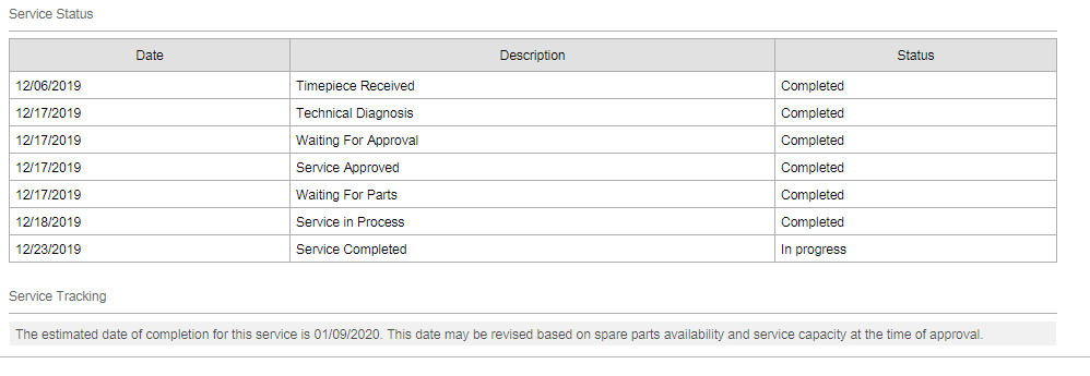

For some reason, when I subscribe to a thread, I never get notifications. But assuming that others do, or remember to go back and follow, here's an update on my service, as promised. I am pleasantly surprised by the progress as shown on the Omega "Customer Information System".
So, hopefully it will be back on my arm shortly. Even if it's finished today, I'm wishing that they won't ship it until after the holiday madness.
Nice to see that there were no issues with the international warranty (I bought it gray market) and it hasn't taken the 7 weeks that some had suggested is the norm these days.
It was also nice that Omega provided the web site for status, although it would have been even nicer if they'd sent me an email when the status was updated.
So, Merry Christmas to me!!!

Would have been a pretty easy repair. Remove back, extract loose screw, reinstall it, check all are torqued to spec, do a visual inspection to make sure no damage occurred, replace back with new gasket, perform timing and WR check. No case work needed since it's ceramic. Should be back on your wrist soon. There was never going to be a warranty issue since you have a valid signed card, they have no idea it is grey market.

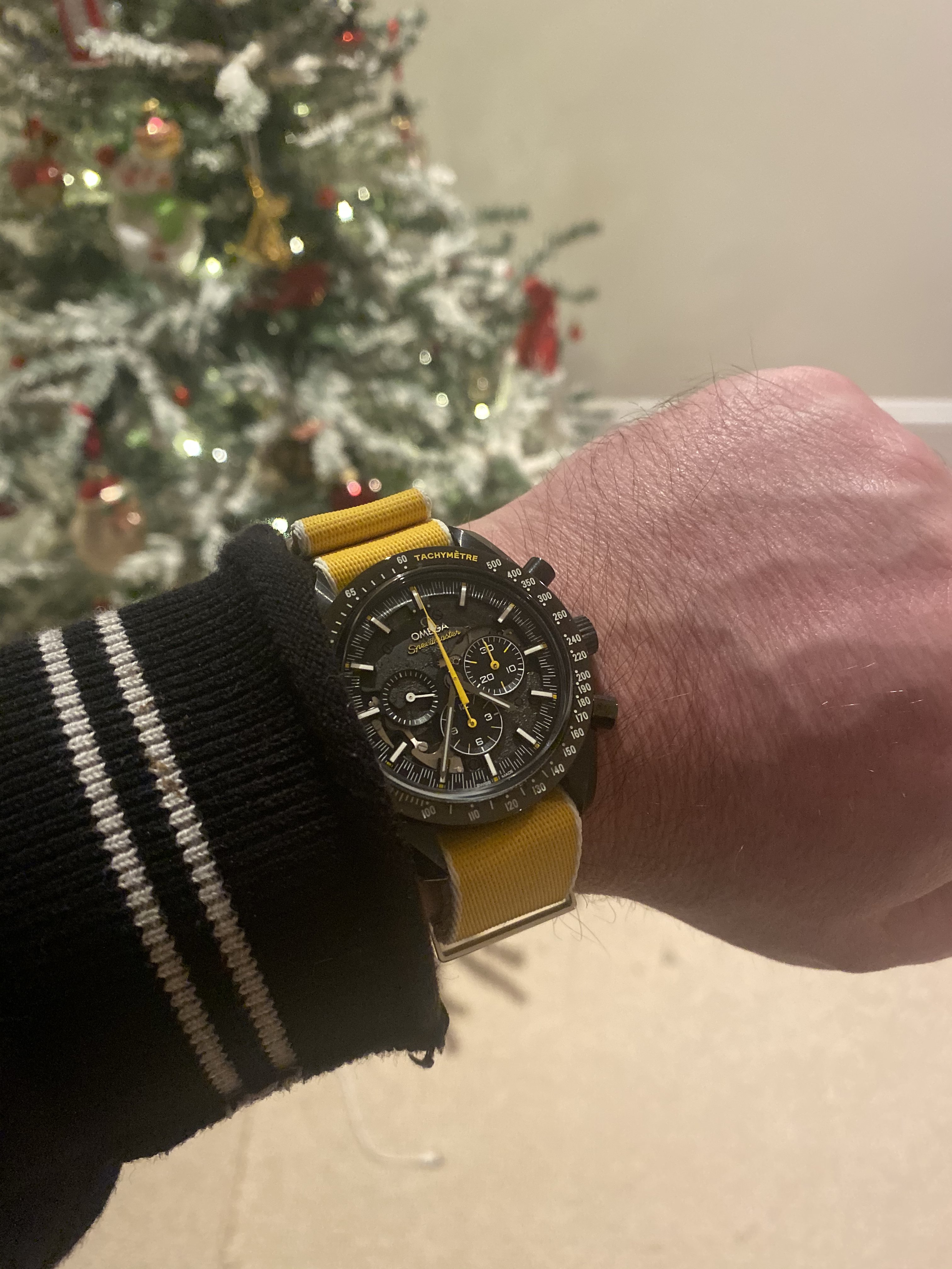

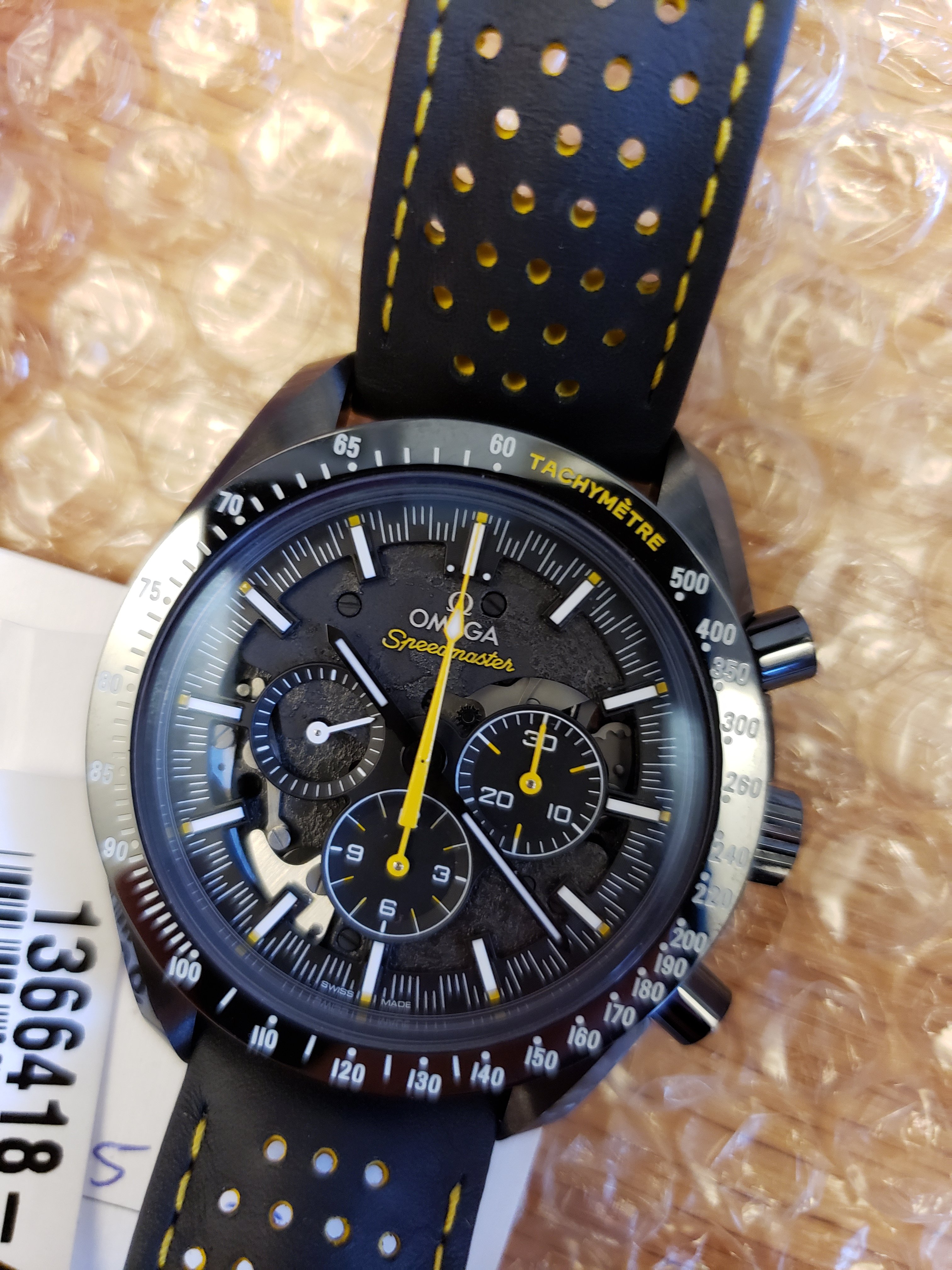

Yippee!!!! It's back.
Got the lovely carrying case as well.
They were kind enough to include the watch:
It's been on my wrist for 10 minutes now, and it's still running! This is, unfortunately, a record for this watch.
I checked, and it appears that all screws are where they are supposed to be.
It was presumably finished on Tuesday, but wasn't shipped until Thursday and even though I could have driven down there, picked it up, and driven back, with multiple overnight stays, in less time than it took FedEx. But I'm not complaining. OK, maybe. LOL
Thanks to everyone, especially Al (@Archer) for the assistance and words of support.
