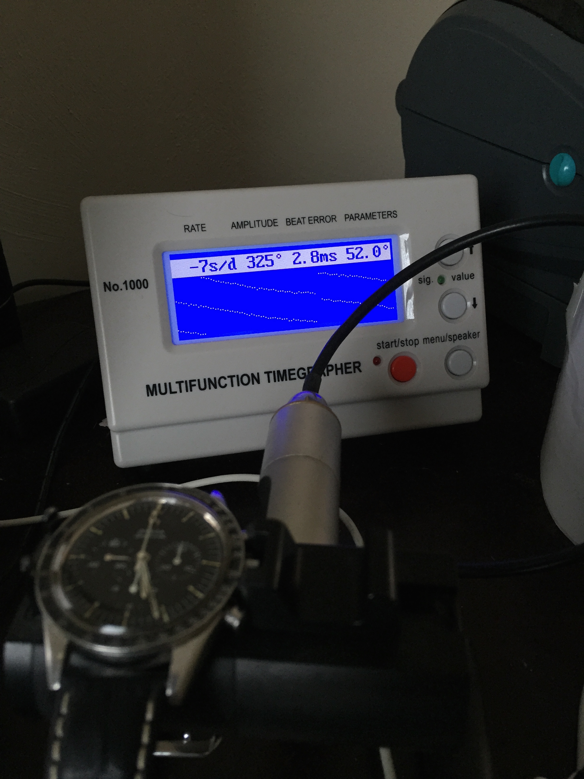

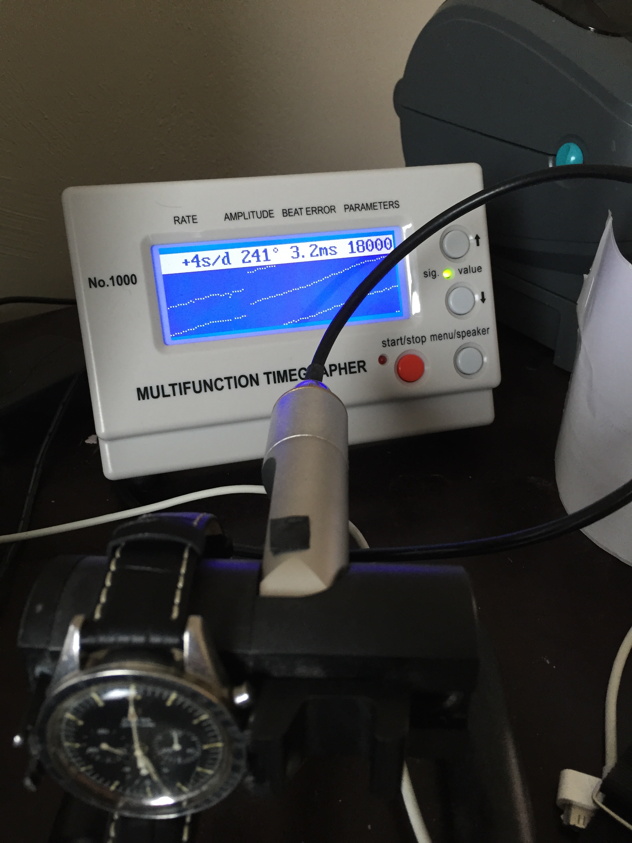

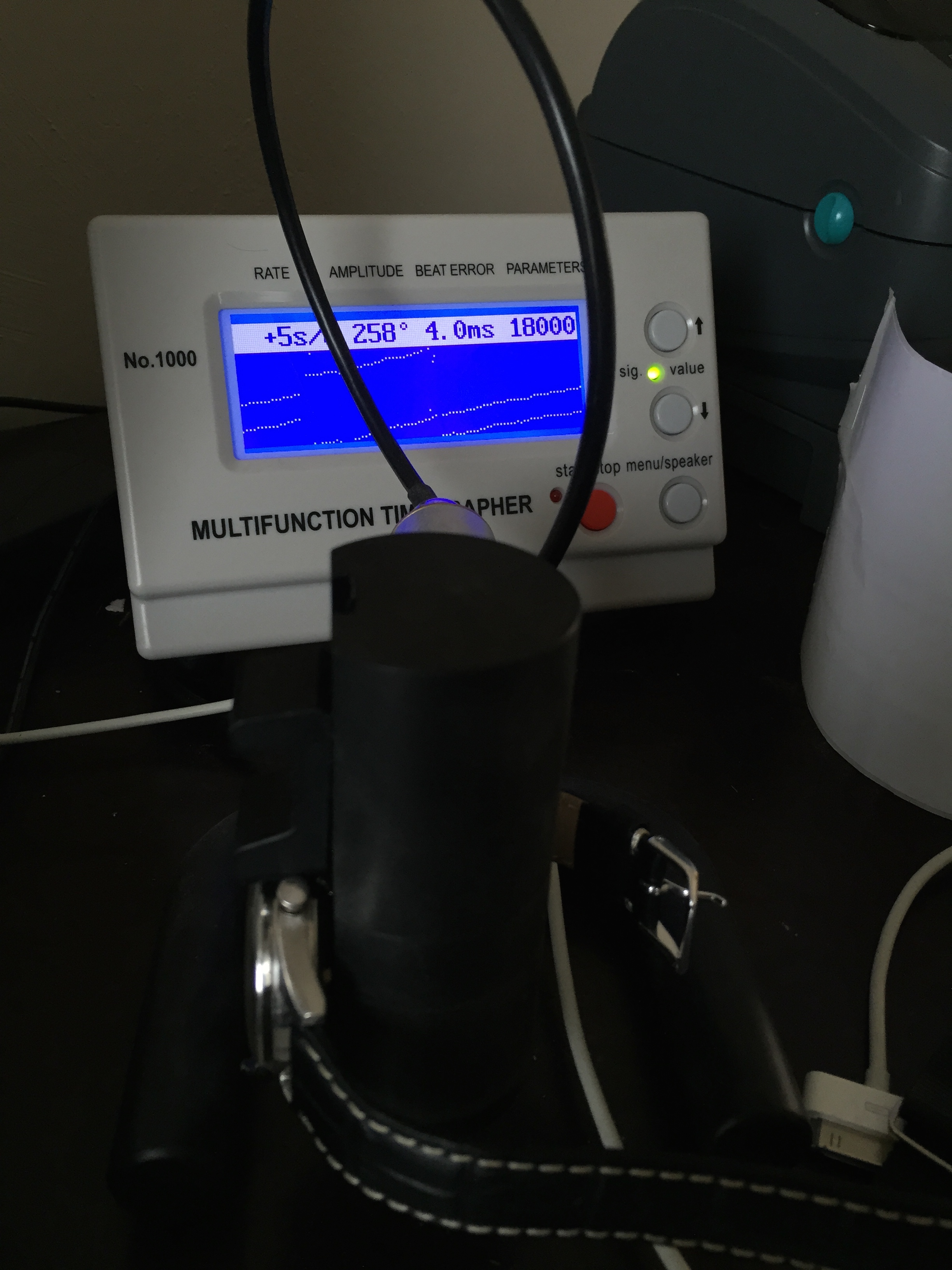

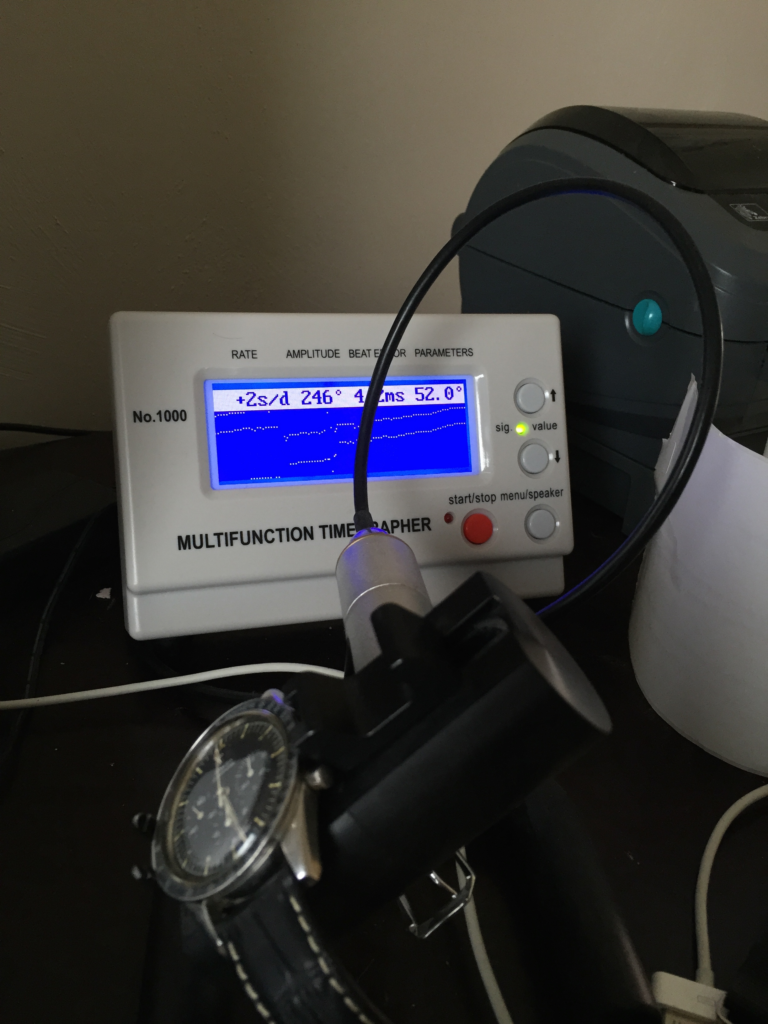

To address your timekeeping claim, I use a multifunction timegrapher No. 1000. Below are several pictures I just took (2/11/15) of the watch's progress in several different positions (even though I usually just keep it face up, single position, during my description write up). I did not do anything to the watch since it arrived back to me from you, Doug. This is the information I have to go off of and information I can show proof of. I do not know how or what you did to get your results.

I'm not at all upset by the way you handled the return, I'm just quite surprised that you still think that the watch's timekeeping is 'within Omega specs with great amplitude'.
The readings you show in the picture mean nothing unless you've waited 24 hours after a full wind (Omega requirement) and change the lift angle setting to 40 degrees. Maybe you didn't know it, but if you leave the Timegrapher on the default setting (52 degrees), it will give you falsely high amplitudes on the order of about 70-90 degrees. When I tested it over the 3 days I had it, it would only run for 22 hours the first time, and 8 hours the second. Within Omega specs? Certainly not for me. ZERO amplitude after 24 hours on two occasions.
Also, I think you know that there are significant parts missing in the movement, but that's not even mentioned in your ad.
I don't believe you are being forthright in your present ad. I'm not trying to be difficult, or create controversy, I just don't believe your eBay ad is 'honest'.

In my view if you are making claims in your sales posts, they should be accurate claims - I don't think anyone would think otherwise. In this case if you are going to use a timing machine to check watches prior to sale, and make claims based upon those checks, I believe it's your responsibility to ensure that you actually know how to use the machine properly.
The balance amplitudes shown are not correct, because instead of having the lift angle set at 40 degrees as it should be for a Cal. 321, you have the machine set to it's default of 52 degrees. A higher lift angle gives a higher balance amplitude reading, and the rule of thumb is that for every 1 degree of lift angle error, it creates 6 degrees of amplitude error. So since your lift angle is out 12 degrees, it overstates the amplitude by 6 X 12, so 72 degrees, which is not insignificant.
You don't have to be a watchmaker, and I don't think anyone said you needed to be. But making claims by using a machine incorrectly is irresponsible and obviously misleading, whether intentional or not. Also to claim that it is running within Omega specs as you have done, you would have to take a second complete set of timing measurements 24 hours after full wind.
I won't even mention the beat error...
