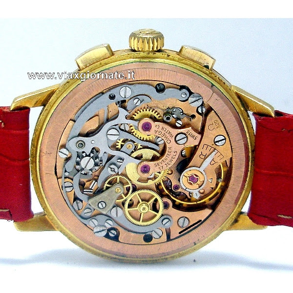

I had the same problem on a Seamaster cal 320 out of Italy. My jury rigged spring was apparently glued on !
Can you beleive I missed this in the ad pic !
I did not return the piece as a friend luckily had the correct part !
