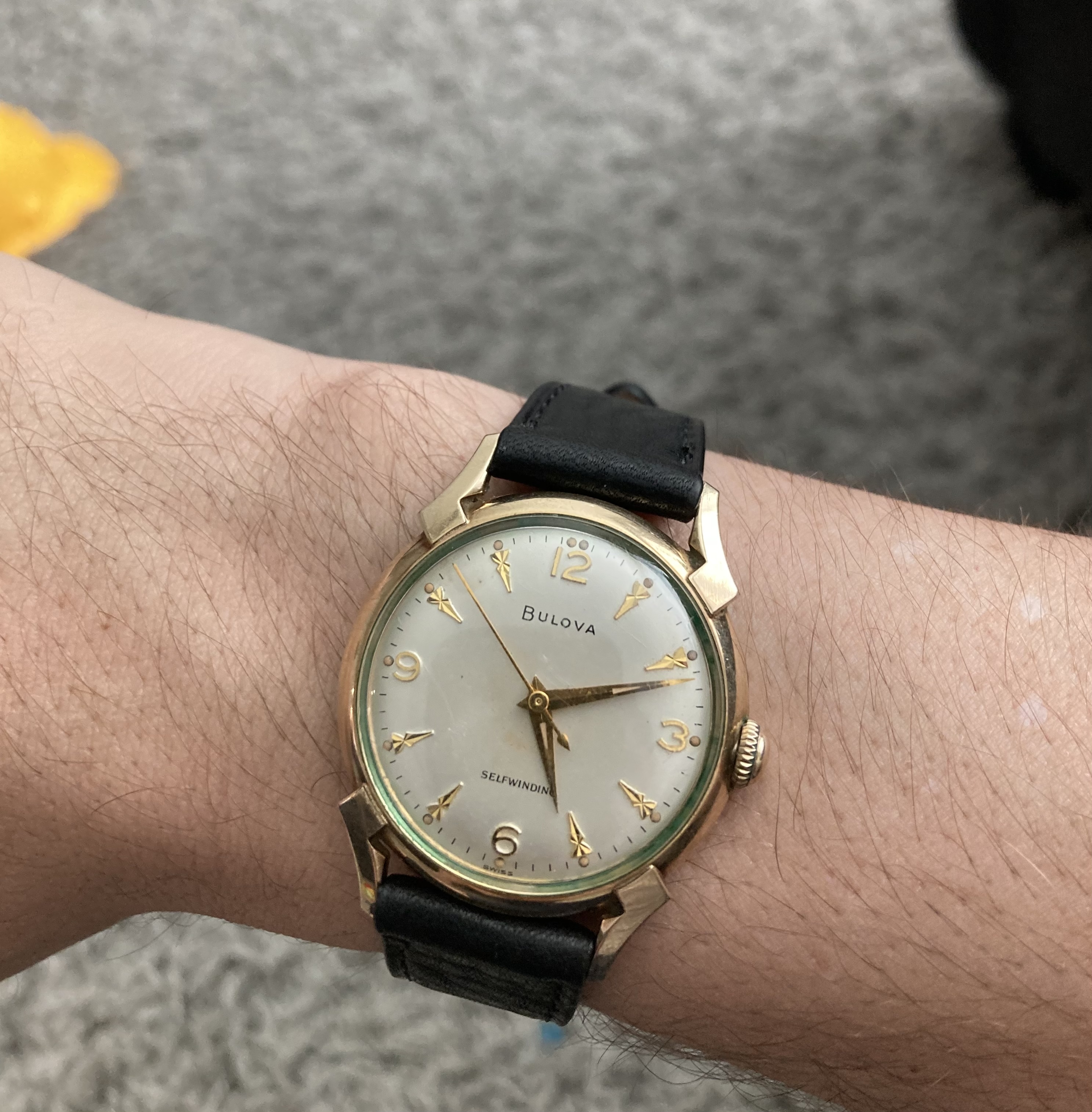

I was recently given my grandfather’s 1957 Bulova self-winding wristwatch. He’s been gone 20 years but the watch is still ticking and I plan to give it to my son who was named after him. Never knew the watch was still around, but needless to say it was a very pleasant and meaningful surprise.
I did have one question——The service history is unknown. When in motion the watch seems to make a fairly audible winding noise (doesn’t sound like a rotor moving, more like the sound the crown makes when it is turned). A watch repair store said that this was normal and wouldn’t be less audible with a service. They said it’s keeping pretty good time and not in need of servicing yet. I was wondering if anyone can confirm the winding sound issue. Thank you!

Would need to see the movement but some of the Bulova's were (are) pretty noisy. Take a quick pic of the back. There might be a date code mark there.
370
1,126
Nice watch! And lovely find. Tough to comment on a sound through the forum, but I’d recommend a service regardless of how well the watch is keeping time if it was just sitting for the past 20 years.

That is a very nice Bulova, and a great memento from your grandfather.
If you think your on will be wearing the watch, I recommend a service. It may run reasonably well, but whatever oils were in the watch have gone bad. Using the watch will cause premature wear. I know some shops will say wear it until it stops running, but I prefer to keep my watches properly maintained to prevent parts from wearing out.

@redpcar gets the credit for the date code recommendation but since the OP said it was 1957, then we can assume he saw L7 on the back and figured it out.
Any competent watchmaker can service this and parts are abundant on eBay in the form of NOS or whole parts movements for these. If a watchmaker says they can’t get parts for it, find another watchmaker.
4,856
12,282
@JwRosenthal is right about the parts availability. These were l quality everyday man's watches, not luxury, so there are lots of parts around. The recommendation to wait on the service is not bad advice, although my preference is to service

Beautiful watch! My older Bulova makes a good amount of noise as well but I would recommend a service as others had mentioned.
I ended up getting it serviced. Hope to get it back soon!
222
205
I also have had 2 bulova' s. Quite noisy also but didn t need to Service them as the accuracy was ok
Good move- it will last you another 60 years now (although you should get it serviced about every decade if you wear it infrequently- every 5 for daily).
