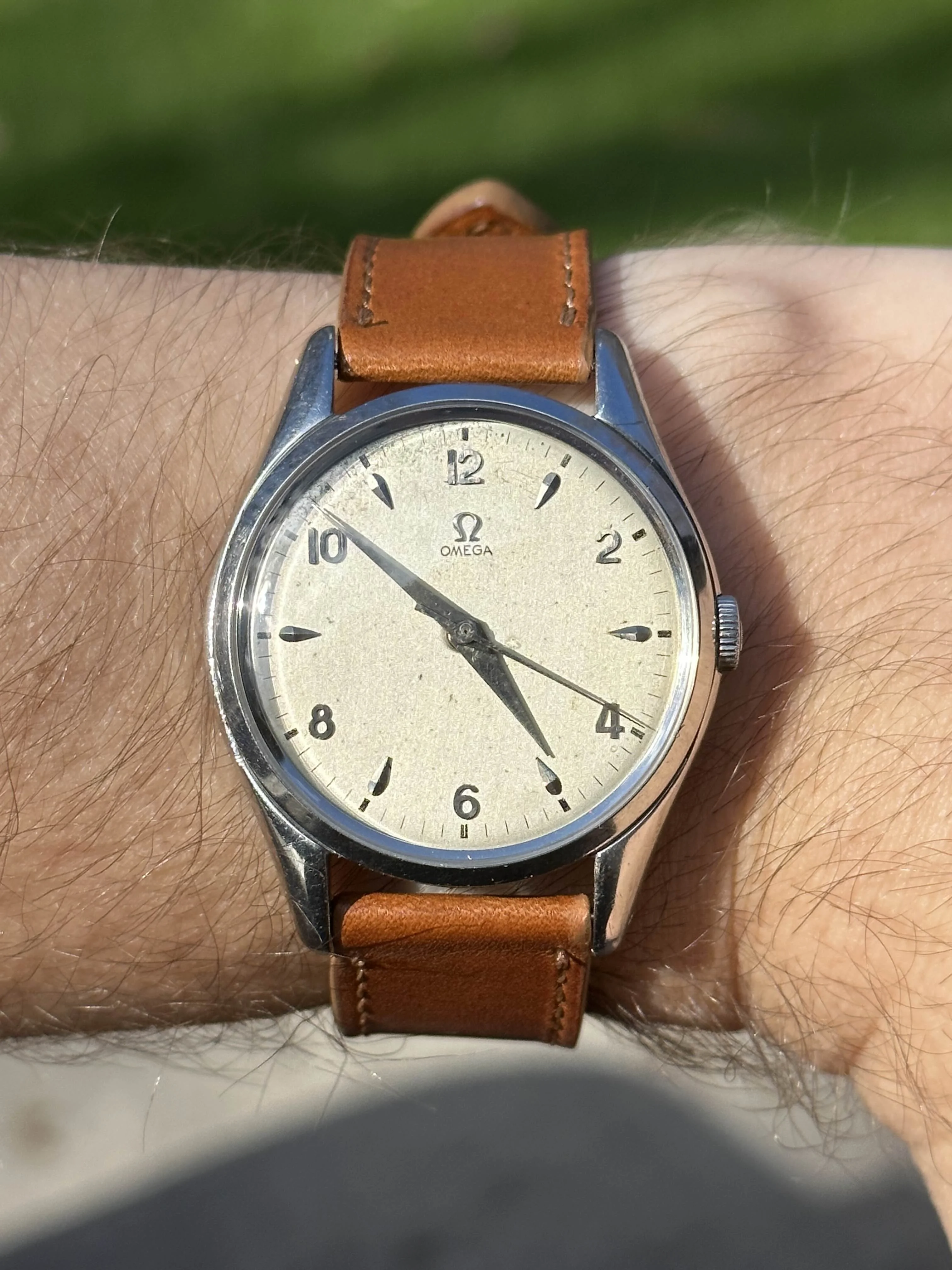

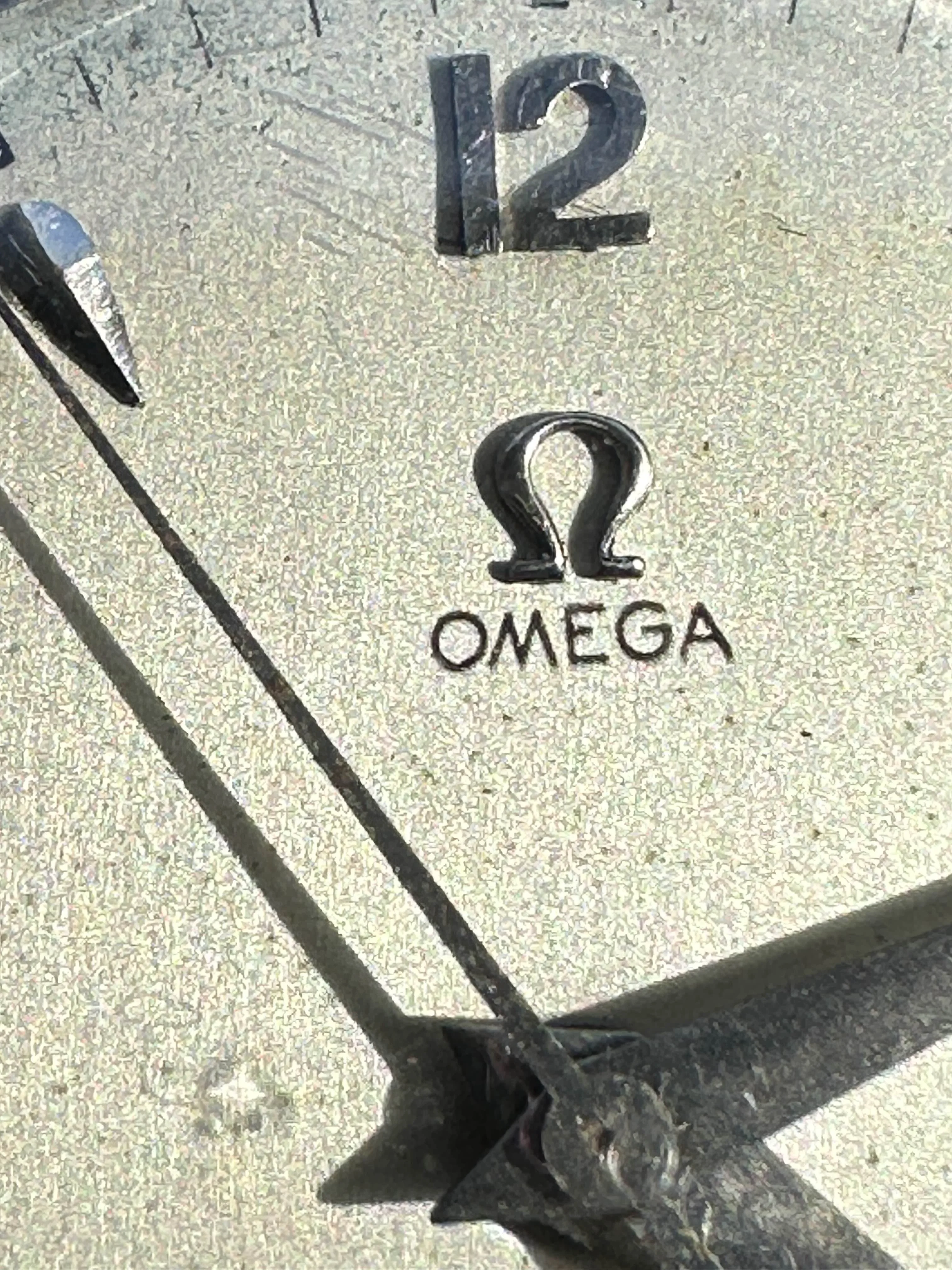

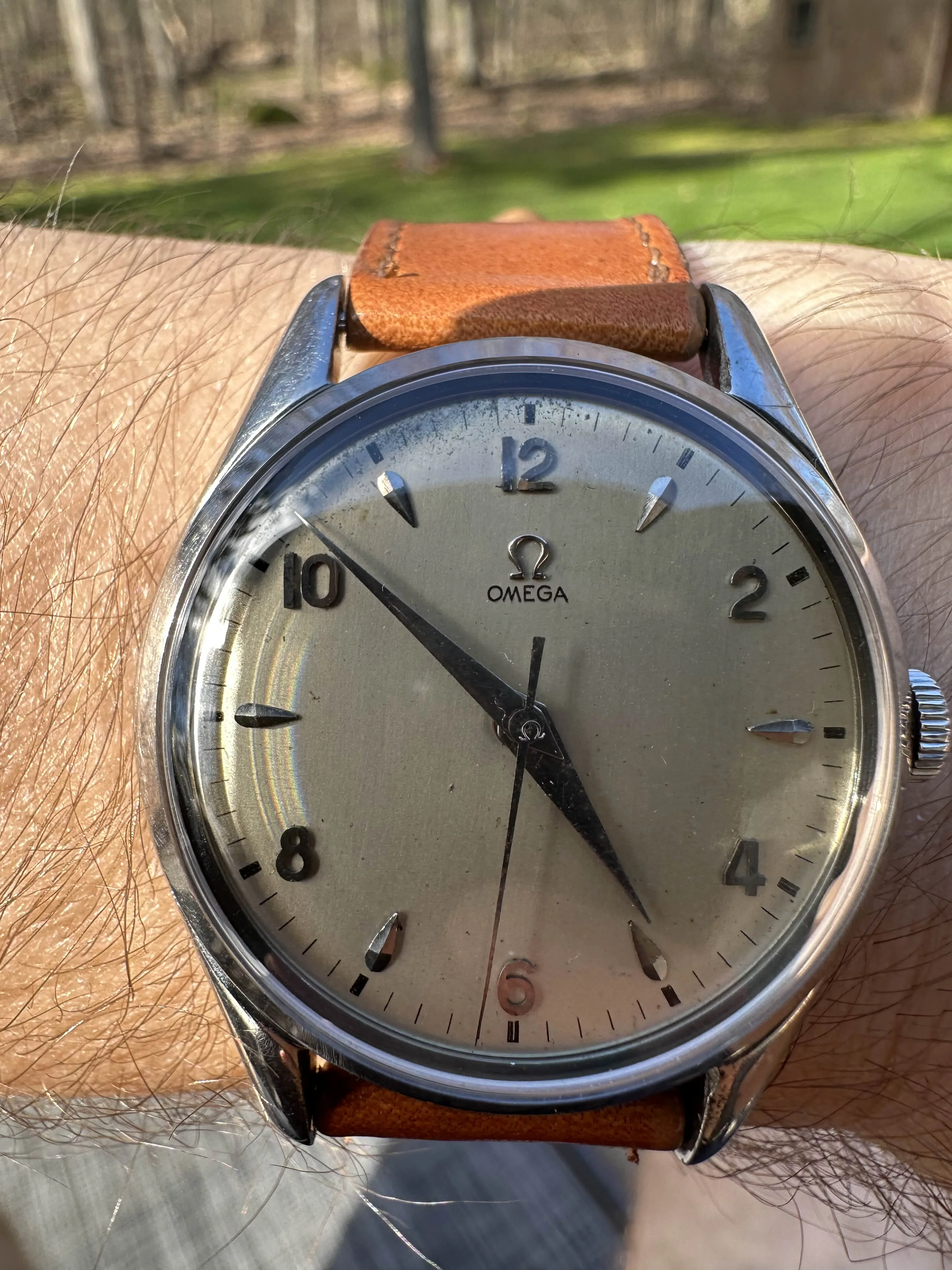

Could someone let me know if this watch has or hasn't been redialed at any point during its life? I was looking at some photos online of this reference and I noticed that the size and font of the OMEGA printing on my watch seems to differ slightly from the examples I have seen online. It's a 1950 Omega CK2504-9 that my grandfather bought in Germany while he was in the US Army.
Please let me know if I need to send more photos, thanks.
I also noticed that the 6 o'clock hashmark appears to be a bit off

It has definitely been messed with. 7 oclock is misaligned, the M in Omega looks uneven, and the 'A' seems like it isn't aligned right. Quite a few of the minute markers are uneven as well, so I suspect yes, this has definitely had some work done to the dial, if not a complete redial.

I see, thank you for helping.

You are correct about the OMEGA being incorrect. Wrong font, too small, etc.
