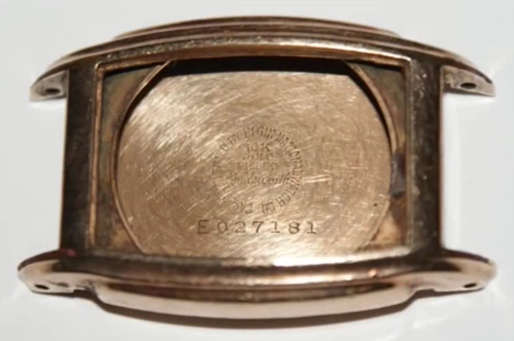

There were a lot of USAAF bases in the UK during WW2. This is a nice story of how a relic hunter found an engraved gold case wrist watch (which shows the diverse range of watches in circulation back then) He traced the watch back the family in the US. It was a graduation present in 1937. Sadly the owner who survived the war had died in 1996. His brother who also served in the war and survived (88 years old) was overjoyed to have the watch found and returned 66 years later. It shows how much these items mean / they are very intimate links to the past.

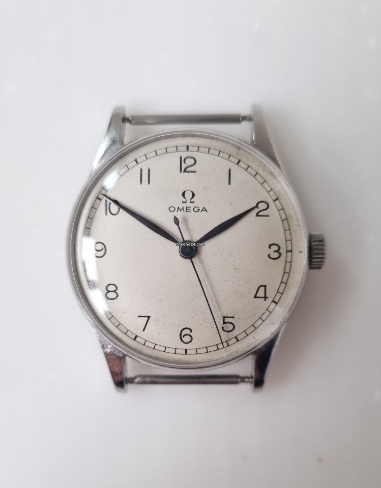

You've described an Omega HS8. Image below borrowed from chrono24:

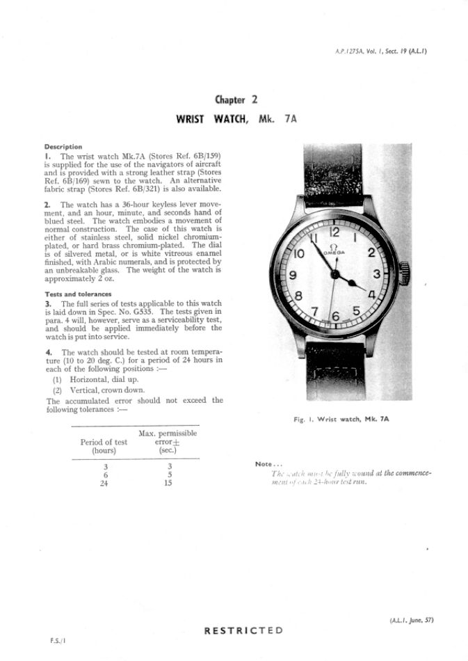

So a Mk7A......
The Omega HS8s were all produced to the same standard specification as the RAF 6B/159 wristwatches, which included a white dial with black arabic numerals, centre seconds and blued steel non-luminous hands. These watches are commonly referred to by their Royal Navy Fleet Air Arm stores reference number of HS8. The initials “HS” stand for Hydrographic Survey and the number “8” refers to a wristwatch. The wonderful Omega HS8 watch for sale was produced around 1943 at the heart of WW2. These watches are considerably rarer than their RAF counterparts and good original examples are seldom offered for sale.

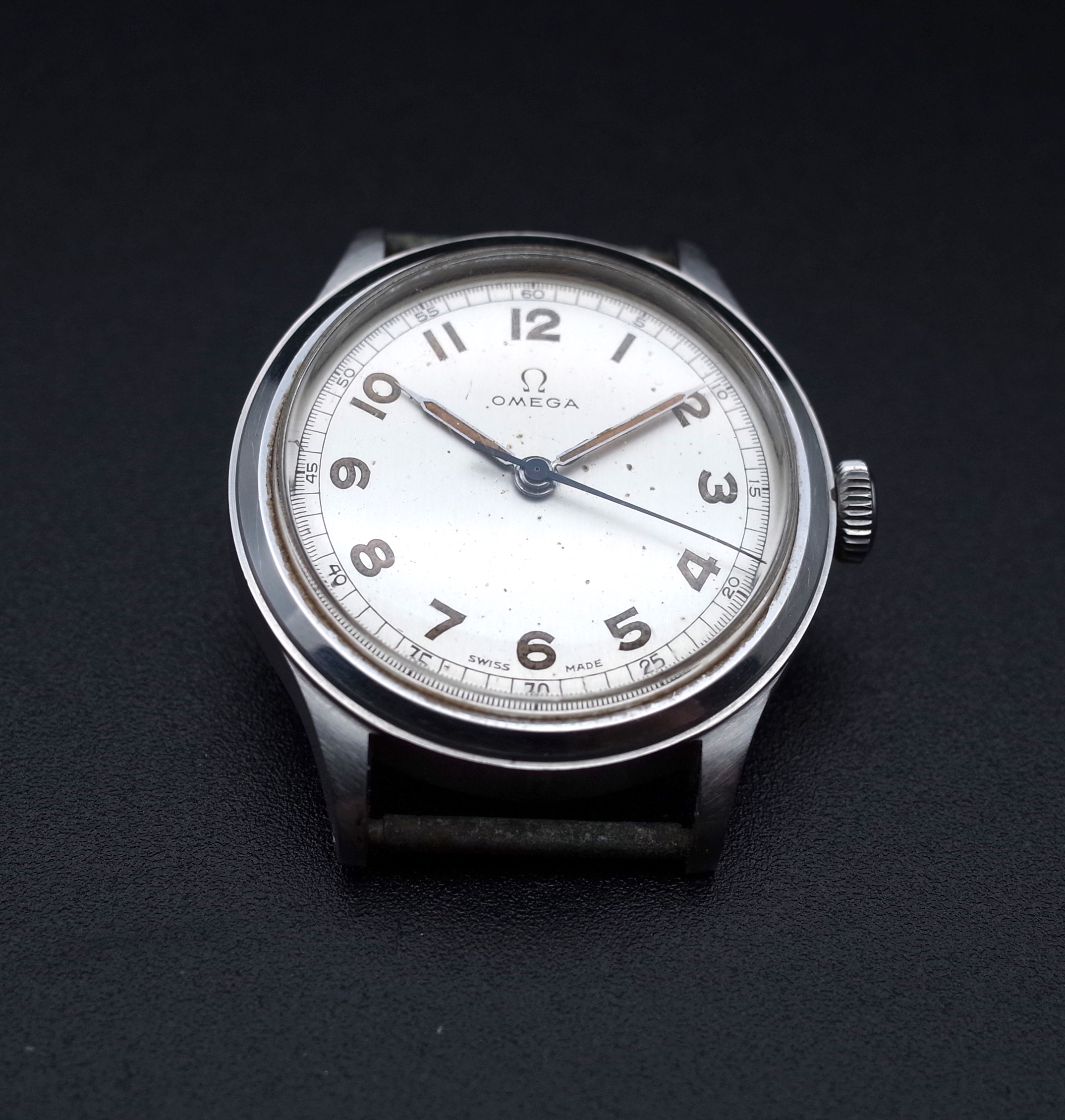

I know it is an 'army watch' but could it have been an Omega 2179/3 with a dial like so?
That was delivered to the US Army after the end of the War, 1945.

That is quite possible. The original dial should have Swiss Made between the 6 and above the railway. Early HS 8 had stainless cases and springbars. Due to the steel shortage in the War, the next deliveries had an Alloy middle case and stainless bezel and outside engraved back. Different case numbers between HS8 and the later deliveries.

I believe these watches were delivered to the US Army in several batches. The first batch went through neutral Portugal in very early 1945, while the war was still going on. The Ref. 2384 watches (engraved with “US Army”) were thought to have been delivered first, due to earlier serial numbers on the movements, but that is not clear.
