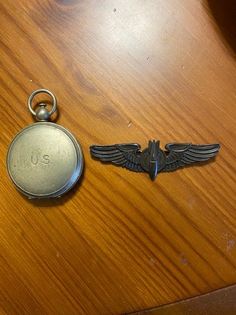

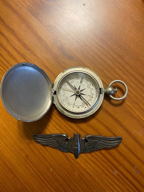

My younger brother recently passed away far too early at the age of 61. In going through his personal effects, I was surprised to find our father's badly tarnished sterling silver flight wings and his Waltham compass from his service in WWII. He was the bombardier on a USAAF B-25 flight crew. I have vivid memories of him showing us the wings when we were children and explaining how the compass worked. I also remember that he wore an Omega military watch that I think he received as a commissioned officer. I thought that the wings, compass and watch were long gone, but having found the first two items, I'm now very motivated to go through a house of personal effects and find that watch. For our Omega military experts out there: any idea of what I might be looking for? All I can remember about the watch is the Omega symbol at the top of the dial which I think was printed in black. I believe that the dial was white. As to the strap, maybe a NATO, but I don't have a clear memory of that so it's a guess at best. He had a number of British officers as friends so it's possible that the watch might have been an RAF model. If anybody can speculate about which model Omega I'm looking for, I'd appreciate the help. He served from 1941 through 1945. Thanks.

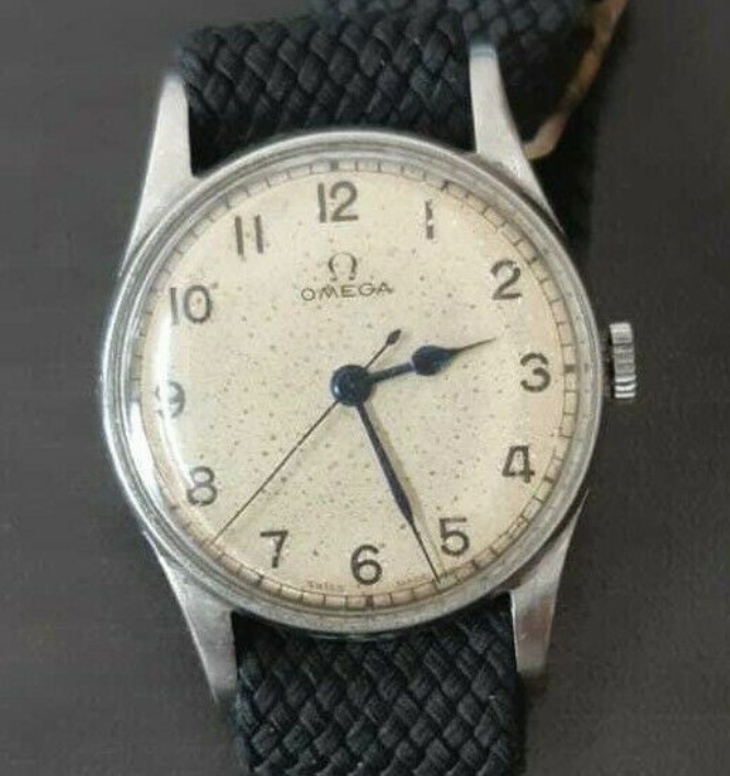

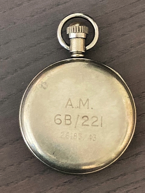

Sorry for your loss and respect to your family history and the fact that such important mementos have been saved for future generations. The thread below has examples of flown watches and sadly some crash recovered items - also some actual WW2 photos showing the style of watches worn. A lot of crew also flew with personal preference watches. If it is an issued watch it should have broad arrow and or air ministry markings and a reference engravings which many better qualified experts can chime in on. Also the specifications for most of the RAF watches are available. It will be very interesting if you find it and a very good chance that an extract from the archives would be possible if it is an MOD issued Omega.
https://omegaforums.net/threads/ww2-raf-watch-identification-help-please.136116/#post-1850064

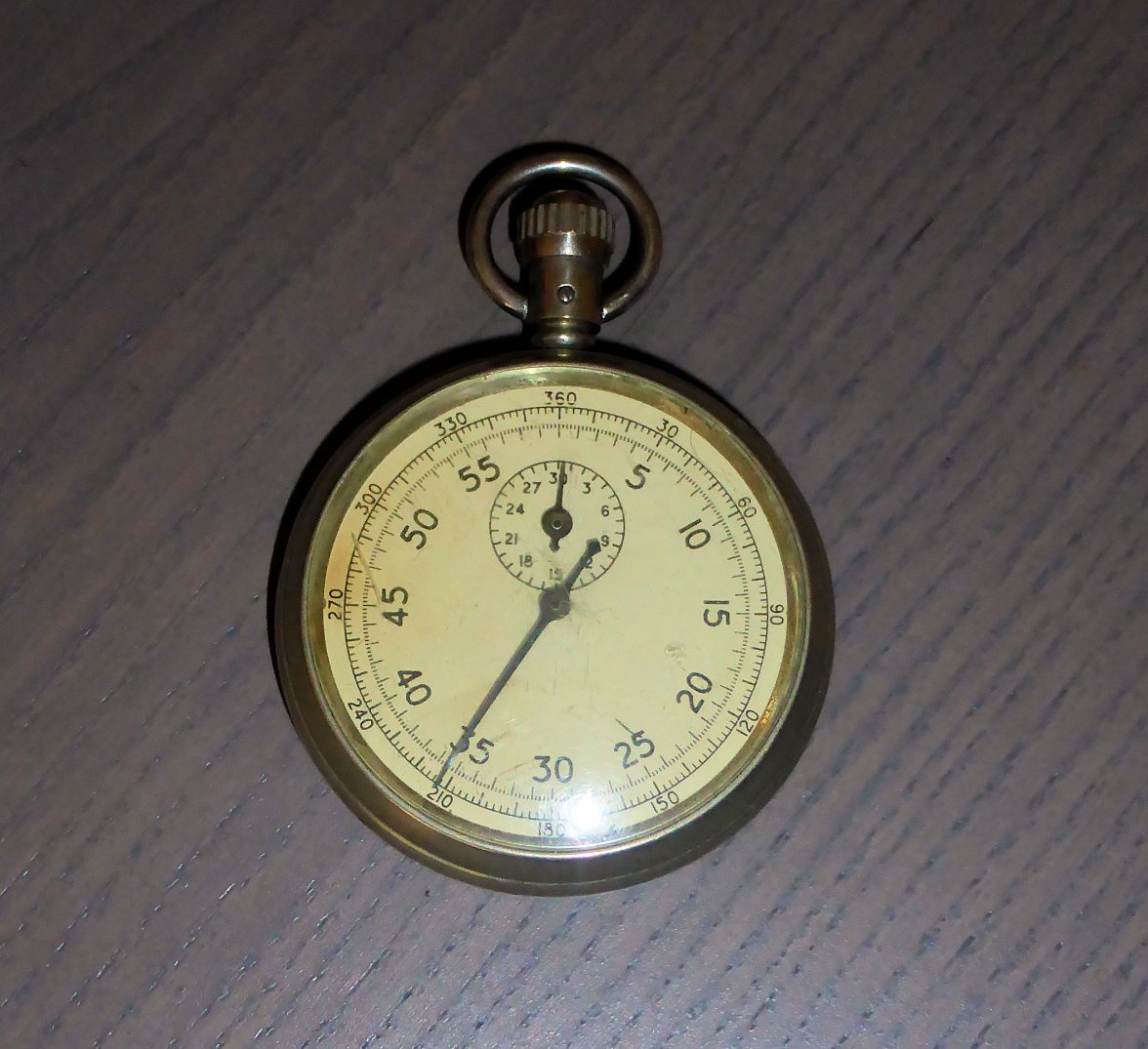

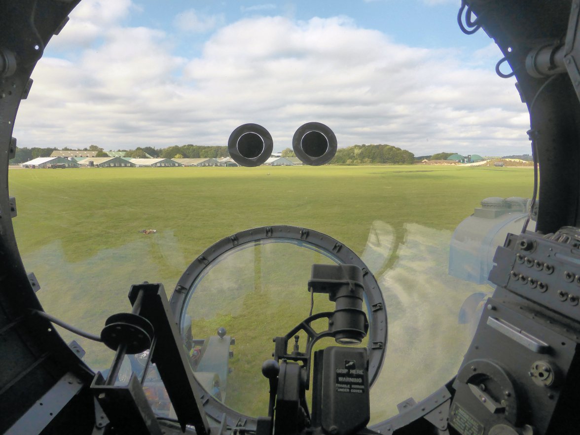

Bombardier/ bomb aimed position in a Lancaster - similar situation in a B25. Flying straight and level / head on into flak with no protection - very brave men.
Also an example stop watch - very likely he would have used one as mentioned by @SkunkPrince

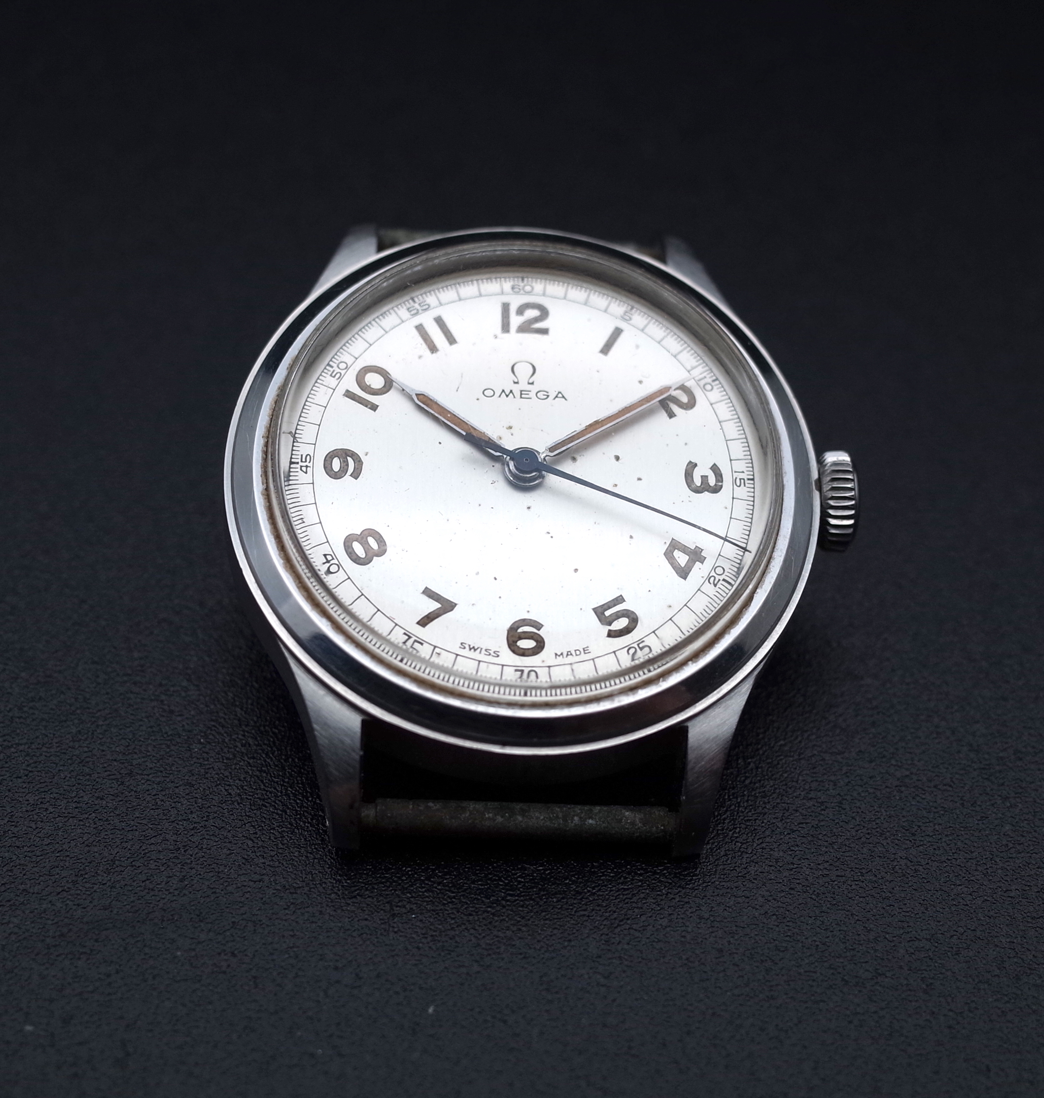

I know it is an 'army watch' but could it have been an Omega 2179/3 with a dial like so?

Thanks to all who have responded both with their sympathies for our family's loss and also with information about my father's watch. I consider myself most fortunate to be a member of a community with so many kind, thoughtful individuals. The hunt for the watch resumes this coming weekend. I'm also going to attempt to gently clean up and polish my father's wings and his compass. We'll see how it goes, but I will be careful to do no harm.
You might consider not doing that. The oxides that are on the wings, at least, will prevent any further degredation. The same is probably true with the compass but we'd need to know what the material is, first.
Just keep them clean and dry, and by clean, you can wipe with a damp rag or spritz with a little lens cleaner, which is mostly isopropyl alcohol.
If you want to proceed anyways, I would suggest an ultrasonic cleaner for the wings. As for the compass, while it was made for war, it is still somewhat fragile, so I don't know that I would try with it anyways.

That's a good thought. I'll hold off.
