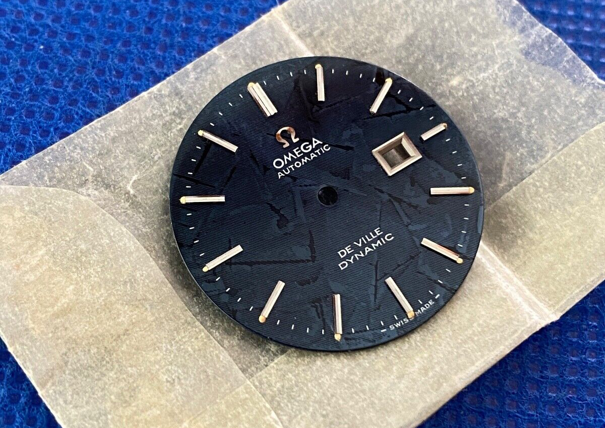

"Bluejeans" dial. DeVille Dynamic 166.144. What am I looking at here?
532
2,136
Stumbled across this really intersting dial on eBay. What is this exactly? Was this is a factory finish offered or is it damaged? I am not too sure what I am looking at. I see way more Geneve Dynamics out there. But those usually have bullseye dials. Either way, its a real stunner in my eye.
Ended up finding it again on a 166.144. Who can tell me something about the dial? Just looking for info out of curiosity.

To me it looks it was damaged by whatever it was folded up in when stored at some point, certainly not anything I'd pay a premium for.
13,555
23,503
Hard to tel from these photos but some Rolex’s and Omegas from the 70’s-80’s suffer from cracking of the top lacquer layer. Some people called it ‘spider webbing’. I don’t find it appealing but some do.

There are funky dials like this, I'd assume it's original
That loose dial however is from the further cost cutting times, it's likely a male model with a smaller ladies movement

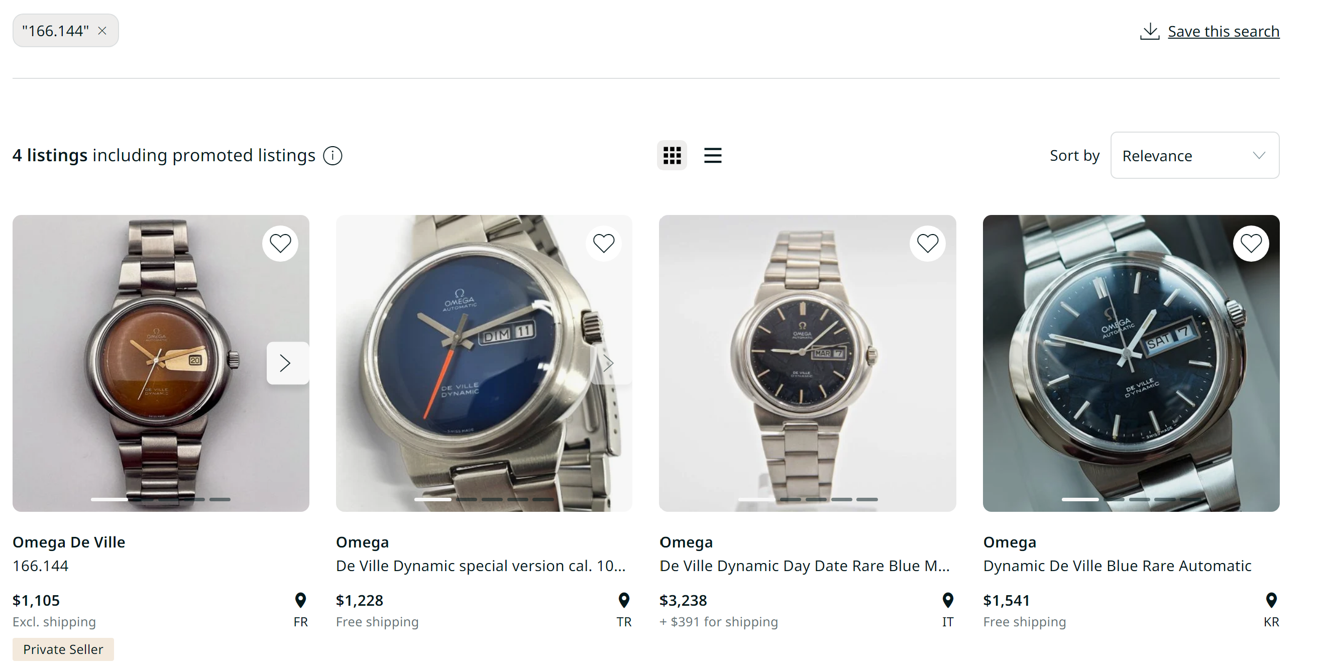

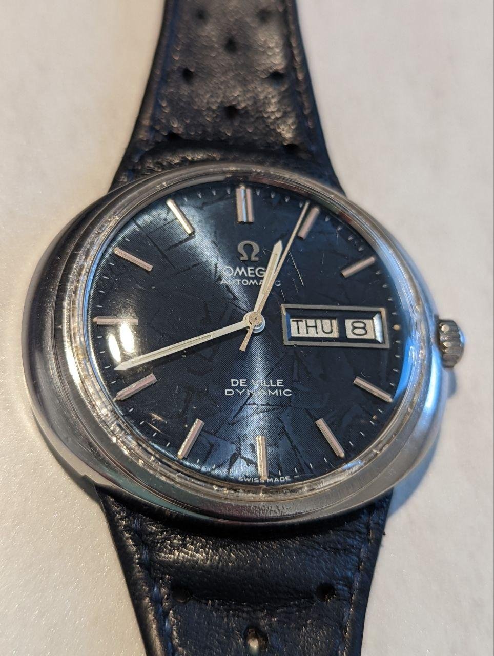

There are two with this odd "blue jeans" dial currently listed on C24. Sellers both indicate dials are rare. It looks too purposeful to be damage and the amount of these Im seeing kinda rules out one-off damage conditions. I wonder if anyone in has one or has seen in person before? Its definitely an oddball. I dont know much about the 70's watches.

I thought the same but this ref got a 1022 and a large 42mm case. Surprising.
Heres one of the two ads on C24
https://www.chrono24.com/watch/JNLRW4

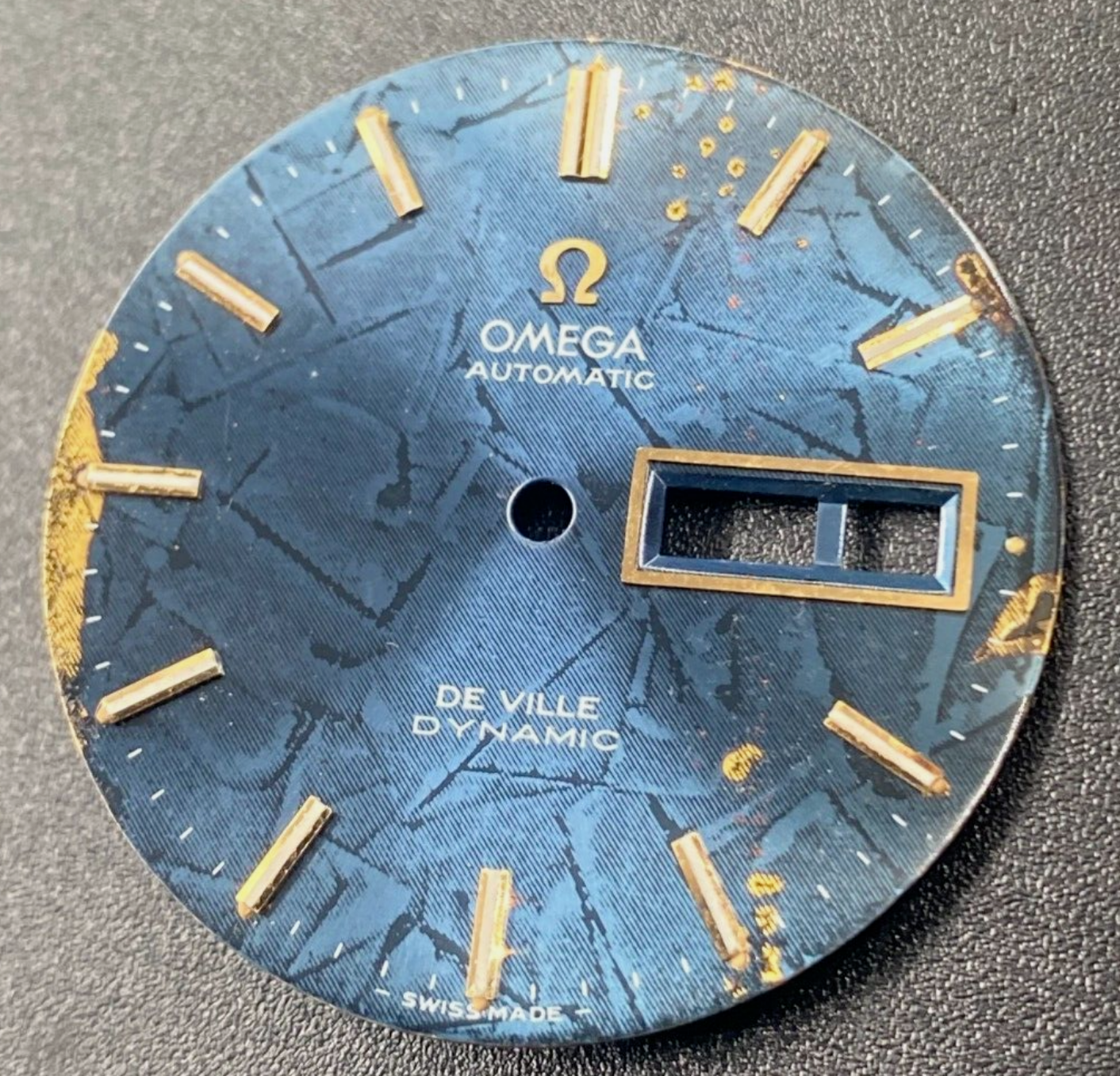

A trashed dial from ebay but you can see the interesting pattern anyway. And Kaplan, you're right, these also came on the smaller 30mm womens watch with a 684cal. The first picture in the post is for the smaller womens watch.

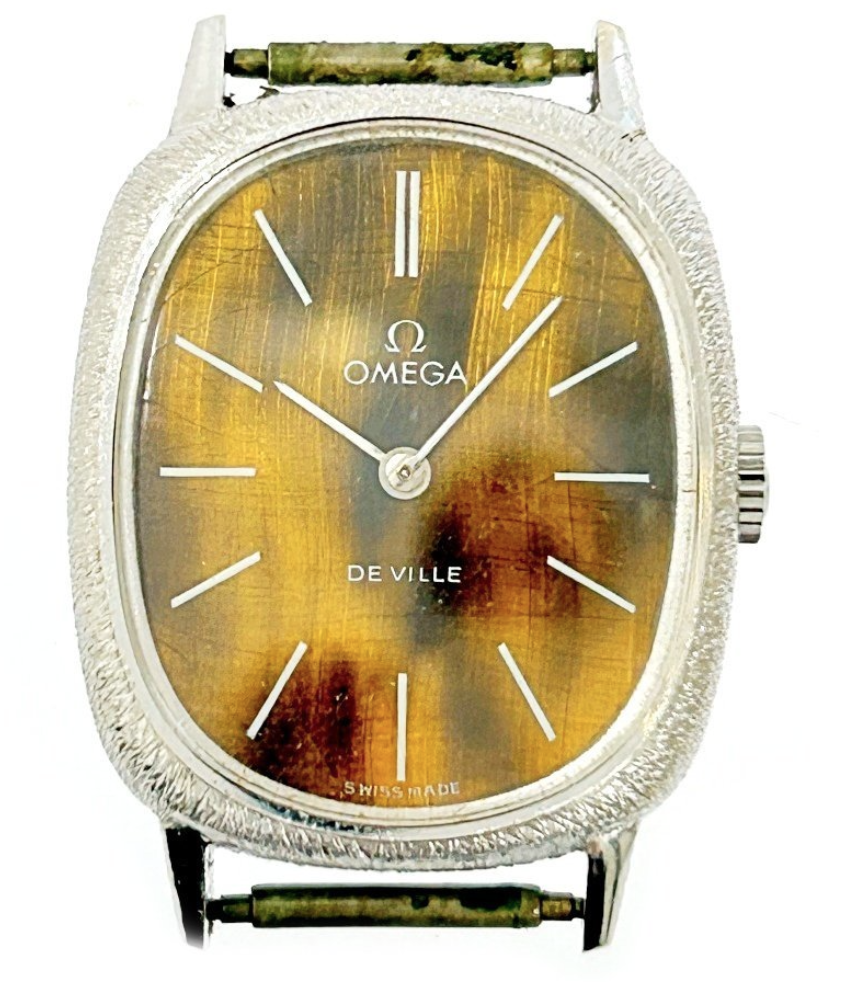

Recently saw this one but there was competition so I couldn't get it
Actual tiger eye stone dial on an Omega with an unidentified metal case
Different De Ville's, Unique Dynamic's - these become the usual thing after a while, it's pretty sad for even a one of a kind dial to be undemanded

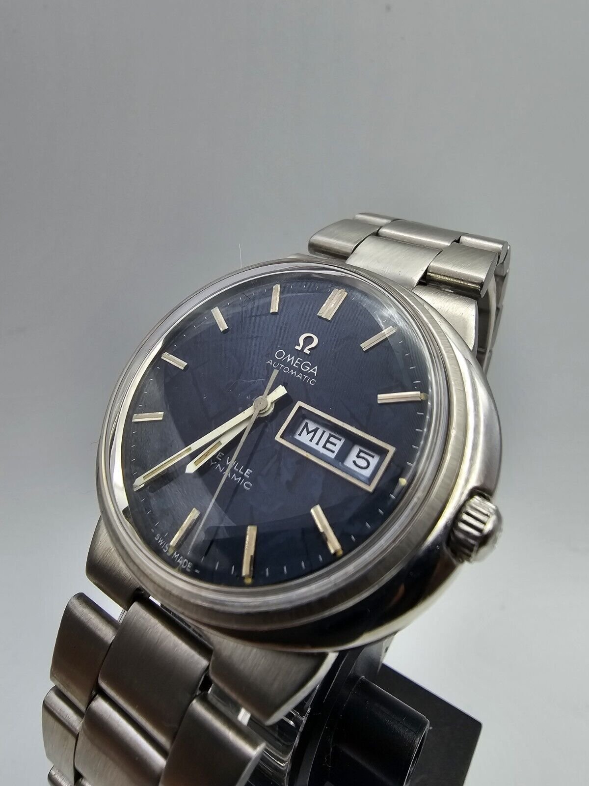

Here's another similar dial (from this link).
In fact the dial texture pattern looks the same as the above day/date.

It's a factory dial...this is the dial for the 166144 case...
064TT1668008 | DIAL BLUE IND.GREY LUM. 1020
Omega doesn't list anything particular about the pattern, so it was just another one that they offered. No longer available, so if you end up with a damaged one, it would be refinished by Omega, but I have no idea if they would put the same pattern on it or not. So if you are going to buy one, buy well.
