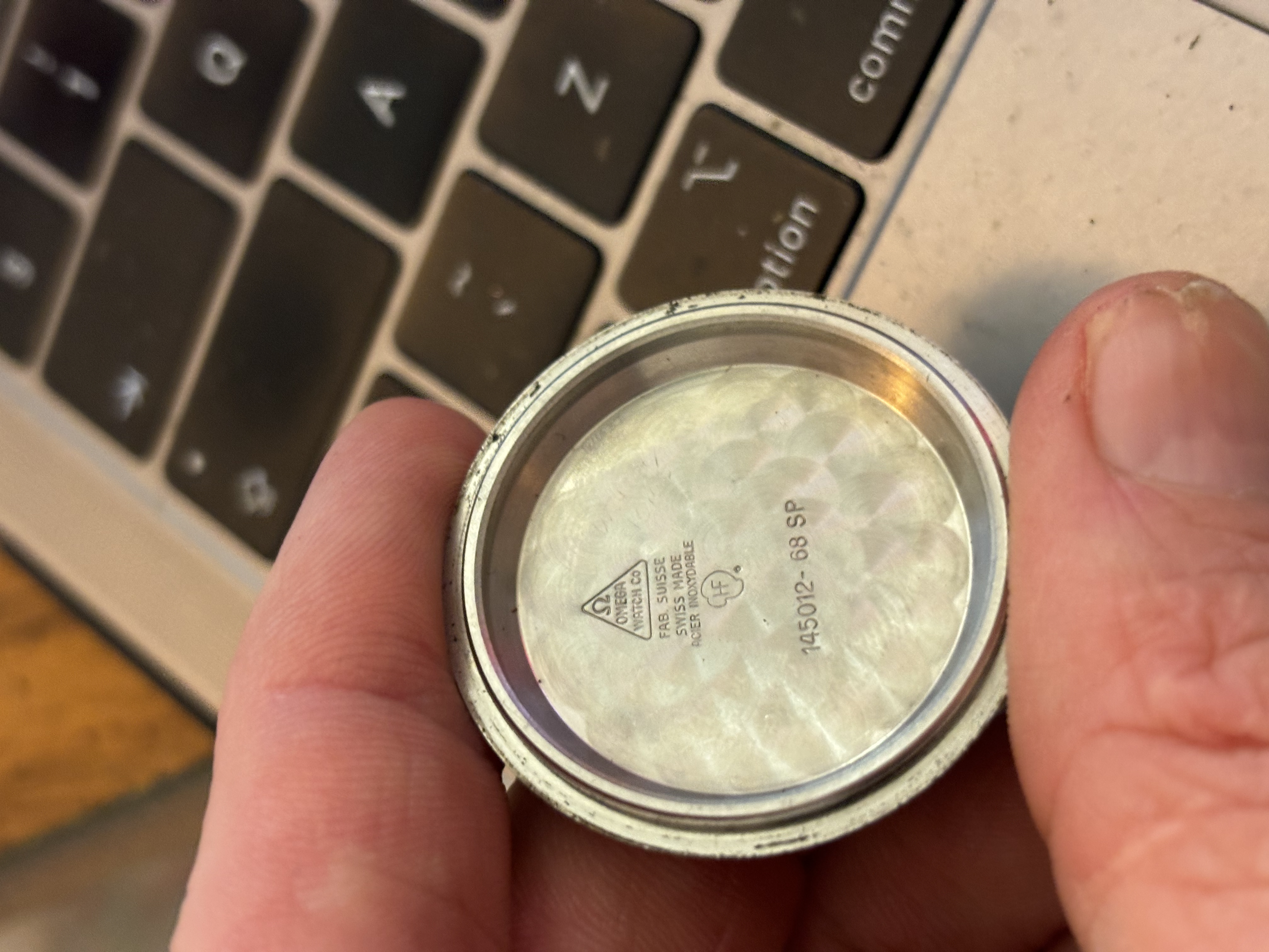

Please re-post the photo of the inside of the case back.
13,492
31,811
It's a 145012 68. Serial serial number seems to be in the correct range for this.
If you look through the link I posted there is a discussion of this reference along with photos of what it should look like.

Something doesn't add up, the watch is from 1968, the case and serial number confirms as much.

We saw the SWISS MADE, it's actually quite relevant and helps date the dial. IIRC, in 1963-ish, the dials transitioned to T SWISS MADE T, to indicate the use of "tritium" luminous paint. That, along with the absence of the word PROFESSIONAL, is how we dated the dial.

Yes, it's possible that it wasn't new, we understand that. He could not have purchased that movement and case in 1966, but he could have purchased them in 1968/69. But they would generally have come with a dial saying PROFESSIONAL. That's the issue.
It's possible to find a period-correct dial and pusher cap if you're interested. Not from Omega. I'd suggest going slow and doing your complete research first. And really there's no reason to try to fix the dial, it is what it is.

The dial is looking more and more like a pre-professional dial that had the radium lume removed.Hard to guess why it’s in the wqtch- can only assume a watchmaker mixed them up at service or replaced the damaged original with one they had sat in a drawer. As has been stated, if it is a genuine 60’s pre-pro dial, it pre dates the rest of the watch by at least 6 years but does have value
