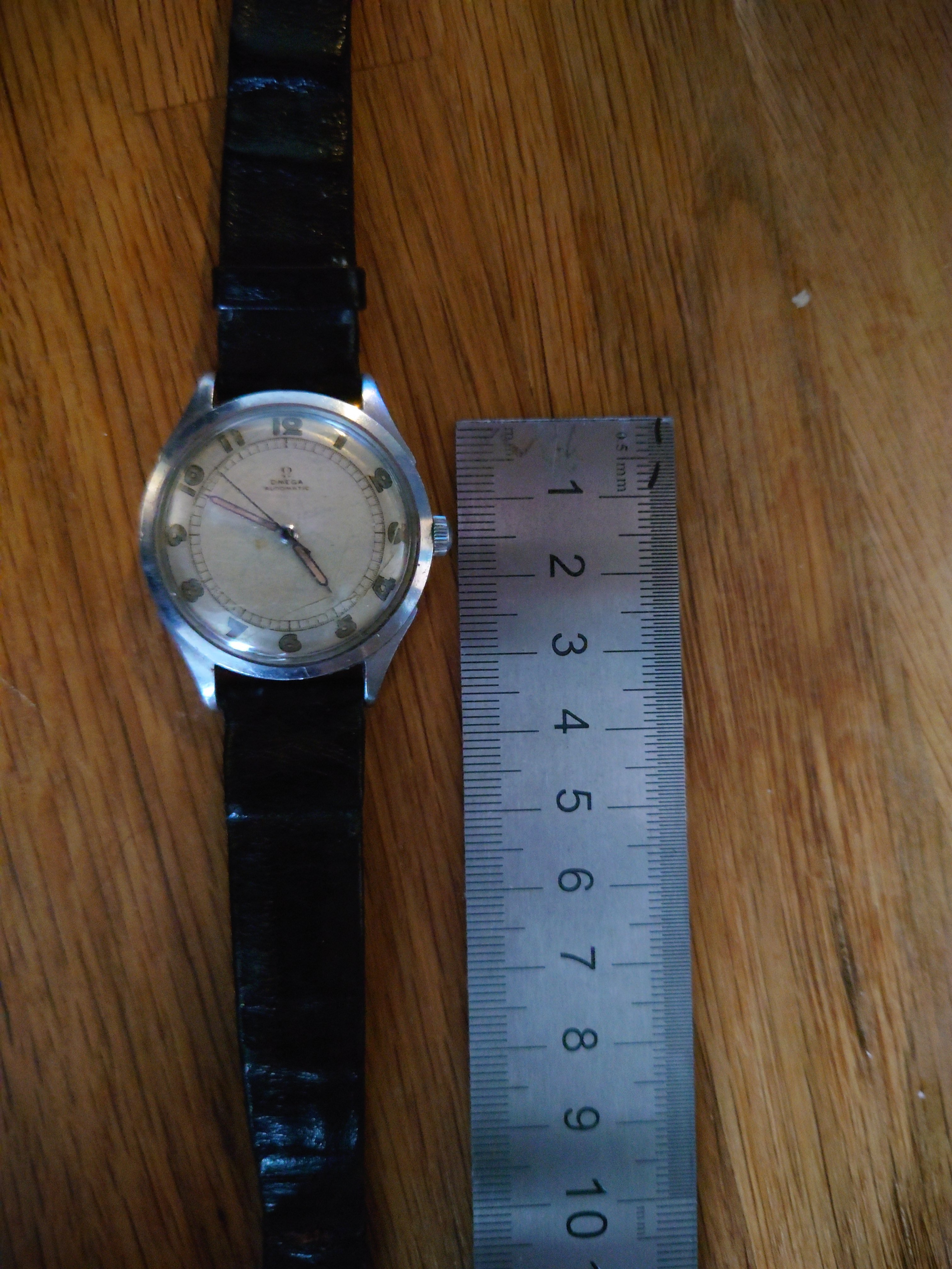

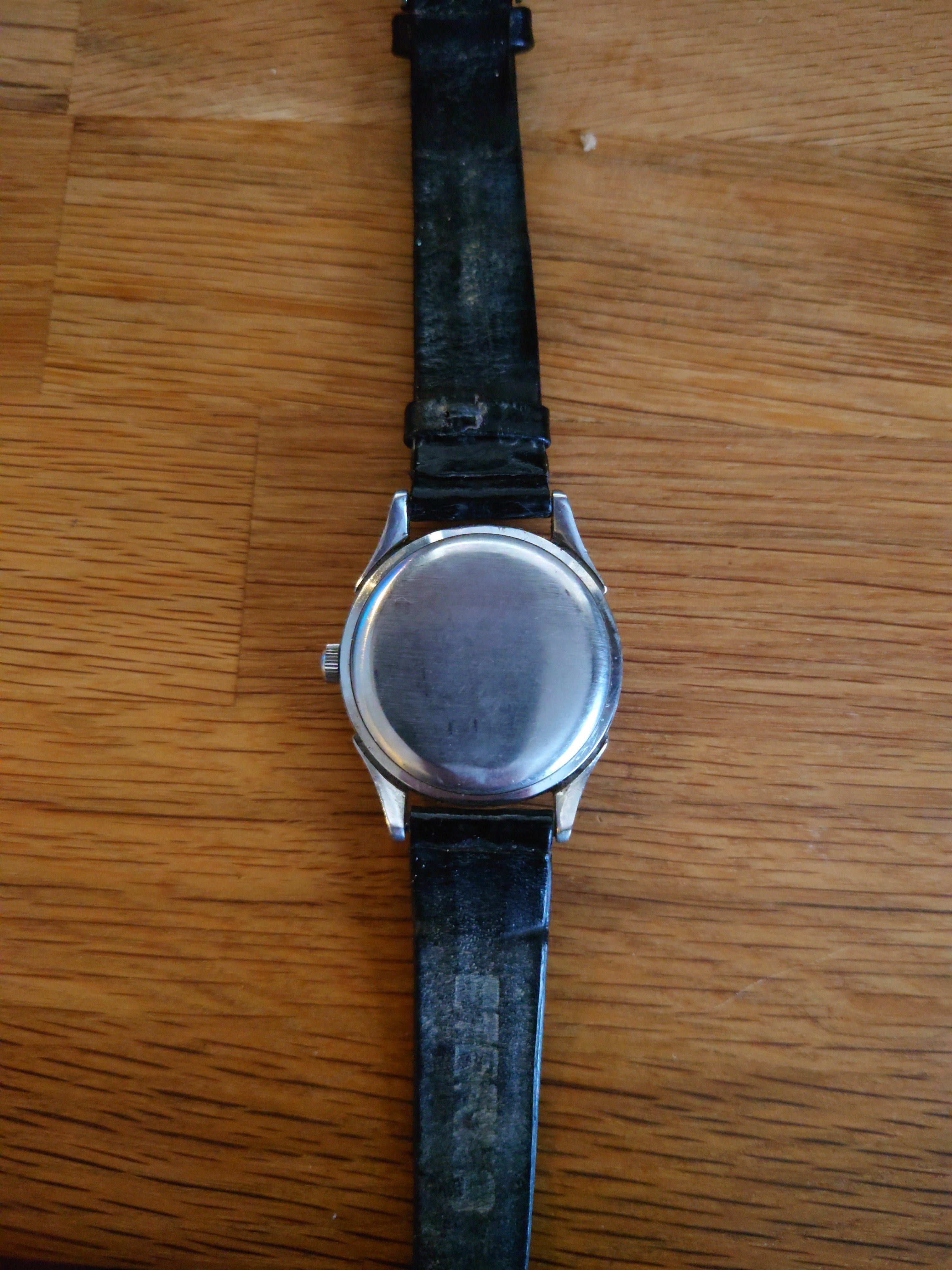

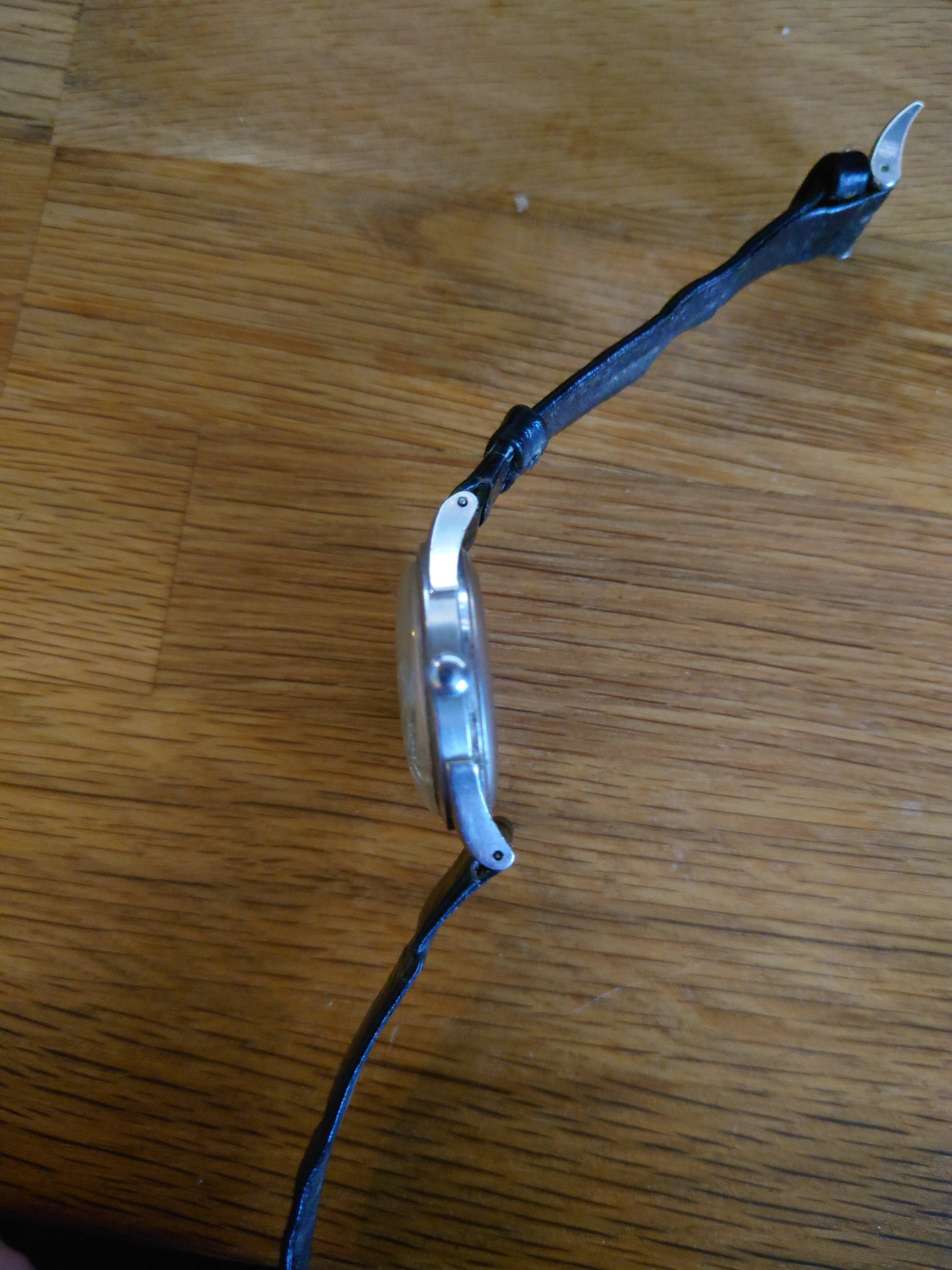

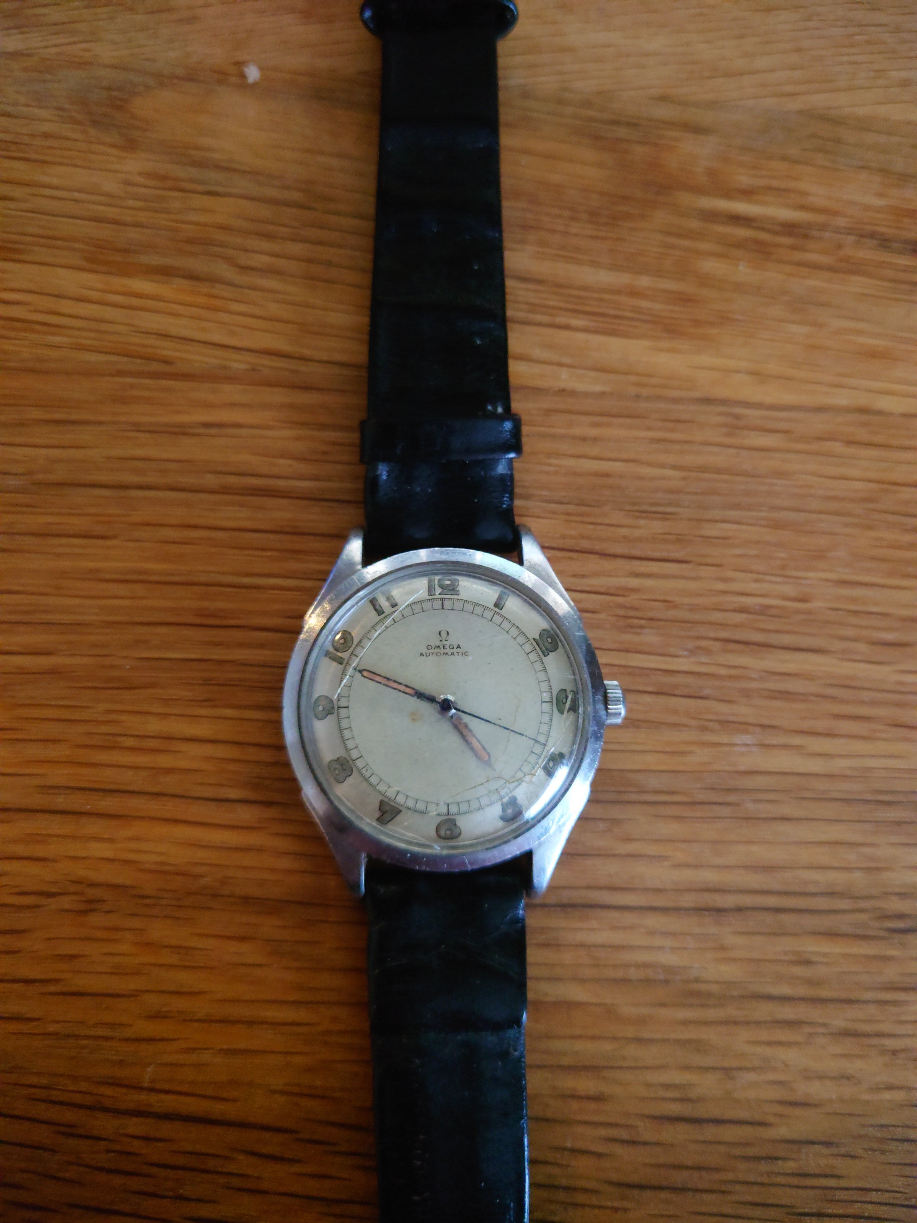

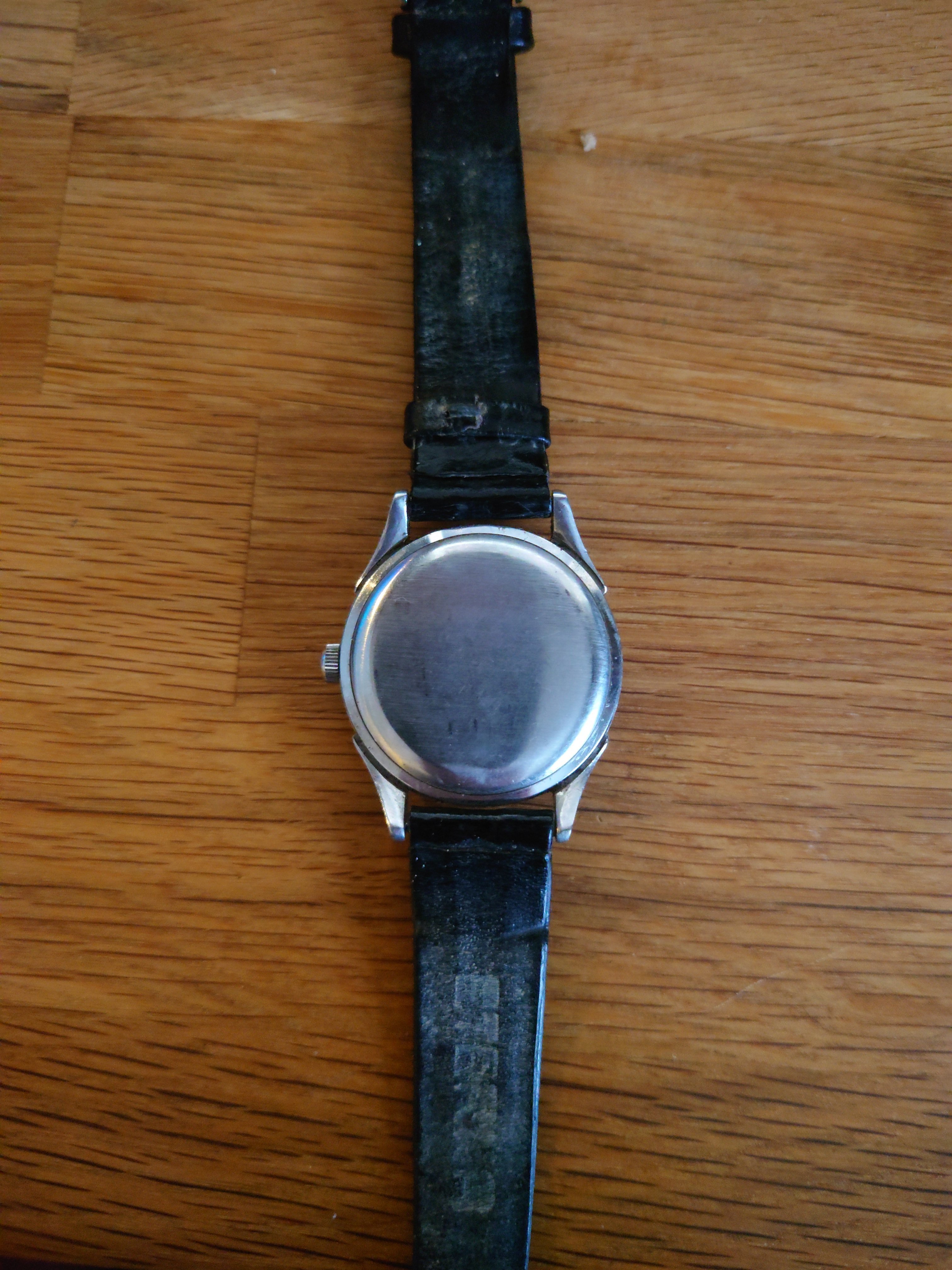

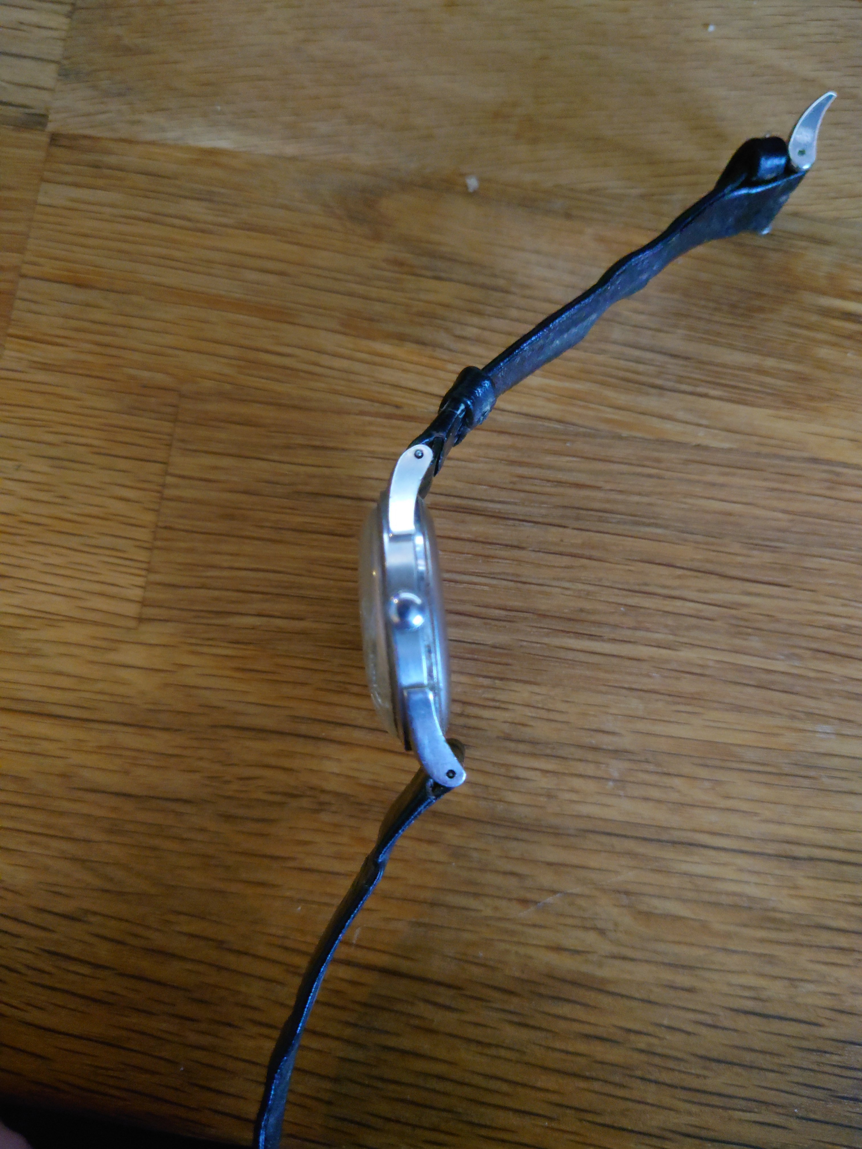

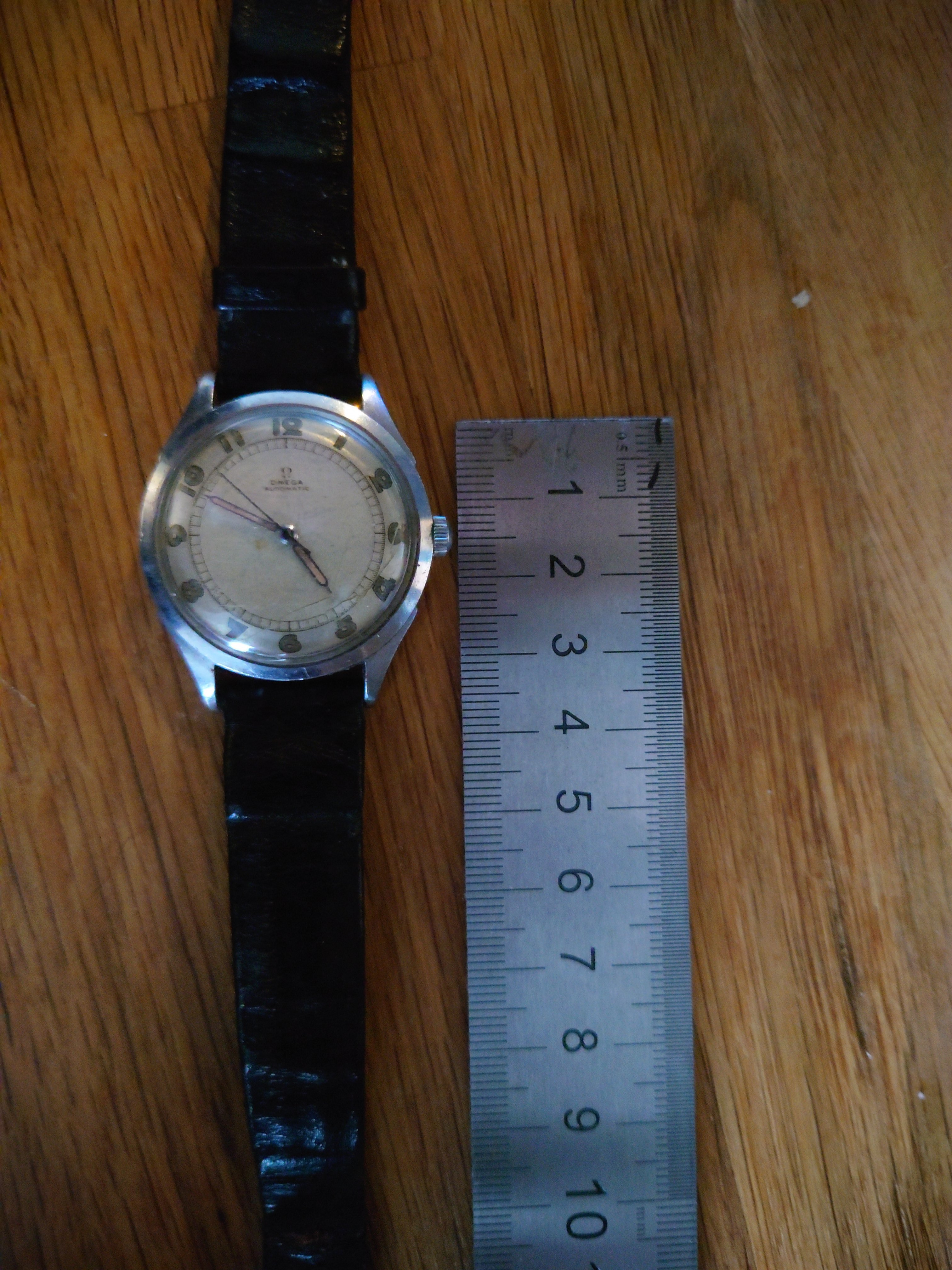

Hello good people!
My father (born in '47) found this piece when he was around 12, he thinks. After he and his father tried to find the owner, my grandfather used it until the day my father left to serve in the military. My father used it from that day until he got a job after the army, and he bought a new watch, and this one was left in a drawer. Now it winds but stops and starts as it will. My father took it to someone claiming to know watches, which told him it was best used as parts.
My father was gutted, and I think this sounds strange.
Can anyone tell me something about it? I have not opened it..
Sorry for the poor quality of the pictures..
8,283
29,288
It's actually a desirable model in the collector market, but it does have condition issues.
If you (or he) want to use it, it would obviously require a good service, and they are not cheap.
If it is ever to be sold, better to sell it complete, as it would almost certainly have more value than parts alone.

Thank you for your answers! He will never sell it I believe, but it would be nice to surprise him with it in working conditions. So it should be possible to repair it? Does the model have a name or number for reference?
8,283
29,288
It is what is called a "bumper" automatic. Best to find a watchmaker who is familiar with that type of mid-century technology, though most of a certain age are, as would be with vintage Omega watches.

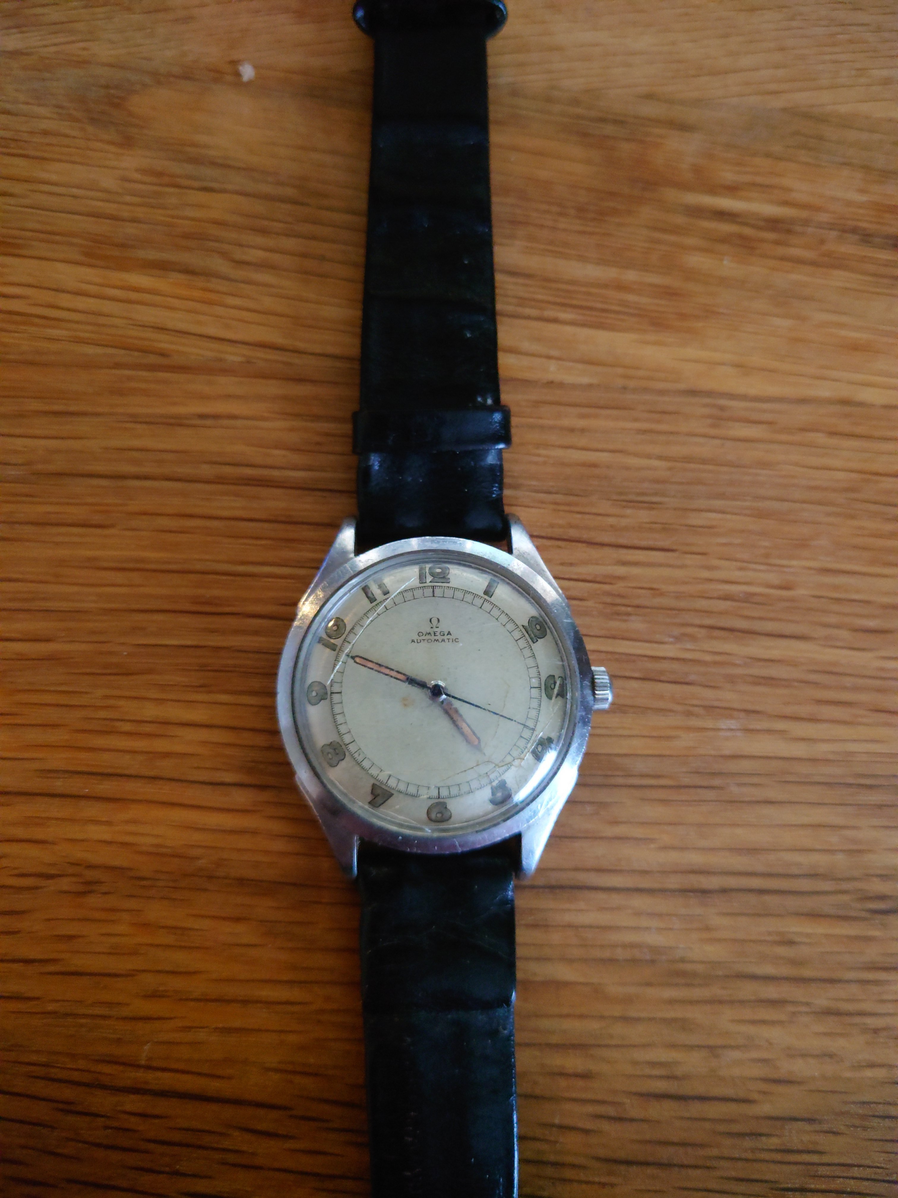

When you service it….new crystal for sure. Movement only. Do not touch the dial, hands and case.

Keep it and service it, those hands are lovely! Not sure if the lume has been reapplied given the "fat" shape of the numbers and the difference in patina, pictures are too blurry to tell..
1,844
7,419
My Lume is pretty similar in shape, just more yellowish.
This is exactly the same dial and lume, only my father's dial has some more yellowish patina on it.

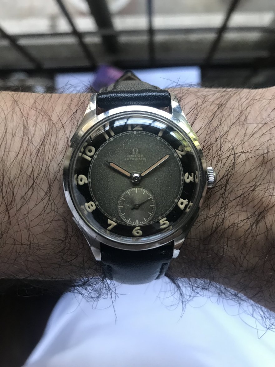

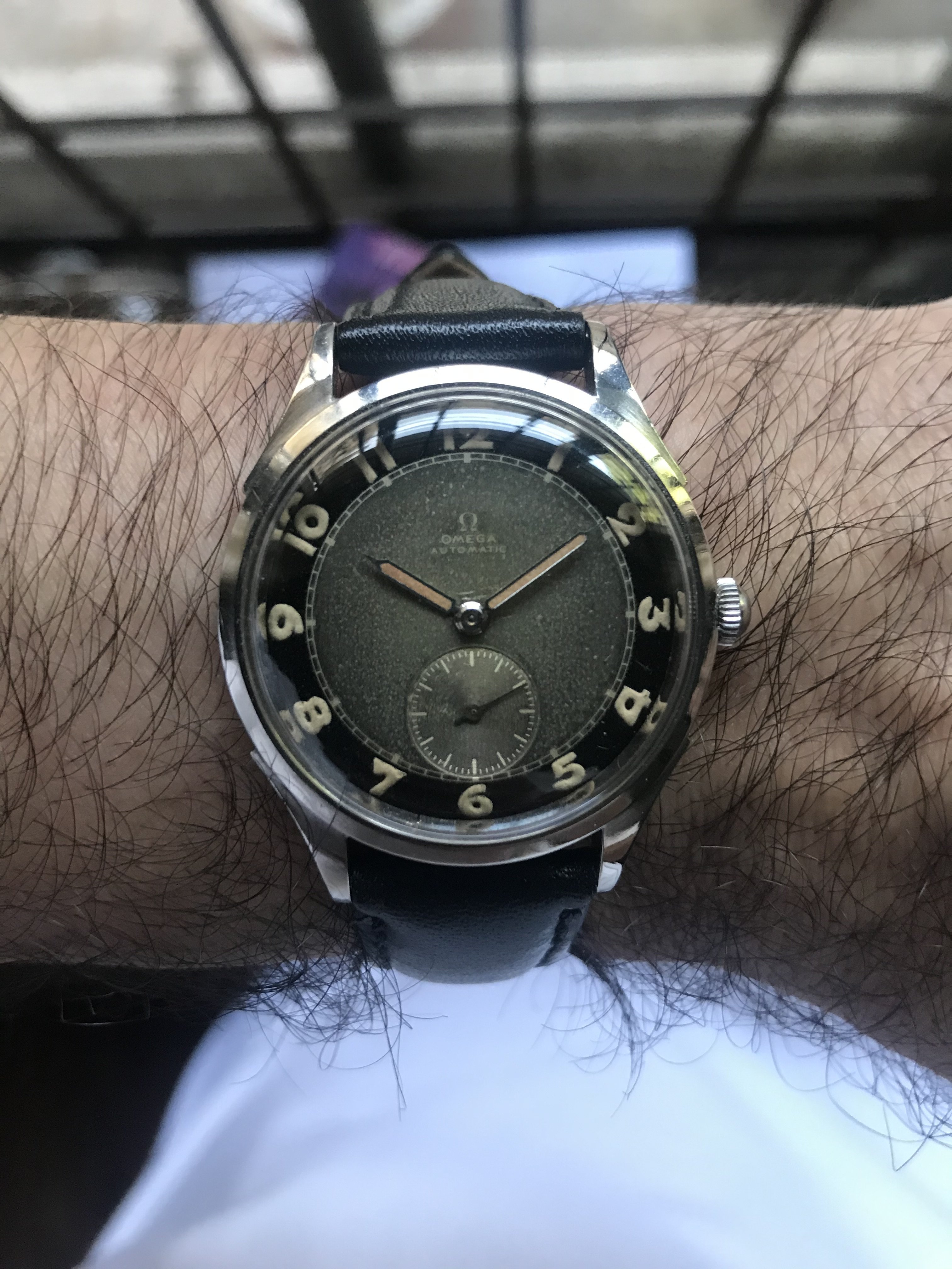

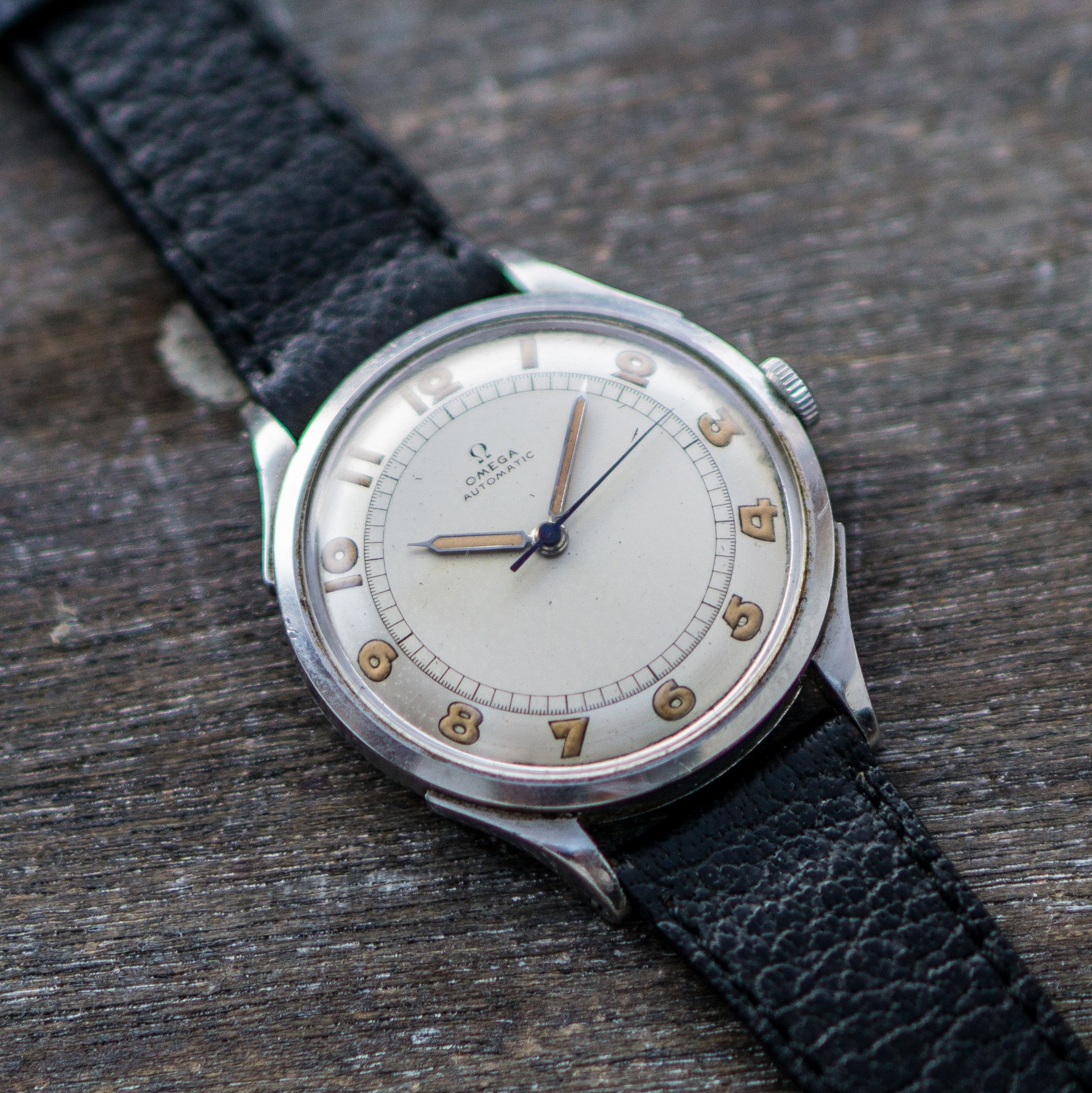

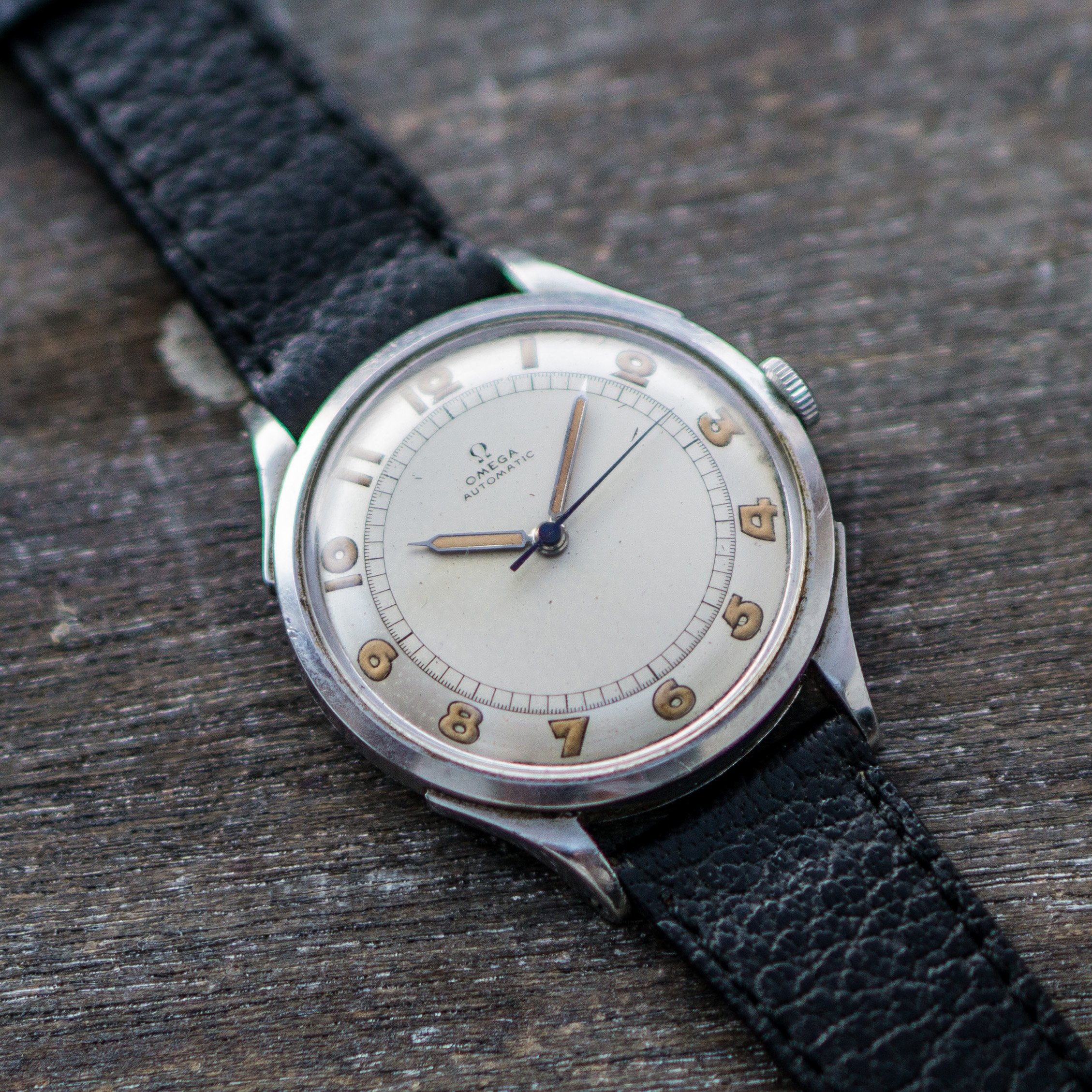

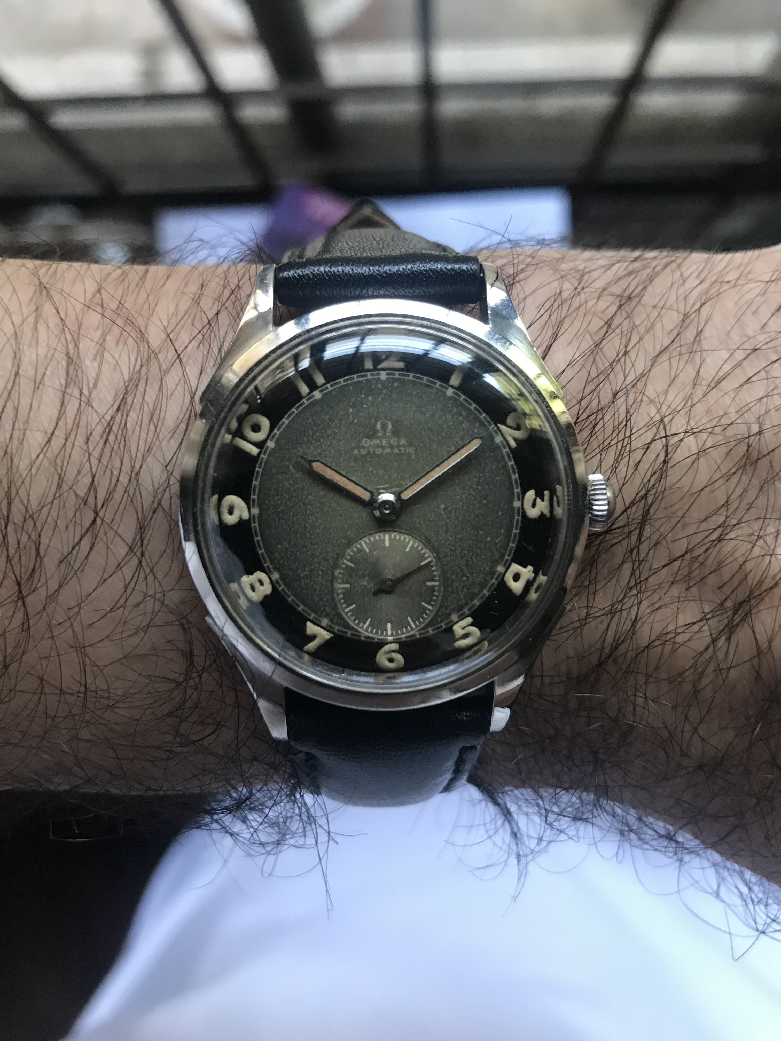

By the way. Here’s mine which is a sub second bumper from the same family. Found it in Sweden
