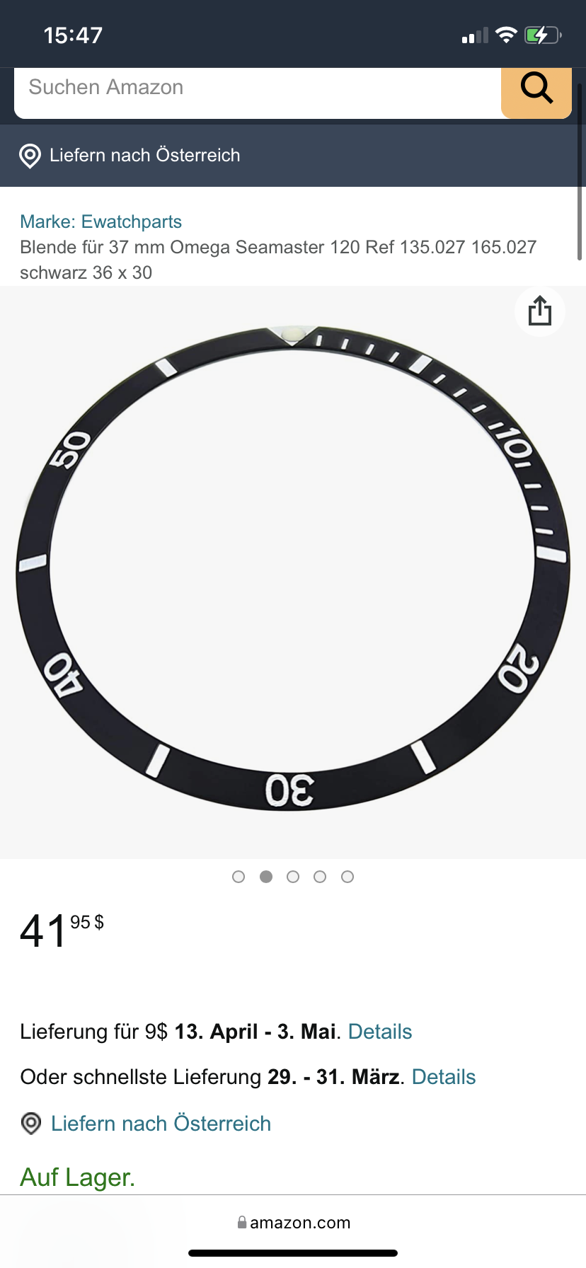

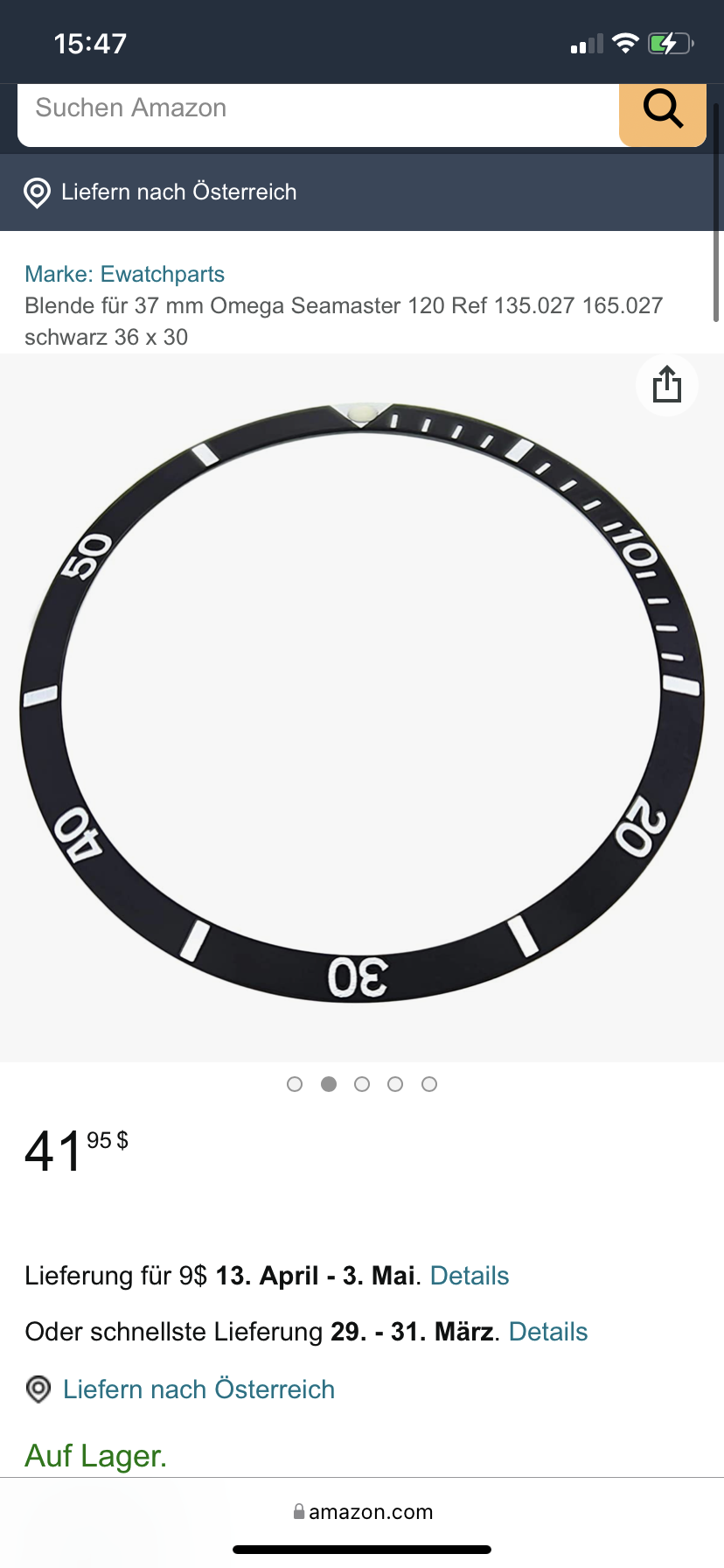

And the bezel… I saw them already make insert or replacements for the print
Could that be or is it genuine ?

The factory bezel doesn’t take an insert- it’s a solid anodized piece

But still, if that bezel is original that is the best kept condition I’ve seen so far.
