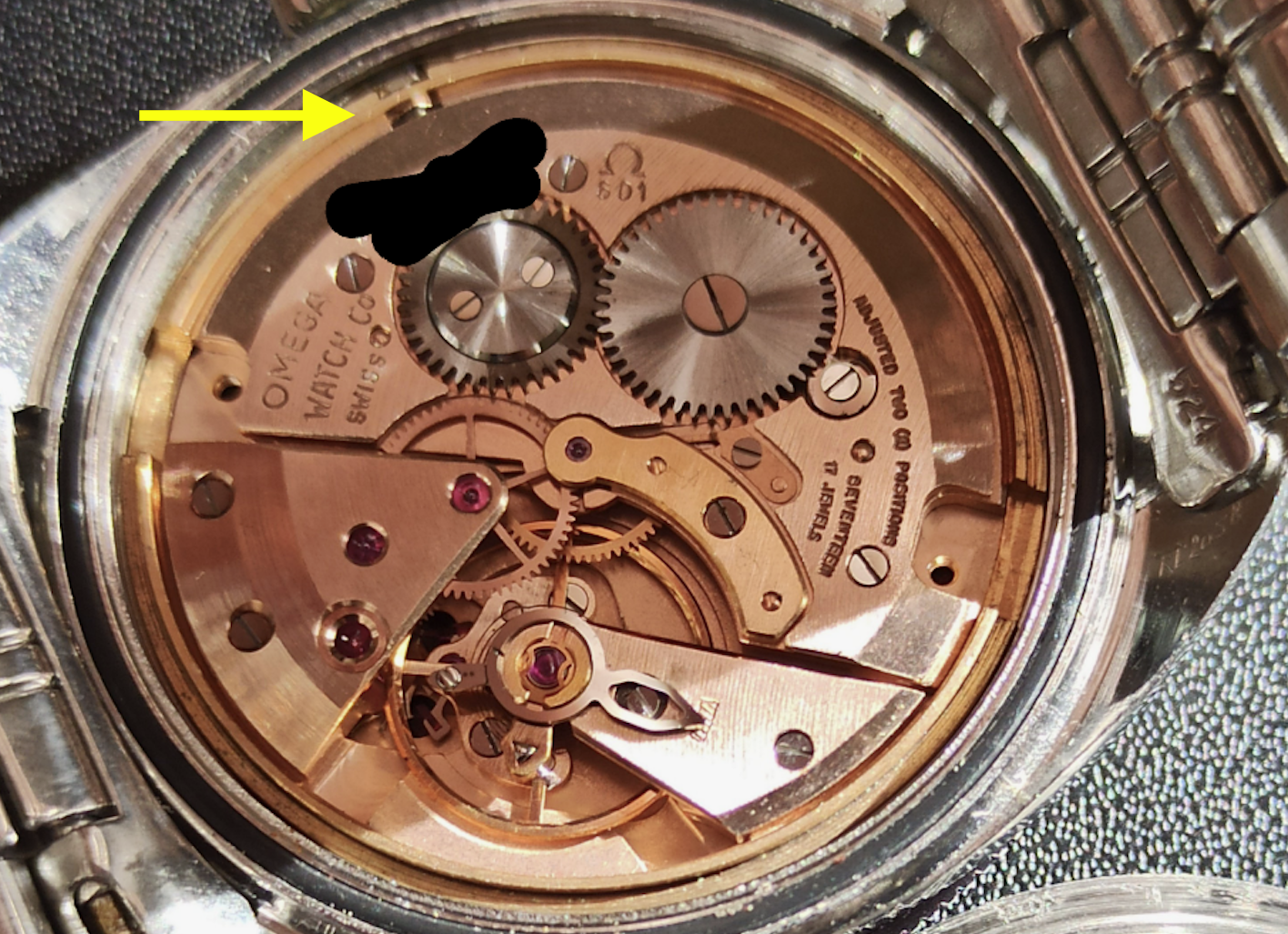

Sorry I meant to ask - the picture that you shared, is that of an actual seamaster 120?

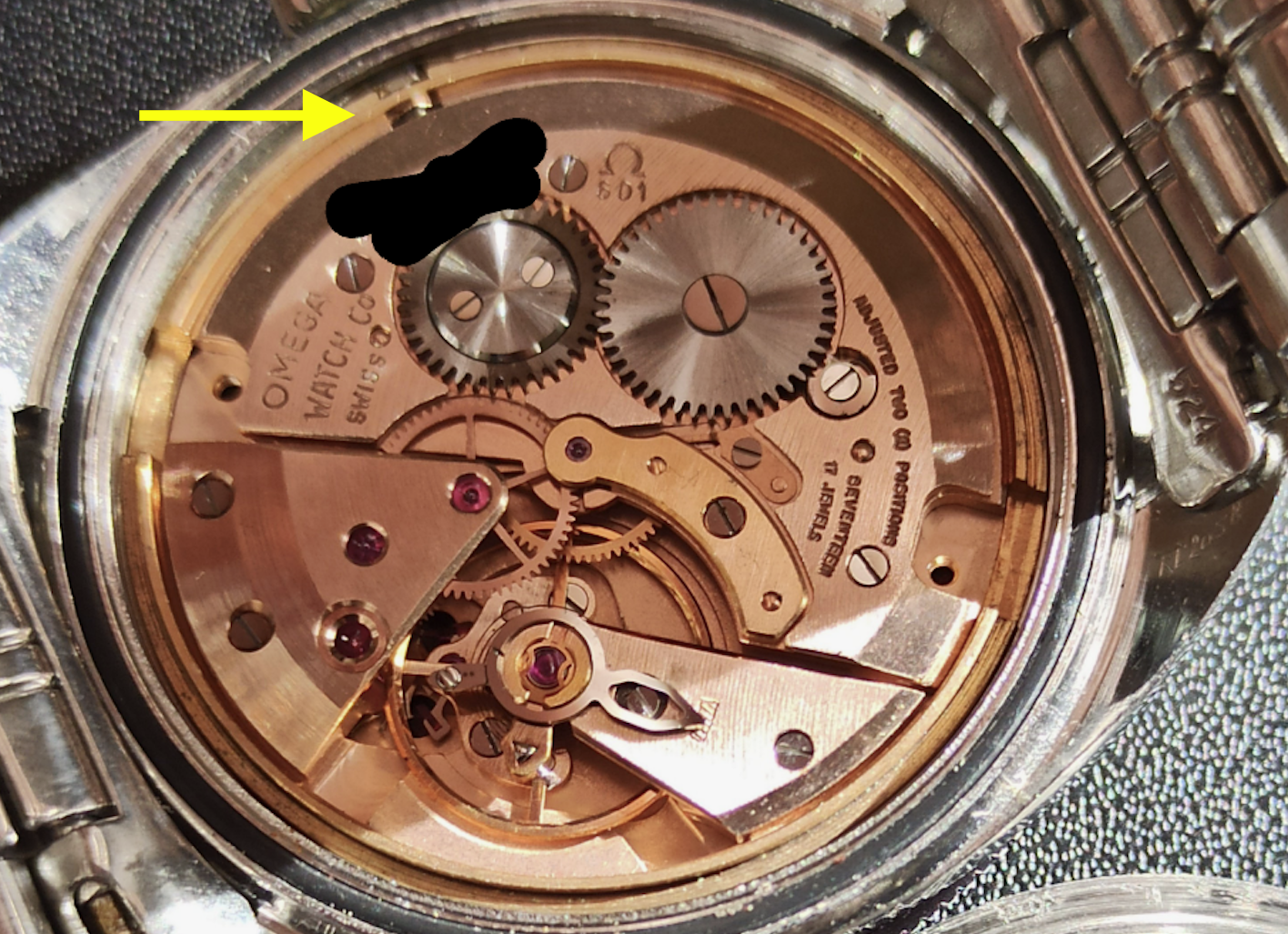

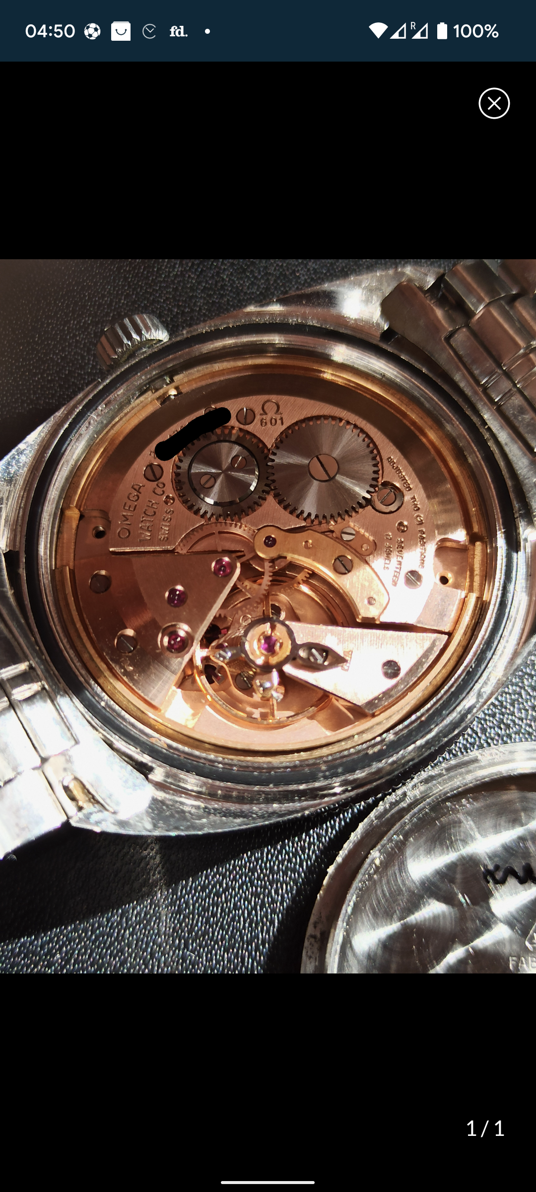

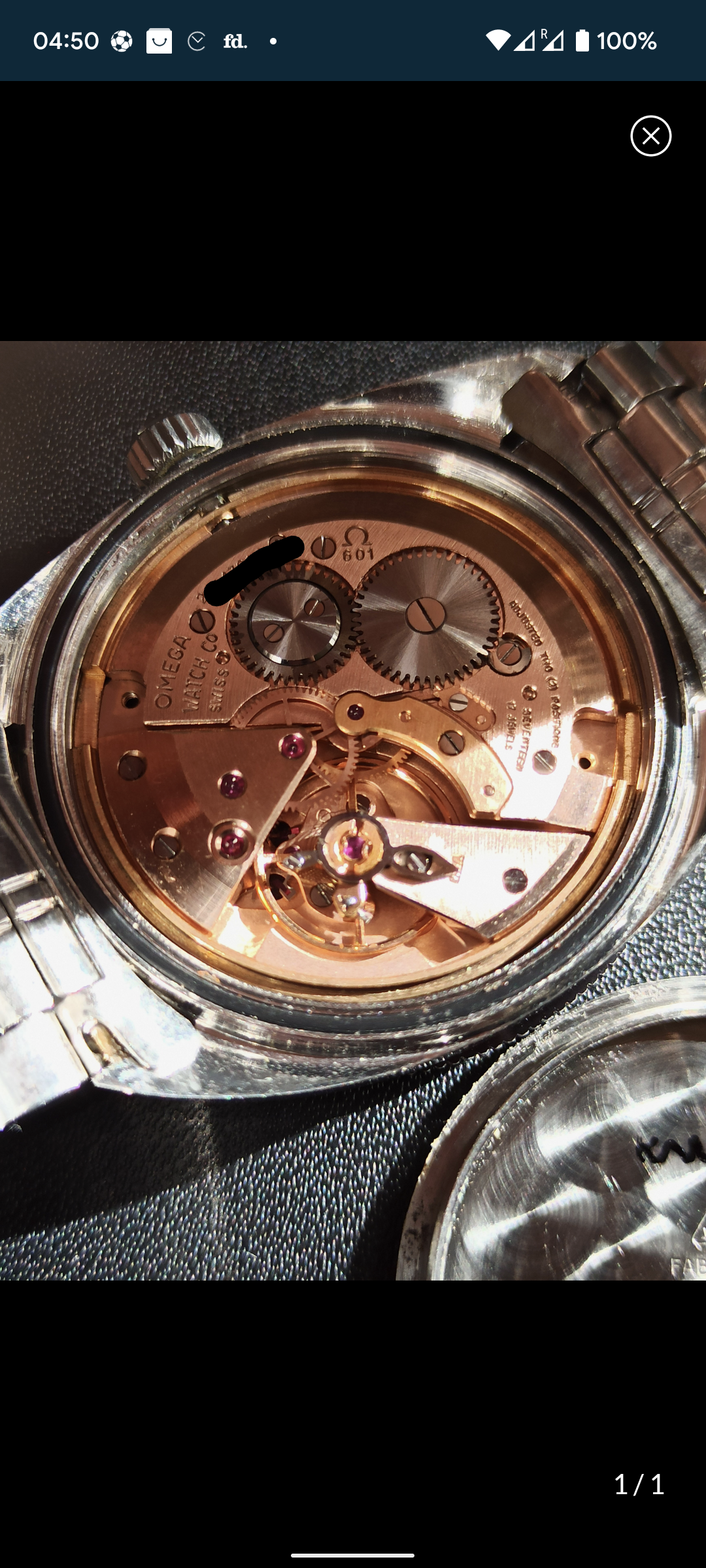

Yes ... the 601 movement i posted is in a manual wind NO DATE case ref 135.027 OMEGA Seamaster 120
also .. added info if in case u might need it ... SS Bracelet ref# 1098 with 19MM end links ref# 547 ... is actual paired with the case range in the photo
16,305
45,025

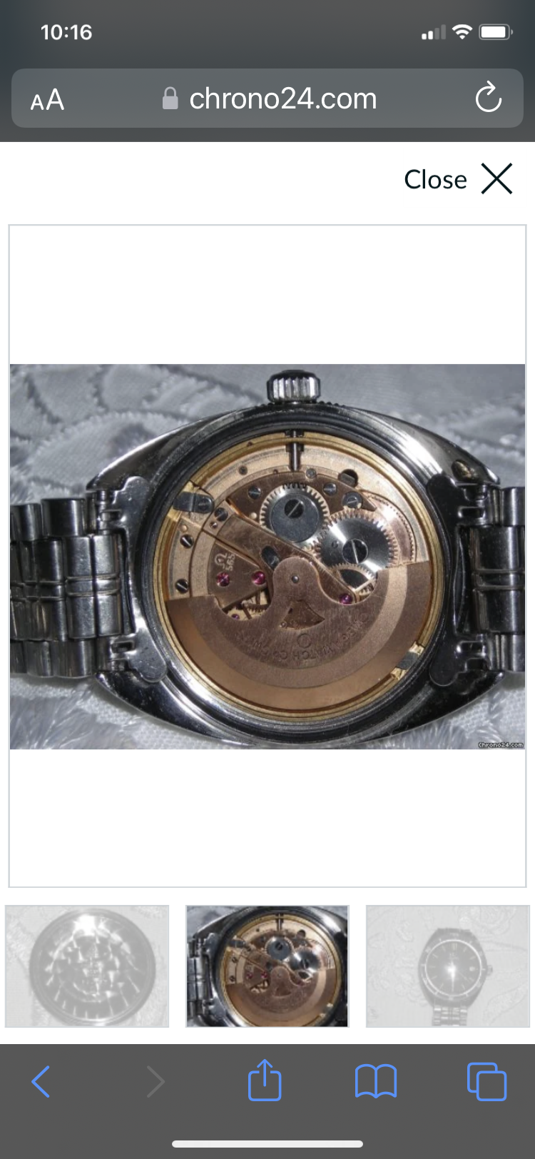

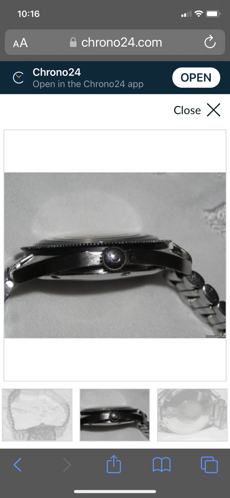

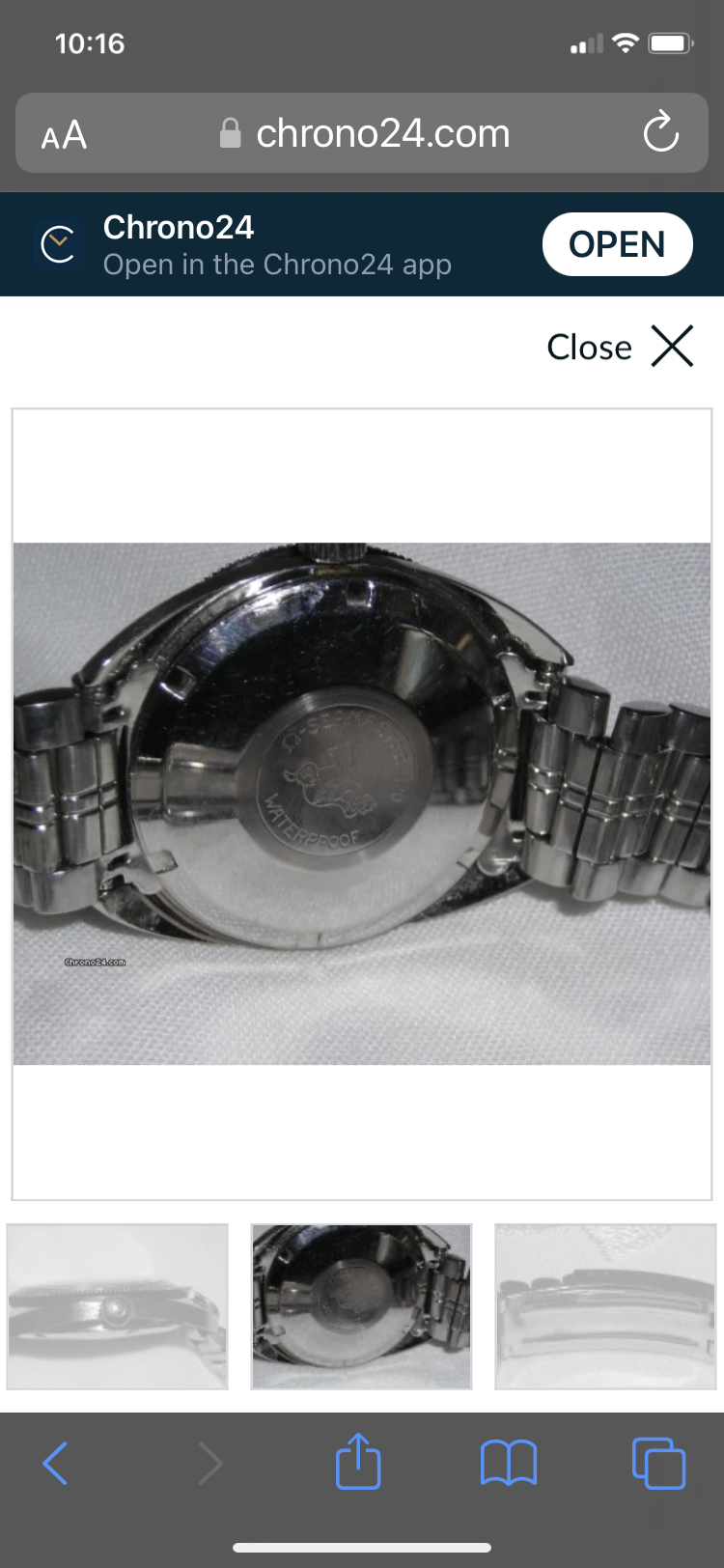

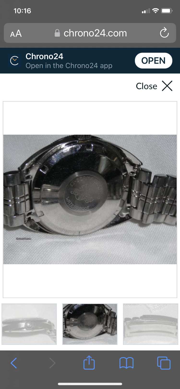

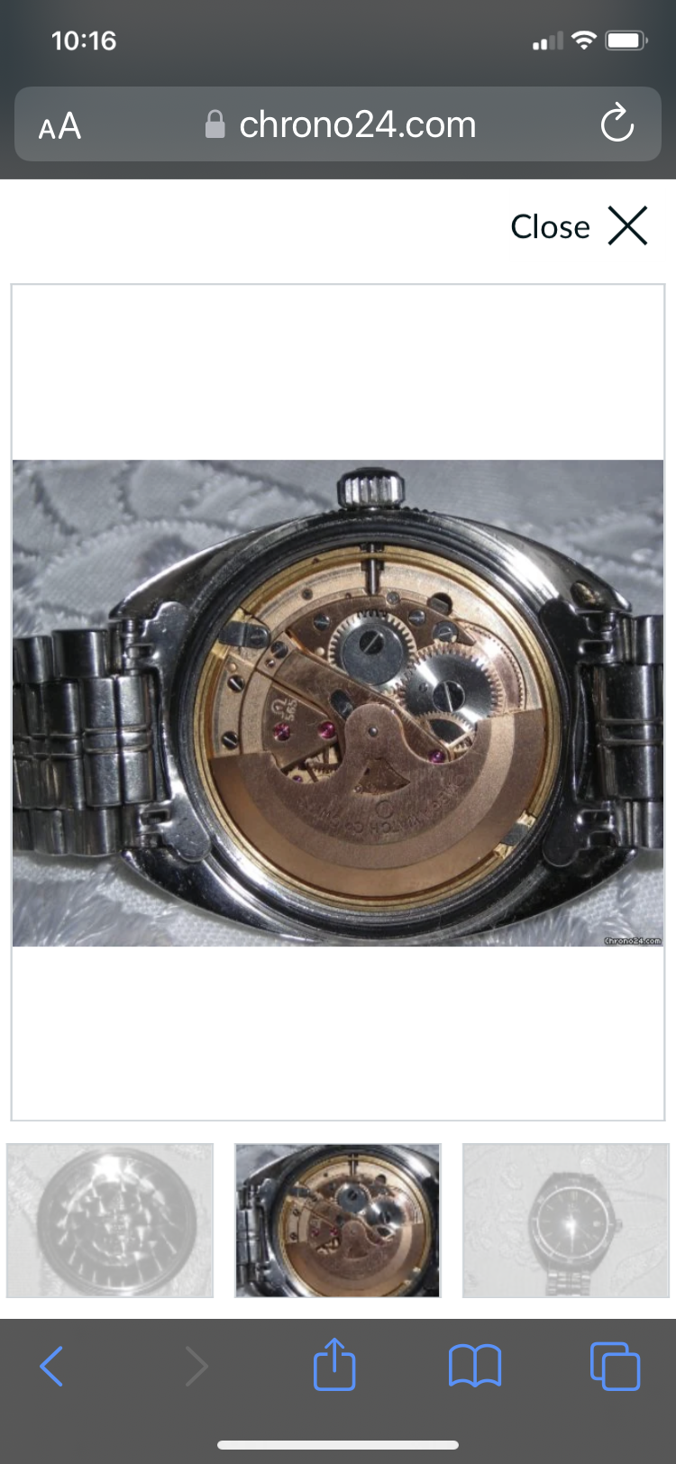

The movement retaining ring is absolutely not easy to find. A few years ago I had one with a heavily damaged ring and several watchmakers said they couldn’t help. After scouring various sources for months I eventually called Swiss time services who thankfully had one.
Point is, you’ll likely need a full service from an Omega authorised watchmaker to get this piece.
This is good info. Once again the 120 seems to be an orphan.
529
819
I was about to say! Just when you think you've found one..
My watchmaker just confirmed the same about the difficulty for finding that ring.
For me it's a pass. Seller also has some other offers, for whom apparently it isn't an issue.

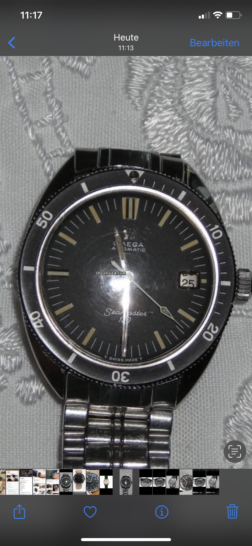

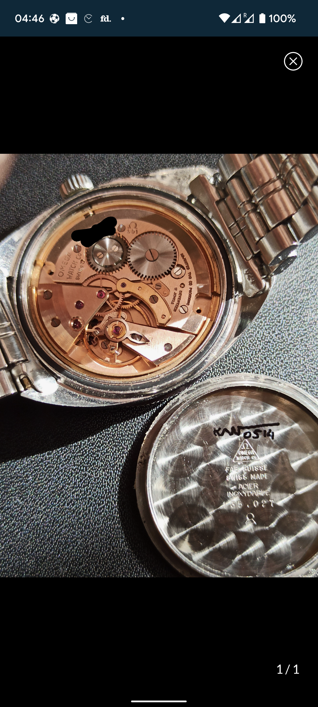

Ok some new insights.. @sonicosa reached out to me, thinking that the movement retaining ring is actually there. It supposedly has the same pink gold color as the movement . I had removed the photos upon request of the seller, but here it is again (after his approval). What do you think?

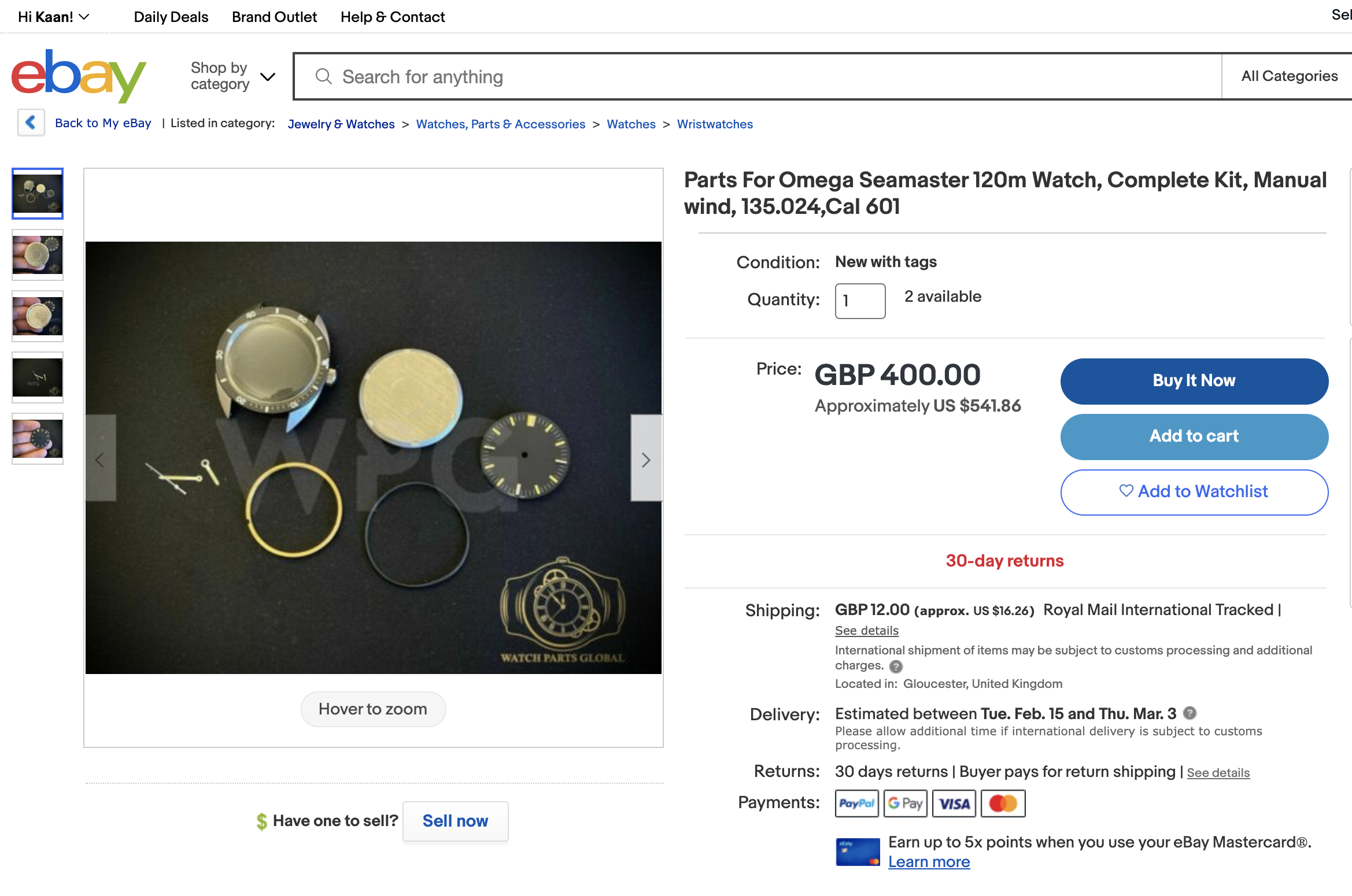

Good news, no need to fanatically seek fake 120's, there's an easily available kit for it now

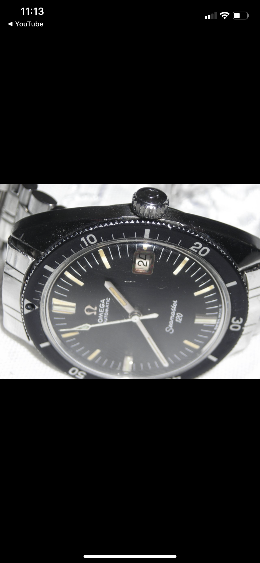

Nice restoration video that just popped up in YouTube. Calibre 563 in a 166.027... is it correct or a Frankenstein?

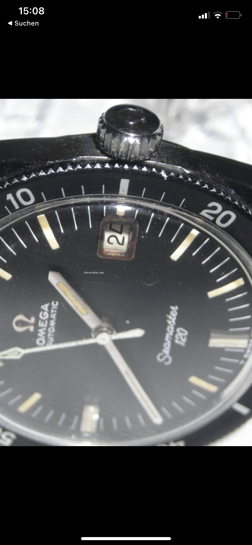

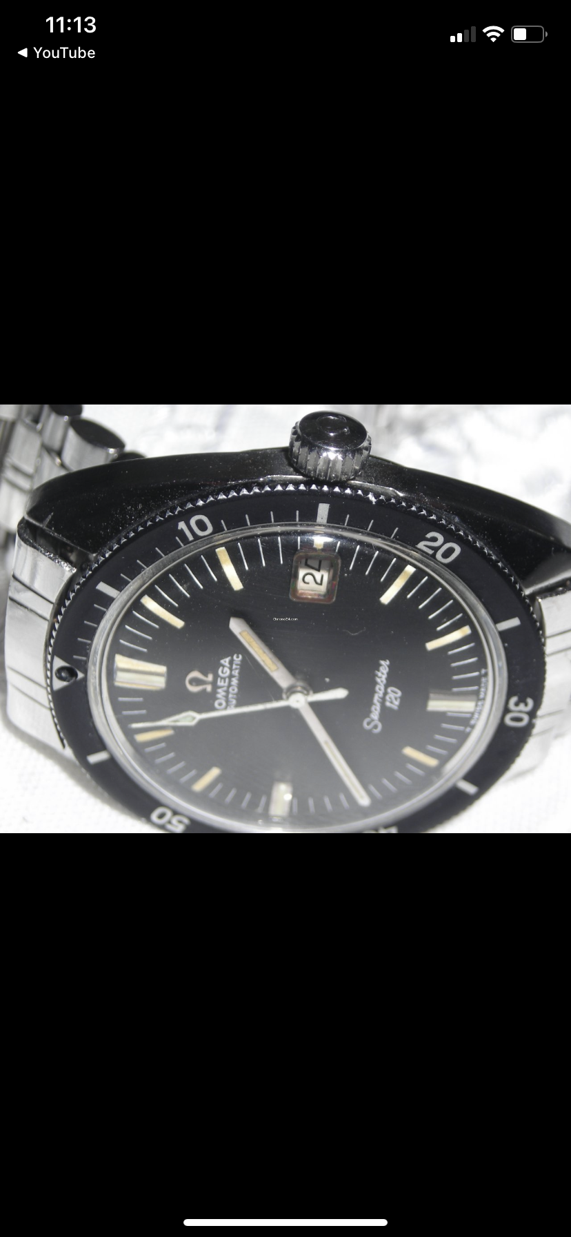

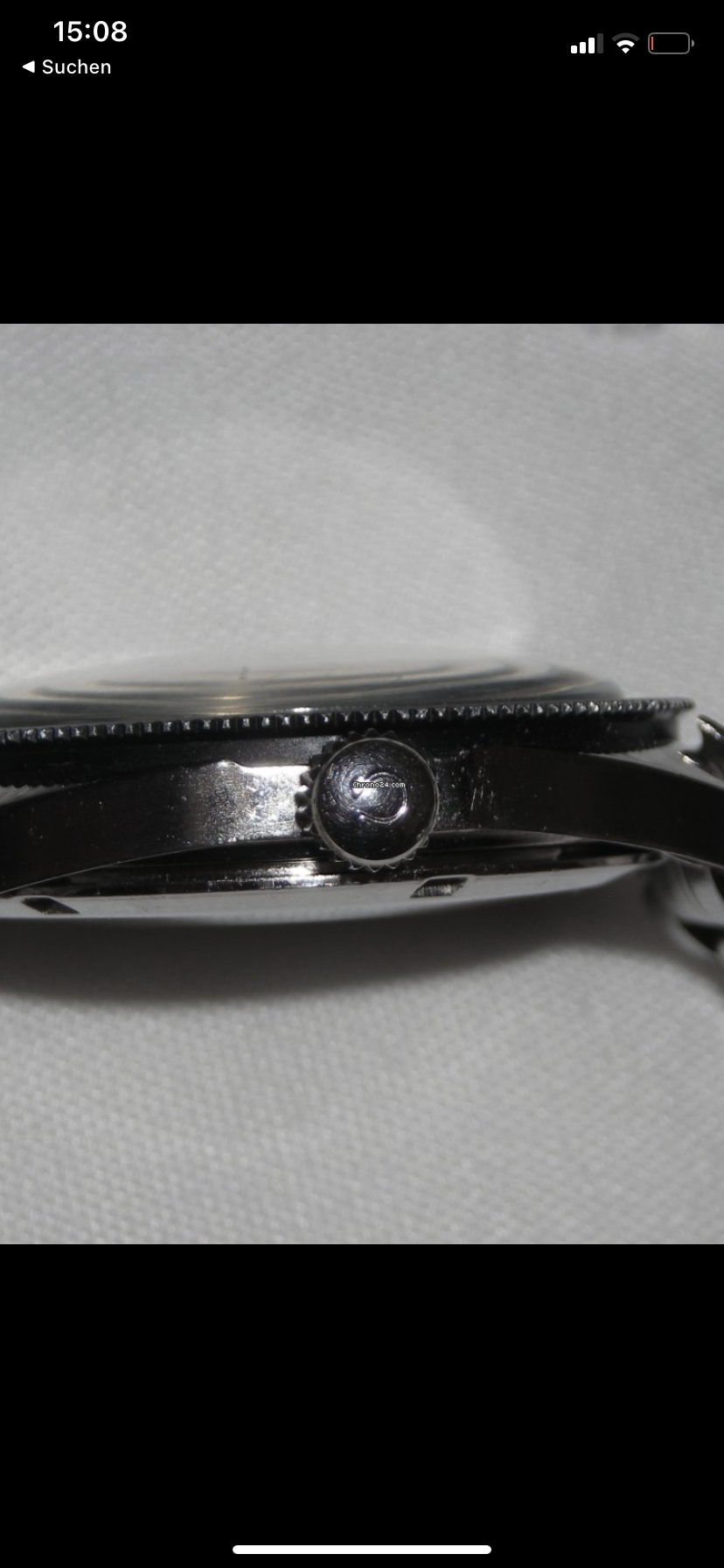

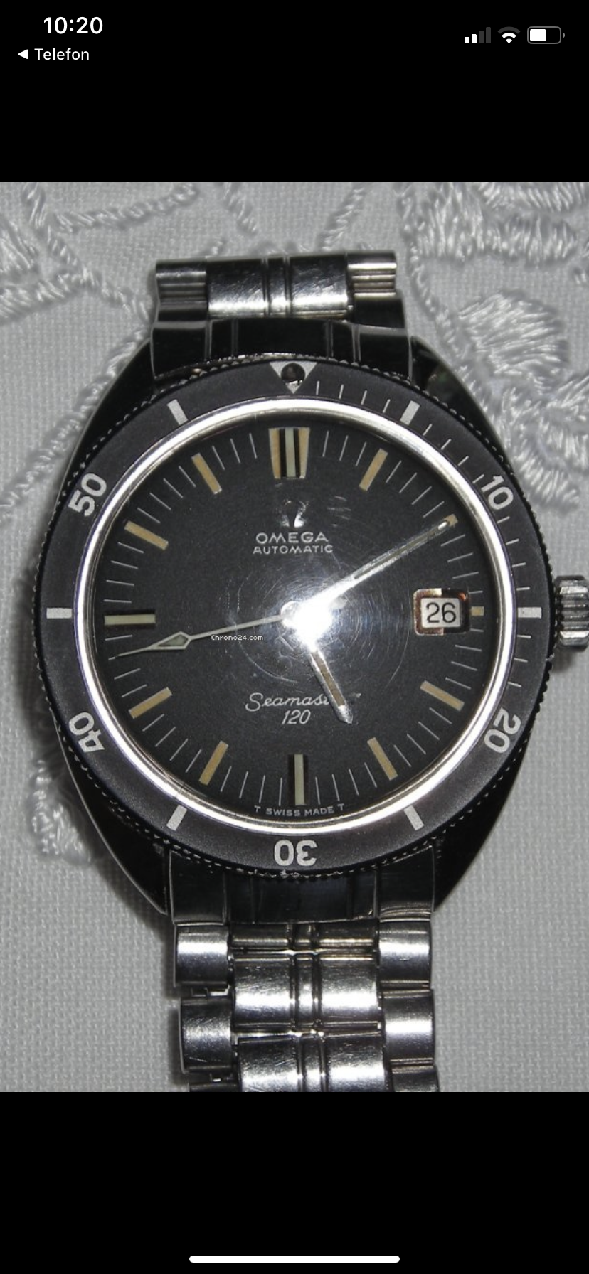

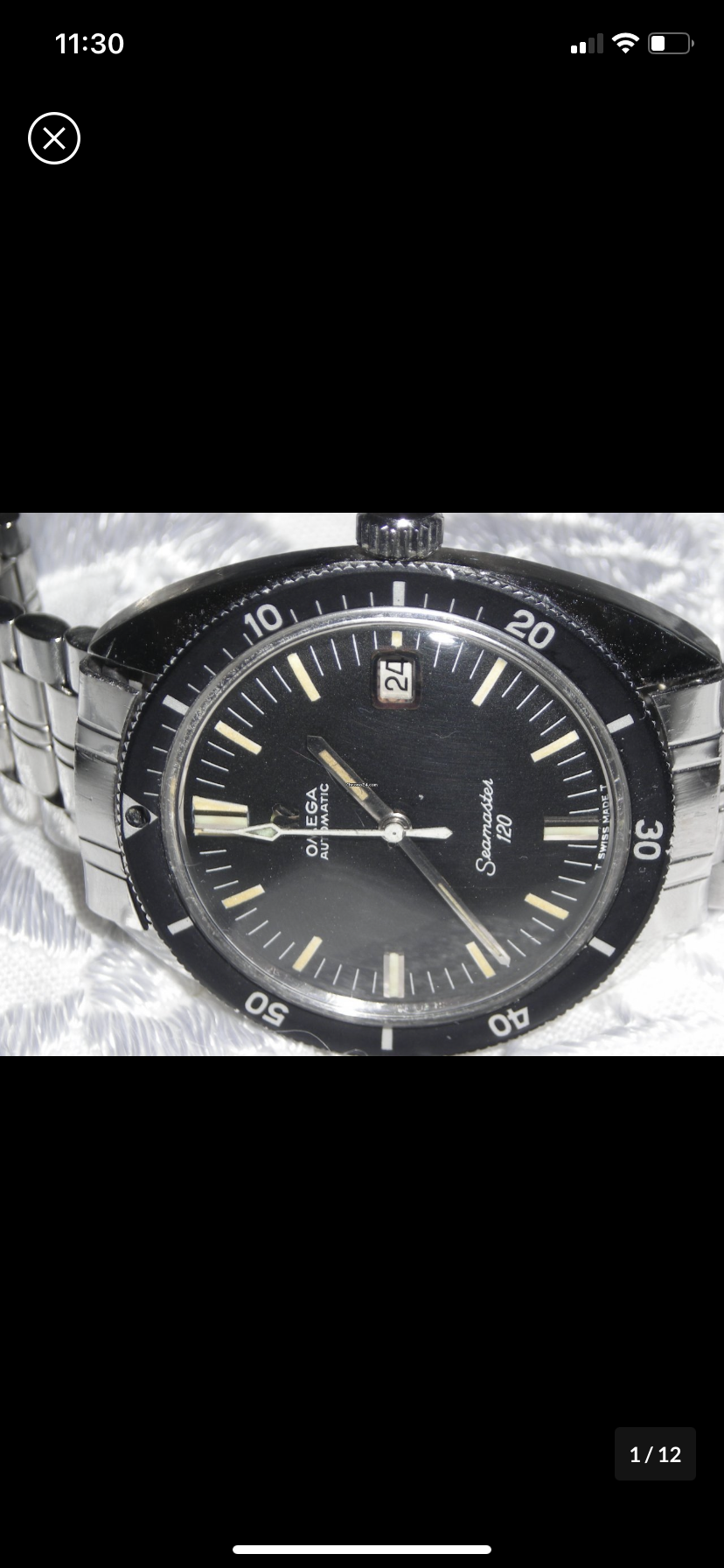

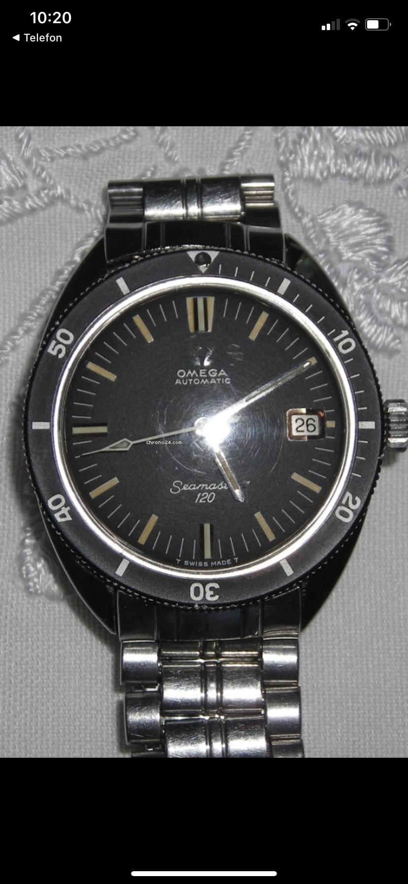

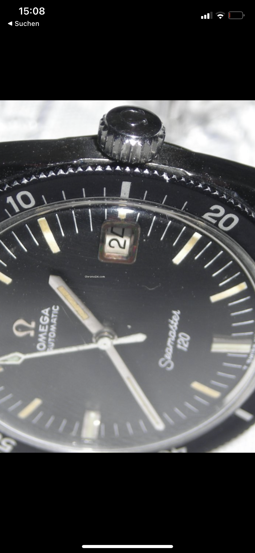

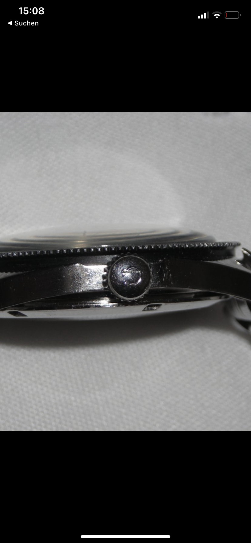

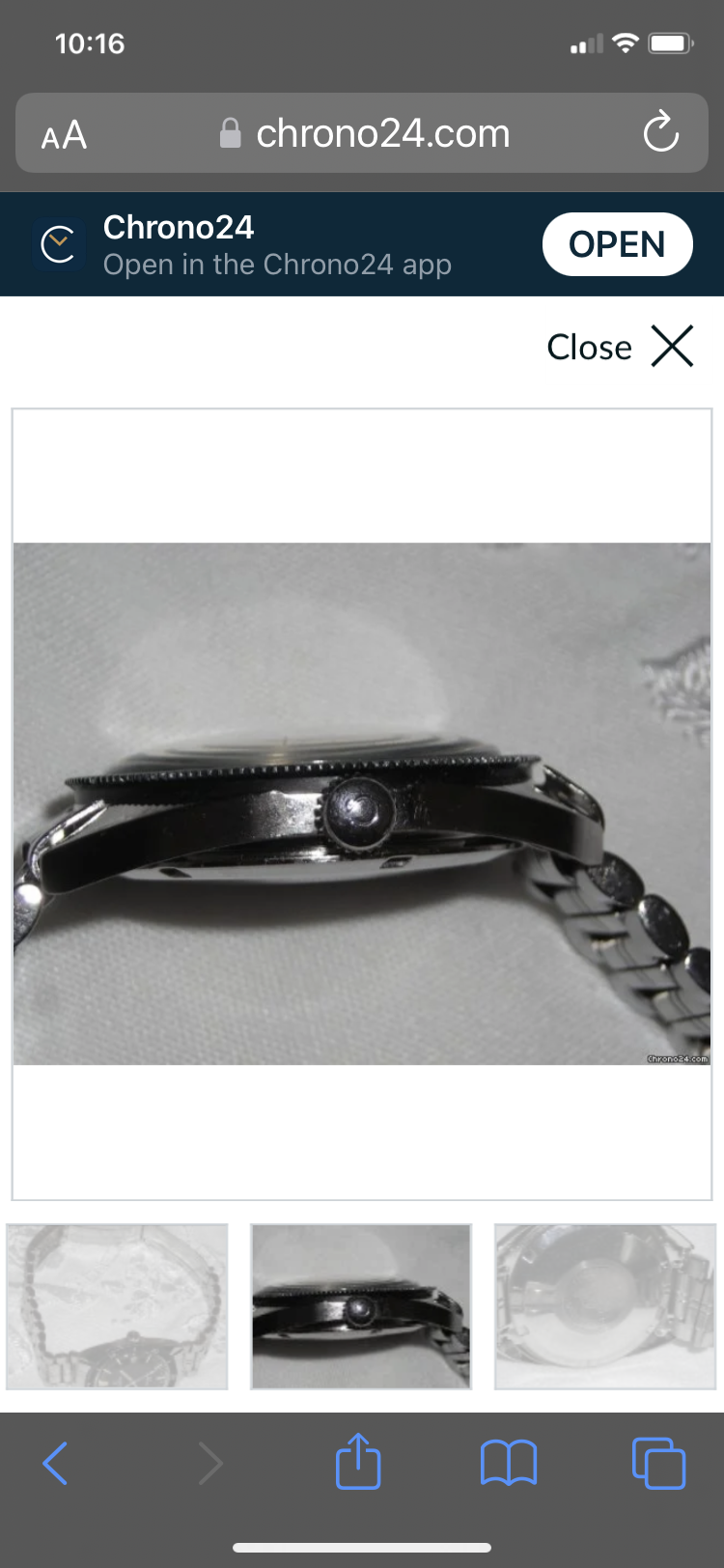

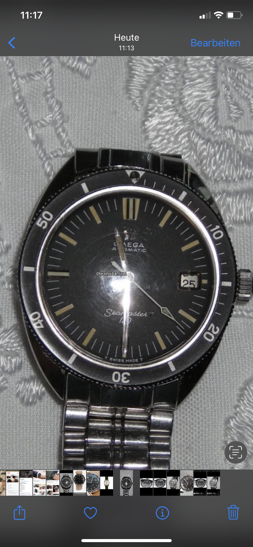

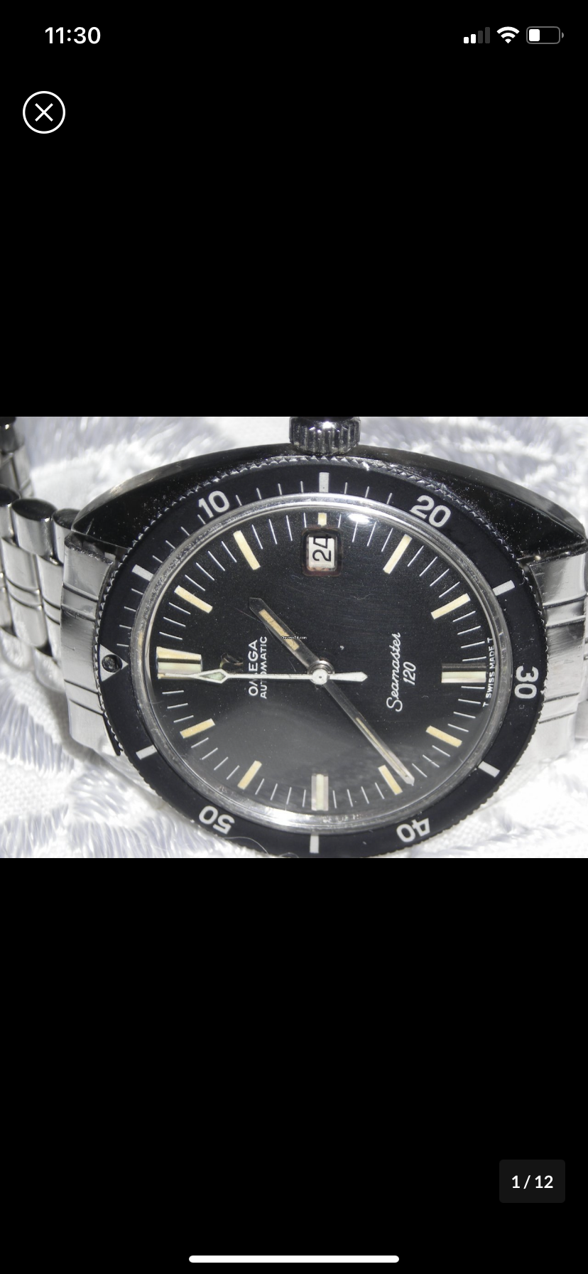

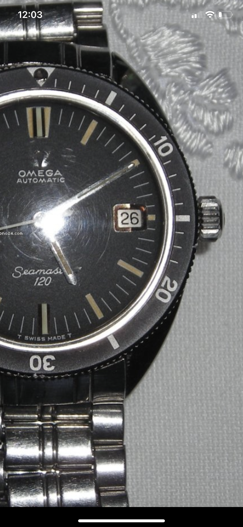

Dear Forum, I would please need your help…
I have read all the comments on this thread and am searching for a Seamaster 120.
i have found the following and am in negotiation. Please tell me what you think !!
It has the 144 teeth on the bezel and the right font and size to my eyes. Also the case is original I think. The seconds hand is obviously not.
The owner says it has been kept in excellent condition still the bezel is almost to perfect.
What do you think? Am I missing the obvious ?
Thanks so much in advance!
499
749

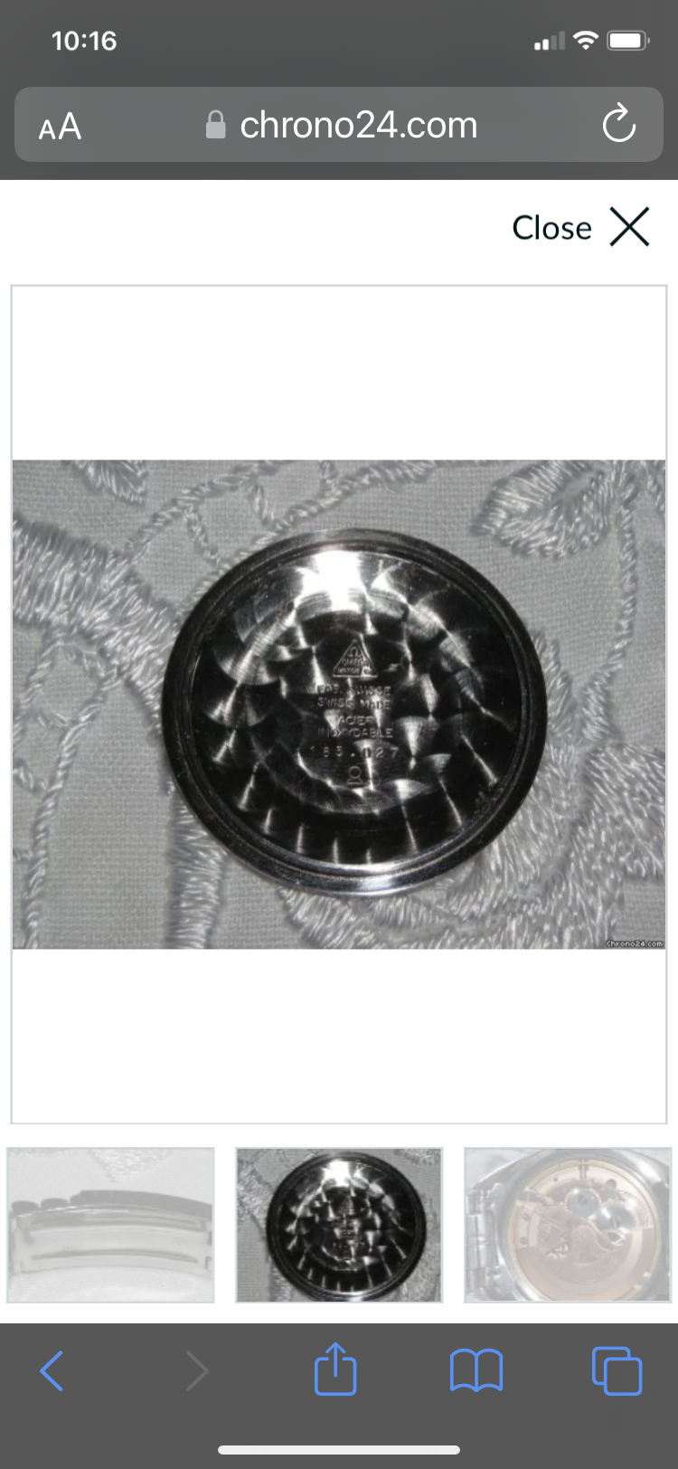

What is the reference number engraved in the case back ;-))
3,689
18,156
the seconds sweep hand is either from a seamaster 300 or from a 1960's speedmaster , i have seen some 120's were watch makers have used these as a replacement ... minus more details like case ref number inside the case back, photo of the movement it, the watch seem ok
16,305
45,025
Watch look fine to me. Even has the bracelet which Is a big bonus (but I would want to verify size). Asking price at €2.35k isn’t bad actually considering what fake and cobbled ones have been going for. Obviously it will need a service so factor that into the cost as well.
Edit- endlinks aren’t omega factory. They are JB Champion. JBC made the bracelet for Omega, but it should have stamped factory endlinks
Edit-edit, the endlinks are actually totally wrong for the watch and look to have been fashioned to fit the bracelet- so subtract the value of the bracelet from the watch entirely- endlinks are not correct.
499
749
I already saw the photos James but I was trying to give Samuel a hint ;-))
