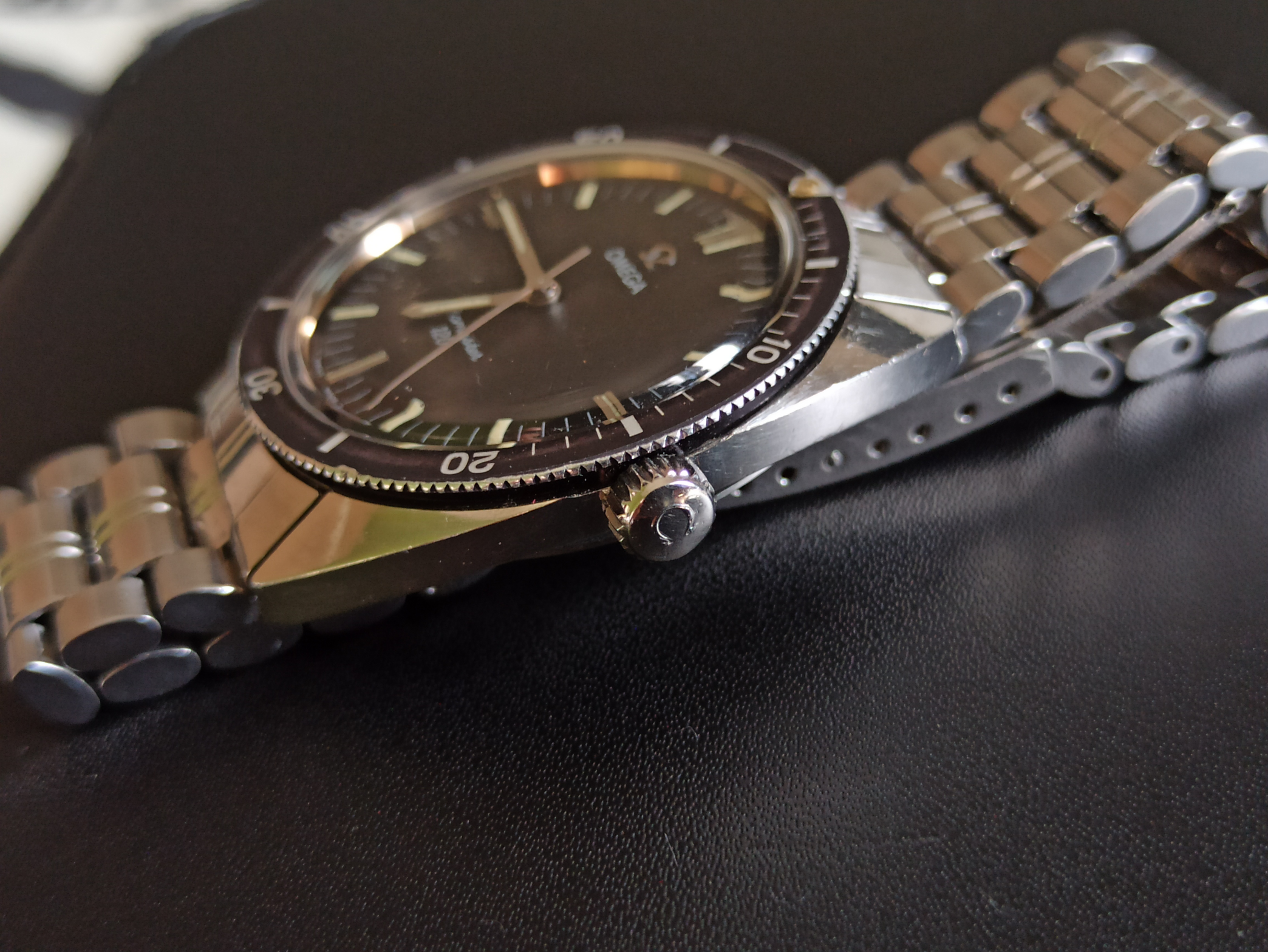

I got referred to this thread, trying to look for a Seamaster 120. I was told the watch below was not correct - based on what?
What I can think of is that the Omega logo and text should be switched around and the fact that the engraving is too thick. I'm not sure about the bezel. It looks too perfect to be true, but I also don't find it very glossy. What do you think? Anything else that is incorrect?
STAY AWAY FROM THIS, DO NOT PURCHASE
13,555
23,503
It’s all wrong, but it’s most prevalent on the dial and bezel.
These are known fakes and have been discussed various times in this thread. There’s a lot to go at but give it a read and you’ll start to get a good understanding. It’s necessarily reading for anyone looking for a 120.

Thanks everyone- don't worry I won't buy, was trying to understand everything that's wrong about it. I was curious what part of the bezel was wrong, but will read through more of the pages to understand
13,555
23,503
As a starting point;
Bezel - look at the pip.
Dial - Seanaster
103
96
Dial - Seanaster
Seanaster vs. Seamaster is usually the first thing I look for on these.

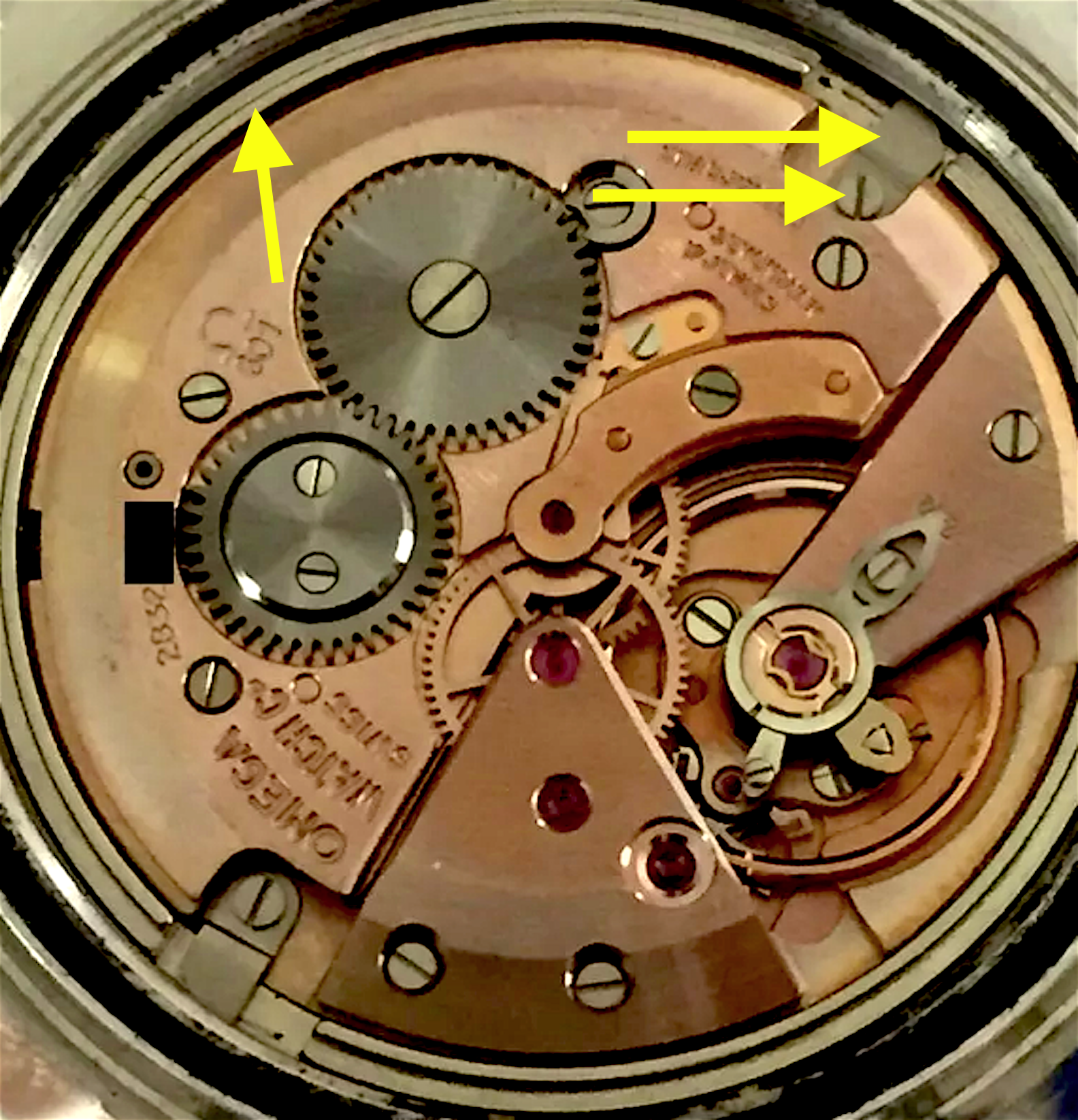

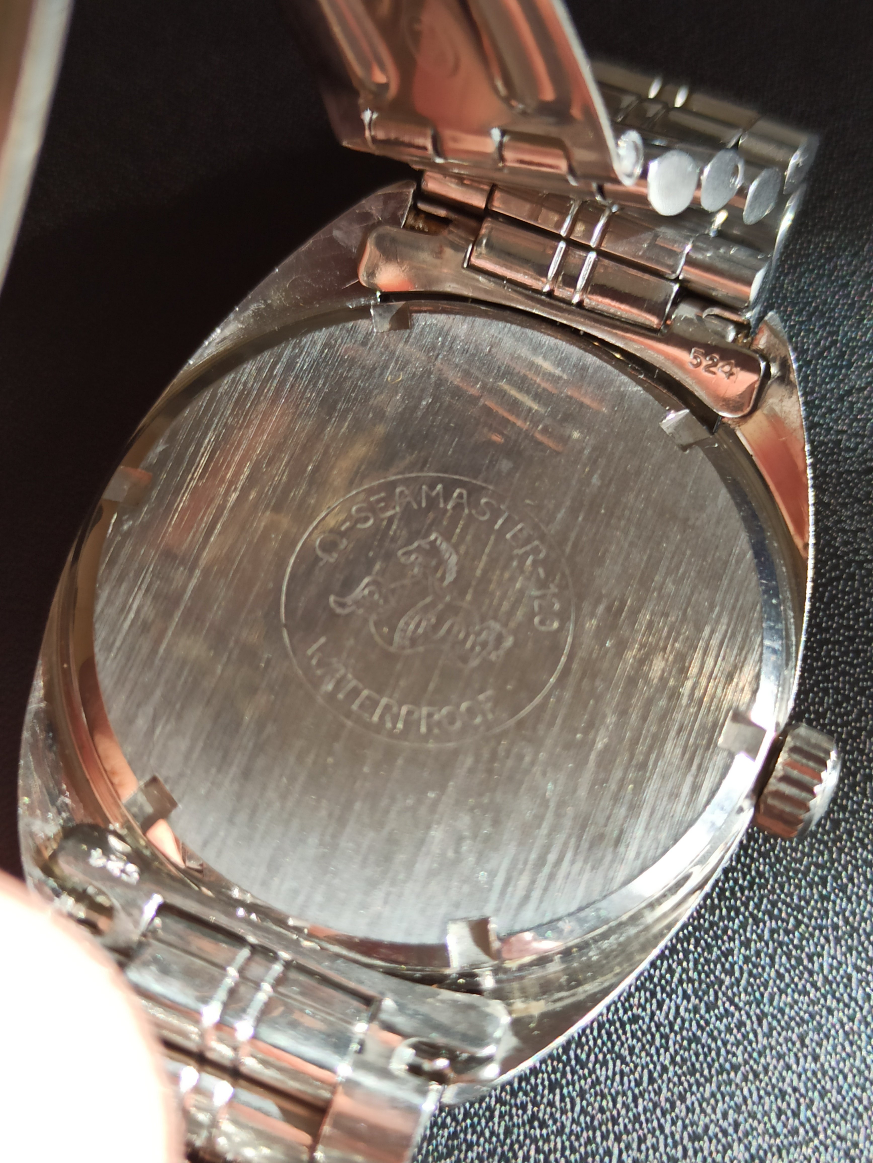

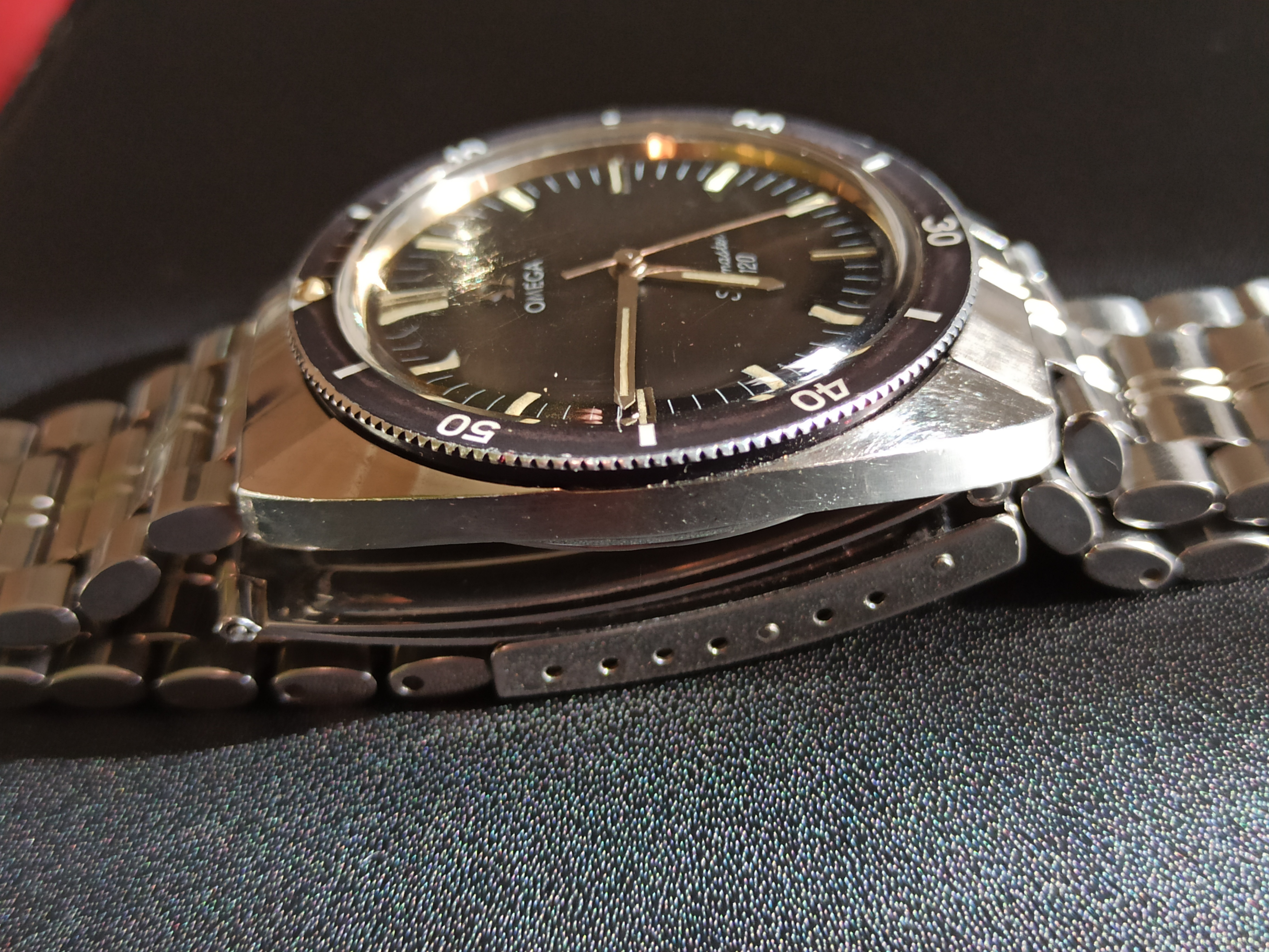

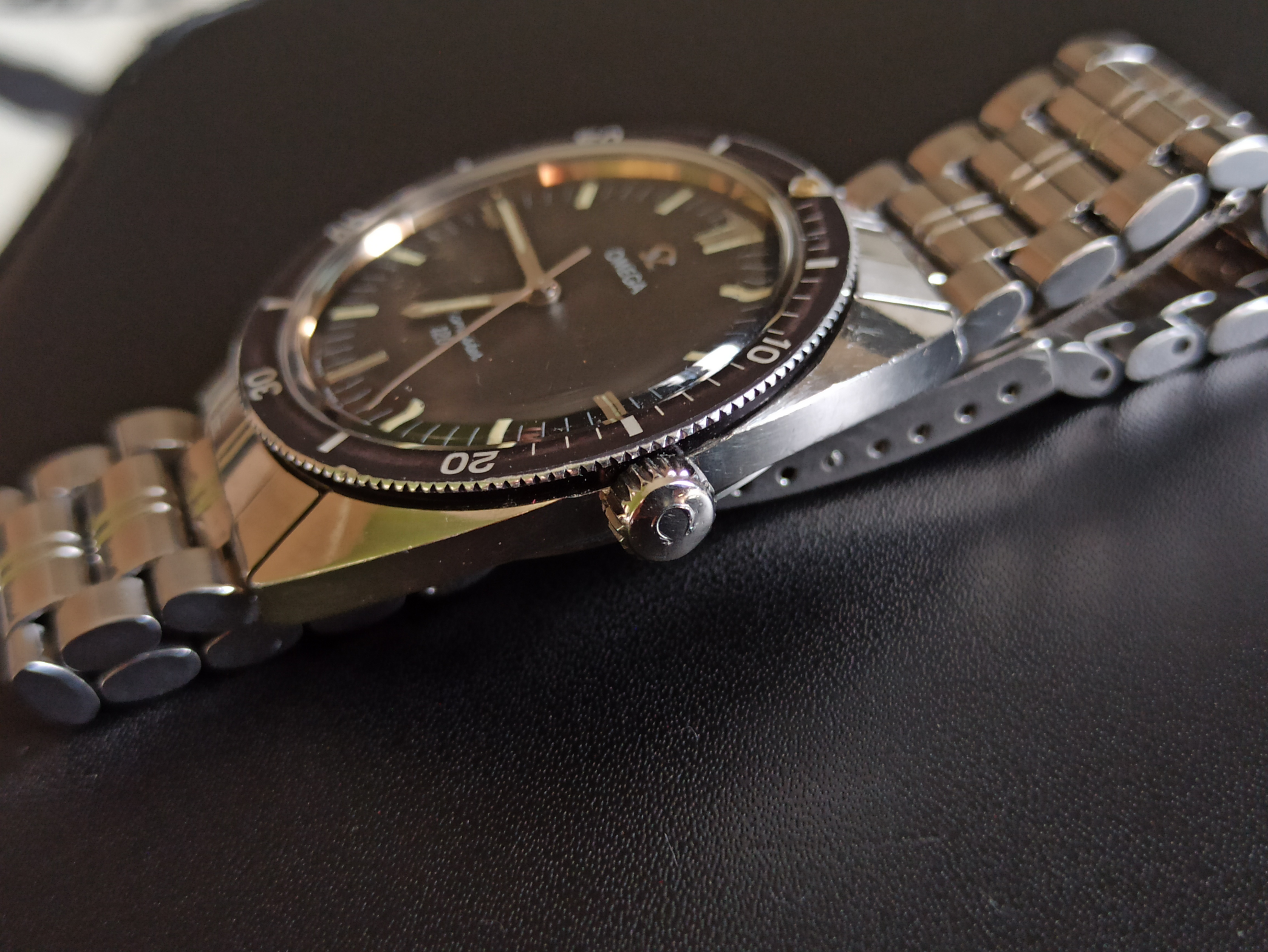

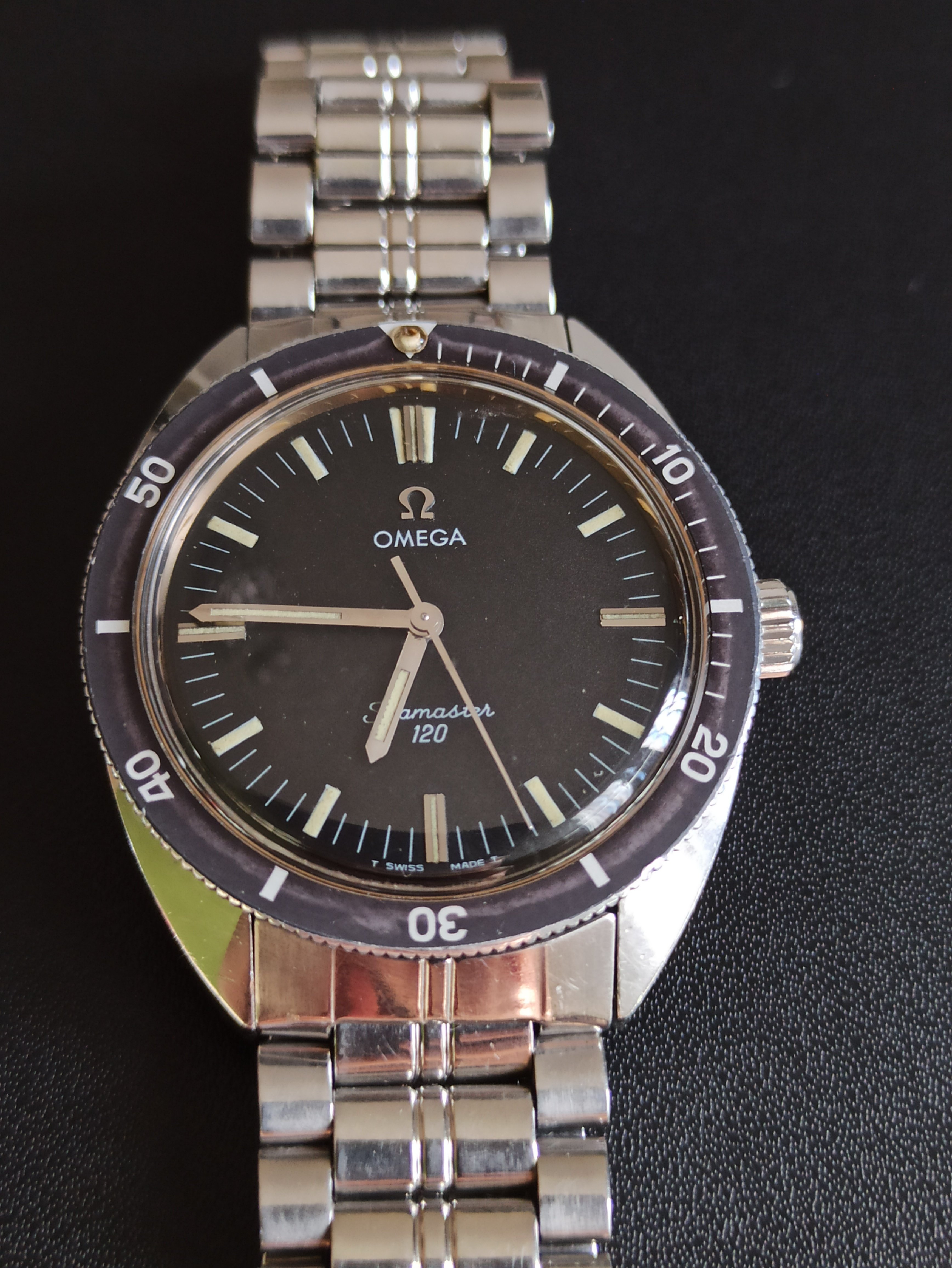

I've been going further, and now came across this model, listed by a private seller who claims it's from his family and all original. I've been examining the pictures, my only doubt was the seconds hand, but I've read another thread where it was said this was quite common and perhaps service replacement.
Also I'm seriously considering to bid for it, but with so many fakes I'm not sure what's a fair value. Watch has been serviced a couple of years back, but no proof. Appears to be running accurately. Listing price is 2500 but that to me feels way out of hand. Thanks in advance for your advice!

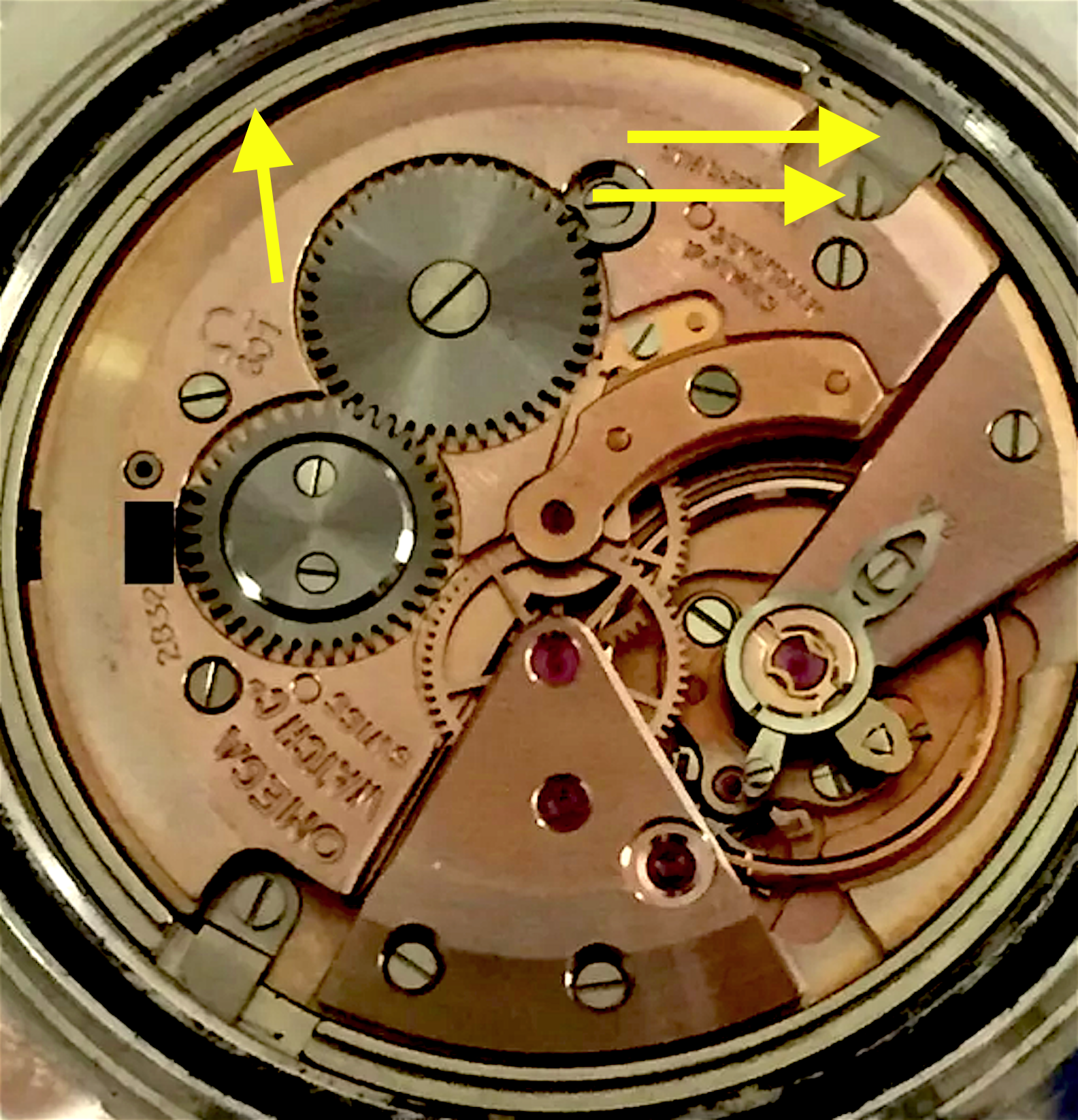

Missing case clamps and screws?
16,305
45,025
Good spot! I would ask the seller if he is aware that the clamps and screws are missing - perhaps he pulled the movement out when taking pics (why I don’t know) and hadn’t put it back together yet.
Otherwise it looks good to me. Considering it comes with the factory bracelet and correct endlinks, with original bezel and pip, and nice dial with good looking lume- $2.5k is very reasonable these days.

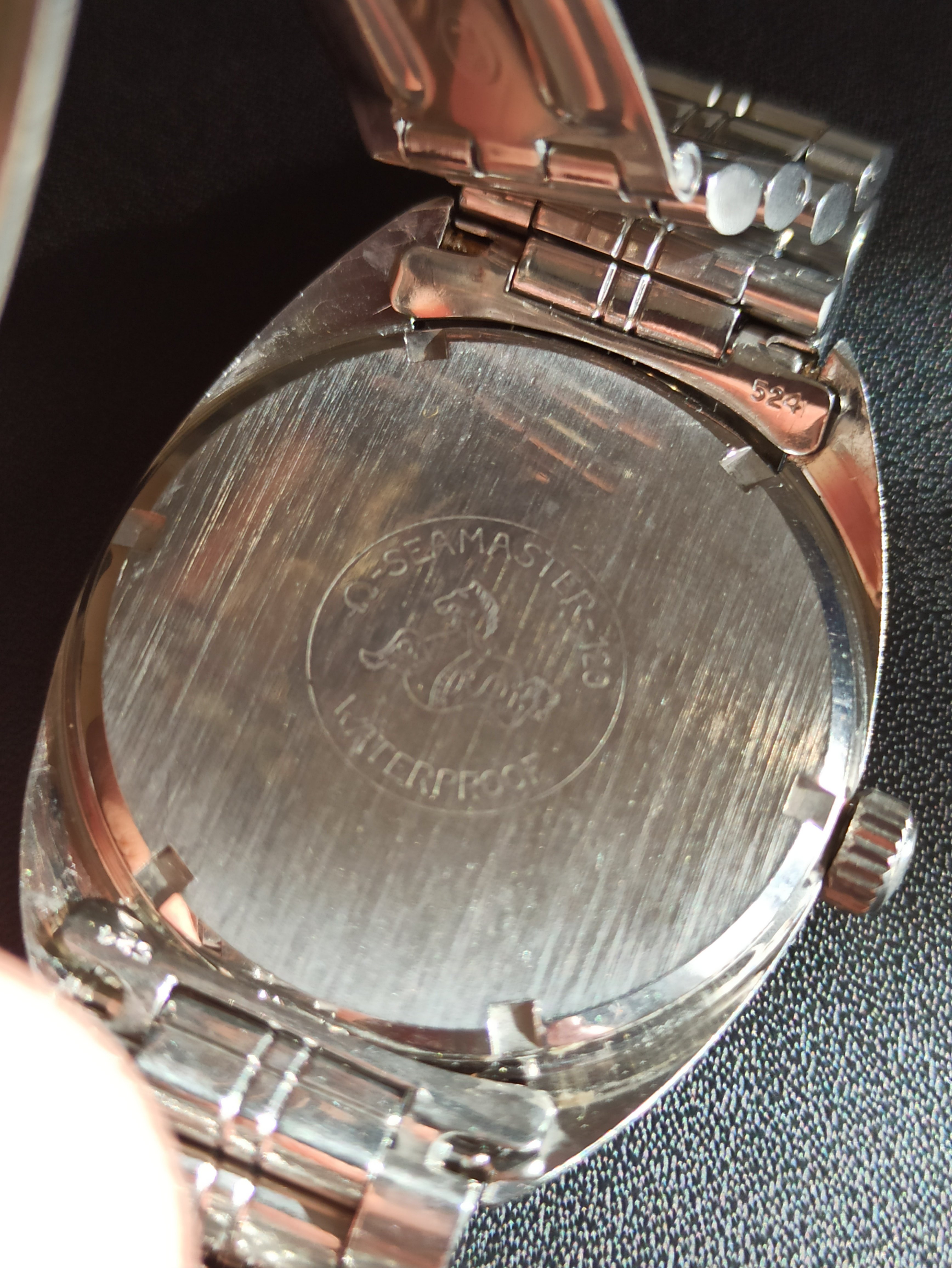

In case they do end up missing - is that an easy replacement part to find?
16,305
45,025
I would ask the seller first- he isn’t a novice with watches, the quality of his images, the fact that he got the back off and the travel case he has the watch resting on speaks to that
1,615
3,862
Not too hard, but I don't like it. What else is wrong if it is missing obvious parts? So if you buy it, factor in some service and parts.

watch looks correct but as mentioned above missing parts to secure the movement
529
819
Oh it's even this outer ring which is missing, hadn't seen that. The seller doesn't know why it is missing, he didn't remove it himself, and it only went for service a couple of years back. Hmmm.. feels tricky.
possible his watch maker neglected to replace the parts

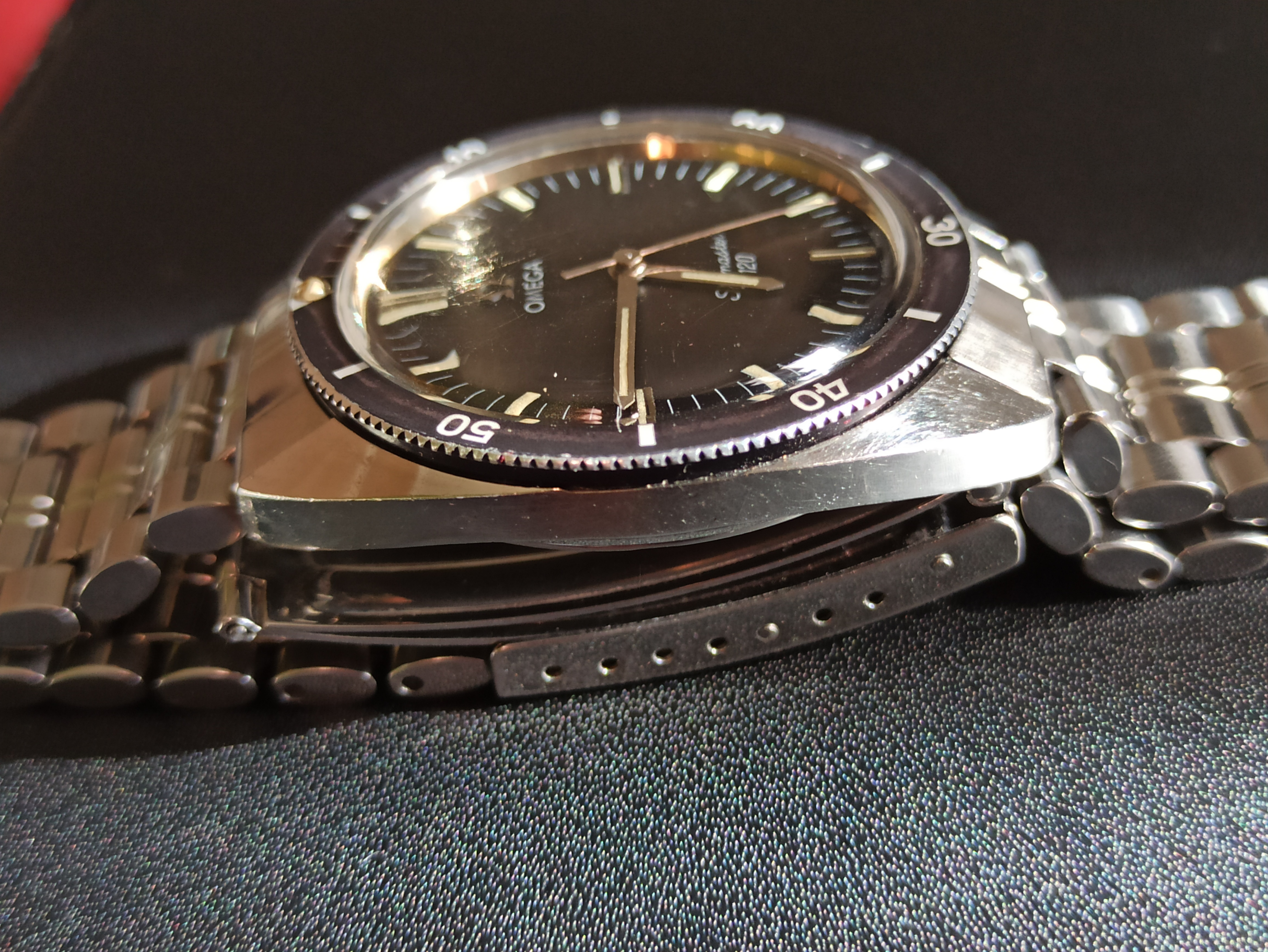

And this is a 601, fitted in the seamaster 120?
3,689
18,156
2 manual wind versions for this watch
NO DATE ... case ref# 135.027 ... Cal. 601
DATE WINDOW ... case ref# 136.027 ... Cal. 613

Sorry I meant to ask - the picture that you shared, is that of an actual seamaster 120?

The movement retaining ring is absolutely not easy to find. A few years ago I had one with a heavily damaged ring and several watchmakers said they couldn’t help. After scouring various sources for months I eventually called Swiss time services who thankfully had one.
Point is, you’ll likely need a full service from an Omega authorised watchmaker to get this piece.
