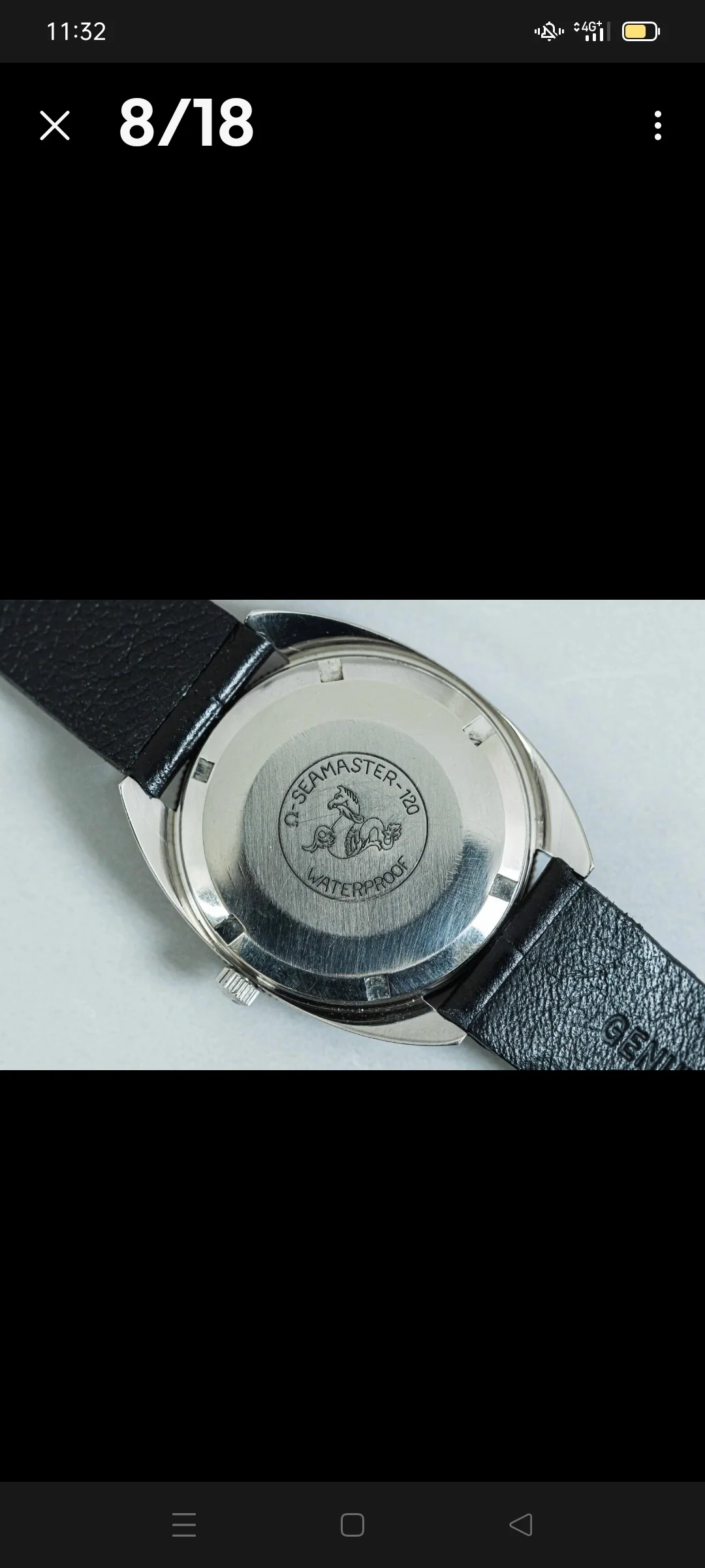

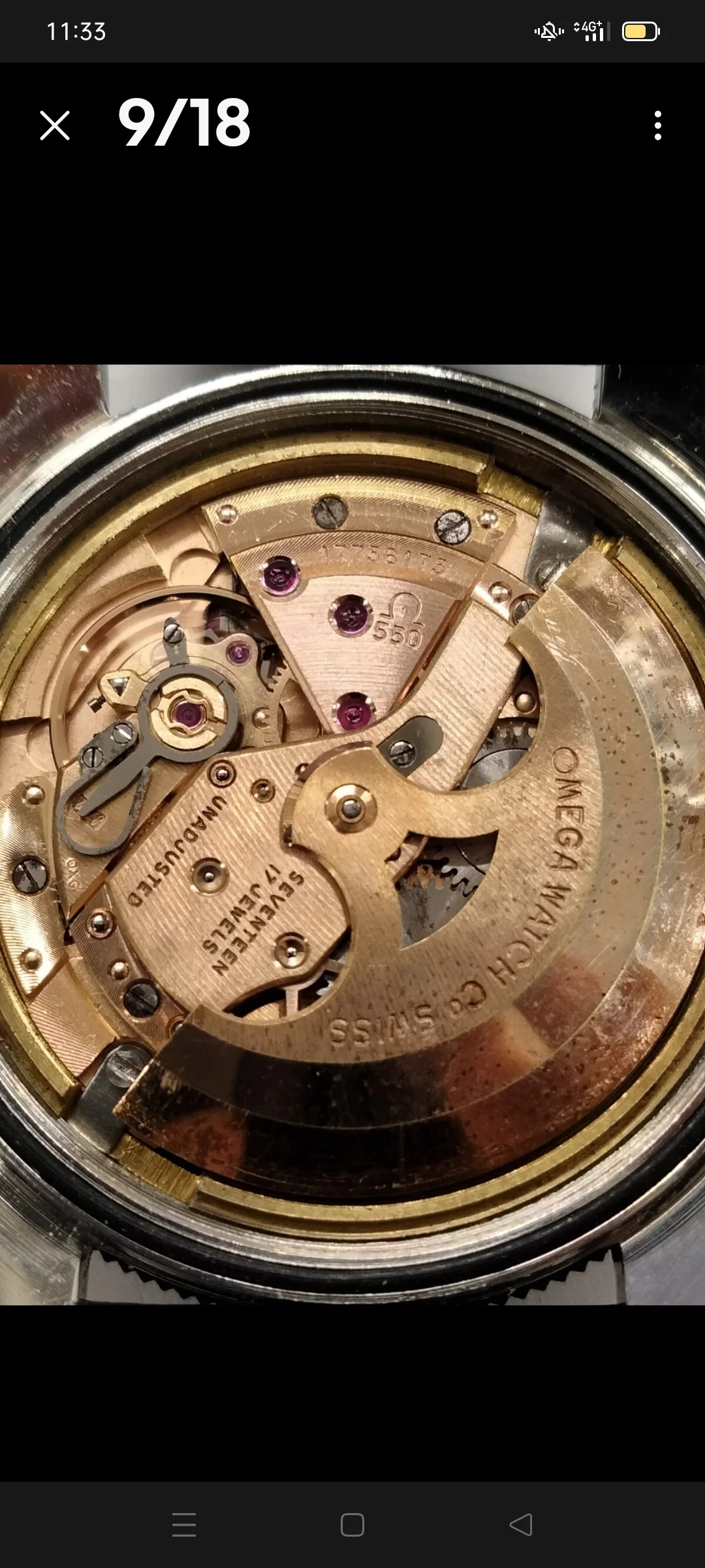

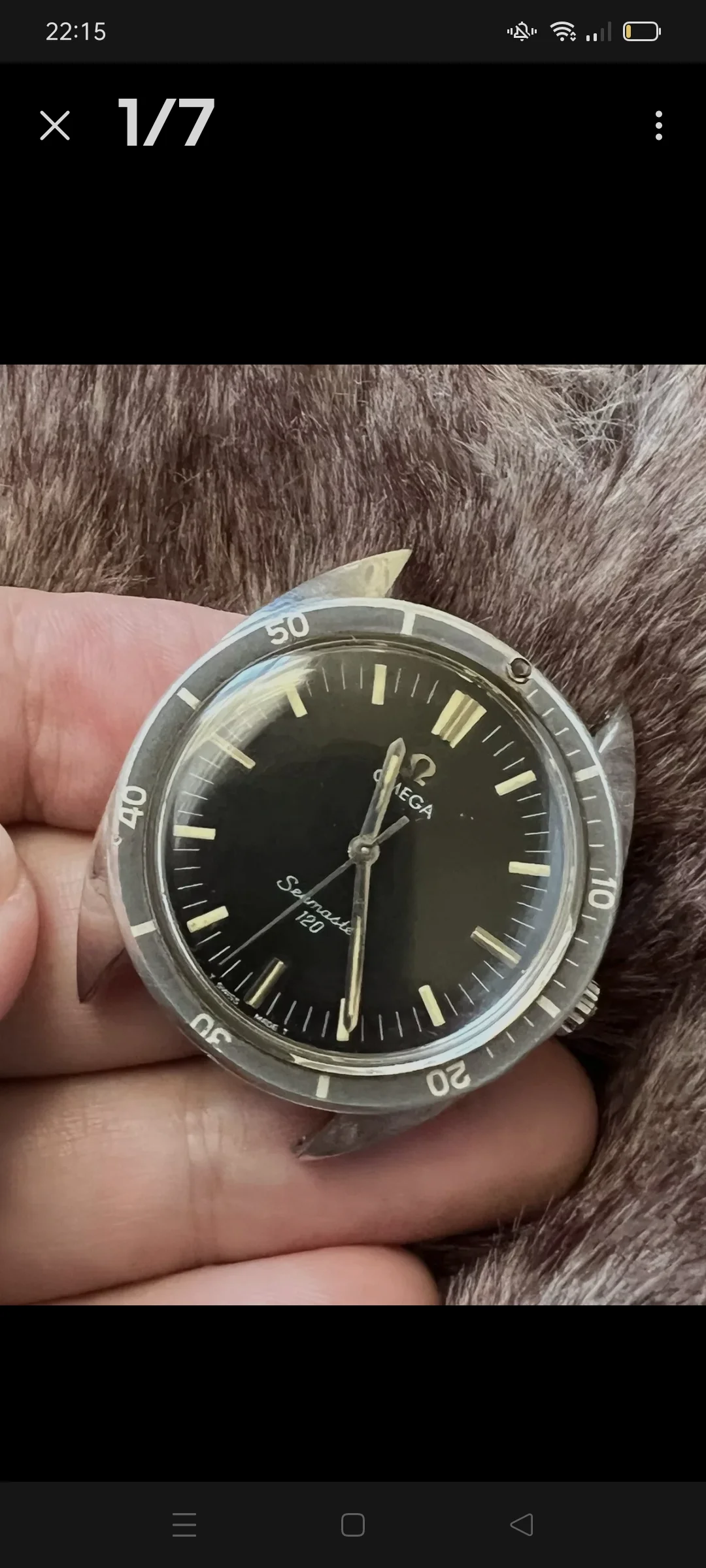

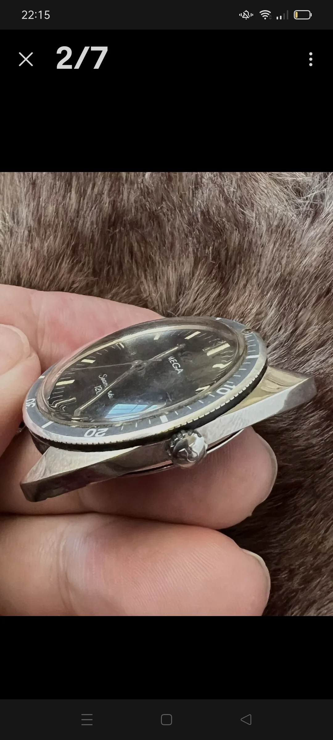

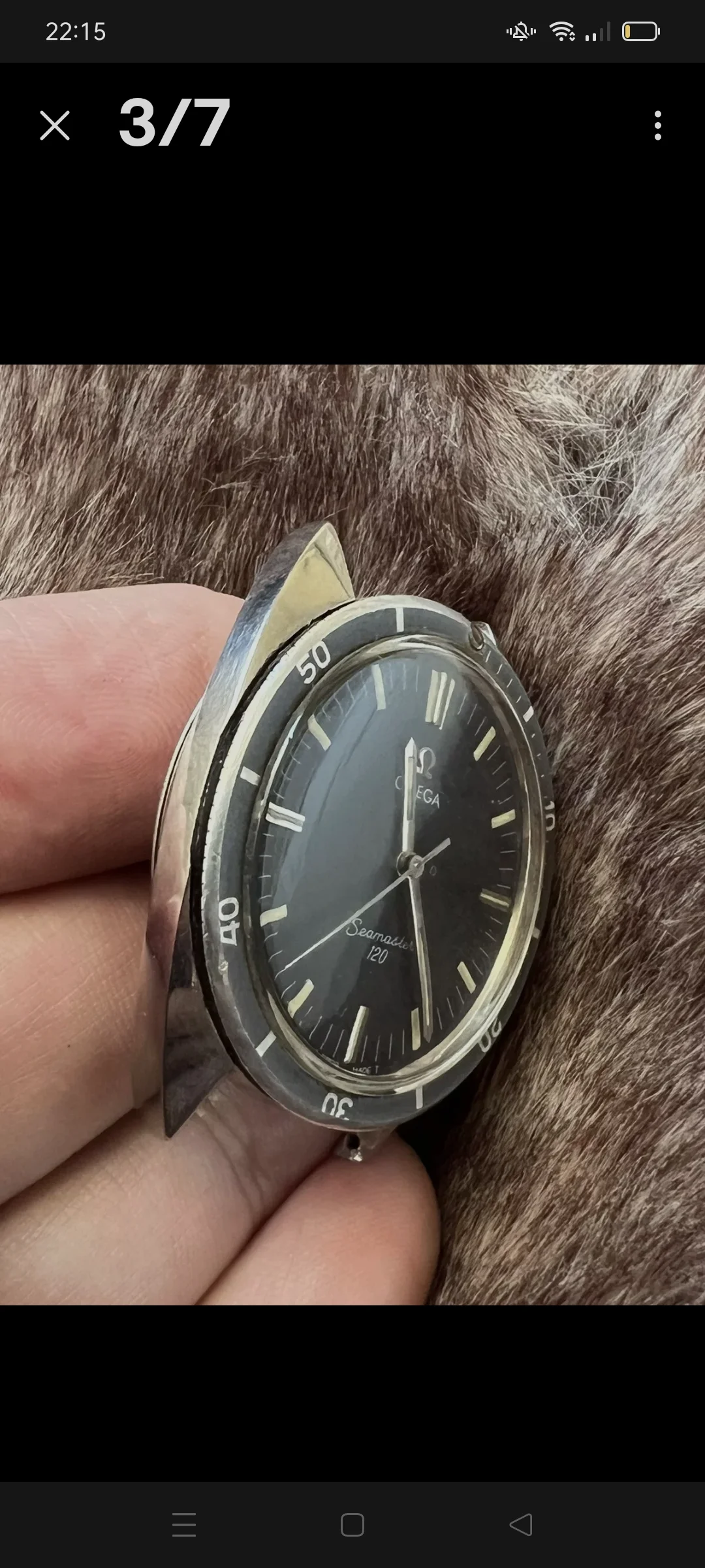

Hi, can someone help me? I'm trying to get better at spotting fakes! In my opinion, the bezel, case, and crown are fake here. But the caseback and dial seem original? The movement isn't a 552, but I've read that the 550 was used on some models—is that true? Anyway, the serial number (17xxxxxx) seems a bit low for a late 1960s model, doesn't it? Thanks a lot for your answers!

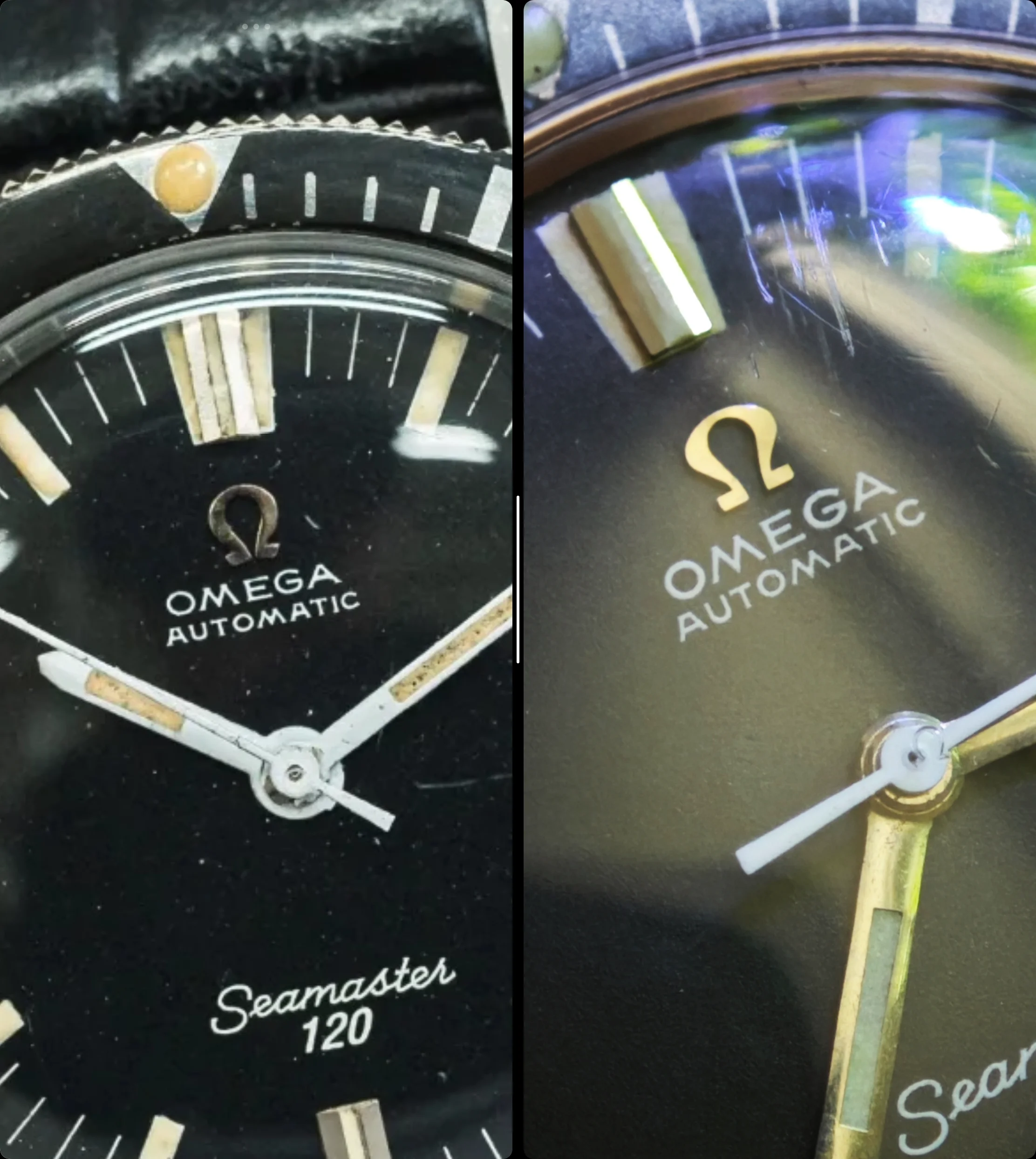

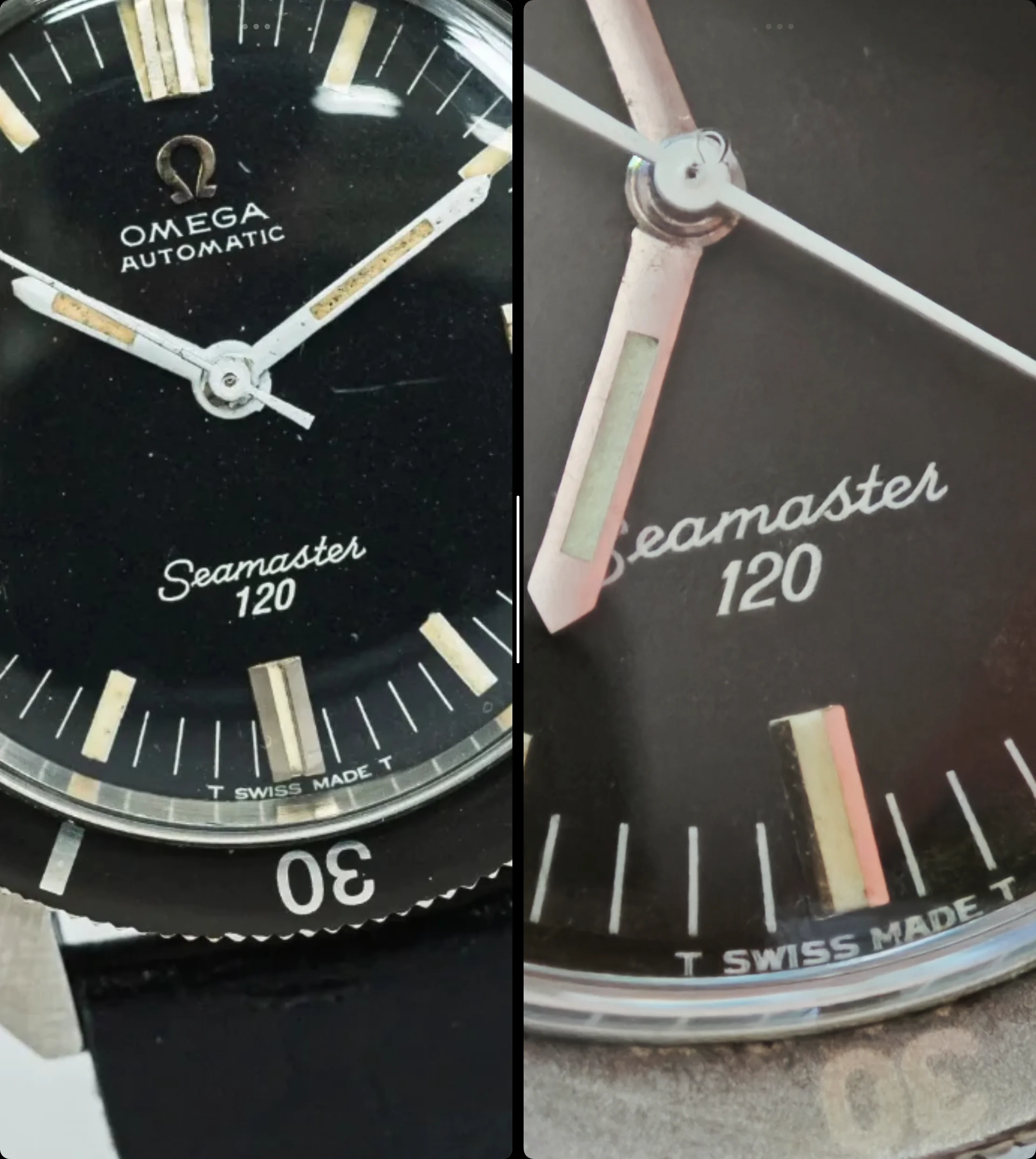

@vb dial is also not original, based on how 120 is written.
Compare the dials, I see lots of differences. Mine is on the right.
Well the case, caseback and bezel are certainly fake. The dial isn’t the typical fake dial we usually see but it does have issues so there’s a high likelihood it’s fake as well. Ultimately it doesn’t matter as so much of the watch is fake it’s a definite pass.

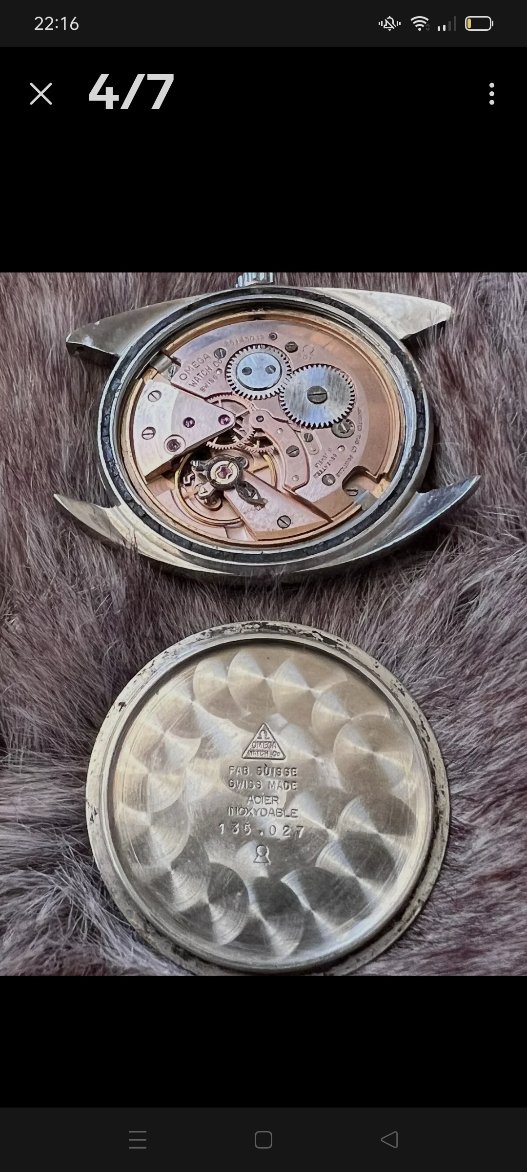

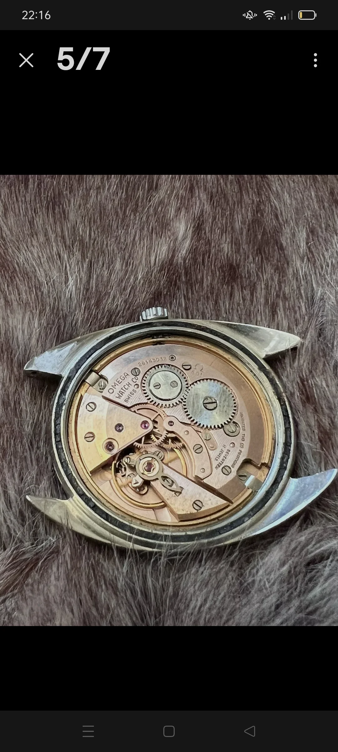

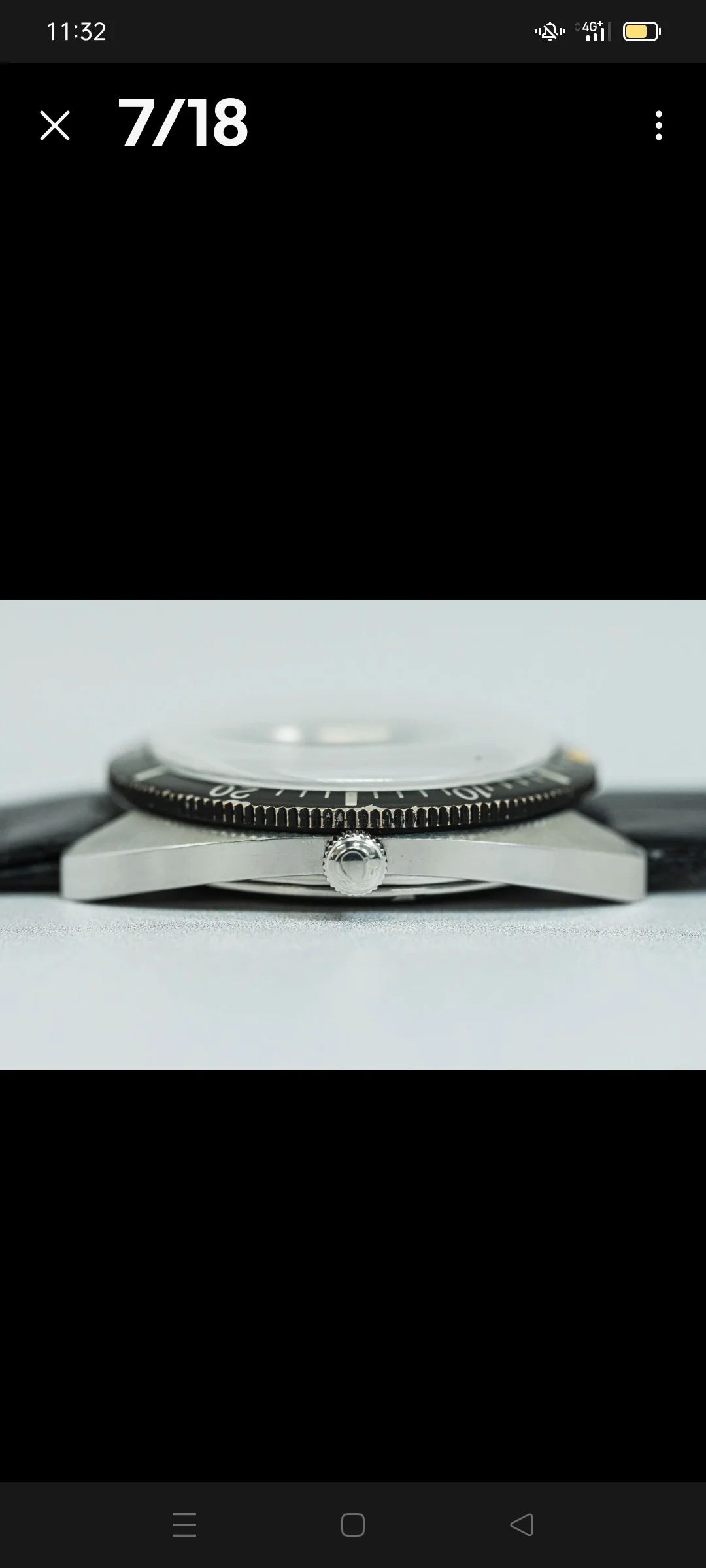

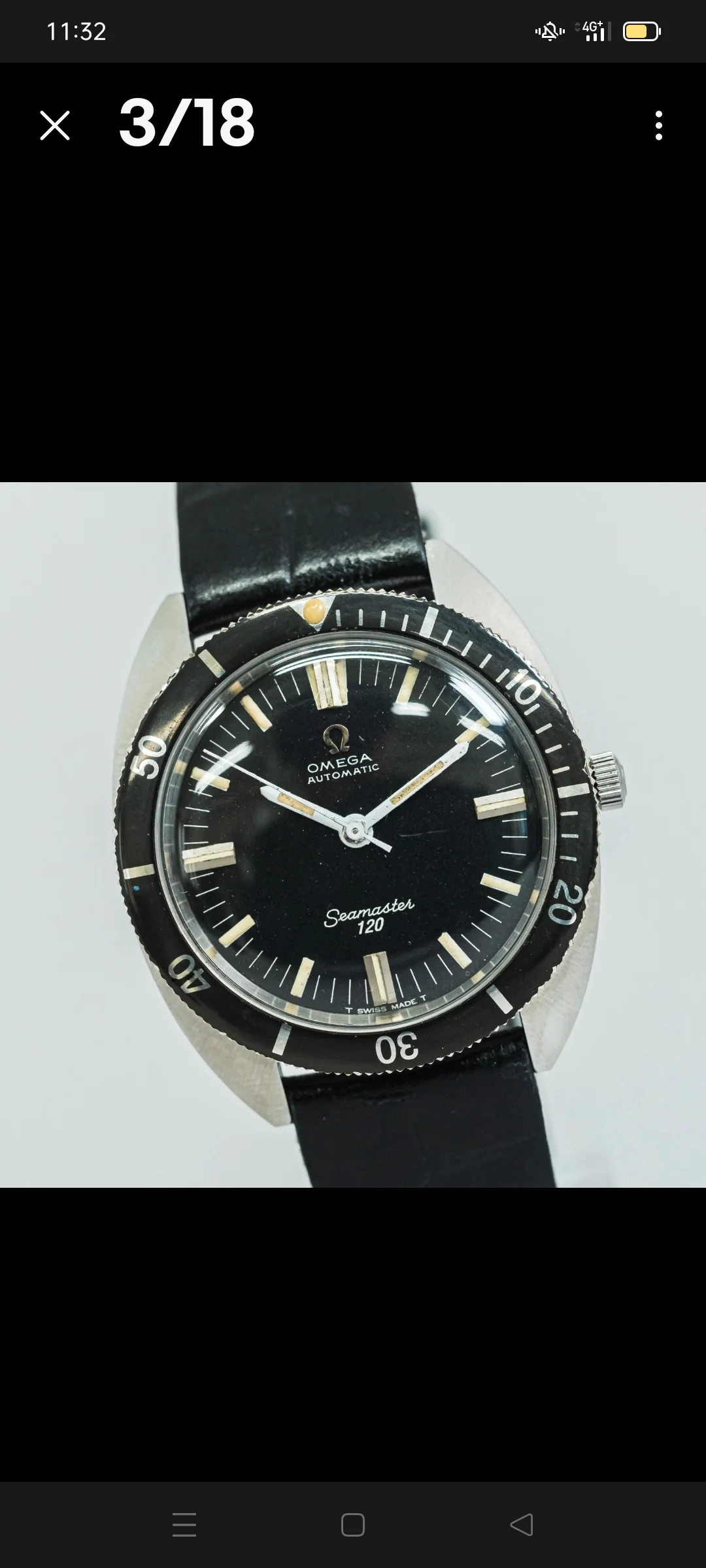

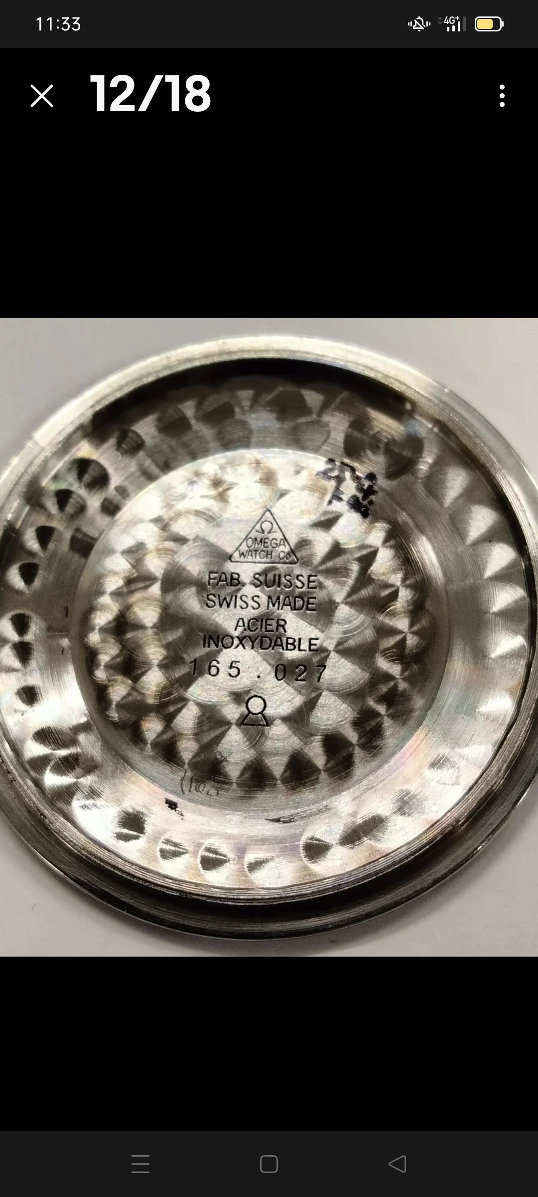

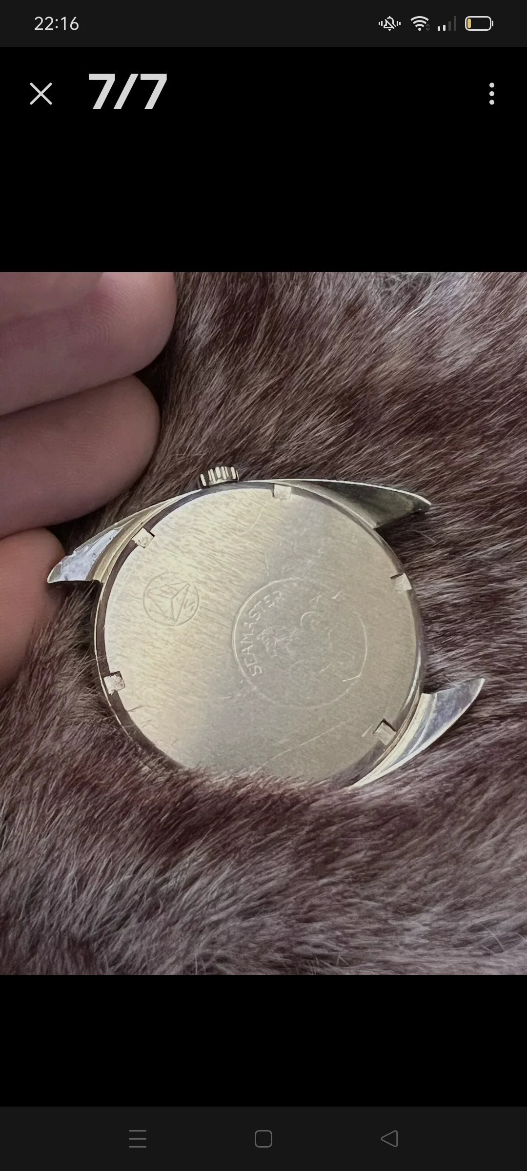

Hello, sorry for all these posts ! Found this one and it's look legit to me but i really need a feedback before go ahead! Thank you

Ah, the no-date. Cool one. I think the crown is off, bezel and dial look legit but the photos are not that crisp. Never seen that case back, my case back looks different then this one.

Suspect caseback. Incorrect crown. Bezel is way worn down.

And when I zoom in at the dial, I'm not positive. Strange font.
Have you got an eBay link. The pictures are poor but in first glance it looks ok with the exception of the caseback but I’d like to see the original pictures.
It looks ok but smells fishy is perhaps a better way of putting it.

Hello, here the link https://ebay.us/m/3F6NiA

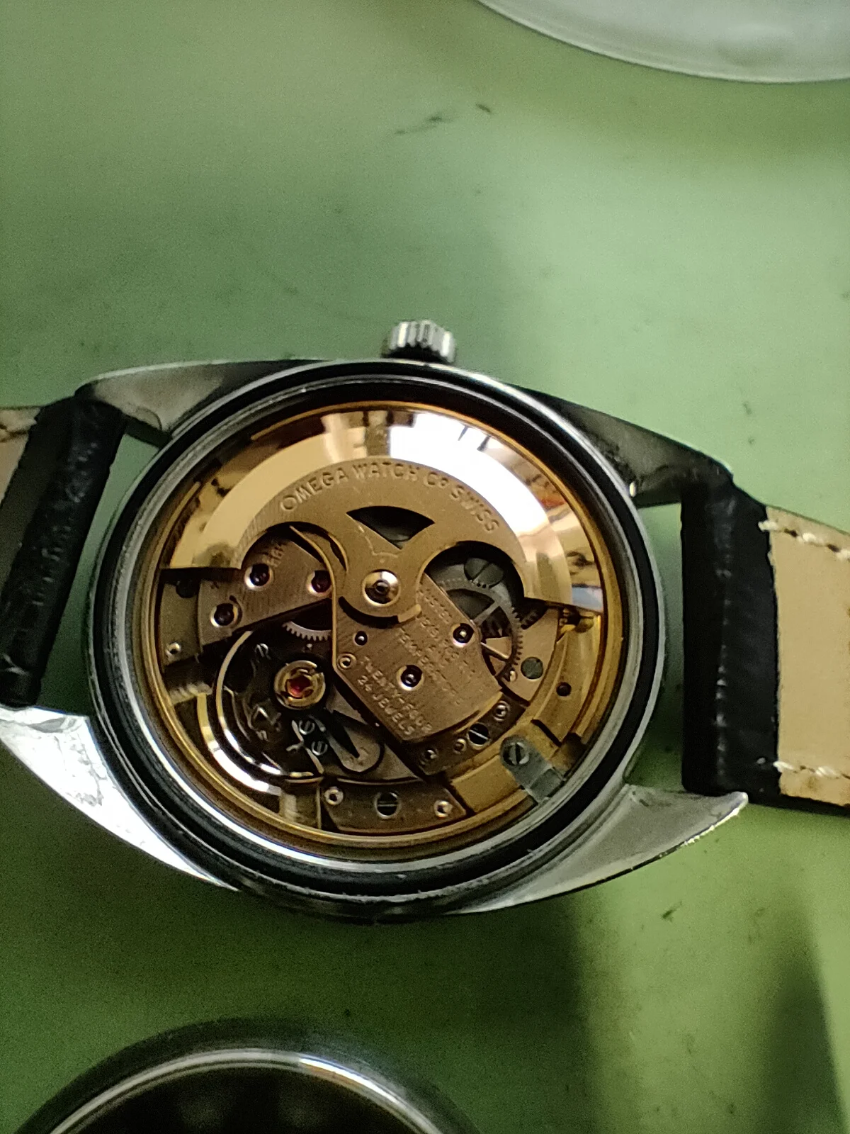

I have a question about my SM120. Bought it a couple of years ago and it had an official Omega service. This is it:
This photo show a lot of smudges and hairs, i took it under a real bright light.
These are on another bracelet (both original Omega and corresponding the watch age):
I know this watch is delivered with the 565 movement. But, mine is with the 561 movement. The watchmaker said: well, the watch is almost 60 years old, its quite possible someone just replaced the movement 50 years ago. Movements were easy to order, Omega wasn't that strict with parts back then, so maybe someone even liked the 561 more because of the COSC. We don't know. It was in there, we serviced it.
Is this a logical explanation? Or is it even possible that some 565 were equiped with the 561 movement? Its quite dull, because the quickset isnt working on the 561.

100% swapped movement. I’m pretty sure a 561 would preceed the introduction of the model age wise.
Yeah, 561 is from 1958 and 565 from 1966.
Its not possible to see if movement and cases match somewhere right? There is no serial in case and on the movement that need to match, i mean.
Well, i already assumed it was a swapped movement, this just confirms. Does a swapped movement matter?

Could also just be a swapped bridge containing the cal number, resulting from damage to the original.
Yeah, basically there is just a little difference between the 565 and 561 as a movement, right?

They’re the same base caliber but one is a chronometer and one isn’t. If you have pics it’s possible to say with more certainty whether the movement is a 565 with a 561 bridge or a full 561.

I'm pretty sure that SM120s were never originally supplied with chronometer rated movts.
As @Davidt says, it could be a swapped bridge - or an entire swapped movt.
561s don't have a quickset date, it has a 'semi-quickset' date function - i.e. through 12, back through 9, then through 12 again.
So, if it doesn't have a quickset date, as a 565 should have, it is more likely that the whole movt was replaced.
For the record, 561s, IIRC, were first released in 1959 and ran through until ~1966/7, before being replaced by 564s
