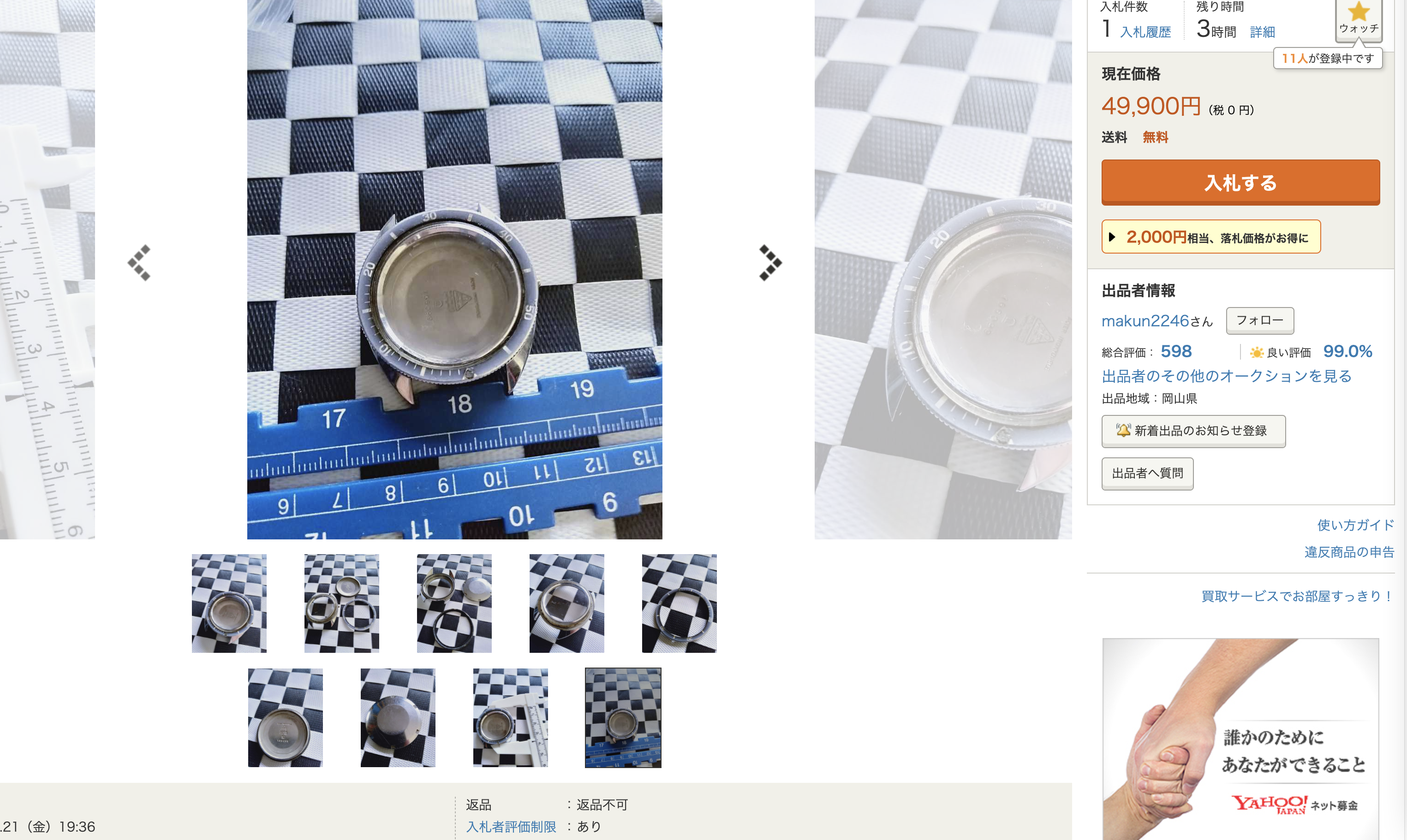

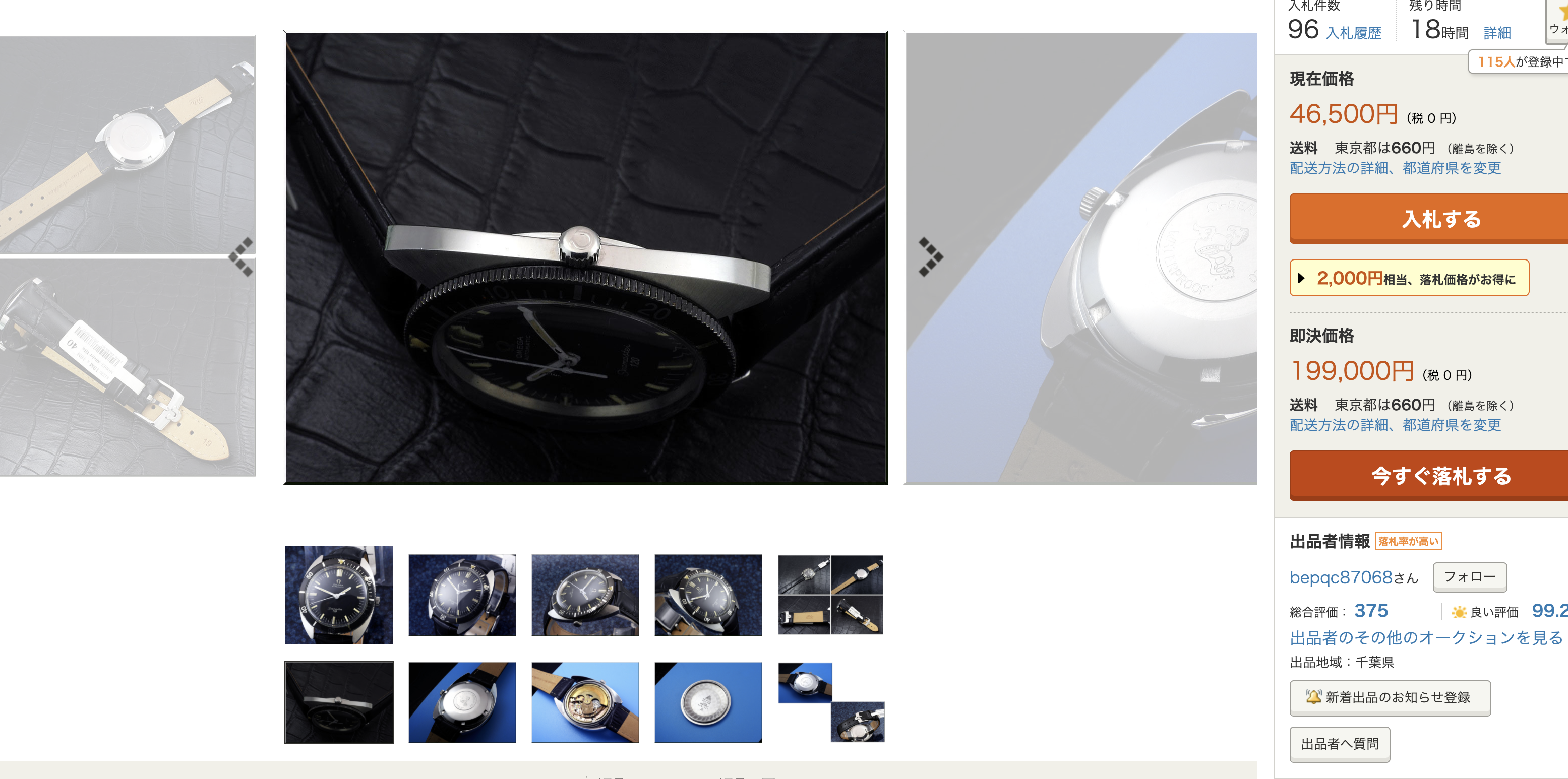

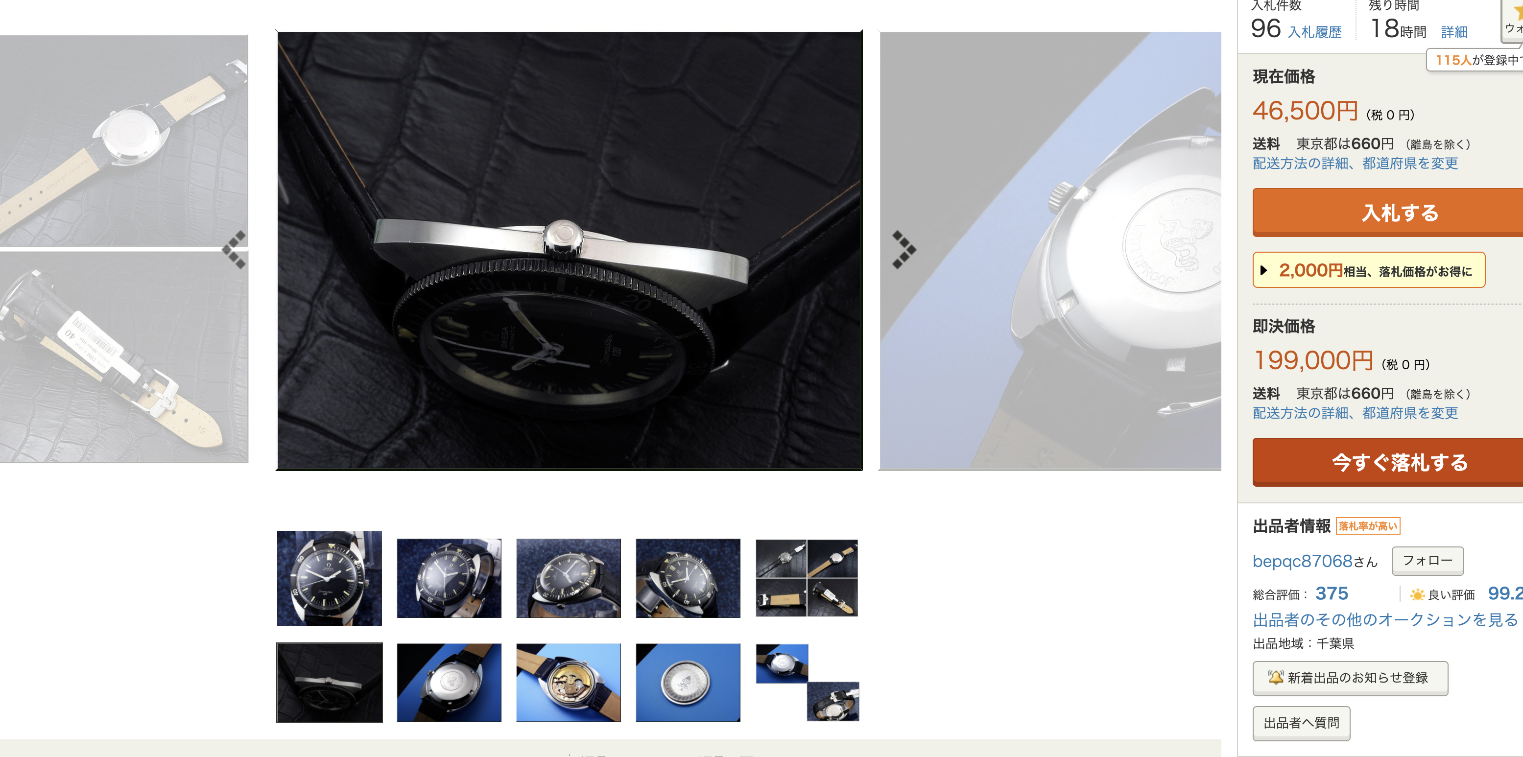

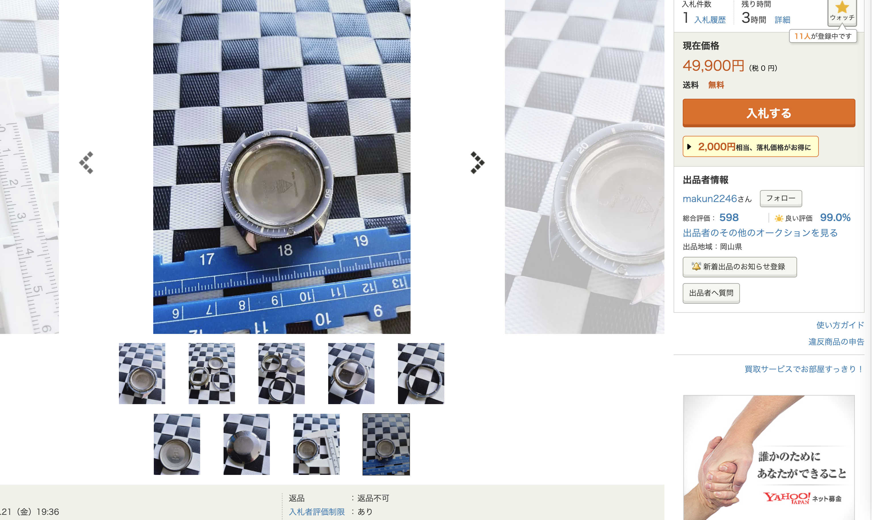

A quick warning about a recent auction in Japan
The seller bepqc87068 is a (soft) scammer, as in, he mixes authentic stuff with non-authentic stuff and hides extreme flaws and so on - the near 100% good feedback is because proxy services always leave a good review immediately
Stay away from this auction: https://page.auctions.yahoo.co.jp/jp/auction/u433370168
Even if it looked authentic, I'd say stay away 100% - but from the photos, I think the case is forged:

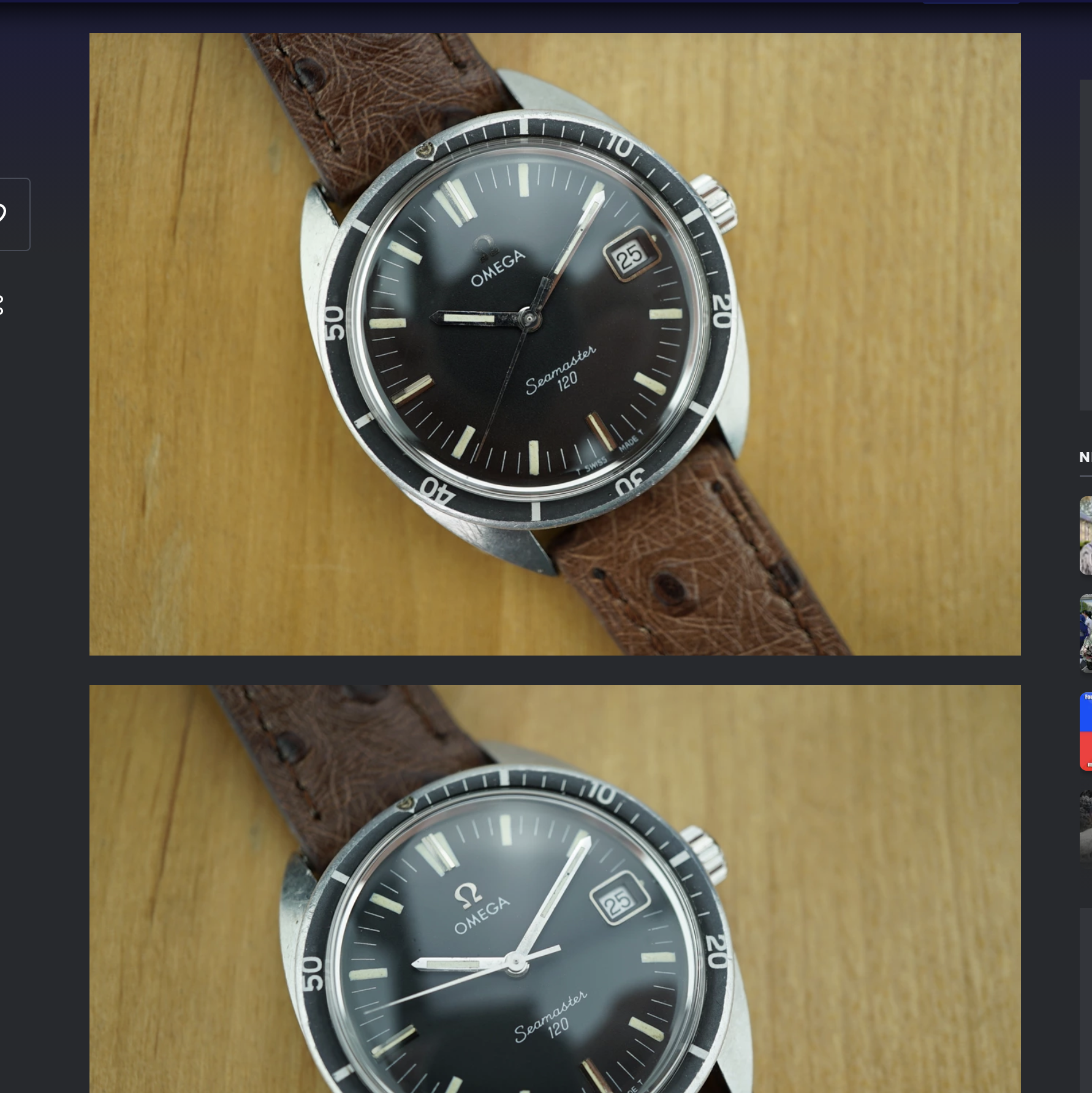

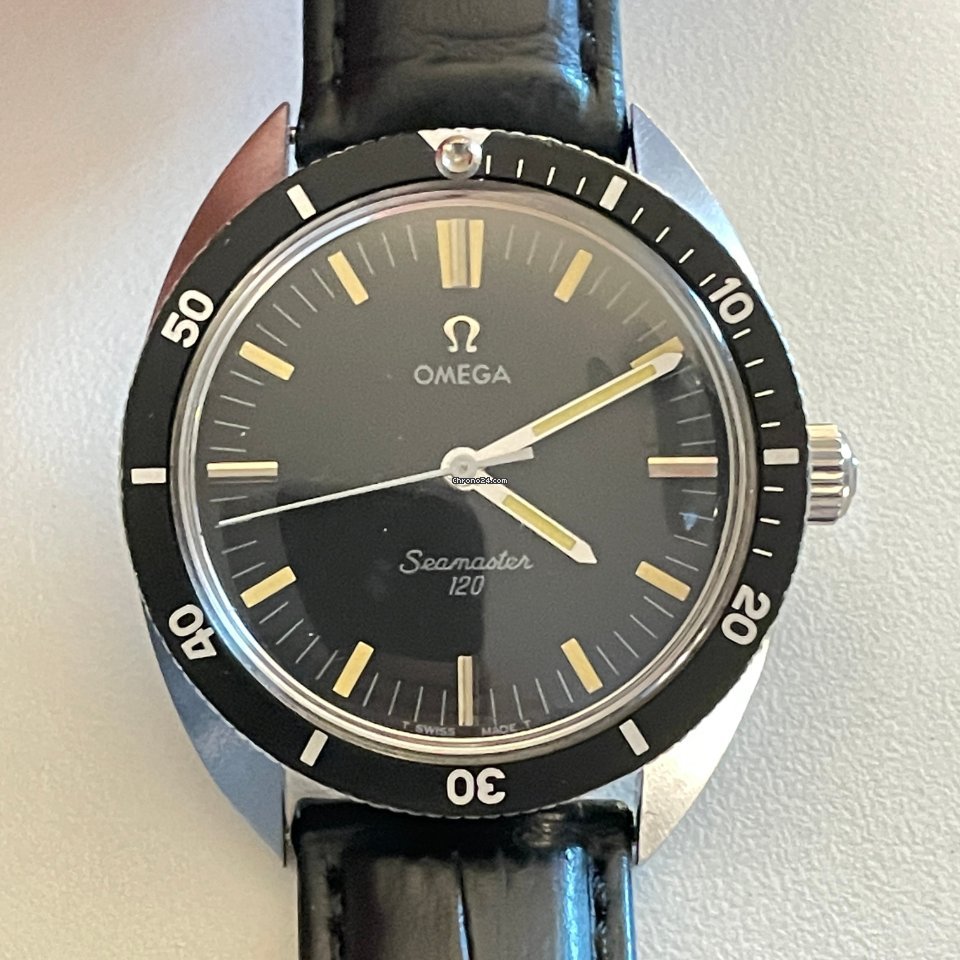

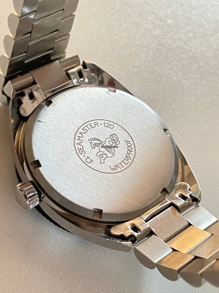

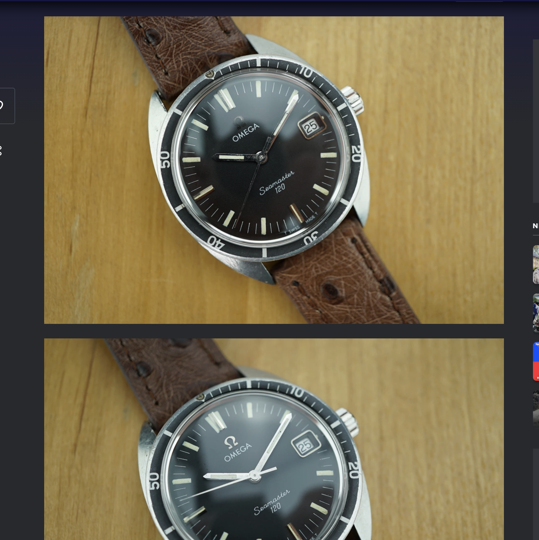

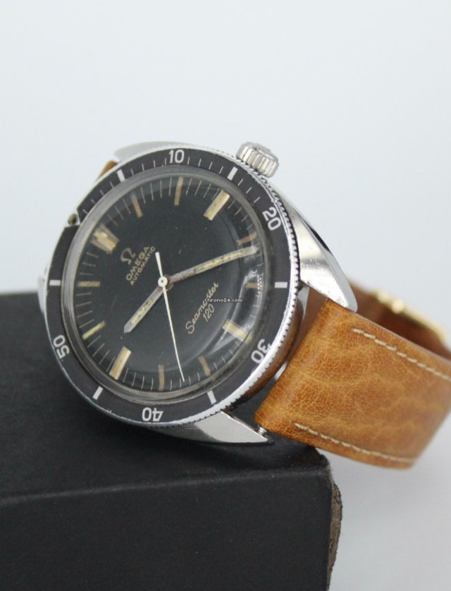

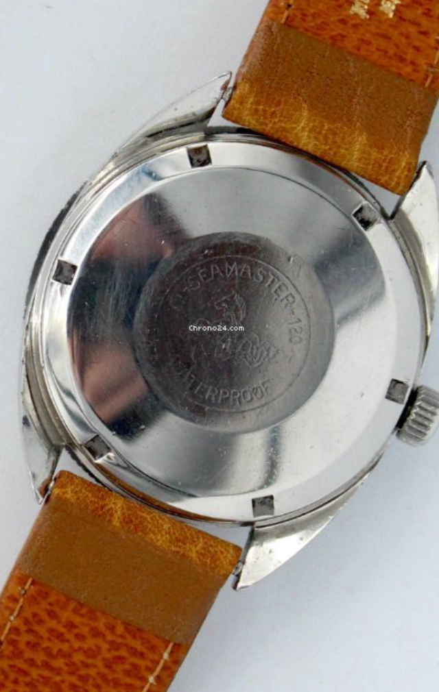

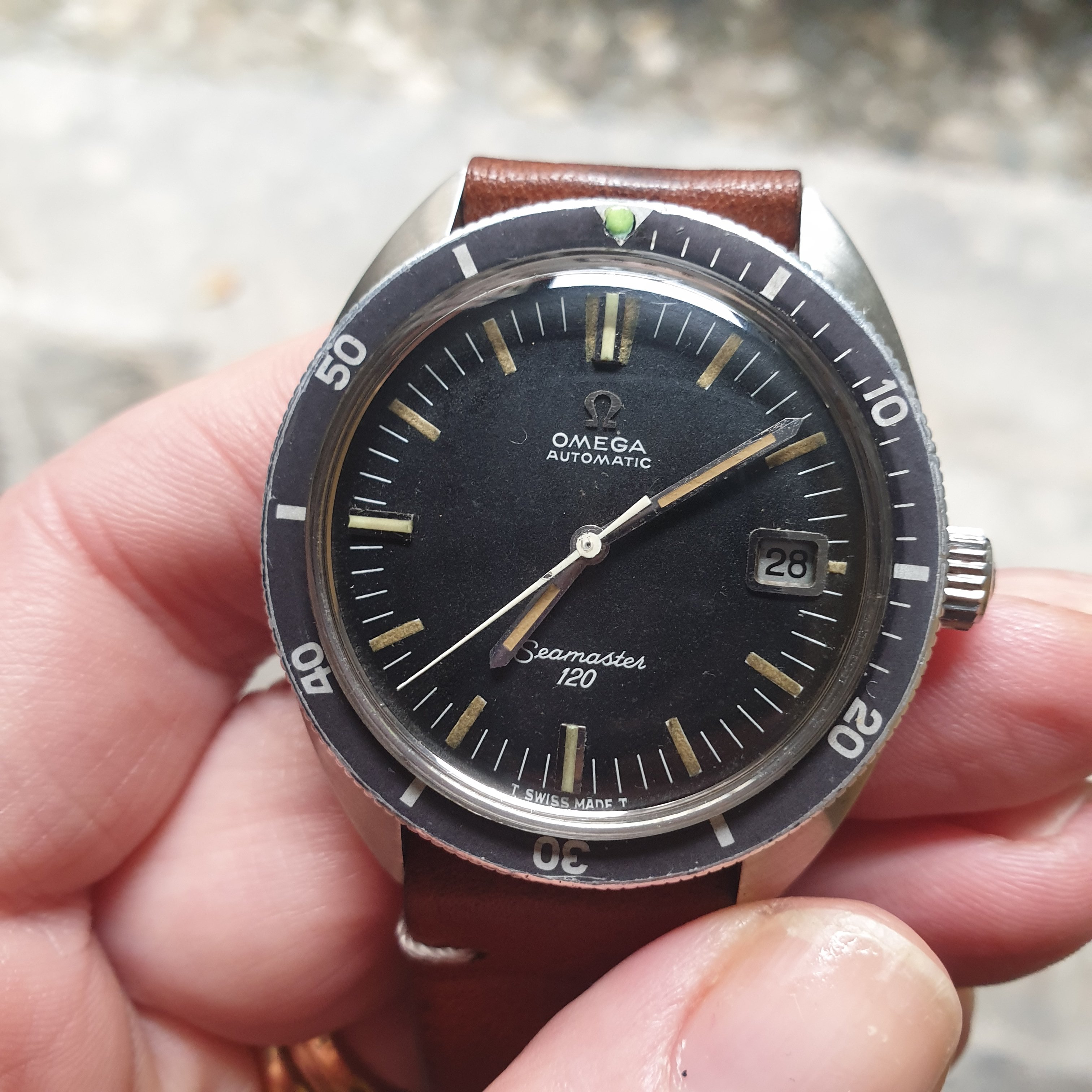

Movement number and ref. on the inner side of the case back match (165.027 / caliber 552). Watch has been serviced.
Lume on the dial seems faded to a yellowish color, not reapplied, looks original to me, in a very good condition.
Hands are ok, as well. The bezel looks also original including the pearl in the middle, but heavily damaged. Bezel does not rotate. Plexi is not original. The case looks really clean, the case back too with the seahorse logo, which look original.
In overall, this watch looks too clean for a 60 year old watch. What do you think? I'm waiting for photos to check the notch on the sides.

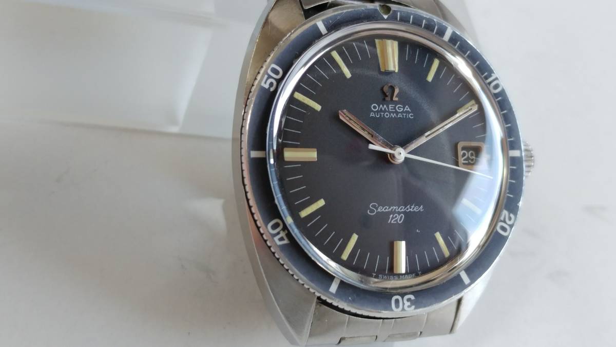

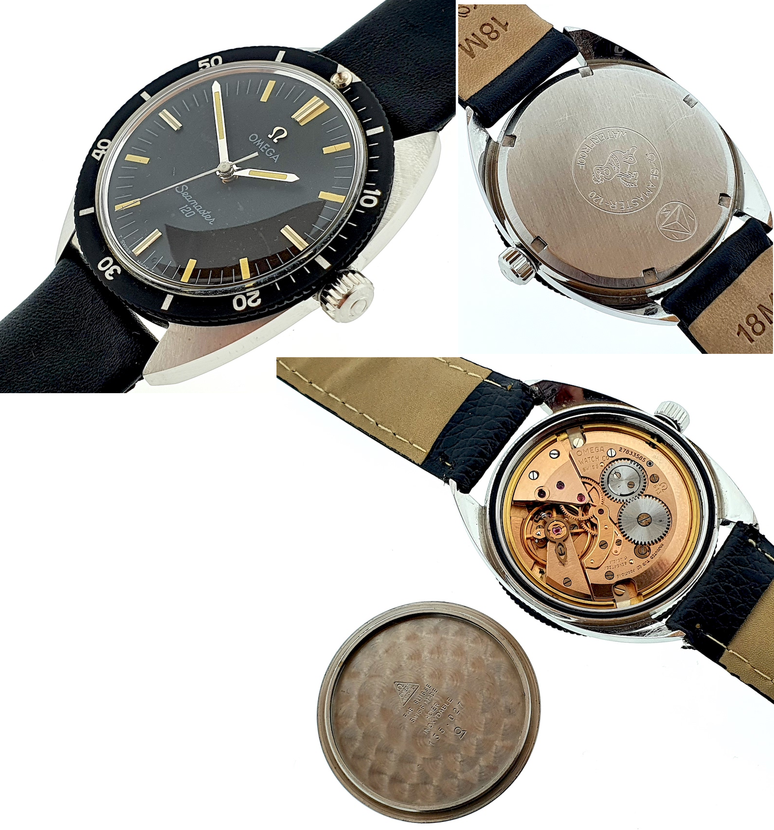

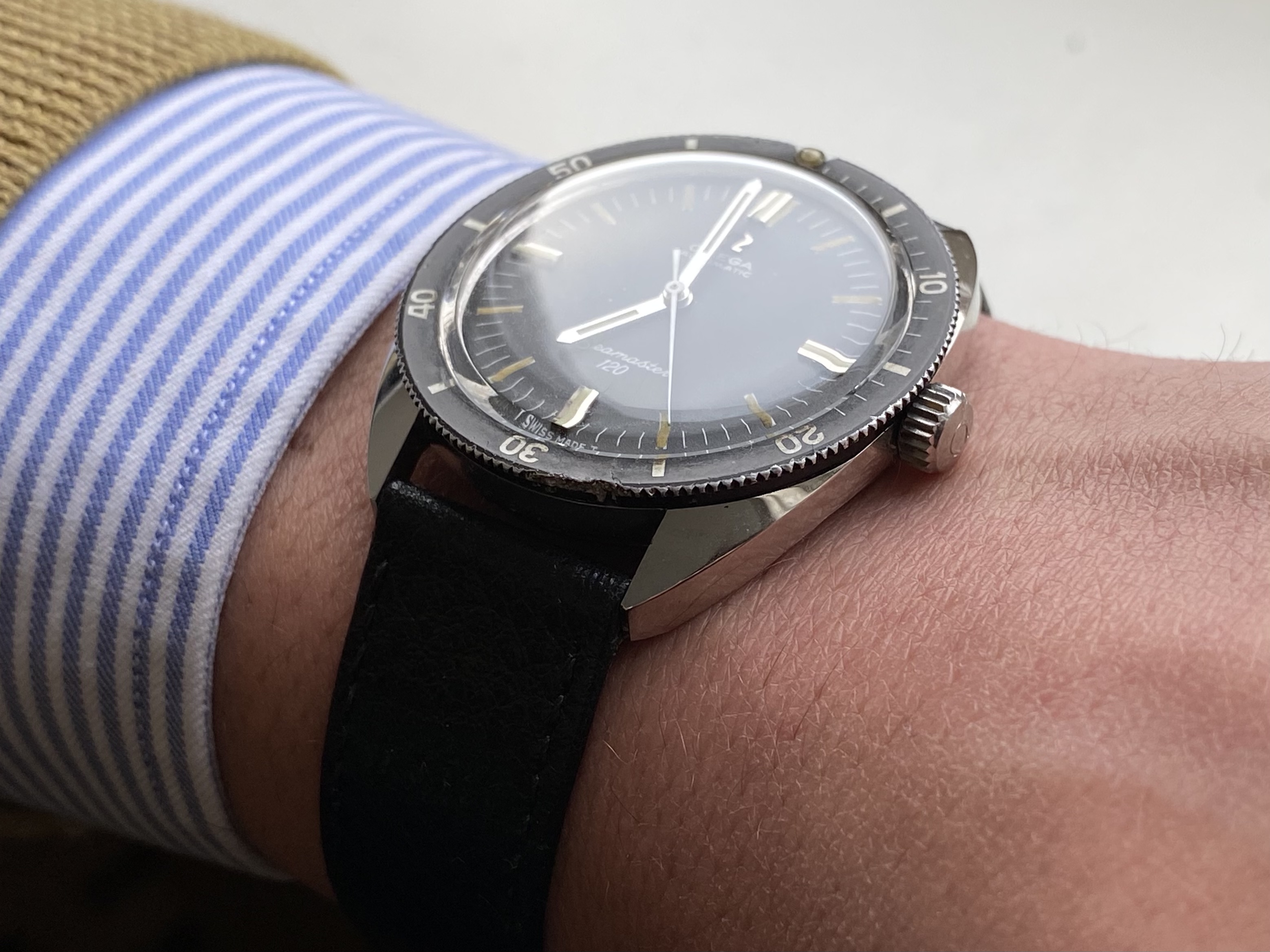

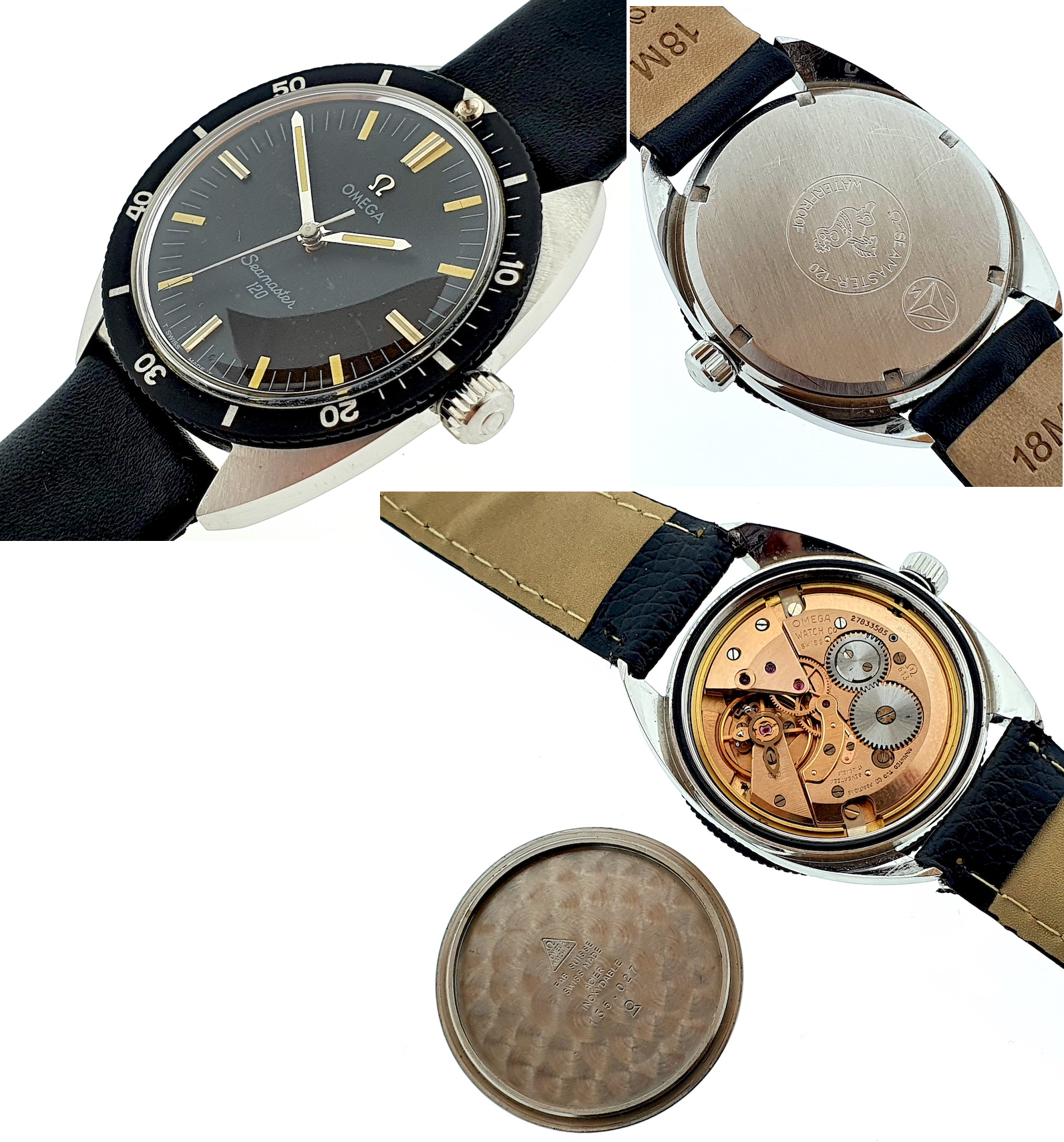

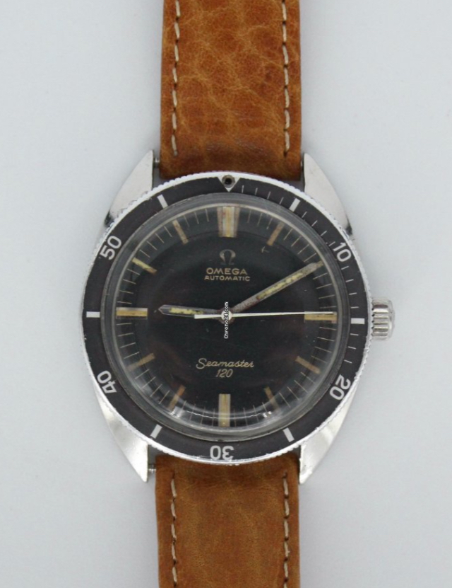

And I have this 2nd option, below. Movement number and ref. on the inner side of the case back match (166.027 / caliber 565). The case, case back, inner side of case back, and movement is original based on the photos I saw. Lume dot on the bezel is reapplied, not too nice. Bezel looks original and is a relatively good condition. Lume on the dial and hands are faded, dirty-ish, but perhaps considering the age of the watch it's ok. Colors on the dial and hands match. However, the "Omega automatic" and the "Seamaster 120" text looks too brigh/white on the dial compared to the aged lume on the dial, perhaps reapplied, a bit off I would say. May I have your opinion please about the dial?
Thank you !

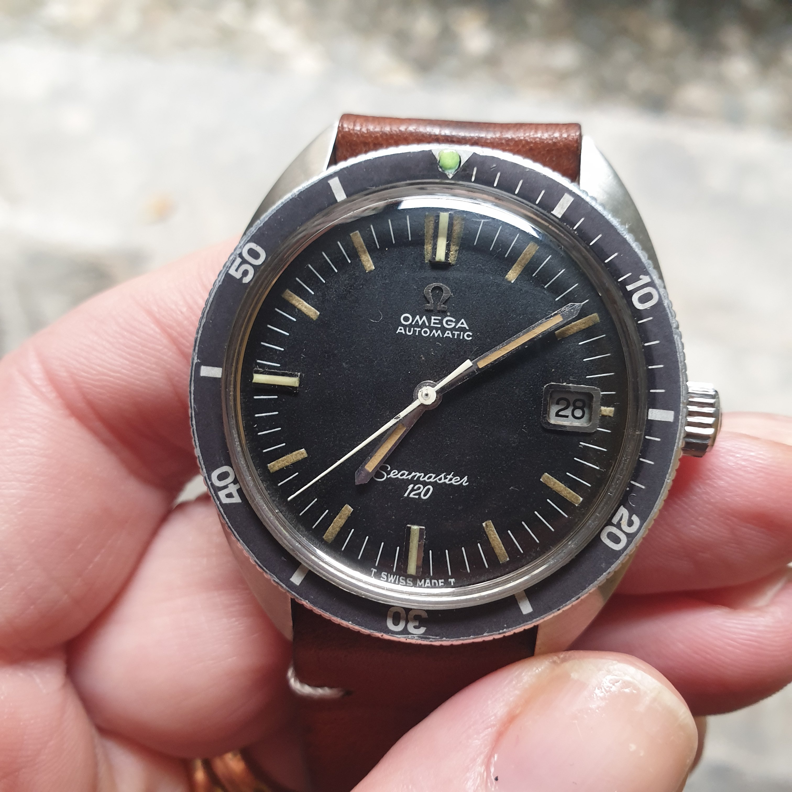

Both dials, bezels and hands look good to me. I'm wondering what happened to the pip lume on the first one. I'm on my phone so pictures are a bit small. Anyway, it comes down to price and the rest of the pictures (movement, case, caseback).
34
19
They might be able to laser weld the bezel on the watch with the black strap, but I would look into that before you purchase if the damage at 6 bothers you.
I can tell you from experience there is next to a zero chance of finding a replacement Bezel. Even if you do - the last one I saw in November on ebay sold for $1,150 USD in like an hour.
You can get a replacement original crystal with the omega logo in the middle, but I am not seeing anything really bad on either example.
The second watch, the pip at 12 is wrong, they should look like the first example.
The case on the first one seems really polished - I don't think they're supposed to be that shiny.

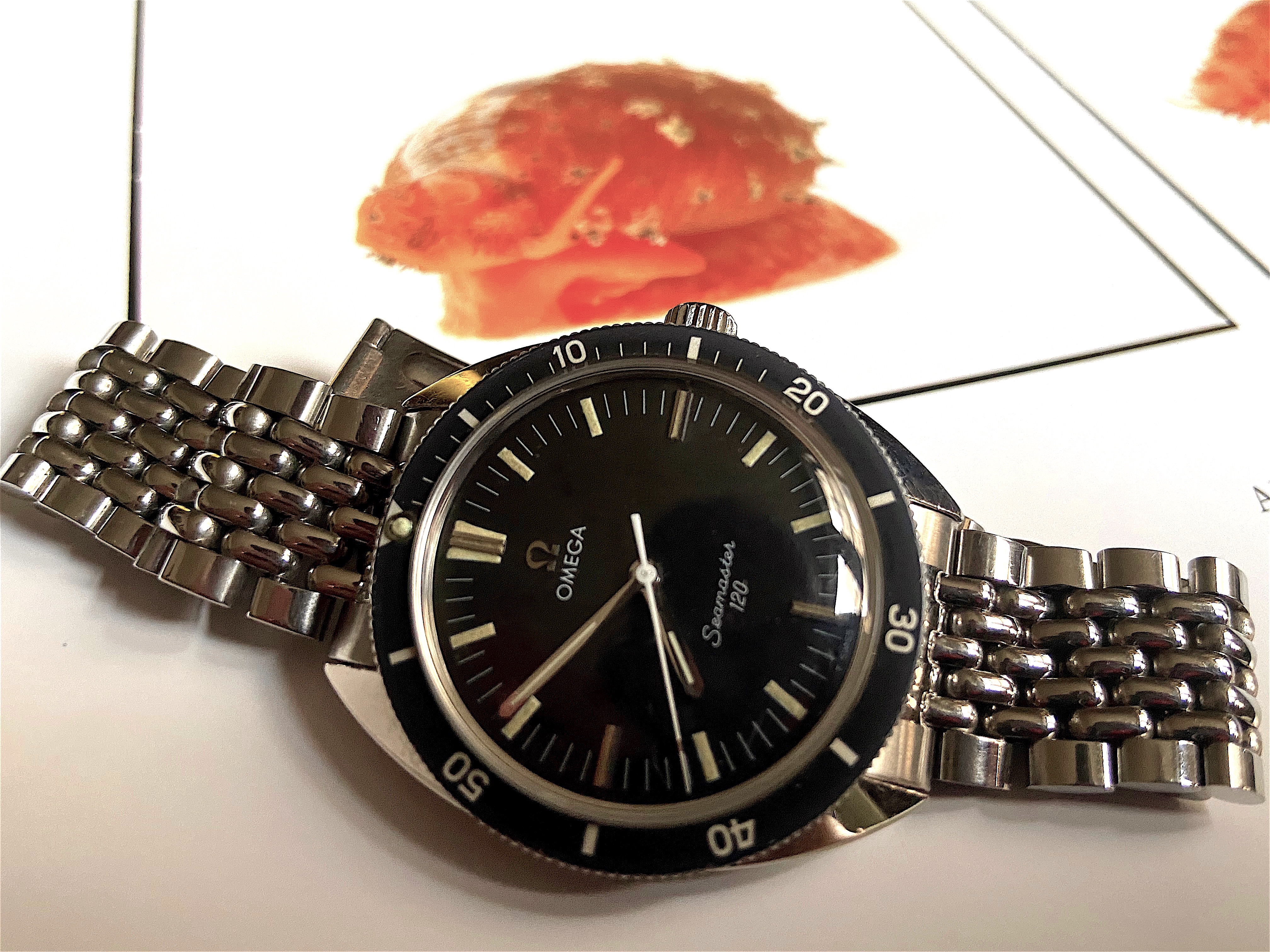

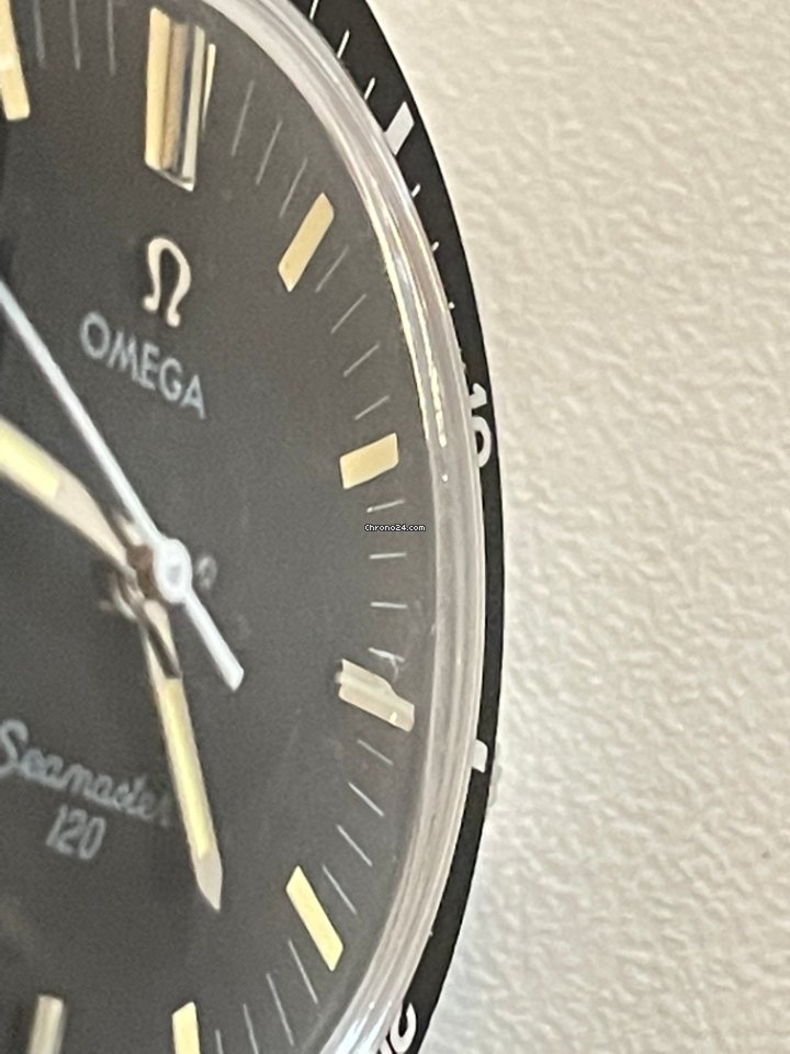

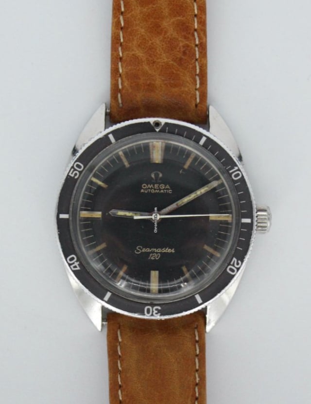

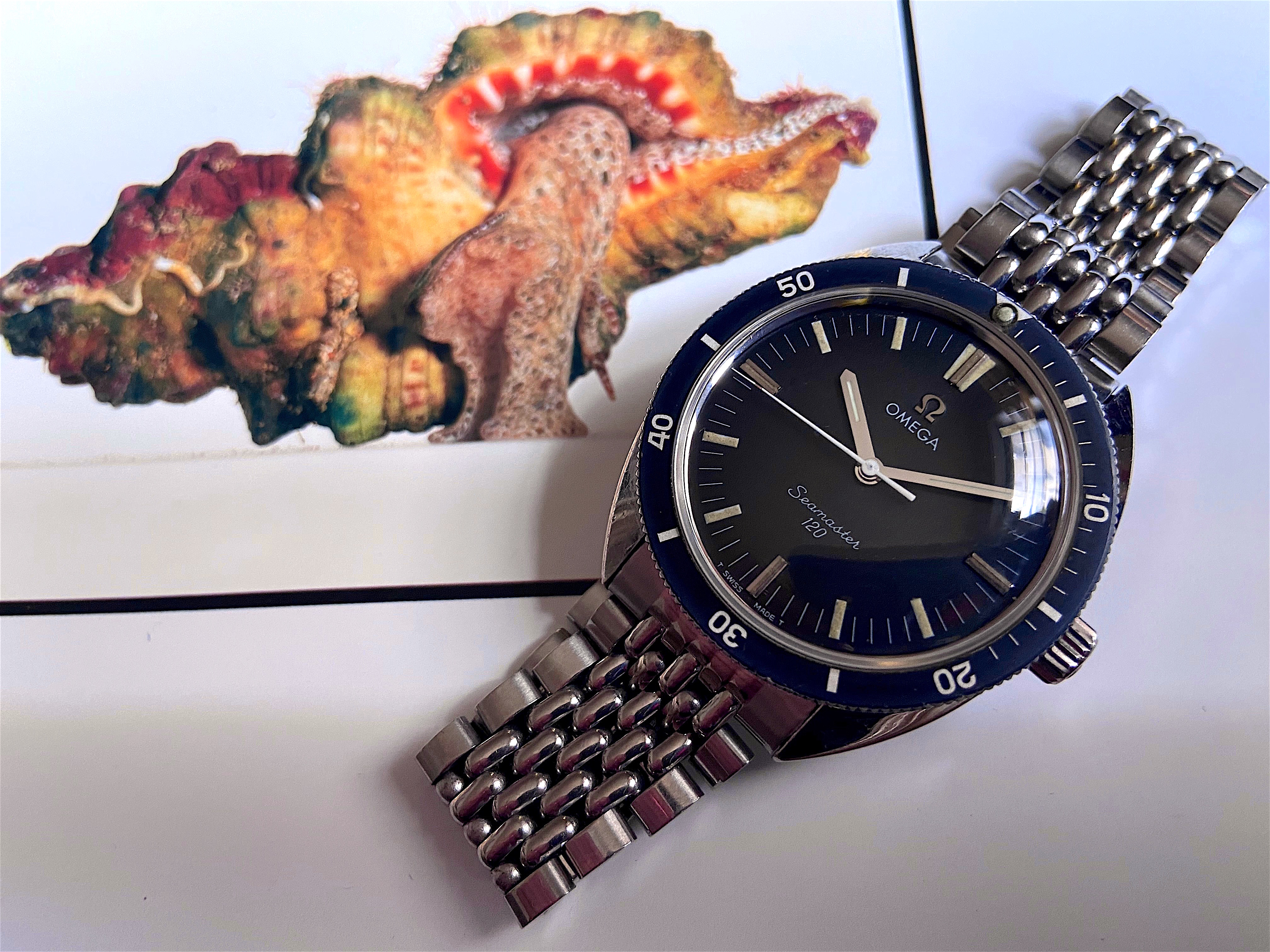

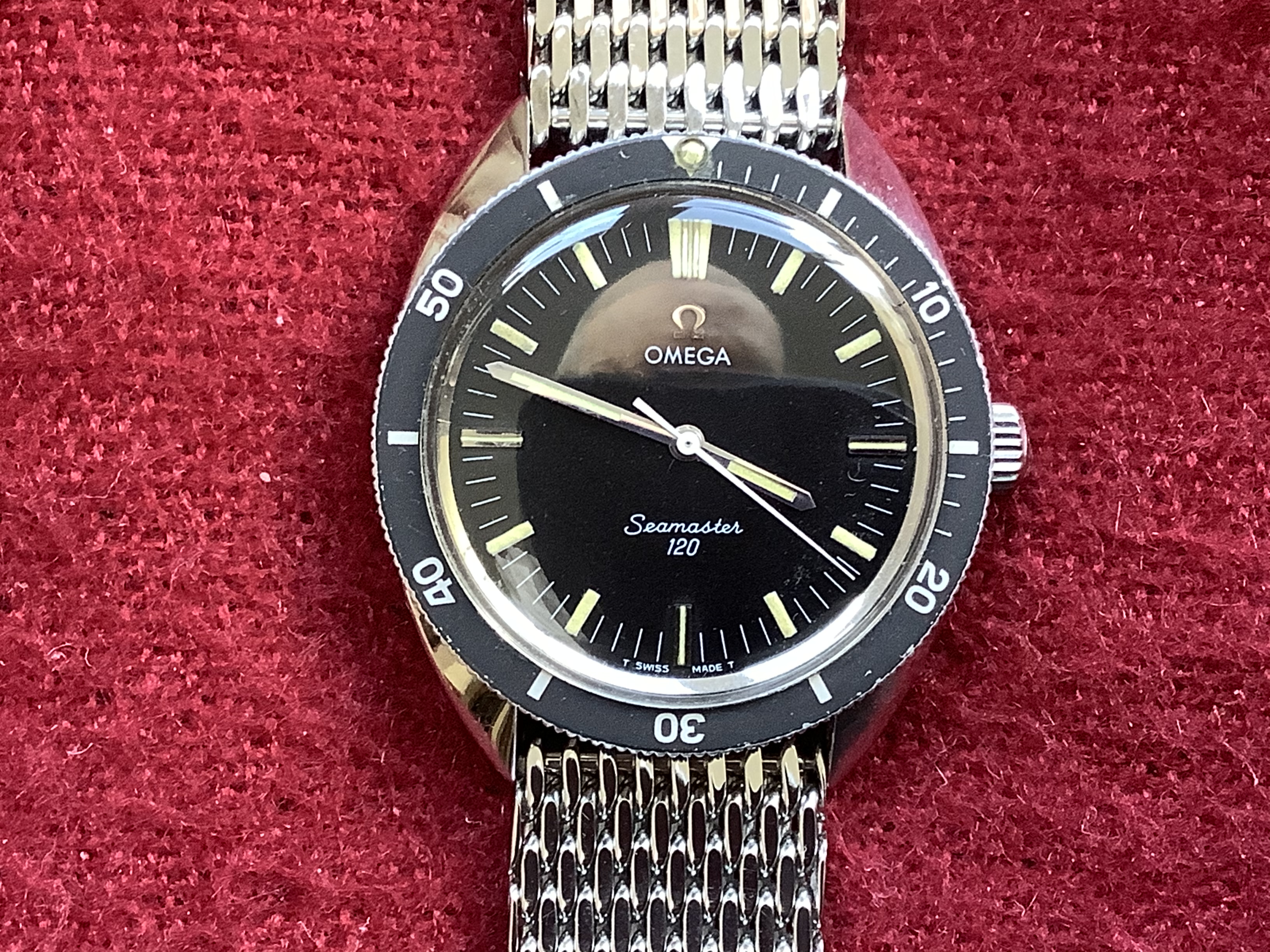

Hi,
Any thoughts on this one? In my opinion, the bezel is fake, the font on the dial looks grey and not white. The A on the back also looks wrong. Completely fake?
1,060
1,634
Fake
Btw I got the last 3 fakes out of chrono24 yesteday...

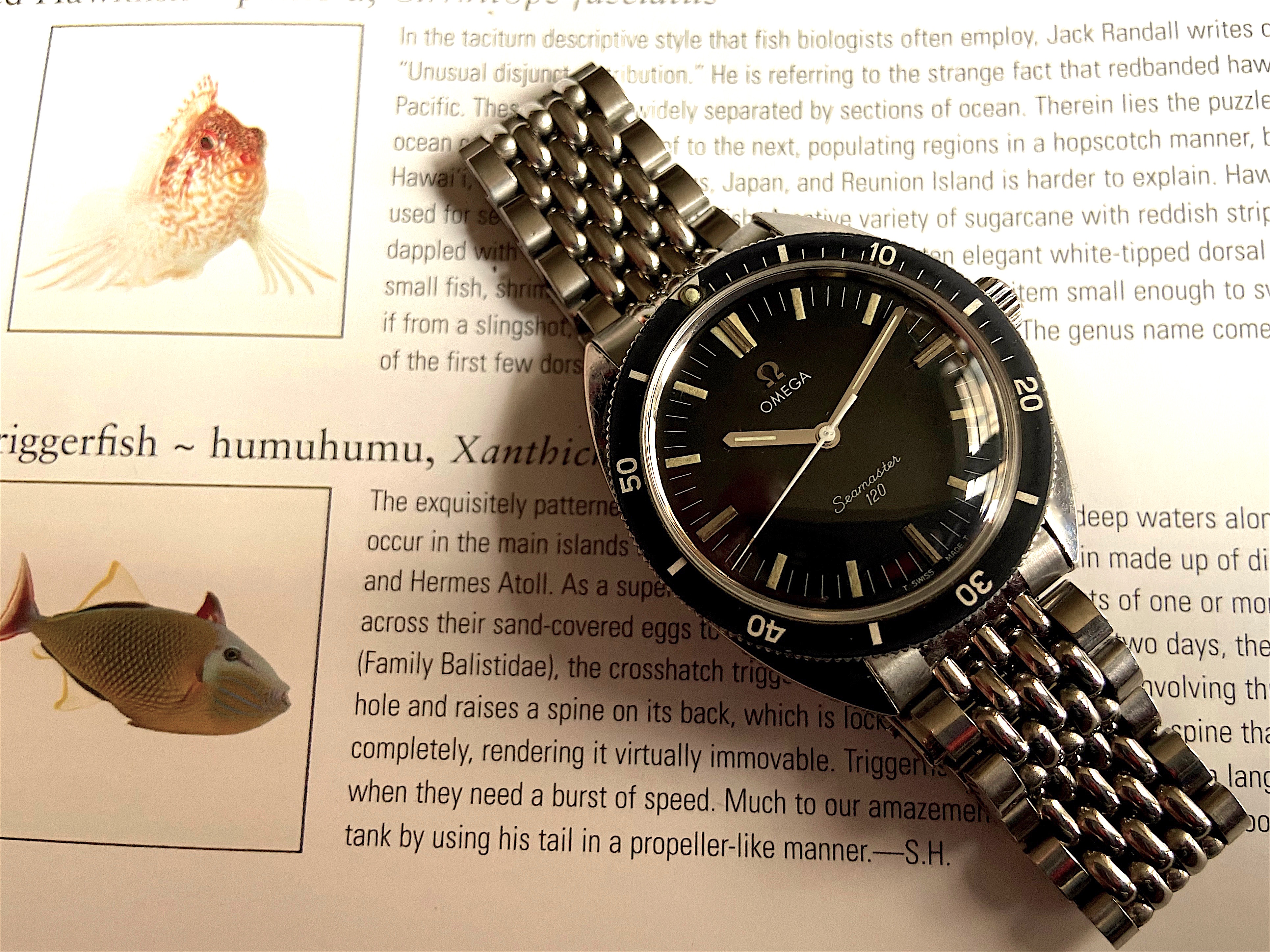

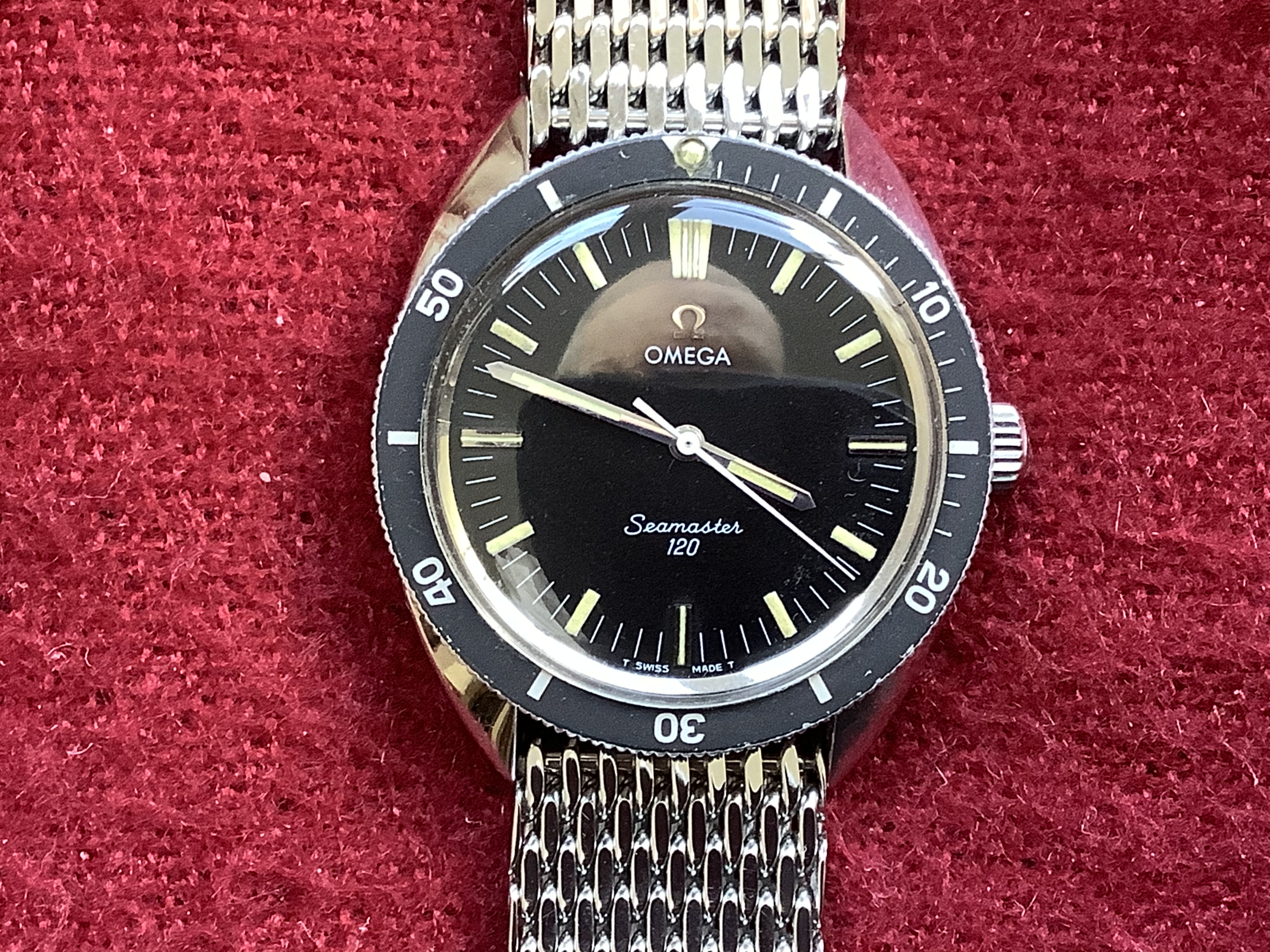

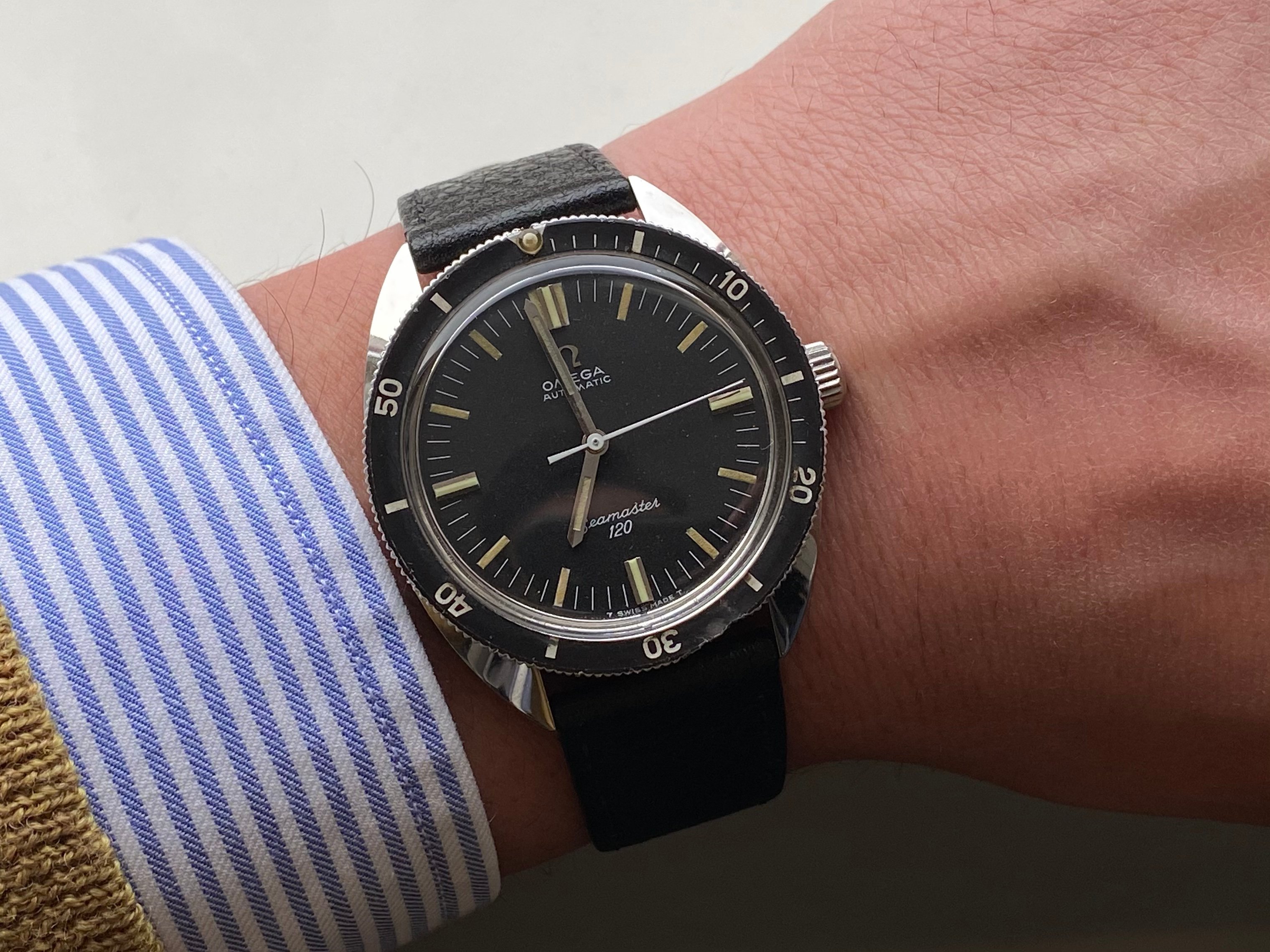

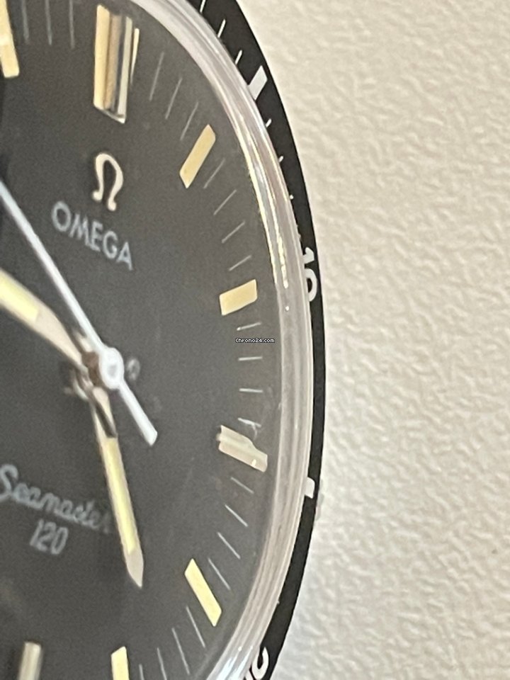

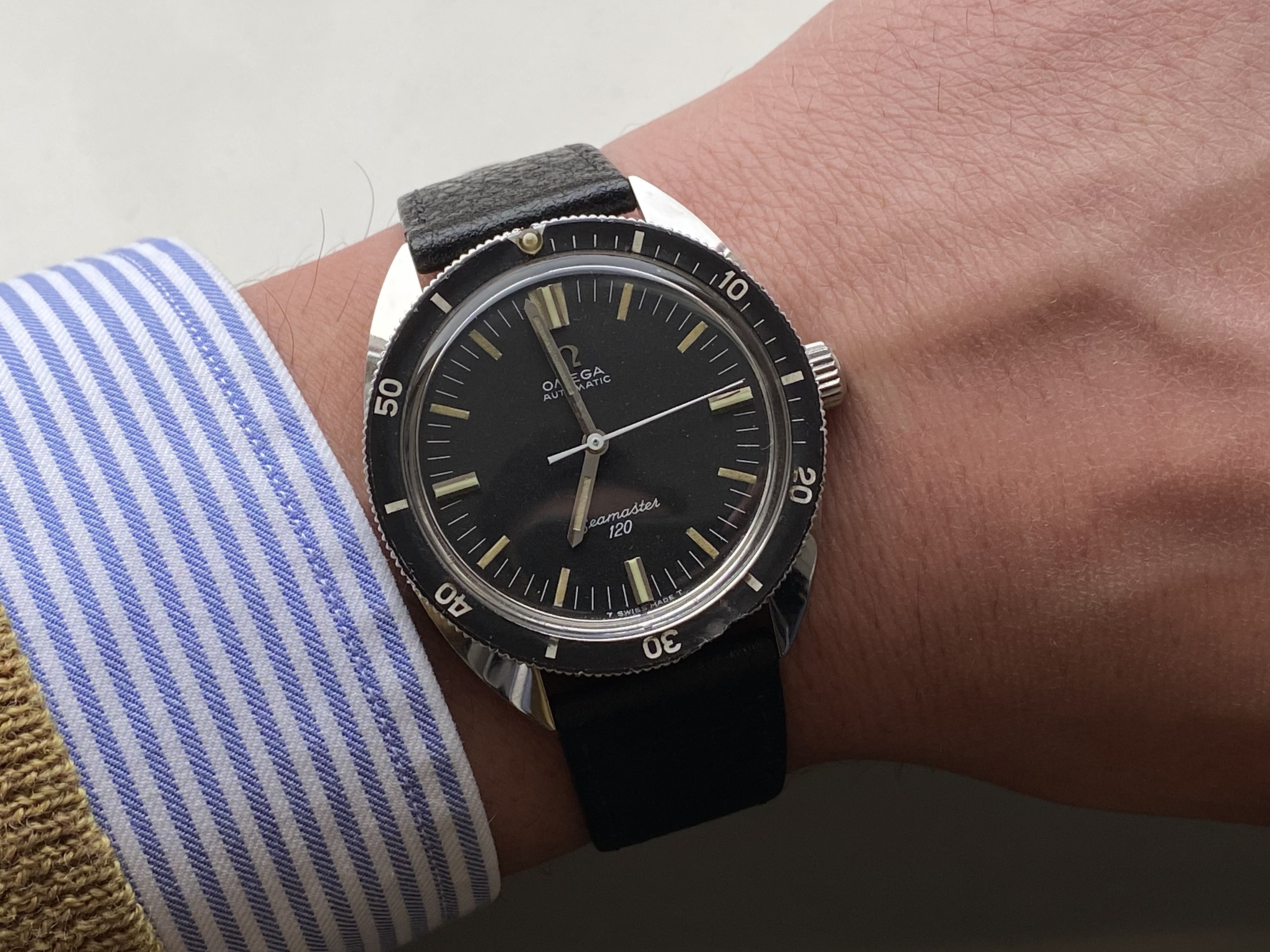

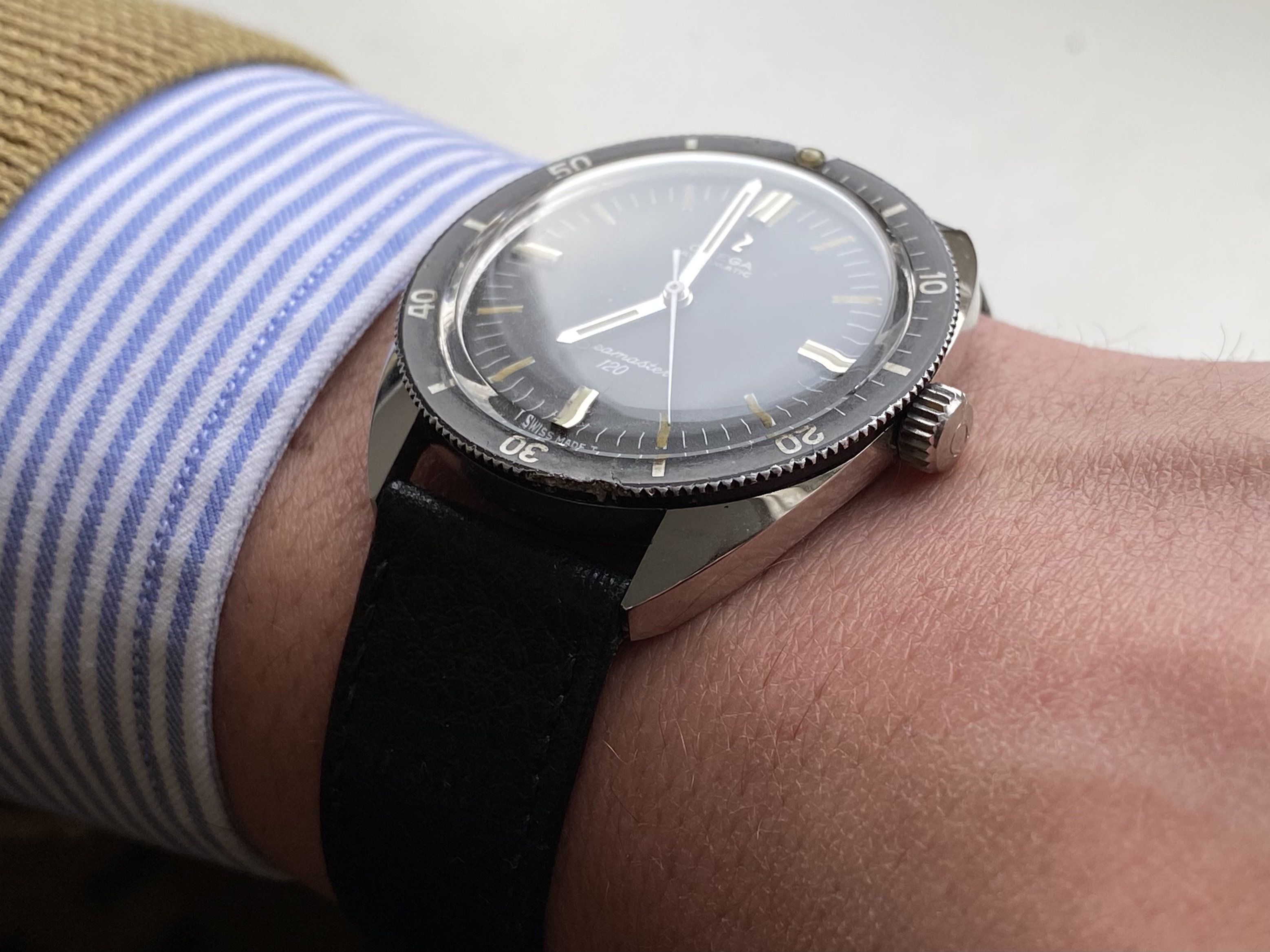

Hello everyone, new to the forum. I found this thread so informative I decided to join. I have one for y’all. From what I’ve can see it all looks right, dial print is not quite white but also not grey… case bezel, dial and hands look right to me… thoughts? And thanks to op and everyone who has contributed to this informative thread.

It's sad that people are paying this much for a non-authentic watch, even when it's -mostly- stated it's not authentic
Lately Seamaster 120's are on the rise as well, I'm glad I no longer actively seek one 😀

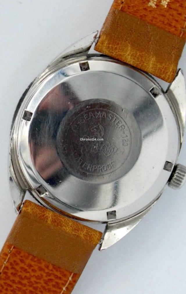

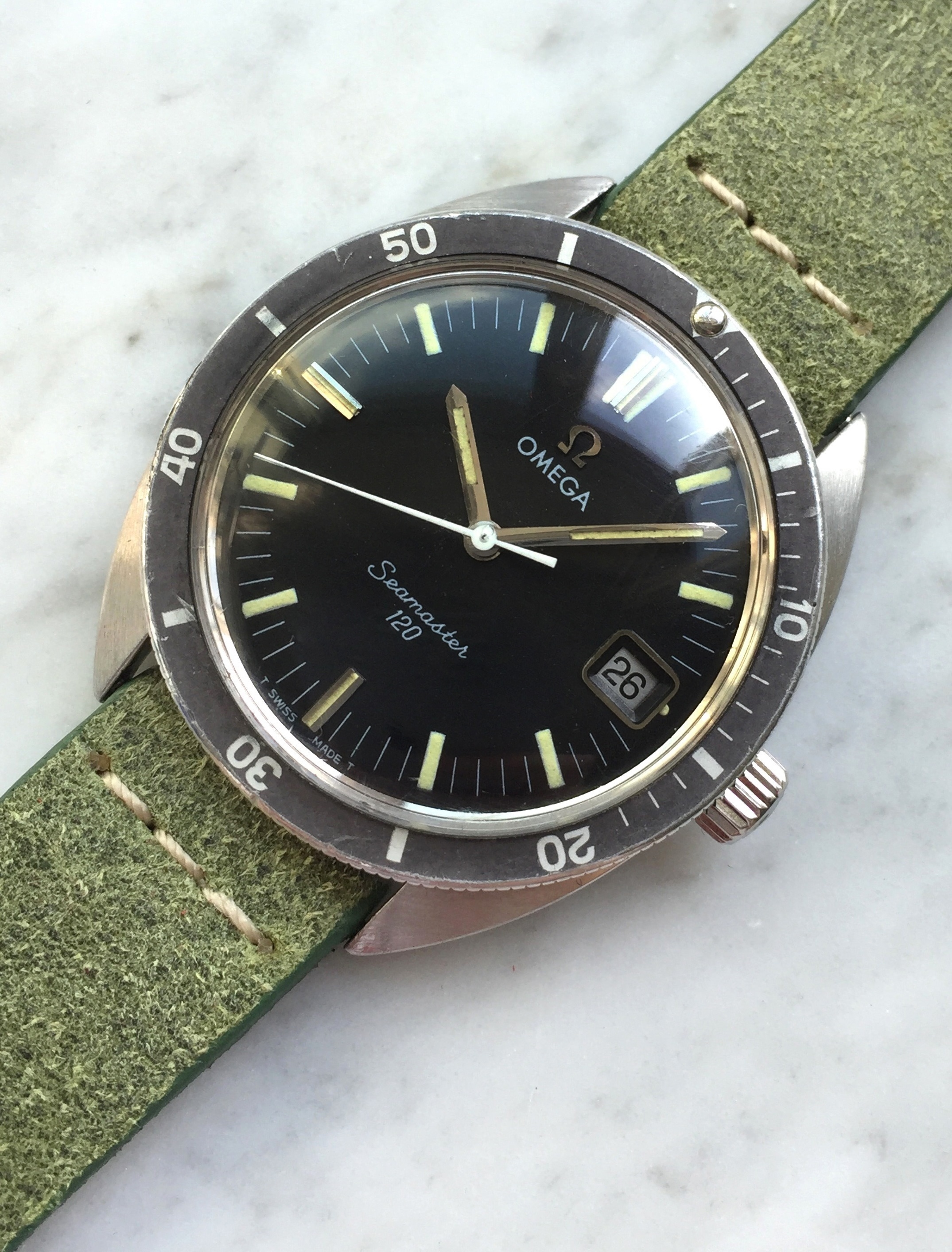

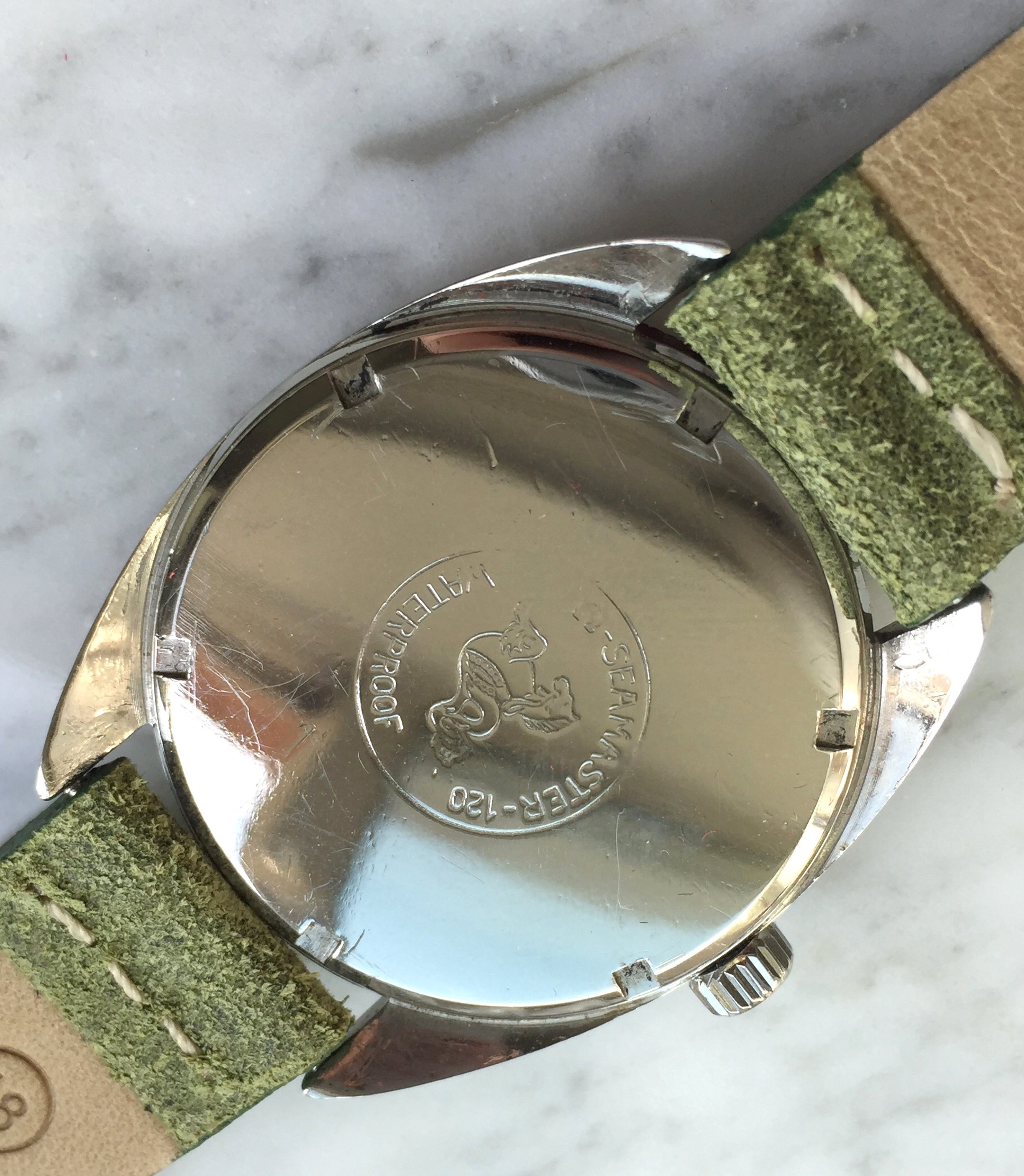

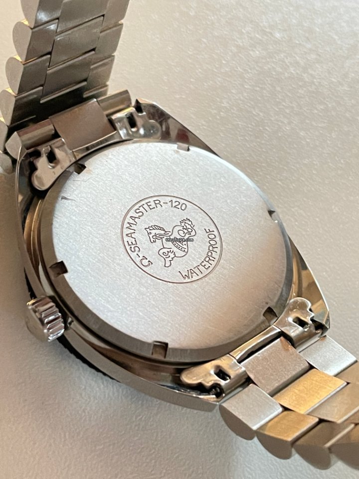

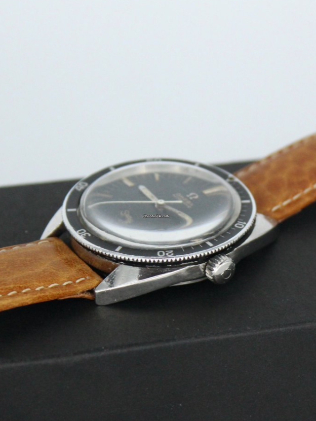

Hi,
Any thoughts on this piece? Dial looks good (white font), bezel seams fine. Not sure about the engraving at the back though.
103
96
Dial looks good to my eye and crystal even appears signed. Case is alright, though definitely well-worn and polished.

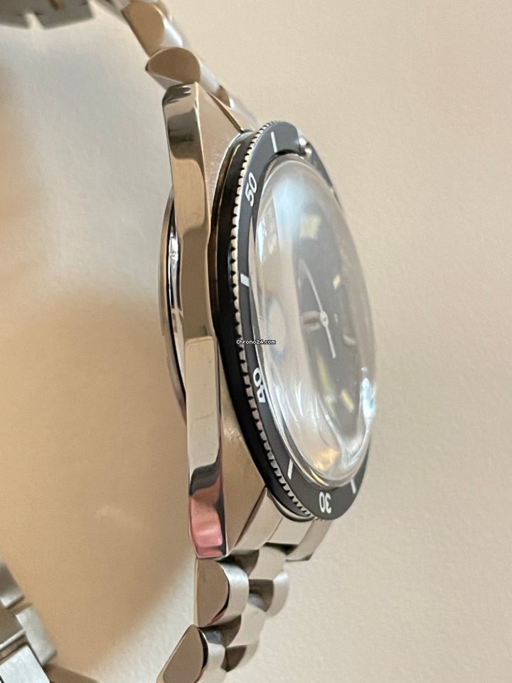

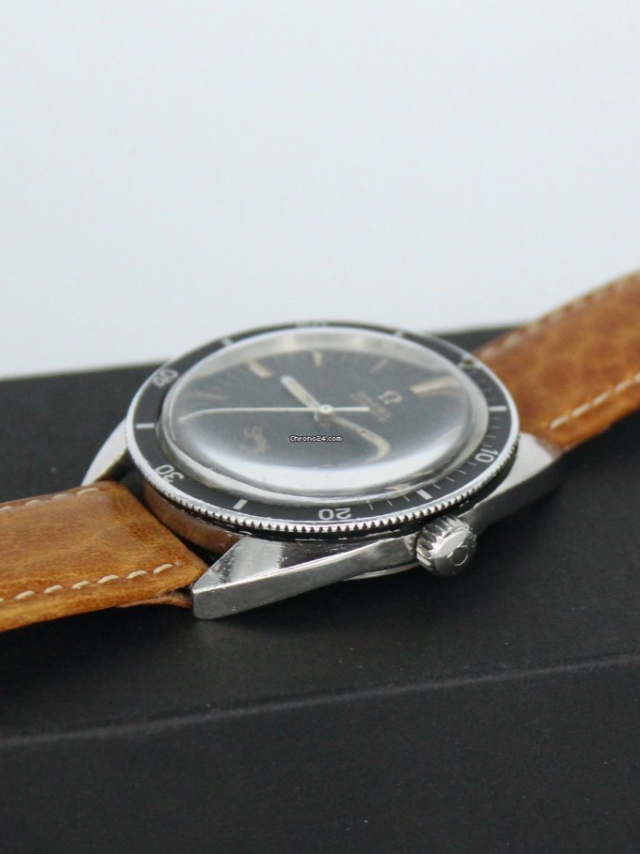

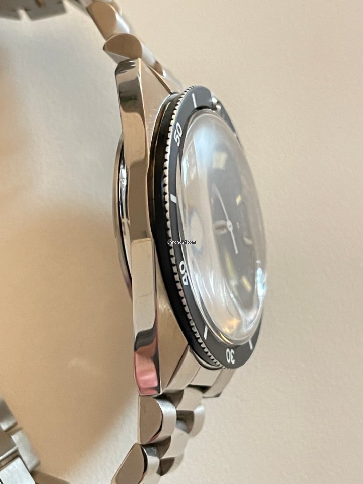

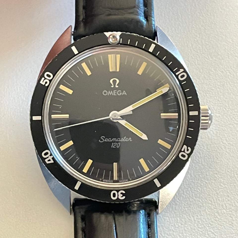

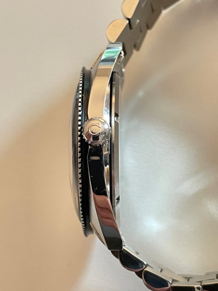

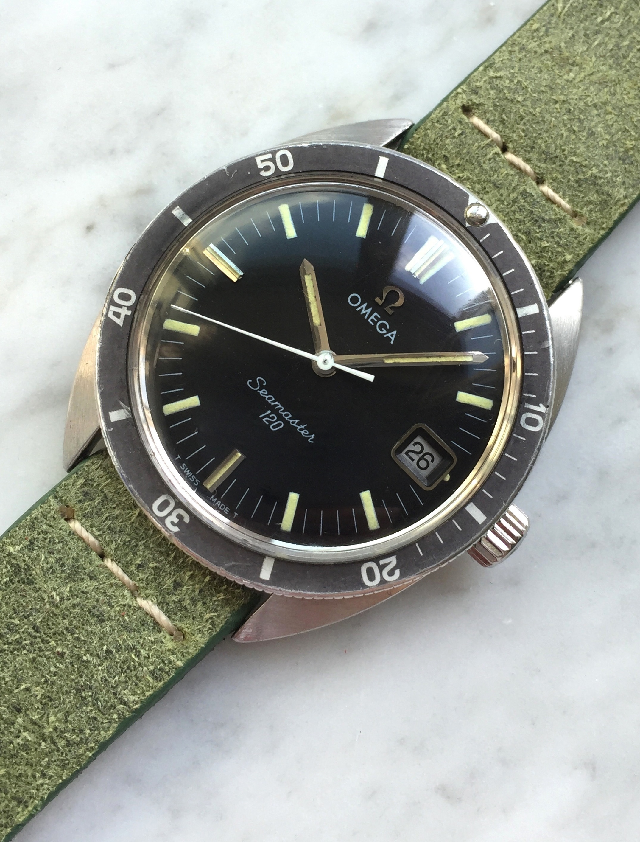

Hi everyone,
I got referred to this thread, trying to look for a Seamaster 120. I was told the watch below was not correct - based on what?
What I can think of is that the Omega logo and text should be switched around and the fact that the engraving is too thick. I'm not sure about the bezel. It looks too perfect to be true, but I also don't find it very glossy. What do you think? Anything else that is incorrect?
2,681
3,161
My eye isn’t trained for 120’s but nothing looks correct to me, only interesting thing is the faked(?) side curvature of the case
