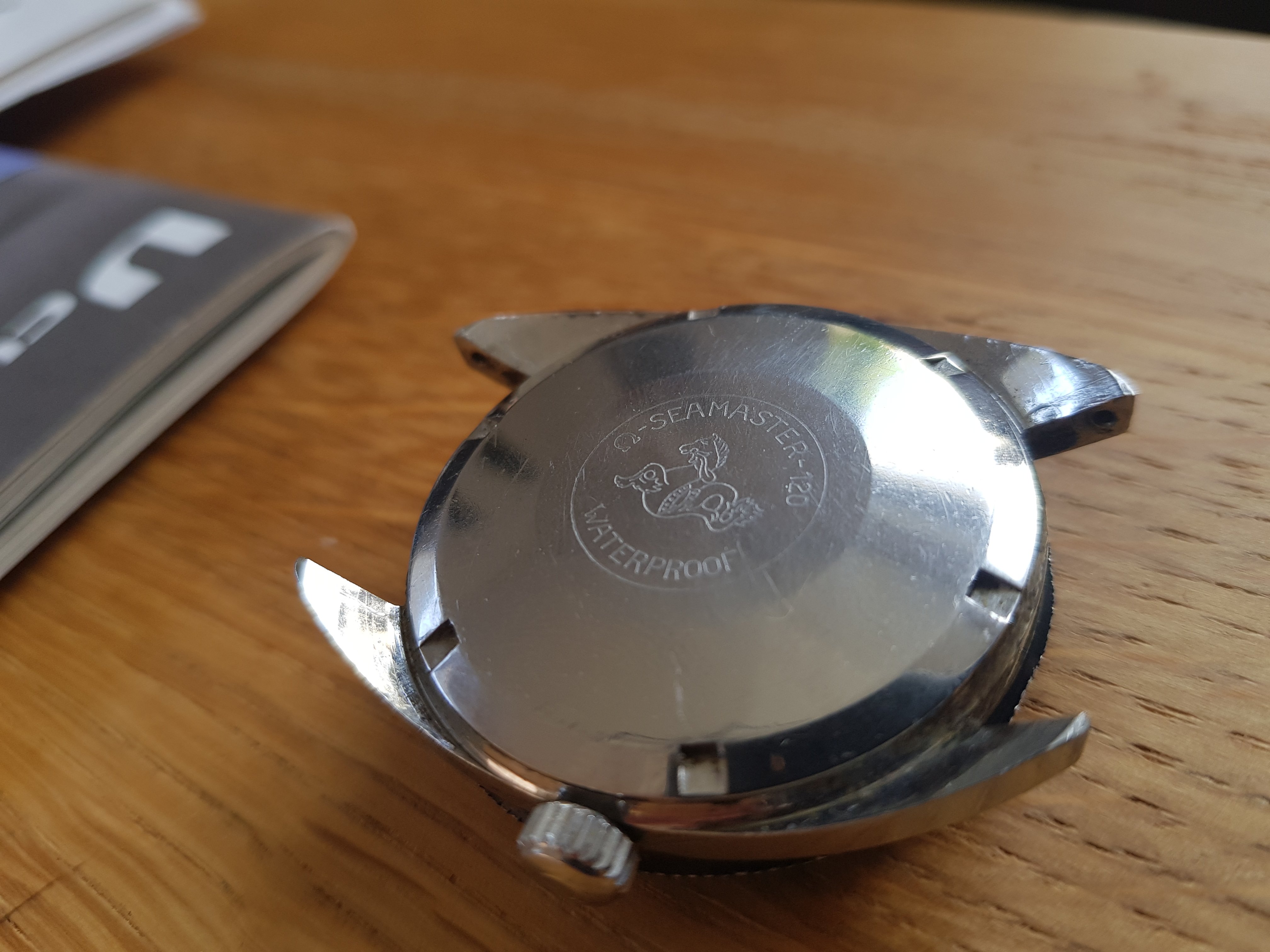

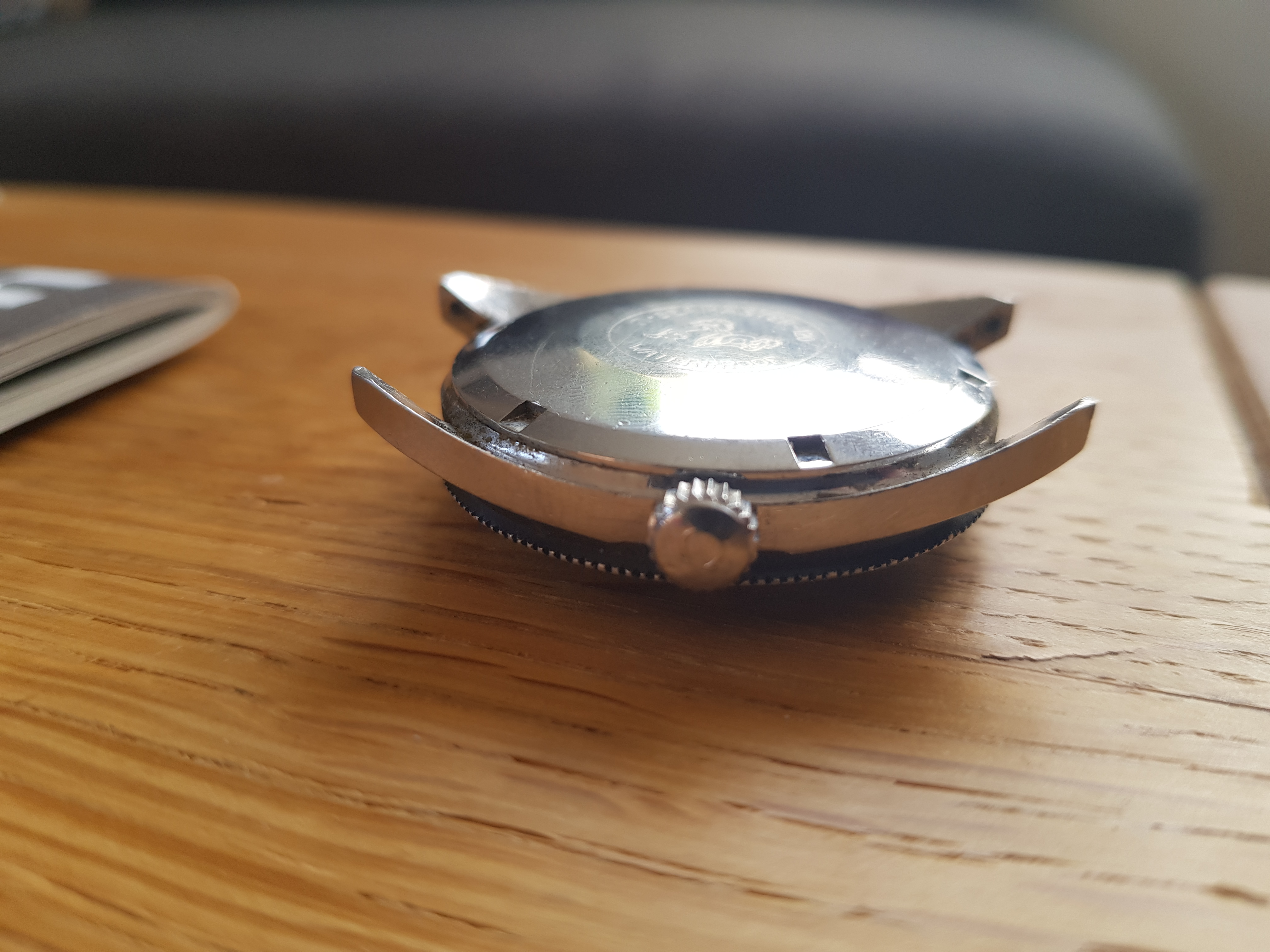

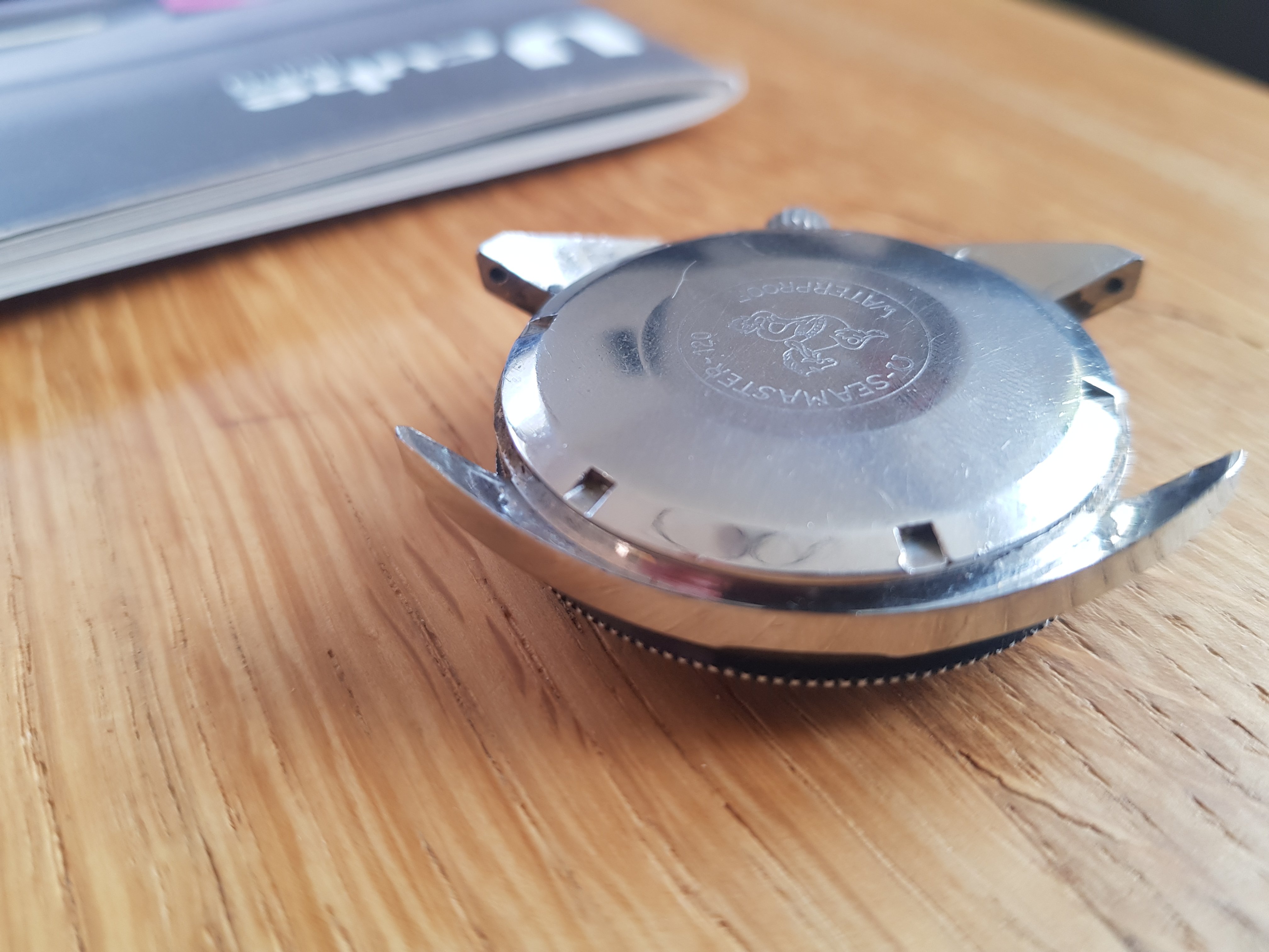

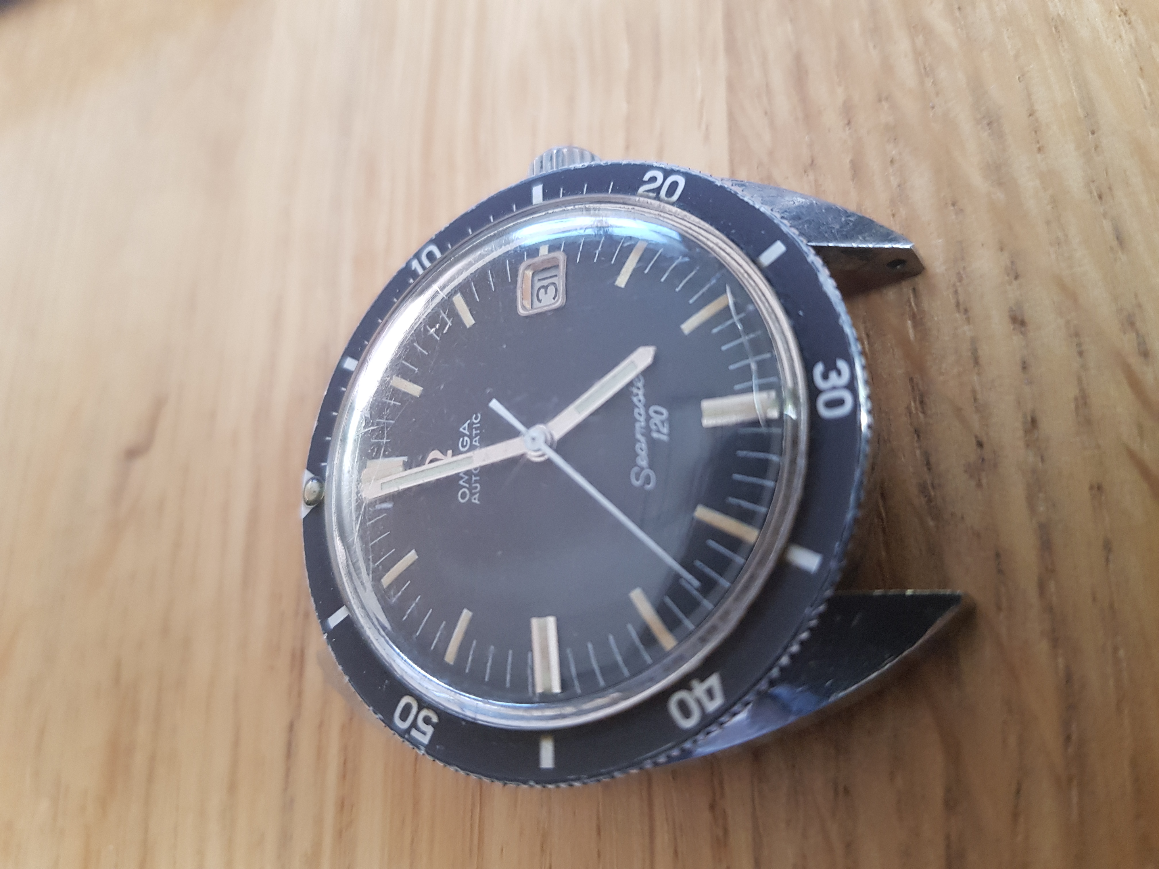

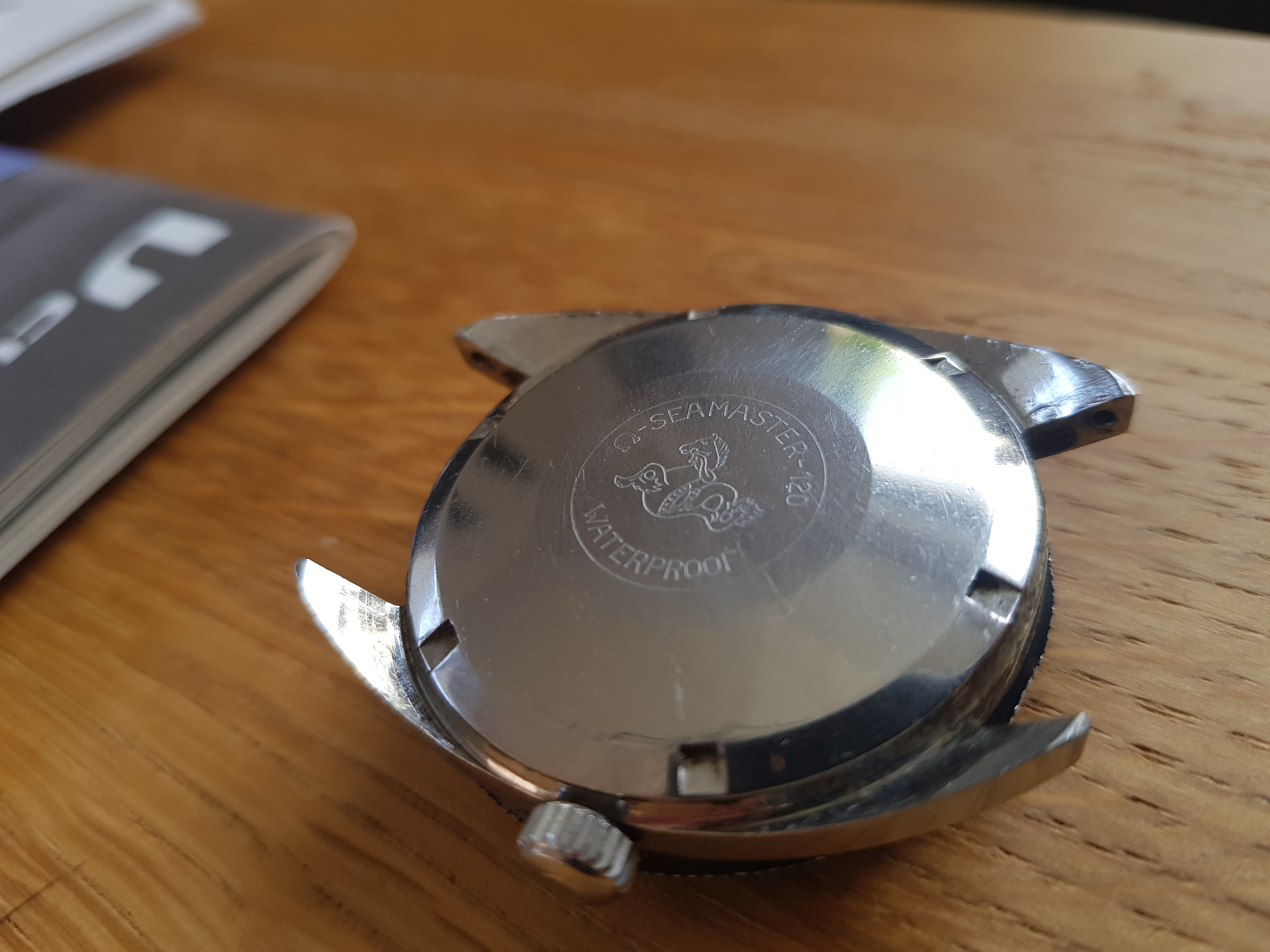

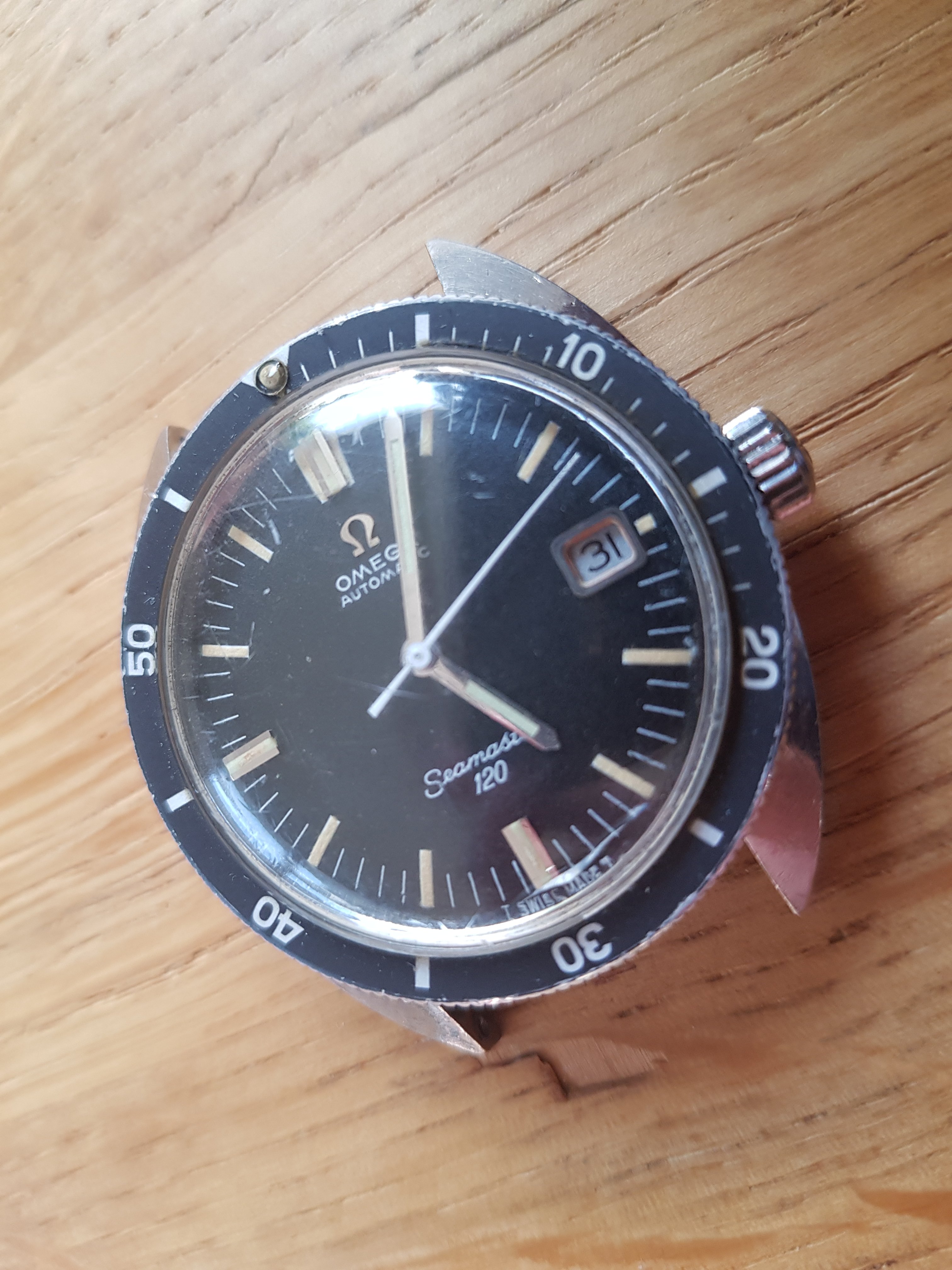

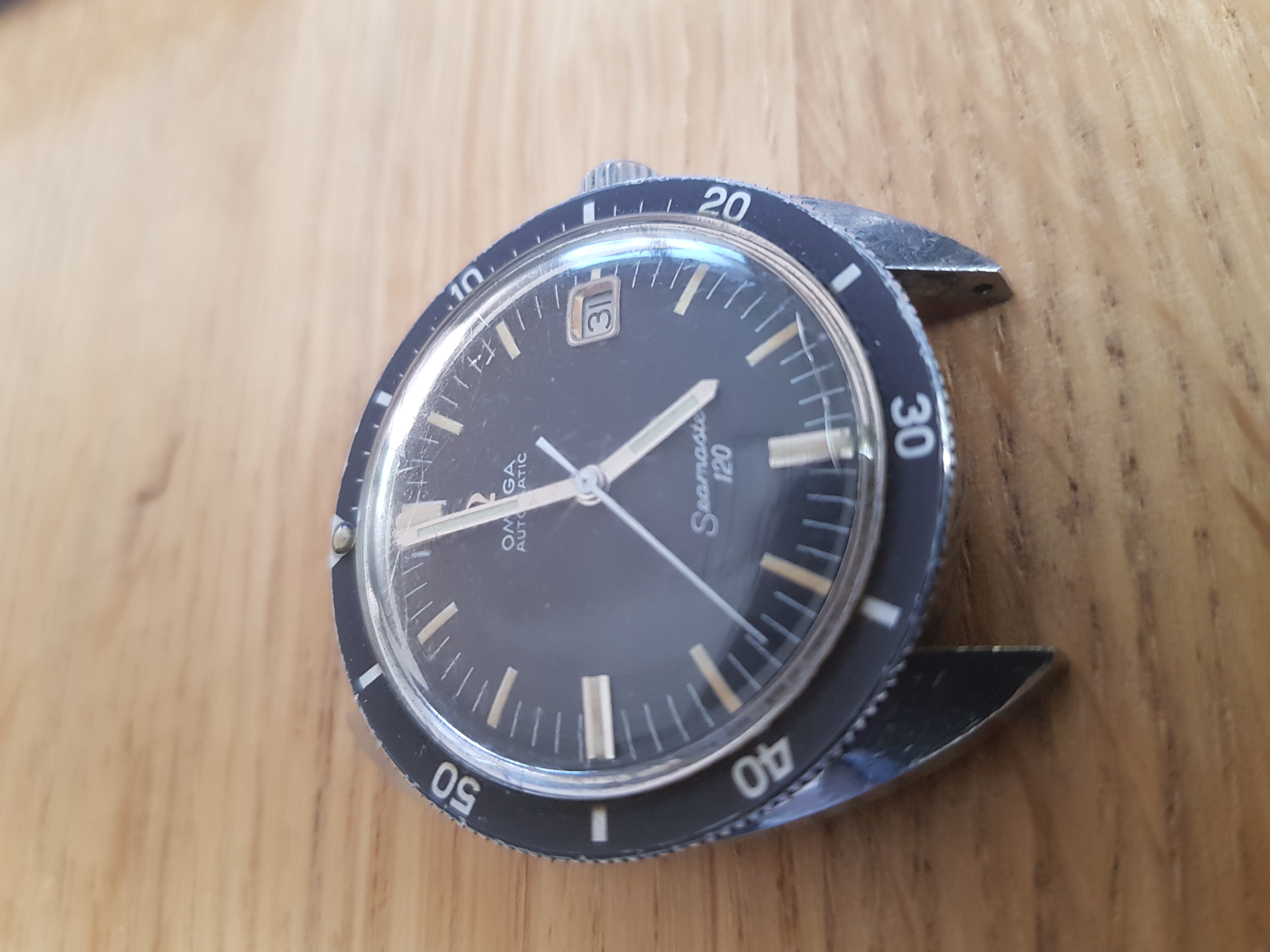

Yes i agree with Sonicosa, also the movement looks like it's been a bit traumatised, different coloured rotor to a few other components that i'm not experienced enough to identify, but the bezel is wrong for sure, the teeth on the outer edge aren't usually that deep and a bit more worn, i have one that's worn nearly smooth because it's been worn by a nervous bezel-fiddler in the past, apparently the case should look matt brushed as well and not glossy and polished unless it's been serviced to within an inch of it's original-ness

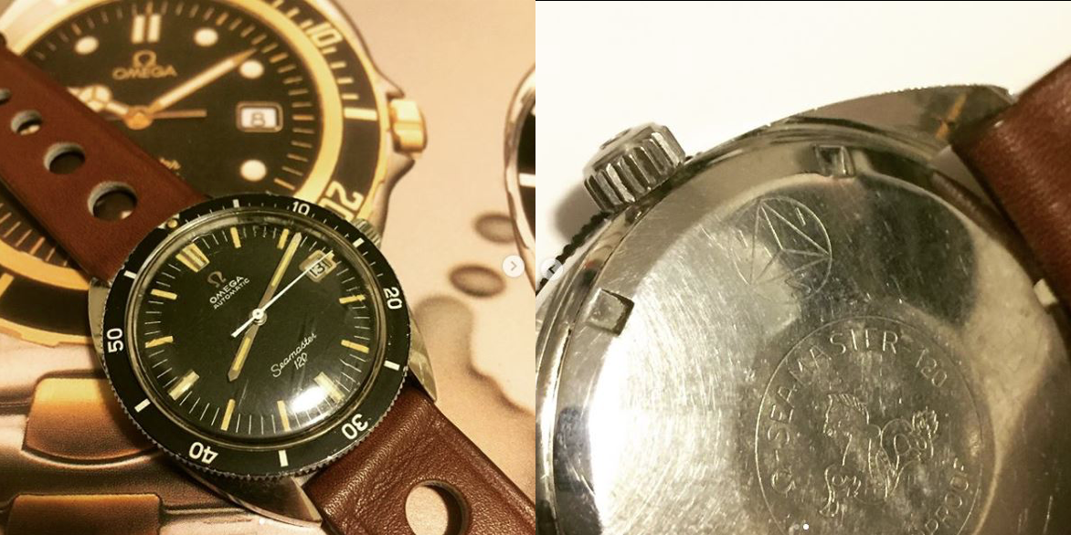

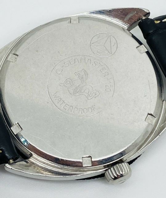

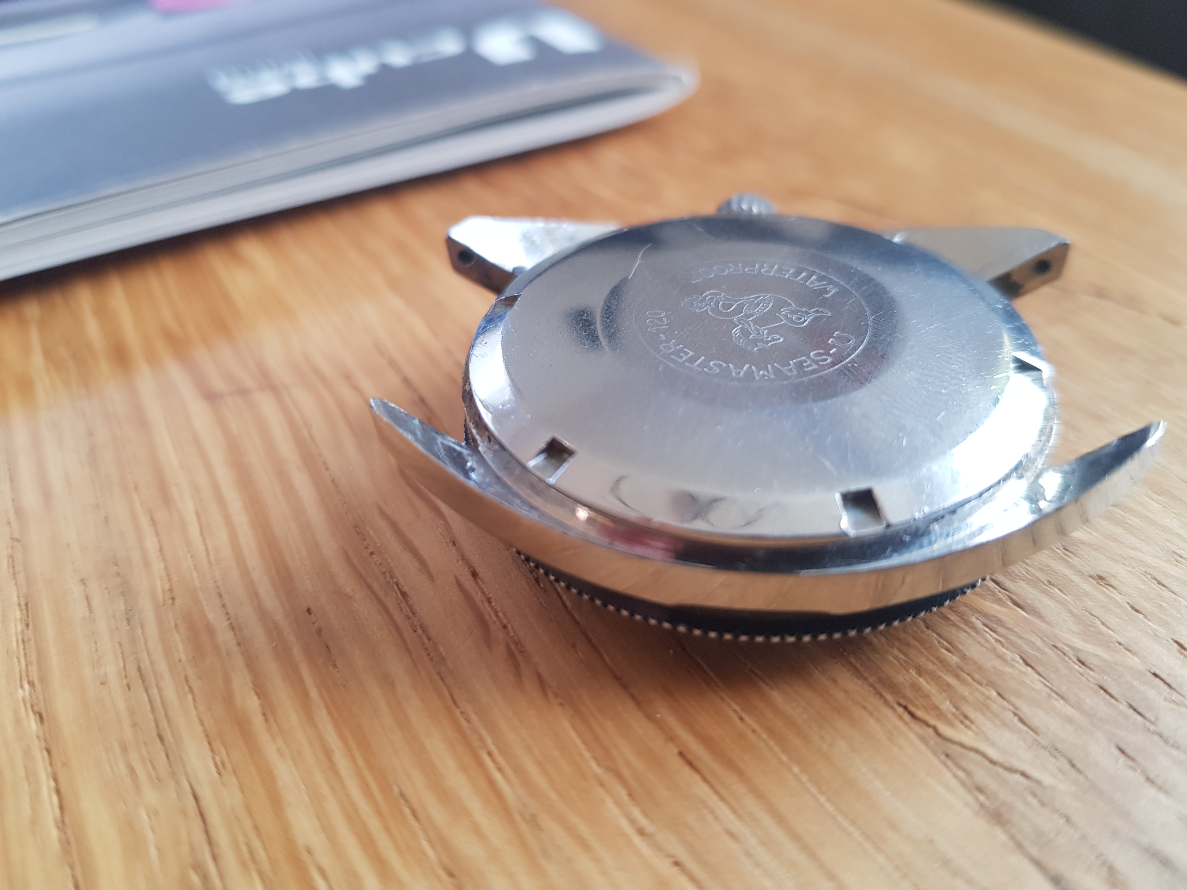

Not exactly an avalanche of archive extracts from Omega flooding the internet. Nada, less than nada in fact.
A land-locked country supplies it's army and/or air force with a luxury branded diver/dress watch (rated to 120m when brand new but actually probably only suitable for snorkelling) and laser etches an incorrect resemblance to it's motif on the back, becomes more preposterous the more i think about it, unless this is Imaginationland, which changes everything

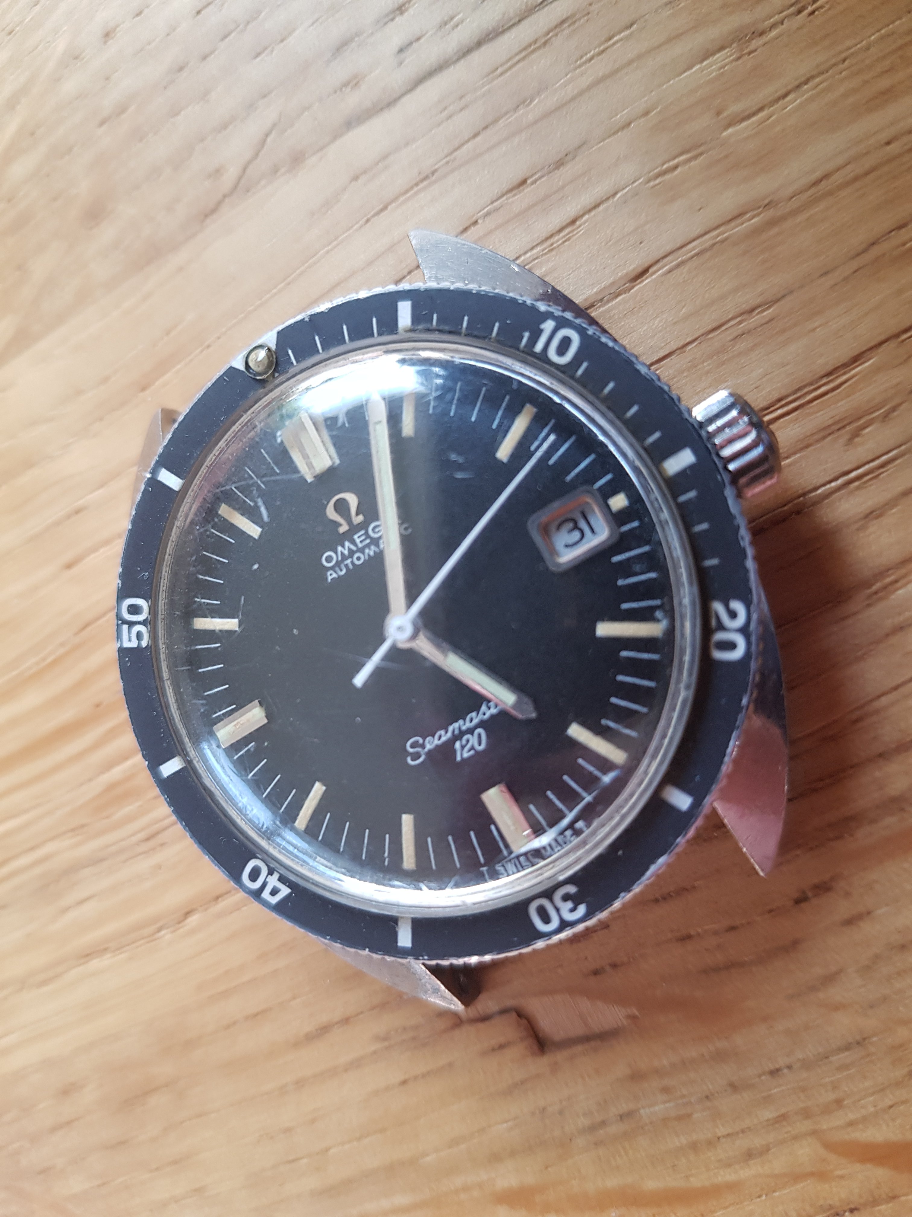

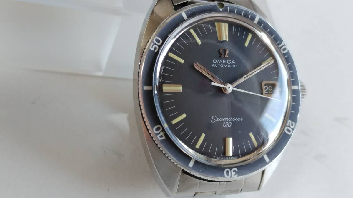

Thanks for this helpful thread - I managed to grab one of those beauties.
Was a bit of a gamble with just 3 blurry pics (no movement pic) but to me everything seems legit. (I hope I didn't miss anything)

No it was on an other auction website - in my opinion it was fair priced

Nice find duffy7, i'm not as experienced as some of the guys and girls on here, but still a brave move to buy without seeing the movement, how does it look by the way? (the movement)

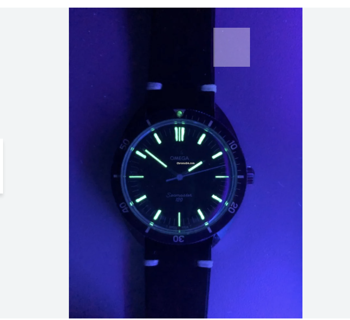

It may be the light (or my eyes) but the hands look like they've had the lume redone, usually their colour ages at the same rate as the hour markers so match each other's darkening to that amber aged look so common with old tritium lume. I have one exactly the same as yours except your bezel is in much better condition, it's had less fiddling so retains the toothed edge, i can't remember how many teeth a genuine one should have compared to a dodgy one, i think it's about 12 extra, but yours looks fine to me, in my super-novice opinion

Also i think the crystal on yours (duffy) looks like genuine one, i think you can just make out the Omega symbol at the centre

Thanks for your reply.
Normally I don't go for a watch in this price range without movement pics but sometimes you have to go for a gamble if you are hunting for a special reference in a honest condition. ( I didn't see the movement by now so I don't really know if everything is fine; watch is running without problems)
You are right- the lume on the hands is a bit more greenish. It noticed this already on the blurry auction pics (as far as I know the lume on the dial and on the hands don't always age the same way so for me it is not that sure that the hands have been relumed)
Yeah the crystal is signed with the Omega symbol.

I would reserve judgment on the hands until you get it in the flesh- seller has some mixed color balance happening there. Not uncommon for hands to age a shade or two differently from the dial (different contractors), color should be similar though. Later tritium service hands could also be a possibility over relume as there was a green lume period for Speedy’s in the early 70’s and hand replacement was SOP for a factory service. I wouldn’t be concerned either way- they are the correct hands and a hand relume is easy to match it actually bothers you. Congrats on a good pick-up.

To be honest, the watch not only look fantastic but also 100% legit. Thank you for sharing the photos!

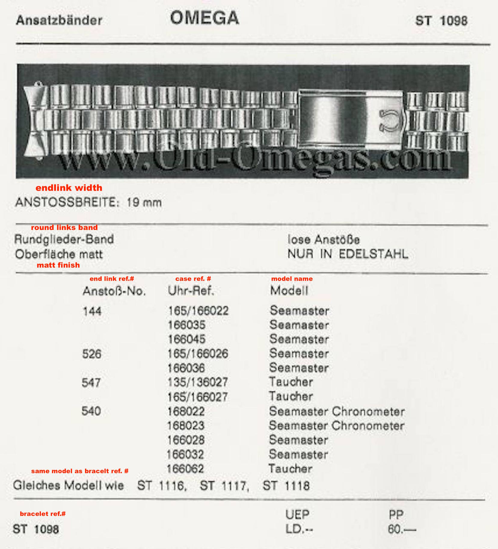

Bracelet is not correct
