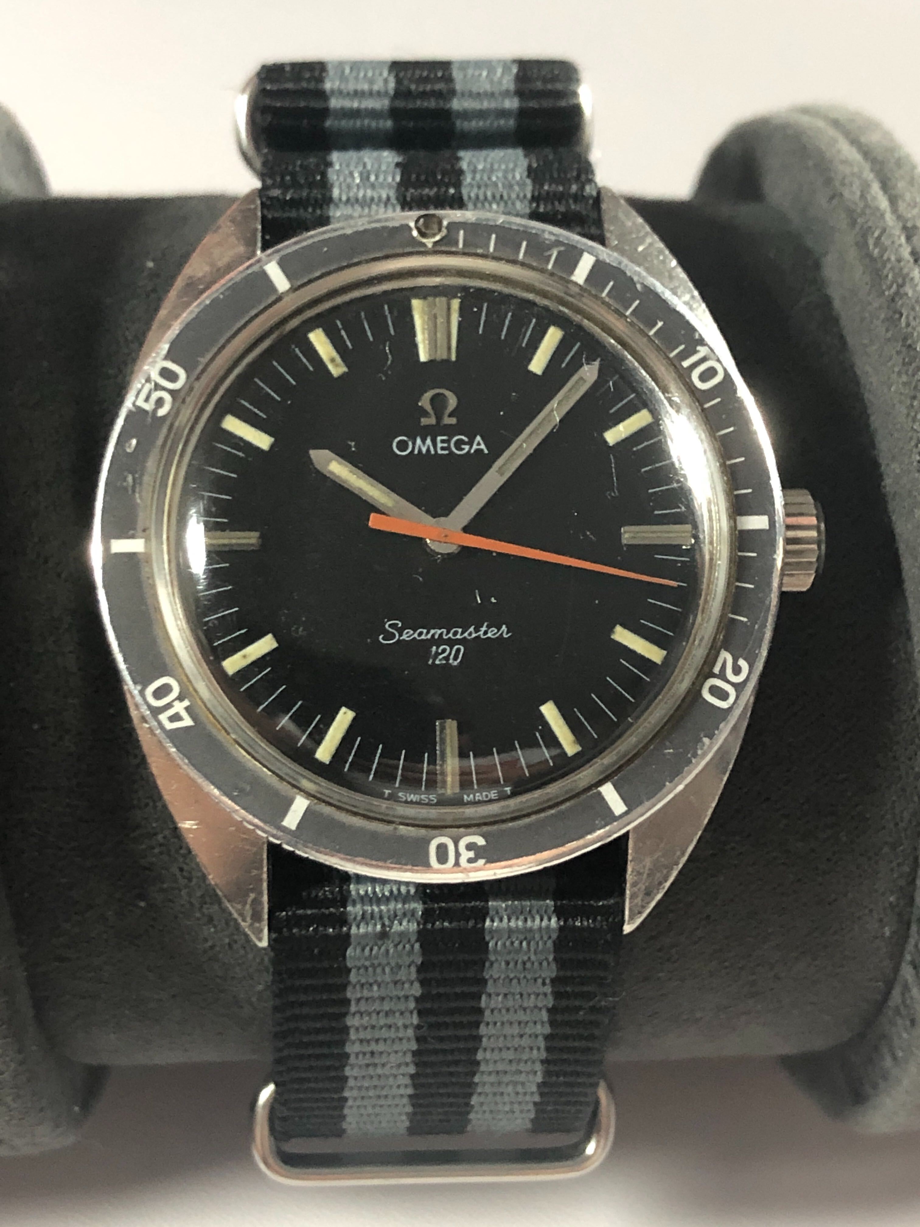

just my 2 cents .. CASE BACK ... original case ref# is scratched off ... in its place a hand scribbled replacement for the case ref# ... food for thought ...
Caseback is original and that was a common practice to change the reference number in the Caseback when they ran out of stock...

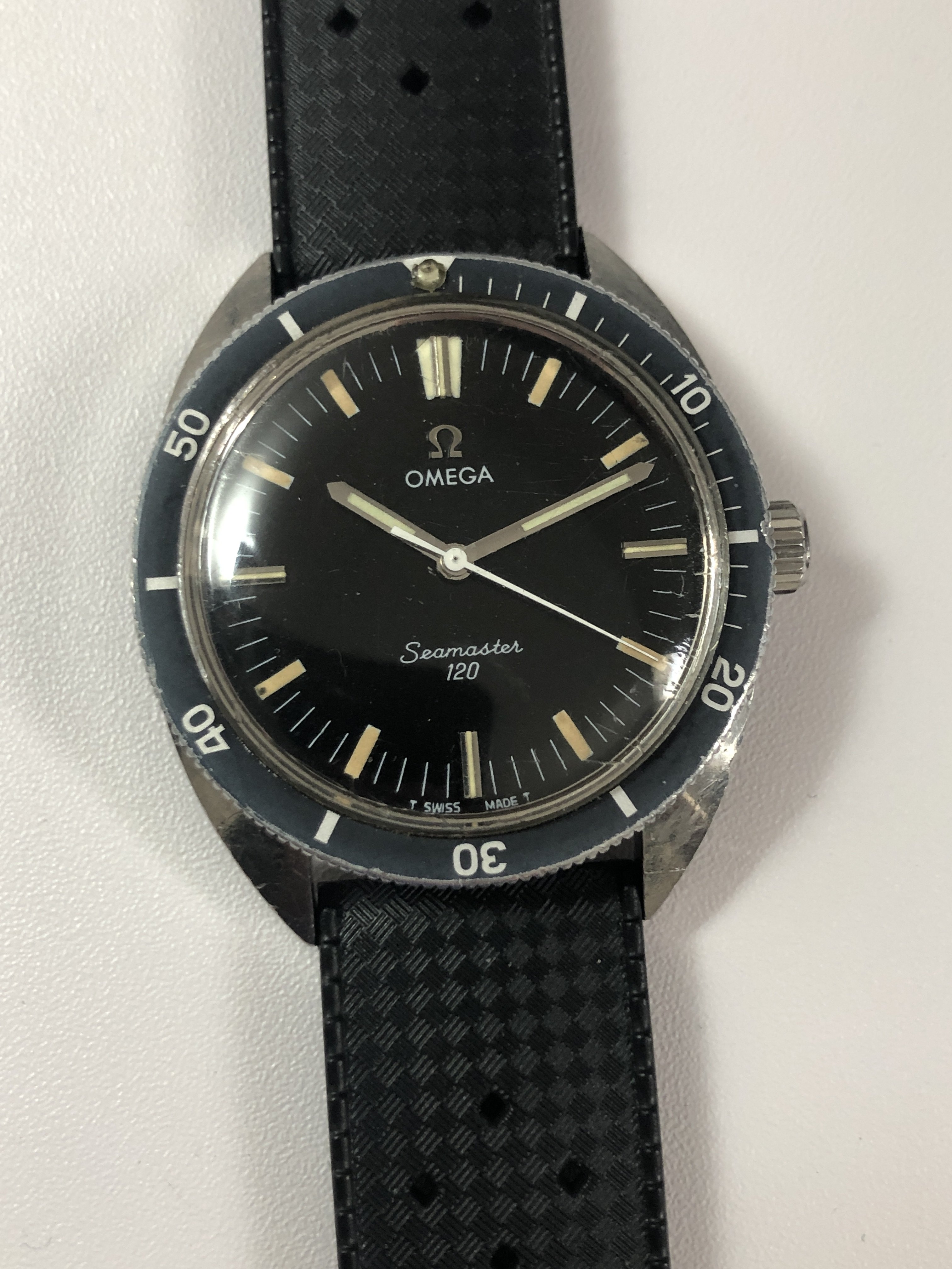

I wholeheartedly agree with the ickiness of creating actual/intentful/explicit Frankestein's/Fake's - I believe these watches are a part of history now, and there's a responsibility to preserve them, that's why when I end up buying an actually good Omega, I don't use it and store it, for this stupid reason, I try to buy beat up watches for cheaper that I can actually use - but if it's not possible to restore a watch, you might as well use an aftermarket part, I don't really believe it promotes fakes either, since all the ones I come across are generic, they don't match the font or the style, even the color (I want to get a blue one for example, but the ones marketed as blue are actually more navy-ish)
I couldn't find a parts list for a complete Speedmaster 120 - I really want to see what kind of a construct the bezel is, I suspect it's like this:
- but I can't asses whether there's a tension ring too inside the bezel or not
The aftermarket ones for sale on eBay seem to be just the plastic parts, and not containing the steel
TL;DR: A lot of aftermarket "Bezel Insert"s marketed, but none actual "Bezel"s
If I got the watch, I'd 3d-print a bezel and attach a bezel insert on it, this way it'll be mine, and when/if it drops, I can just repeat the process
If you guys can't see anything wrong with this: https://www.ebay.com/itm/Vintage-OM...579918?hash=item3433c0e8ce:g:ds0AAOSwhSNfk291 - I'll probably attempt it - I can only see some possible base surface cracks around the crystal, apart from the funky model number approach

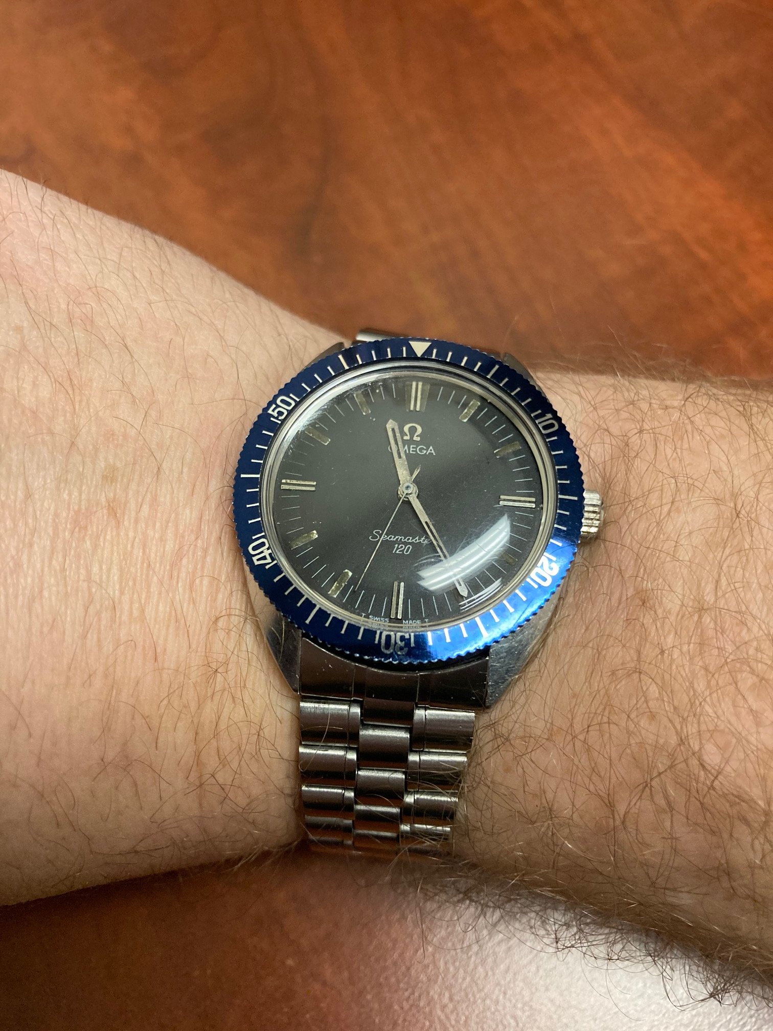

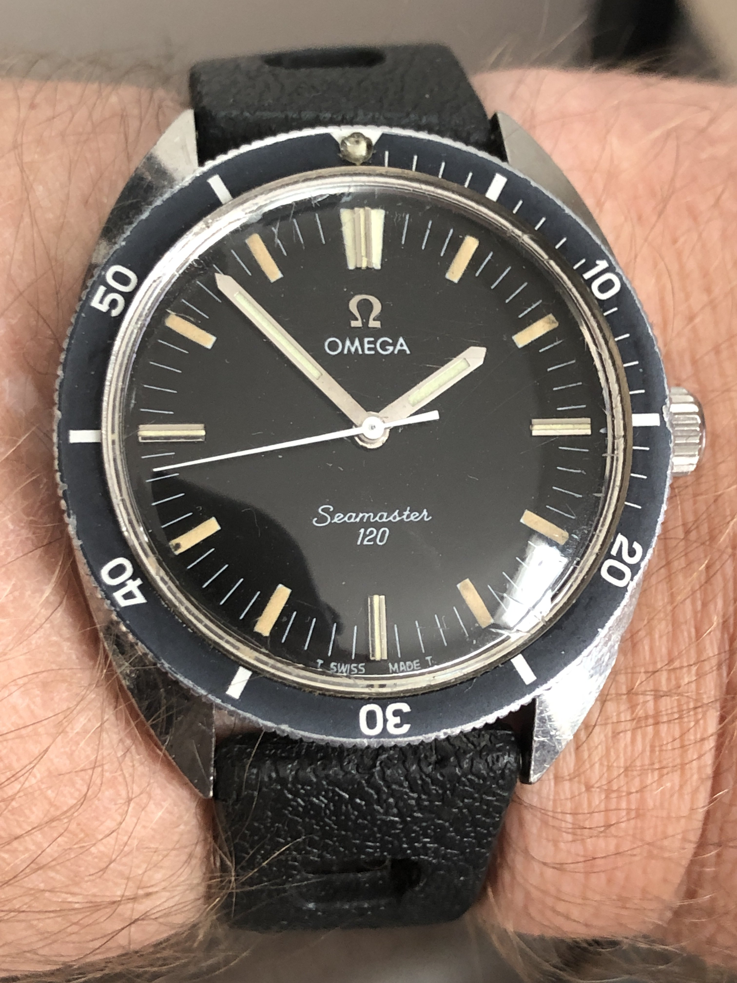

Here is my 135.027 (it's by no means a museum piece lol) with the "franken-bezel" if you're curious. No clue where the bezel came from, the posting on ebay was for a "early 70's skin diver bezel". I think everything else is correct, hands could use a refresh but I gather that is kind of frowned upon? If anyone has the part number for the sweep hand I would be very grateful. I gather not all of the SM 120's came with a white sweep hand?
I had to source a bracelet (thanks OF!), NOS Omega crystal and of course the bezel search is ongoing. I don't want to ever sell it as it has sentimental meaning to me, if the bezel search takes years that's fine with me. I figured this way at least the case is more protected from bumps and dings along the way.
Thanks for sharing it, nice to see how navy looks

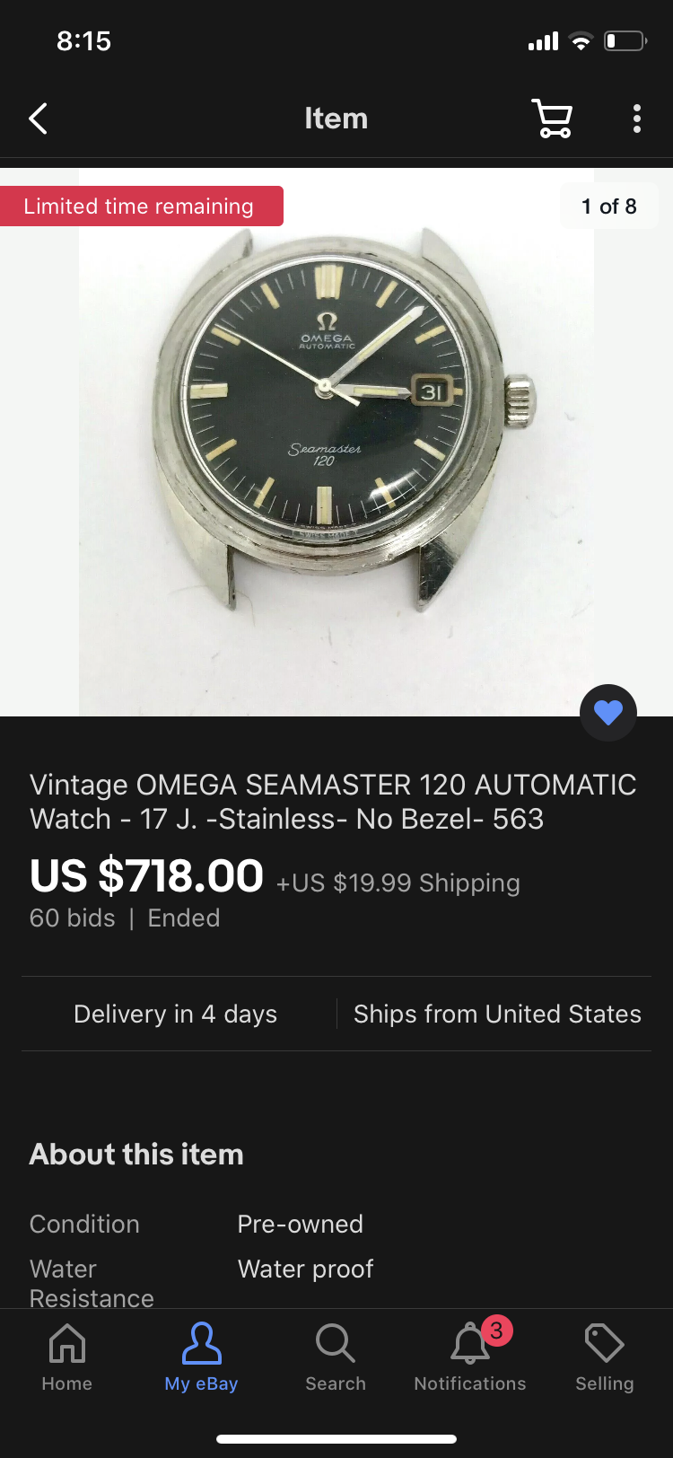

Phew that was a brutal auction, why people pay so high on eBay is beyond me, up until 1 minute left it was $290 and mine (with 560 max, which is my I really want it price), in that last minute it jumped to $700 - ones with bezels can be found around 800's - anyway, it was a bitter end to my quest 😀
I'll be on the watch and hopefully join the ranks one day
Edit: Thinking about it now, it'll probably sell on Reddit for 2.5X the price with a makeshift bezel, as far as my limited interaction with vintage watches, flipping and people over-paying extreme amounts seem to be the drive
Ended auction page here for posterity
If that one had the bezel it would have gone for twice if not more.
The days of $900 SM120’s is gone. Finding a real one in decent shape, with attractive lume for under $1.5k is a challenge- if not unheard of lately.

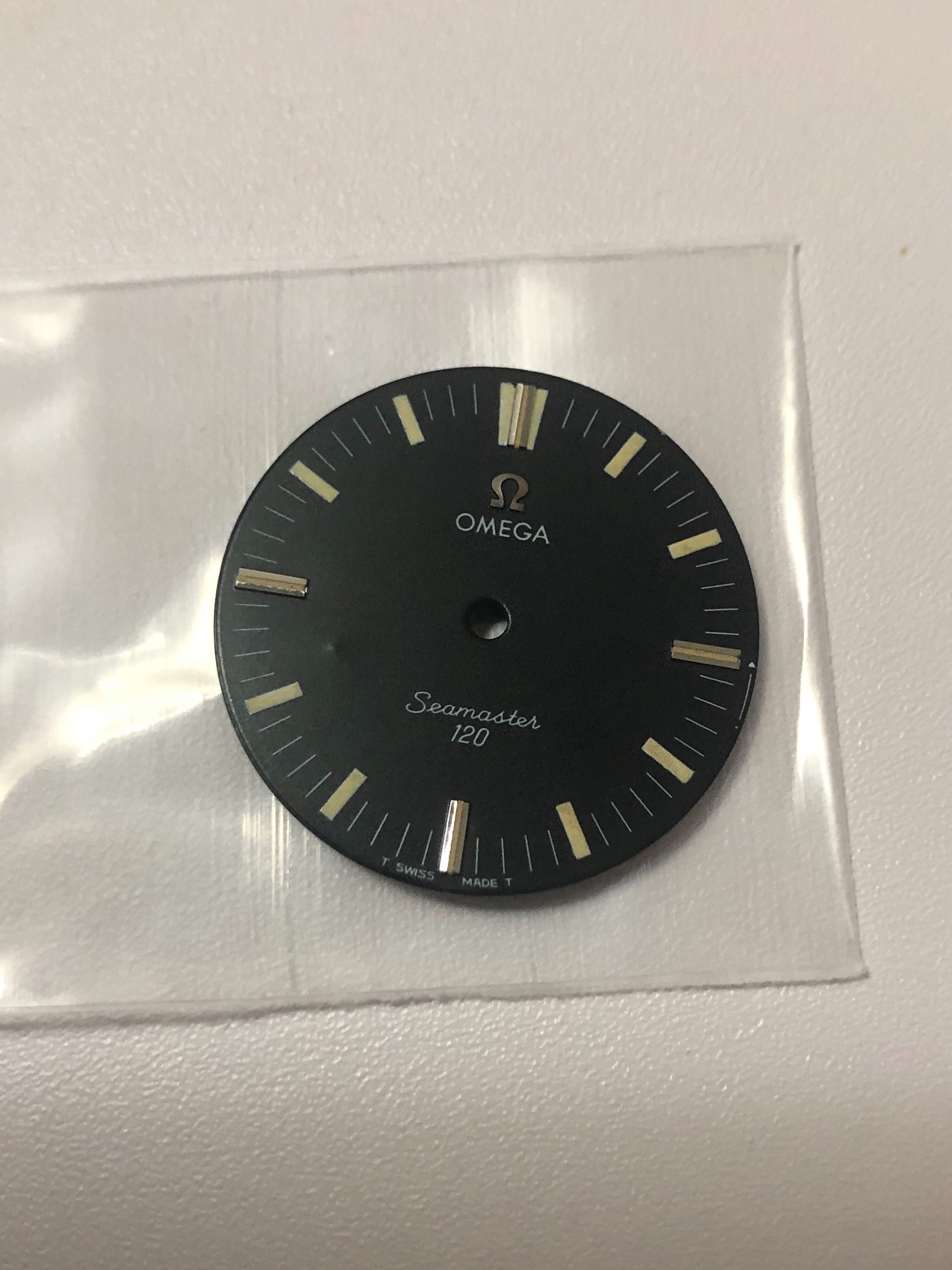

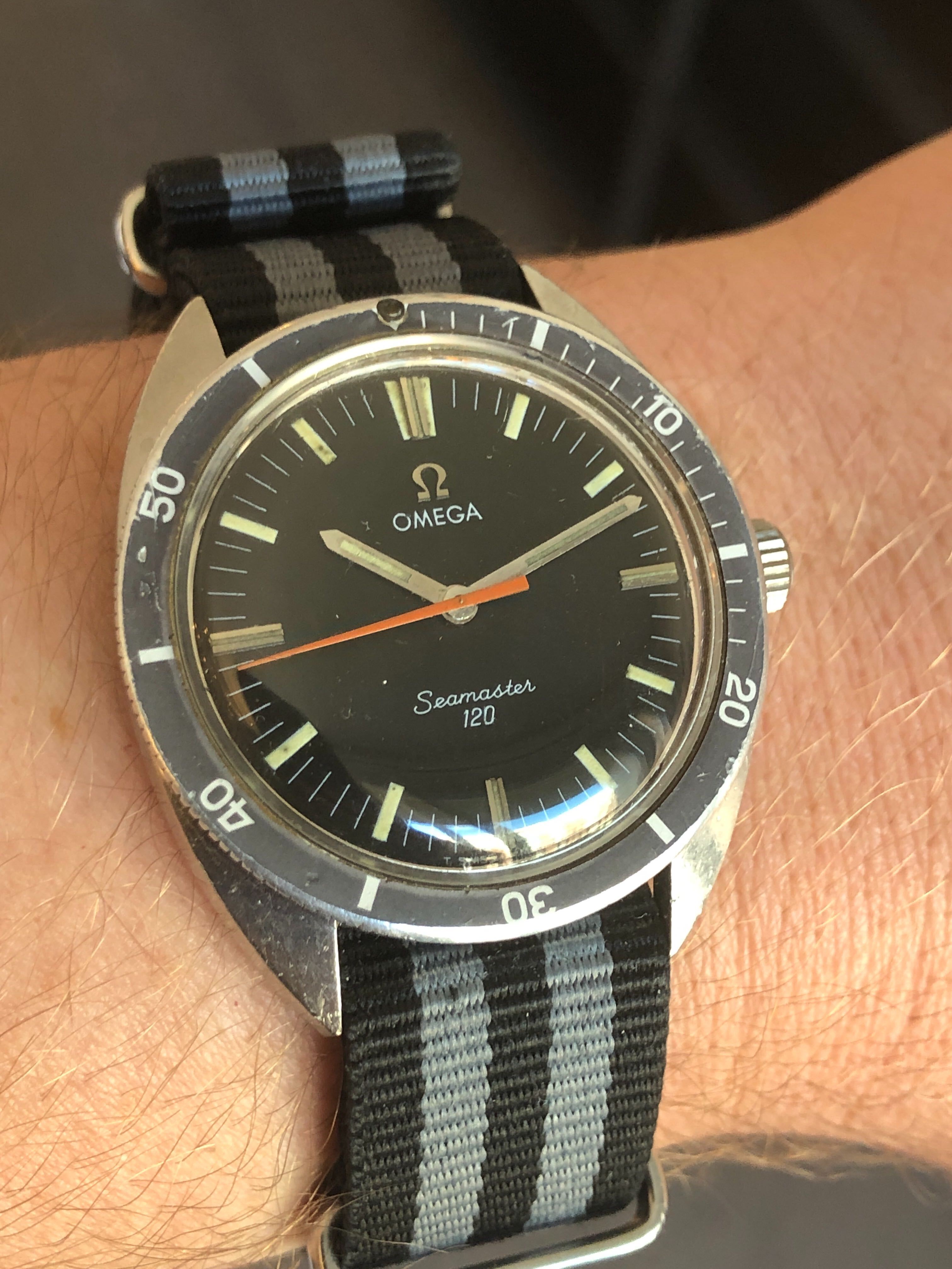

(I've got a 135.027 that I believe was relumed, and I might use the dial I sourced to replace that existing dial. Will post pics later, I'm interested in other's thoughts.)

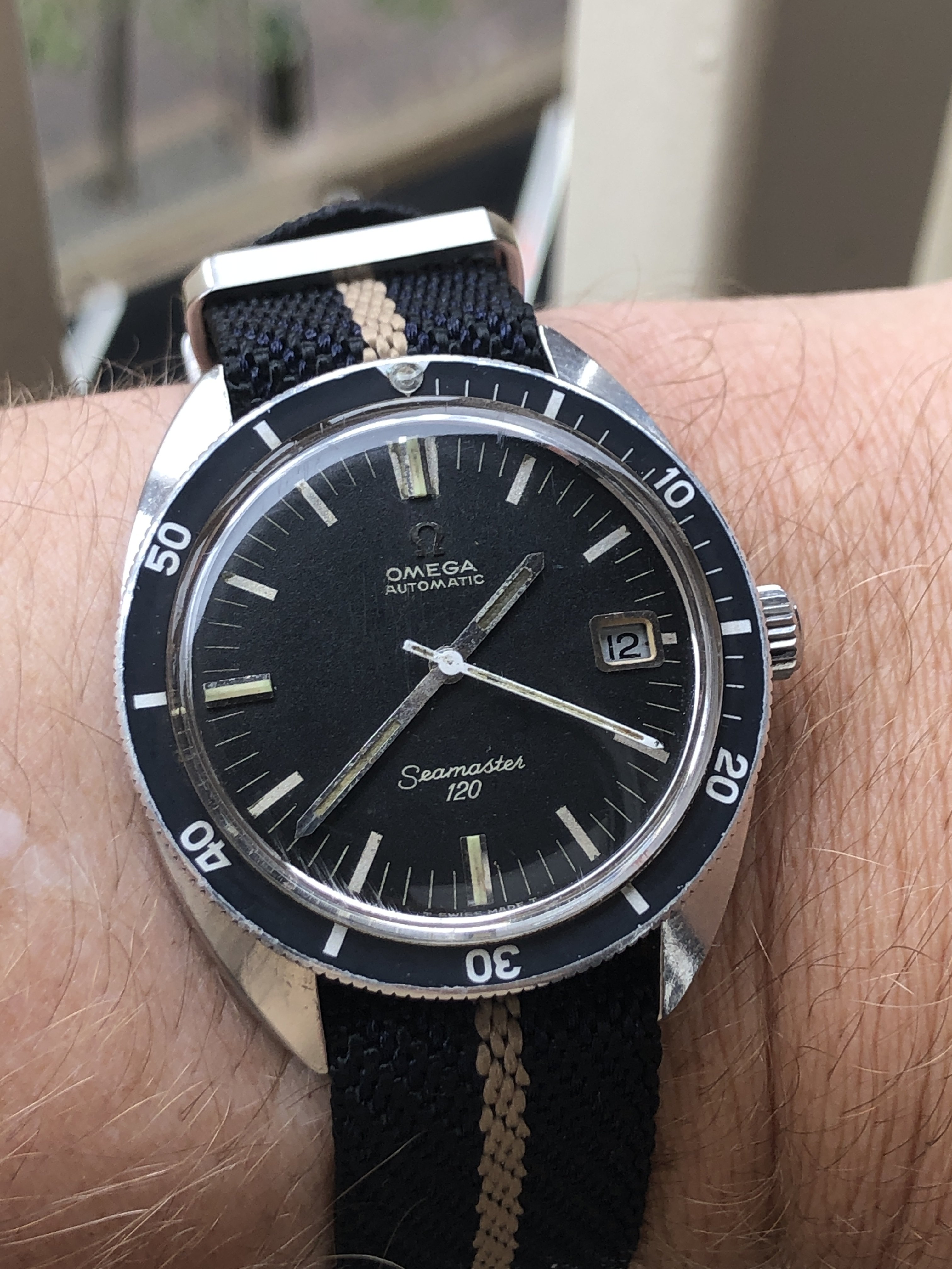

I bought this watch from the original owner who got it as a high school graduation present in 1972. He told me he had it serviced in the mid-80s and the main spring was replaced. He stuck it in a drawer at some point when it started running fast, and it sat there until he sold it earlier this year.
I asked him if he had the lume reapplied at any point, and he said he didn't recall that happening. To me the watch looks like it was most likely relumed at some point, possibly during the service in the 80s. The hands and marker at 12 look to be original to me, and the rest of the painted hour markers look like they were relumed. What do others think?
I own this dial, and I've been considering having installed when I get the watch serviced. (It's been sitting patiently in the queue for about six months now.) There is a bump between 8 and 9 that is barely noticeable when wearing. If I had the dials swapped. I'd most likely hold onto the original dial.
What do you think? Keep it original or go for the even lume?

Well if it's going in for service anyways why not! I wonder if they could sort out the bump as well? I wonder if it works like on cars where you can use dry ice to pop dints back into shape 😀

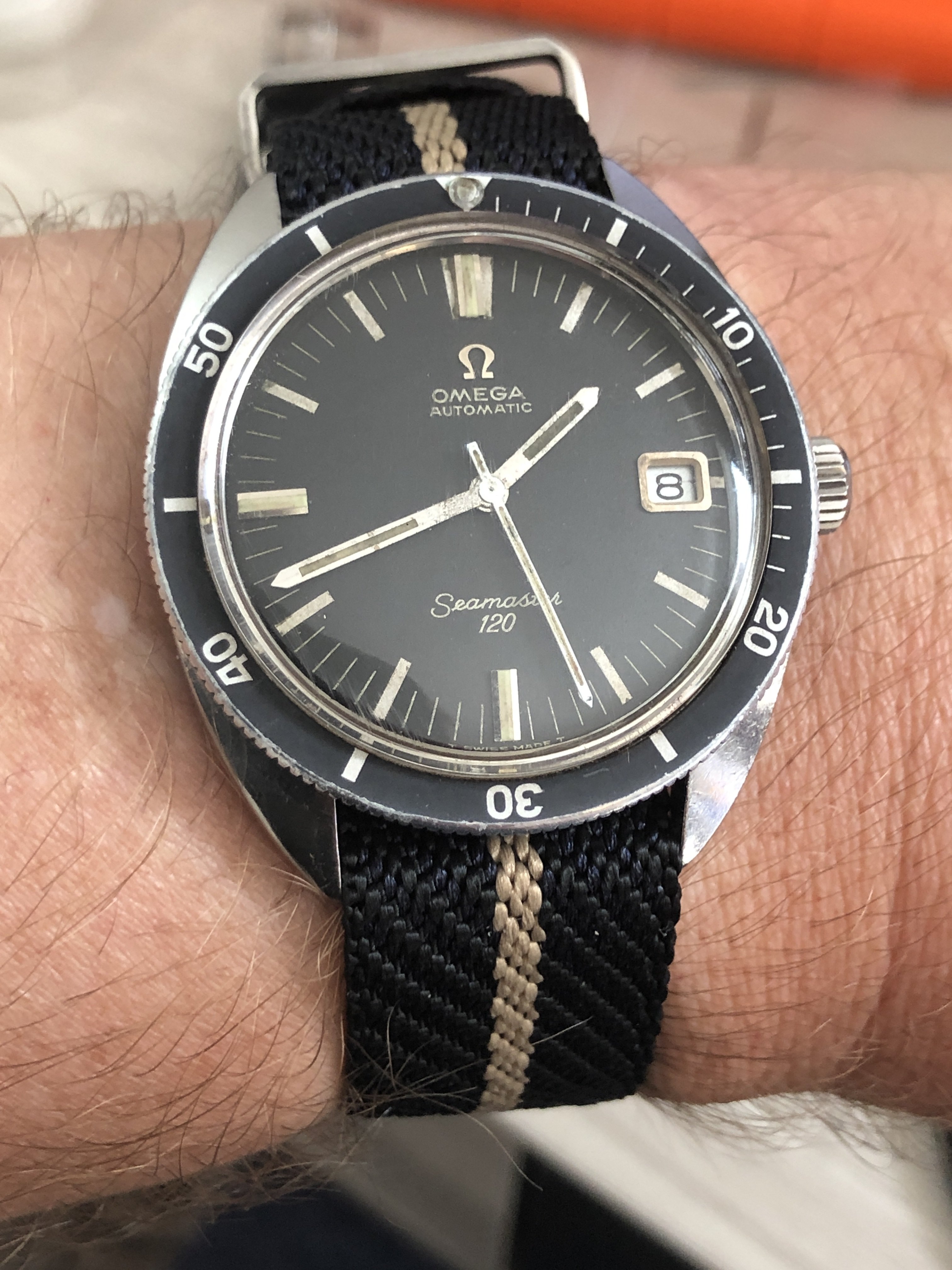

That was why I was bidding on it. Take a look at my next watch:
As has been discussed lately https://omegaforums.net/threads/opening-a-can-of-worms.121685/page-2#post-1633730, this dial had some lume that was on the swampy end of the mossy range, so I cleaned it from the dial. I'm planning to get a sympathetic relume done some time soon, but I wouldn't have minded swapping in the dial, hands, and date disc from that ebay watch if I could have gotten it for a price that worked for me.
...and here's one more for kicks (I know the second hand is not correct.)
There is no dent on the the back of the dial, so the bump must be a different kind of defect. If I installed it, I'd just leave the dial as is. I'd rather not risk any damage trying to improve on its condition.
