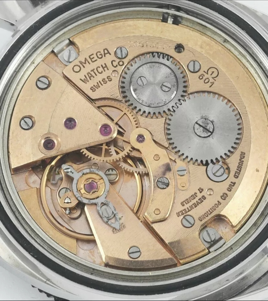

Subject to the limited amount of photos posted it looks like a pretty decent example of a 165.027. This happens to be my personal favourite out of the four Seamaster 120 models - automatic movement without the date complication - and is generally thought to be the hardest model to find. It is also worth noting that it has the lumed seconds hand which is not seen very often.
Is it possible to get a photo of the movement (should be cal.552)?
A Seamaster 120 would certainly be a very nice first vintage watch subject to getting one for a fair price relative to the condition and whether it has had a proper service or not.

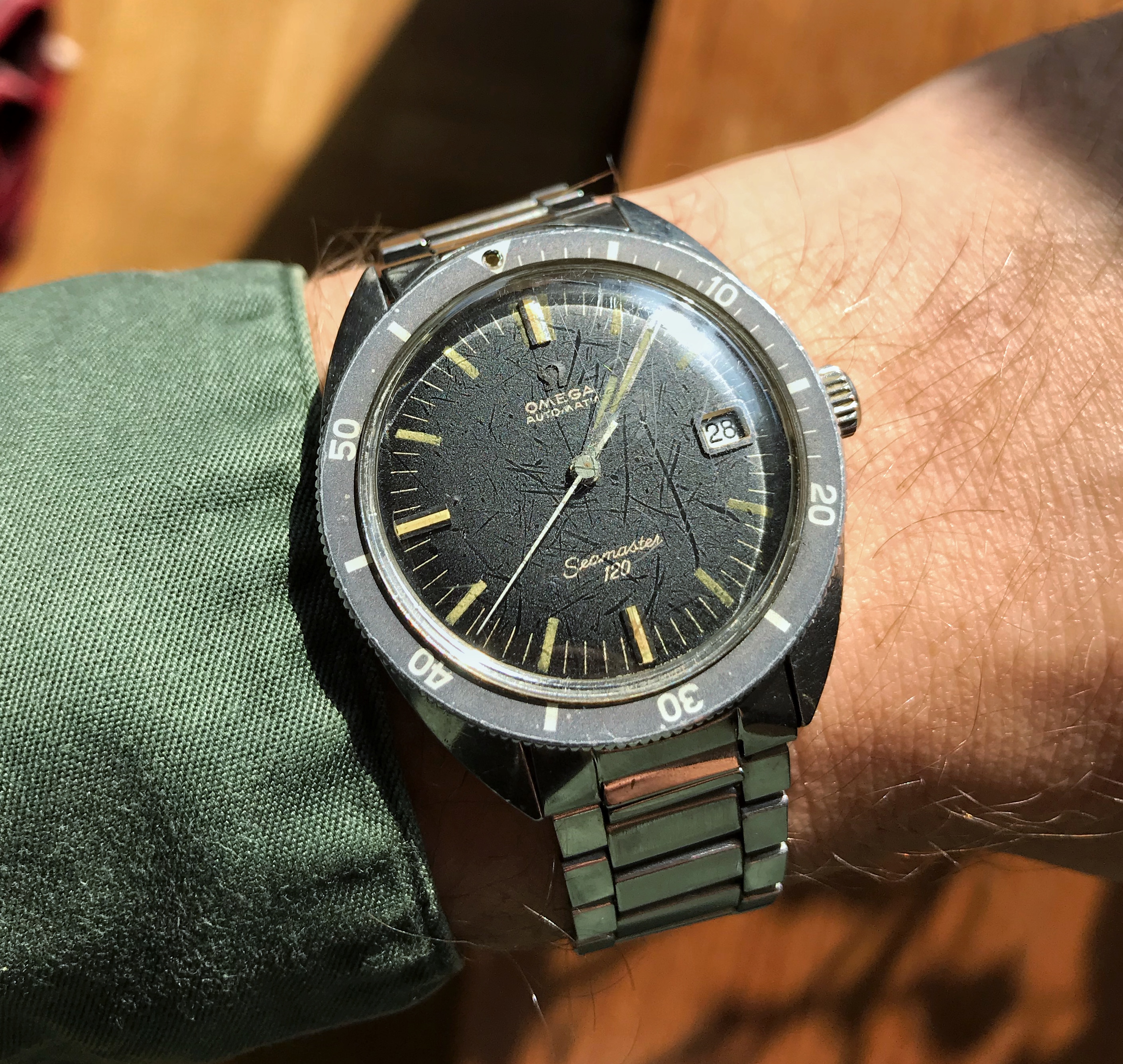

IS this ladies 565.007 correct? Print on the dial is faint but apart from that I think it may be ok.
I bought it years ago for my then missus but upgraded her to a speedy. Been lay in the watch box for a decade since
Well, Cal. 684 is a movement with a calendar, so as this is a no date dial, something is certainly off...this should have a Cal. 671.
Also the dial is missing the text 'Automatic'.
Indeed - I wasn't sure if the smaller dials had this, but I looked up the dial for this and yes it should have Automatic on it as well. Good catch.

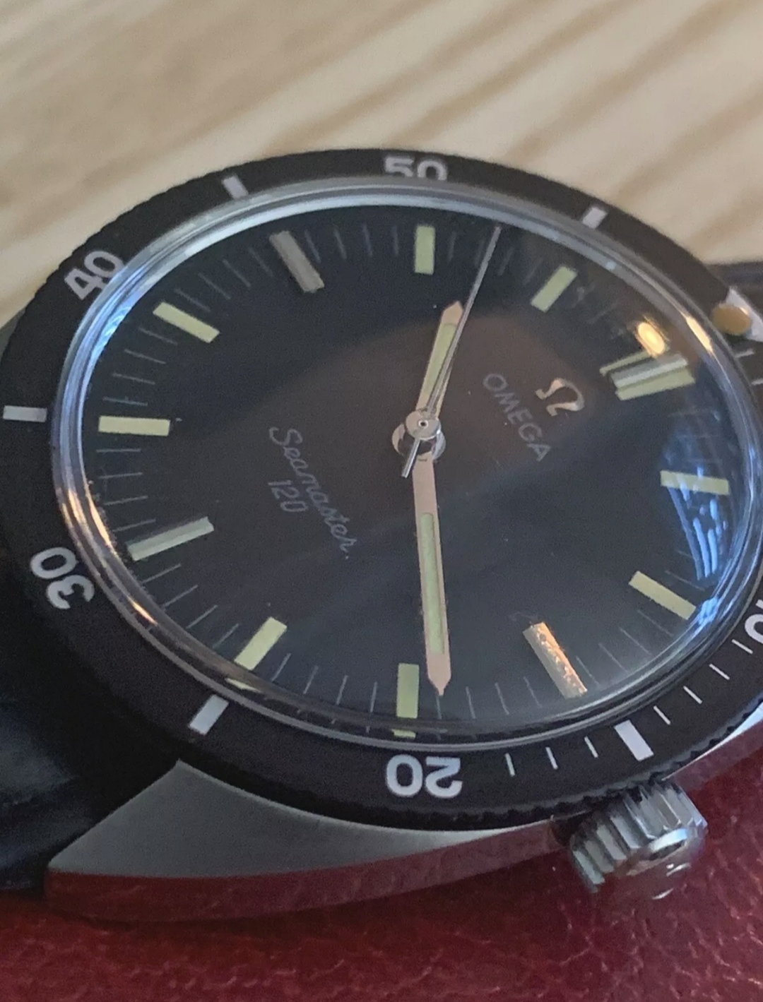

Hi, I just got this beautiful sm120 yesterday. Everything looks legit to my eyes, but Im wondering if the movement starting with 25xxxxxx is okey? Cal 565 of course 😀 Also, mine came ona 7912 64/2 #6 braclet and endlinks, is that period correct?
16,305
45,025
Thanks.

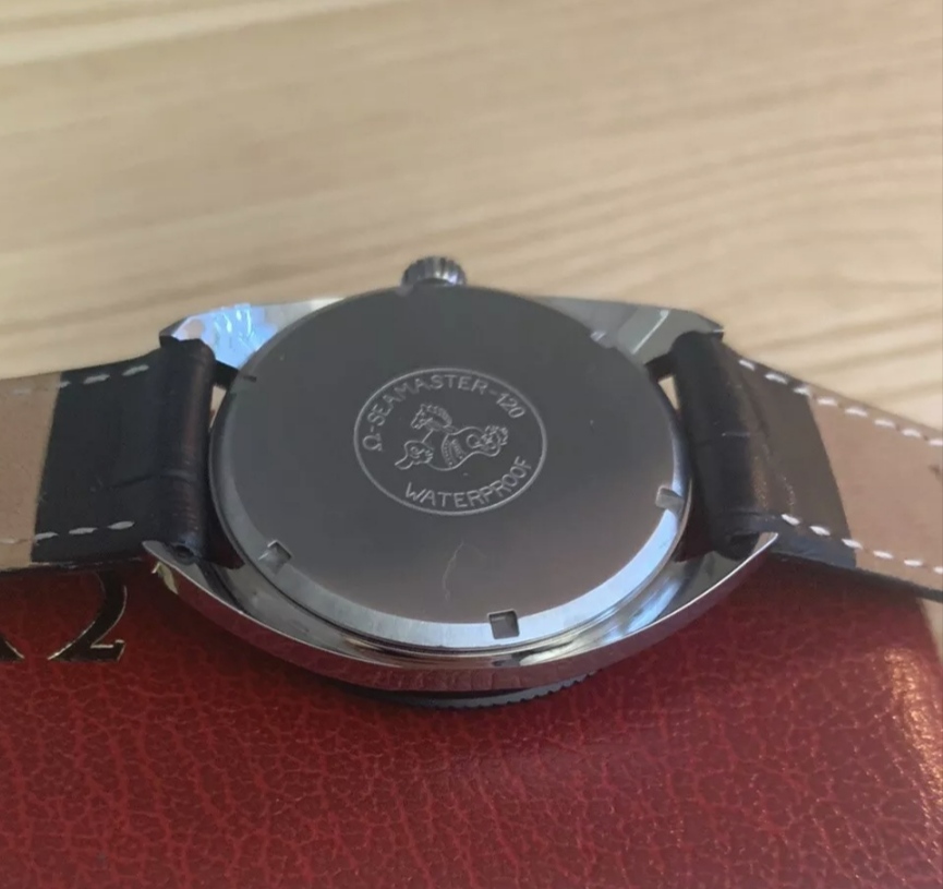

These were sold as a "kit" for a little while. The first give away is the ight grey text- it should be bold white. When you start looking at the details compared to real ones you see the differences.

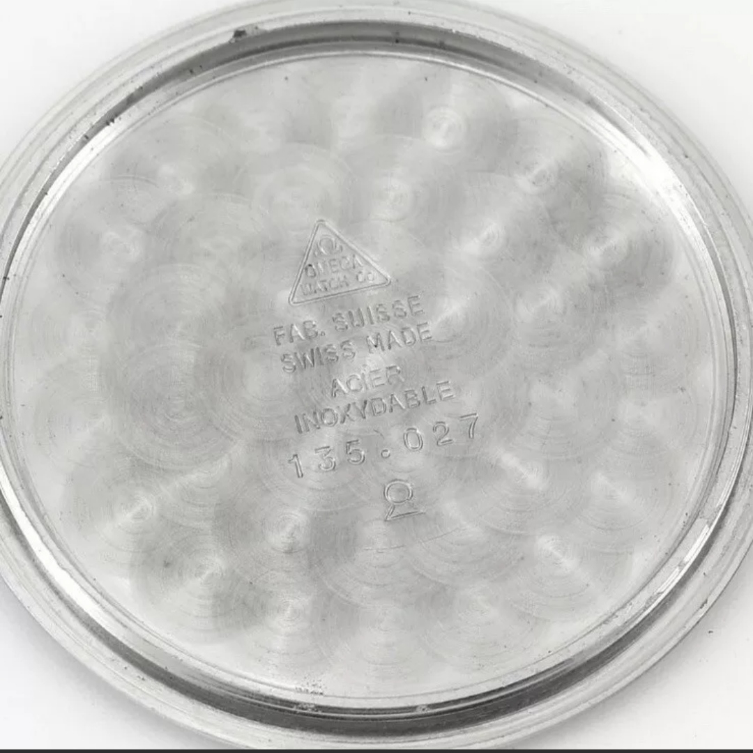

just my 2 cents .. CASE BACK ... original case ref# is scratched off ... in its place a hand scribbled replacement for the case ref# ... food for thought ...
