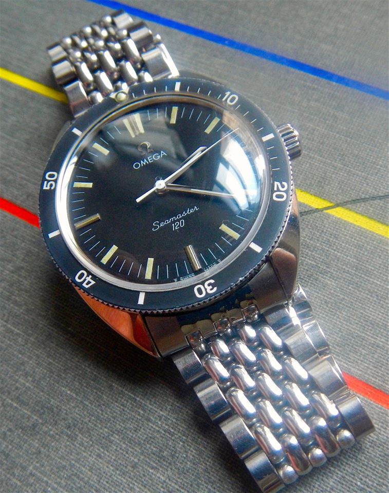

I picked mine up for $900 with non-original hands and crown (both being corrected as we speak), so deals still can be had. This one looks nice and with the bracelet makes it it a bargain. It also has the white lumed second hand which I believe was a rarity- there was a thread on it here and I’m sure someone with one can chime in.

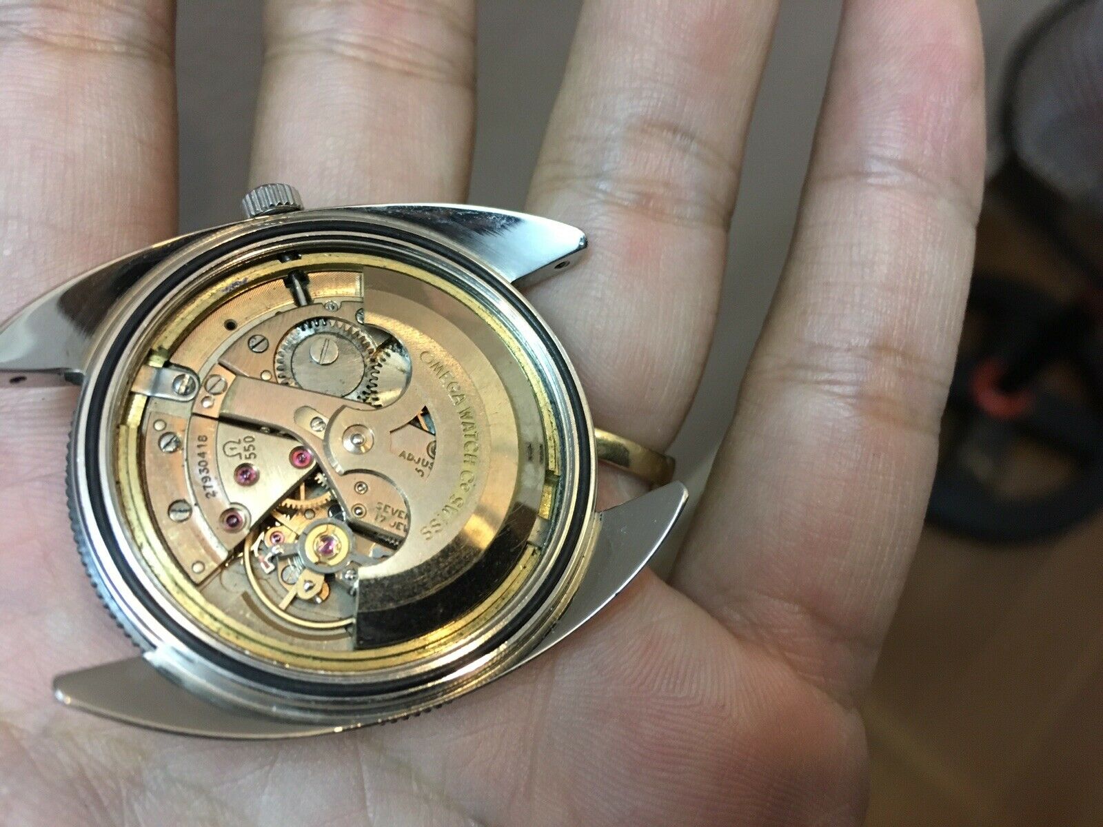

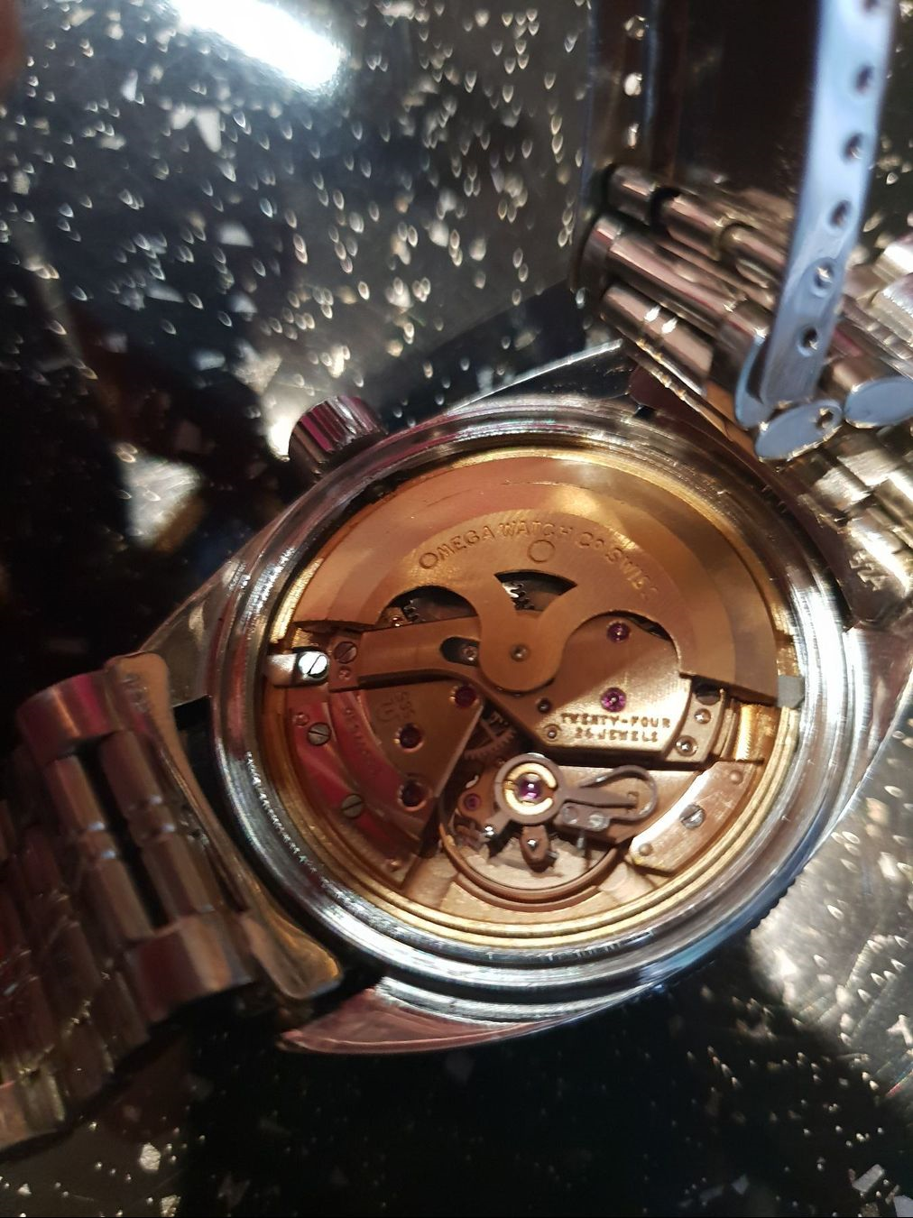

Received now as well Pictures of the movement. Everything except the crown Looks legit in my opinion.

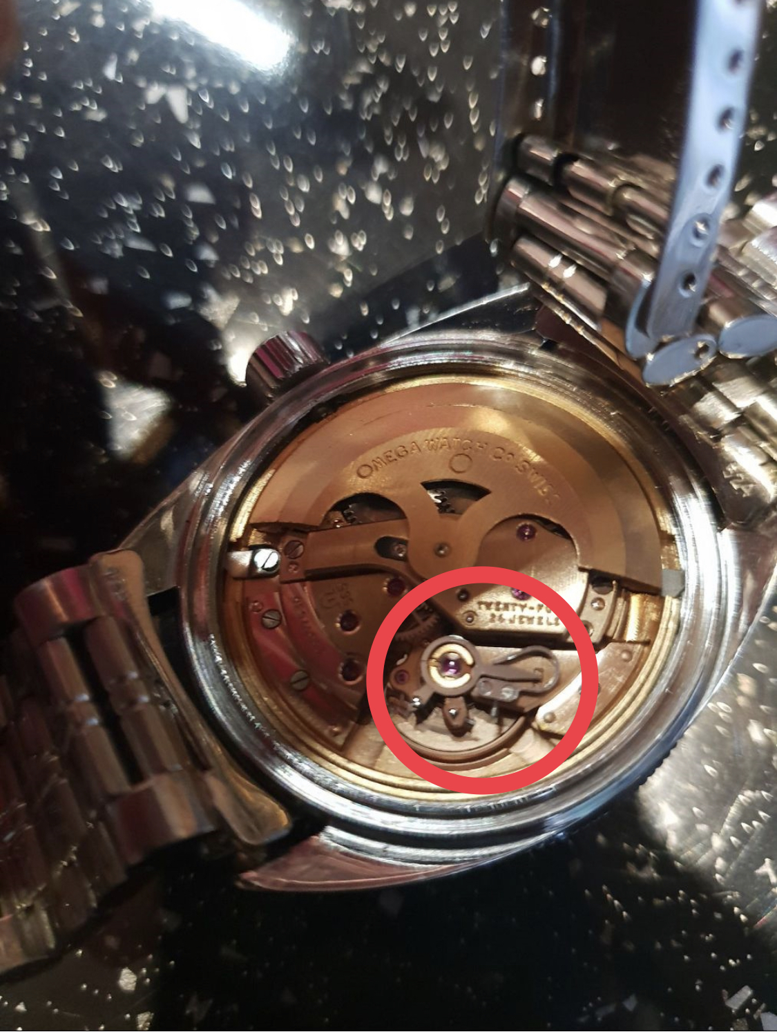

I’m definitely no experts on movements but on the ones I’ve seen the highlighted part here is nice and shiny.
Anyone knows if there is anything worrying about this?

Looks good to me. Crown is easy, don’t even sweat that. Even if it were orginal, you would want the change it during service since the gasket inside would be hard as a rock.
323
1,134
24 jewel 565 caliber movement is correct for the 166.027 which is verified on the case back. Serial number is out of focus so can’t check against tables available for approximate year produced. I don’t have an issue with the discolored movement part.

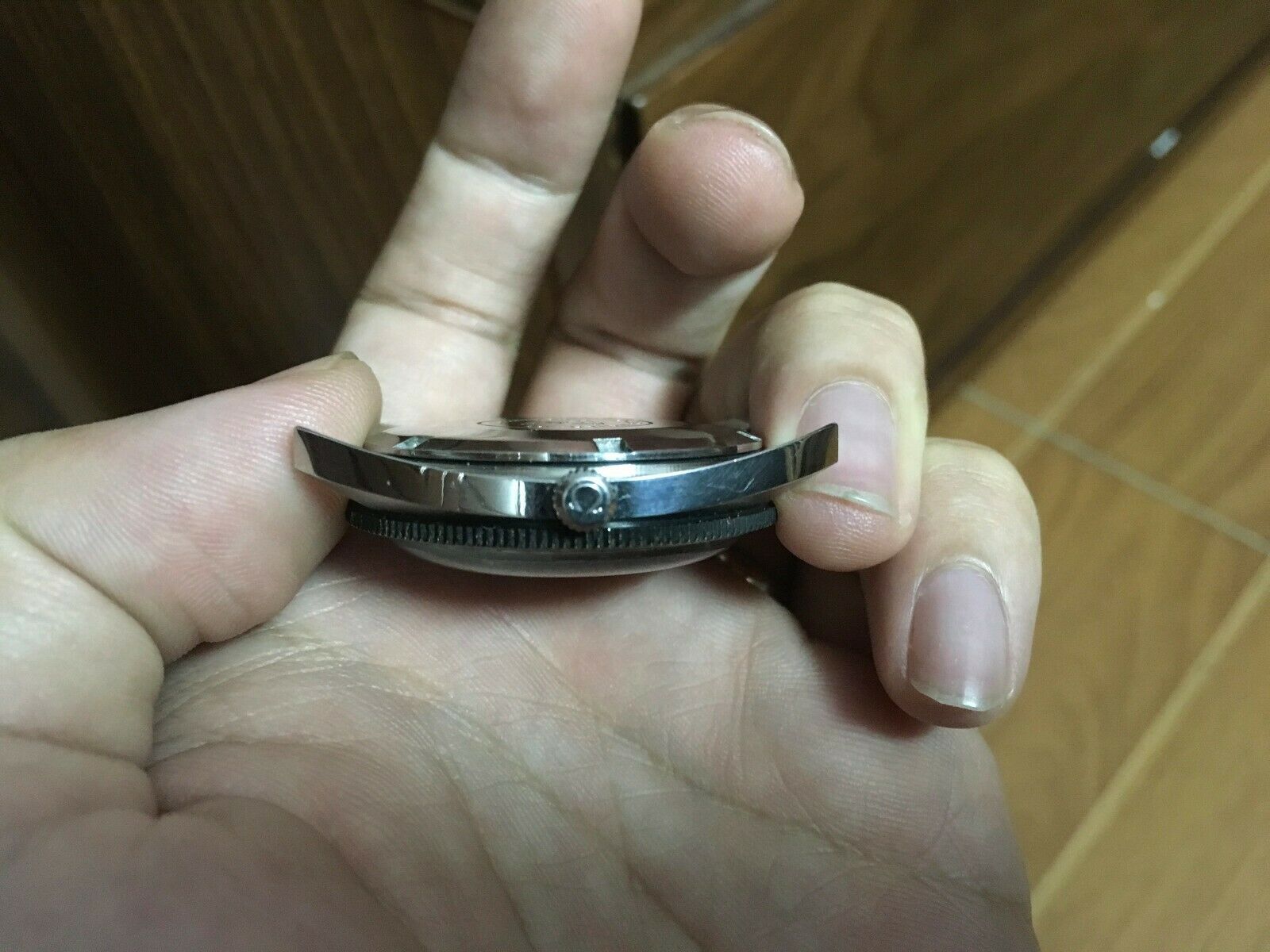

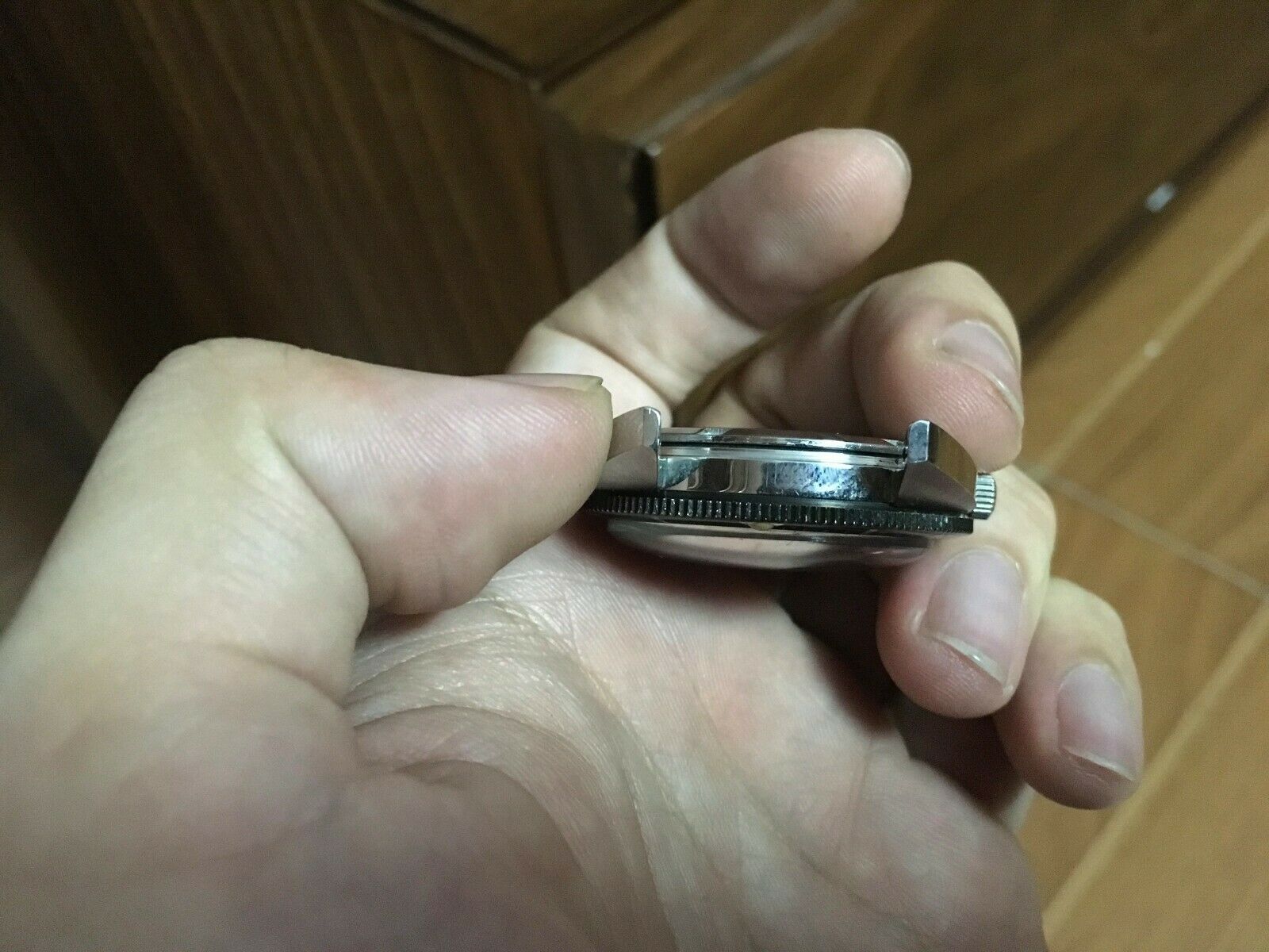

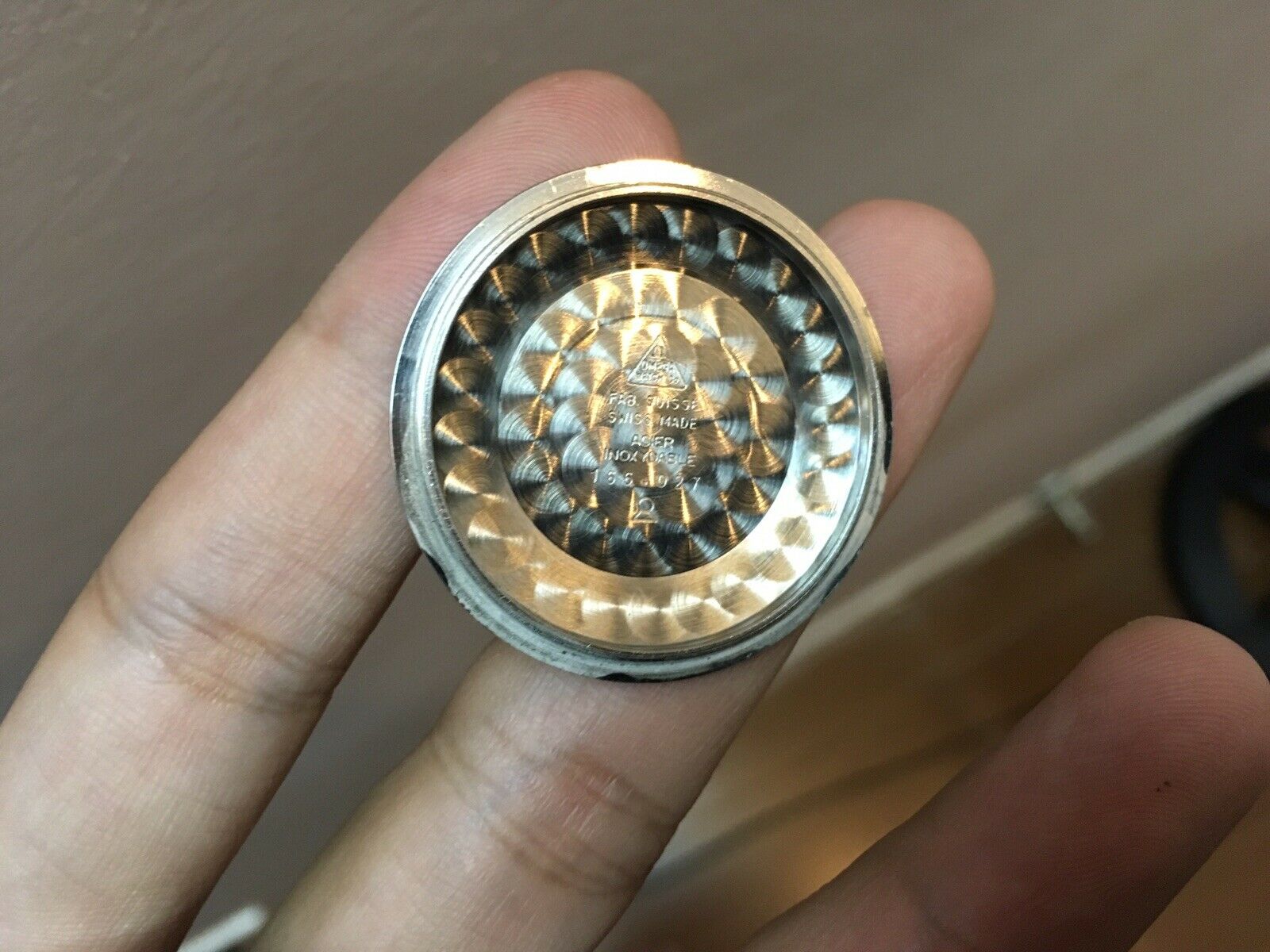

Ahh, unfortunately there was another bidder which went up too high. Want to spend max 1500 USD. Quite unfortunate.
But I'm watching two other watches. And actually I like them more as they are no date versions (not a huge fan of the date function) and do not have an engraving on the back case.

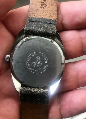

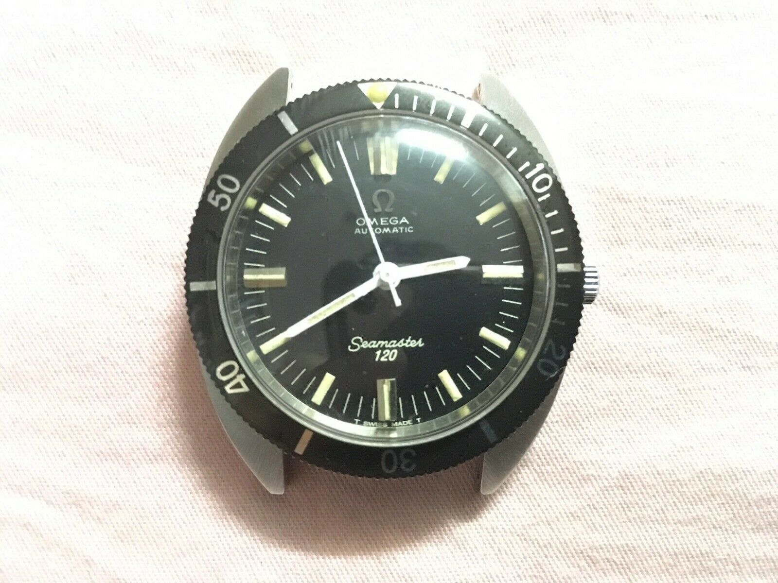

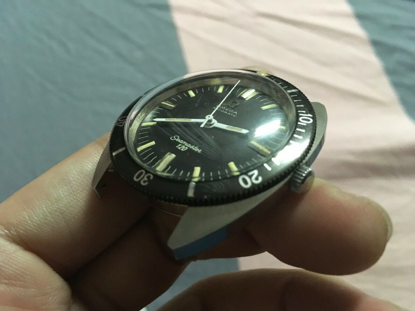

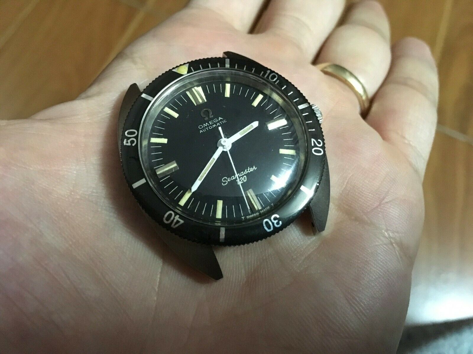

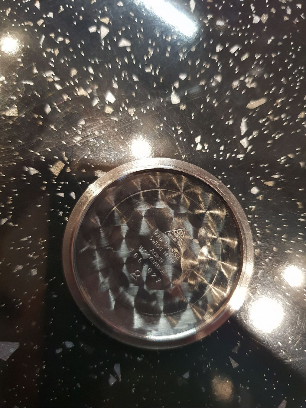

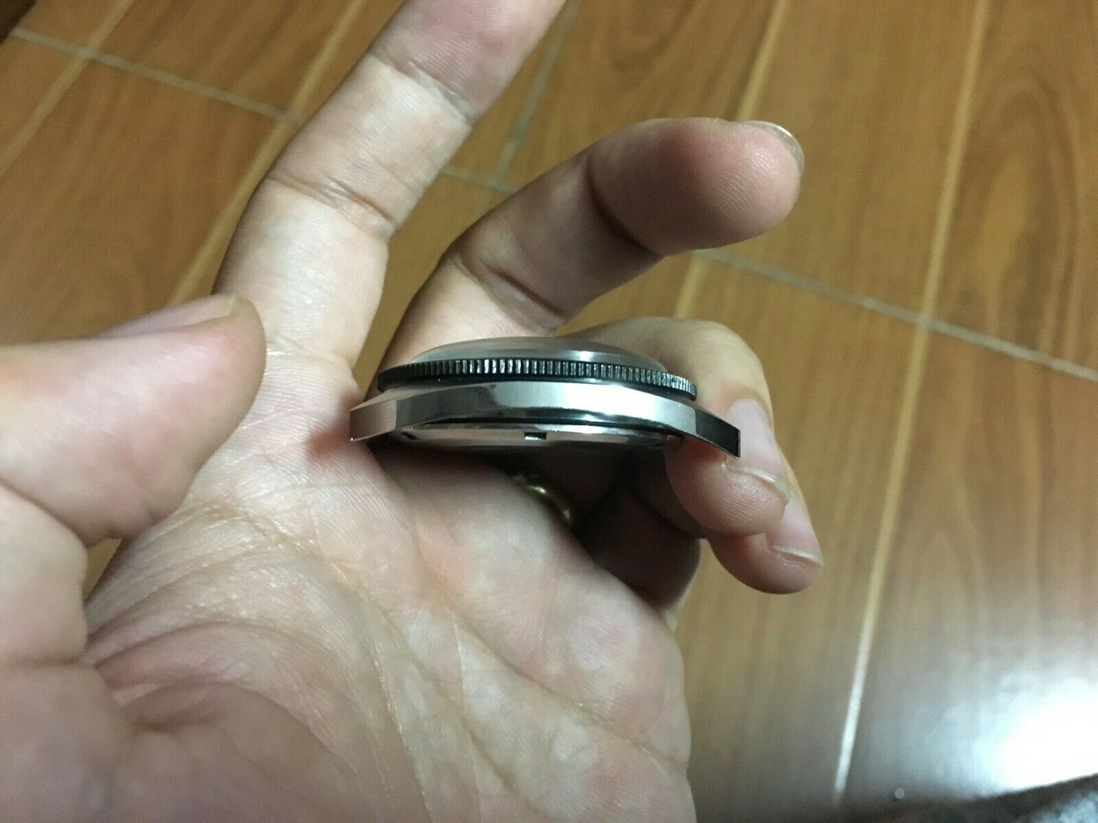

This one from Vietnam. As far as I can tell a 165.027. What is odd for me is that it is supposed to be a 165.027, but there is a 550 Movement instead of a 552 and the caseback tells 166.027 instead of 165.027. So a Frankenstein watch?
137
70

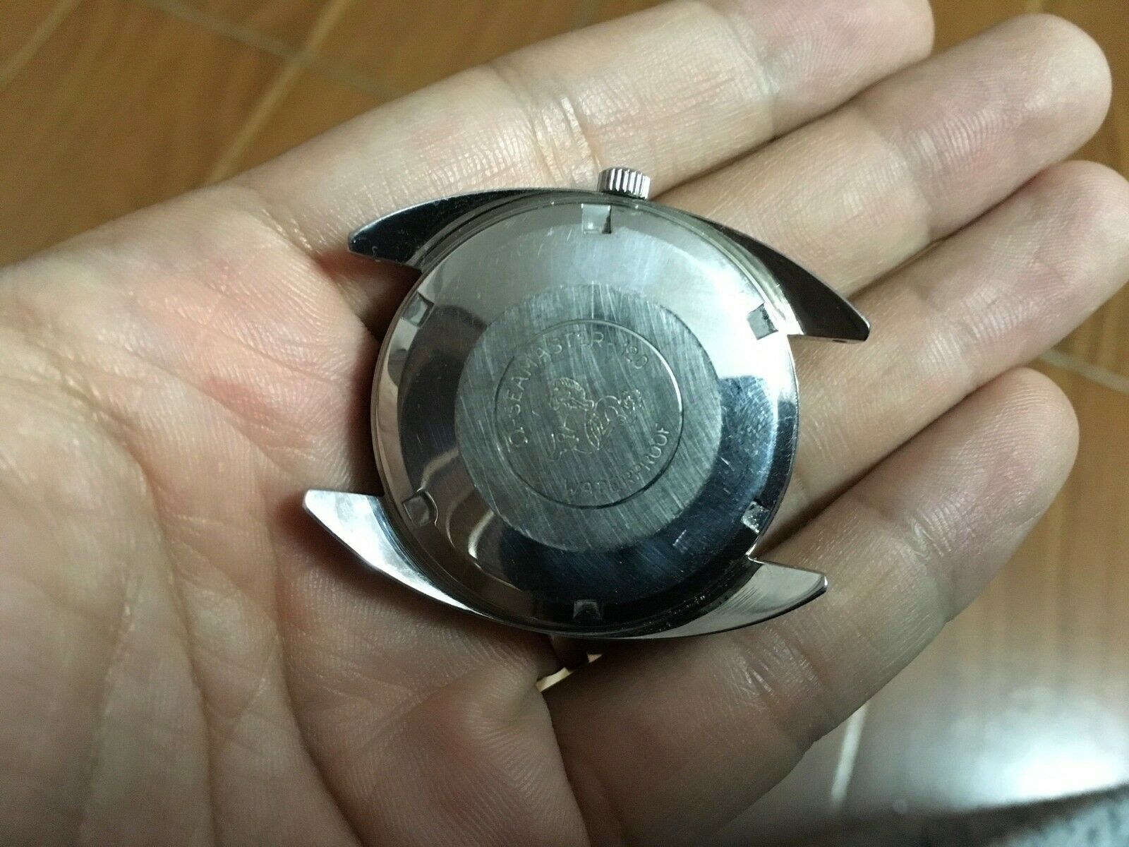

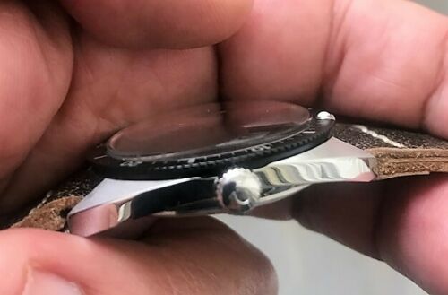

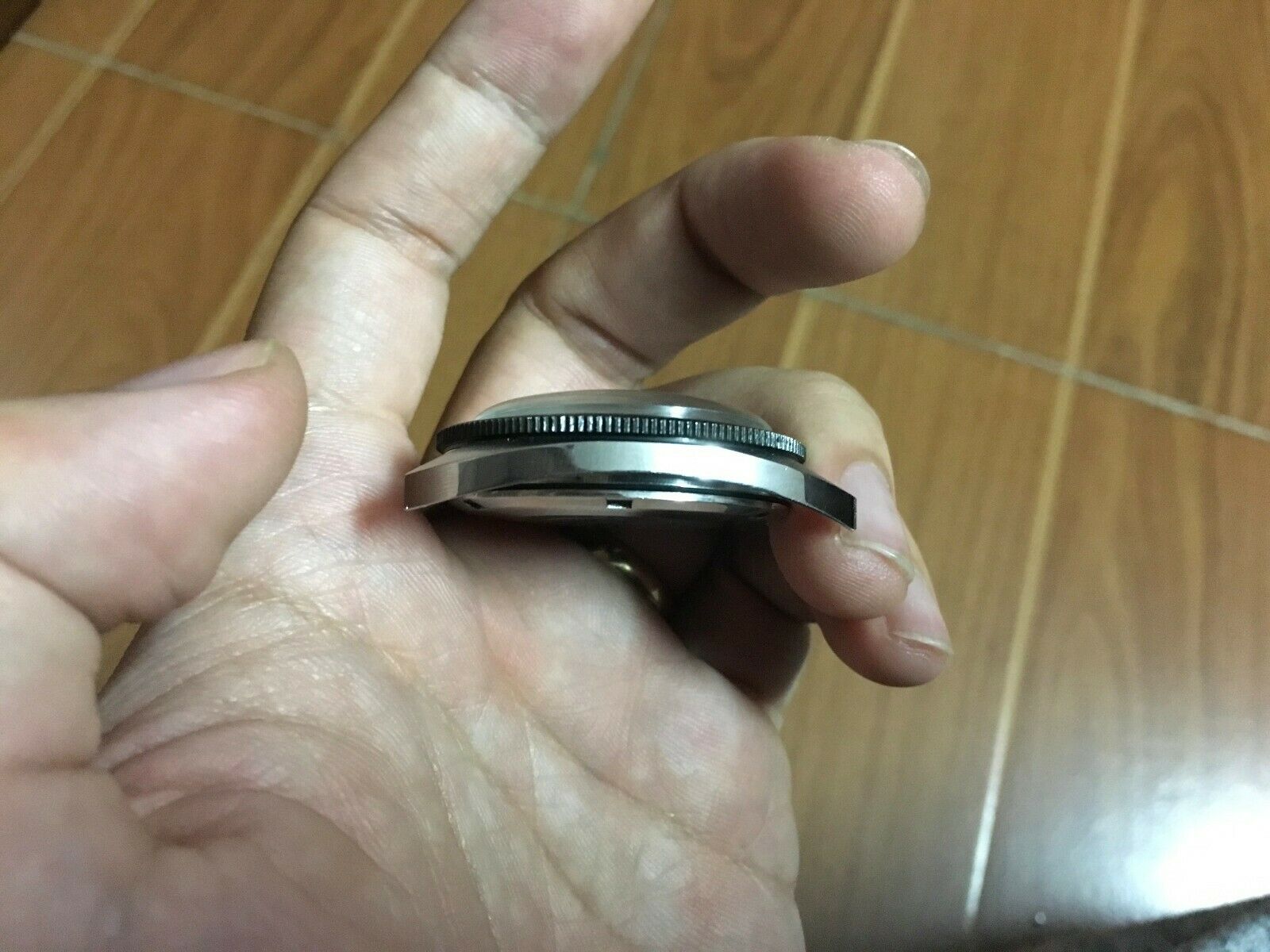

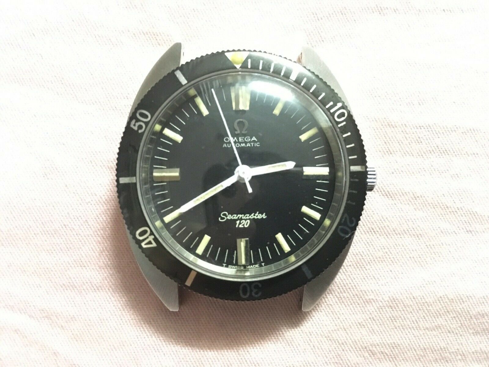

The second one I'm Looking at is one from italy. According to the seller freshly serviced.
Is supposed to be a 135.027 Manual Movement, No Date, Caliber 601. Unfortunately without any Pictures of the movement. But this one Looks genuine to me. What do you think?
5,026
18,608
Avoid too!!!
5,026
18,608
I dont believe that's a genuine 120 bezel. And if you look at the caseback and compare this with dial, hands and bezel.. Well. This watch was worked on IMHO...
5,026
18,608
But I must say it's beginning to be very hard to tell nowadays if a 120 is genuine or not. You almost need to have the watch in hand to be sure.
137
70
Agreed. The first one was obvious. But the second one looked good to me. But yes, Bezel seems to be in a too good condition for a 50 year old watch
5,026
18,608
Unless the whole watch is like NOS I would start buying a 120 with a lightly faded bezel. You have better chances you hit the jackpot.

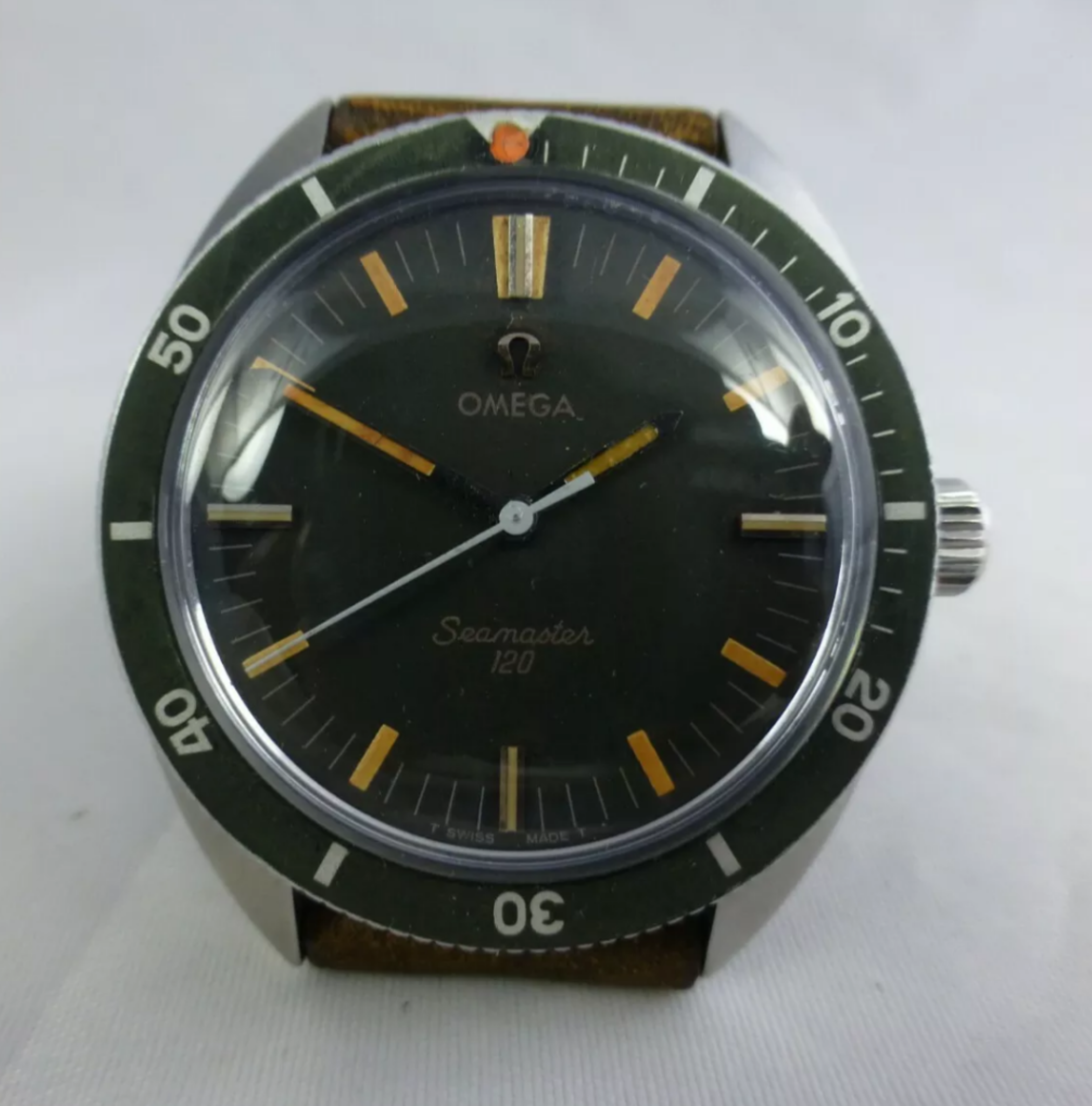

SM 120 is on my "must have" - list. Haven't done proper research yet, but his one says no no right away.
16,305
45,025
That’s the Tangarine Dream edition.

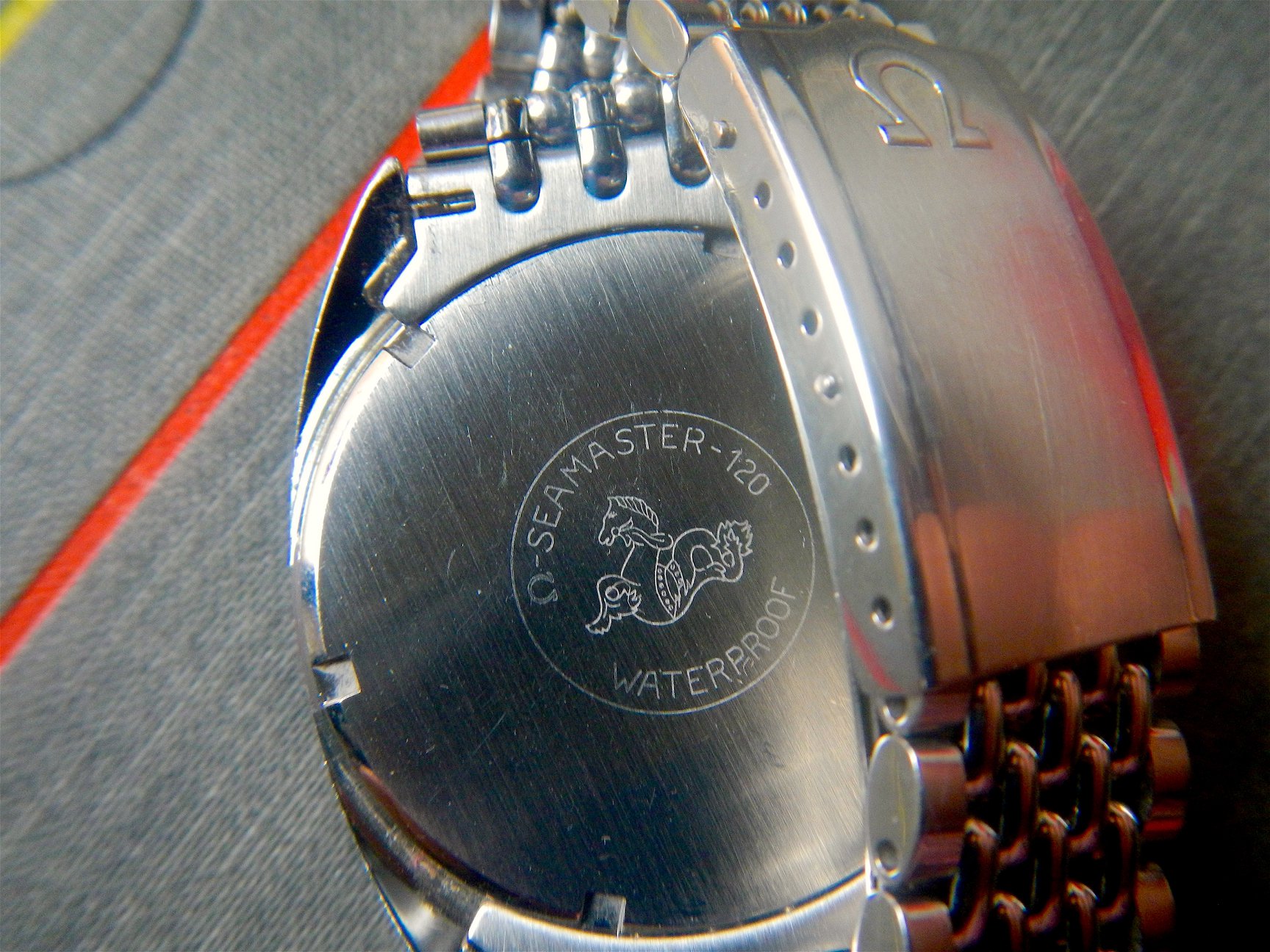

Omega Seamaster 120
" SKIN DIVER "
ca. 1967

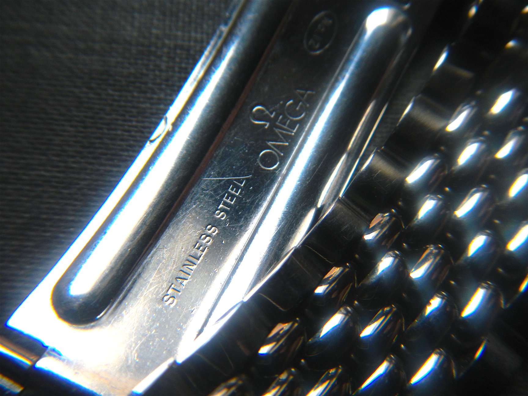

* paired with Omega ref#. 12 Beads of Rice bracelet with ref# 517 end links @ 19mm
[ original Omega SS bracelet for this model would be ref#. 1098 SS bracelet with ref# 547 end links @ 19mm ]
