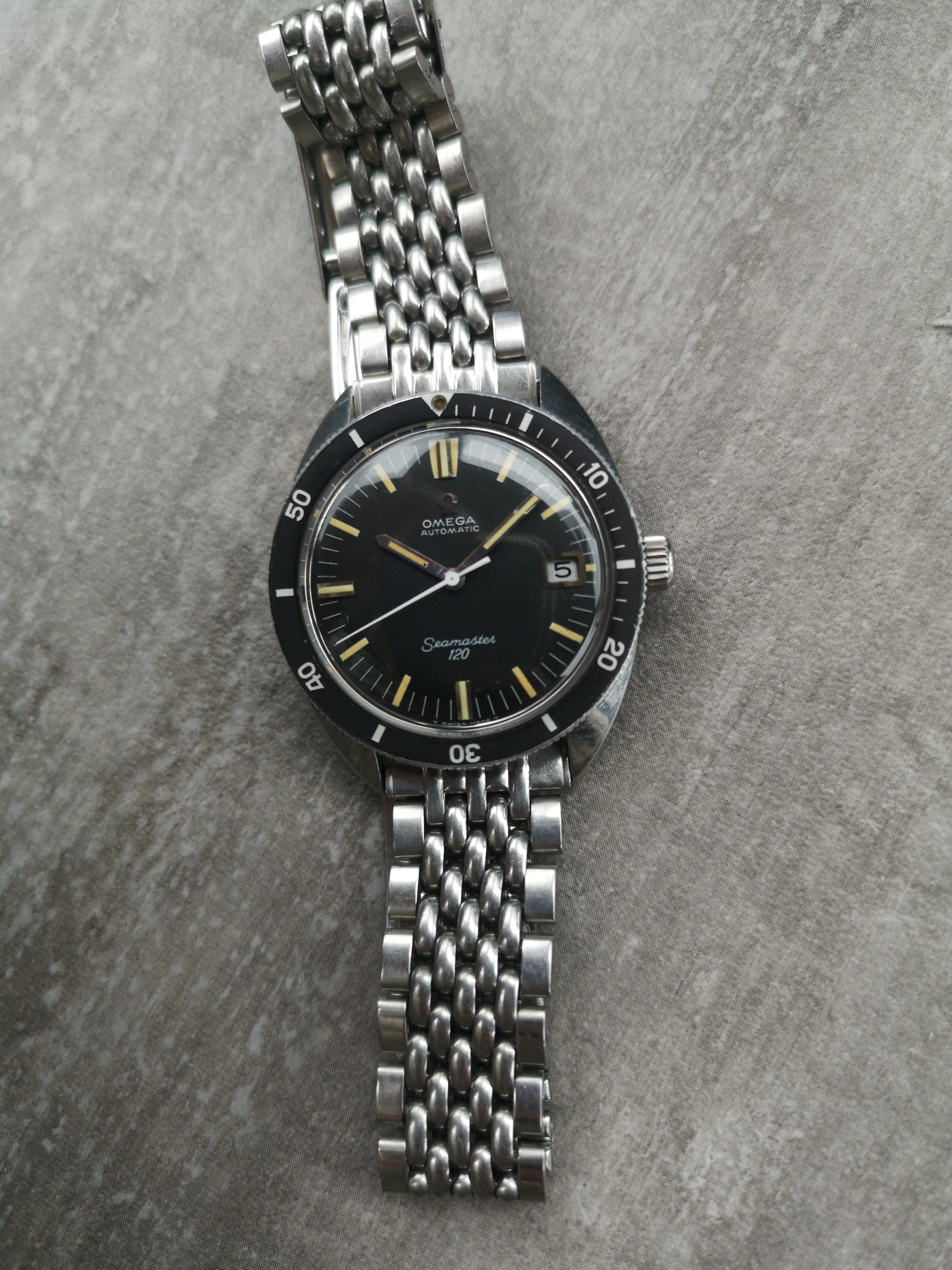

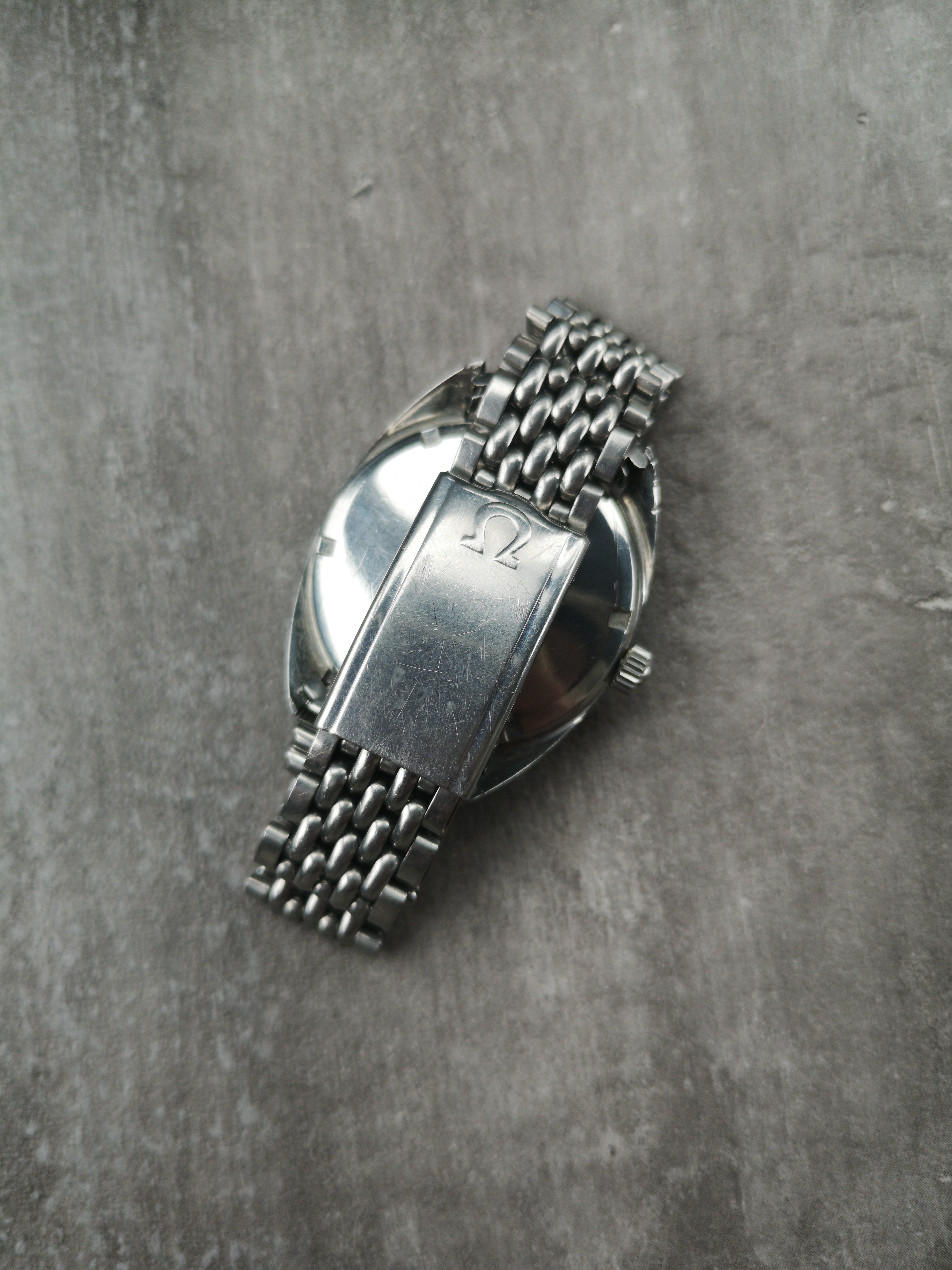

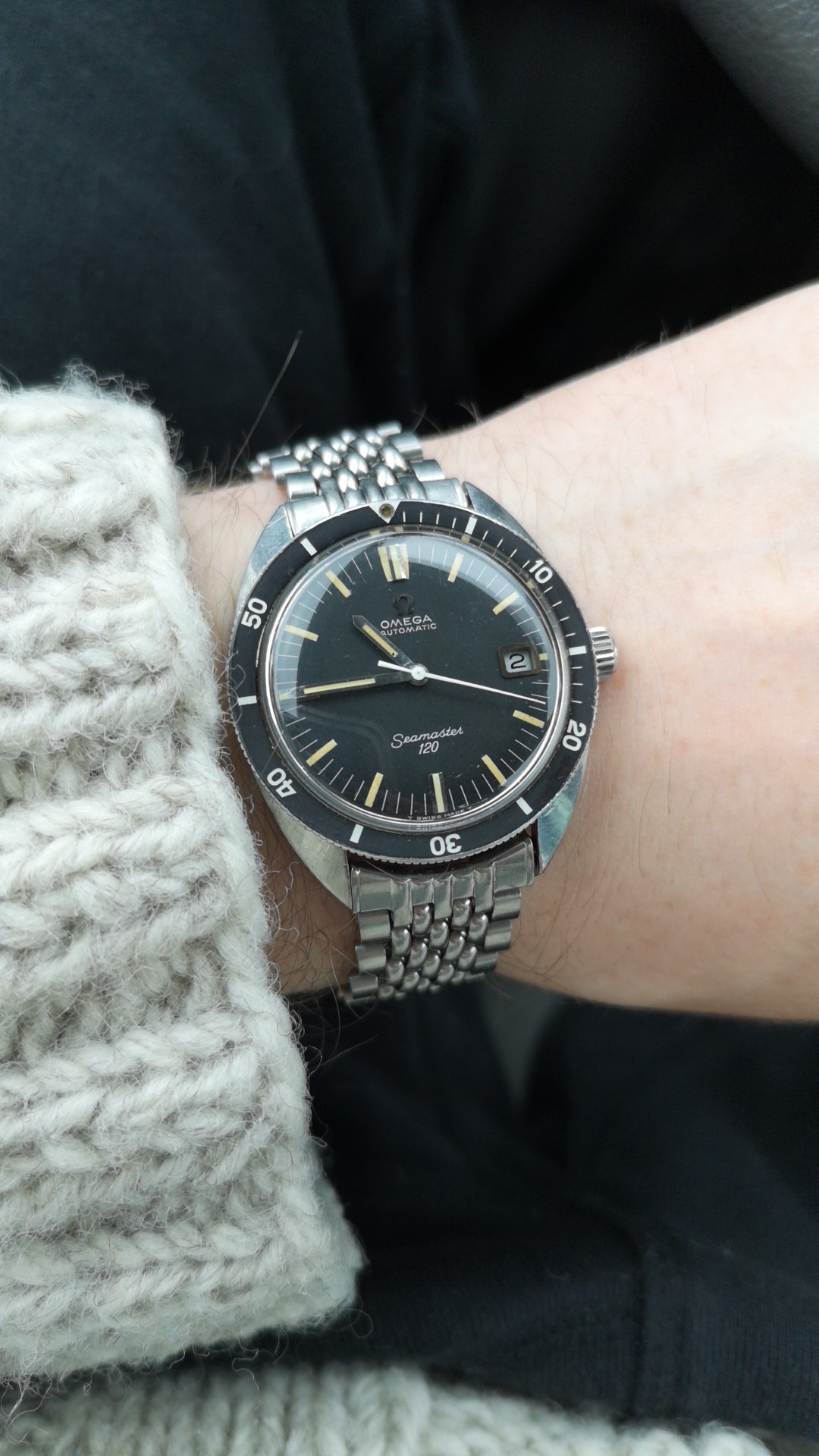

What do you guys think? I believe it to be the best one I have seen. I'll be listing it for sale today. No flaws I can see on the dial.
A

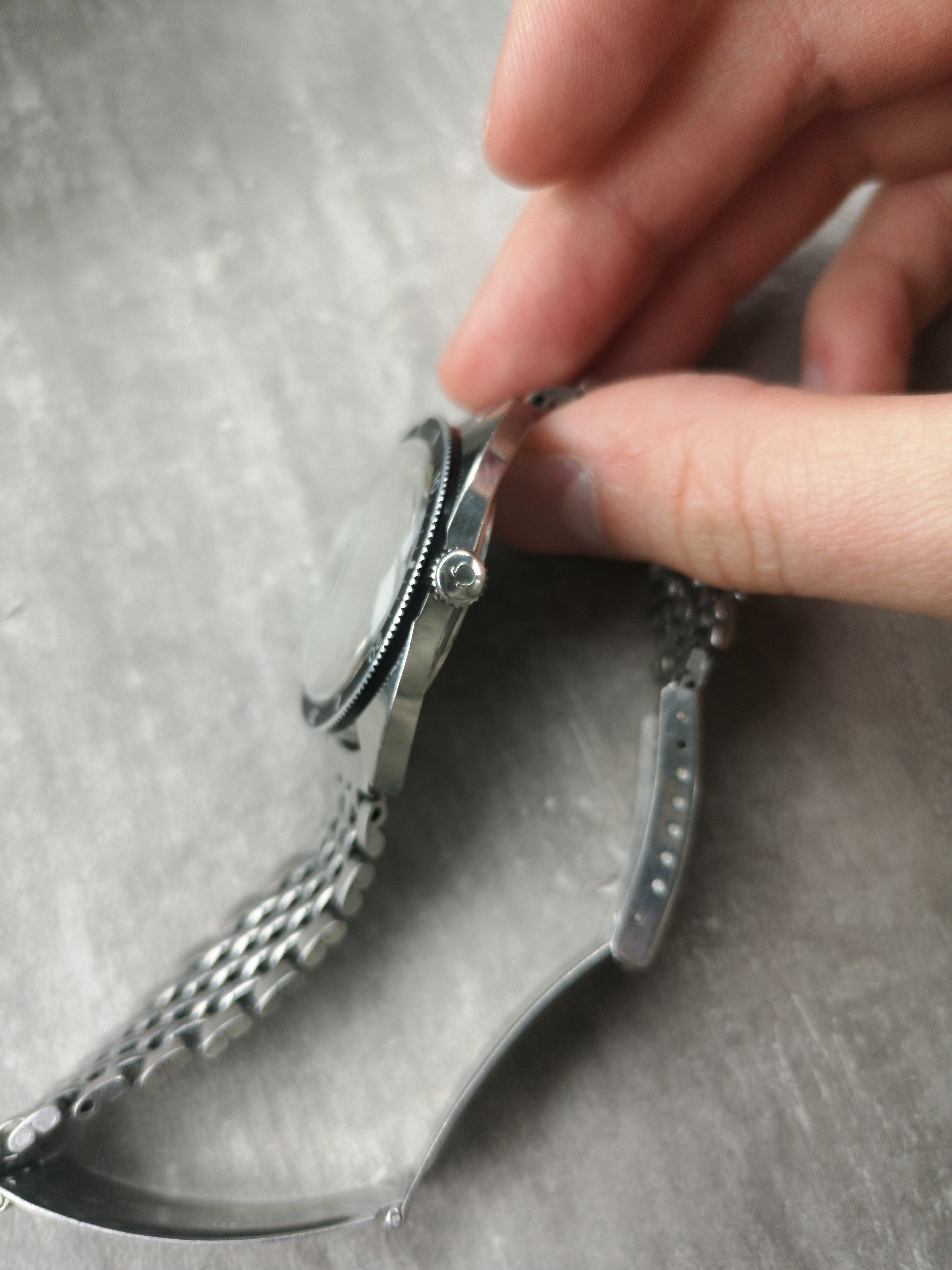

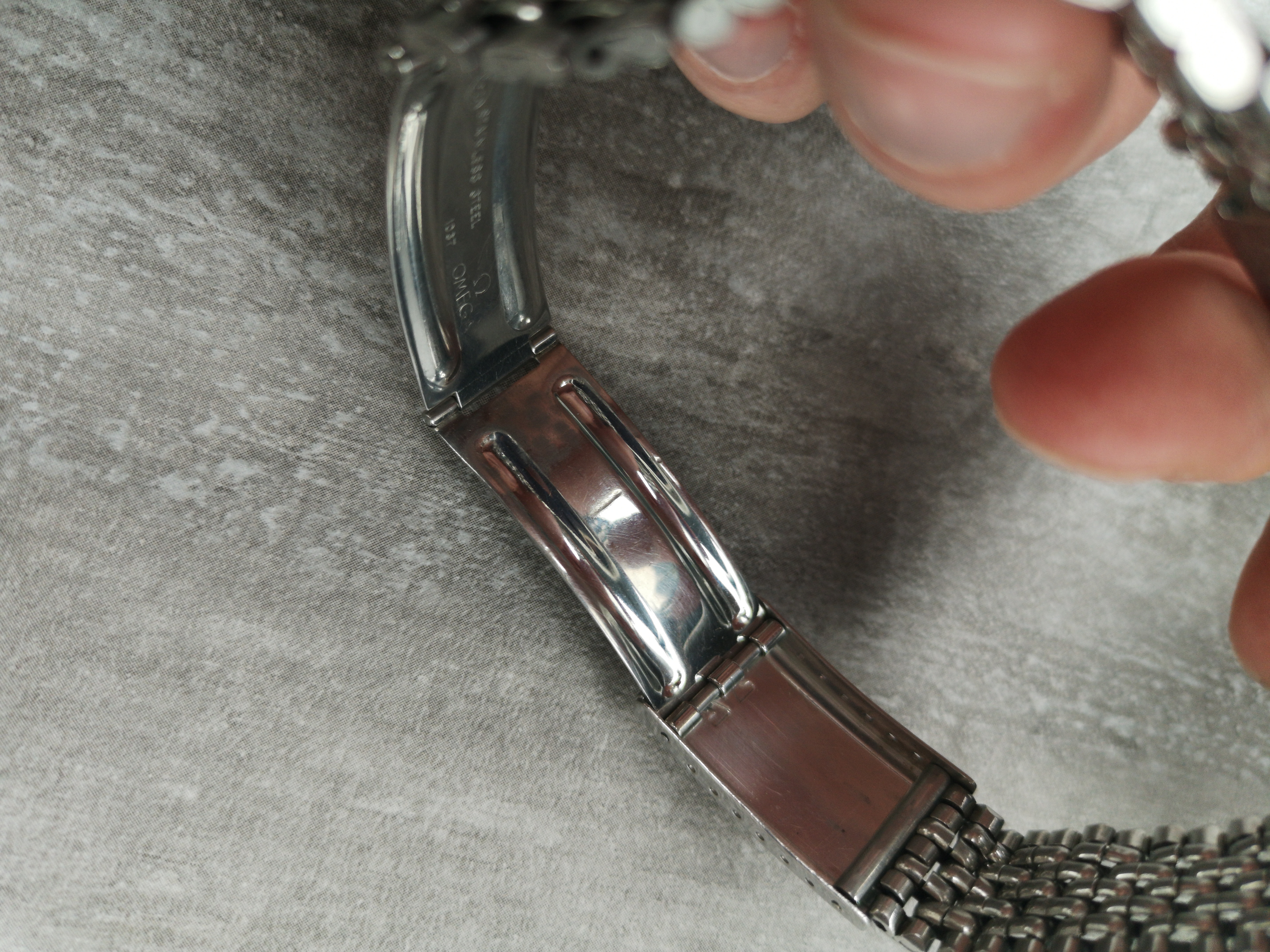

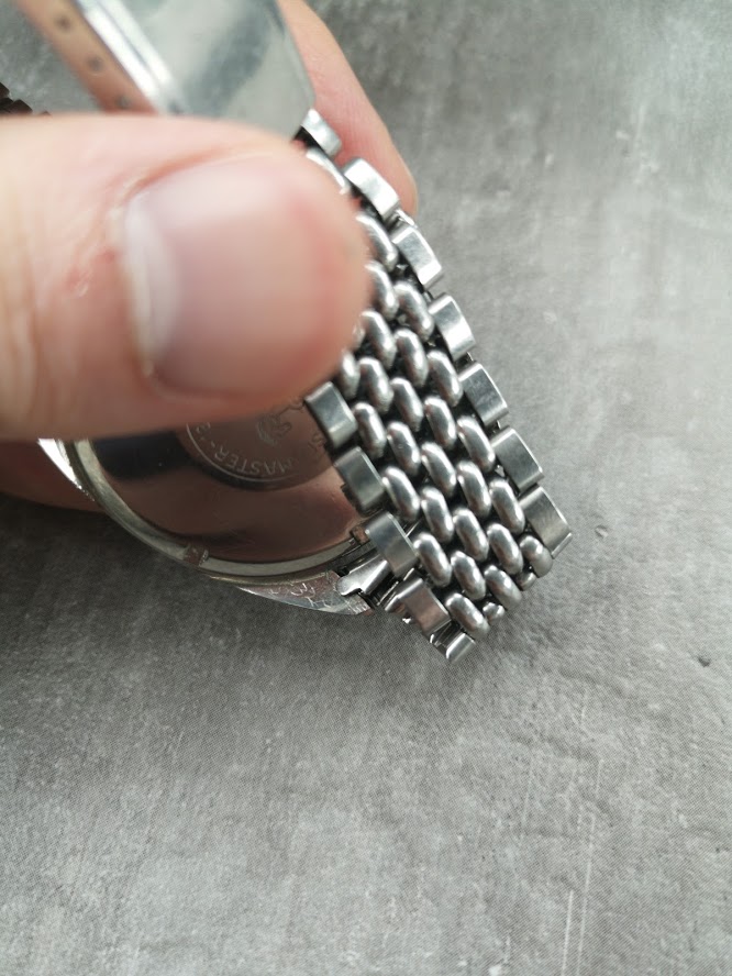

More pics. I appreciate your critique so I can have an informed sales listing.

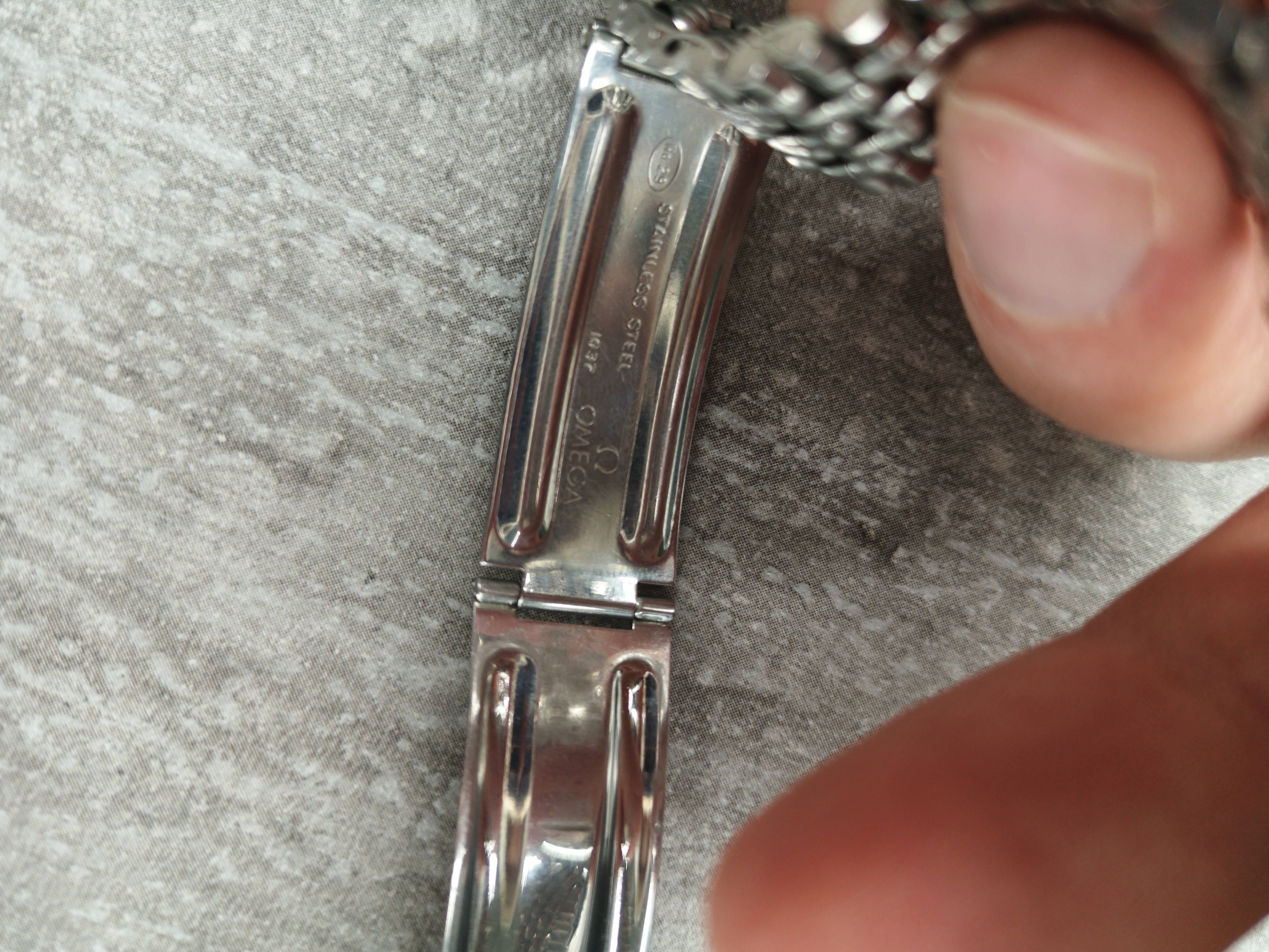

ur BOR braceLet seems tO have 18mm endLInks .... the lug width of the 120 is 19mm ..
. would help ur sale pst if u set ur camera to .... MICRO .. get up close to the ... MARKERS AND LUME ... also upclose to the .... BEZEL .. also if the crystal has ... Omega LOGO

Looks pretty good to me. Hard to say more without a close up of the dial but it certainly looks clean.

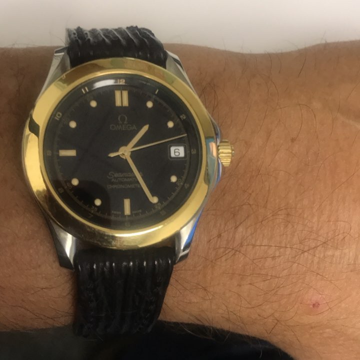

Wait, I was told mine was a 120
This would be a late 120 from the 90s (ish). The watches that this thread is concerned with were made in the mid to late 60s and early 70s.

For a minute I thought you were telling the japenney his was from the 90s. It looks very nice to me. I can't say it's the BEST with the missing pip, but the patina and dial are very nice and warm. Bezel, hands, crown look original to me. The bracelet is neither here nor there unless you list it as original. In the current market it could fetch 2500 ish for just the head.

I appreciate the input on the originality.

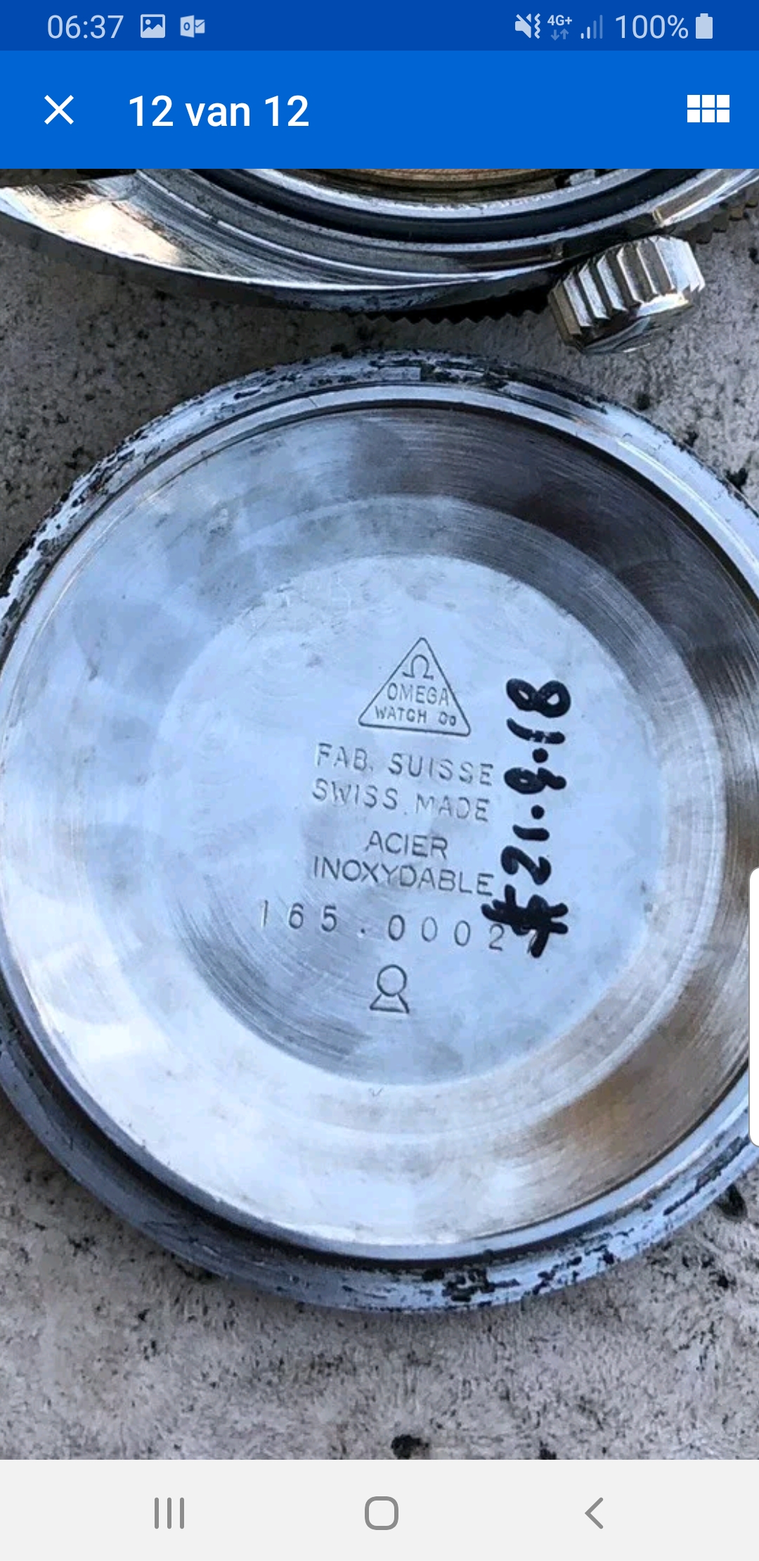

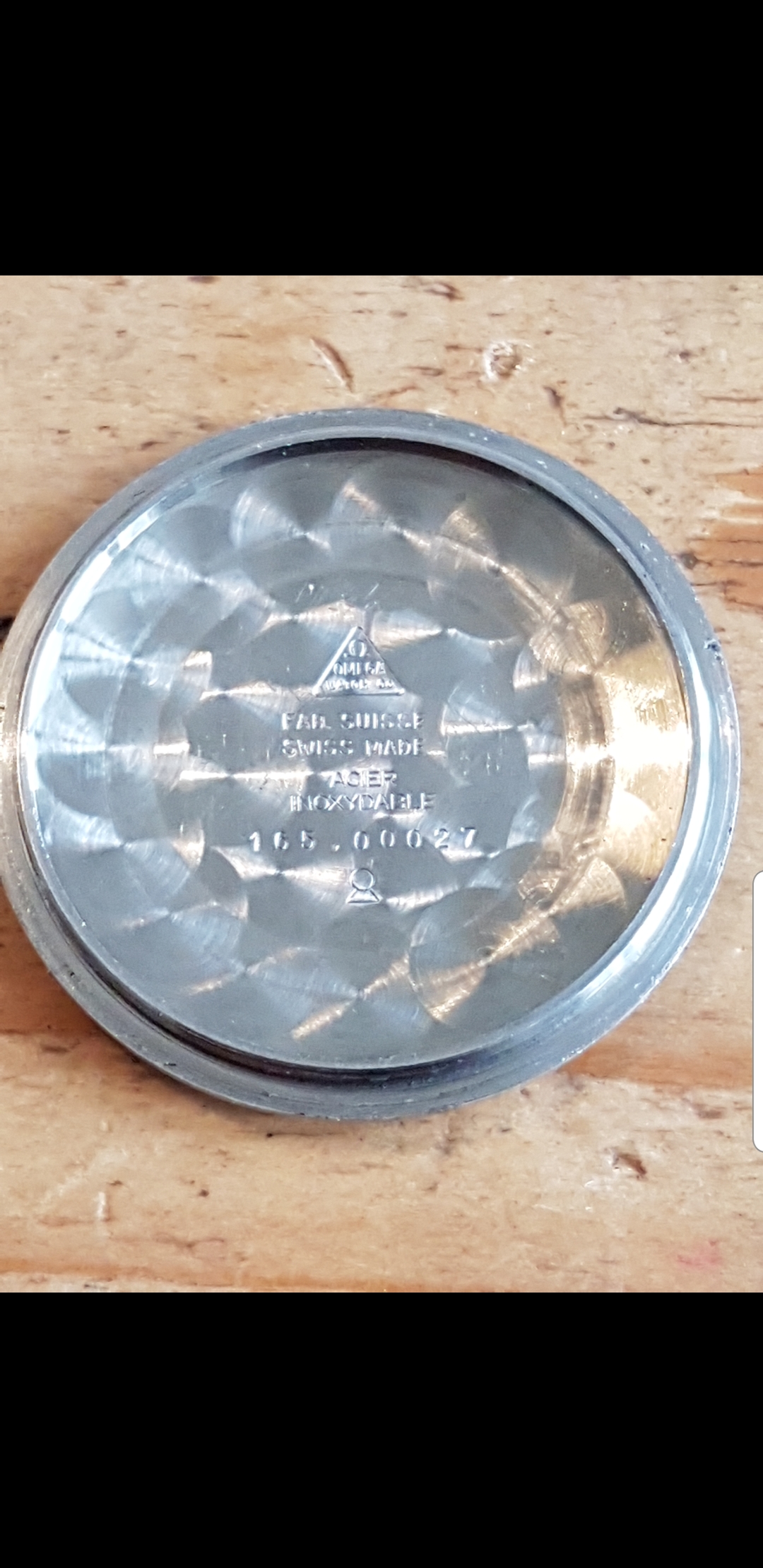

Hi guys, I have recently taken the plunge on this piece here:
https://www.ebay.com.au/itm/Diver-Omega-Automatic-Seamaster-120-Ref-165027-Cal-552-Original-Dial-Patina-/173899355329?hash=item287d3594c1:g:e3MAAOSwD3pc1VTs&nma=true&si=mLihCpoMzuQW68xjAJa8hkuhMc8%3D&orig_cvip=true&nordt=true&rt=nc&_trksid=p2047675.l2557

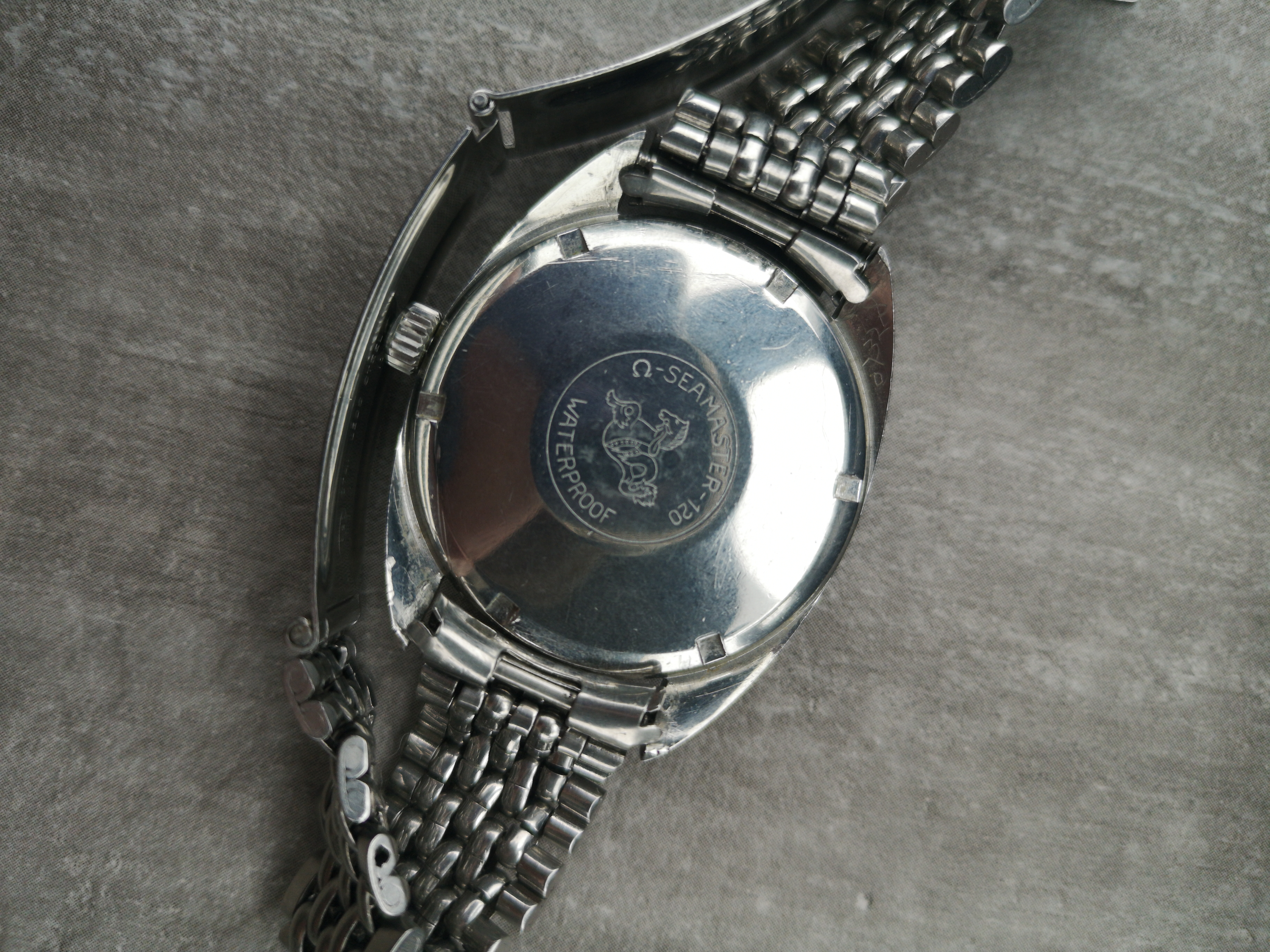

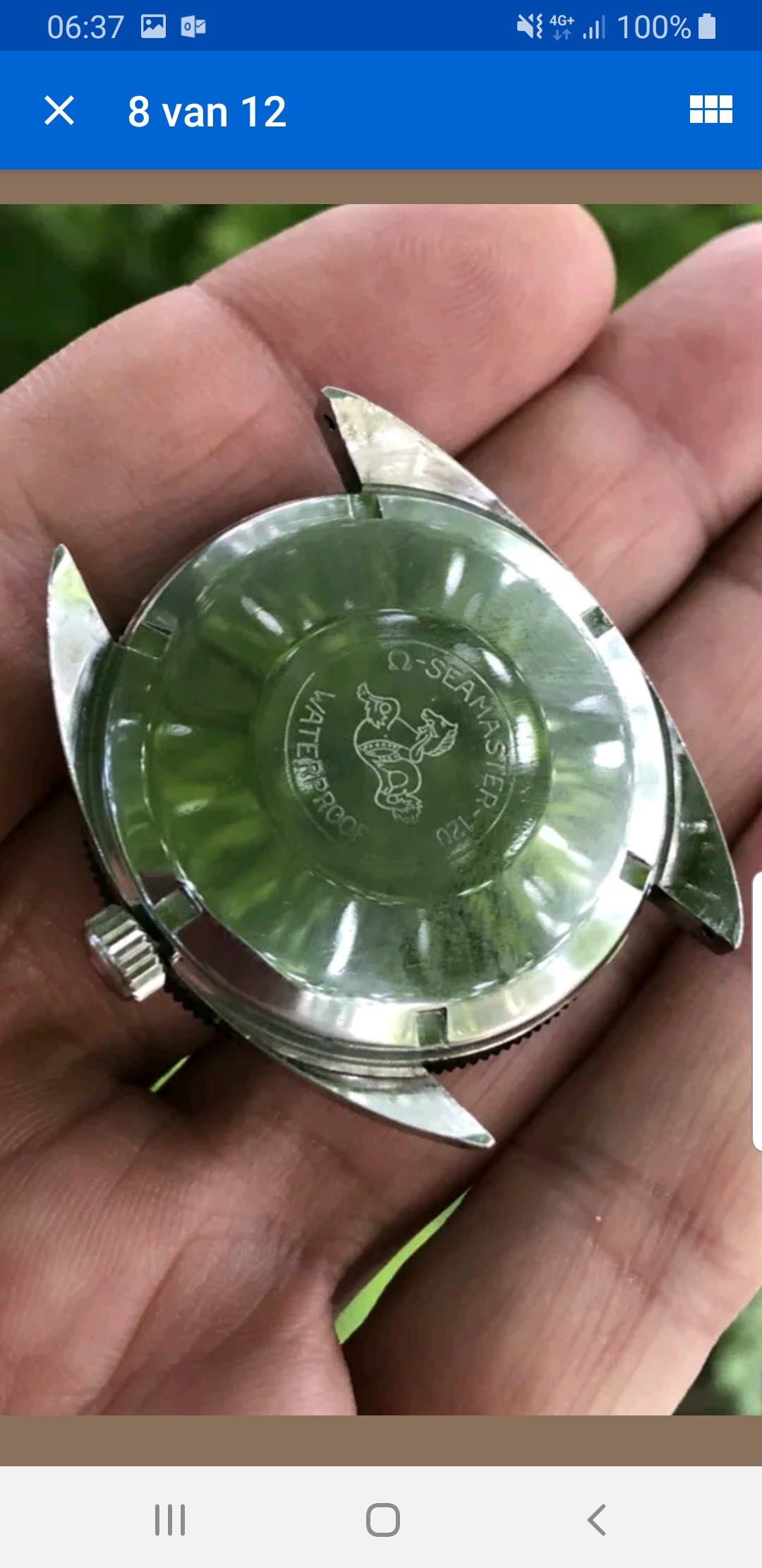

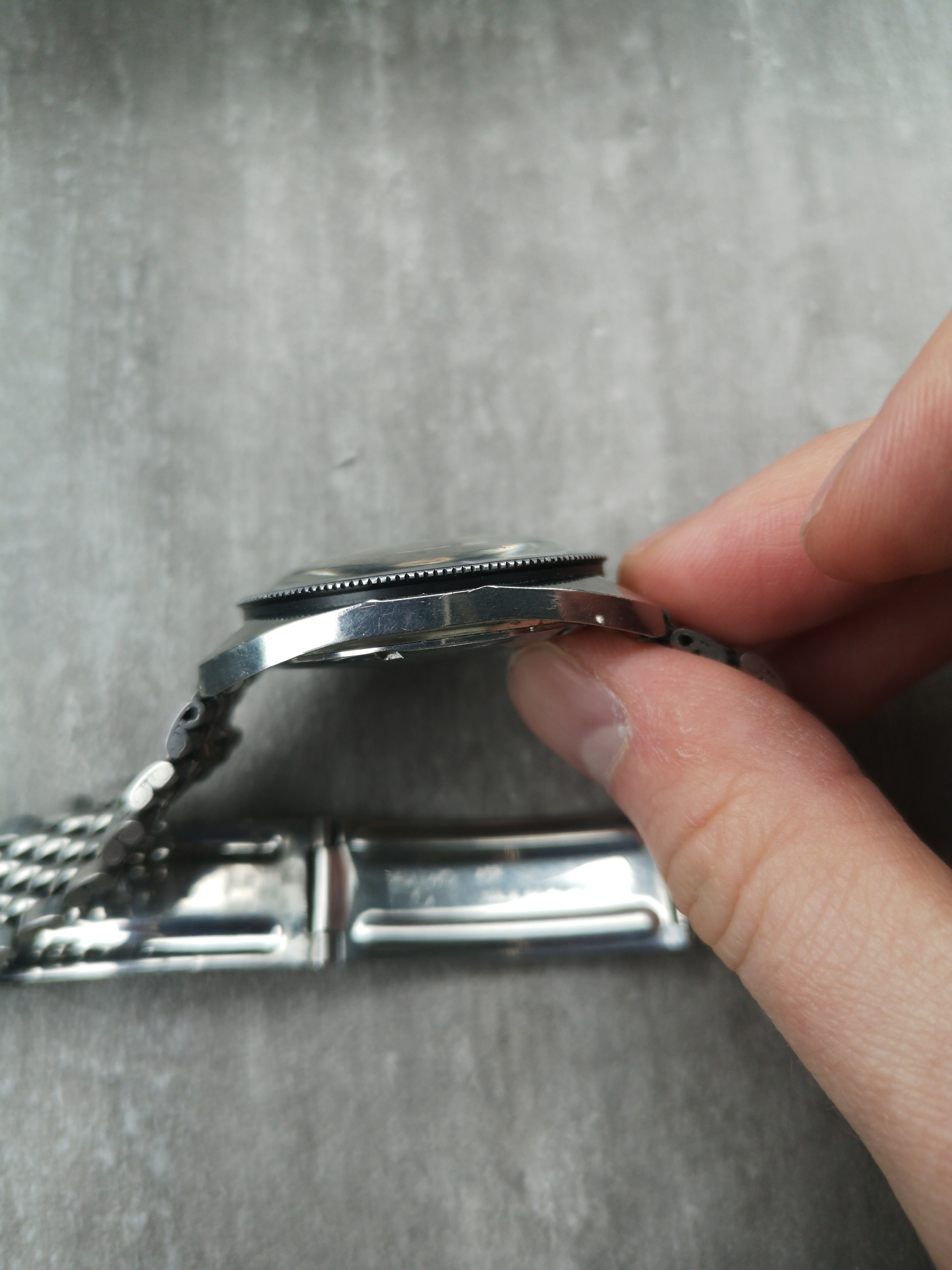

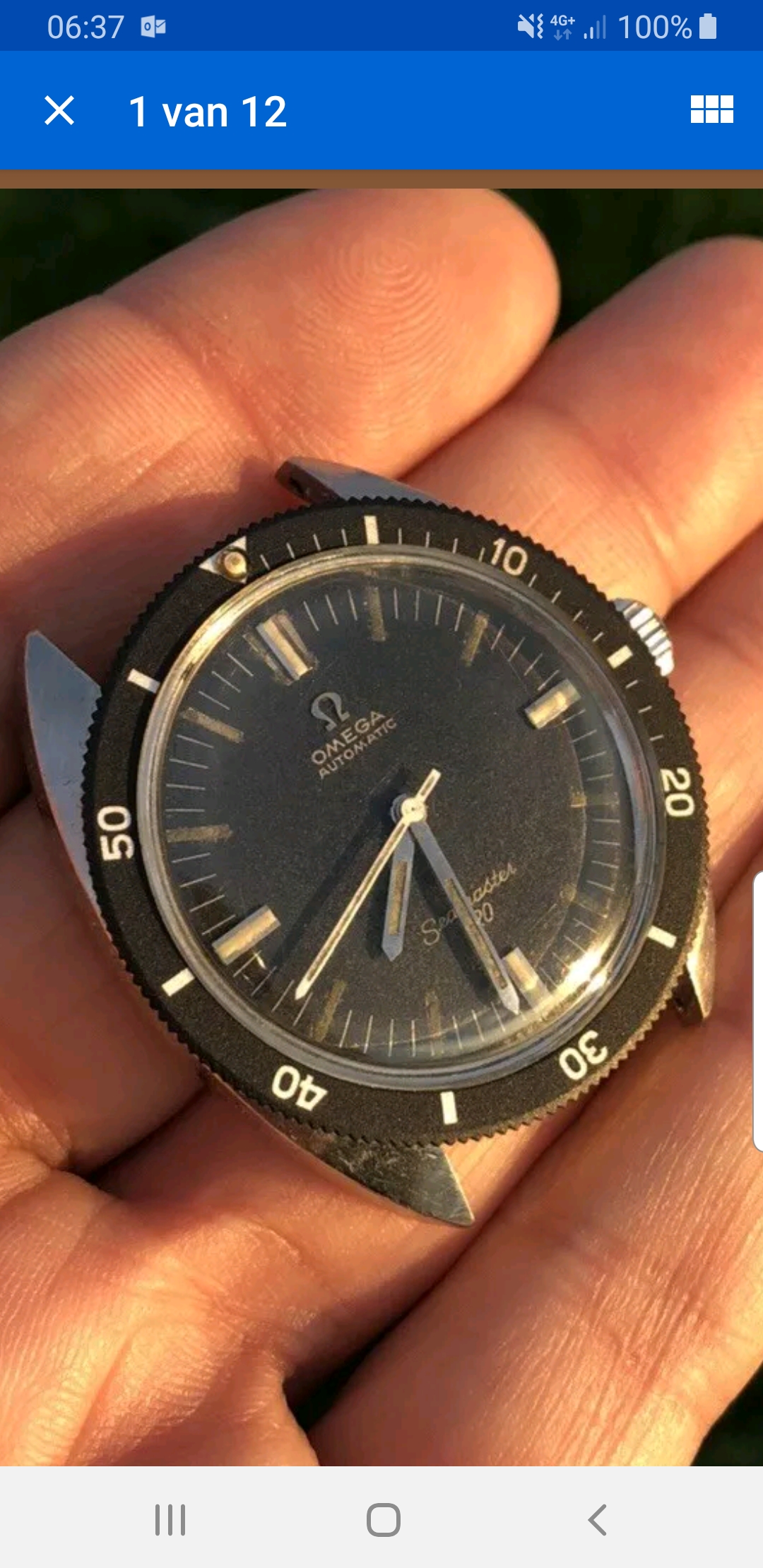

I have only just seen this thread and now I have some alarm bells ringing - namely the ref on case back (165.0002) and the condition of the bezel... Does anyone with more experienced eyes see any red flags?
Yes, I see red flags. I dont believe that bezel is original to the watch. But the caseback is fine. You only dont see the 7. it's probably saying: 165.00027
5,026
18,608
And maybe it's better to start a seperate thread for more opinions. And next time please post pictures iso a link. Thnx
