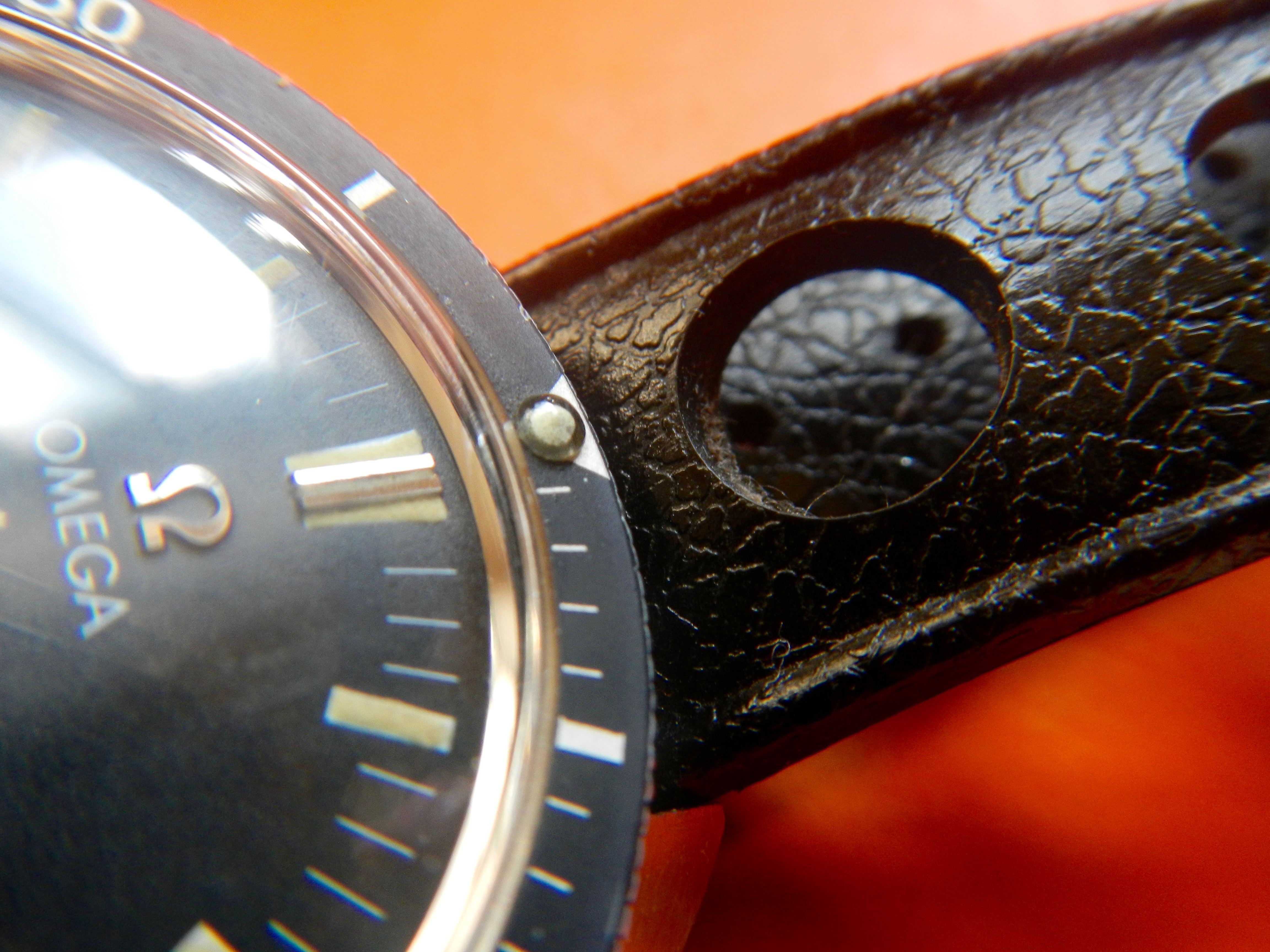

Does the 120 have a clicking bezel?
Mine rotates but doesn't click. I'm not sure if it's missing a part or that's just how they are.
120 bezel for both automatic and manual wind versions is ... NON CLICK [friction mounted] ... bi directional

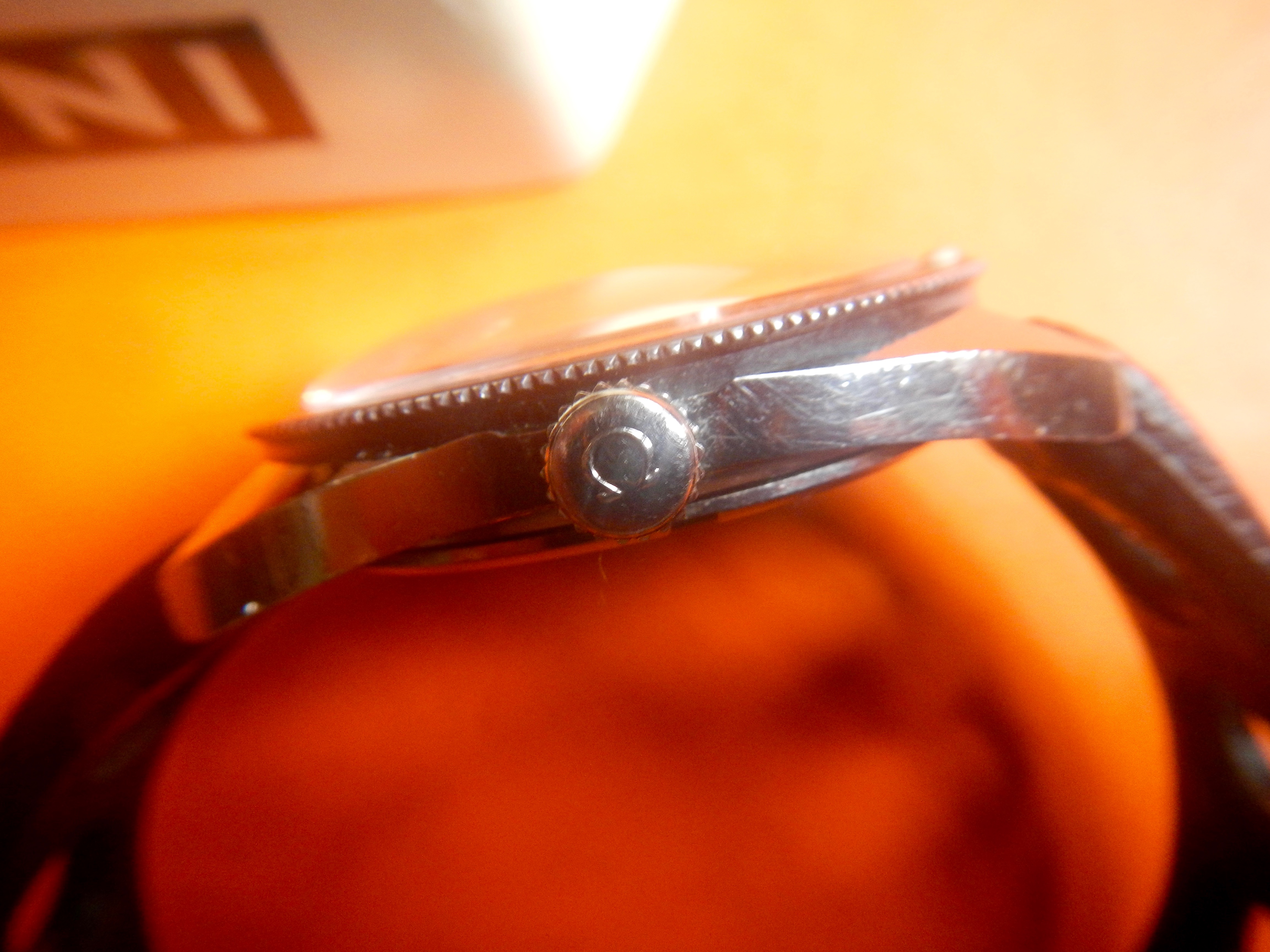

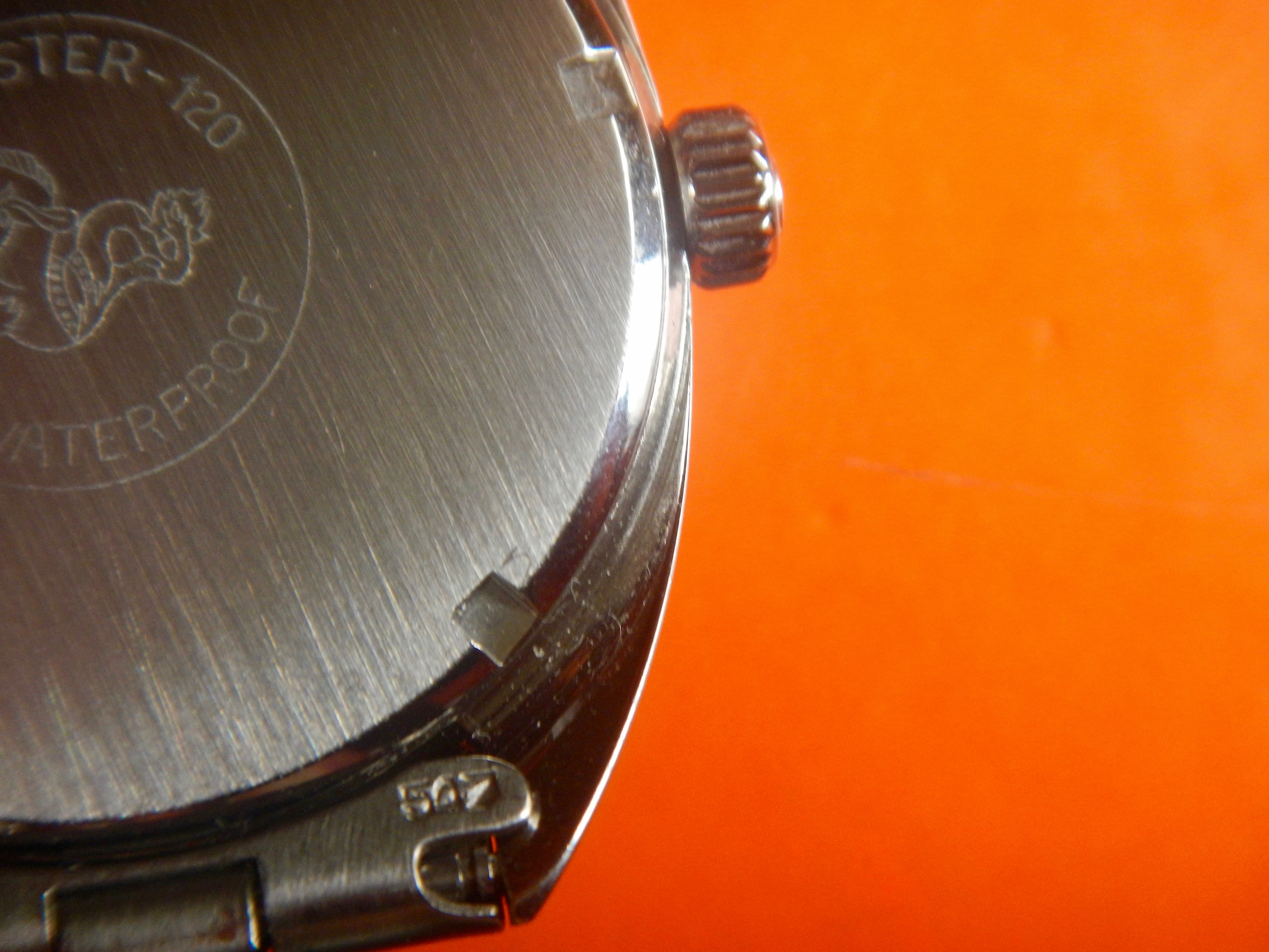

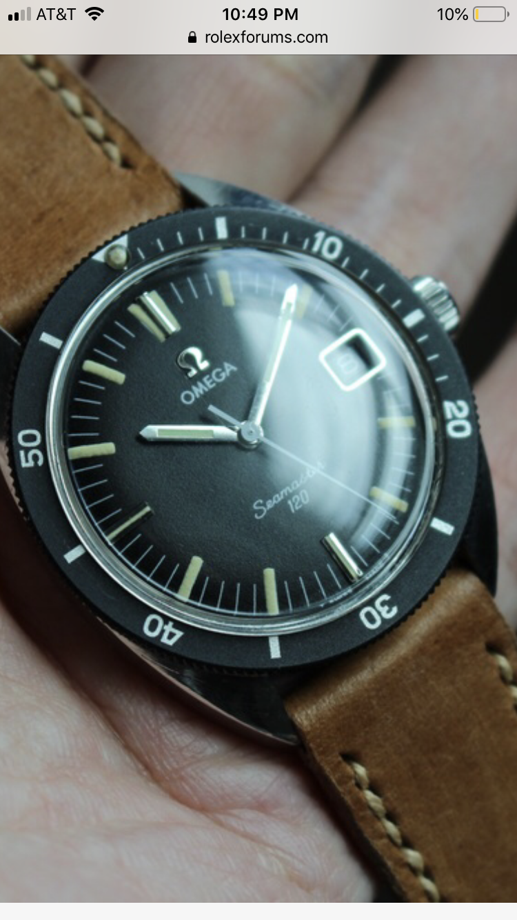

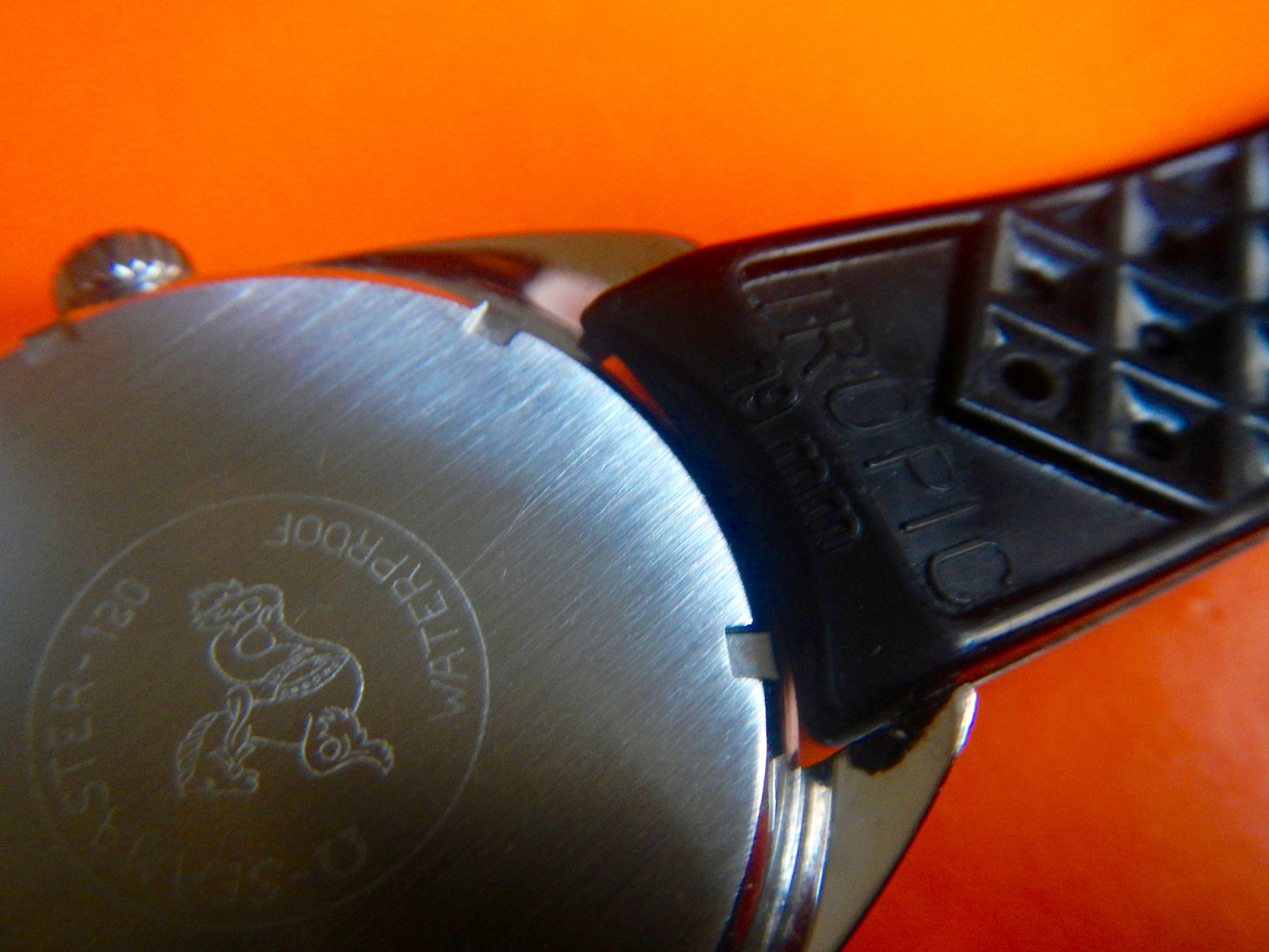

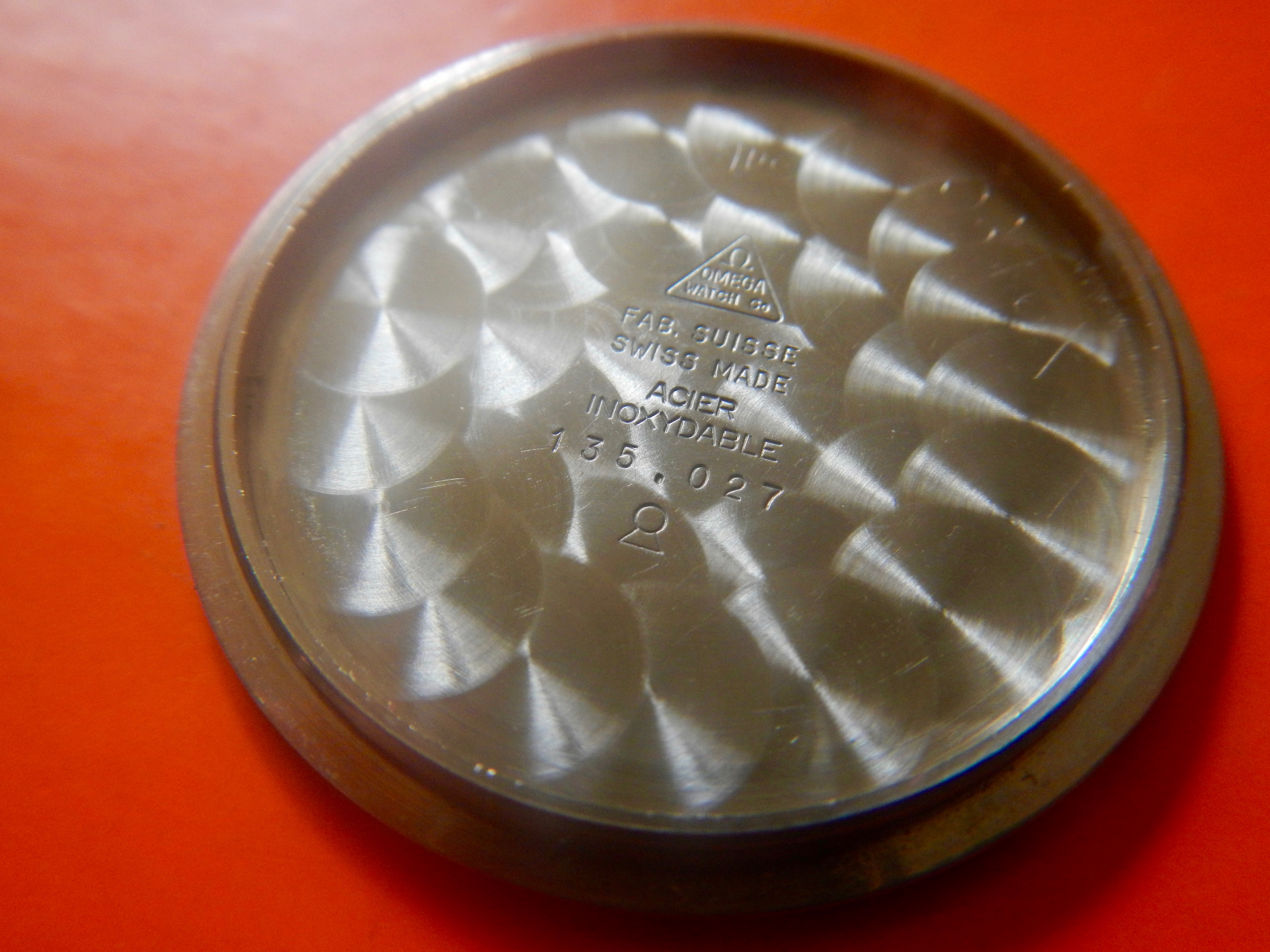

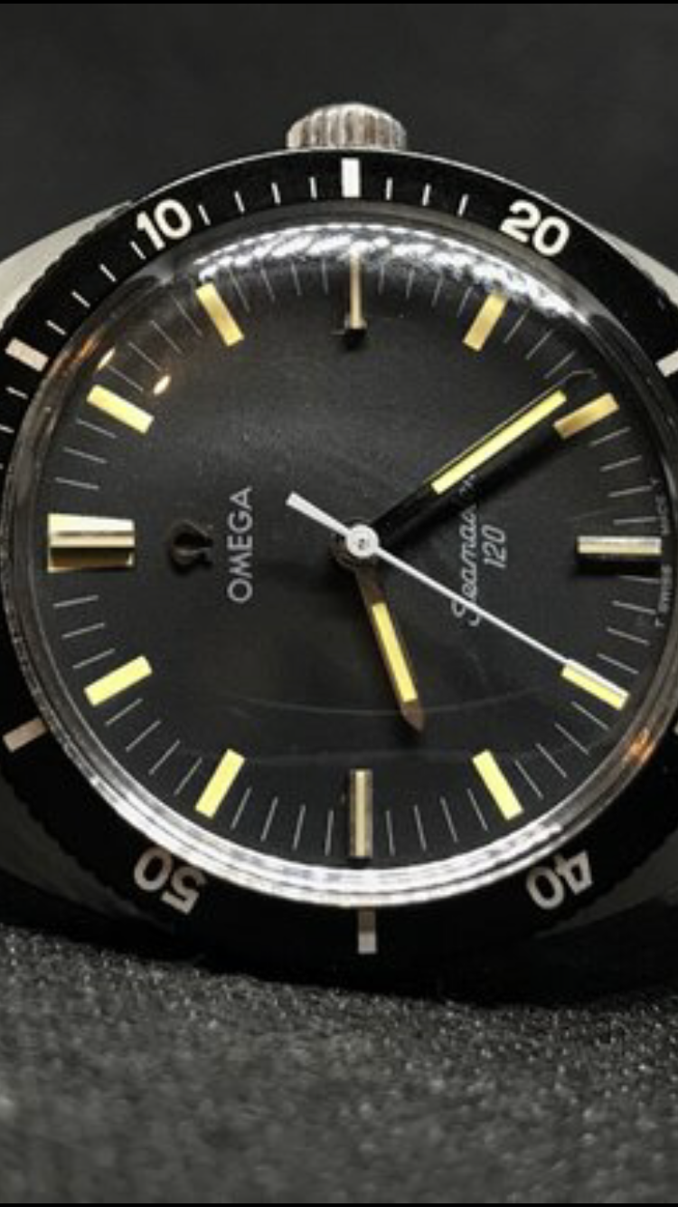

Hello,
Can anyone give me their assessment of this 120, the condition is excellent which immediately make me think redial, etc. any help would be appreciated.
3,689
18,156
Hello,
FAKE .... here are some details that might help ... original parts
214
188

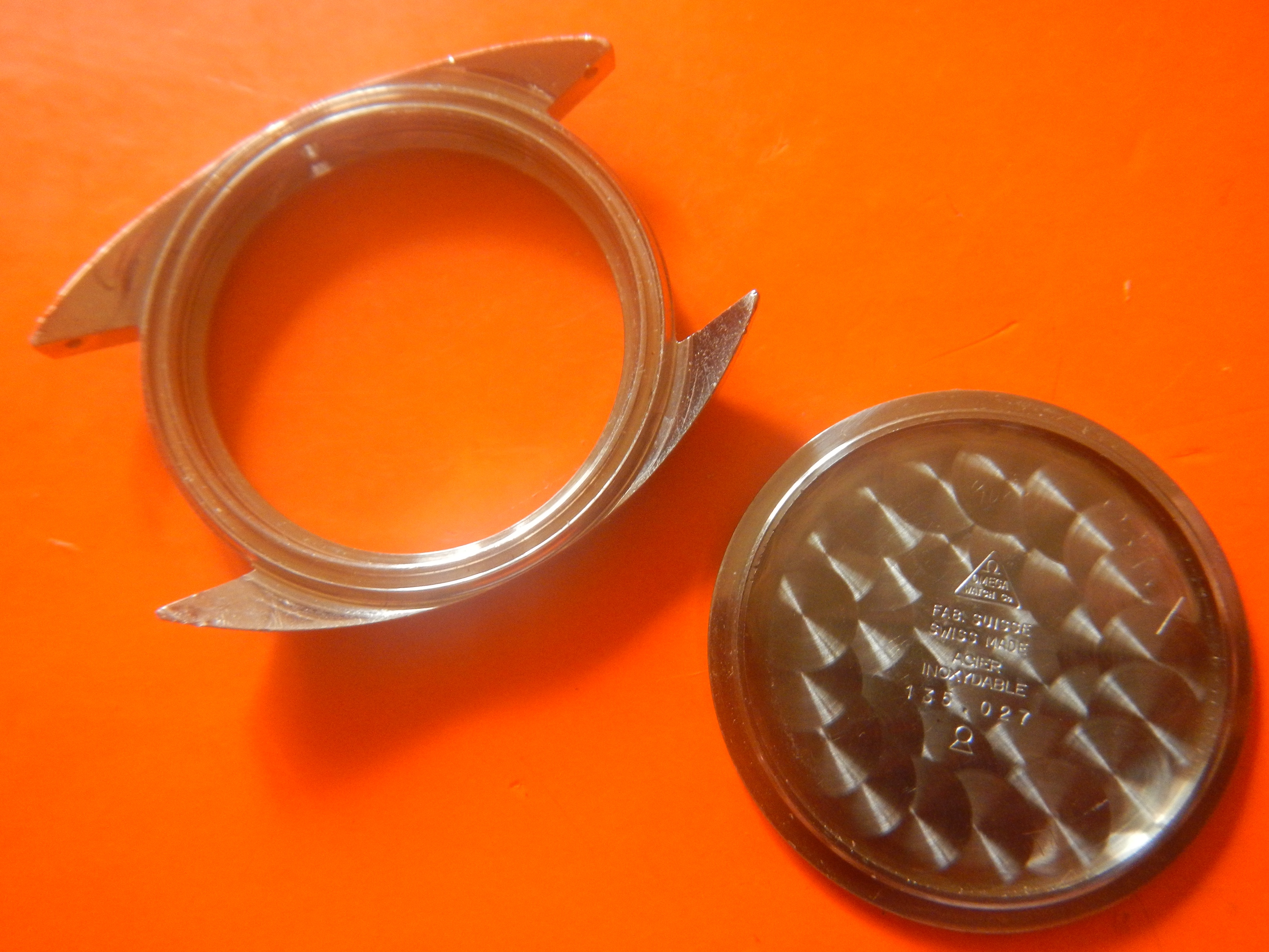

Thank you

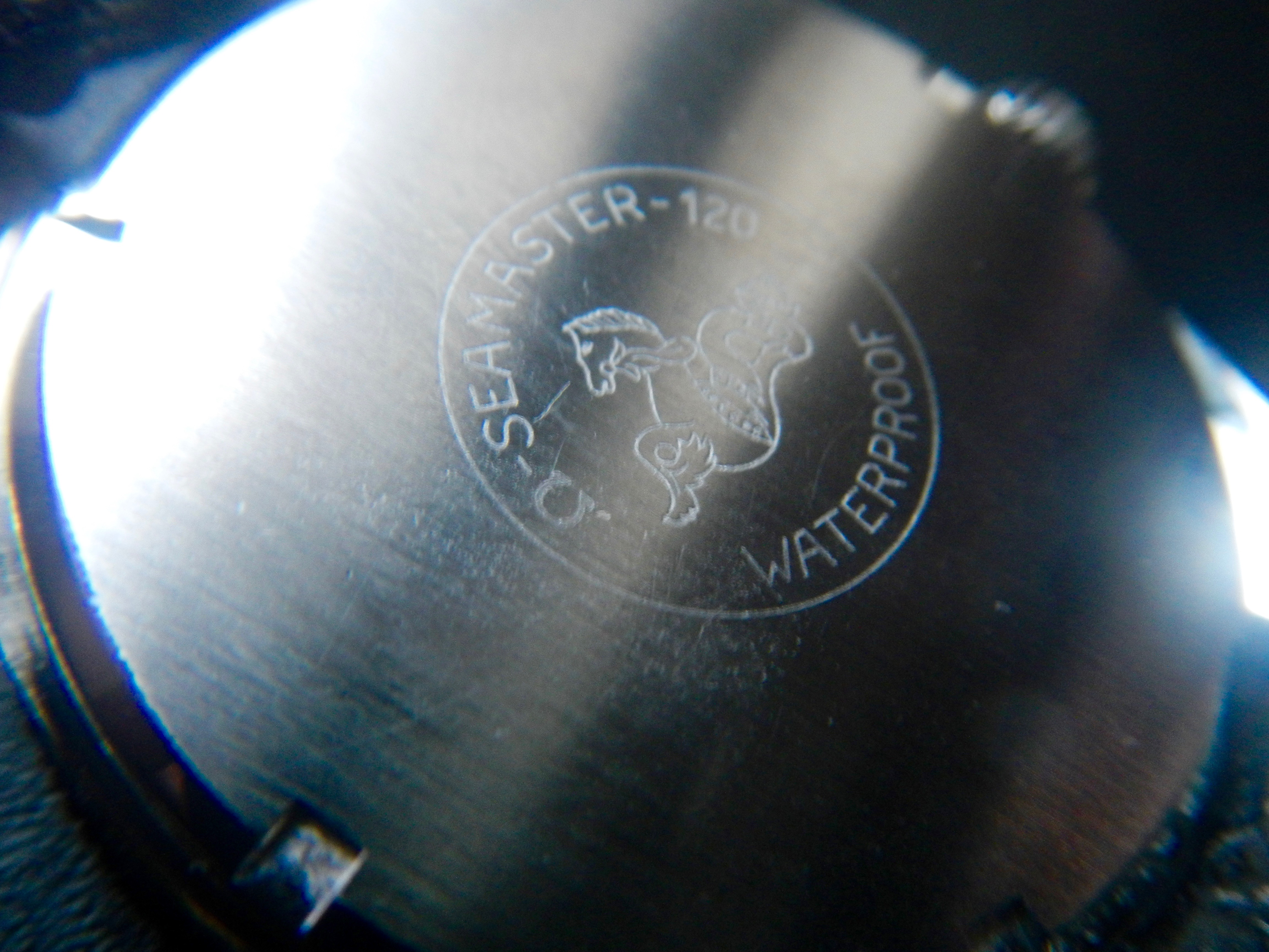

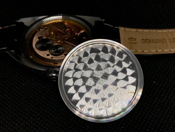

I see the lume pit is different, the case back and under the case back. The movement looks original.
I have a lot more research to do, if I want to find a decent example but what screamed fake to you?
1,060
1,634

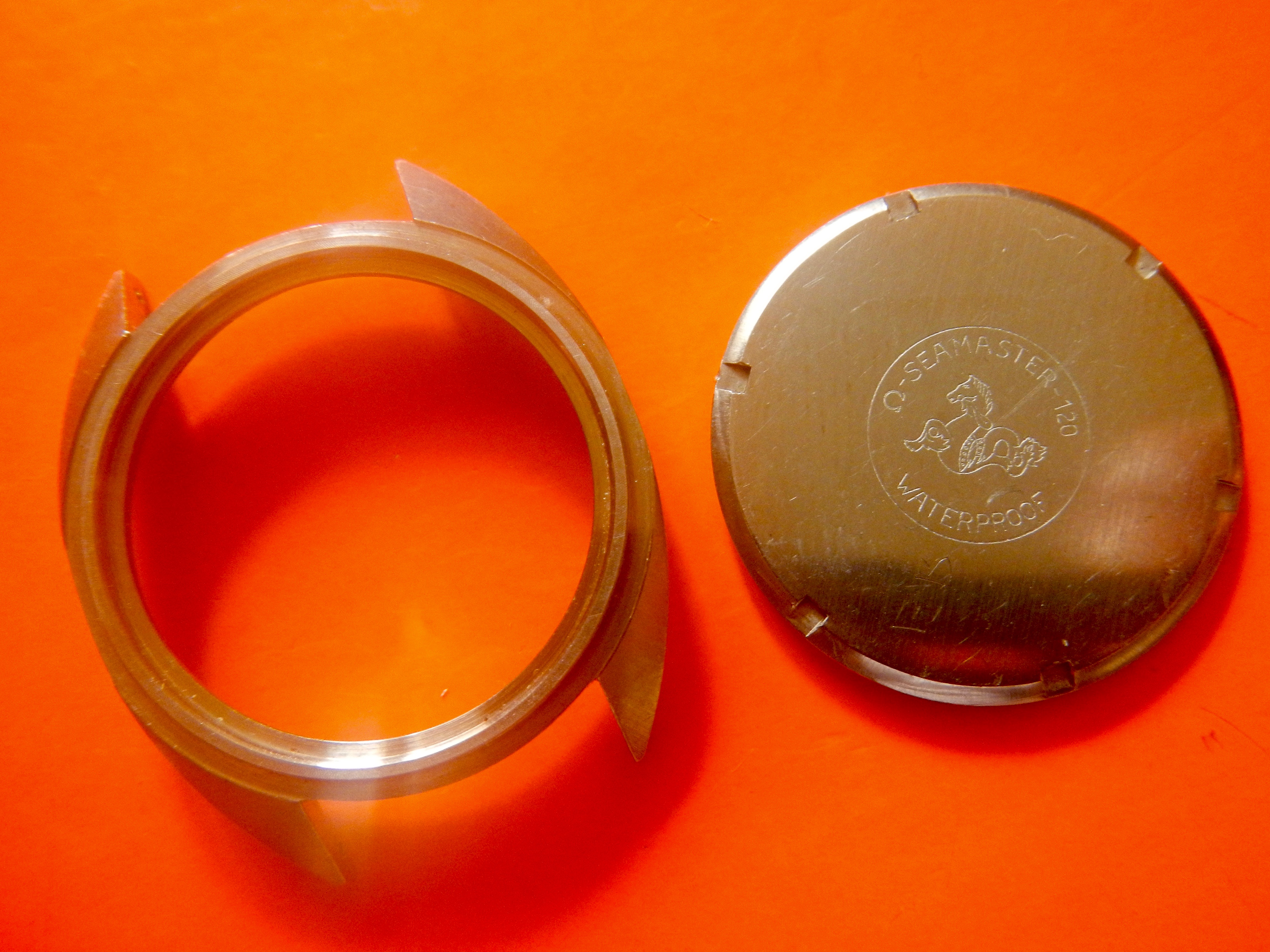

+1 typical fake

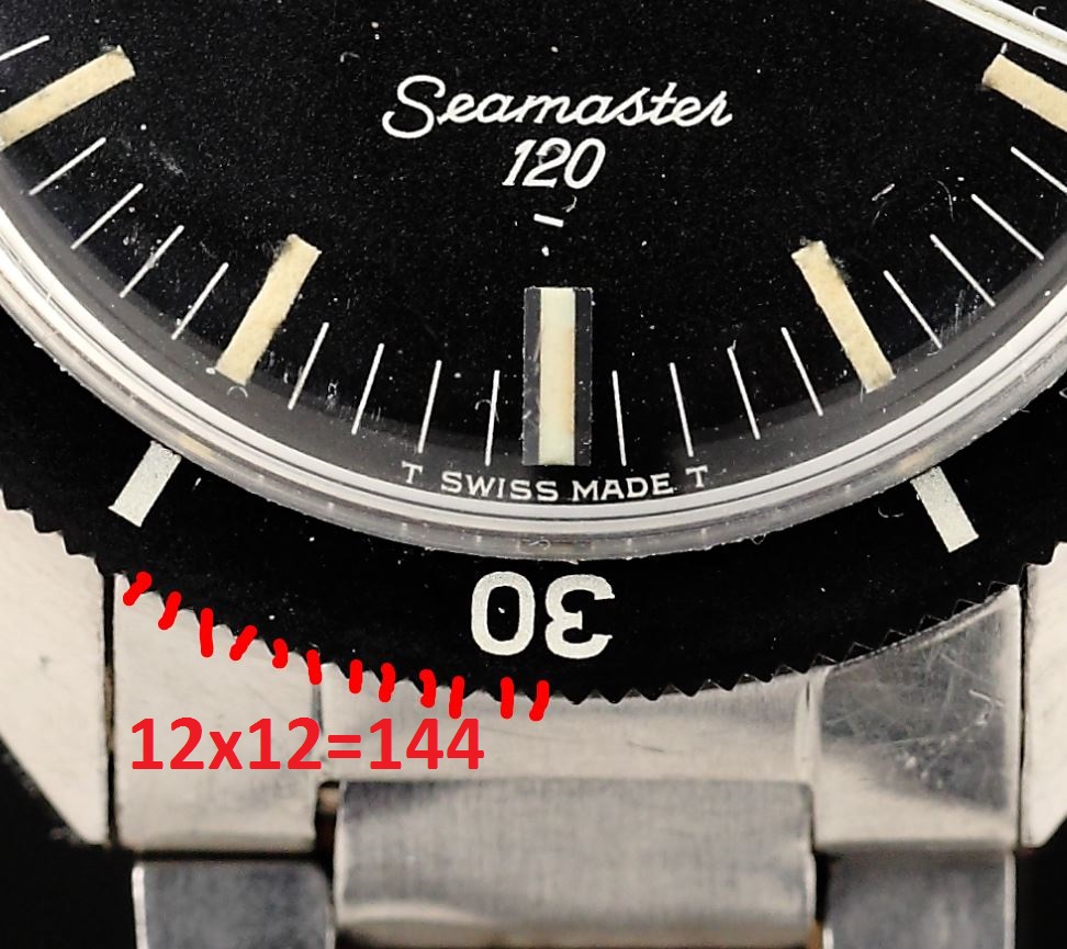

Check:
- fake shiny bezel, wrong lume pit, 120 instead of 144 dents.
- dial print should be whiter
- Royal Afghan Airforce caseback is different (seamaster is not centered)
- different case

+1 typical fake
Check:
- different case
All great info for someone who is trying to navigate through all the crap out there.
When you say 120 instead of 144 dents, what does that mean.

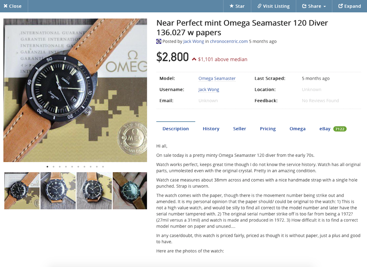

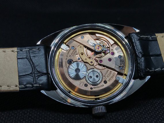

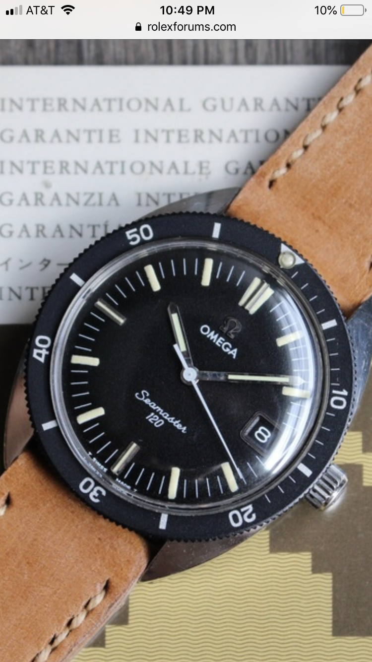

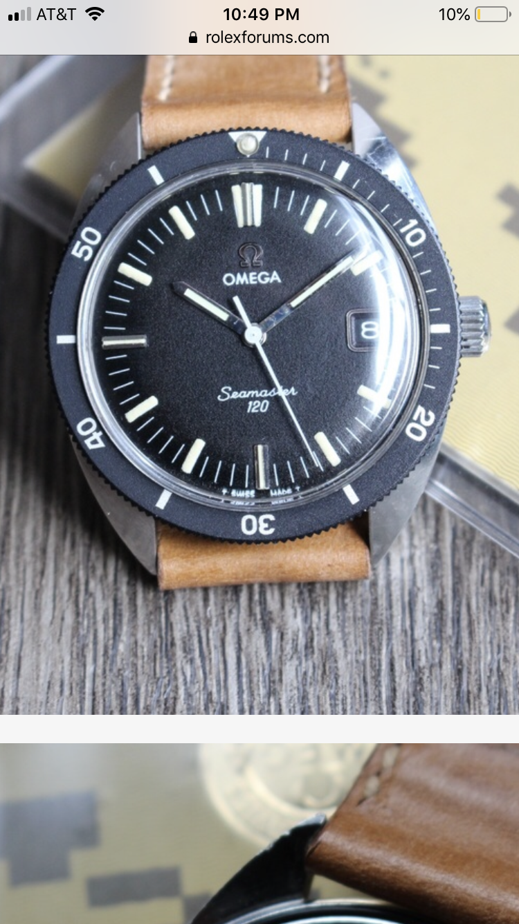

How about this one, the seller responded and explained to me that it was purchased from Jack Wongs vintage collection and is 100% original
214
188
it looks good ...

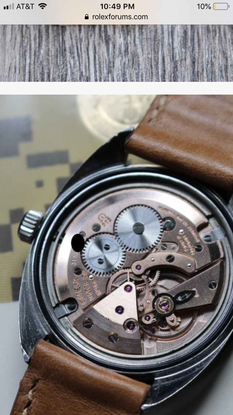

How about the movement, it looks like it says 513 instead of 613. Any clue why that would be?
3,689
18,156
thats the issue on Jack Wongs post the numbers don't match ... on the serial number dates it from
1973 ... watch was made in the 60's and she\oud have a 600 series ref mvmnt
214
188
I agree with the above, it seems like he is confused and the # on the movement is concerning along with the prestige bezel.

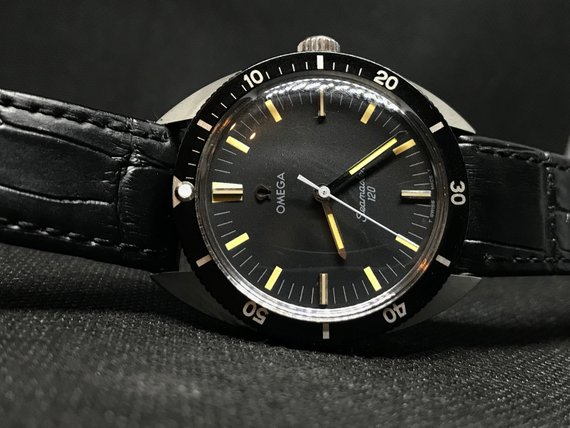

I was looking at the one you posted and was seriously considering it.

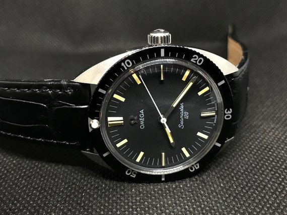

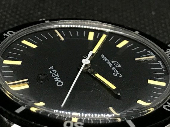

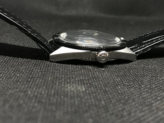

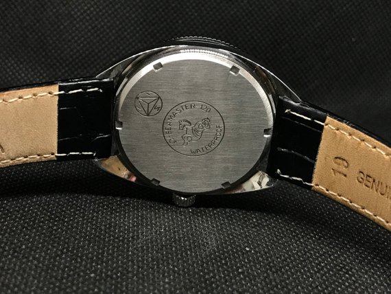

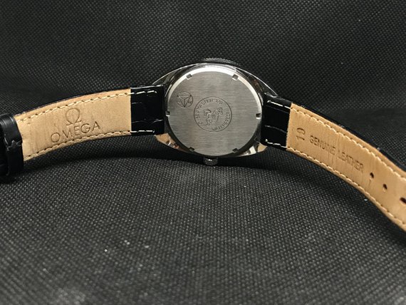

What about this one, no date but the condition looks good.
https://www.chrono24.com/omega/seamaster-120-vintage--id7935365.htm
3,689
18,156

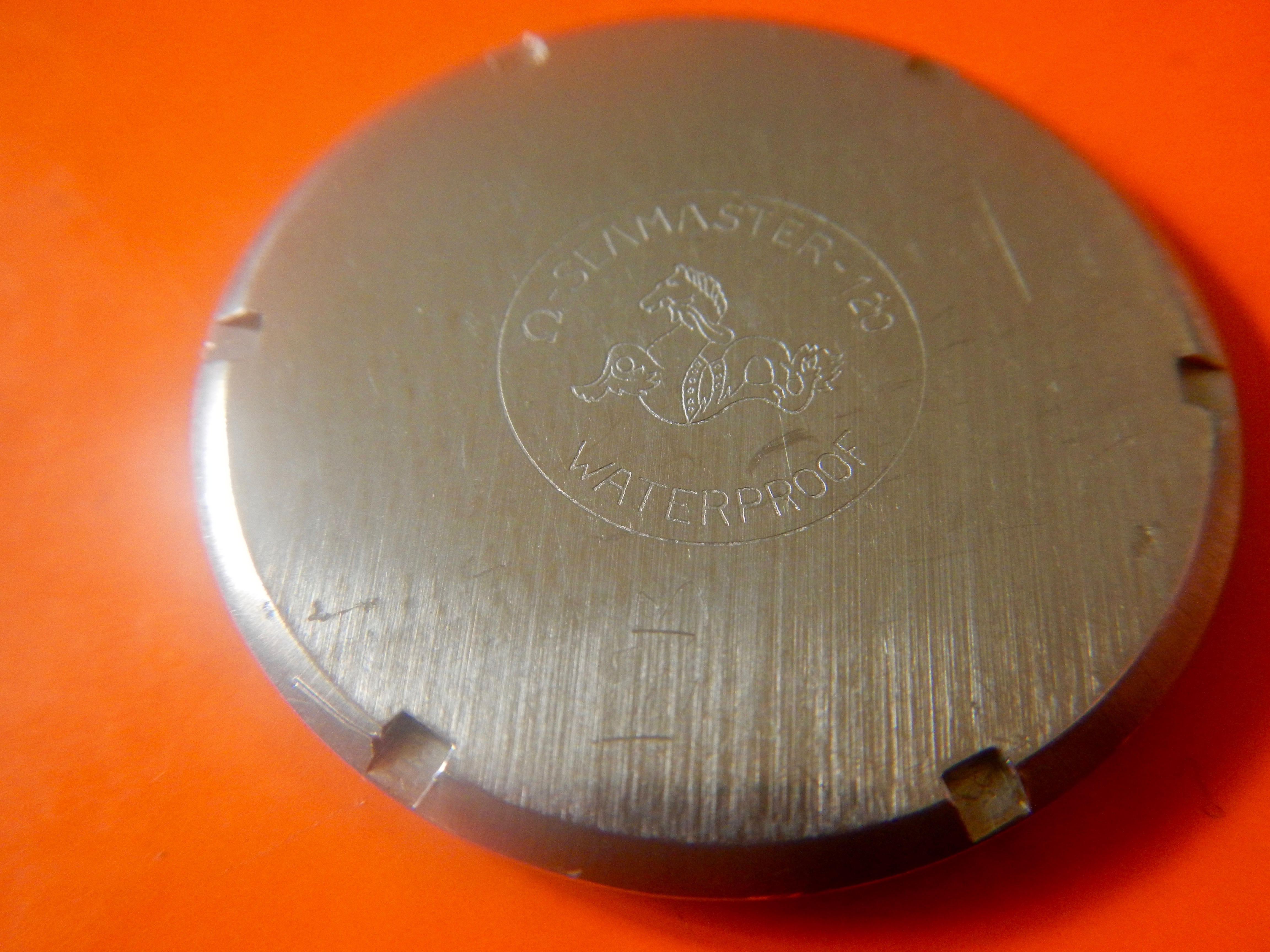

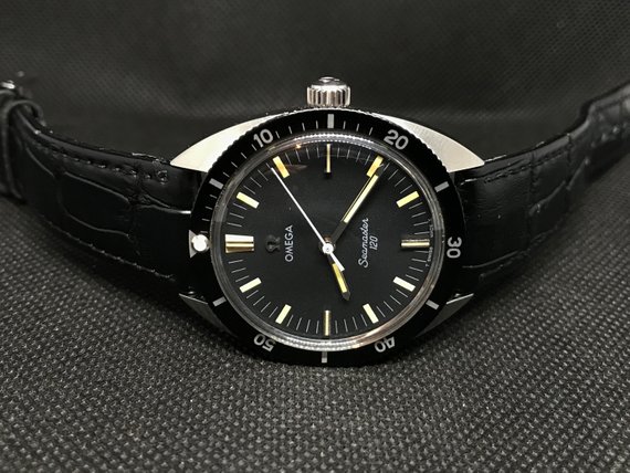

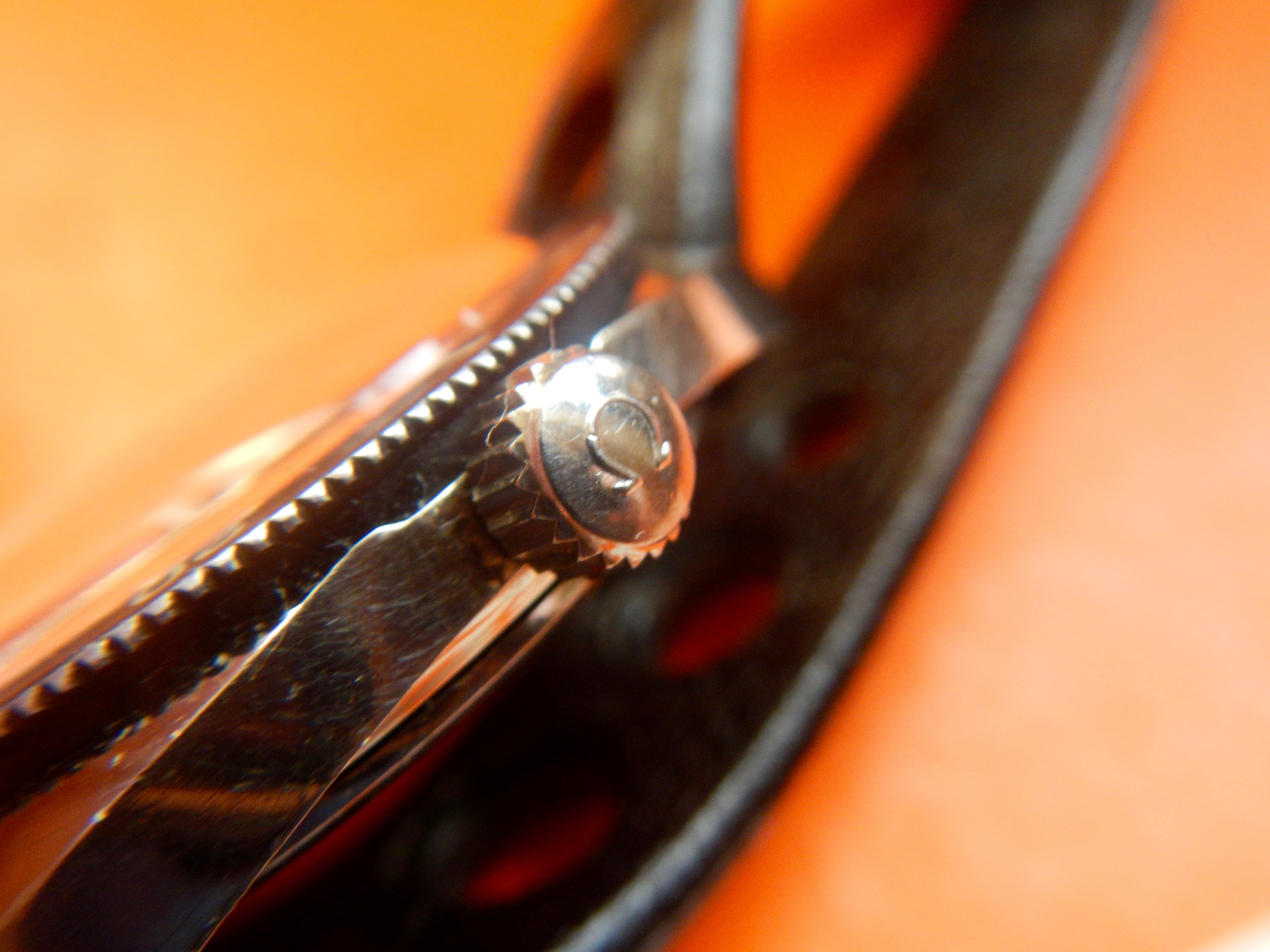

CROWN is not correct, I don't trust the case back , mvmnt shud be cal 601 ........ Omega launched the Seamaster 120 in 1966 ...... and the ad says it's from 1962 ?
214
188
Good point that caseback is scribble. What does it mean when there is a 1 in between the omega symbol on the movement.
3,689
18,156

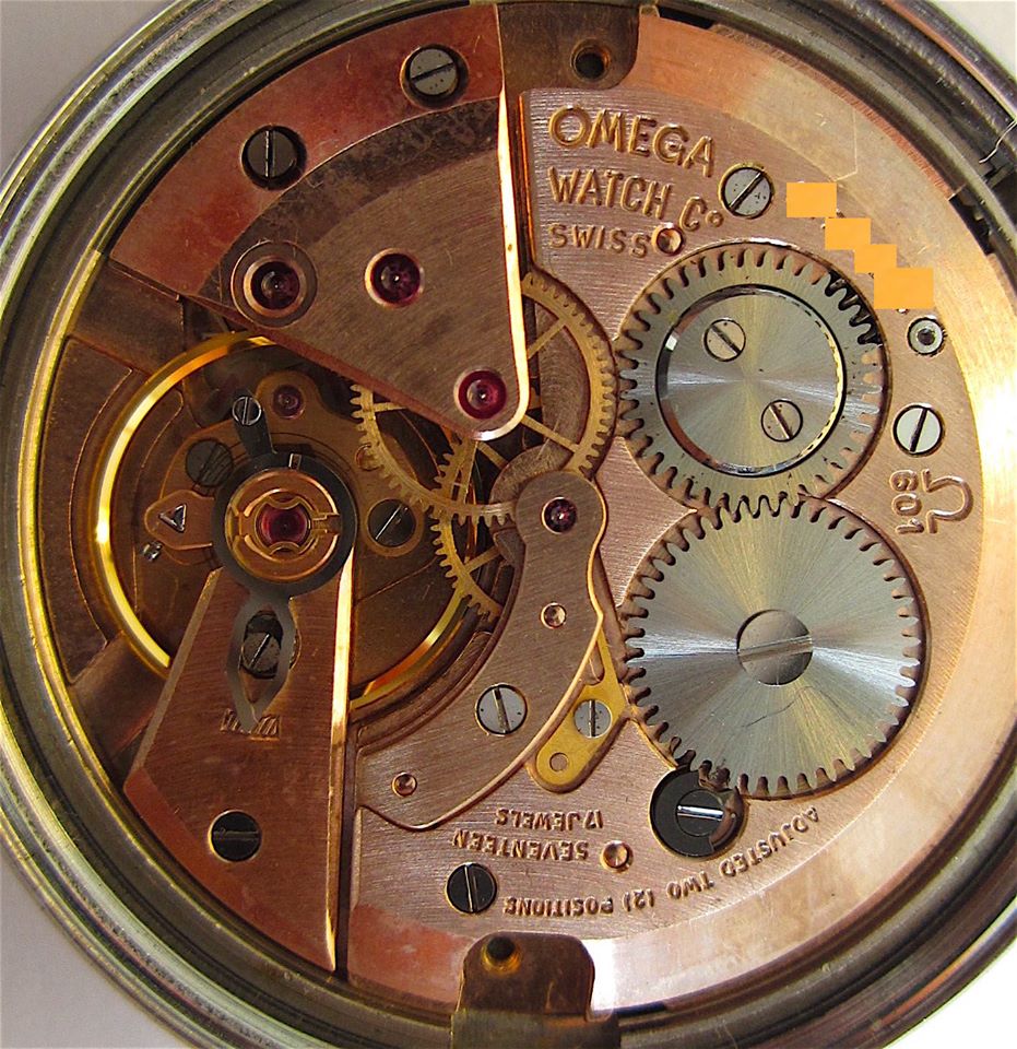

here is the no date, manual wind cal. 601 mvmnt ..... case ref 135.027
