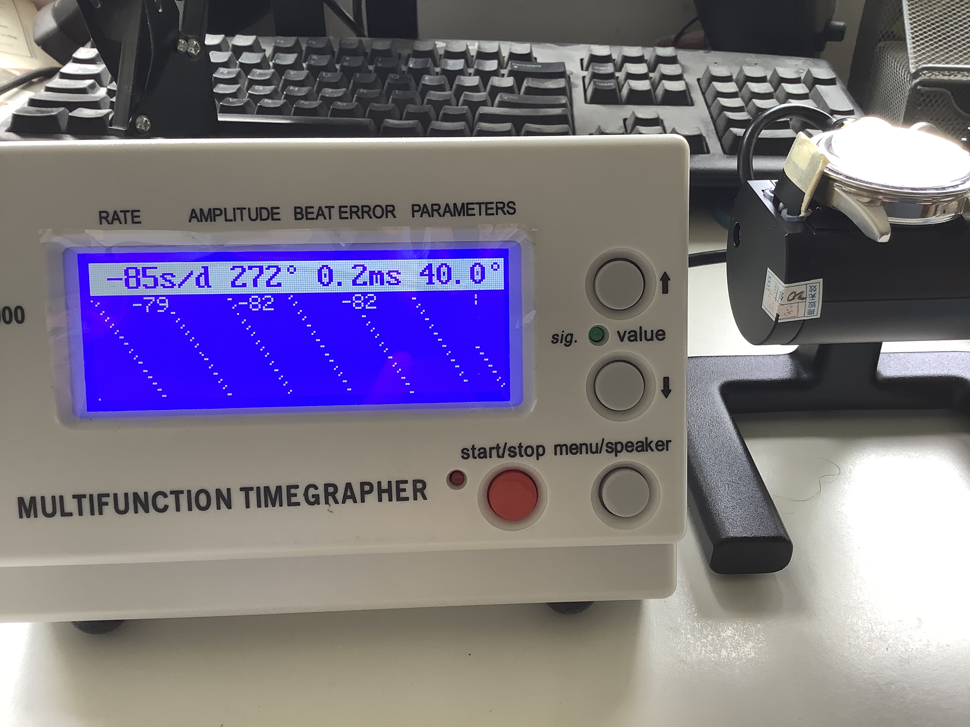

Just back (literally) from a full overhaul, seemed to be running slow, put it on the timegrapher:
They said it was within spec when it left the shop. No trauma since receiving it, not yet worn. What could cause this? Thanks.

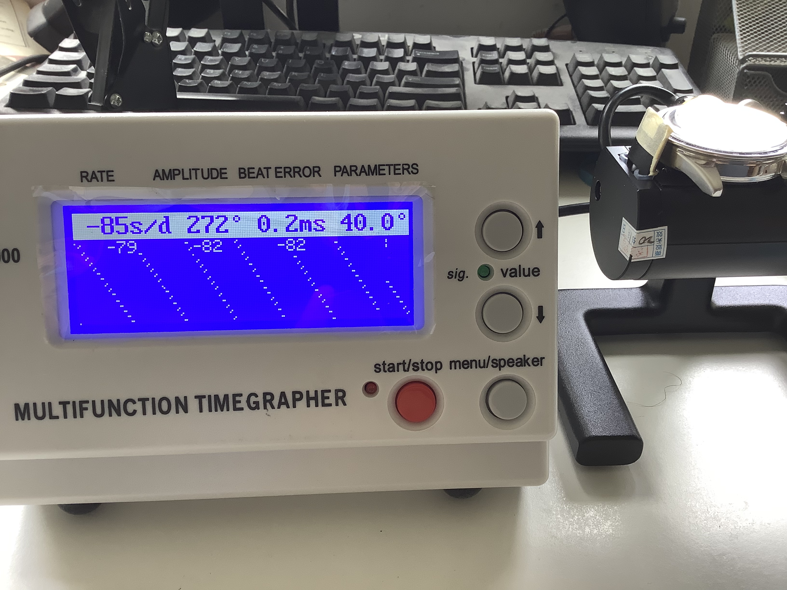

Poor service work? Whatever the cause, hand it back and ask for it to be remedied.
EDIT: you beat me to it David, and rather more succinctly too!

Sure thing. Just tell me why the beat error and amplitude can be within spec. and why the rate is so low, and I will give it some serious consideration…
7,393
23,865
Is that the reading in the best position, or the worst position?
Just took it dial up, didn’t have the gumption to go further.

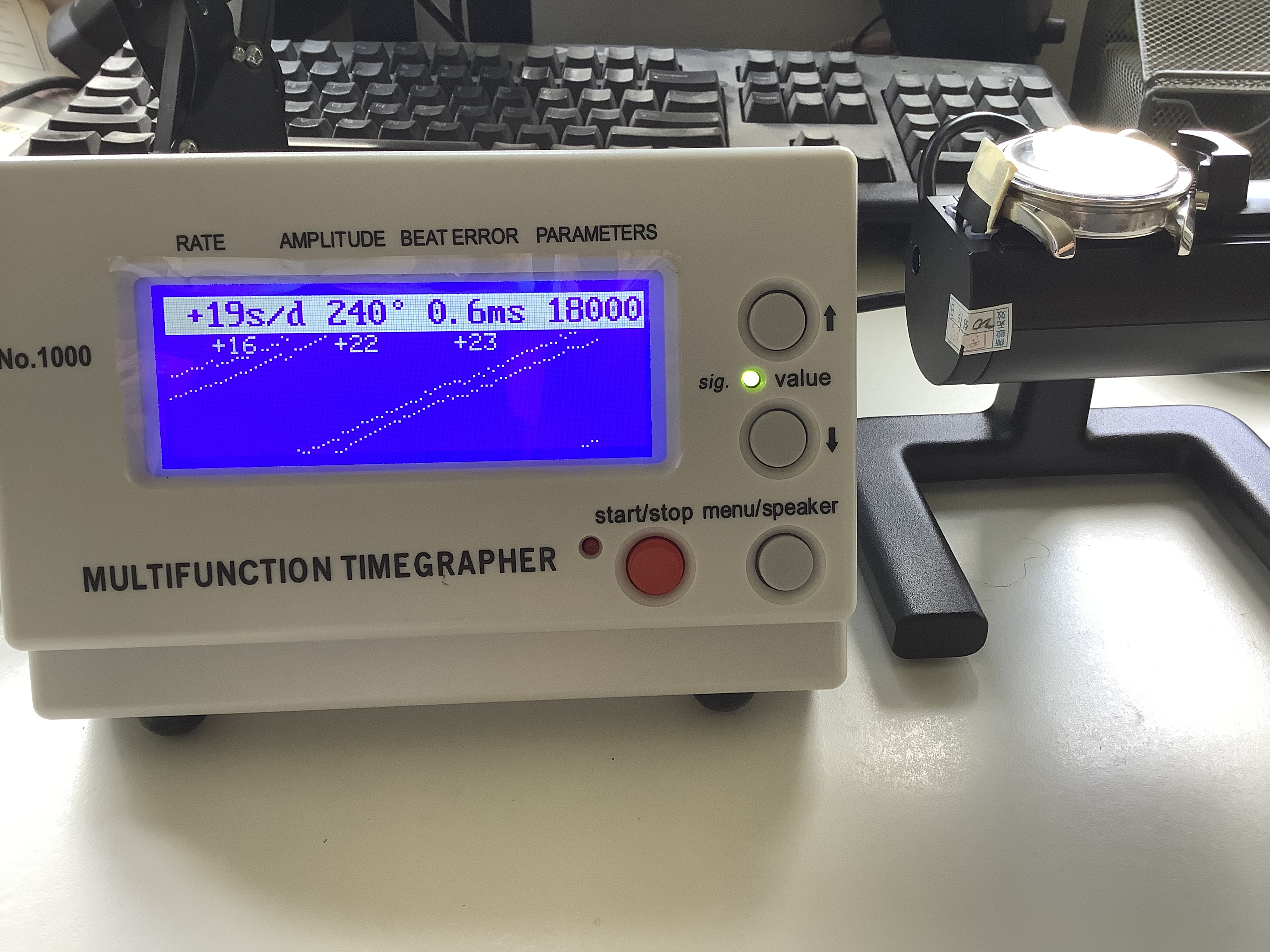

For shits and giggles, I just tested this other cal. 321 I have, that hasn’t been worn or serviced in over 20 years. Just wanted to be sure the timegrapher wasn’t flaking out:

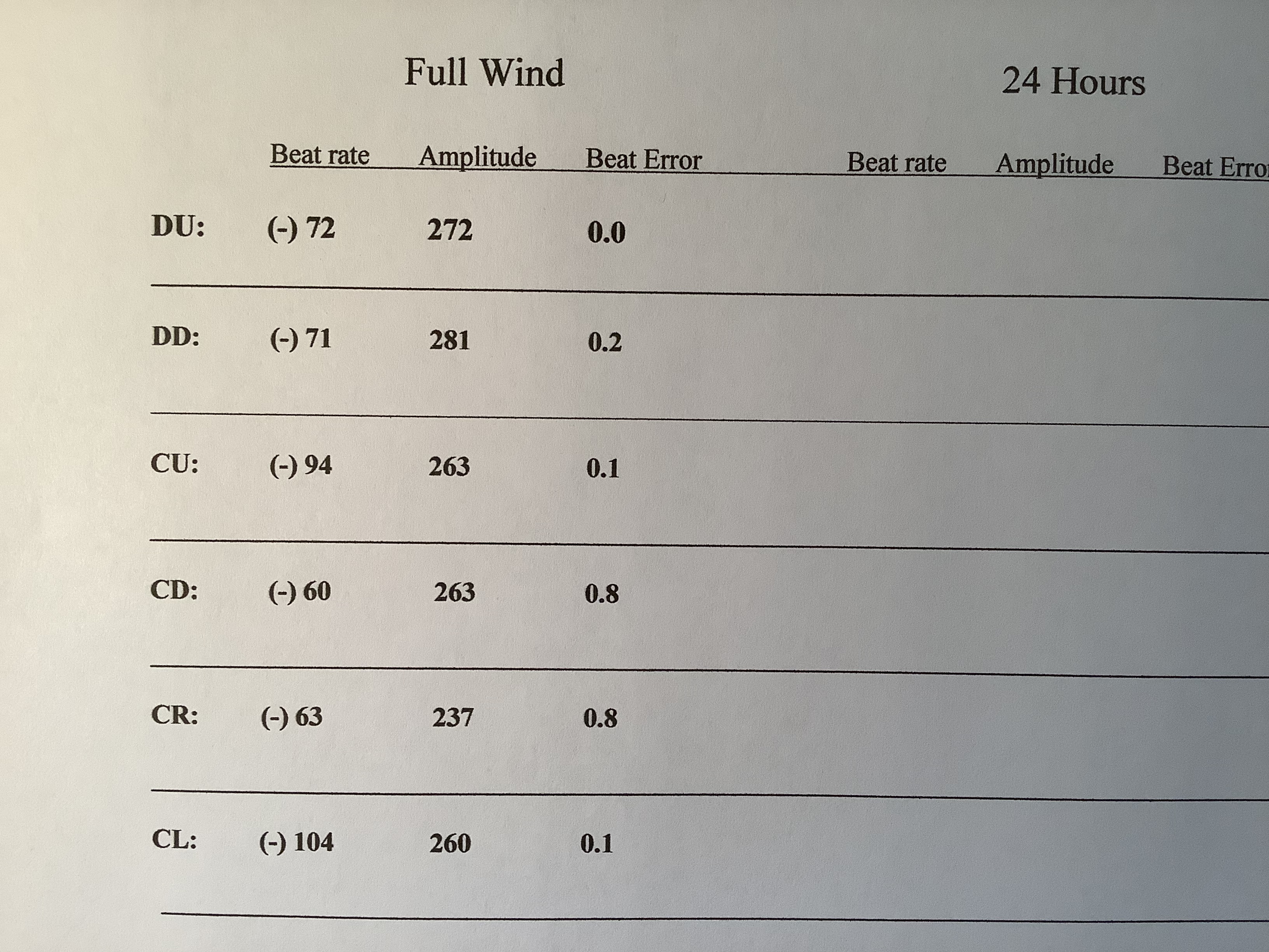

It may just be that the regulator has moved slightly. You need more information, similar to what I said in your other thread:
https://omegaforums.net/threads/is-this-watchmaker-excuse-legit.144163/page-2#post-1965881
The dial up beat error you've shown is fine and the amplitude is fair so, if you show the six position graphs at full wind (+30 minutes) with the chrono off, this will give a better idea.
Good luck, Chris
Thanks, Chris. Will post that.

Hi Chris,
Here are the results at full wind. Many thanks.
