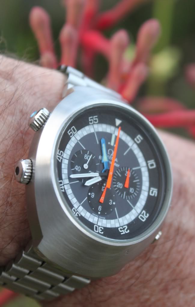

    My flightmaster Cal 911, has been the bain of my collection. Purchased in 2010, a few years later, (after I had sourced the necessities) I sent it away to have installed, new, some (5) “coloured” pushers, 2 x red subdial and Chrono seconds hands, Crystal, Caseback and to get a service. When it came back I noticed that the dial (Factory issued replacement - thankfully) had a lot of new chips around it, so had to purchase a new one and send it back to my watchmaker at the time. No apologies, no explanation.
    Regretfully, that watch had around 3 or more trips to that watch maker. Inner bezel would not turn, pushers were installed incorrectly, it only had a 12 hour power reserve. Etc
    When it finally returned, I remember wearing it for a day or two, still suspecting the watch had problems with the main spring as I could only wind it 12 times, instead of the 28 that I would expect in the least for a fully unwound watch. (Generally for me, it is one wind per hour of elapsed time. I wore it for a day or two, and put it back into my watch box. A year or so later I brought it back into my rotation and voila, within a day, the sub dials hours hand fell off.
