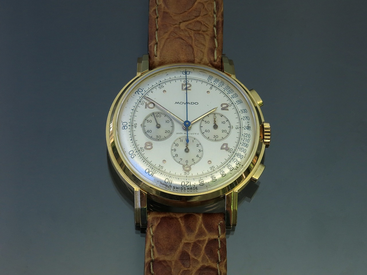

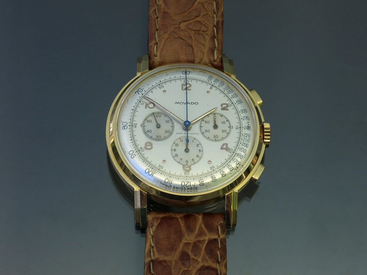

Hello all,
Been researching and digging into the Vintage Movado M90/M95 chronographs of late and have stumbled across an M90 that appears to be in very good condition. This one is available from a dealer, and I am considering purchasing. The case looks very nice, and the case design appears correct for the reference. My main concern is with the dial, which has a 'freshness' to it that I find surprising for a watch of this age. I have studied the dial and can't find any red flags. The font is sharp and consistent and the sub dials appear correct in relation to other examples I have studied...am i missing something?

Just giving this thread a nudge as I would like the viewpoint of someone more knowledgeable than me

I'm not an expert but also been saving up for the right M90. I don't see anything wrong either in consistency.
As with all purchases, it's also the seller you'd be buying into and if the price is too low that'd be a flag.
Likely already considered, but use a reliable Credit Card even if this is from Chrono24 (per the watermark), check it as soon as it arrives as the Escrow I've read may not fully protect you right if across different countries.

I'd echo the above on buying a reliable seller.
Also, if the dial is your worry, the case condition is telling me the dial should be crisp. I think they match.

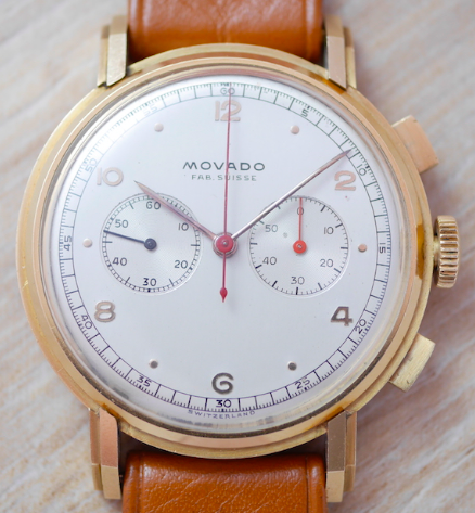

Here is a very similar dial on a M95. This one is not mine, just including as a reference of a known correct example from the era.

I have never dealt with the seller directly, but I have seen other watches of theirs featured on Bring a Loupe. Pretty anecdotal, but that is the only example I have of attestation to their credibility. I believe the above watch is being offered by Vision Vintage? I looked at that one as well but thought the lugs looked overpolished.

Yes it is being offered by Vision Vintage, lugs may be soft I was offering it as an example to compare dials with. I am more familiar with how a M95 dial should look no matter the variation, the Vision example looks correct to me.

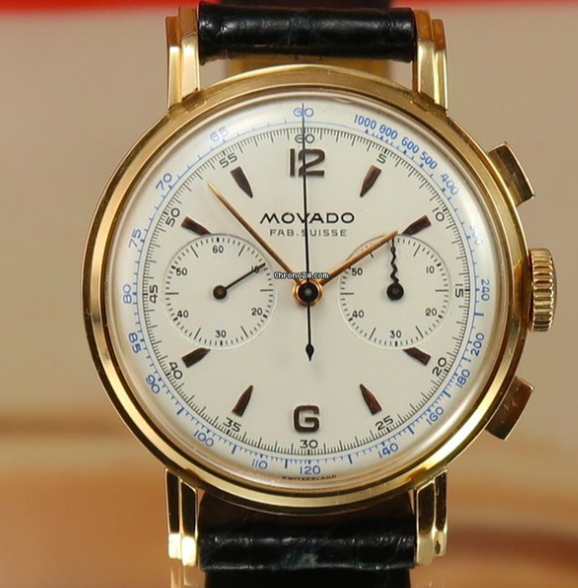

My next question is about the hands...should the minute hand extend to the minute track? The watch below is a ref. 9033, whereas the above watch is a 9023. I have not been able to find another 9023 on the web.

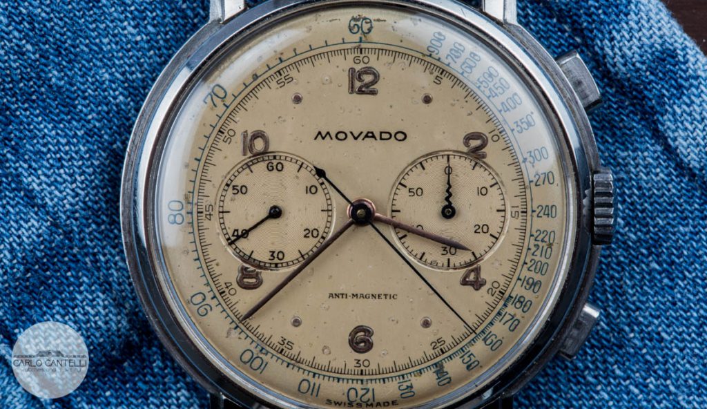

I think you are right with your concerns, not because of the dial's freshness which could be possible. But the font is a bit thick and not so sharp and not so good looking like on the example above or the one @Taybharr or @rfordo posted. Also, 30 seconds marker and 120km marker are not properly aligned.
Definitely!

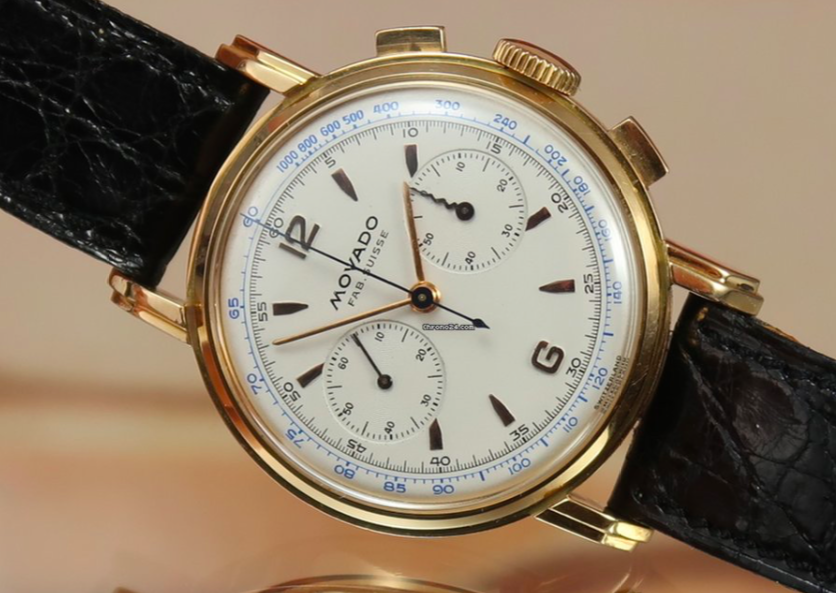

Personally, I would prefer the other one on chrono24:

You are correct that the seller is Cars and Watches. Very good eye on the 30s and 120 of the tachy not being aligned...I completely missed that. This is why I asked the wise folks of OF! I could have bought that watch and noticed it a week later. Once you see that, you can't unsee it. In terms of price, what dealer doesn't ask too high of price? Thankfully, these things are negotiable 😉
I looked at that one as well, but wasn't too keen on the bubbling of the dial that is occurring. Do you know how much they are asking for it? The other watch I posted above is for sale as well for 4000 EUR.

FWIW, it's entirely possible for a watch to still be honest and in this condition.
Without a doubt, but it seems appropriate when a piece is advertised as very good condition (with a corresponding price) to exercise additional caution.

My concern would be the dial finish and subdials lacking snailing- every other example above, including the other white (not silver) dial has the eggshell/sateen sheen and snailing. I would want to see many alternative examples with the flat white finish and no snailing to believe it is not a redial.
Based on the misalignment of the minute and tachy tracks as pointed out by @Oku, I'm leaning toward it being refinished. Although I think it is a pretty solid redial if it is one

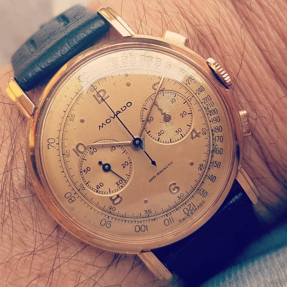

Keep in mind there are two types of dials on the M95s. The earlier, more valuable type has the smaller sub dials. The later more common type has the larger sub dials.
Look at the space between the sub dials. I have never seen an early, small sub dial Movado chronograph without a heavy patina.
