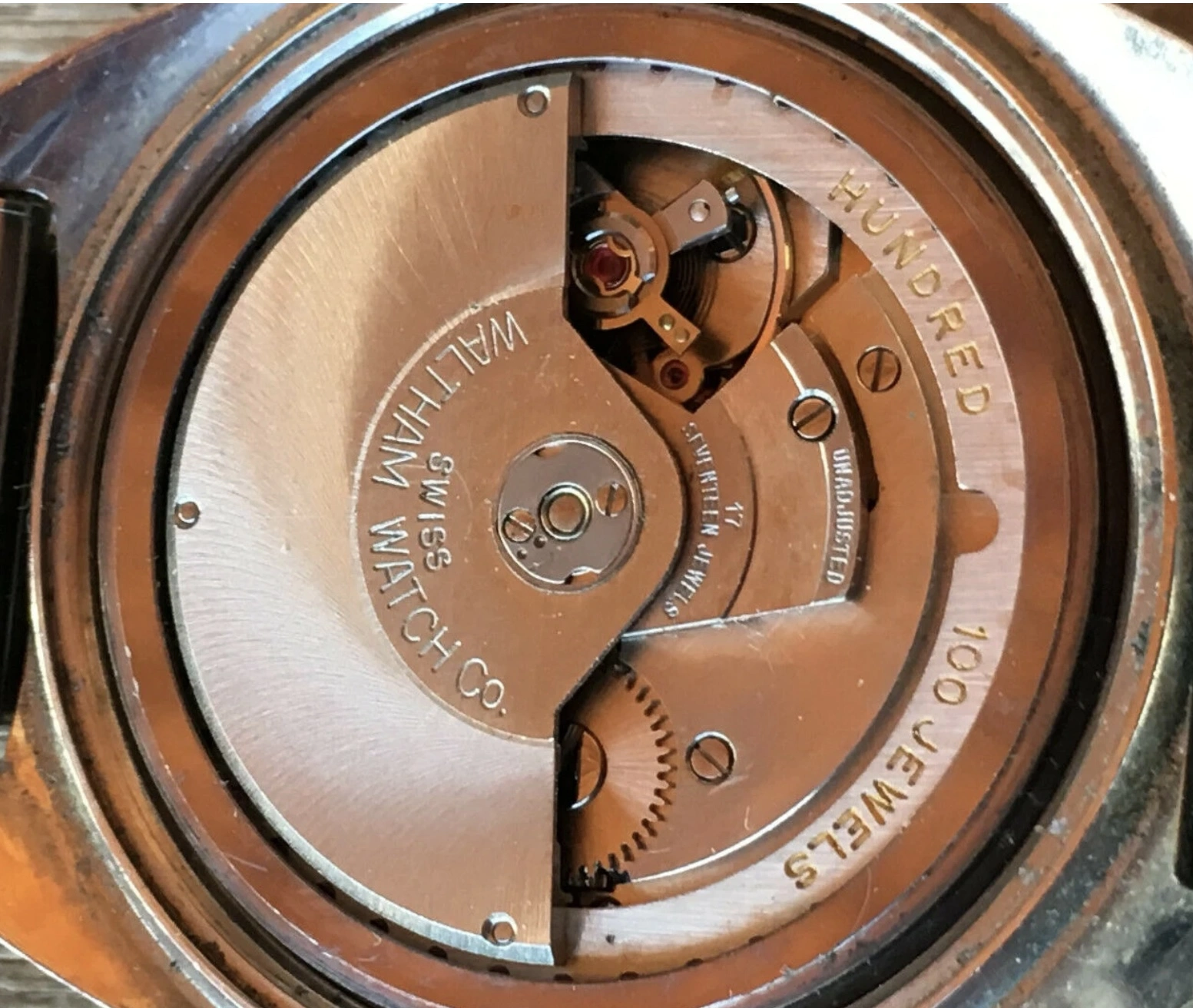

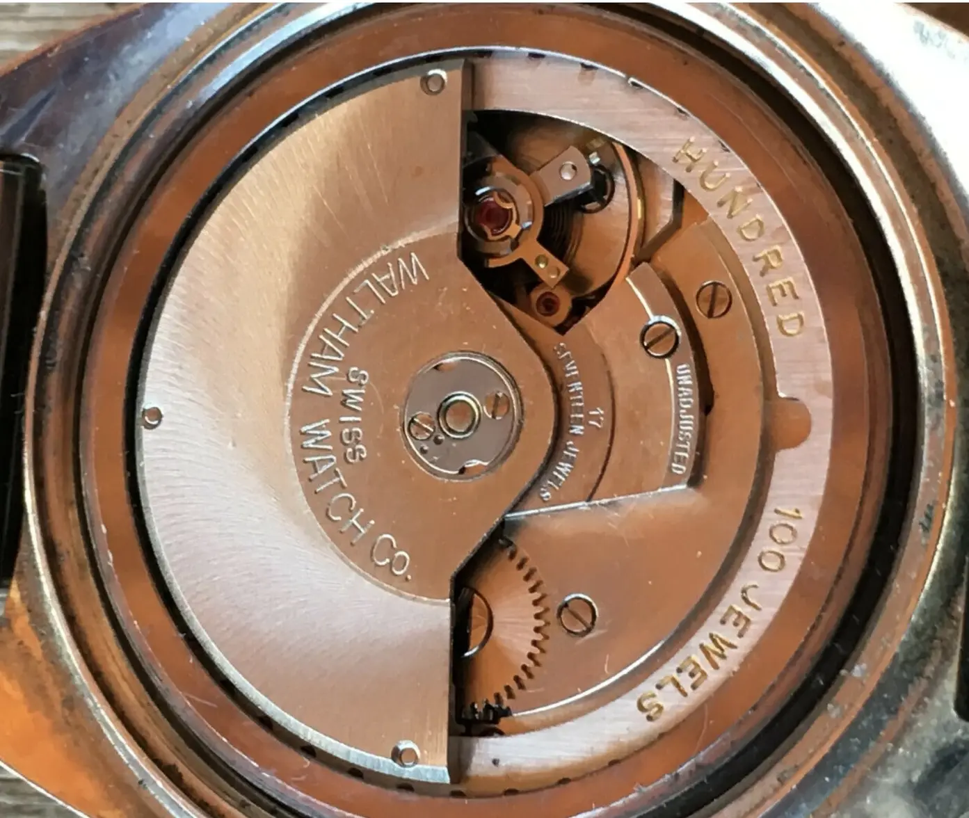

The movement shown in this post has what might appear to be a “perimeter rotor”. That is, the component stamped 100 jewel is a 360° ring affixed to the rotor. Some watches of this design utilize an internal ring gear which actuates the winding gears in the automatic winding. Some watches with this type of auto wind system have the rotor and attached ring running in jewelled bearings. In the case of the subject Waltham 100 shown in the picture, there are many cap jewels installed in the rotor and the ring, those jewels being barely visible around the outer perimeter of the ring. Not truly a perimeter rotor, with the self winding mechanism operating just as it does on a standard self winder. The movement pictured is pivoted in the centre of the rotor on a standard rotor post. The true perimeter rotor doesn’t have that centre rotor post, the rotor operating on a jewelled race around the perimeter. The jewels in the ring serve no function.
