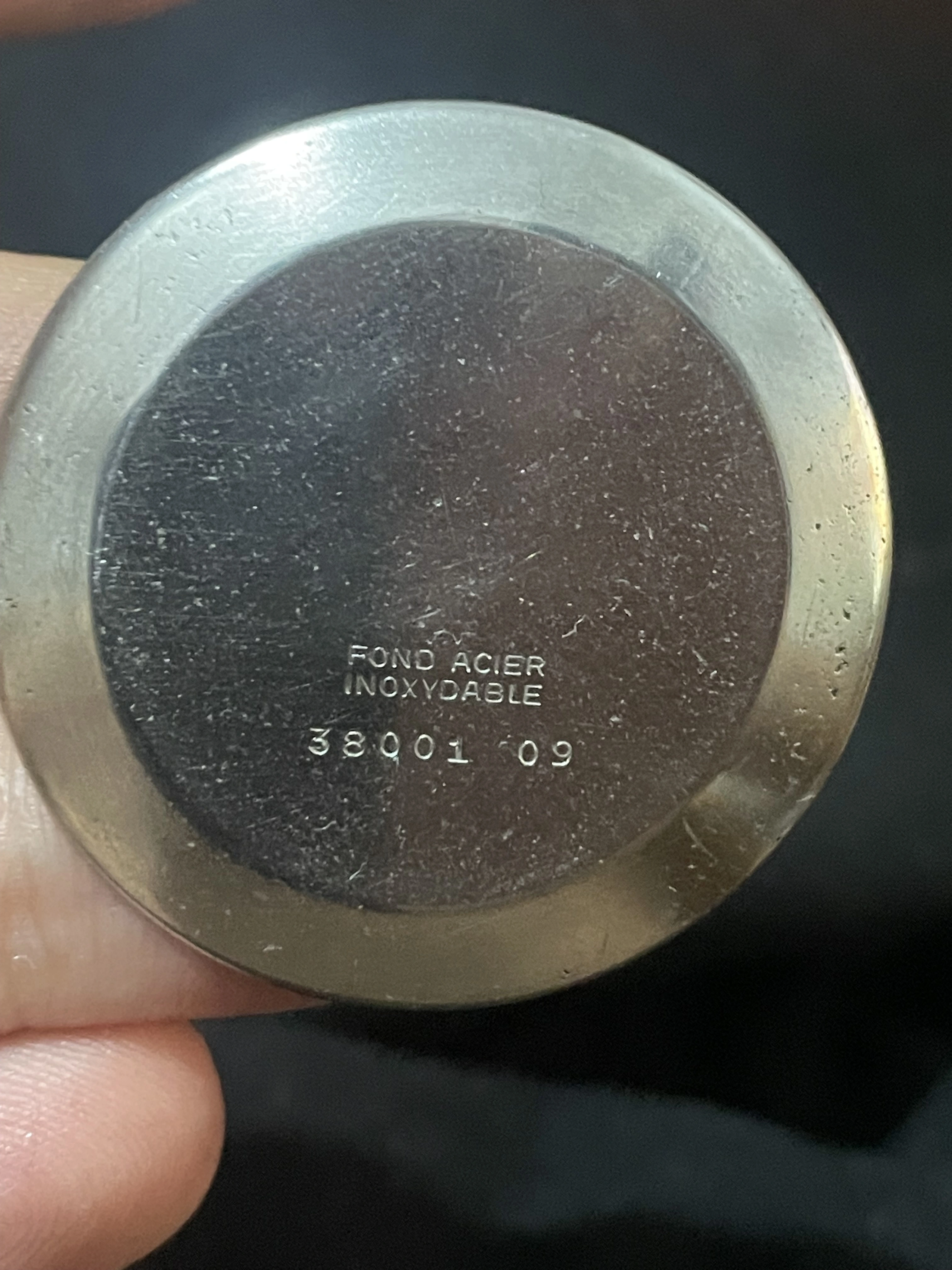

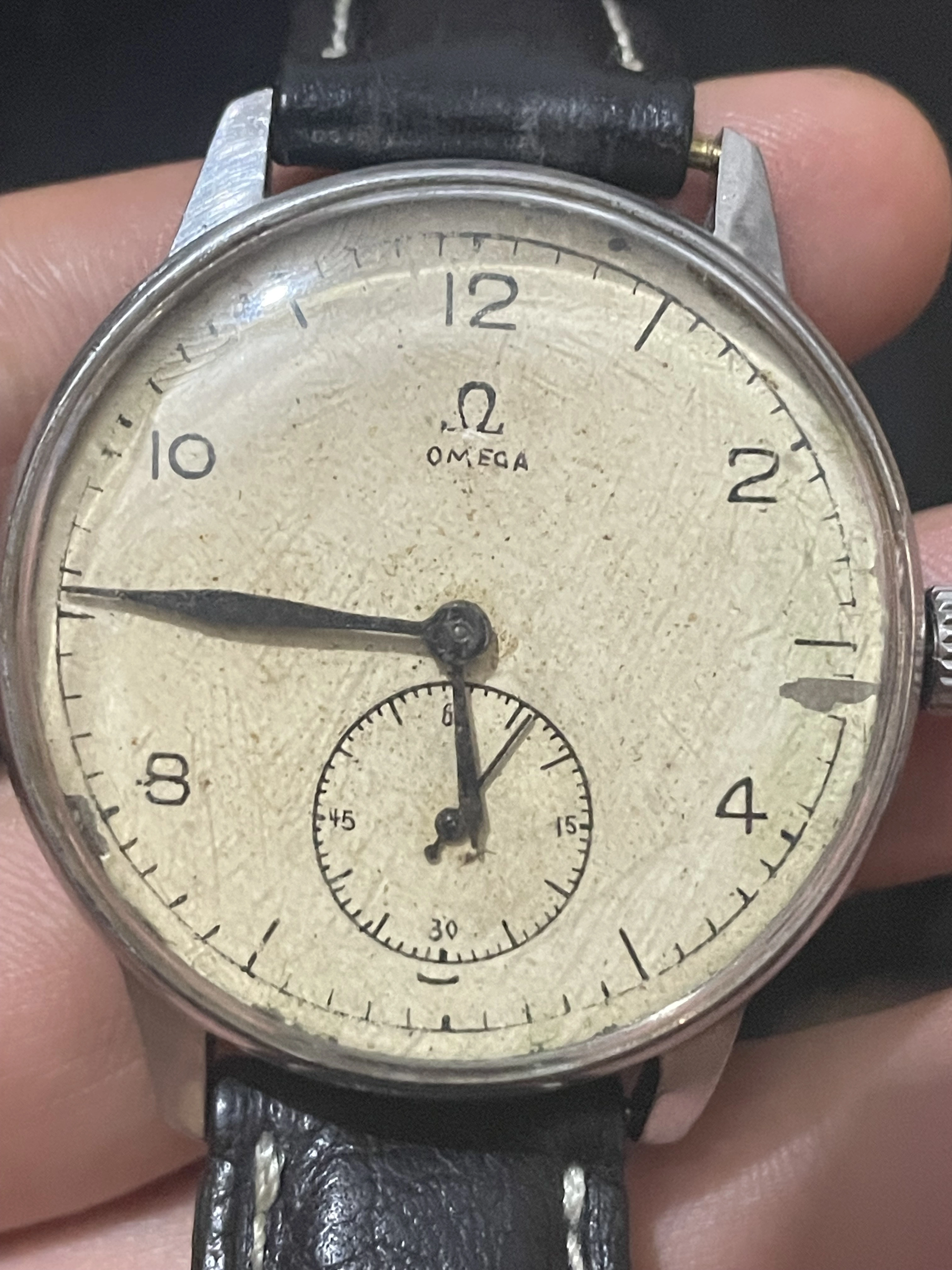

Unfortunately your watch also has at least a non-original case back. The case front possibly too. The hands dont look quite right either, possibly mis-matched hour/minute hands or a damaged hour hand.
3,653
7,770

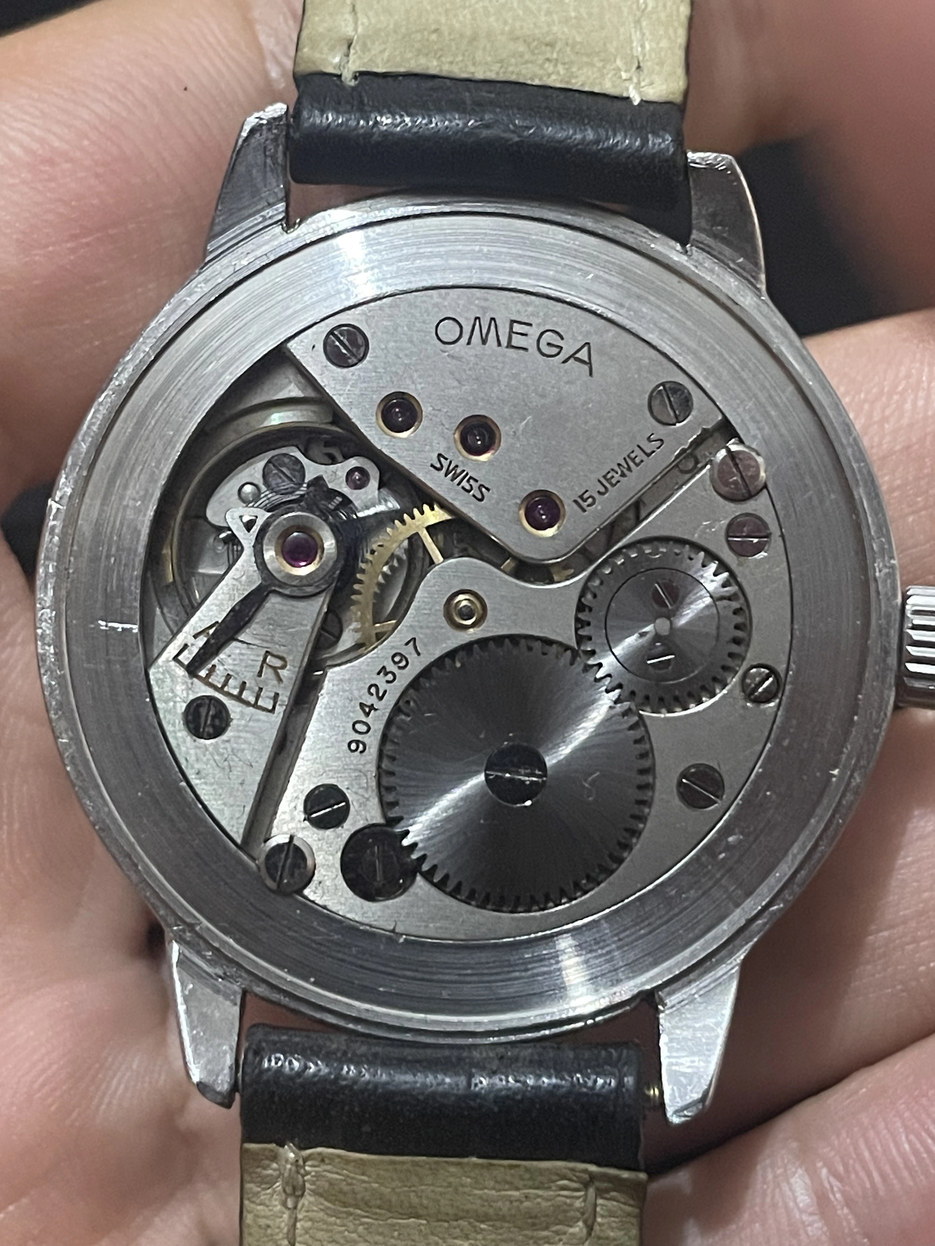

There’s also a number stamped on the movement: 902387. I’m not sure if this is the full serial or a partial one.
You obviously missed a digit!
It reads 9 042 387, so its of the correct length.
Movement is in nice condition and is indeed cal 30 (no T1 or t2)
But the rest is for the bin:
case is wrong, dial is awfully reprinted
hour and minute hands are wrong
sorry for the bad news

It really doesn't make sense for you to think about replacing parts, restoring, or even spending any more time thinking about this watch. It's too far gone (i.e. there is too little left of the original watch) and there is no plausible way to rescue it. If you like the watch, then wear it as is. Or, you could sell the watch to someone who has a need for the movement, and put the funds towards a better example.
4
I like the watch, but with that dial is basically unwearable! So i guess selling for parts is the best option.
