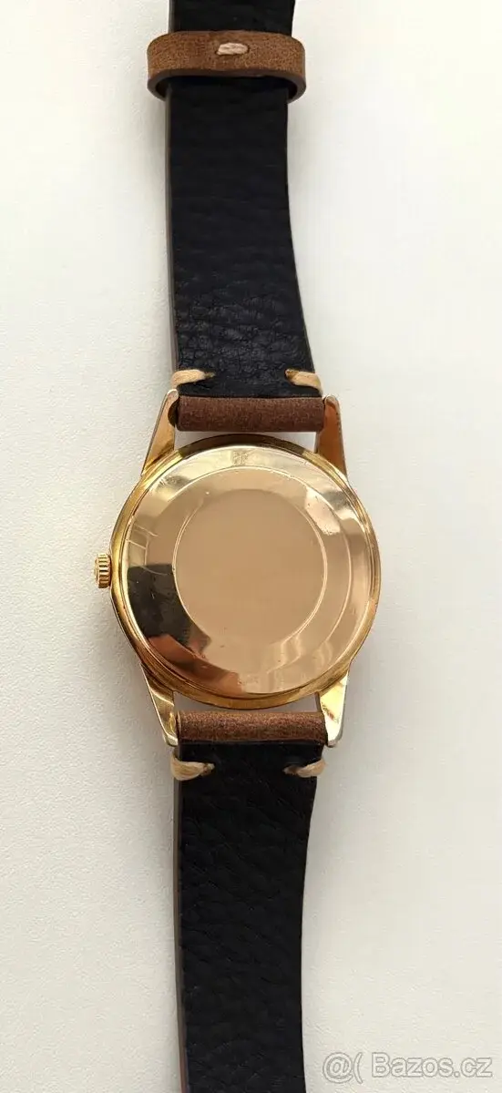

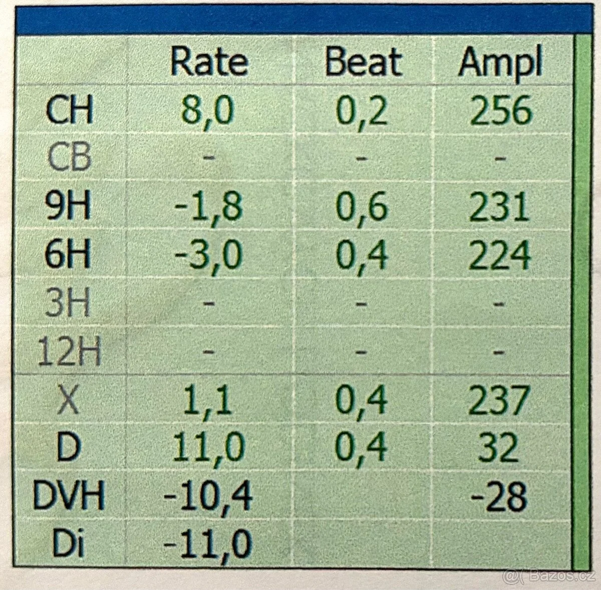

I’m considering purchasing a vintage Omega Seamaster with the Caliber 552, and I’d love some advice before pulling the trigger. The watch has recently been serviced, and the seller provided a timing report (attached below).

- Are the timekeeping numbers in this report a good sign for a well-running movement? The Delta seems within Omega specs, and the amplitude looks reasonable, but I’d appreciate a second opinion.
- Can't really tell if it is gold plated / gold capped?
