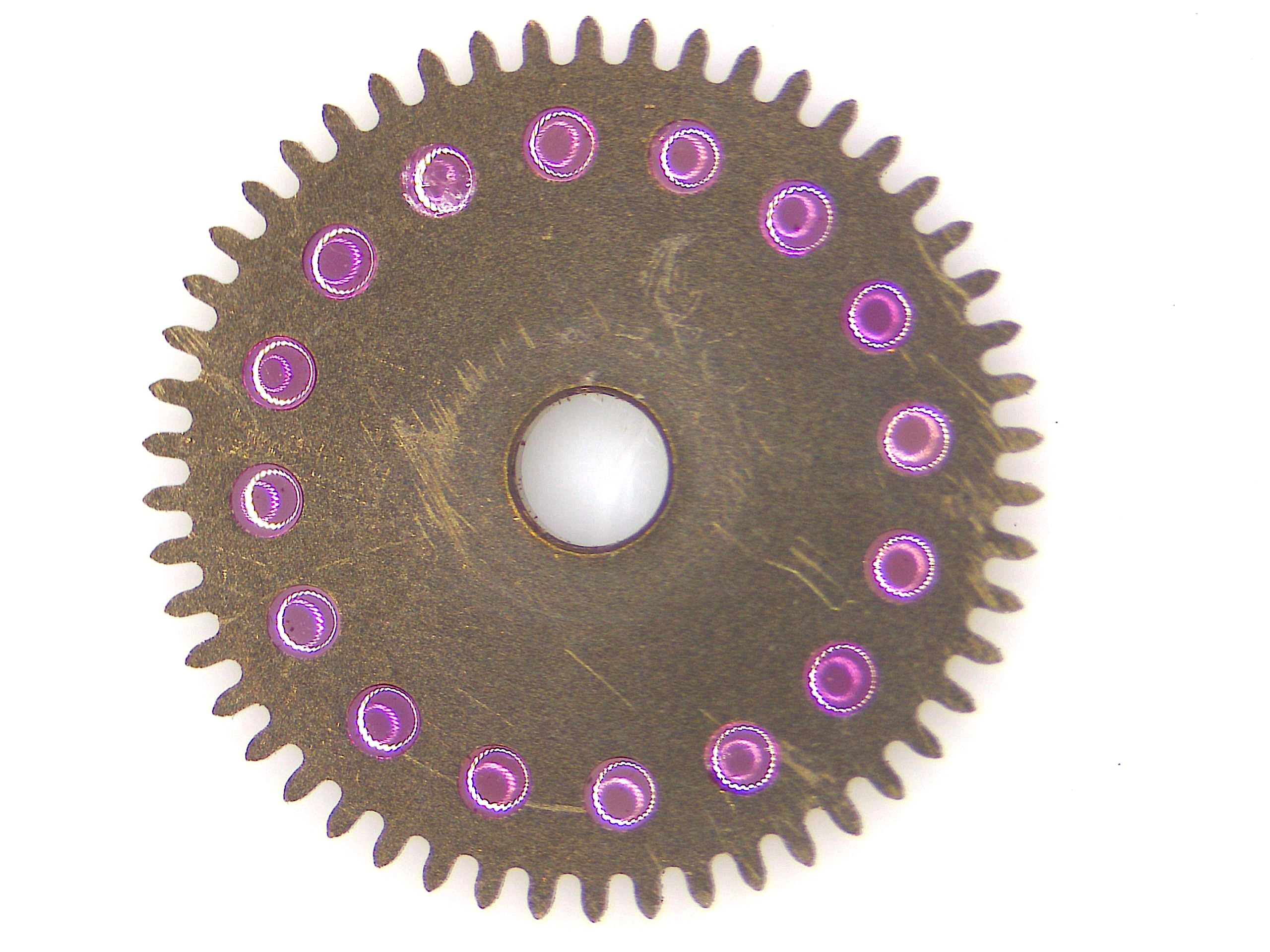

Just to refresh this thread.
Found in my Swiss watch graveyard.
Sixteen Jewels doing nothing.
5,081
15,687
It must have been embarrassing for the watchmakers when the marketing dept wandered in with that bright idea
