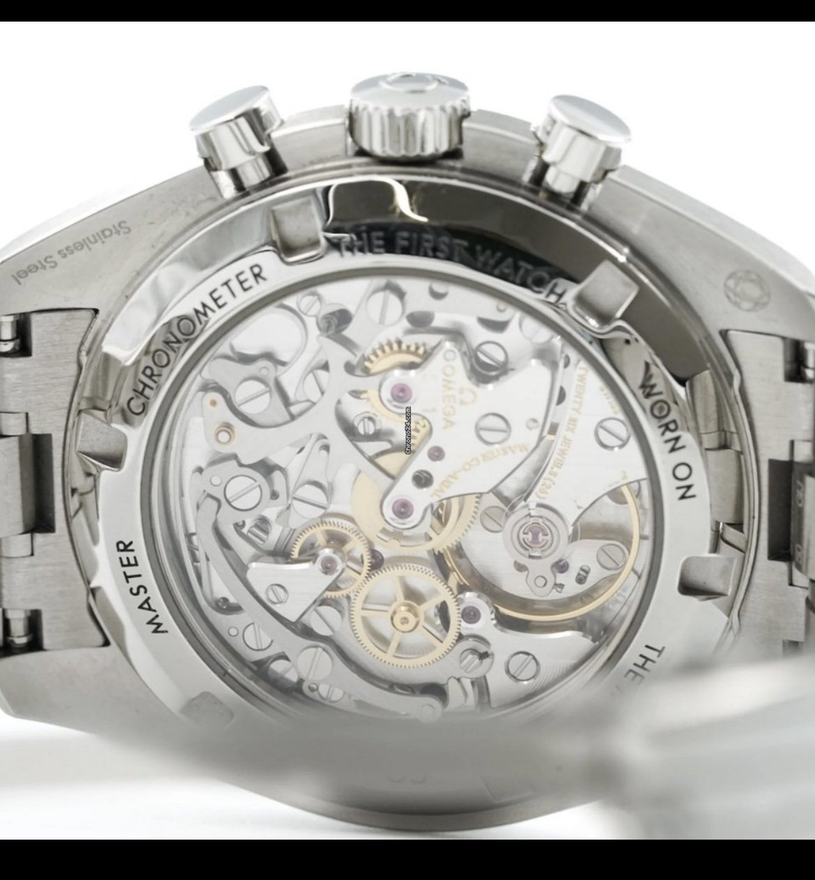

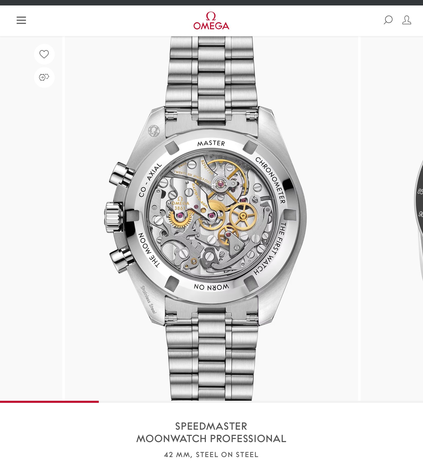

Posts 16 Likes 2 Article55 ·Dec 3, 2023 Hi all, I am comparing the stock photos and the case back of this SS. Is it normal for case back to be misaligned? Thanks!
Posts 6,609 Likes 26,779 Scarecrow Boat ·Dec 3, 2023 Article55 Is it normal for case back to be misaligned? Yes it is normal. The photo you see on Omegas website is just a rendering.
Posts 18,839 Likes 39,180 JimInOz ·Dec 3, 2023·Melbourne Australia The caseback is fastened by a helical screw thread so alignment is dependant on a number of factors, it's not an issue. If it was a Naiad (bayonet type fastening) caseback, then I would be concerned if it was mis-aligned.
