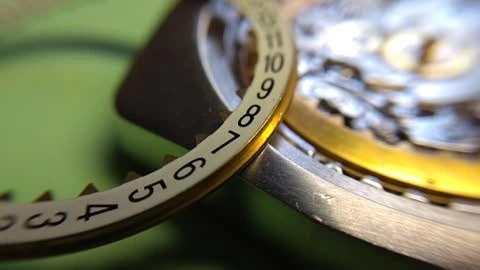

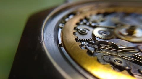

I am restoring a Zenith El Primero A788 fitted with the calibre 3019 PHC and I am looking for help identifying and sourcing two parts:
The date ring originally fitted to my watch is visibly profiled rather than flat. The outer numbered section sits at a different height from the inner toothed section. I have compared it with a commonly available flat 2557/1 ring, and the flat version does not fit correctly.
- the correct original A788 case back;
- the original curved or dished date indicator ring.
I have attached:
- a comparison between the flat 2557/1 ring and the original A788 ring;
- a side view showing the curvature of the original ring.
