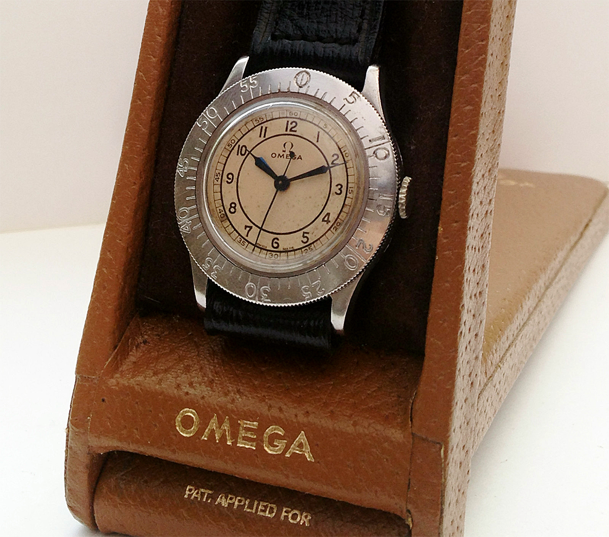

Medicus cal 23.4SC with bezel ring

Hi,
I am not convinced. I never saw an omega case that was not signed and numbered. I saw only one signed but without serial number. It had a 3 digit number, which I presumed (but no certainty) to be either a replacement caseback or a model numbered outside (like the Naiad you have bought) that has been overpolished.
I also never saw an Omega of that period with a spacer ring like the one you present. I don't know about the weems, but the only other rotating bezel Watch from that period from Omega that I know is the St Christopher, which doesn't have a ball bearing under the bezel, only a spring.
I would assume that the caliber dial and bezel are all original and in a very good condition, but they have been fitted in a non Omega case imho.
BTW I was keeping an eye on the Naiad you purchased and was also puzzled by the spacer ring. Would the case inner diameter be 25.6mm without it? Naiad were also produced with 25.6 cal and it could be the case of one of them. That was my guessing looking at the pictures during the sale but, not having bought it, I have not been able to investigate further on this supposition.
There is probably one way to know more : asking for an extract from Omega with the caliber number of the rotating bezel one, they should be able to say with which case it was delivered.
1,516
4,769
Hi,
Hello. Thank you for the reply.
If the watch was only a experimental watch I would not expect the case back to be marked or numbered as a production run watch would have.
The rose coloured movement ring which I think could be brass has a stainless steel nib inserted in the side which would have probably been but there originally to hold the movement in place against the inner case side, I believe the watchmaker who built this watch used the softer brass so the steel nib could be inserted into the brass and hold much better than a steel in steel construction. I will add pictures of this tomorrow of this area.
The movement ring of the medicus in the first picture below looks like it could be brass underneath too.
I still have not found a case like this on any other watch, I am sure a watch with a case like this would be known and collectable.
Below is a picture of another omega from the same era with the same circle with a line through it on the bezel at 12 oclock , this again I have not seen on any other watch bezel other than this omega.
The medicus I have just bought on eBay looked OK to me, here are two other examples with the same spacer ring.
I welcome your comments but not one thing yet as convinced me it is a franken watch while everything else makes me believe the watch has been made as a experimental watch.
I have spoken to the Omega museum regarding the watch and they cannot tell me if it is a prototype or not. Omega archives are not the best the older the watch is, I have been lucky in the past if I get much information on a watch from the 60s.

Do you know what is the inner size of the case without the spacer ring for the Naiad?
1,516
4,769
Hi.
Yes it is 26.3mm

I can't imagine Omega producing a case that doesn't fit one of its calibers without spacer ring. I think the Naiad was made by Omega for a 26.5 and fitted with a 23.4SC, by Omega or a distributor or a later owner. For the one with the rotating bezel, I doubt that the case which does not fit either 23.4, 23.7 or 26.5, was produced by Omega. If you refer to the explanations provided with the other one you show (http://omega.watchprosite.com/show-nblog.post/fi-/ti-532136/t-/) it was exported to France but found later in India. Could have been recased there, this would not be the first time. Another explanation would be a French distributor who bought calibers and cased them in non Omega cases. We have other examples, like a St Christophe shown in AJTT. But without any historical facts on the Watch, it is impossible to know the real explanation.
1,516
4,769
Hello Tire-comedon.
All three of the other examples I have shown have the same spacer ring as the niad medicus watch I have.
You said the niad medicus I had looked like it had the wrong spacer ring, then I showed you three other examples with the same spacer ring, I might be getting a little confused here so sorry if I am. What did you mean about the spacer ring not being correct, is it something I have missed?
The Omega with the rotating bezel (cal 23.4) is designed with a bezel which is held on by screws from inside the case, as you can see from the front the dial fits in the case perfectly with the uniform white plain space around the edge of the dial like the other Omega watches I have seen of this calibre or era.
what I have is a watch that the movement can only be removed from the back. The dial over hangs the movement so a spacer ring would have been needed to fit the case while the dial still fitted the space of the circumference of the bezel, looking at my pictures of the watch you can see with the dial and movement out of the watch the spacer protrudes a bit on the edges, if this spacer was flush with the dial it would have probably been too thin.
The watch also has 1940 and 1941 case cack service dates etched inside. I cannot imagine someone making this case, spending hours and days just to fit a Omega movement into it, surely to get another Omega case would have been easier? The person who had the machinery and tools in those days to craft a case of this quality must have had good training and money behind them especially to afford the precision tools needed.
The tiny round grooves on the middle case back made in the case making process are identical through a loop to the niad medicus I bought to compare the two watches, the materials used in both cases seems to be of the same quality too.
The case must be a one off, I am pretty certain a watch by any other manufacturer with a case style like this would be known to the collector market but I have not seen another one ever.
I have looked at the other watch you mention in your link and which we have looked at in this thread, this again is a design we have not seen before, The bezel marking and case back shape are very similar to the watch I have.
I think as collectors it is sometimes too easy to dismiss a watch that we have never seen before, to me it is better to investigate before dismissing the watch as a franken watch, the investigation is part of the fun of vintage watches for me. I still strongly believe that this watch and case are a one off made by Omega at the Omega factory as a experiment. I might be bias I know. I would love someone to show me hard evidence like a watch with the same case that was in production by another watch company. but as you have said without historical facts and maybe a time machine it is sometimes not possible.
Could you also answer my question regarding the niad medicus please? Do you think it is correct? and is this how it would have come off the production line?
Many thanks for you input, it is greatly appreciated.

Hi Mick
For the Naiad, you're right, I made a mistake.
The spacer I was thinking about for Naiads is this one :
which is found on later (1941) tonneau shaped Naiads.
When I checked for comparing the spacer for Naiads first generation like the one you showed, I went to pictures on my hard disk (I hate to open too often my wathes) and saw this Medicus, with no spacer, which apparently confirmed my conviction that early Naiads didn't have spacer rings. :
But after your last thread, I opened my Naiad to double check, and realised I did look at the wrong picture and compared yours with a later type and not Naiad 1st gen.
I can confirm that the first Naiads had the spacer as you showed, mine has the same.
I apologize, I should have been more careful.
regarding the other one, there's nothing more I can say, except that you could try to get info on the Watch with caliber number from Omega.

Hello Tire-comedon.
That is great news for the Naiad medicus then, many thanks for checking your watch for me I appreciate you doing that.
I have contacted the owner of the other medicus with bezel to see if he can help with it, I will report back if I get any news.

Just a update on this.
I have spoken to the Alain Monachon at the Omega museum regarding the watch with the rotating bezel, according to the Omega ledger the watch is recorded as a CO 2063 stainless steel with gold bezel produced in 1939, we talked at length about the watch and the model 2063.
I said I was under the impression that the 2063 had a bigger dial than the (bezel) watch I own, My pictures above with the dial of my (bezel) watch alongside the Naiad medicus watch clearly show a difference in diameter, isn't the 2063 dial meant to have the same size dial? The dial on the bezel watch looks like it was manufactured to fit the case perfectly. I was also under the impression that the 2063 did not have a removable bezel and have never seen a bi metal 2063 or any other bi metal Omega from this era. I also wondered about the service marks for 1940 and 1941 in the case back, would someone re-case a one year old watch or is the case from another watch if so which watch?
Alain was very helpful and could see my point of view regarding the watch but said without going back in time he could not be certain of the manufacturing origins of the watch, he also noted the similarities in bezel design with the other Omega with inner bezel from the same time period of 1939 which was verified as a Omega CK 2093 by Marco Richon. This again seems a coincidence that both this watch and the bezel watch I have were both produced in the same year.
Hats off to Alain for calling me, we spoke at length about this watch and other Omega watches we both own and have owned, I was surprised at how helpful he was, he also sent a few pictures of some of his watches and the view he has from his desk in his office which was full of Omega goodies. He also owns a collection of Omega medicus watches too.
It is good to know someone has a real passion for watches at the Omega museum just like the rest of us here, he really made a good impression on me so cannot fault the service I got.
I am still non the wiser about this watch though, I know some of you guys know a million times more than me about watches from this era, so my questions are> Have you ever seen a 2063 with a gold bezel? are the bezels on the 2063 a integral part of the case or are they removable? What about the dial diameter, is the dial on the 2063 the same size as the bezel watch I have or is it bigger like the Naiad medicus?
I think my research on this watch is done, I have enjoyed it and guess it will remain a mystery, I might see a watch with the same case one day that doesn't contain a Omega movement or I might not, I might hear news that yes indeed someone owns a bi metal 2063 and it does exist.
My new research project is a 1940s Royal navy Vacheron & Constantin deck watch, I plan to find out which ship it served on so that should be fun. I have a couple of mystery watches which I will post about when I have a bit more time on my hands.
Cheers Mick

Hi, I am not familiar with ref 2093, so I can't really help you for this one. Do you have any documentation on this ref? I would be interested to have a look to it. The only thing I can guess is that if it is a Naiad it probably should not have a removable bezel, at least based on the ones I have seen. BTW this explains the spacer ring ;-), it is needed to insert the caliber from the back side. Also based on what I have seen, most of non Naiads medicus did have a removable one (but for CK 651, the first square medicus, for example, or CK2044).
Ref 2063 is not a Naiad. It is one of the first medicus. It was named 'Chantilly', launched in 1937, the same year as the 2041 'St Christophe' and the 2064 'Naiad' 1st generation. Here in an ad for retailers :
Here in two ads in a newspaper :
Here also in the 23.4SC - not waterproof - section of the 1940 Catalog) :
It has a removable bezel with a very specific shape : very thin and high, it looks somewhat like a cylinder.
Mines say hello :
dsc_0022.jpg original dial
A small case (28.5mm), if the Watch was a 2063, it is no more in its original case. I measured a 26.5mm dial on mine. Hope this helps.
Regarding bi-color cases, I have one example from the same period : the CO 2300 (http://www.omegawatches.com/spirit/history/vintage-omegas/vintage-watches-database?ref=14917), from 1943. So it is possible that bi color cases were also used for other references, lthough this 2300 is the only gold tone bezel ref I saw from the 40's.
My CO 2300 is still a project, one day, maybe..... :

Thank you for taking the time to send all that information Yann, That has answered many of my questions especially the gold bezel details and the detailed pictures of the 2063 have helped a lot too..
The only thing that puzzles me now is why the dial on the bezel medicus is smaller than the 2063 Omega say it is recorded in the archives as.
The 2063 dial is 26.5mm however the dial on the bezel medicus is 23mm so quite a bit smaller, it fit in the case perfectly, the hands are also not as long. Someone must have gone to a lot of trouble to create this watch, I wonder were the smaller dial and hands came from? or were they made for this watch? I know they are original Omega items. I have noticed this morning that the numbers on the dial are very similar to a Omega/Tissot 15cht I have too from the same era.
Once again thank you for you help Yann.
Cheers Mick

Hi,
I saw your message :
Nearly 550 page views and not one idea of who the case was made by, I have been pointed in the direction of this Omega ad from the 30 with a similar watch but not close enough. Anyone know anything?
This Watch is not related to the one you showed. It ias a ref 650, with a three steps bezel. It can be seen on page 126 of AJTT.
Here is mine (photo taken before I replace the second hand by the correct one...) :
It is referenced as a medicus in the Richon. It is not a Naiad (non waterproof), with 31mm case. It may look bigger because it is on the side of a very small women's Watch on the ad.
The medicus was produced with one, two or three steps bezel.

Found this on the bay - thought it was yours obviously not - it has all the elements that yours has including the very thick spacer etc.,

Thanks for the info yet again Yann, I did wonder about the watch in the Omega ad, The lugs, case and dial looked exactly the same as mine but I was not aware of dimensions.
As above the watch is for sale on eBay.

guys, that is a great thread. some forensic investigation...... that is what it`s all about among collectors ! be very polite in achiving a result for the greater good. my hat is off to both of you. during the auction i did not want to interfere with more comments. but the first gut feeling, i had, about that case was a Movado case. on the other hand, movade signed all cases as well. so, the only guess would be a one-off from the case maker for omega/movado/.......later recased to fit a different mvmt. & dial. the service marks belong to the case; whatever it started it`s life with. if the omega inerts have been added later, the case marks have nothing to do with the current setup. for the present state, i think the auction result is a good one. kind regards from down under. achim..........and, BTW: Alain is a very passionate omeganisti, yes ! an excellent continuator for the work, John Diethelm started ! Omega can be proud of these guys; many other big Swiss Watch Manufacturers could learn a lot from these guys, who preserve the history and write new history.

Thanks for the comments Achim and to all who have contributed especially Yann..
The US buyer has just contacted me to say he is unsure after just reading this thread, I do hope he joins in the thread.
I respect his comments and can understand his worries about this watch. It is still my believe that this is indeed a prototype and a lovely looking one at that, as I have just said to the high bidder, I would have not risked making a fool of myself showing this watch on the Omega forum if I thought it wasn't a prototype of some kind, I have had some great answers regarding the watch but nothing in my mind has been definitive, I think the buyer thought I had doubts about the watch and this was the reason I put it up for auction. This was not the case, I just came to the end of what I could find out so the fun had been had for me.
Not a ideal way to end the auction but so is life.
Alain at Omega has been fantastic, he has a great passion for vintage Omega, he took my mobile number and has shared a few pictures and messages with me which he did not need to do but did them because he has a genuine interest in Omega watches and their history.
Even though this has not ended in the best way I still have good feelings about the whole process and have learnt a few things on the way which is always good.
Cheers guys!
Thanks Mick

Thanks Achim. I must confess I love this kind of exchange and it is always interesting to discuss about a watch for which we can't determine the origin.
Michael, I am sorry to read that the buyer is hesitating. Your listing on eBay was absolutely fair and transparent, all the information you had was there. The buyer had read it and could also have seen the thread before bidding. And BTW he would not have discovered more info on the Watch here than in your listing. There is no ground for cancellation in my humble opinion, I hope you'll do the deal with him.

Thank you Yann.
The high bidder seems a nice guy, he is apologetic and just got caught up in the bidding process at the last minute on his mobile phone, I have done the same thing before, he has said he saw this thread afterwards.
I am glad he spoke up now instead of me sending the watch across the pond only for it to be sent back again.
I think I will contact the under bidder and direct him to this thread before he makes a decision on the watch, hopefully he is a member here.

i was bidding myself, michael. with a slight price adjustment , this is a great watch to own. kind regards. achim
