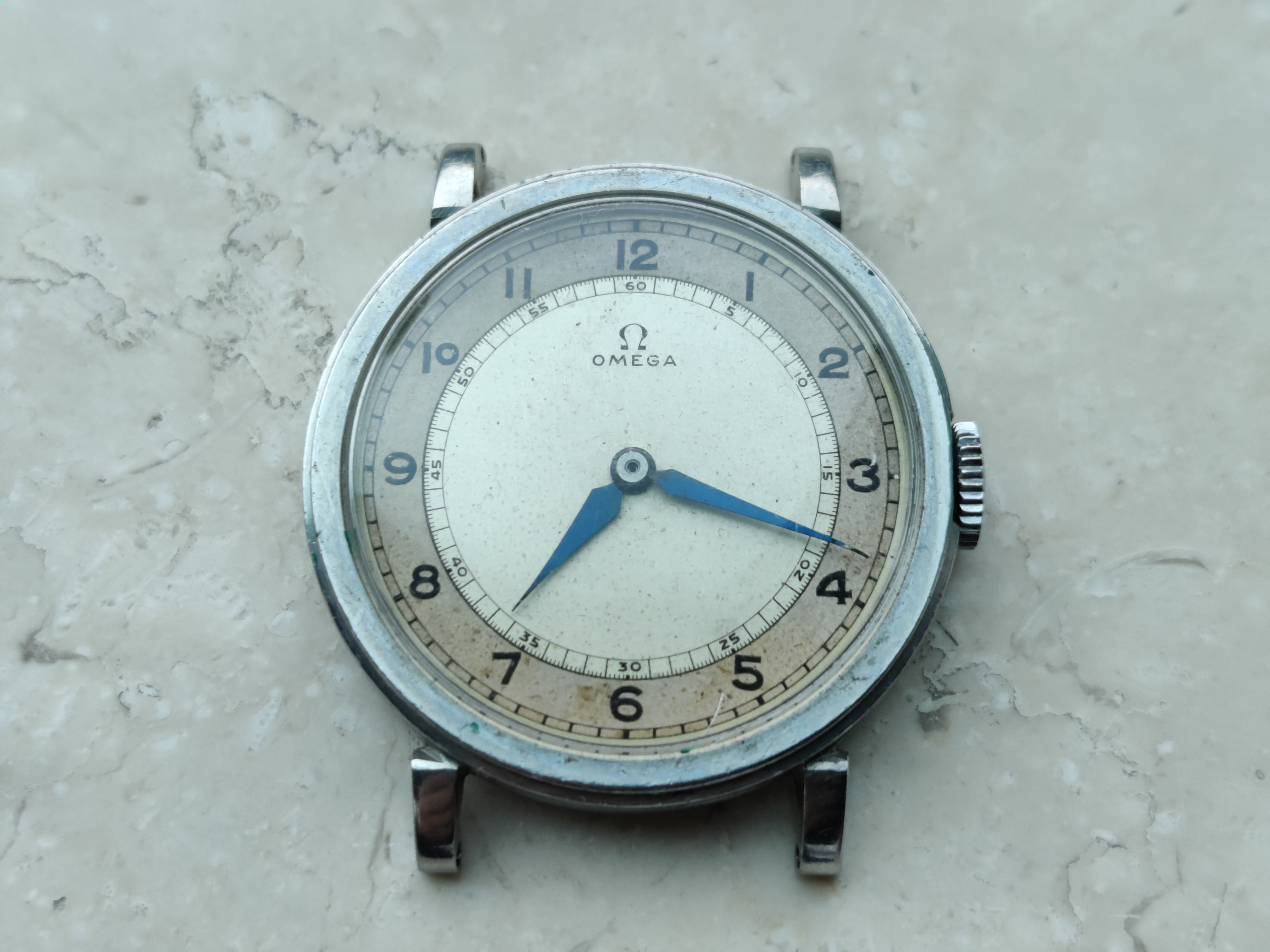

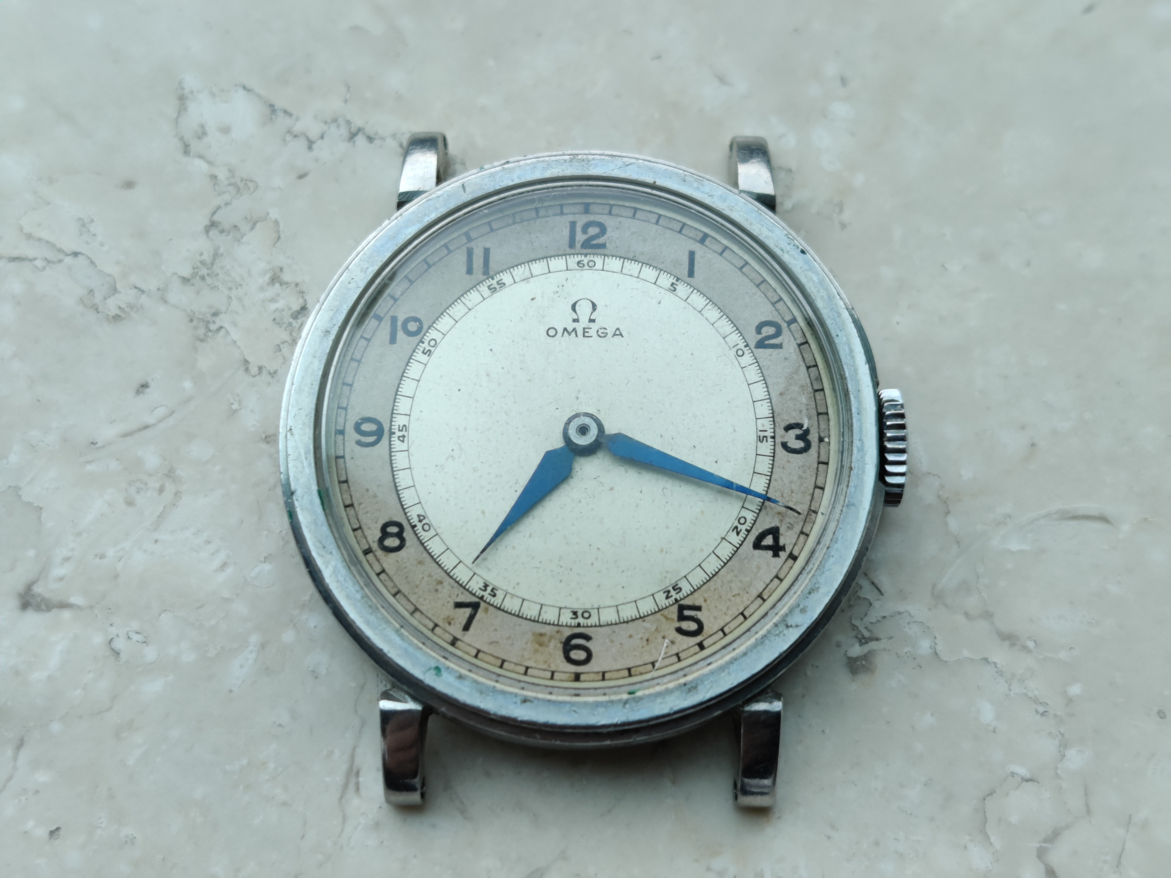

I'm looking for a 13mm (measured from the centre) sweep seconds hand (i.e. one with a 'bobble' weight on the end) for the following 35mm Medicus, Cal. 23.4SC (please see image below). The only viable option would be to find a donor watch but that is proving to be extremely difficult. Any help/advice would be much appreciated. Many thanks.

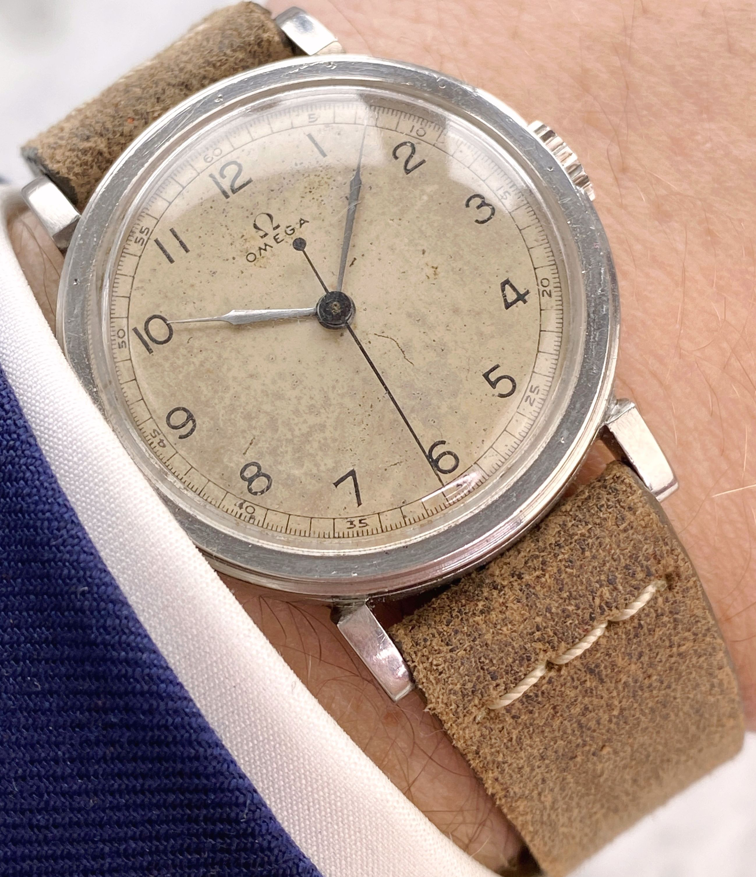

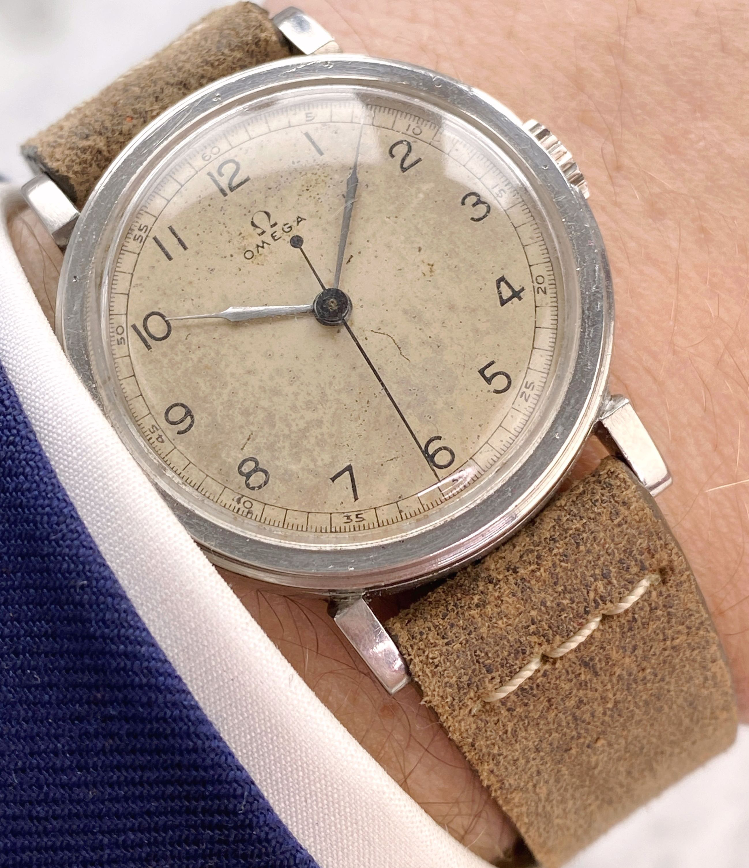

Sure, please find an image below showing the correct sweep seconds hand.

Ref CK 2015, a nice and unusual one.
Here in a 1940 French catalog :
Existed with luminous hands and dial, mine says hello :
Cal. 23.4 SC had second hands with either round or oval shaped counterpoise. We tried, with a friend collector, to understand if they corresponded to some specific models or periods (especially for the St Christophe), but there was no logics in what we found so I suppose both were used on same models and years.
