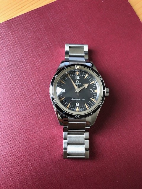

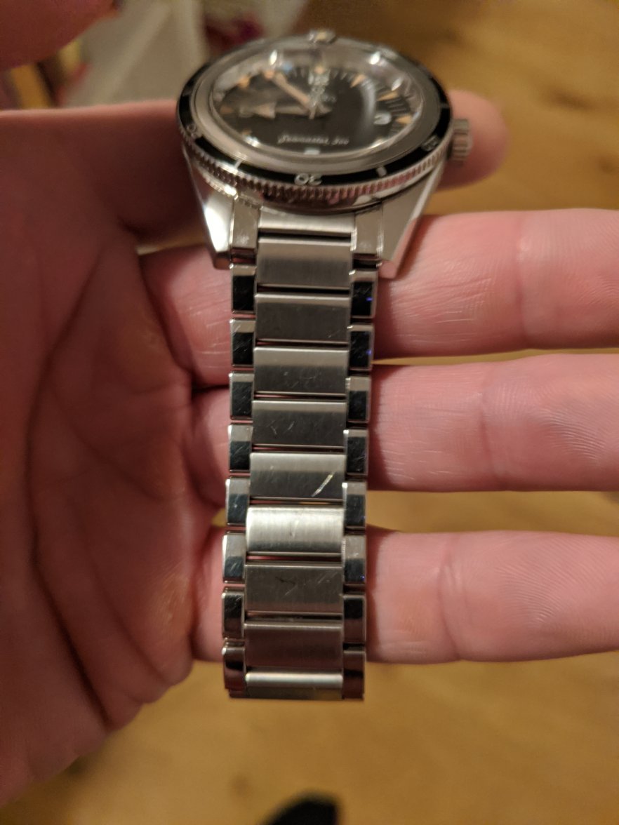

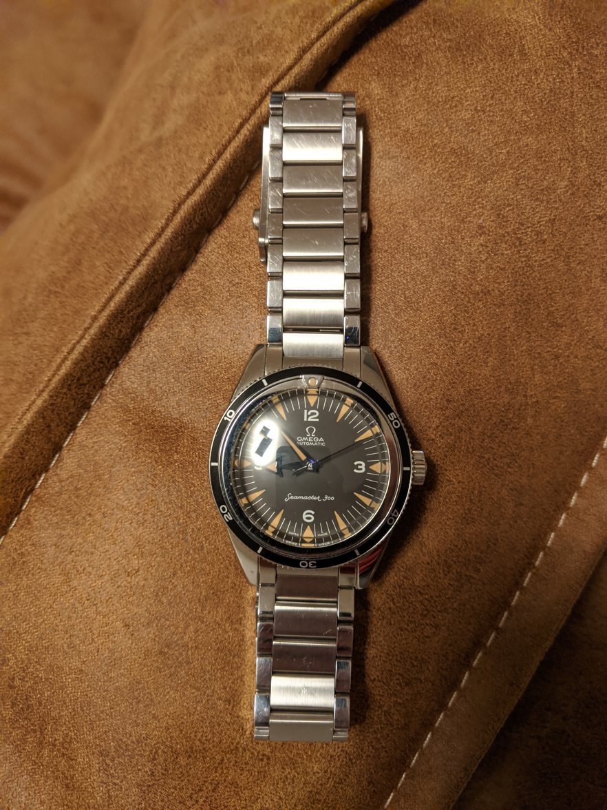

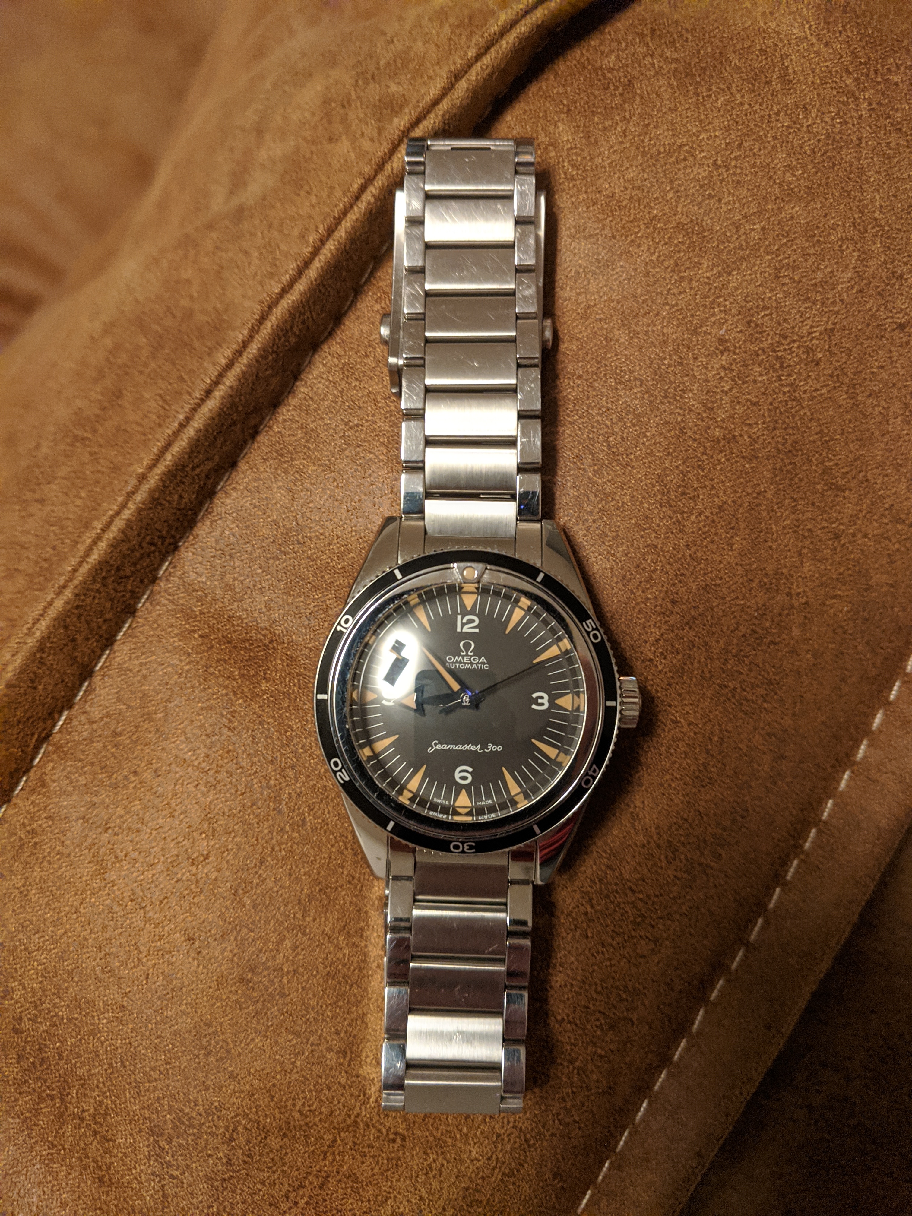

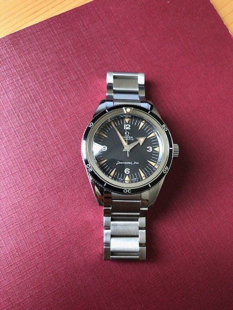

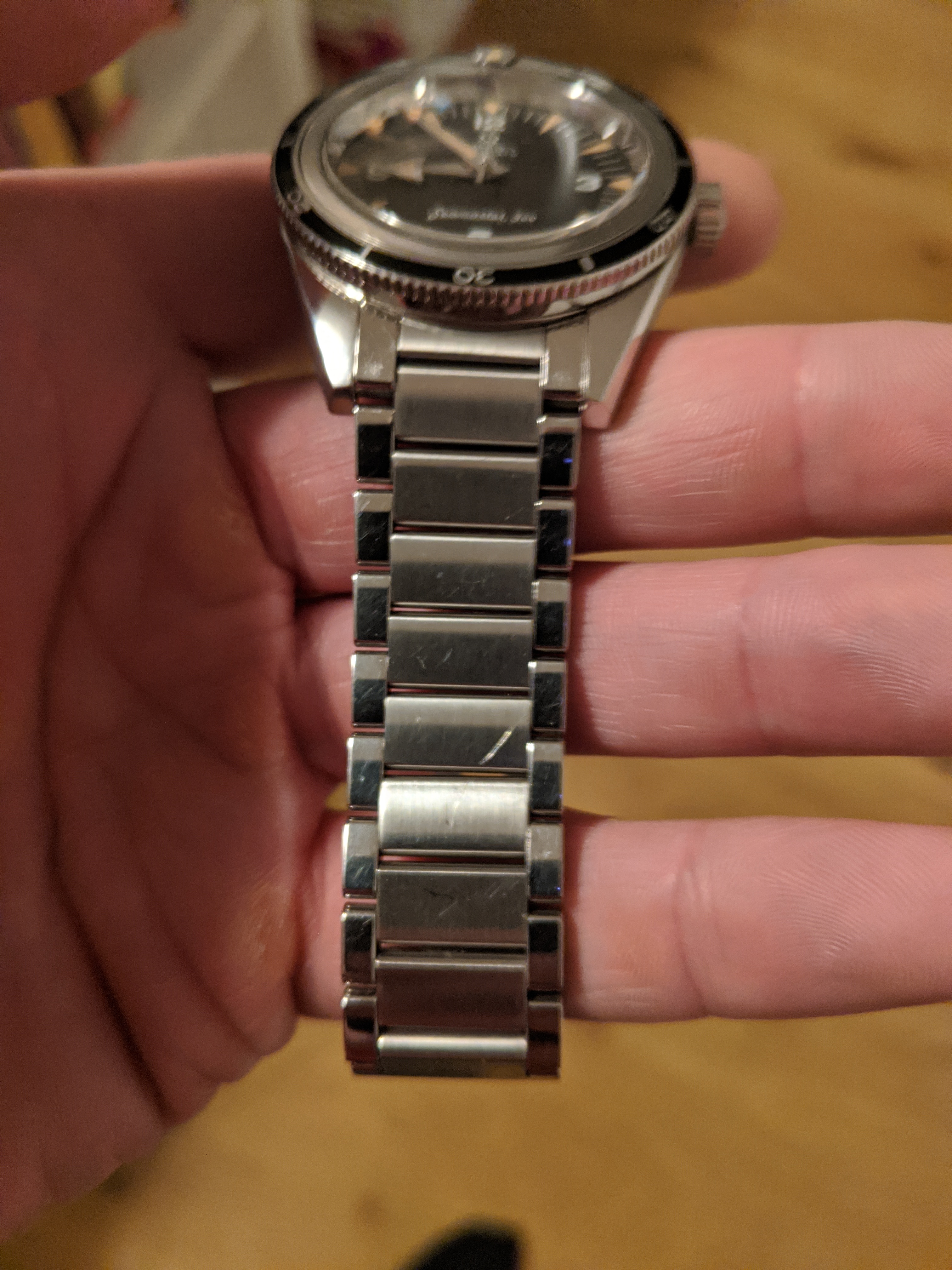

If that's what you want, it's your watch. It's easily done...I do this for people who ask...
Before:
After:
Before and after:
It can be reversed, so if you change your mind down the road it can be polished in the right spots again.

Thanks, it's looking great. 😀
Good to know that I can go back to the original look

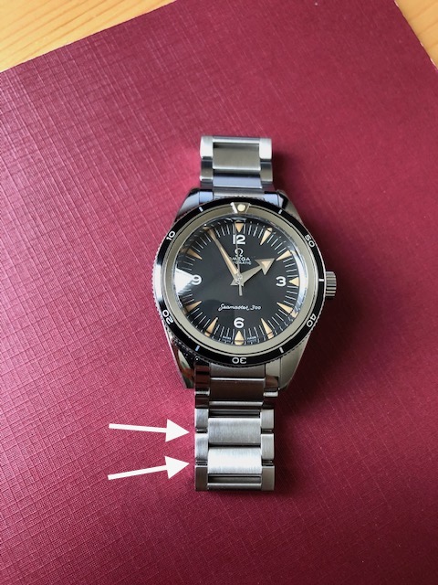

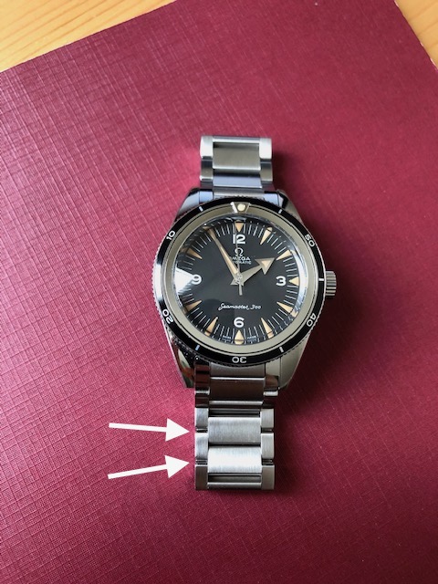

Yes, definitely tips the scale more toward the toolwatch character, after brushing the sides.
On mine, I found that even after brushing, it still retained some "bling" because:
1) The sides and the center link have an exact 50% overlap. This causes the larger center links to always have a different light reflection from the smaller side links, even when both surfaces are satin brushed.
2) The watchmaker who worked on mine only brushed the outer surface, so the "pits" 😁 in between the outer links retained their high polish. When the bracelet drapes in a curvature around your wrist, there's no way to hide some of those pits from showing. So you still get small sparkles of polished accents that will shine as you rotate your wrist
Sorry I'm sure there's a better way to describe that specific surface/side of the bracelet I'm talking about in #2, but hope I was successful in communicating that point. Using white arrows in picture below to point that out.
I ultimately sold the watch because I still found the high polish of the metal bezel ring too flashy. I've always wondered how the watch would look if that part was brushed. Maybe one day, a forum member will elect to take the aluminum ring off and brush that metal ring, and we'll be treated to pictures of what the watch looks like after that procedure.

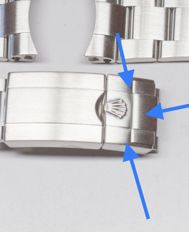

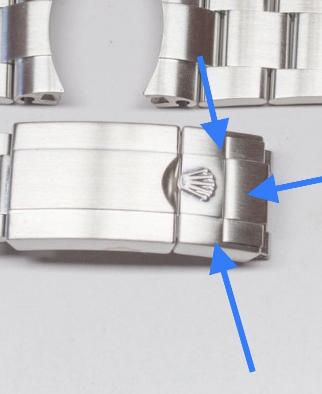

No, I don’t suggest that you do it. It’s very difficult to bring back to a completely original state and any other advice is not good advice in my opinion. If you look at the below picture you can see the modified clasp and the problem areas with it.
These areas have been rounded off during the polishing process and it will be very difficult bring them back to factory standard.

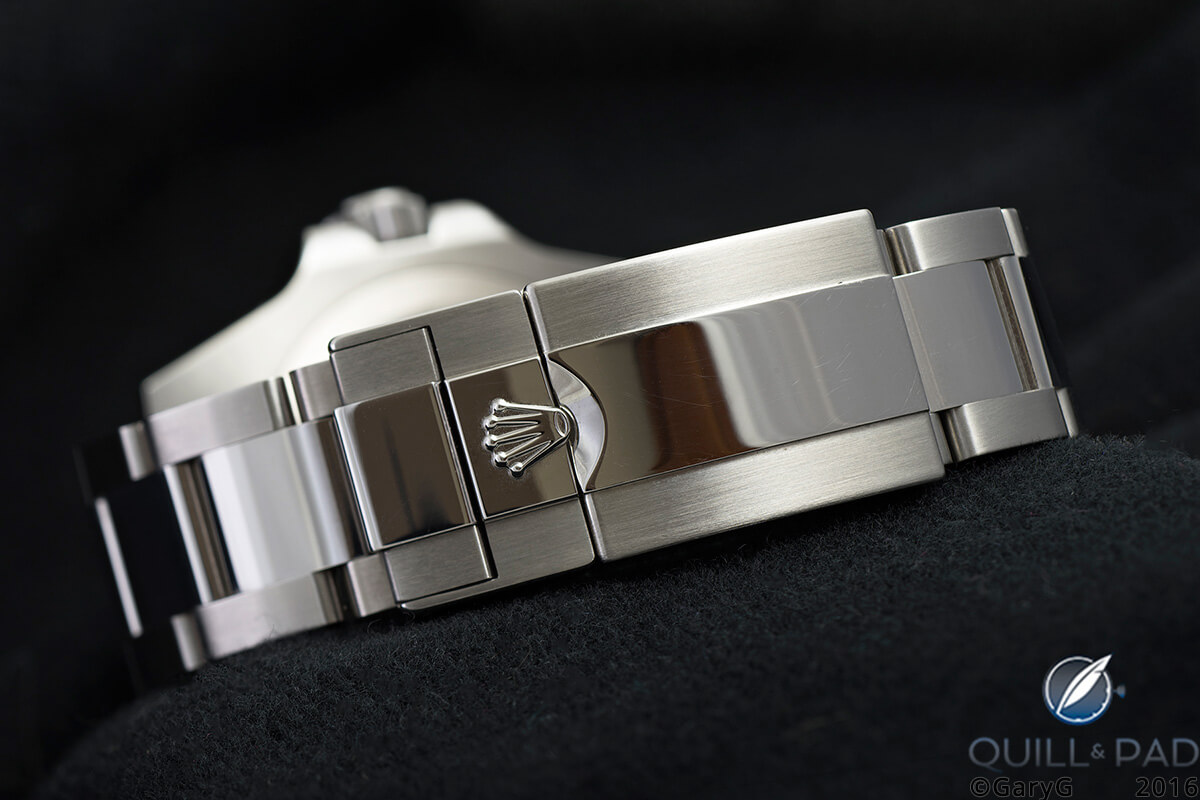

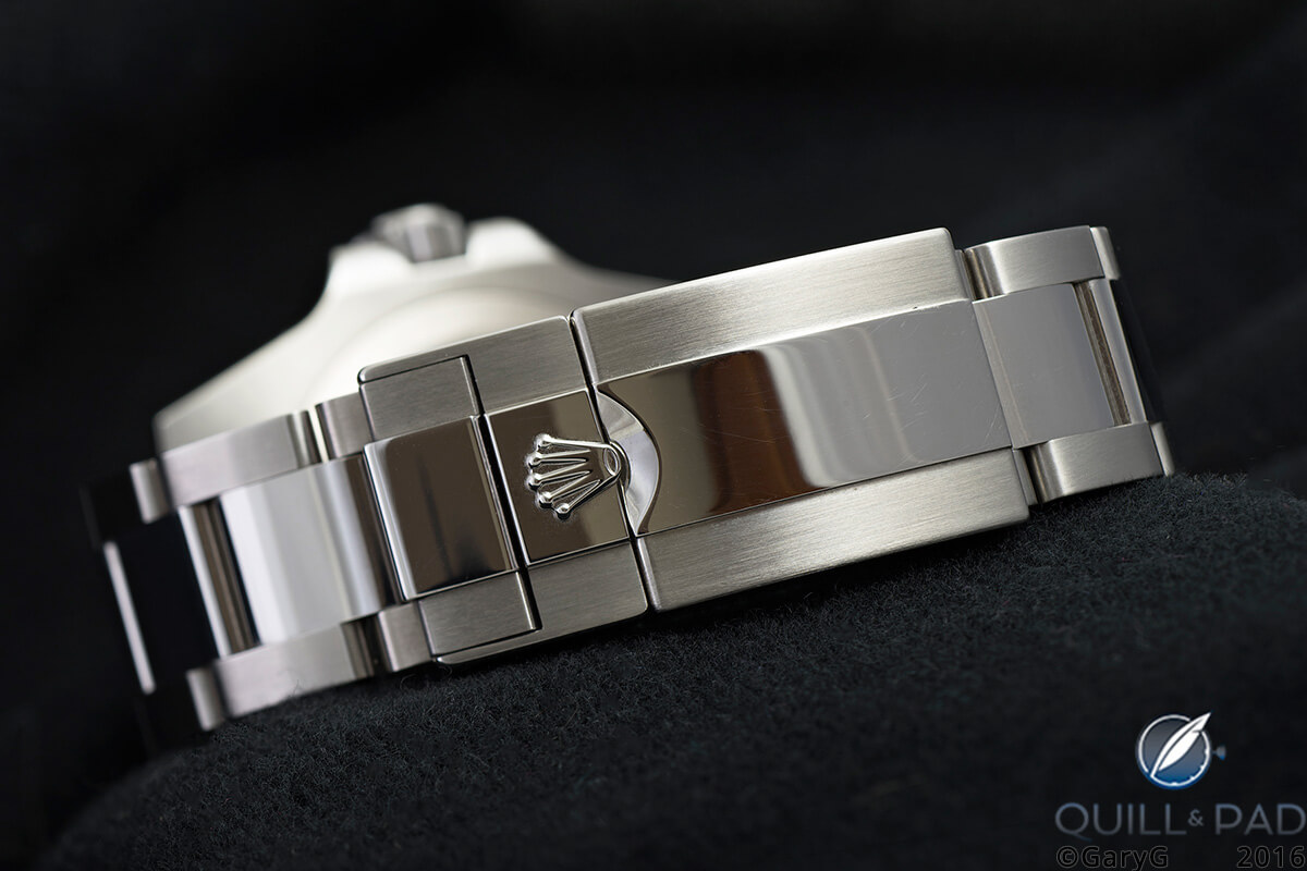

We can compare it with the below photograph of a factory clasp. You will note that there is no rounding.
Once the clasp, especially around the Rolex crown, has been rounded off like this, it’s going to be very difficult, nearly impossible to reverse this and bring it back to factory specs.
i understand that the bracelet in question is an Omega bracelet , but the same principles and concerns still apply. So be very careful with which decision you make.

the rounding is unlikely to happen when an amateur uses something like a Scotch-brite pad... only those who put it on the polishing wheel too long
