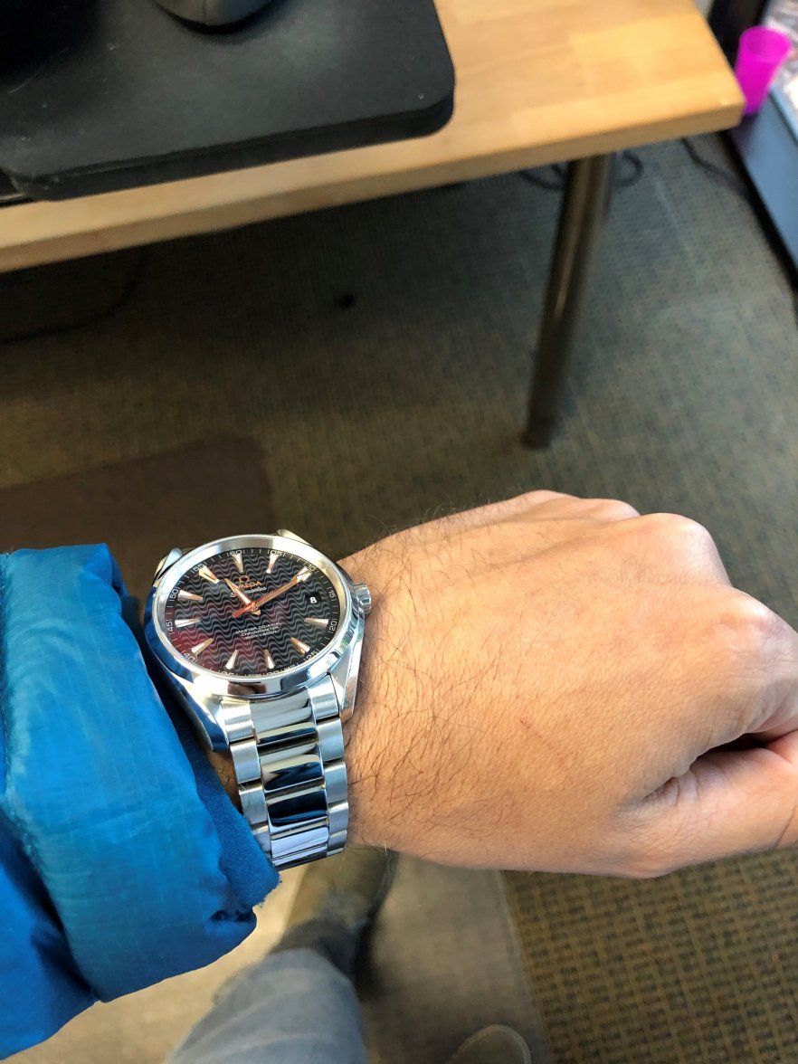

I have the 8500 AT and was having a similar issue where it was resting in the box, dial up and wasn't being worn very-often. I gave it a full wind and wore it all day for 5 days in a row (in the evening, it rested in the travel box, but crown side down) and it went from being +2-3 a day to +/-0 for a straight week thereafter.
I've read a good bit of these threads and a common consensus is that if you wear it most of the time and are able to identify it's ideal resting position, it will calm down and keep better time.
So that being said, try giving it a full wind, then wearing it A TON and keeping it at the SAME resting position for quite a few nights in a row. I've had the most success in the crown down position.
