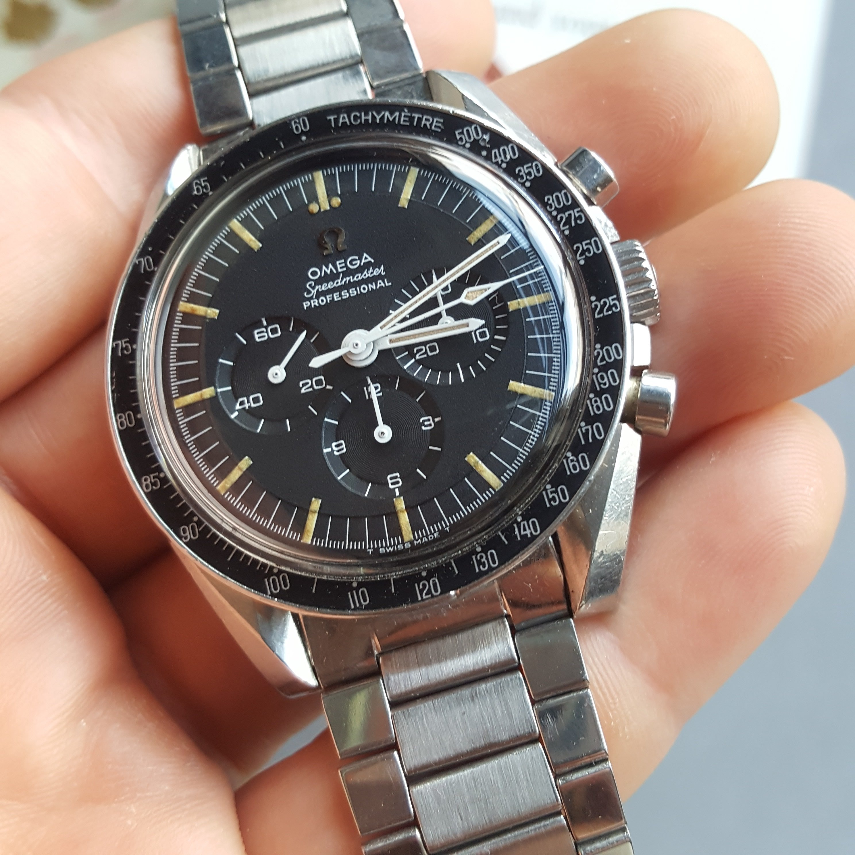

Thanks a lot for your quick answers.
To precise:
I'm speaking of index and hands of a 105012.

Oh great to learn that it is done by the backside for the hands. Of course that is another story for the dial...
My lume is ok now, so as said by @Davidt , it is a preventiv measure.
I'm wondering if the index will be "modified". Until now, they are perfect. So it is scary... If there is a tiny modification, I will see that... I will focus on that... I can't bear that...
An OF member has an example of index stab "before&after"?
