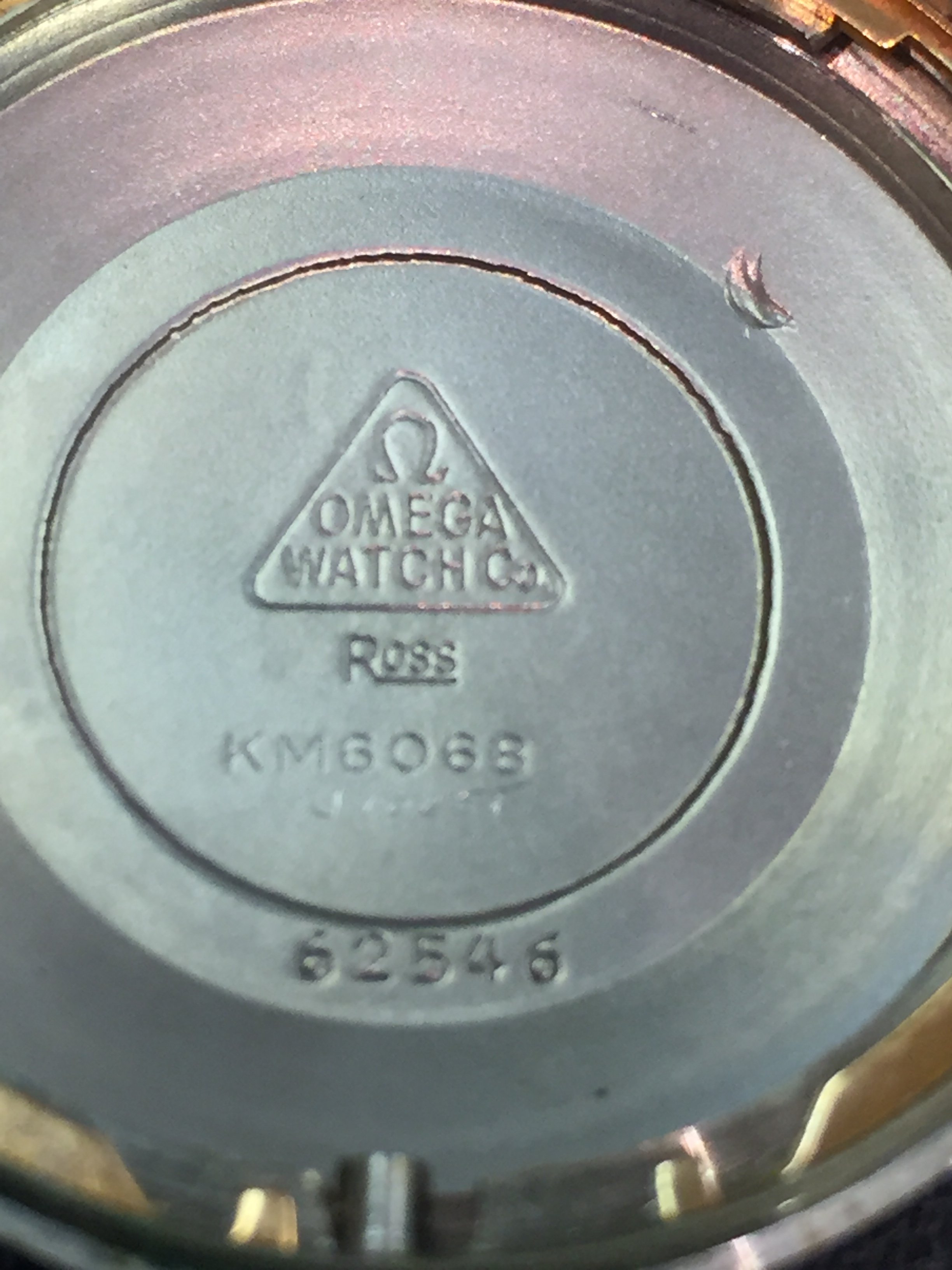

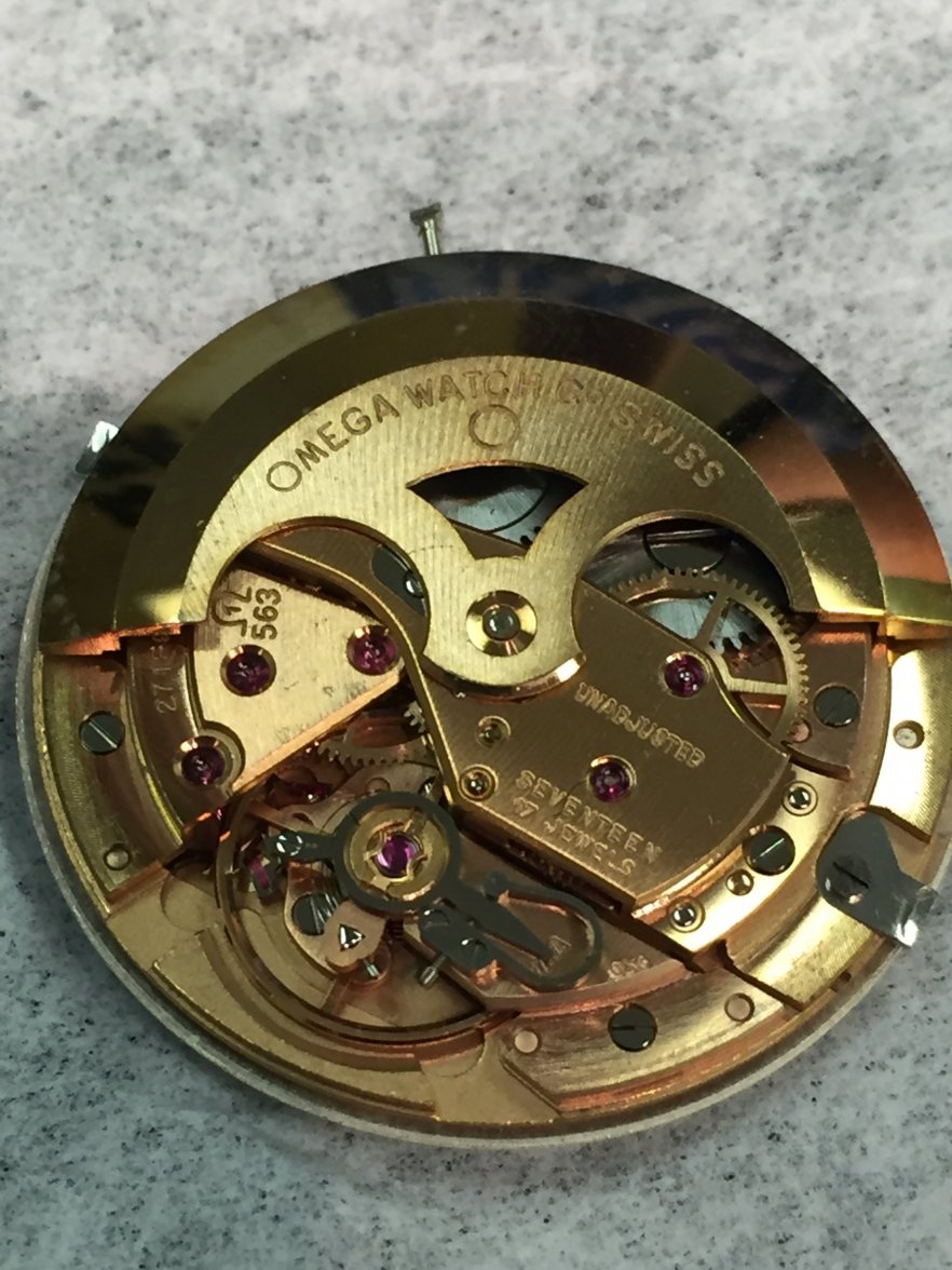

I I finally got the watch open. Not sure if the numbers on the case help putting a date to the watch

27,1XXM dates the movement in the '68/'69 date range
you can try typing the case number into the Omega Vintage Data Base to get more information

That is a Ross case made in the US. The dial looks so good you must just fix the case on this watch . If replace the case "That rimmed"? You must find a Ross case .
