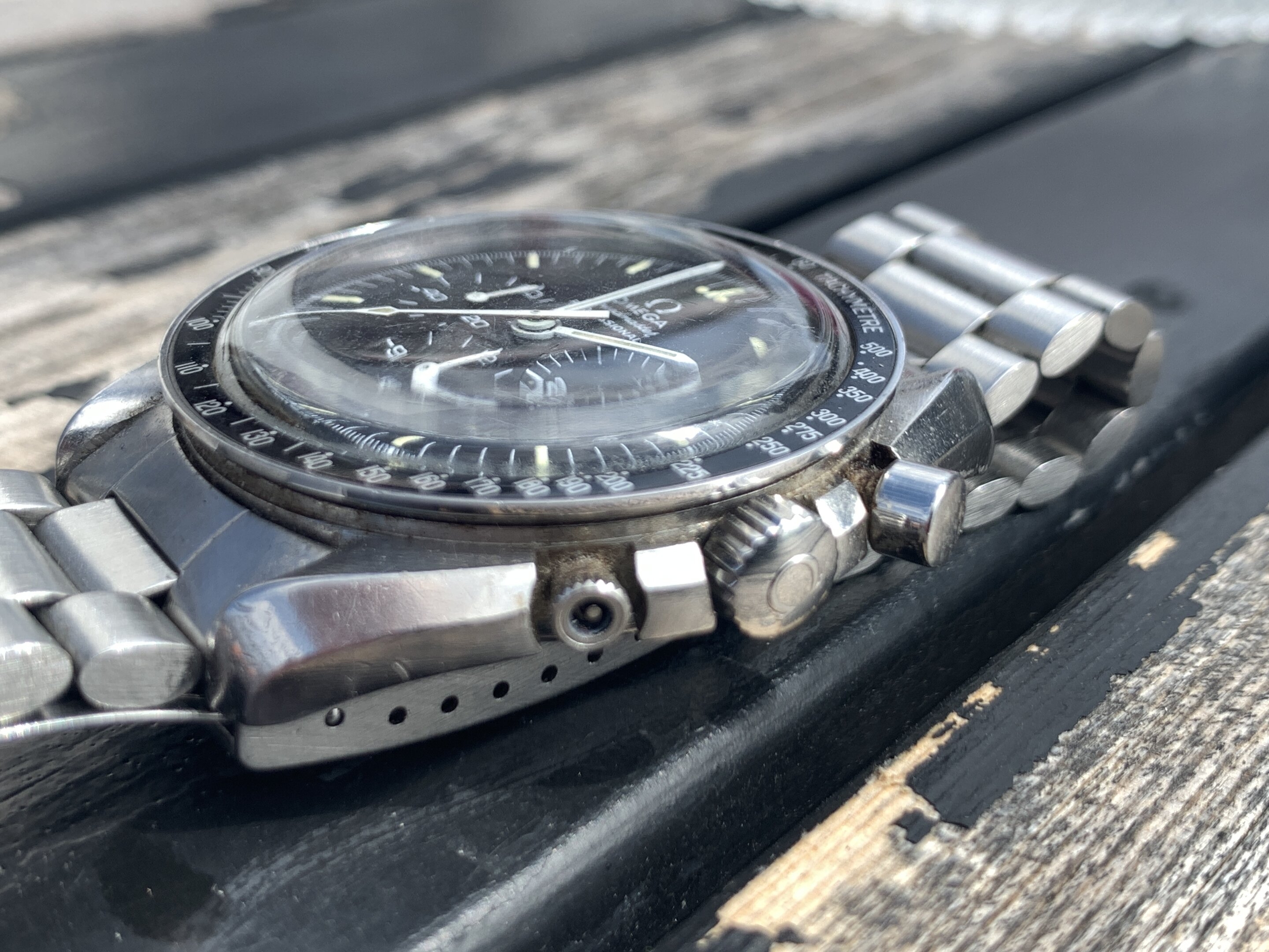

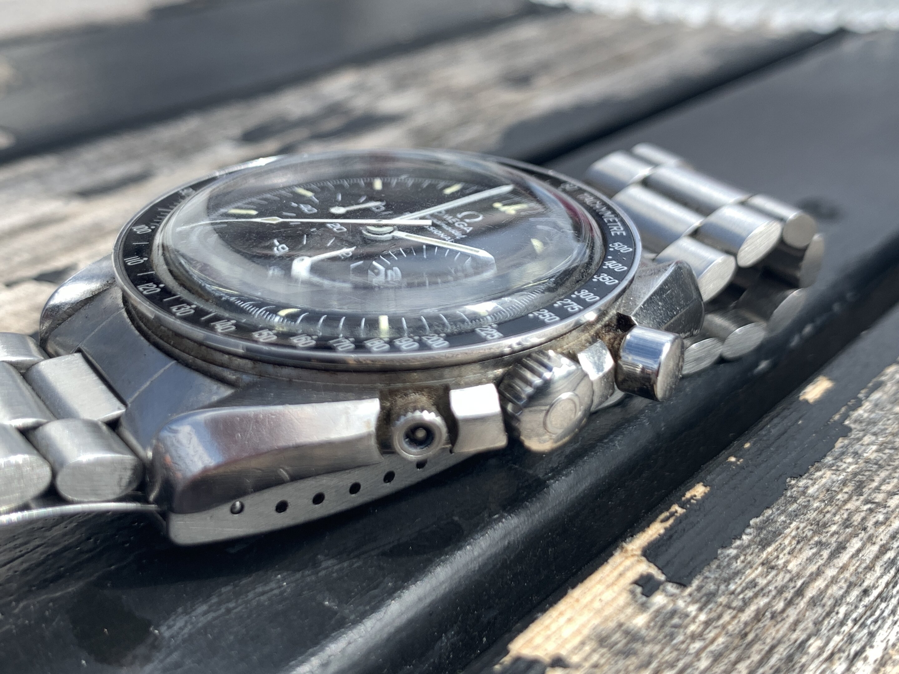

Swedish midsummer took the best out of my speedy ::facepalm1::
Please advice me on how to restore it. Possible to source a new pusher button? What should I look for so it matches my other pusher from 1971?

The pusher part number is 086ST0059. The cap is not sold separately, but you may be able to find one somewhere.
To repair this, the movement needs to be removed from the case, so unless you have worked on watches before, best to take this to a watchmaker you trust, preferably one with an Omega parts account who can get the part for you.

Thank you very much for all the info! I had it serviced in 2018. Maybe good to have it serviced again if big operation to have movement removed? Gah this hobby really chews on my budget. Guess no bycycle for the kid this year either 😜
