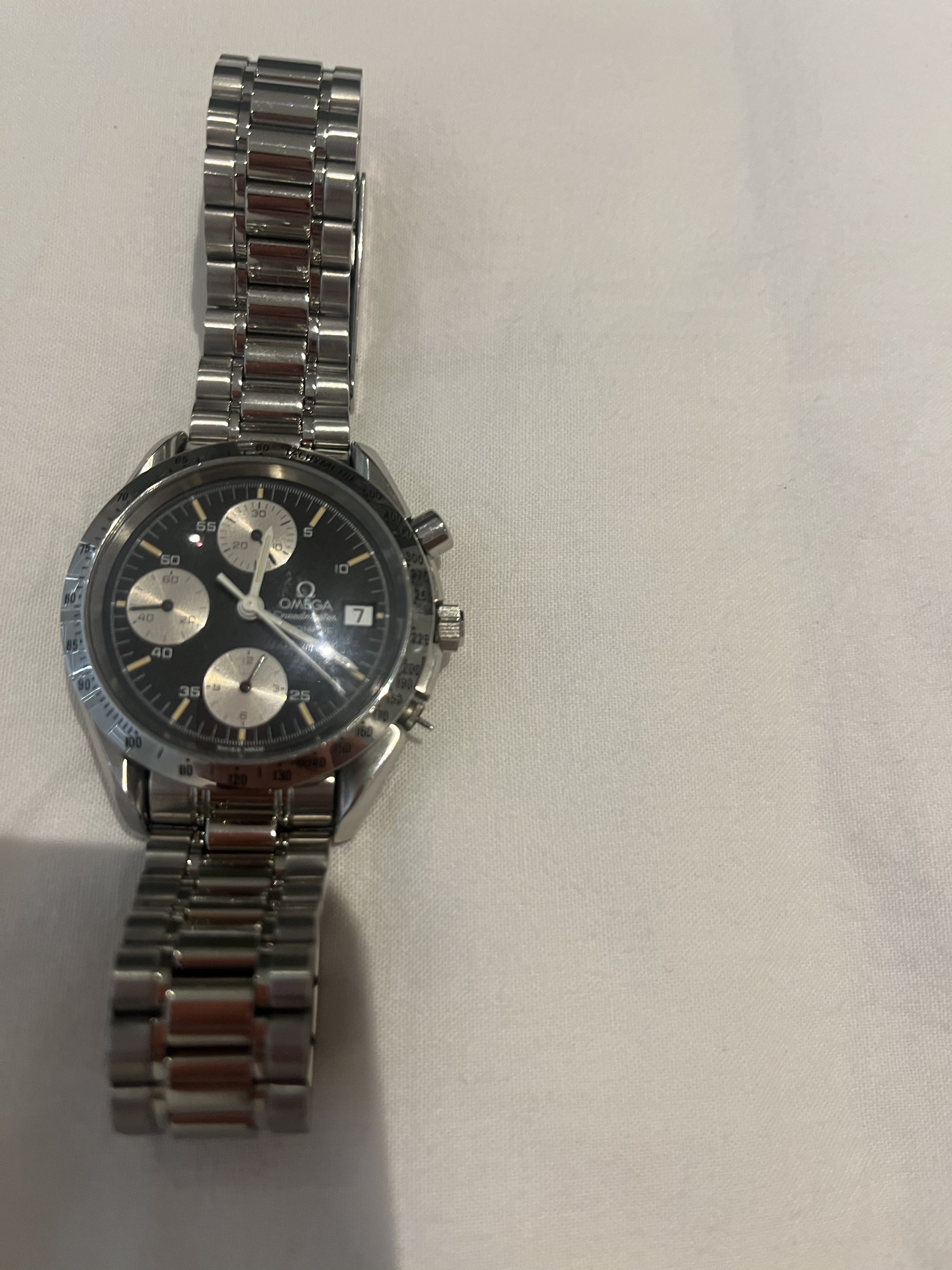

I’ve not had this 3511.50 long and the bottom pusher is gone! When I bought the watch, the pusher did seem to protrude further than the top pusher but I didn’t think too much of it. My mistake! I was out for drinks the other day, looked down and it was gone. Please can someone add some advice as how best to get this fixed (omega vs independent) and if it’s possible to source the part these days (1993 watch)

When I had my Speedmaster. Pushers were screwed on and tightened from the inside
Need to find a watchmaker with a Omega parts account to order a replacement. Probably best to replace the screw section in case of wear (if a screw type)
If you post your location. Someone might be able to suggest someone or call the local distributor. However. They might ask you to send it in rather than suggesting a watch maker
30,270
78,125
This is the pusher you need...
086ST0079 | STEEL PUSH PIECE
This is a pressed in pusher, so the entire unit is pressed out and a new unit pressed in.
Thanks! If I were source the specific part, would a standard watch repair store be able to complete the works or is this a specialist omega type of job?
30,270
78,125
It's not an Omega specific task...
