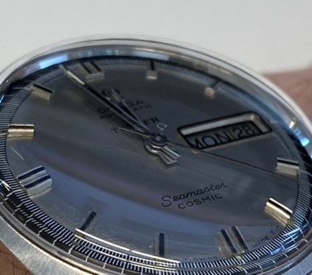

I've received today a wonderful 166.036 Seamaster Cosmic. It seems to be in a very good condition. I've set the time and date respecting the instructions (always go forward, select the day and then the date) and so on.
I've noticed that the crown is a little bit loose, and I wanted to know if this is normal or not, I've to confirm that everything is ok.
In the meanwhile, here is the first picture I took of the watch:
Thanks to all!

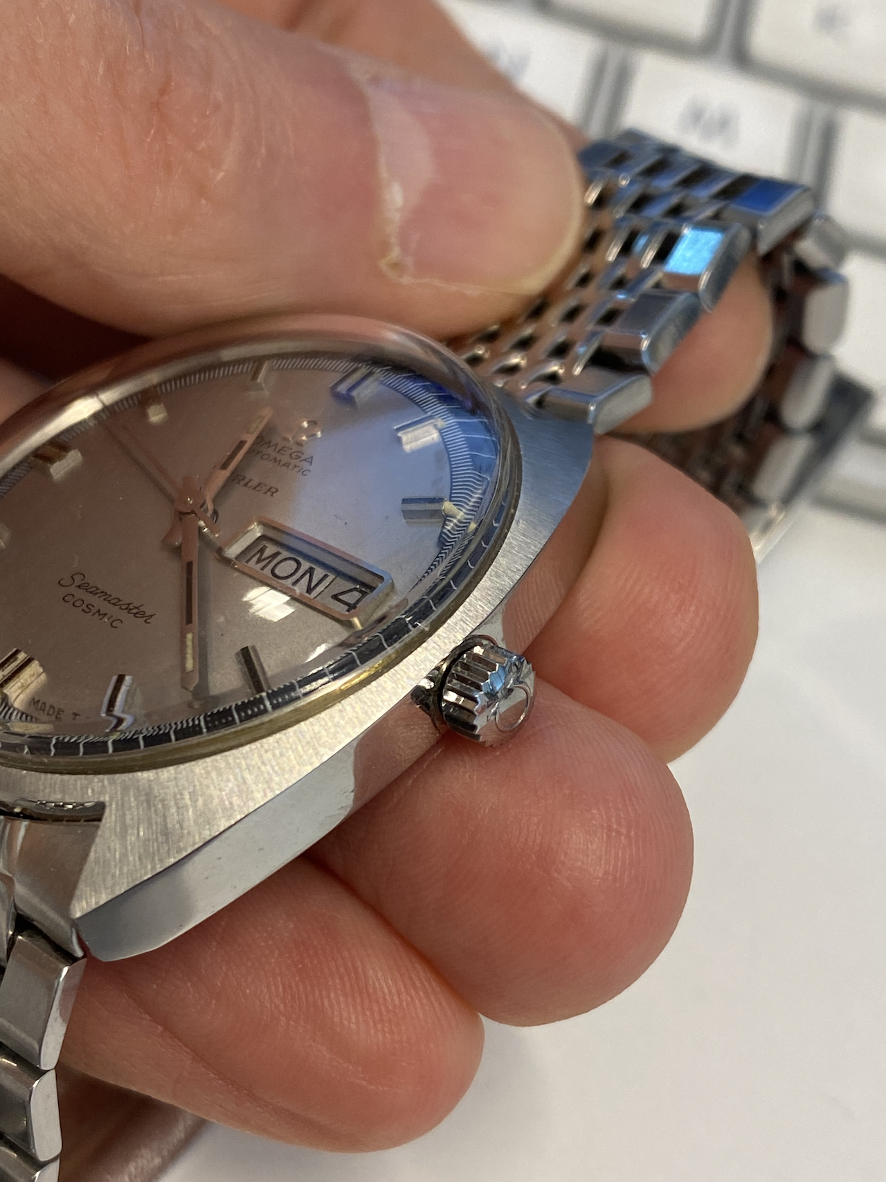

Hi,
it moves slightly when you touch it, it’s not firm when it’s in not extracted position…

Info added: From the images I see around on the web, it seems that the problem that @DON is supposing could be true. All the crowns I see on this particular model seem to be larger than mine. Thanks.

The correct crown for this is 069ST42527. It is approx. 4.4 mm in diameter, and about 2.7 mm long. Yours looks to be the right crown from the photo, but measurements would be needed to confirm. They are fairly small looking in comparison to the case size.
The crown seal could be hardened or gone, and that would certainly make the crown feel very loose.
This is a front loading case, and the stem is a split stem that comes in 2 parts so it can be pulled apart. These tend to feel less solid on the case tube than a normal stem does, so there's a chance that nothing at all is wrong with the crown, but that depends on how much movement there actually is, and we can't judge that from photos.

Thanks @Archer for your contribution. The caliper I have here in the office says 3.90 mm in diameter, this for sure. The other measure is harder to me to do now, without pulling the crown all out (I'm @work now and I can't do it), but it seems to be around 3 mm, it could be those 2.7 you're talking about. So 3.90 seems to confirm my sensation.

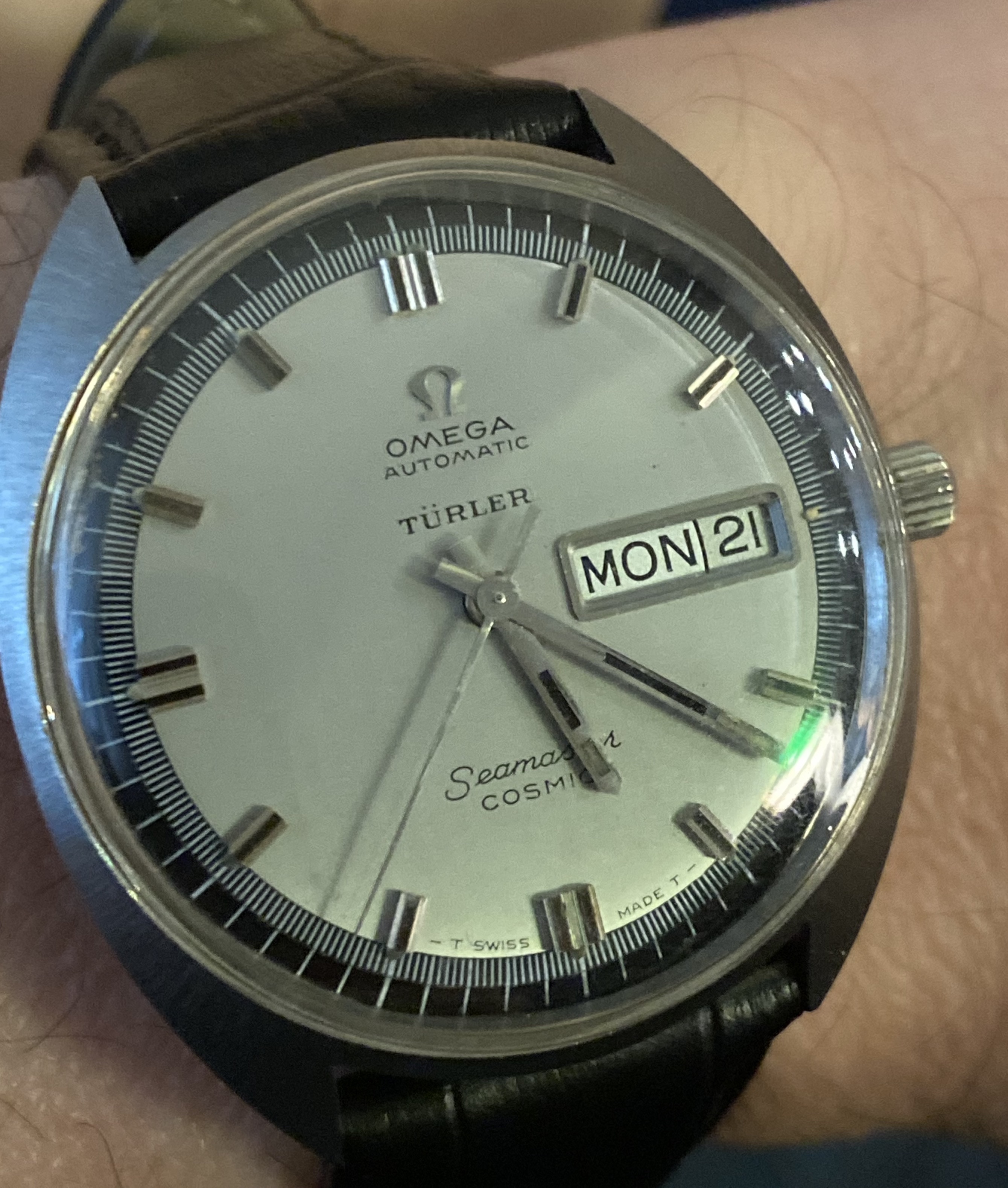

Hi all, the watchmaker confirmed that the crown seems to be too small, and that it shouldn’t move this way. So I asked him to find the part that @Archer reported. So thank you all, but @Archer in particular. I’ll be glad to show you the result.
244
408
Here we have the result. In the meanwhile I was able to find a correct bracelet 1068 and the correct endlinks 523. My wallet is lighter, but now all the pieces have found their place and the watch is complete. Thanks again to @Archer.

Hi all, I have a small update, 2 years later.
When I wrote "all the pieces have found their place and the watch is complete", well, that was not right.
As soon as I discovered that the glass was not original, I asked my Omega certified lab to find one, and here is the result.
Now the watch is really complete.
