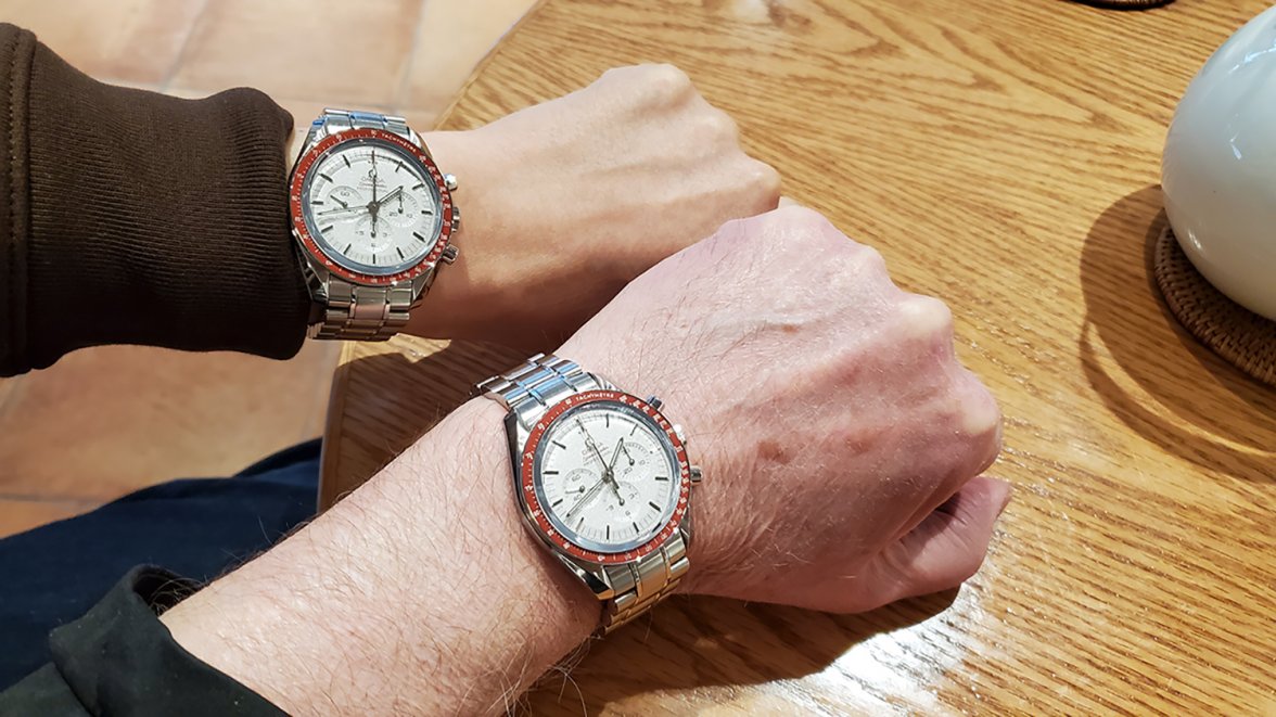

A friend of mine saw mine and also bought one and just received his, so i'll have a chance to feel his winding crown when i meet up with him.

Today, I was able to meet up with my friend who just bought the same watch. Well, our watches both offered very little resistance and felt the same when we wound them as a test.
