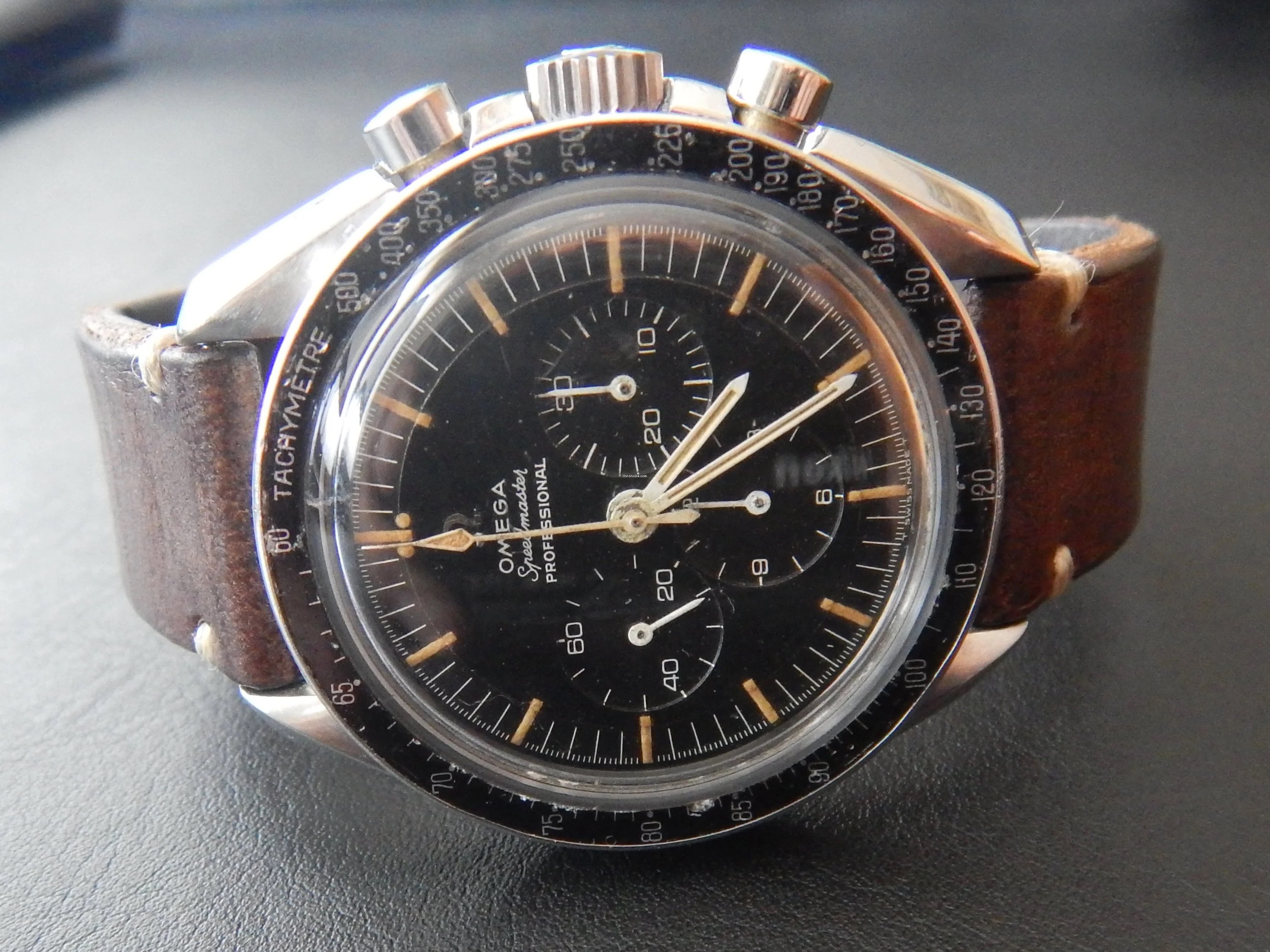

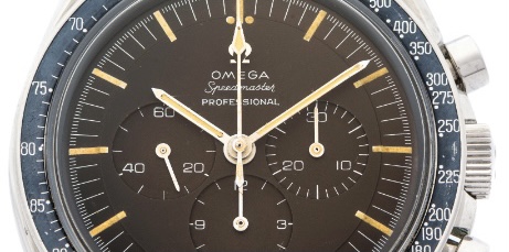

Looking to purchase this 105.012-65

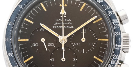

Anybody curious about that minute hand that seems too short to reach the minute track? 🙄
I would expect something like this :
328
127
^ Yep I noticed that too.. (I'm learning)... it's one of the things I actually did notice... but what does it mean? They are swapped in hands? from a Mk2.. ?
328
127
Eugene's watch (see his photo) minute hand is short though... so I really don't know what to believe...

It most certainly is not.
.Ok... sure. maybe the angles of your photo.....yep.. the picture of the 105.012 '64 and '65 in moonwatch only ibook looks short as well...so what do you think of the watch I am looking at Eugene? IS that minute hand short? Look nobody said this stuff is easy....

BTW Can that big ding/hole on the inside rim of the bezel above 85 be repaired?... or is that it with the bezel?
Like I said, I don't really care to think too hard about anything more with this one ... the dial/lume (case) puts me right off. I think what Kov meant was the tip ... it is supposed to come to/slightly passed the minute track. It doesn't on this one.
so, about my questions in my original post ... could you see anything about the lume I mentioned as a difference between the one I posted, and the C24 one?
Well the lume on your watch has dark black spots in it... at random areas on the lume ....that what you are referring too?...so it is more uneven in texture ...because some bits of tritium go black in time? That it?

This is a pass from me unless you're looking to get into a vintage speedmaster at the bottom end of the market.
Imo this is square in the middle of the 'fair' category on sp101. No aspect is 'good.
The case is over polished, the dial looks tired and the bezel is average.

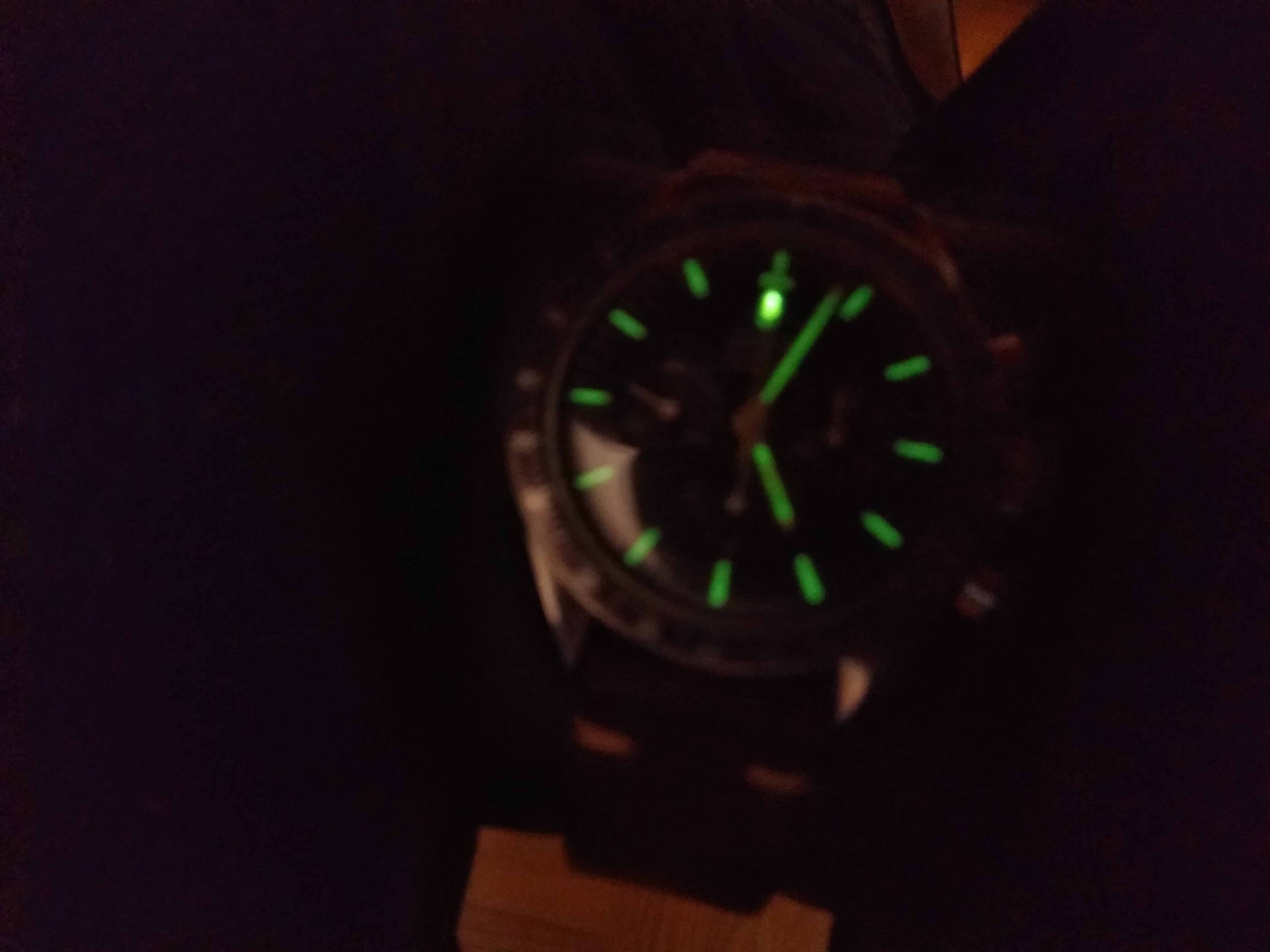

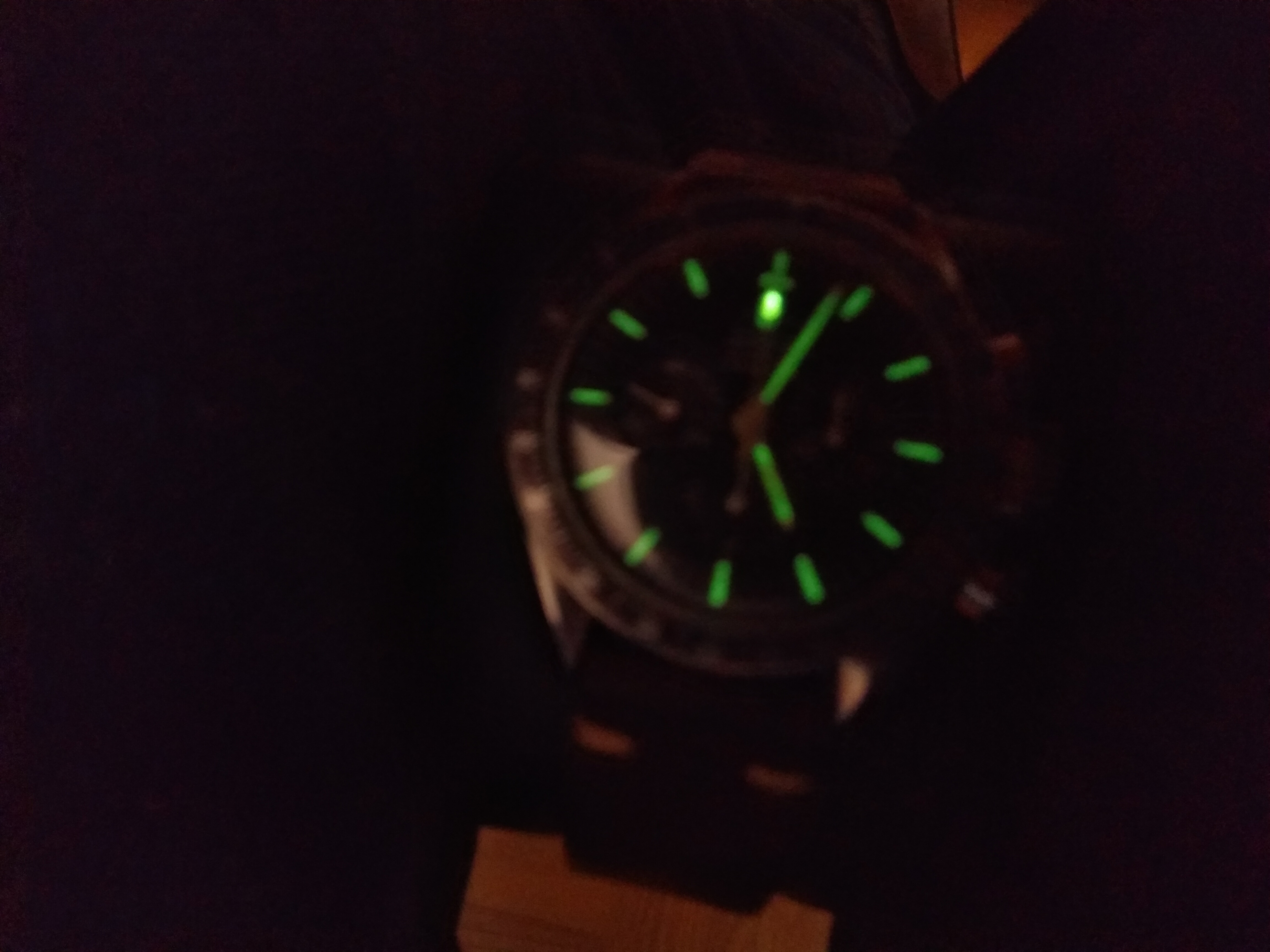

Ok Lume shot as requested after 20sec of torch exposure. Is this genuine tritium lume on dial and hands? Yes or no . Or is this a relume? Yes or no?

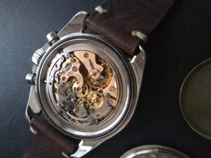

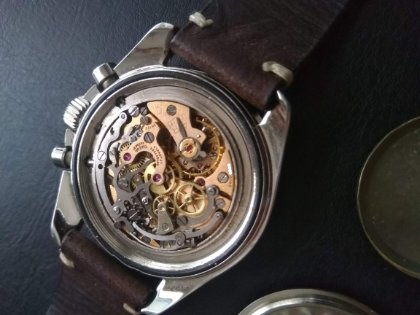

Movement pics. Authentic 321? Yes/No? Tampered? Y/N? Swapped parts? Y/N?

so back to original questions
Is this an authentic '65
1/ Is the Dial original ?Y/N..
2/ Original tritium lume? Y/N
3/ Hands Original? Y/N
4/ Are the hands Tritium Y/N ? (The seller doesn't have a blue UV..so can't tell me)
5/ Clearly hands have been painted but could these hands be restored ie repainted without the lume falling out?
6 / Crown and pushers look original to me.. am I correct?
7/ Bezel looks to me to be original? Y/N
8/ Case looks ok. Original Y/N
9/ Is this an untouched, non rusty 321 movement? Y/N
Appreciate the help!

The problem is you’re looking for a binary answer to subjective questions (or questions it’s hard to be certain on).
You also need to clarify whether you’re asking ‘original’ or ‘correct’?
1/ Is the Dial original ? Probably
2/ Original tritium lume? Hard to say from those pics. Modern relumes can act the way tritium does.
3/ Hands Original? As pointed out above, I think they’re service as the service hands are slightly shorter than the originals.
4/ Are the hands Tritium Y/N ? Same as answer for dial.
5/ Clearly hands have been painted but could these hands be restored ie repainted without the lume falling out? No.
6 / Crown and pushers look original to me.. am I correct? Yes
7/ Bezel looks to me to be original? It’s correct, who knows if original.
8/ Case looks ok. Original. It’s seen a good polish or two.
9/ Is this an untouched, non rusty 321 movement? Utterly impossible to say from one blurred picture. But seems ok from what I can see on my phone.

You say
But nobody has actually answered my original questions....
(I'd appreciate if someone did)
People are answering your questions...
Nobody can say for sure whether a handset or dial began its life together, unless they owned the watch since new.
minute hand seems too short to reach the minute track
No one will be able to answer that question based on that terrible photo.
People can paint hands without lume falling out...often though they end up touching the lume with paint (its a very small are we are talking about).
ghosts around the plots scream ‘relume’ to me. Not to mention that particular color being even all round dial and hands.
6/ Case looks ok for the asking price?
7/ All Comments welcome before I pull the trigger!
You have been given a lot of feedback in this thread and your varying other threads, as well as tools/resources to help you make educated decisions. I get that you still need more help on top of that, but your over eager I need to have one now approach while claiming no-one is answering your questions, when they obviously are, is going to be off-putting to many people.

This is a wordy thread so I may have missed it but do you have the serial number and does it check out on ‘I love my speedmaster’?
Given potential issues here I’d need a better movement picture before continuing.
2,318
5,713
From this picture, the answer is definitely: Y/N.... ::facepalm1::
