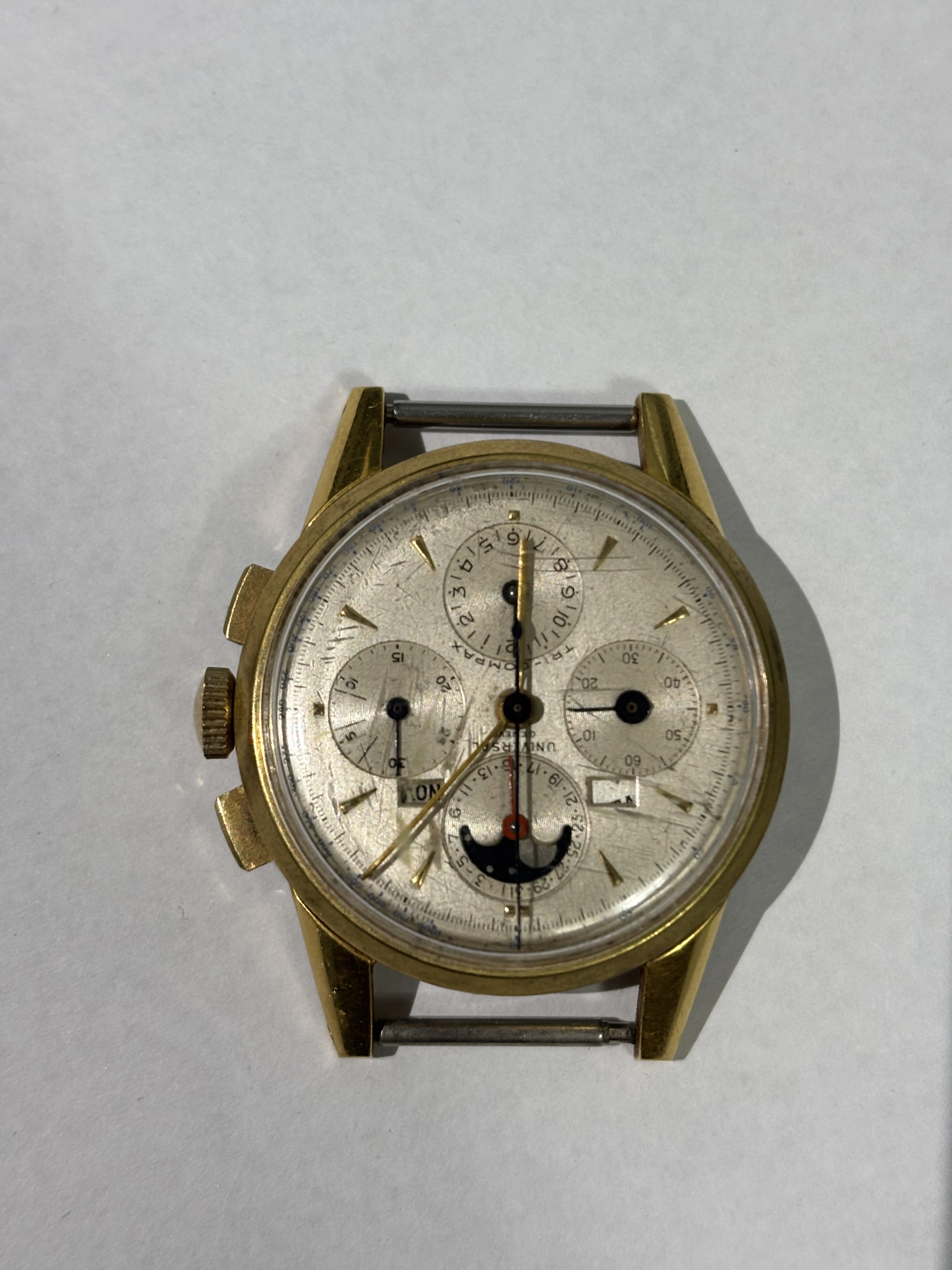

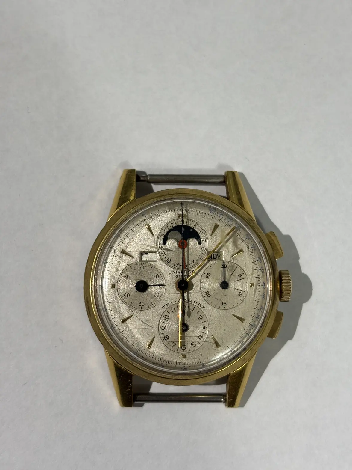

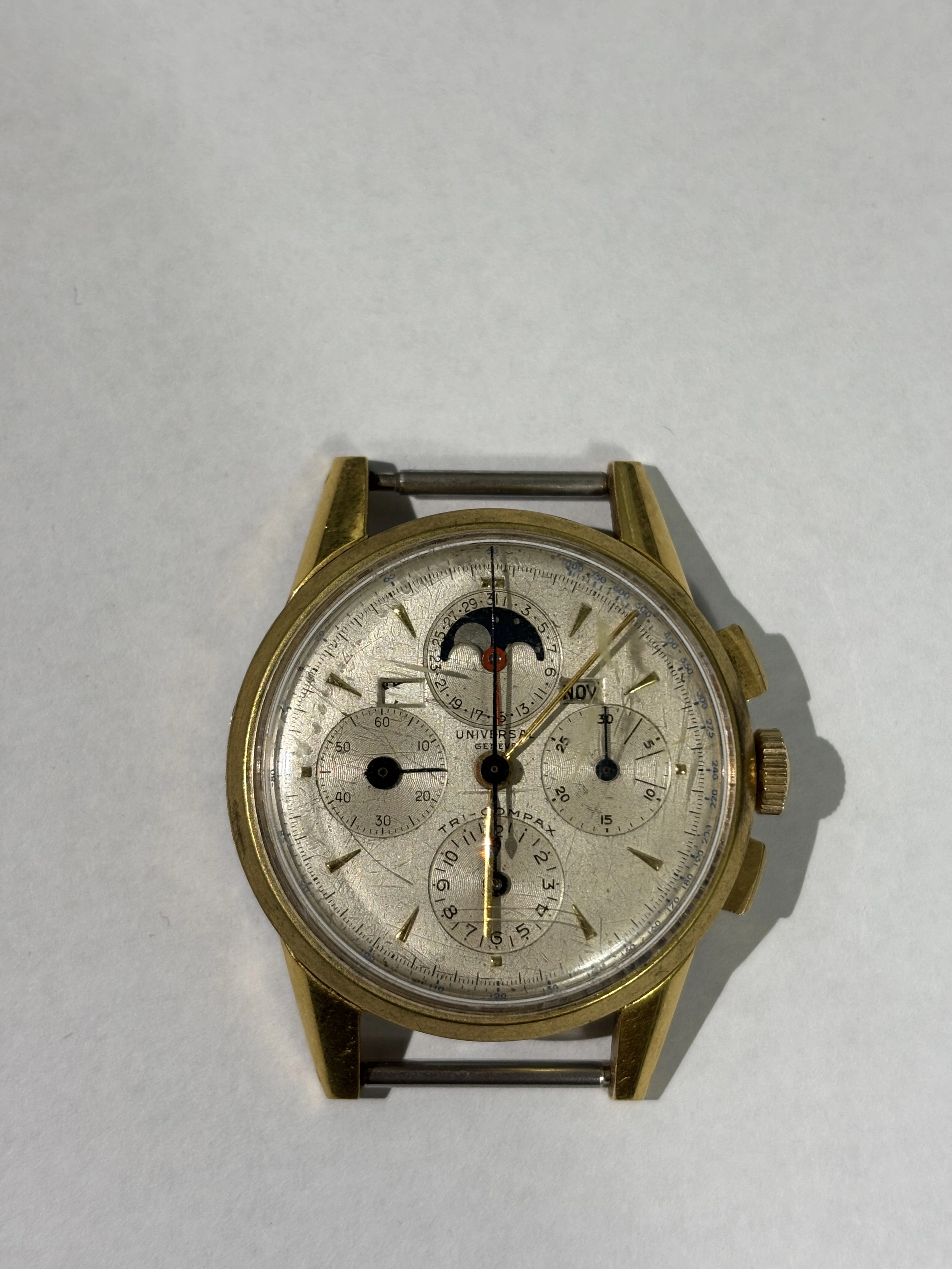

Hello,
I was looking through my late Grandfathers possession and found a Universal Geneve Tri-Compax.
Serial number starts with 11, and the reference number is 22258.
I’m looking for information on this watch, in my brief research I haven’t found one with an identical face or with a serial number close to this one.
Is anyone familiar with these watches and have insight they could share?

If you don't tell me the serial it is hard to show you a close serial.... But it will be 1156/7 😀 Dial is legit

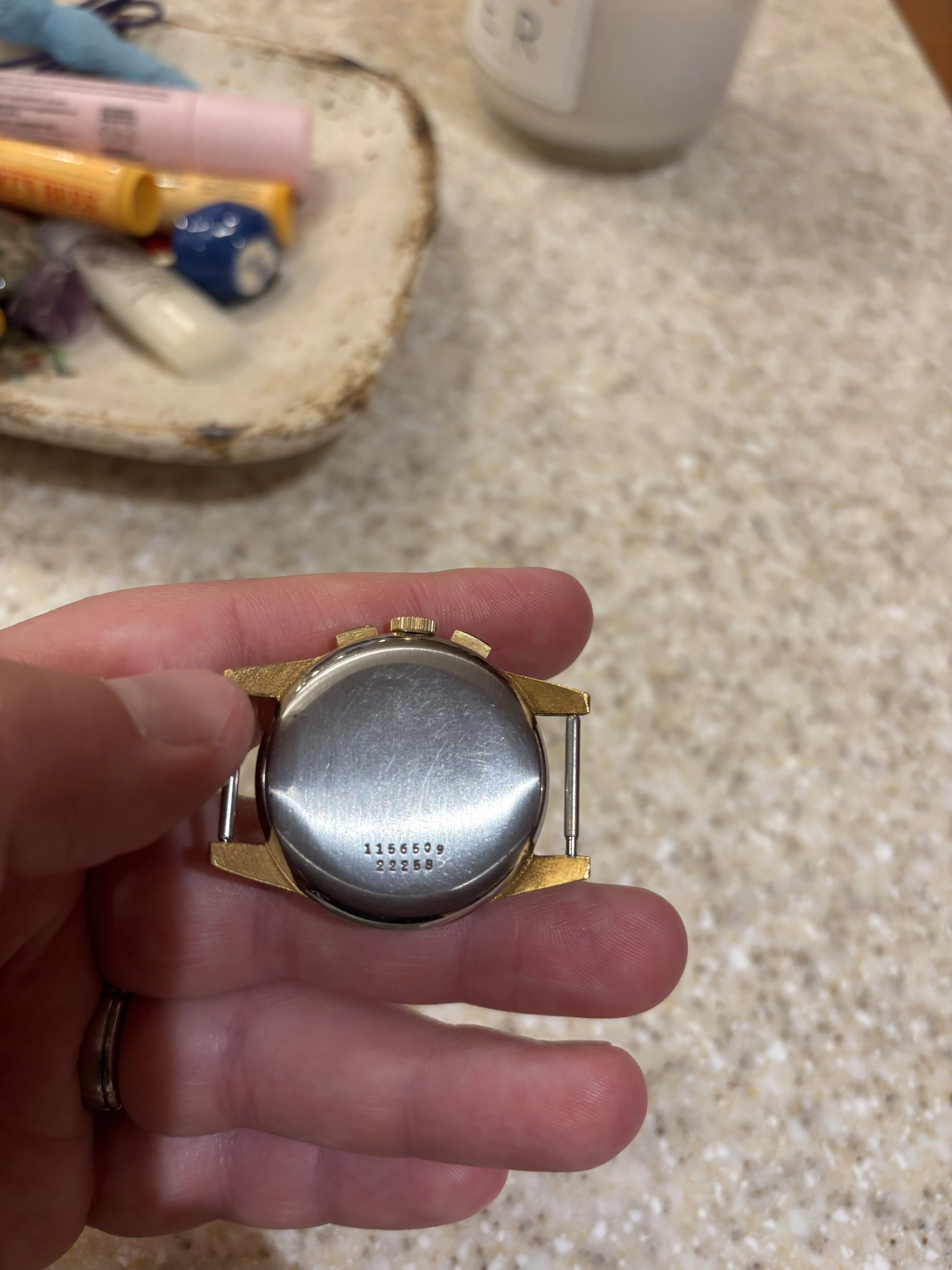

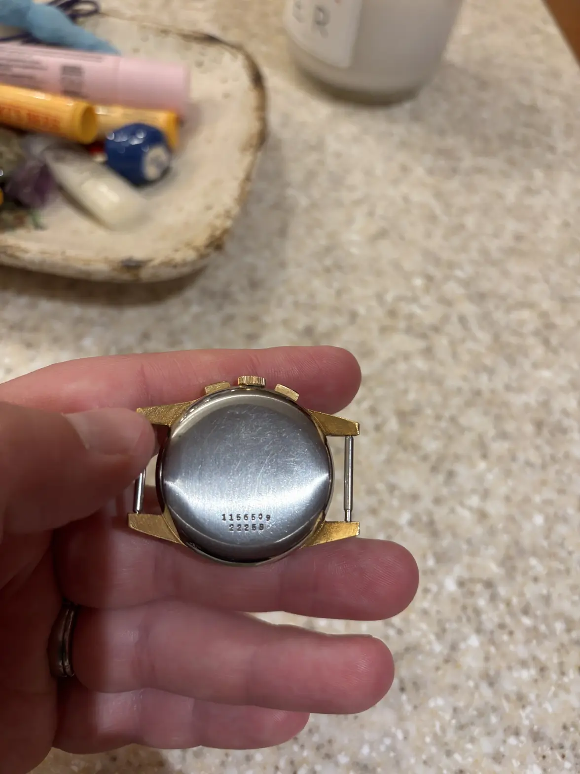

Good call! Here’s a picture of the back, it is a 1156. The reference number is 22258 with a P stamped at the end.
Any idea what the significance of the P is?

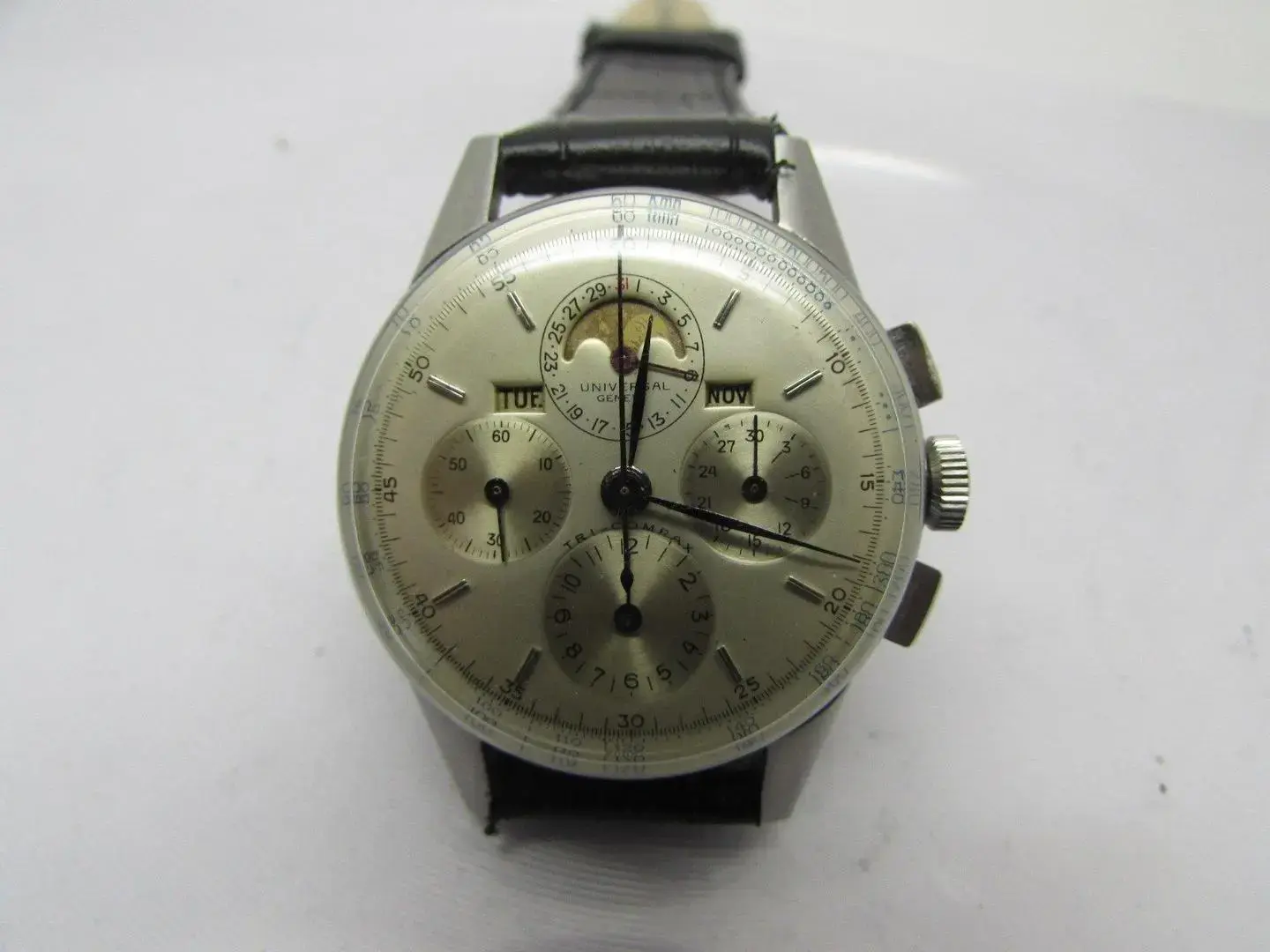

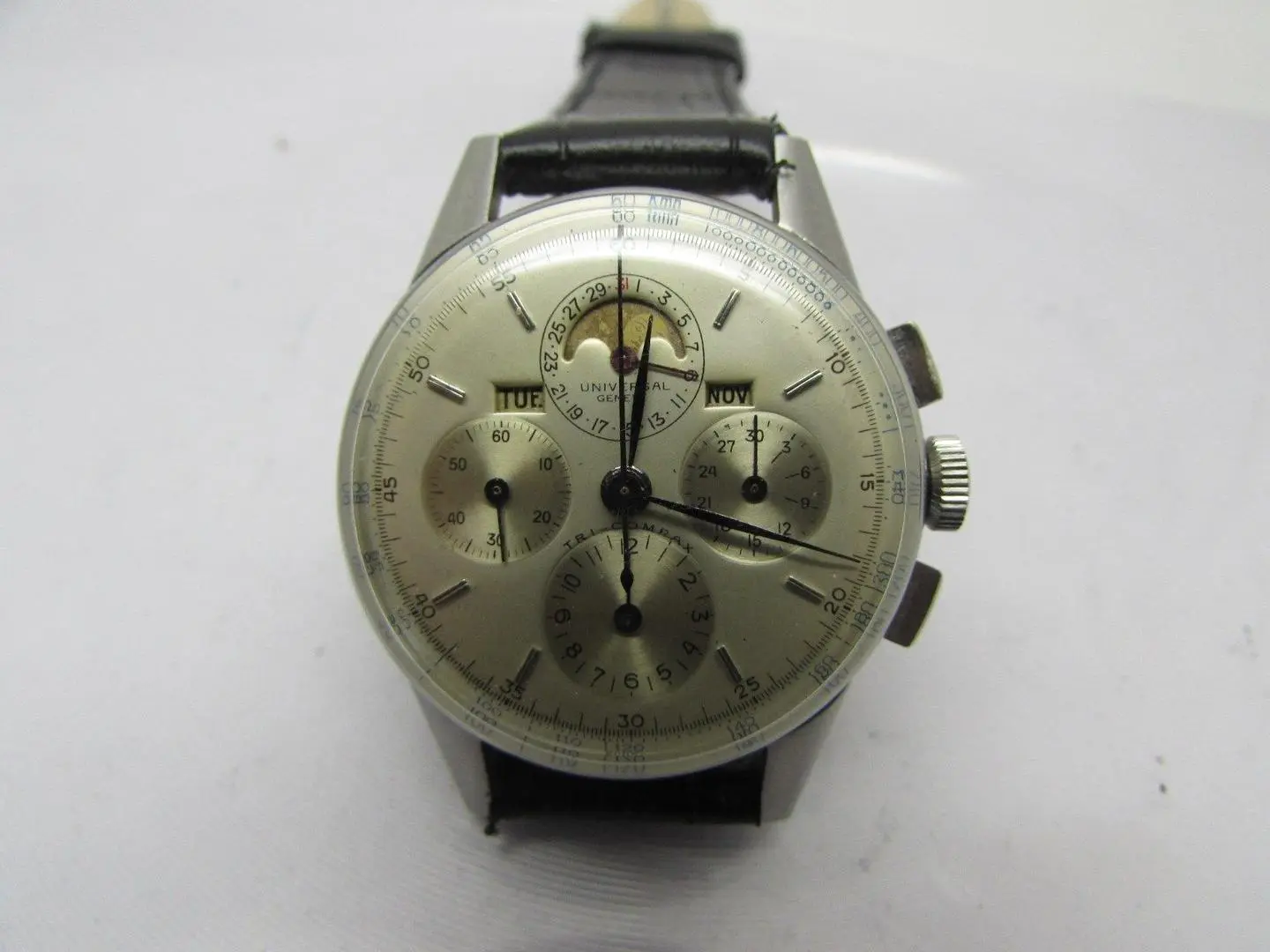

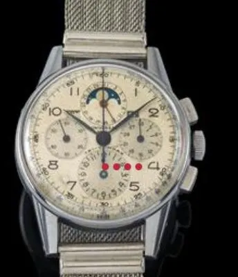

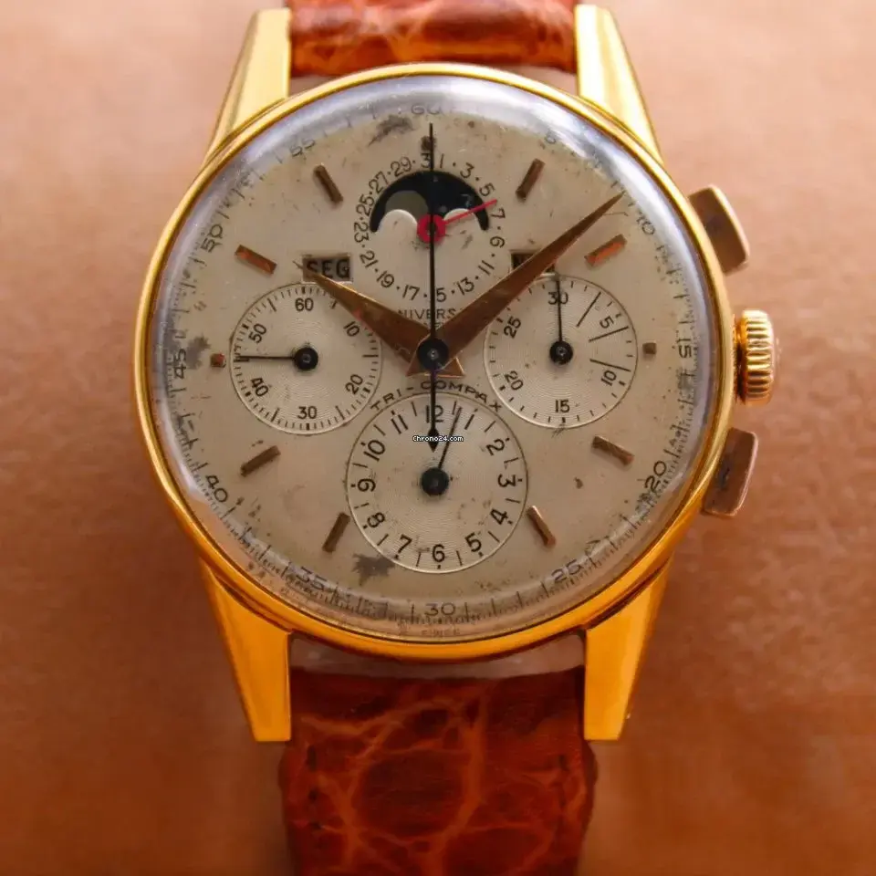

Isn't 22258 a SS reference?
I think there are ones with gold-plated tops and steel casebacks.

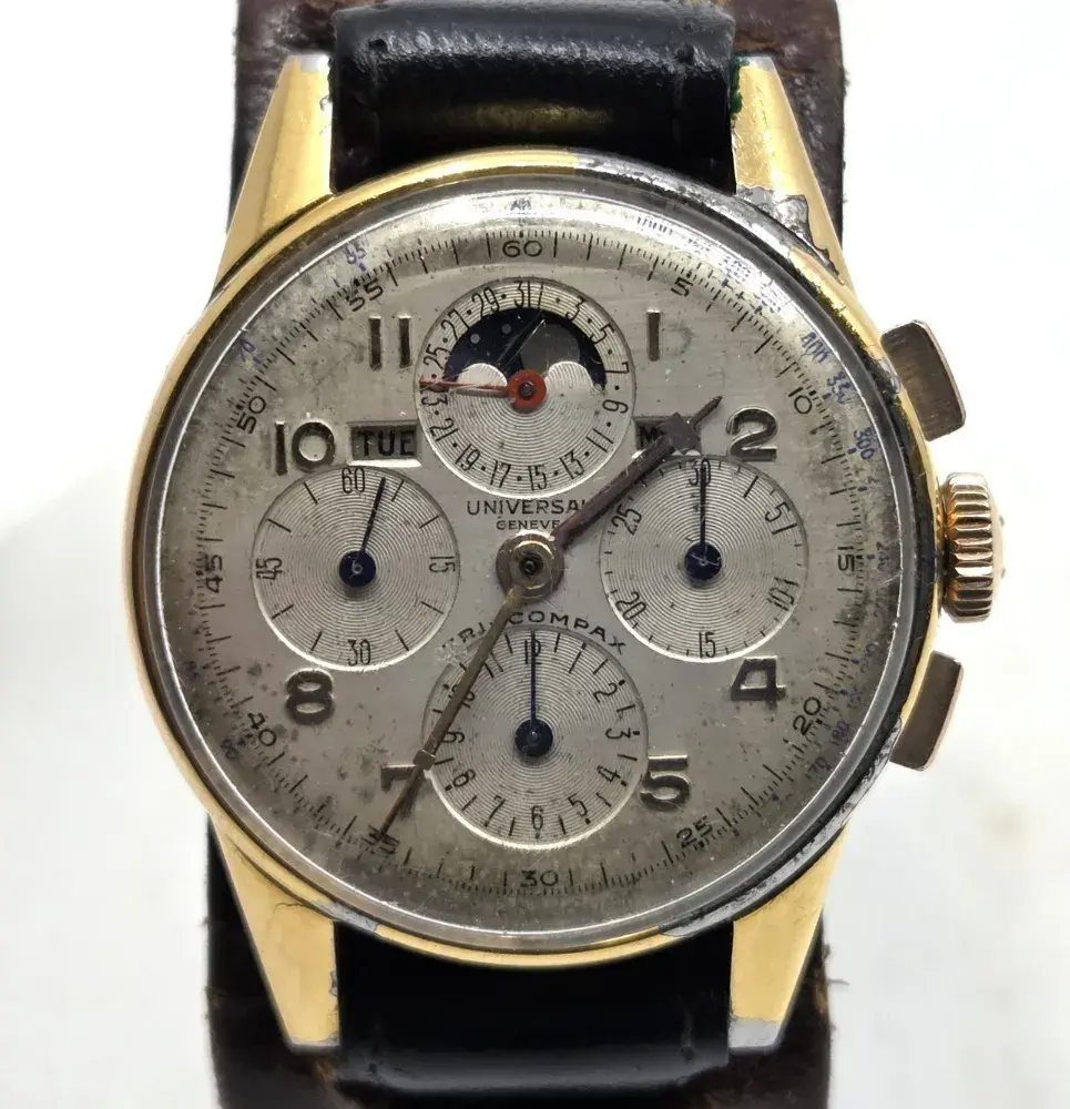

https://everywatch.com/universal-geneve/22258/watch-32354053

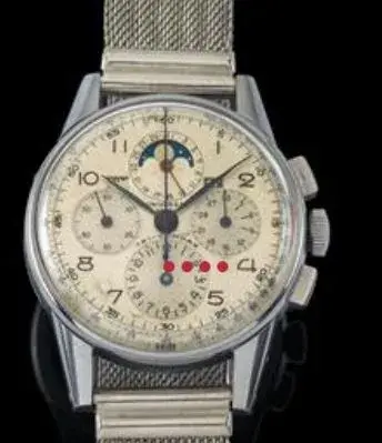

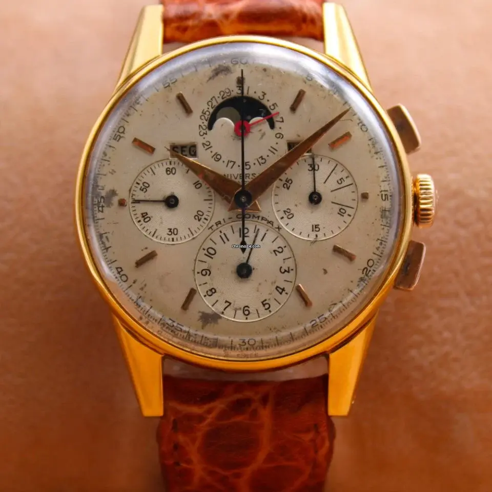

Serial numbers seem to be in the 1,156,xxx to 1,157xxx range, including the OP’s example above.
I can’t imagine that all 3 of these are frankens.

22258 is indeed a SS reference, but we've seen enough of these now I think we can assume it's got something to do with UG. Maybe it's gold cap and not gold plate (gold plate reference should start with 4) and so they left it under SS. I don't know, doesn't really make sense and it's kinda weird.
Getting back to the OP watch, looks nice, in good condition, the running seconds hand has been replaced. The hour and minute hands look weird, not something I used to. I would think leaf hands would be more typical, but if they match each other I would probably leave it alone.
If you can find a running seconds hand, either polish or replace the crystal, and probably due for a full service, you will have a very nice watch.
For this serial range I would expect a moon with face, but all three examples in this thread are similar serial and they are all faceless, so I don't know, maybe that's normal for these models which are already unusual to begin with.
I know another 22258 with it and I have no clue.
Dial is legit but in this batch of 22258's I have no comparable.

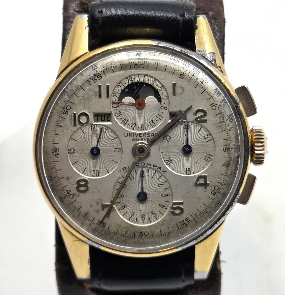

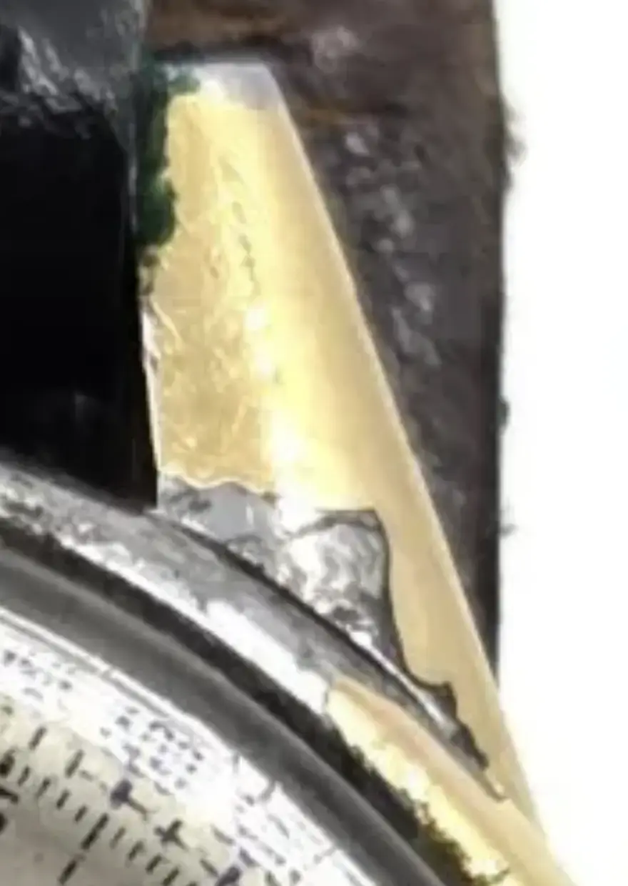

Here’s an enlargement of the top right lug of the Everwatch example I posted above.
You can see where the gold is flaking off the case. I’m not sure if this is thick enough to be considered anything more than gold-filled. For Polerouters, it is my understanding that UG used 300 micron gold capping, which is a bit more than Omega or Rolex used at that time.
My guess is these were some kind of gold plate or gold filled case, maybe only for US market. Without pictures of the movements, we cannot tell.
