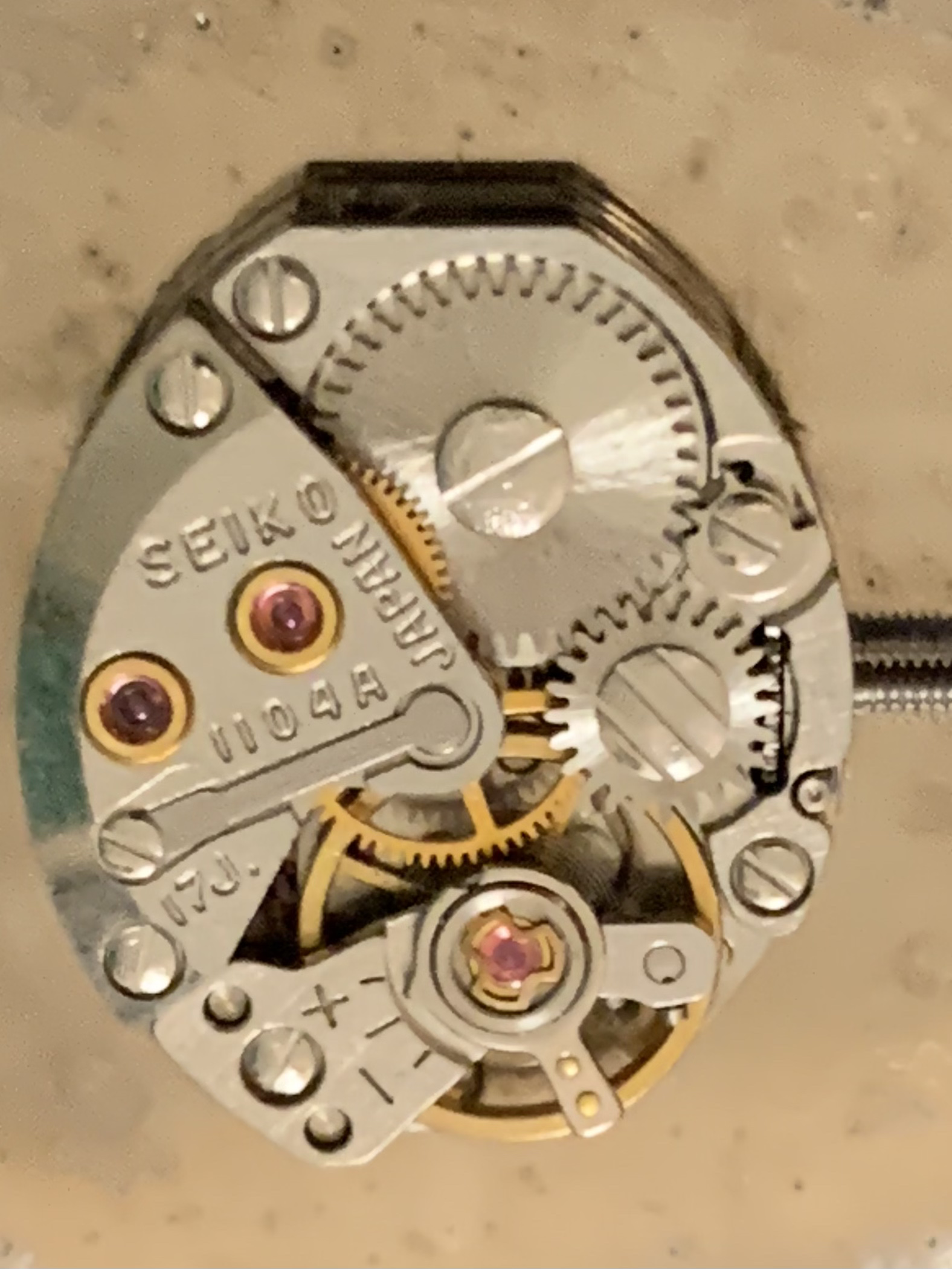

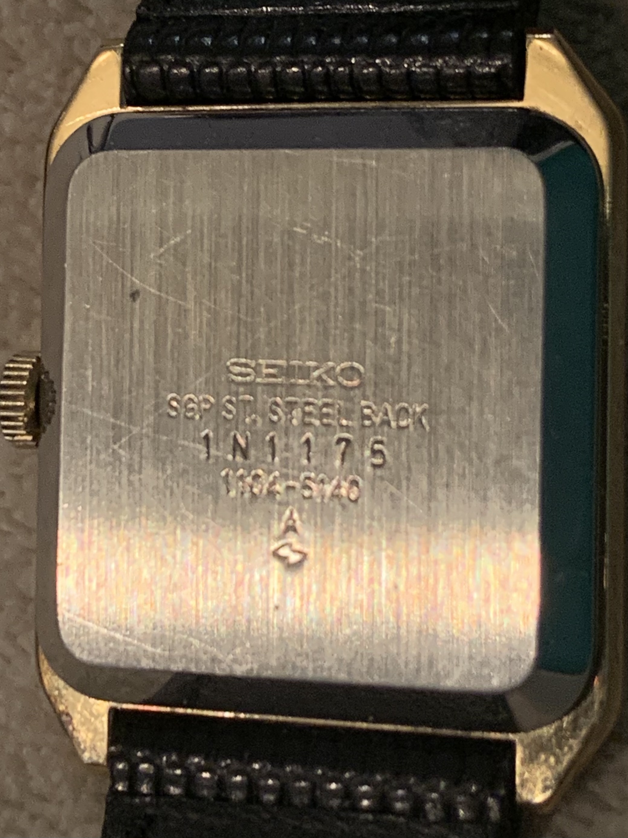

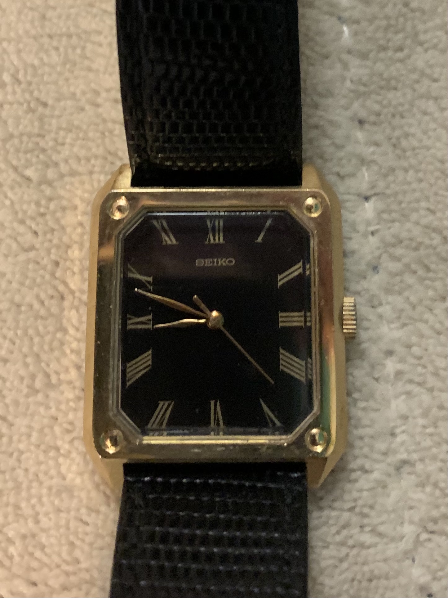

Flea market pick up. Small, manual wind dress watch. I looked through hundreds of watches in early 80's seiko catalogues and found similar watches, but no exact matches. Any info would be appreciated.

Pretty well everything that can be said about the watch is already there. Gold plated case, stainless steel back, tempered mineral crystal, case model #5140 (which means nothing), 17 jewel, manual wind movement, calibre 1104. Watch circa late 1960s. Hard to tell from your pictures, but being as that mechanism is designed for a ladie’s model, it would seem it might be a ladie’s watch. Looks to be in good shape. What more would you like to know?

The serial number indicates November of a year ending in "1". I would guess November 1981.

Thank you for the input. However, it's early 80's, not 60's. And it's most definitely a mans watch. Typical 80's mens dress watch dimensions. My photo of the movement isn't very inclusive. The movement is much smaller than the dial. So it might be a movement that was made for women's watches, but here it's in a mans watch. I'd love to know the model name.

That's what I figured. From what I could find online the movement was made from 1969-1979. Lots of watches that look like it in the 1981 catalogue, but no exact matches. Clean little watch.
