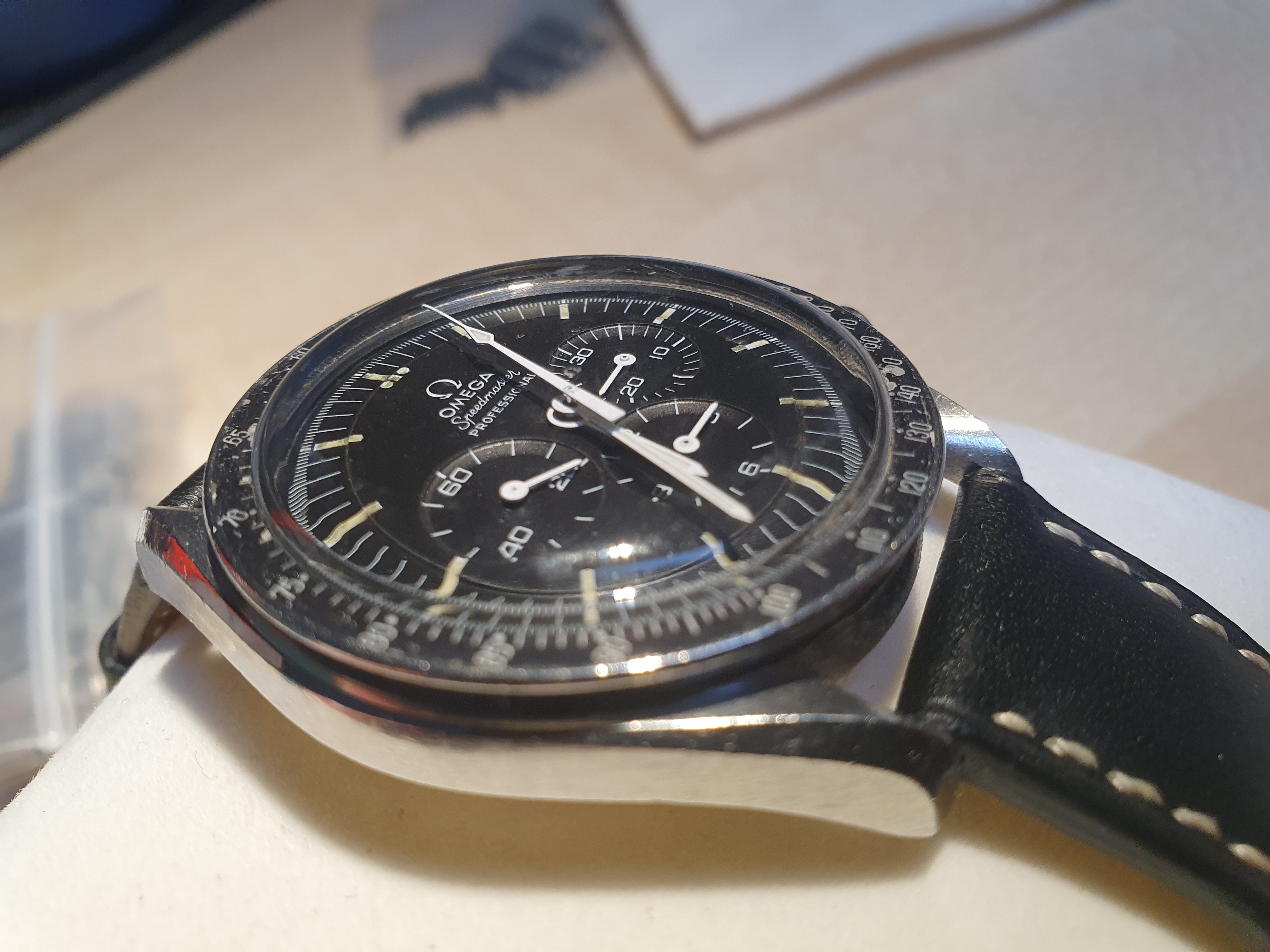

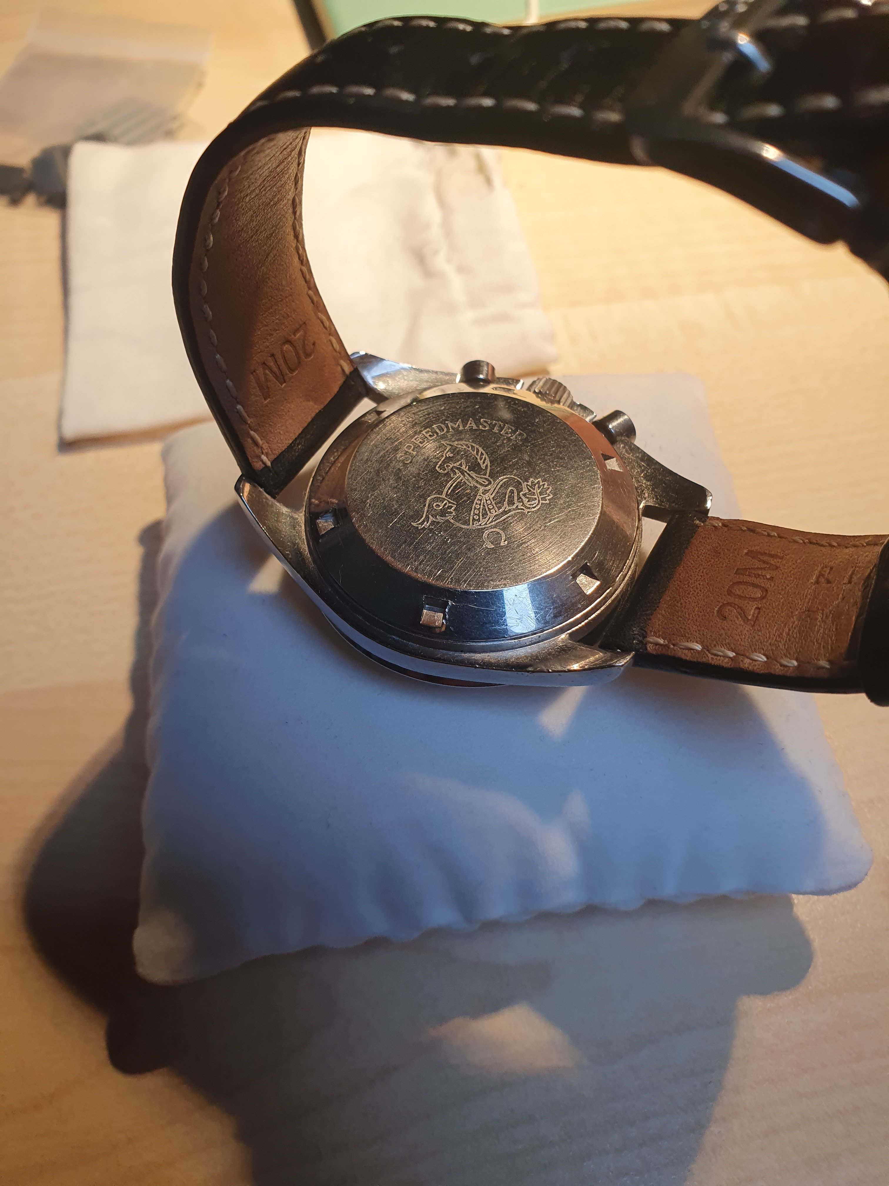

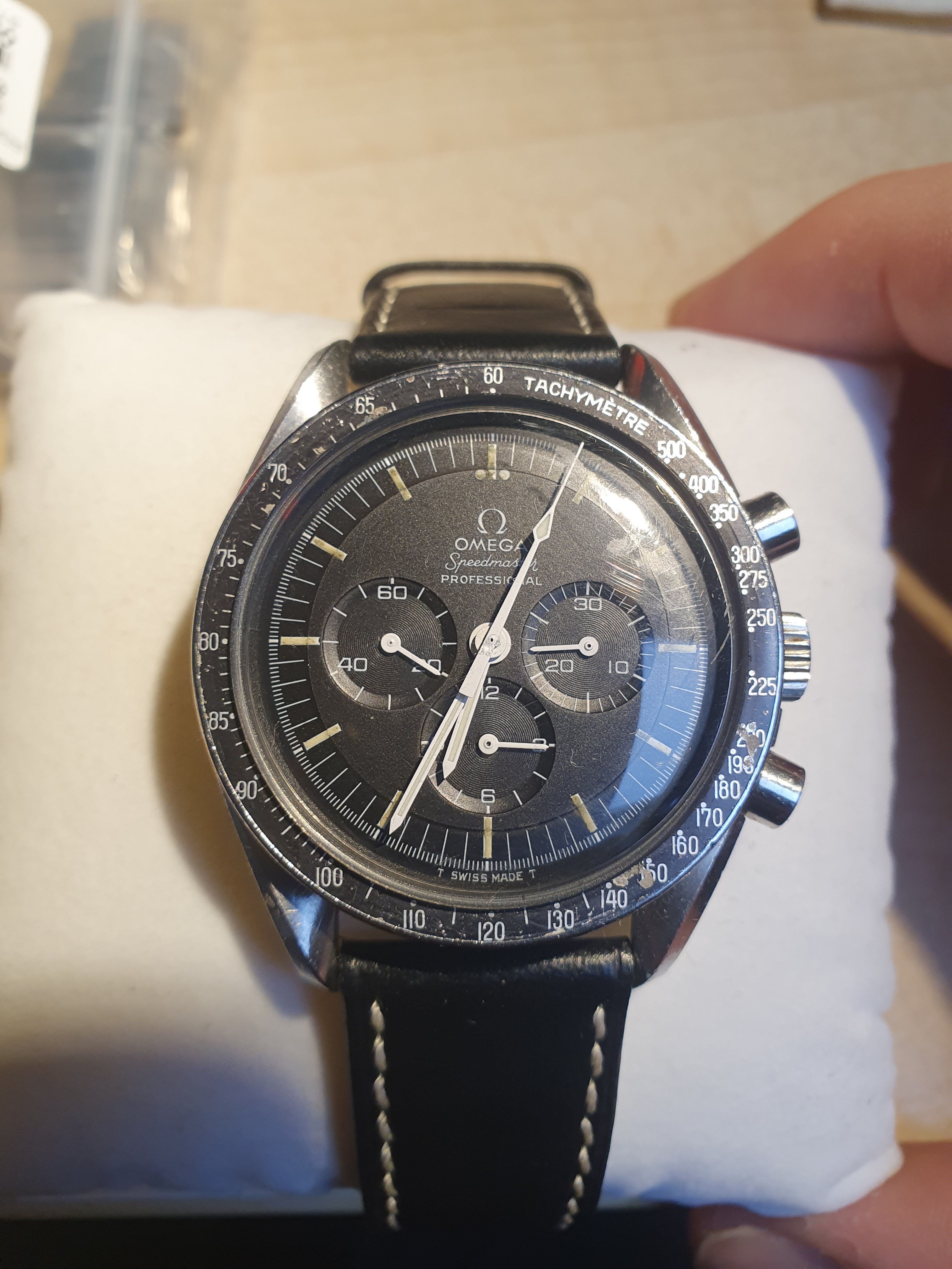

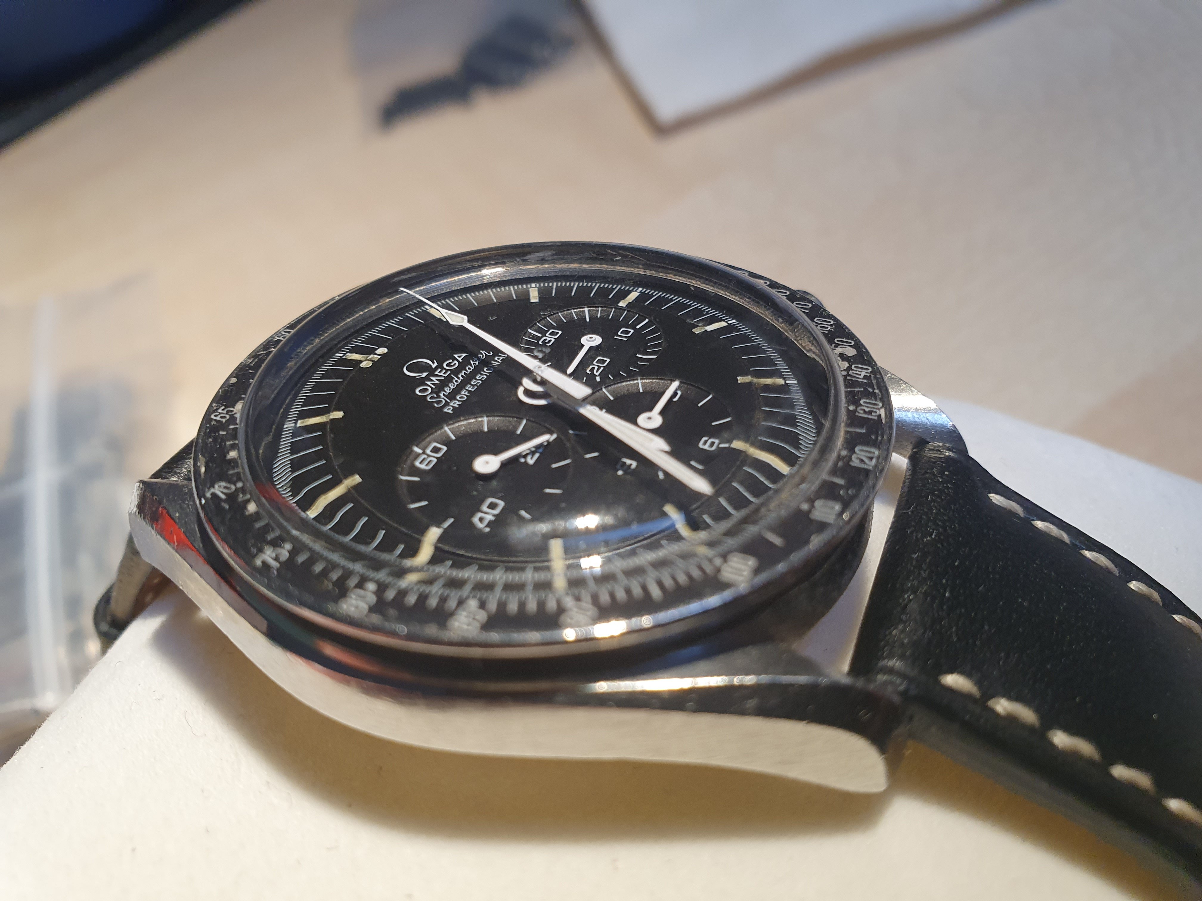

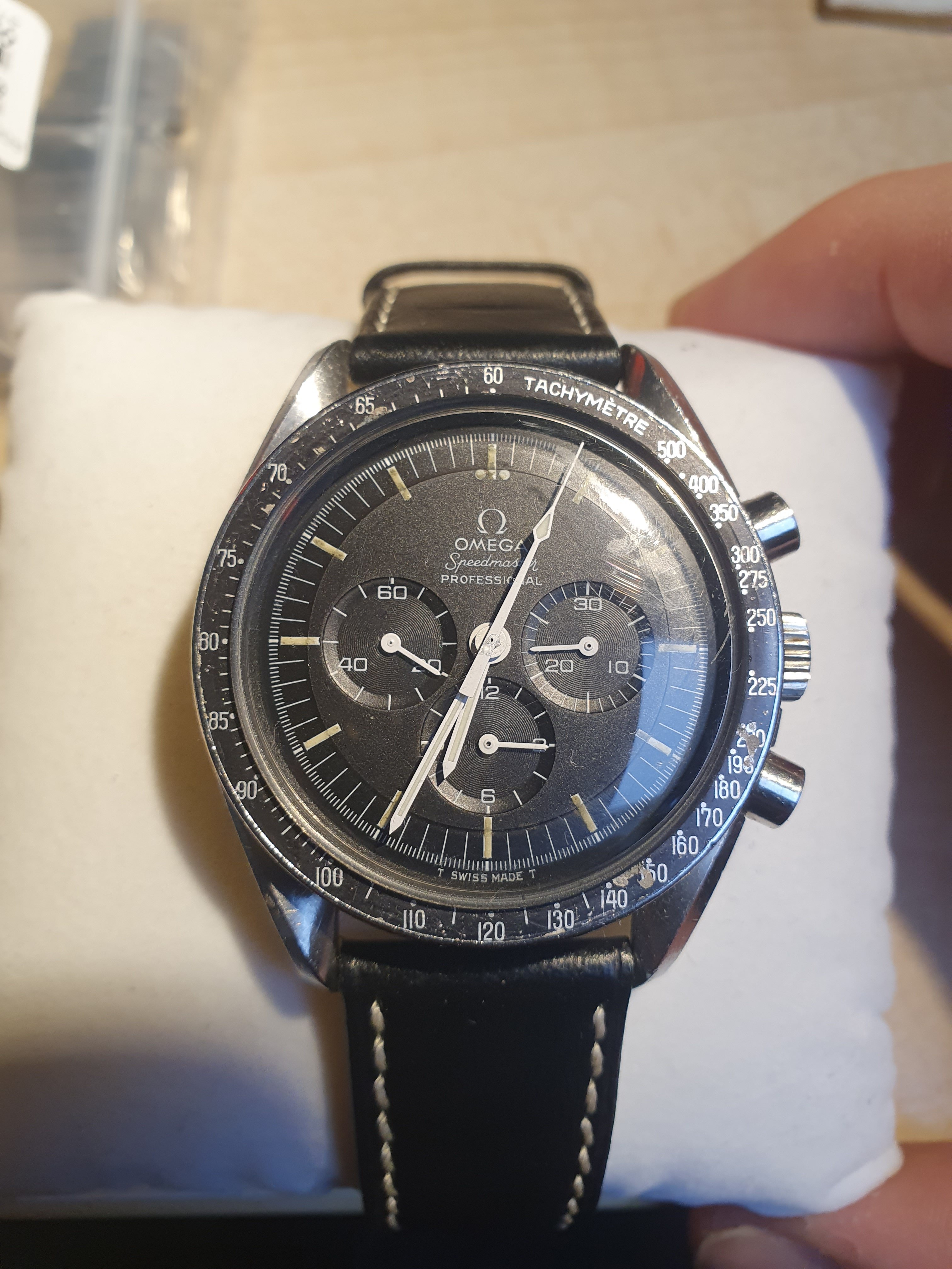

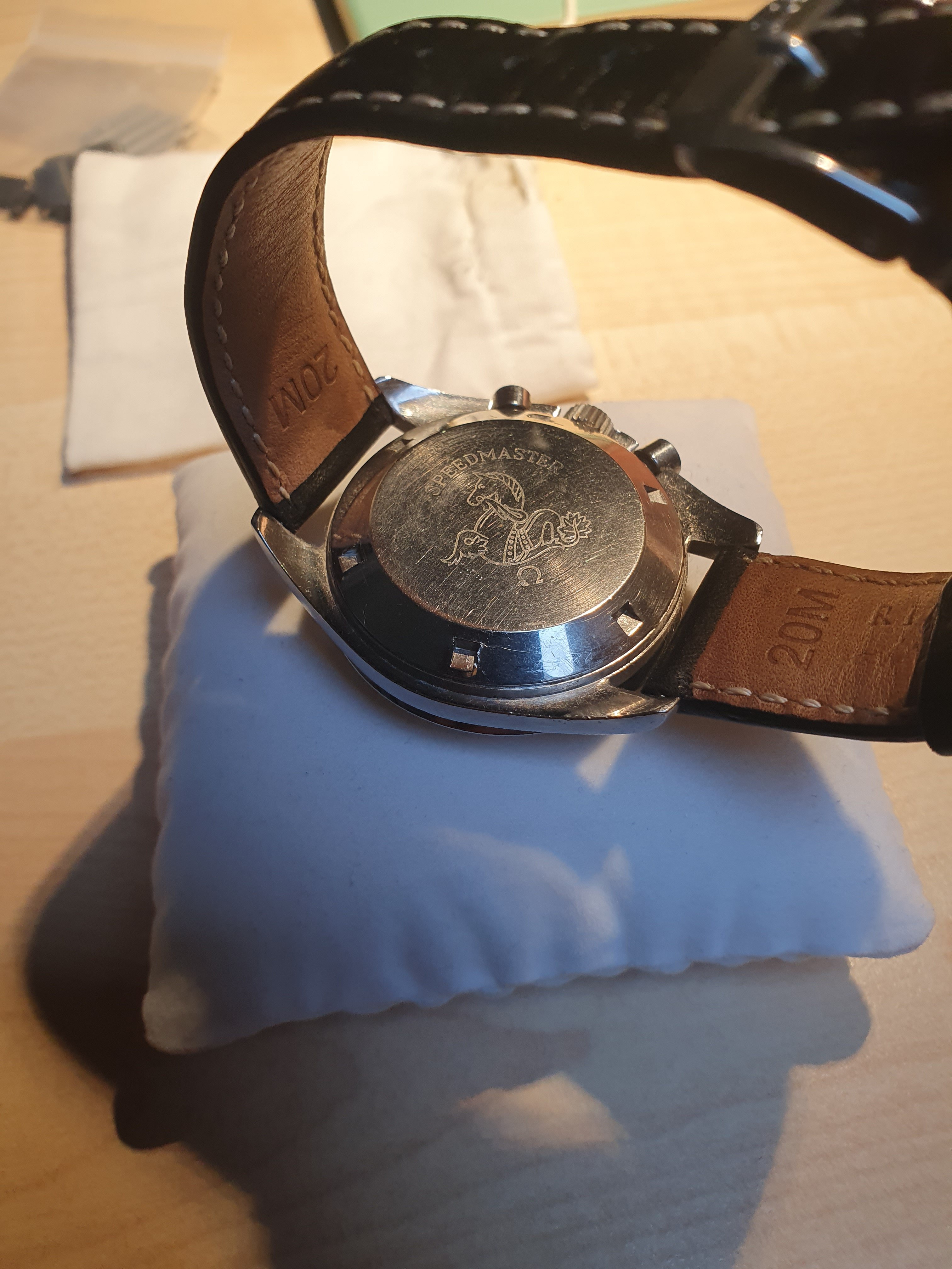

looking for advice on a strap/bracelet for a speedmaster 145022-69st
3
3
This is a watch my grandfather left me. I had it serviced 2 years ago. The wachtmaker then told me if i wanted a original bracelet i should look for a 1039/516 bracelet. But as these are quite pricey is this really worth it as it wont be the original set? And if someone knows some other options for a nice looking bracelets to go with this watch?
Ref. 145022-69st
Cal. 861
13,559
23,507
Forstner and Uncle Seiko make replica Flat Link bracelets which are a cheaper alternative.
Personally though, I think there’s no substitute for the original.

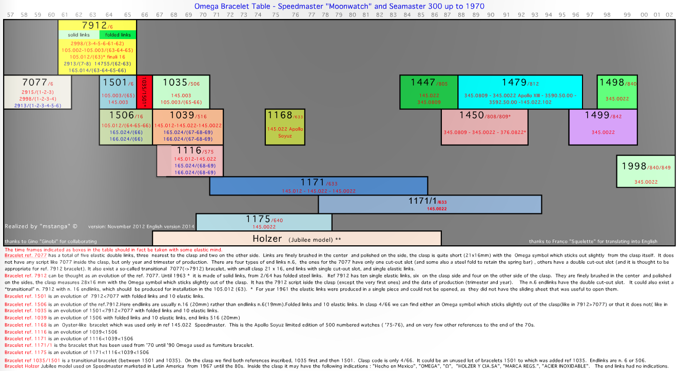

I'm not sure where the "break" is with 1969 serial numbers, but this bracelet reference guide from Millenary Watches indicates that both the 1171 and the 1175 would be correct for a 1969 145.022: Omega Bracelet Reference Numbers Ultimate Guide - Millenary Watches
IMO the first 1175’s came with the straight writing case back -69’s, certainly not a DoN, 29m -69.
1171’s first appeared on the -71 imo.
Perhaps some appeared on very late -69’s but I’ve never seen one on a watch that appeared original.
Neither 1175 nor 1171 are correct for a 29m serial -69 imo.
