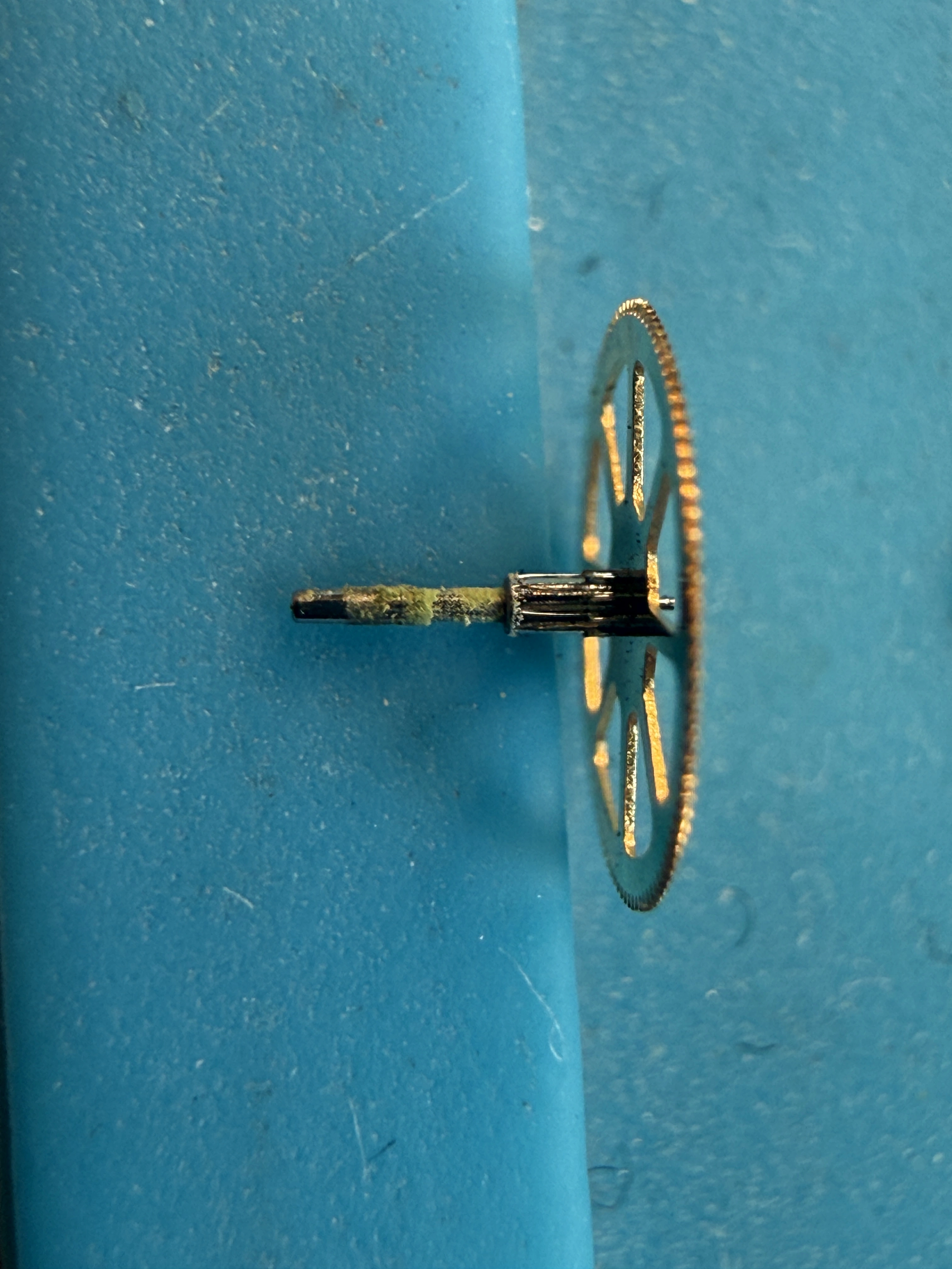

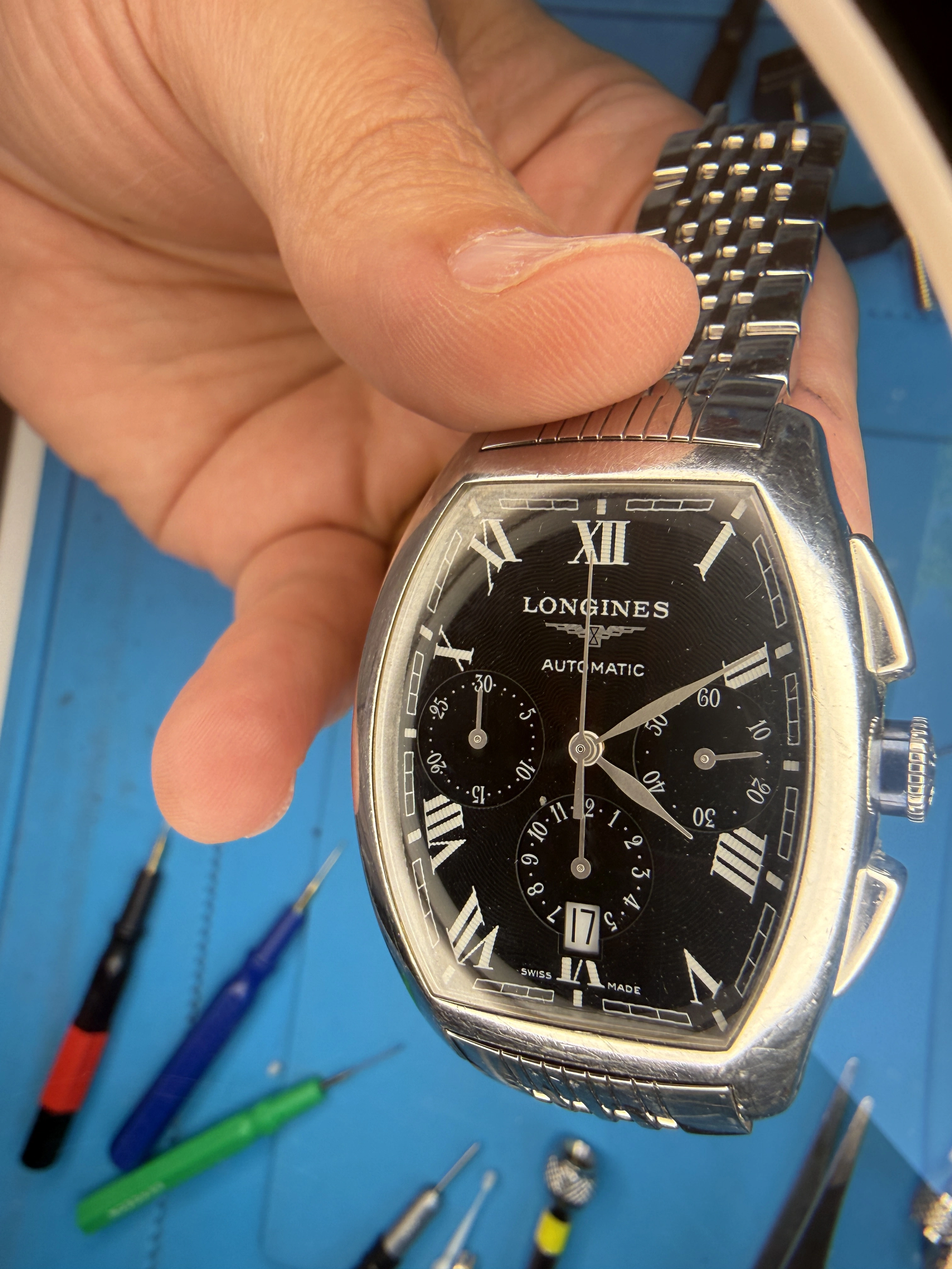

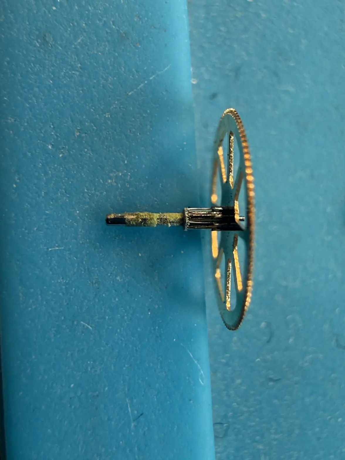

Next project on my bench is this Longines chrono with an ETA 2984-2 inside. I removed the second wheel and found corrosion on the shaft….
I haven’t dealt with verdigris much, but I’ve dealt with plain ol’ rust. Anyone have any good recommendations for how to manage this? Or should I just assume to need to buy a replacement wheel?

Verdigris can usually be cleaned with vinegar or something acidic. It's green thought, what you have looks different?

Verdegris can usually be cleaned with vinegar or something acidic. It's green thought, what you have looks different?
I tried vinegar and it worked. Thank you. (And from the pics, it may not appear green but it is… the post is bronze, which is probably where it came from.)
